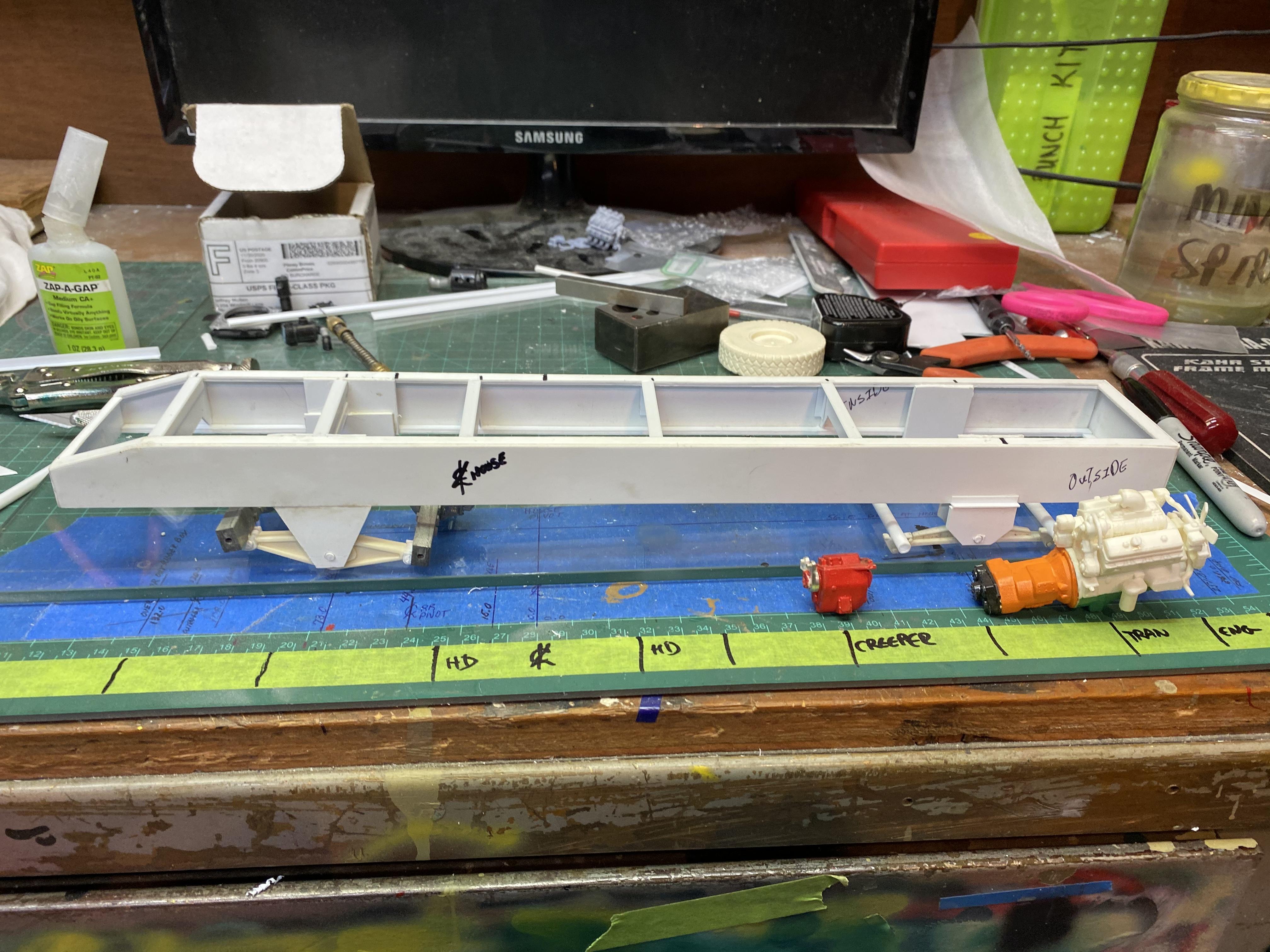

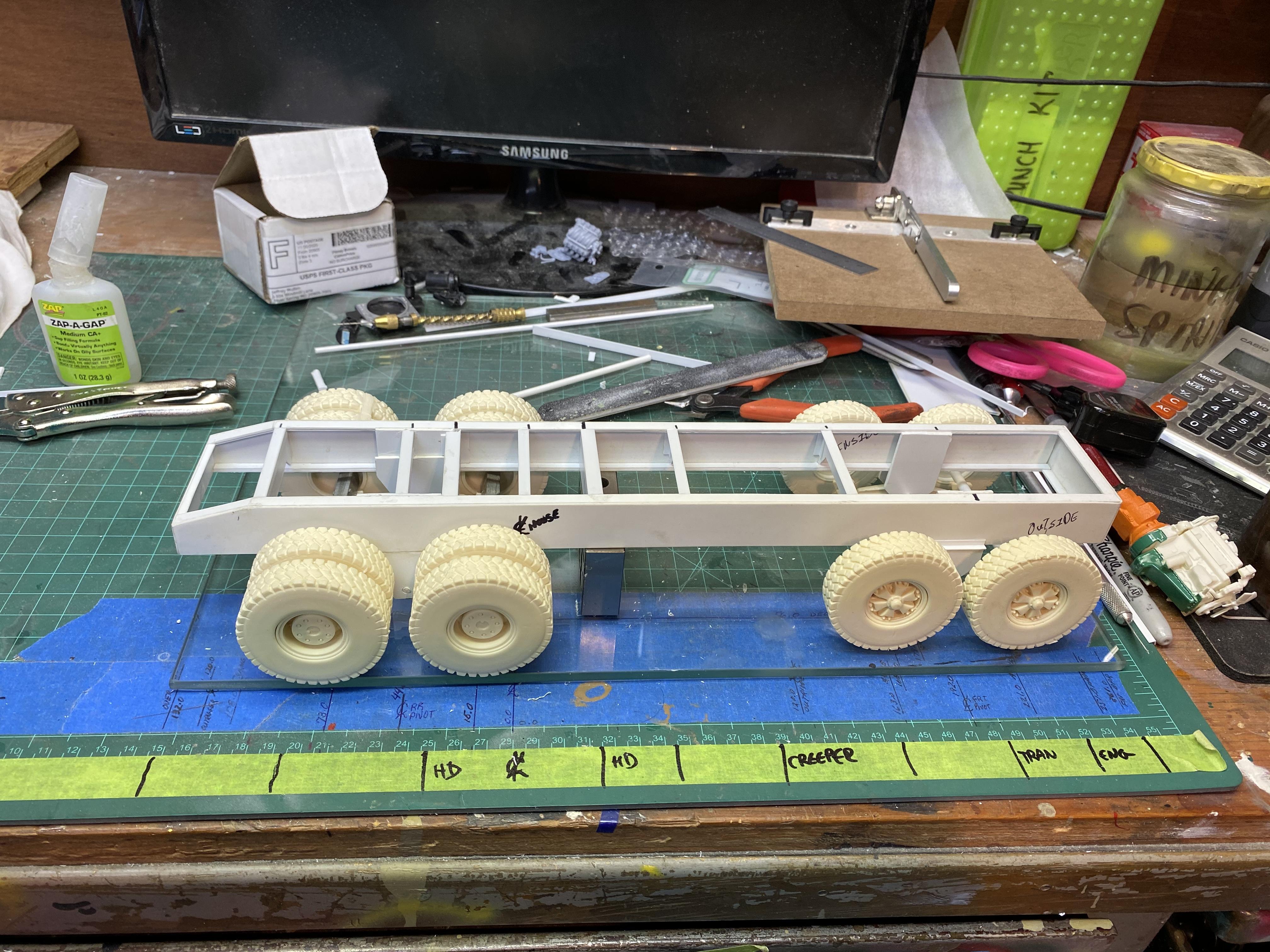

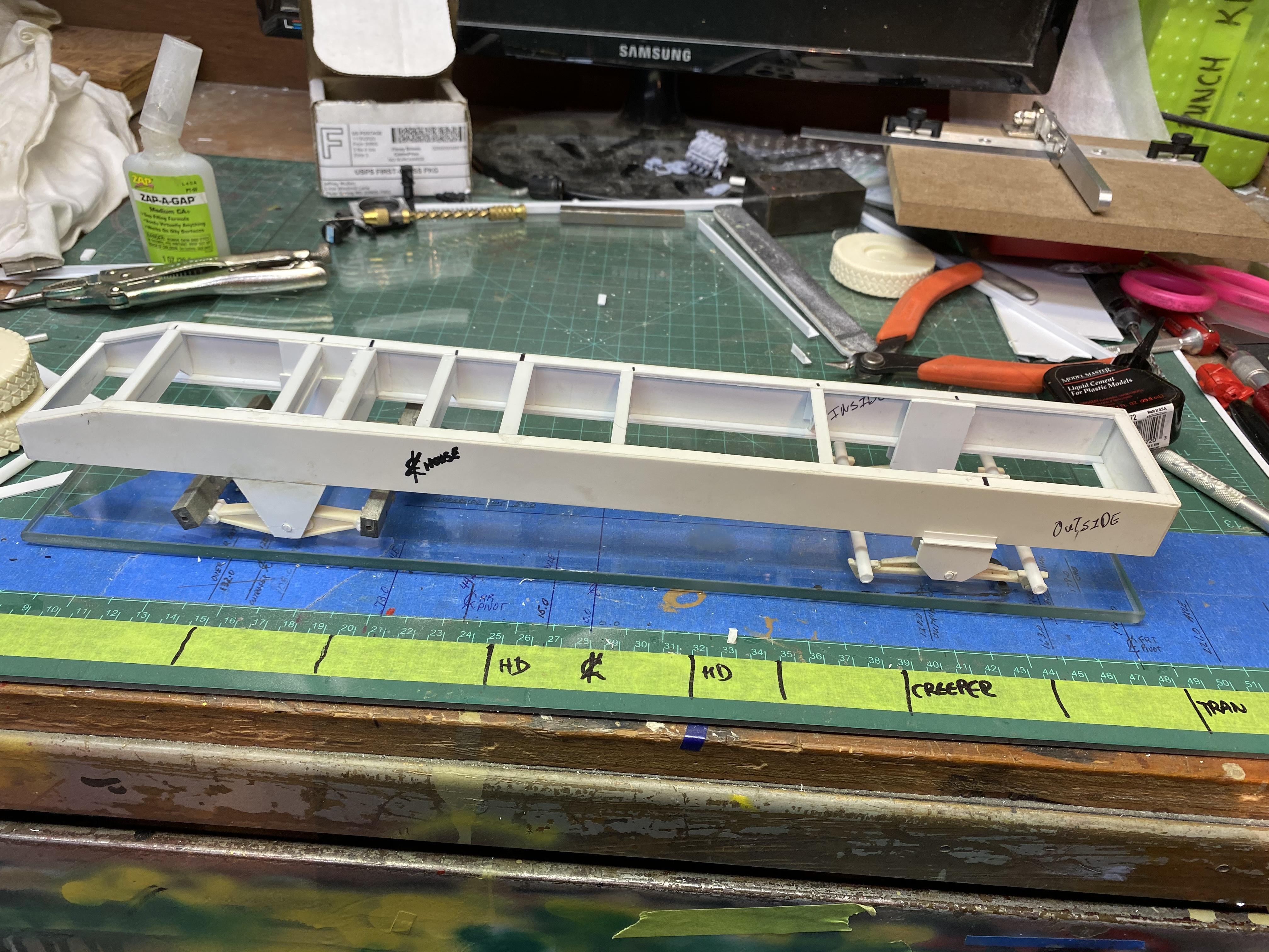

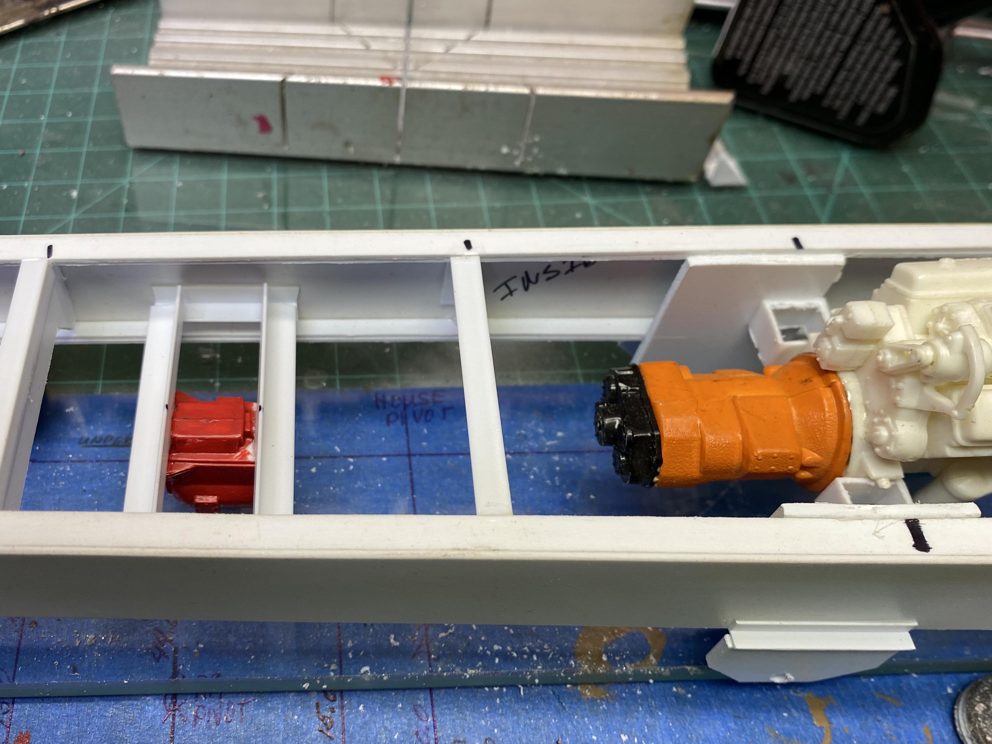

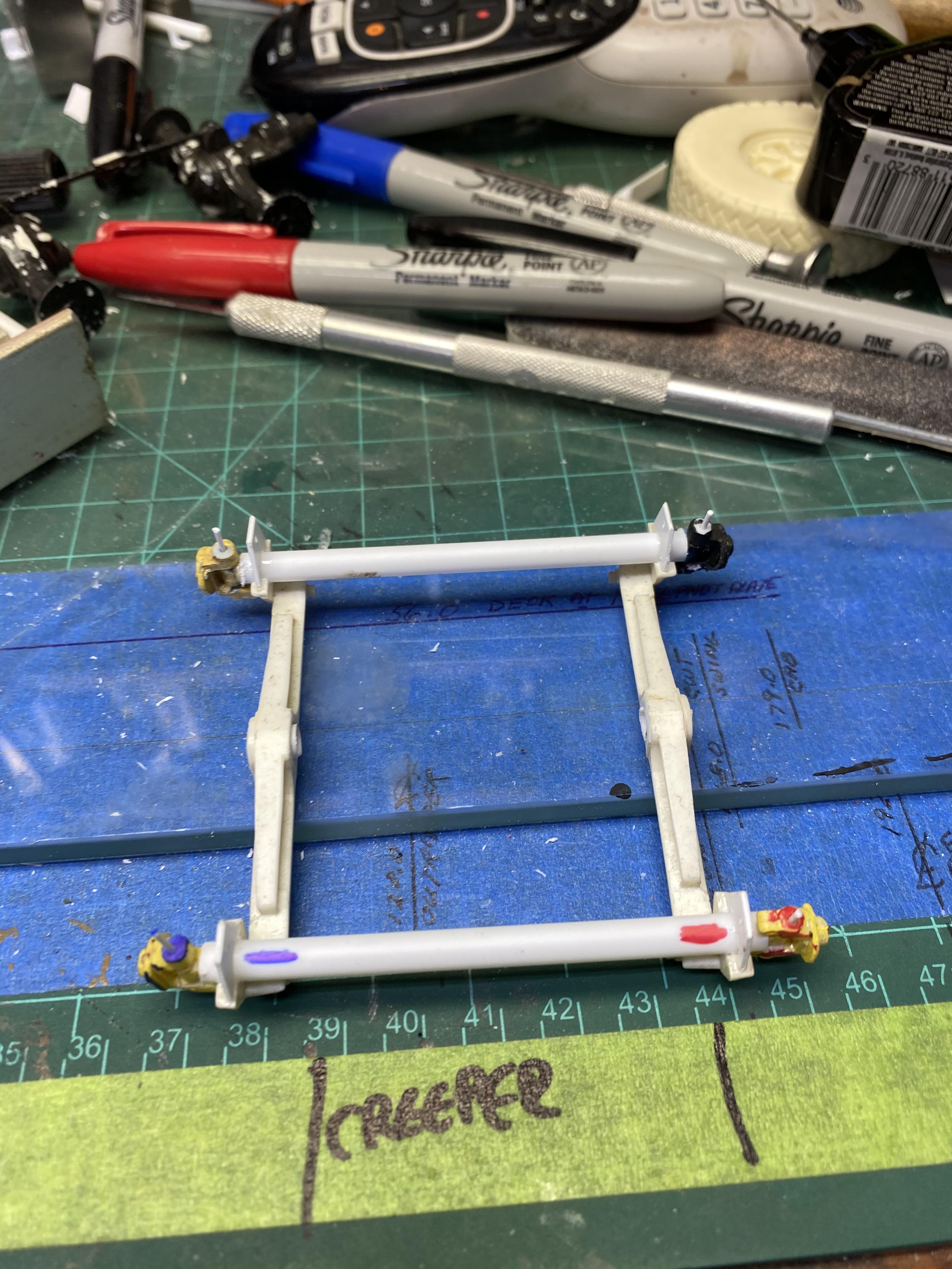

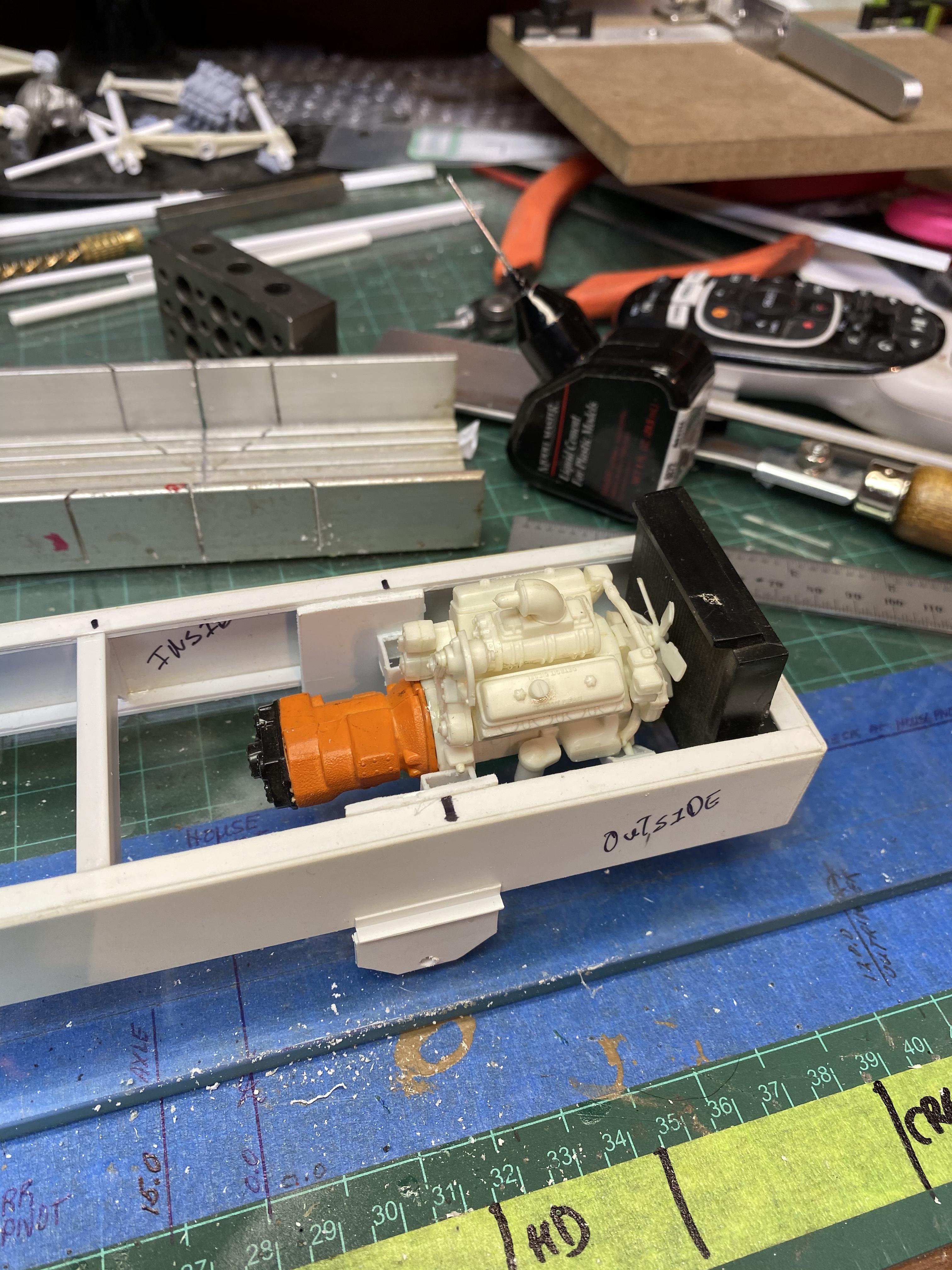

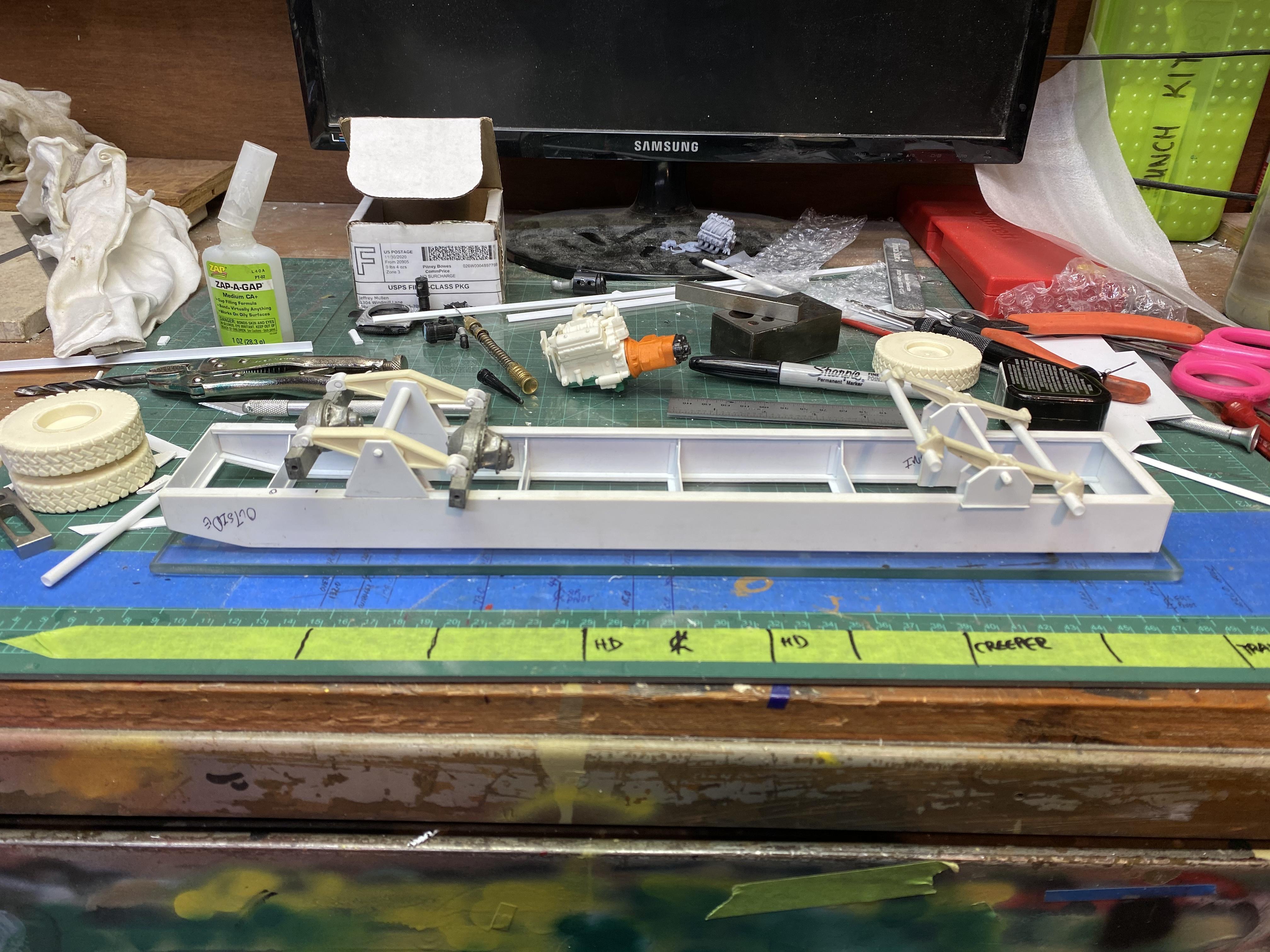

redneckrigger Posted December 16, 2020 Author Posted December 16, 2020 (edited) FINALLY found the time and energy to get back to work on this build. Roughed in the front and rear suspensions and all of the crossmembers. Also roughed in the engine mounts and the creeper transmission and mount. Got down to take some photos of the real one as well. My gun shop is going crazy right now, and added to deer season, available time to work on this is about non existent. Add that to a nasty bout of builder’s block and its sure been a while! Hope to keep it going now. Need to figure out tandem front axle steering next Edited December 16, 2020 by redneckrigger

GLMFAA1 Posted December 16, 2020 Posted December 16, 2020 Tandem steering should be easier than the steering on your last project. 4 tie rods: 90 degree wheel knuckle with tie rod left to right and then tie rod from front to back. You might get away with just three tie rods. The Revell Simba crash truck has tandem front steering. greg
redneckrigger Posted December 17, 2020 Author Posted December 17, 2020 Will check out my Simba kit.......THANKS!

Chariots of Fire Posted December 18, 2020 Posted December 18, 2020 Hey, Tom can I make a suggestion: Get either some aluminum or brass tubing, make two bearings for the walking beams and then slip the next size down tubing in as the connection between the two sides. As you build, the weight is going to get more and more on the plastic rods you are using now and could in time deform or break. I'm liking what I see for sure!

redneckrigger Posted December 20, 2020 Author Posted December 20, 2020 (edited) On 12/17/2020 at 11:30 PM, Chariots of Fire said: Hey, Tom can I make a suggestion: Get either some aluminum or brass tubing, make two bearings for the walking beams and then slip the next size down tubing in as the connection between the two sides. As you build, the weight is going to get more and more on the plastic rods you are using now and could in time deform or break. I'm liking what I see for sure! That’s a great idea Charlie..........will convert to metal axles and bushings shortly!!!! Thanks! Edited December 20, 2020 by redneckrigger

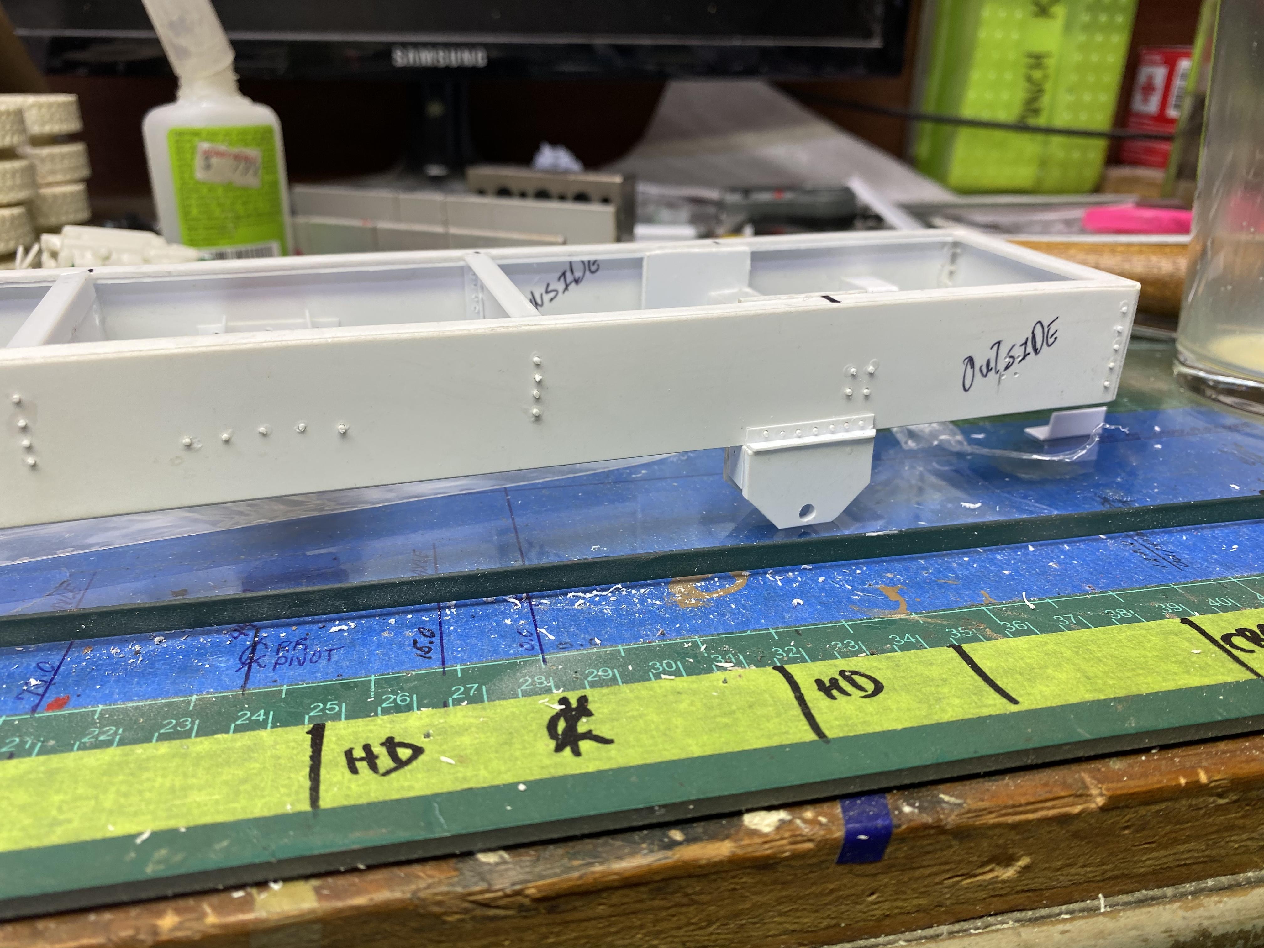

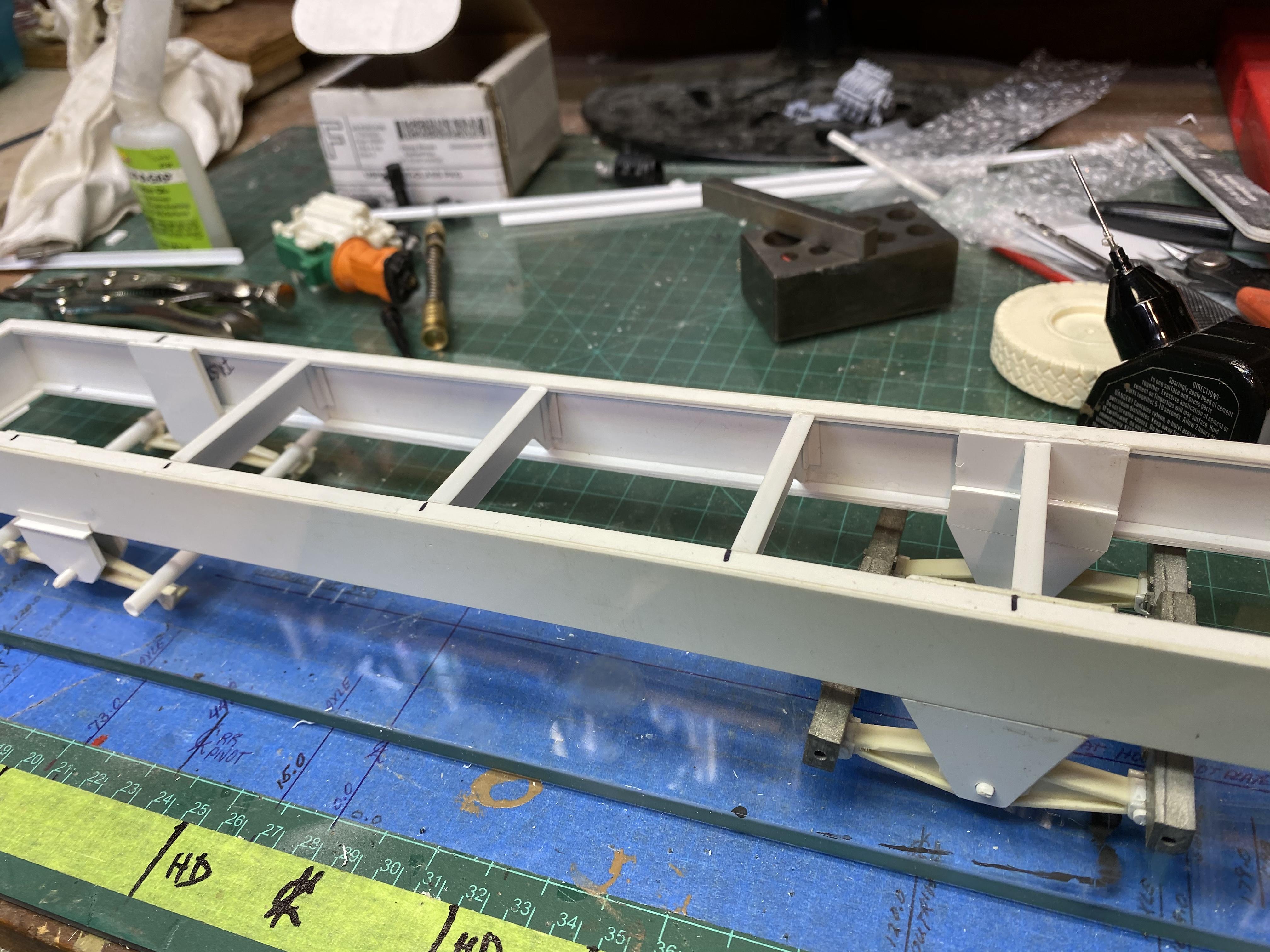

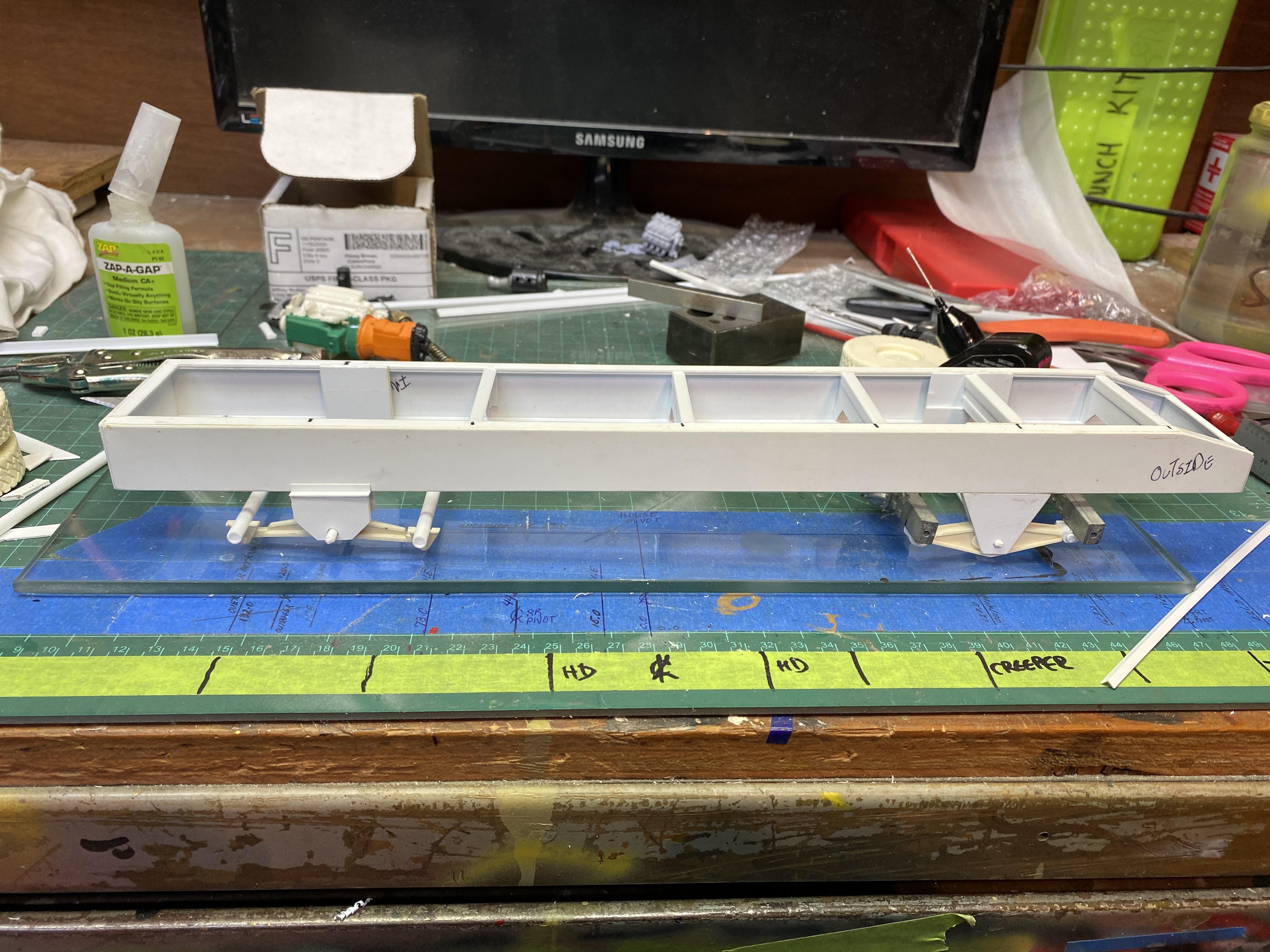

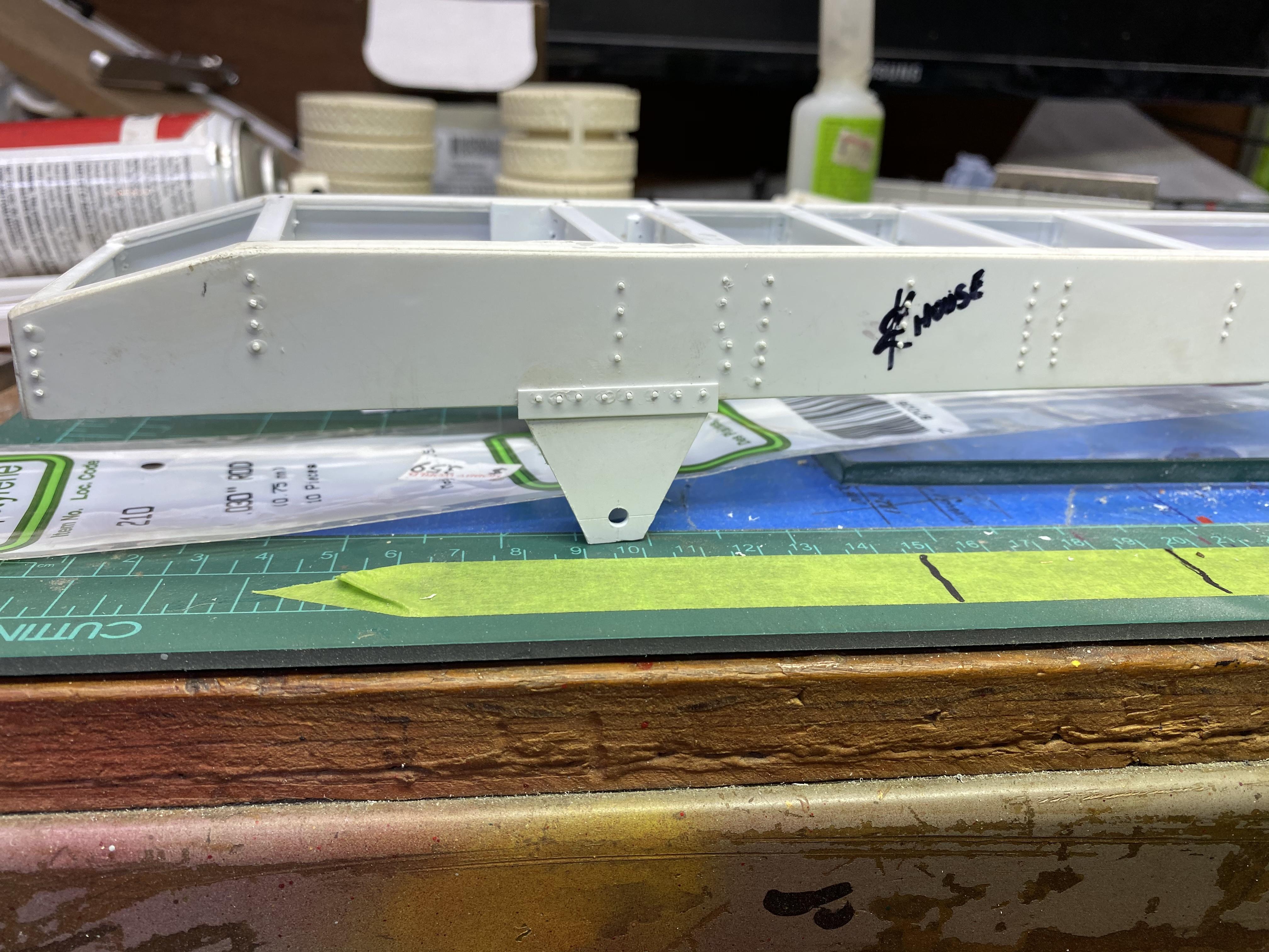

redneckrigger Posted December 20, 2020 Author Posted December 20, 2020 (edited) Pretty much all of the frame is done, and all crossmembers are in with all of the rivets (166 of them), that hold it all together. Lots of tiny bits!!! Edited December 20, 2020 by redneckrigger

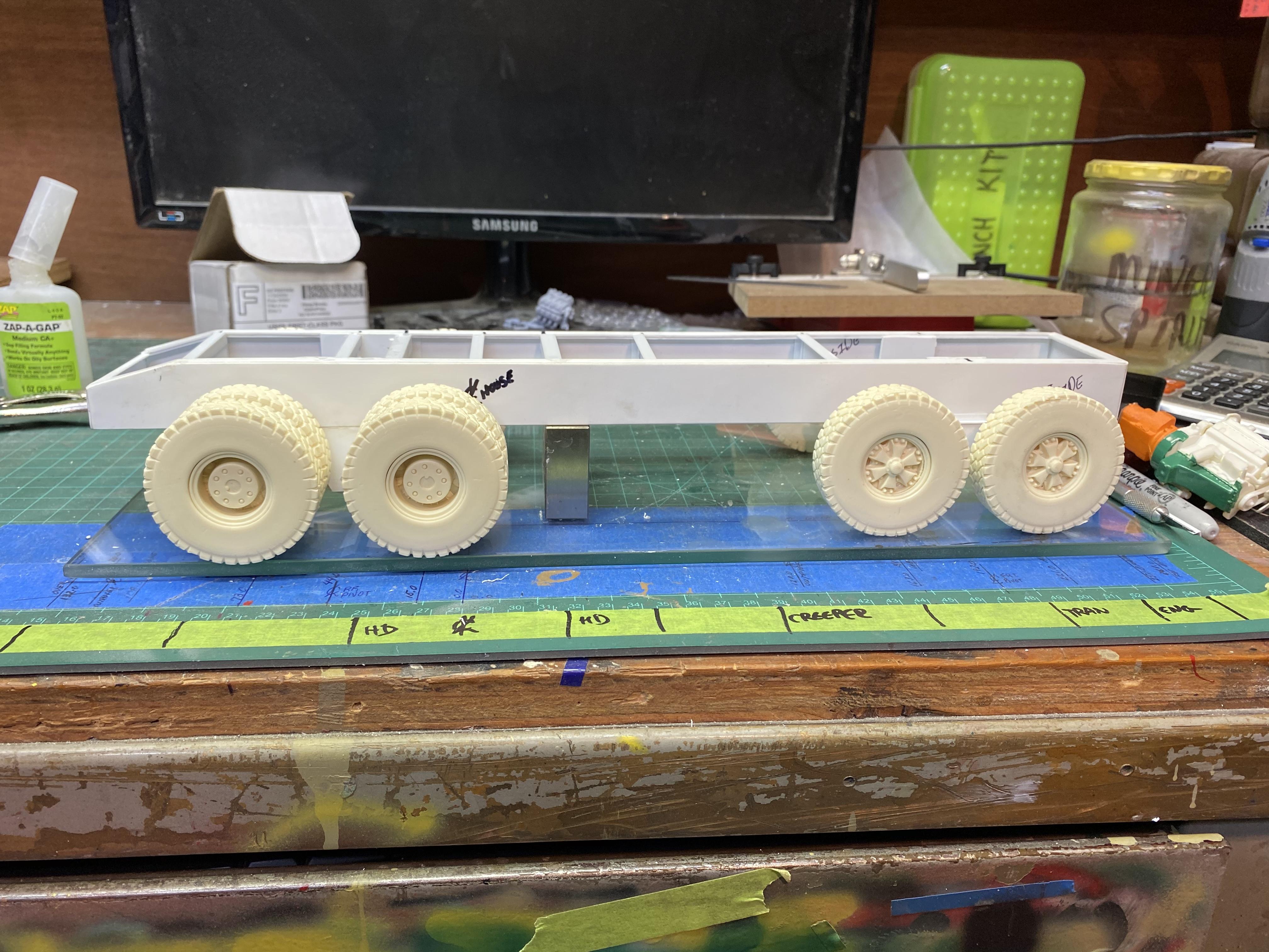

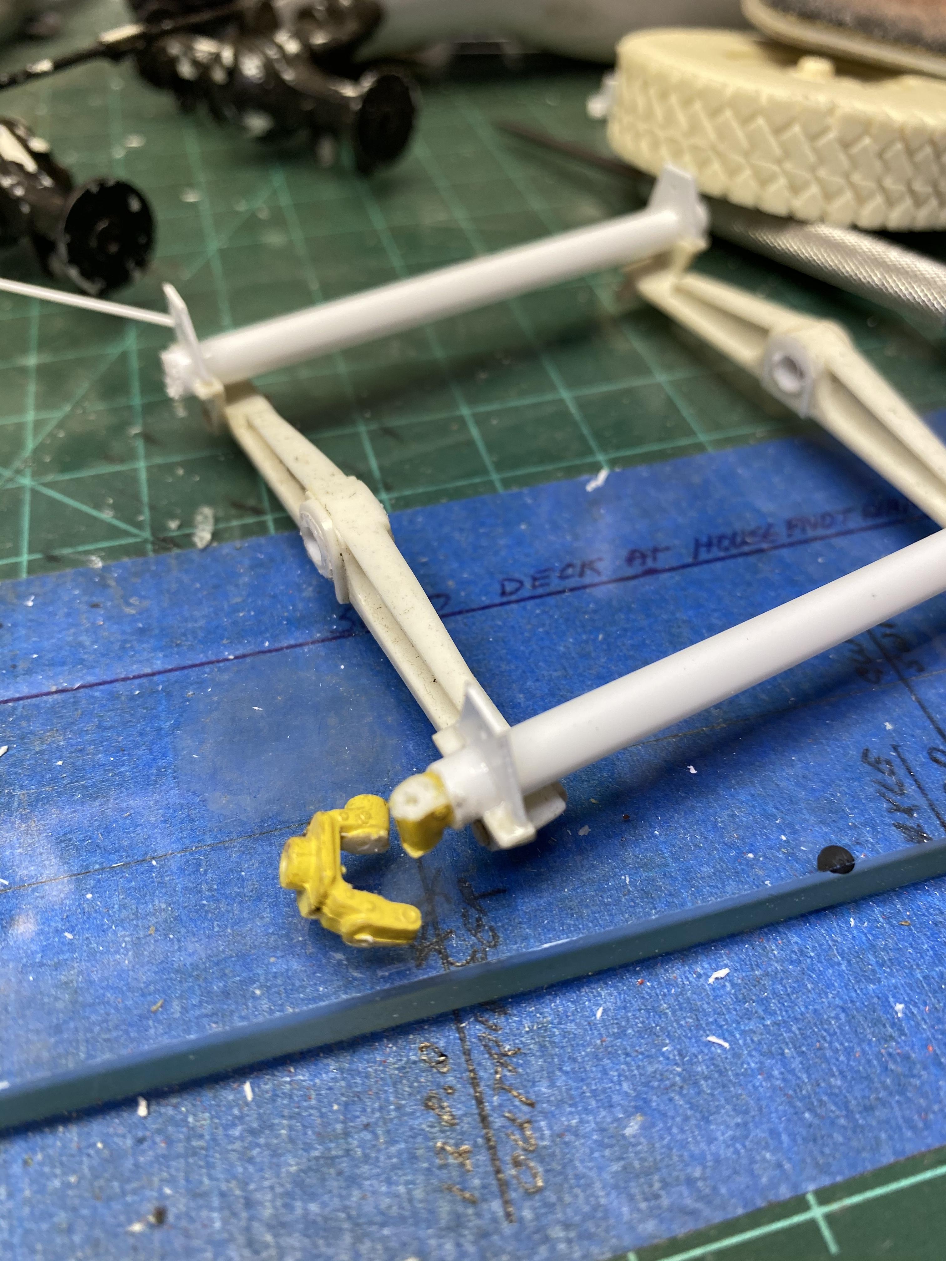

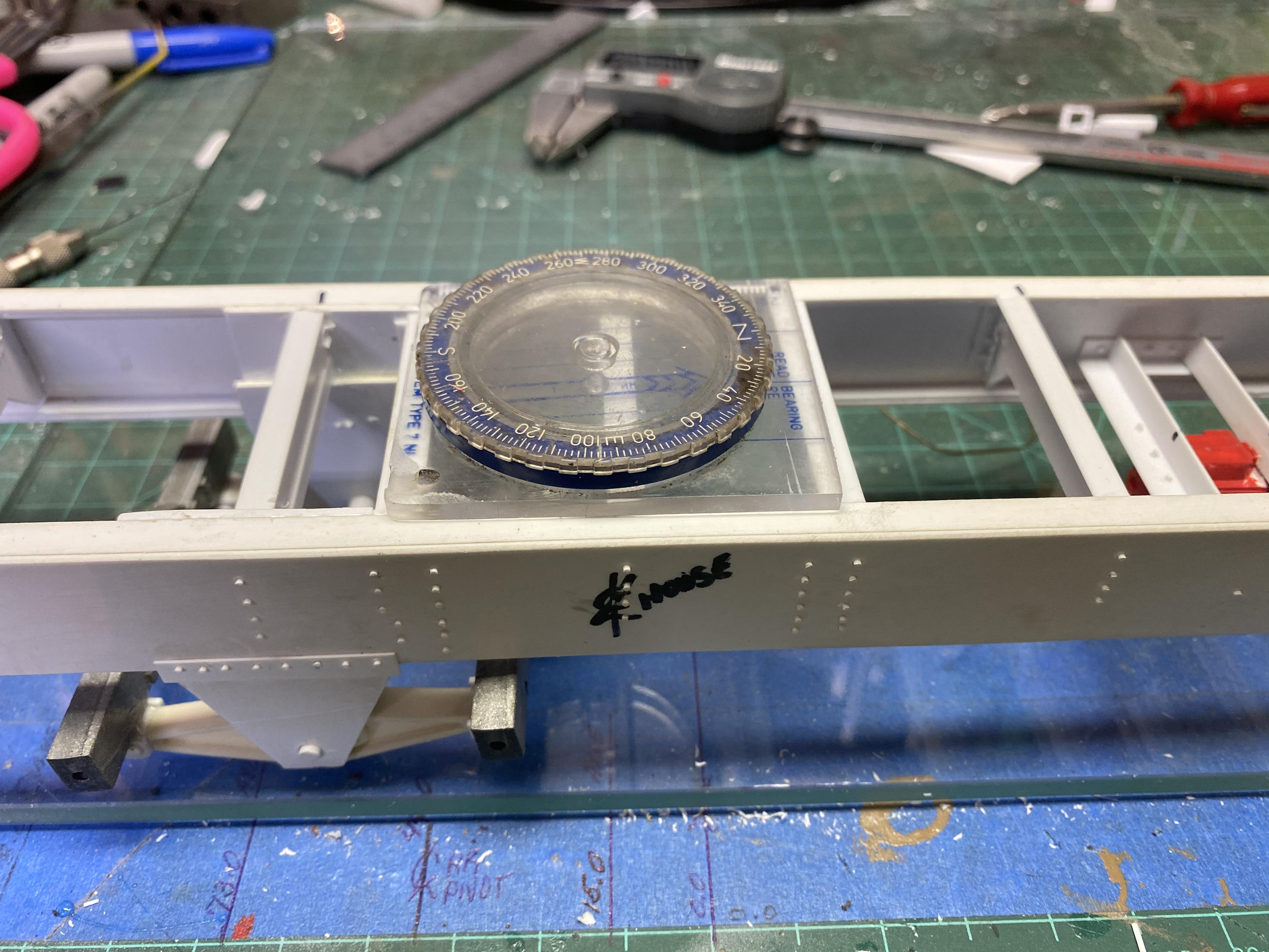

redneckrigger Posted December 20, 2020 Author Posted December 20, 2020 (edited) Steering knuckles in place.......Also got creative with the turntable for the upperworks. Using an old Boy Scout Compass with a few modifications! Edited December 21, 2020 by redneckrigger

gotnitro? Posted December 21, 2020 Posted December 21, 2020 (edited) My fingers hurt just counting all those rivets !! Exceptional work detailing the frame rails , and cool trick w the compass face ..now the operator will always know which direction their facing lol Edited December 21, 2020 by gotnitro?
Chariots of Fire Posted December 21, 2020 Posted December 21, 2020 Tom: Carry over the brass idea to your steering knuckles. Strength will be needed there too.
redneckrigger Posted December 22, 2020 Author Posted December 22, 2020 8 hours ago, Chariots of Fire said: Tom: Carry over the brass idea to your steering knuckles. Strength will be needed there too. Oh yeah.........gonna even look st machining the whole knuckle from aluminum. What I have here may just be a test run to get the engineering correct.
redneckrigger Posted December 22, 2020 Author Posted December 22, 2020 10 hours ago, gotnitro? said: My fingers hurt just counting all those rivets !! Exceptional work detailing the frame rails , and cool trick w the compass face ..now the operator will always know which direction their facing lol The rivets are actually very close to an actual REAL rivet........ .030” holes drilled through frame and crossmembers etc, then a piece of .030” Evergreen rod glued in and trimmed off. Works well enough to satisfy my worst critic.....me!
Chariots of Fire Posted December 22, 2020 Posted December 22, 2020 Here's an example of brass steering knuckles. The long end fits into a tube that is within the axle. Makes the whole thing quite strong.
