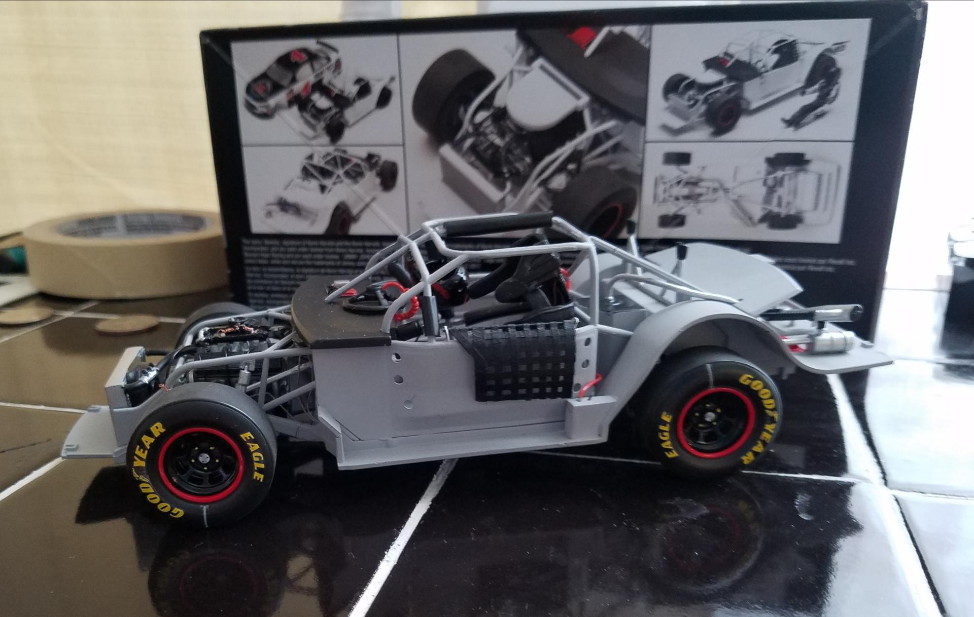

Belugawrx Posted April 17, 2020 Posted April 17, 2020 I made this from masking tape, cut to 1/16th inch and assembled on a small sheet of glass.. then I painted it with flat black, let it dry, flipped it over and painted the other side
