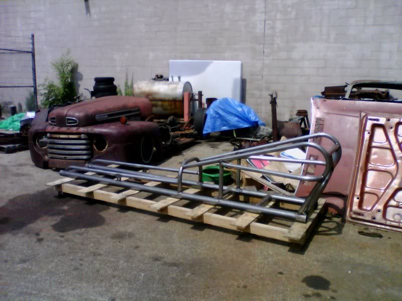

Ace-Garageguy Posted May 18, 2020 Posted May 18, 2020 (edited) On 5/18/2020 at 7:13 PM, Snake45 said: Yah yah yah, I know all about slingshots and rails and diggers, but those terms lived on long past the type of roll bars I'm asking about. Expand Like you said, both Kent Fuller and Chassis Research built the style of frame you're asking about, but so did others. T.E. 448, below ("totally enclosed") was kinda the "kleenex" of the type, and is still a name commonly used to refer to this design. https://www.jalopyjournal.com/forum/threads/retro-te-448-fed-dragster-build-tech.576068/ So you can call it a "Chassis Research T.E. 448-style" frame. Or not. Edited May 18, 2020 by Ace-Garageguy

Ace-Garageguy Posted May 18, 2020 Posted May 18, 2020 Check this out...non-mandrel bends, oxy-acetylene welding on a T.E. 448:
Ace-Garageguy Posted May 18, 2020 Posted May 18, 2020 (edited) On 5/18/2020 at 7:56 PM, keyser said: ...I remember it as a Dragmaster... Expand The classic Dragmaster is more like this, kinda like the Chassis Research K88, but different... or with double hoops like the Mooneyes frames Both were available as Revell parts-packs. ----------------------------------------------------------------------------------------------------------------------------- The other Revell parts-pack frame was a Kent Fuller version of the TE448, identifiable by its small-diameter-tube X at the rear, with upper and lower forward rails forming a shallow triangle, the basis for the twin-nailhead powered Tommy Ivo car above in Snake's original post. The TE448 had double Us at the rear, and generally more parallel forward rails, as in Snake's first photo. And I don't know who built the first one, but I find the Fuller version to be the superior design. Edited May 18, 2020 by Ace-Garageguy
Ace-Garageguy Posted May 18, 2020 Posted May 18, 2020 Here's a TE448 that has had the sides of its rear cage raised to comply with sanctioning body regs. Probably should have gone a little higher...
