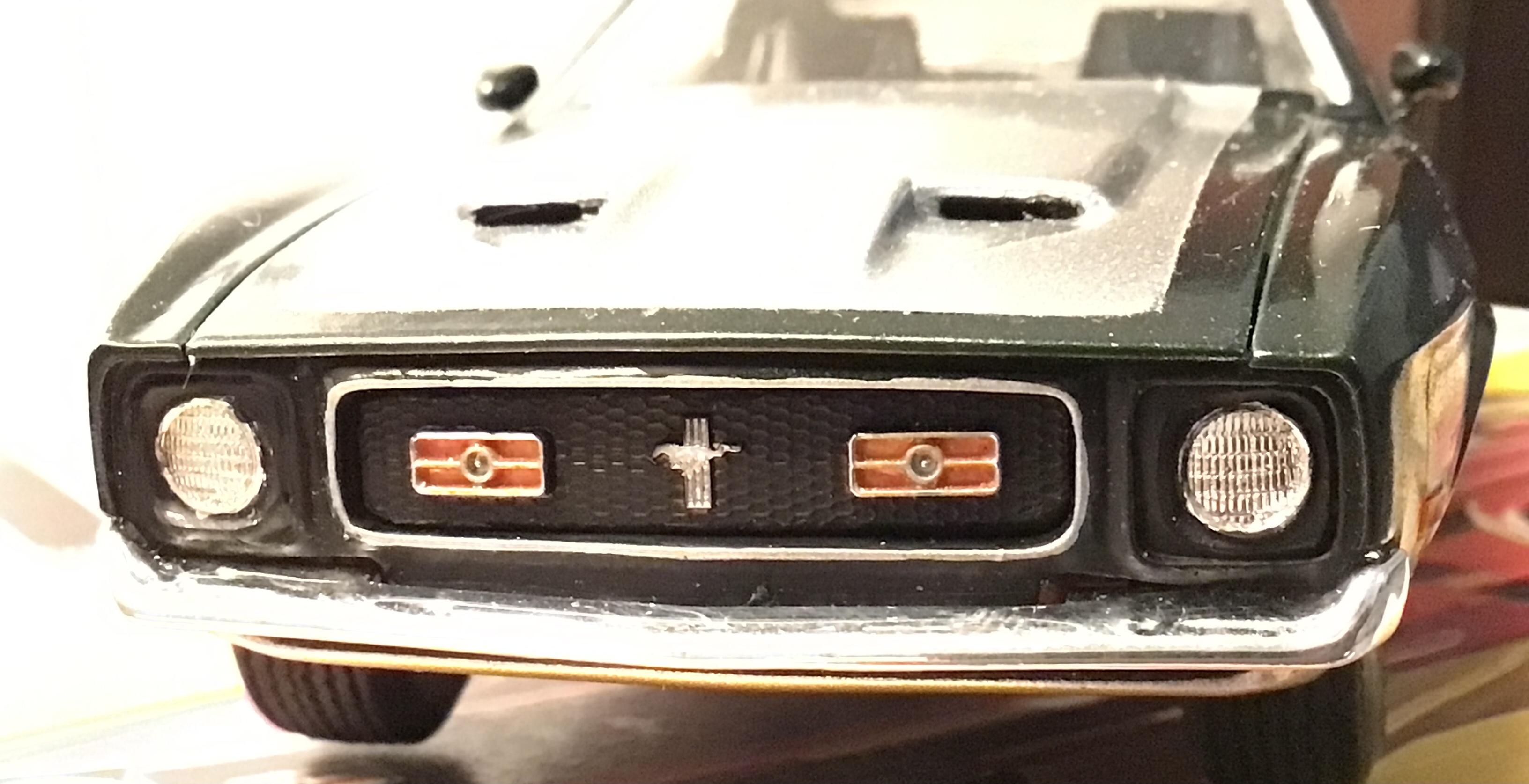

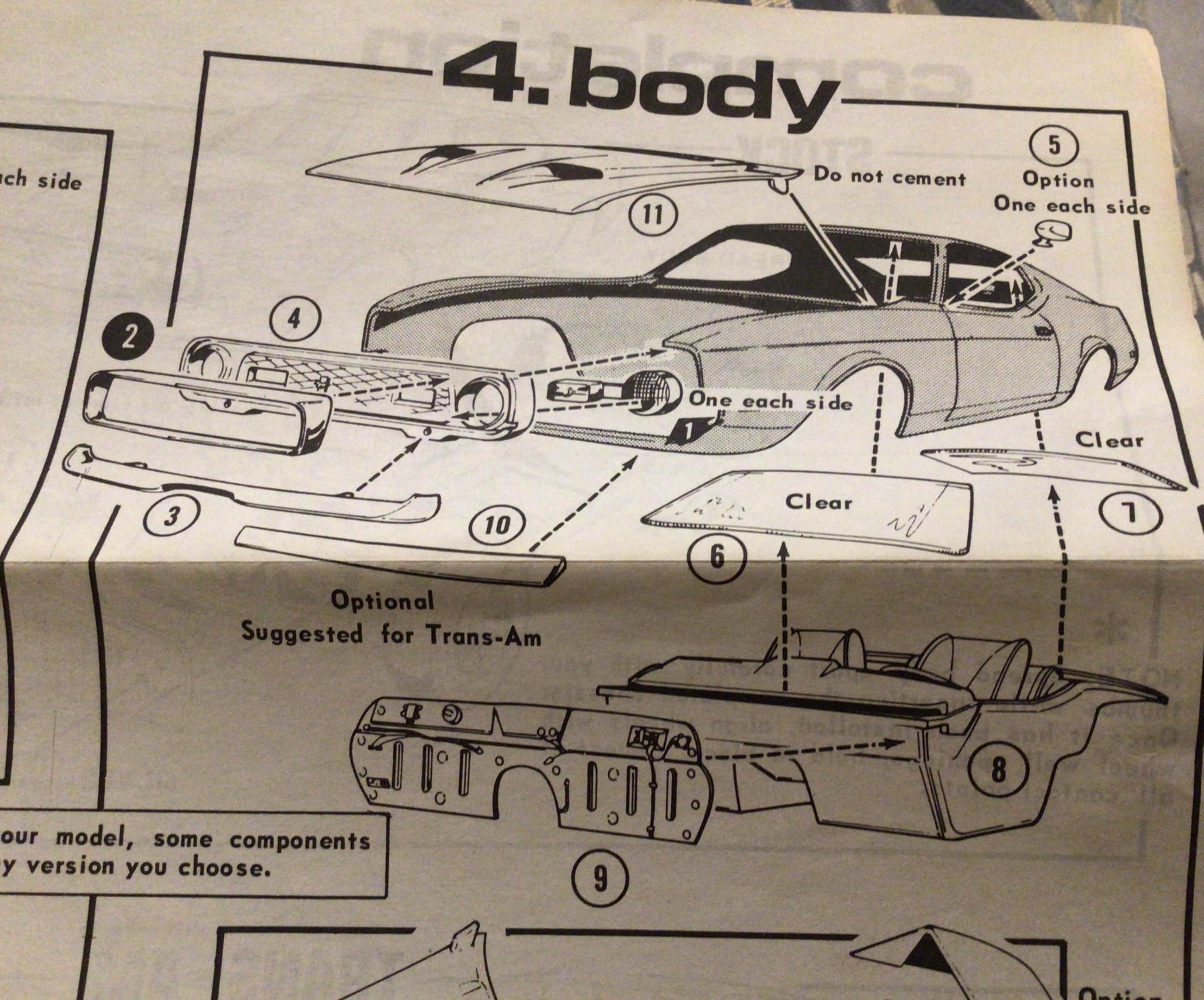

Very interesting solution. They retooled the header panel attached to the front of the body to mimic the separate part in the original annual, so that the original grille surround (part 103) could be re-used. Clear lenses are a nice "first" for this issue too.  Any competent builder could make a nice 1971/2 out of what is here...super-detail is up to the builder. This issue is the best one yet when you figure in the wheels/tires/decals.

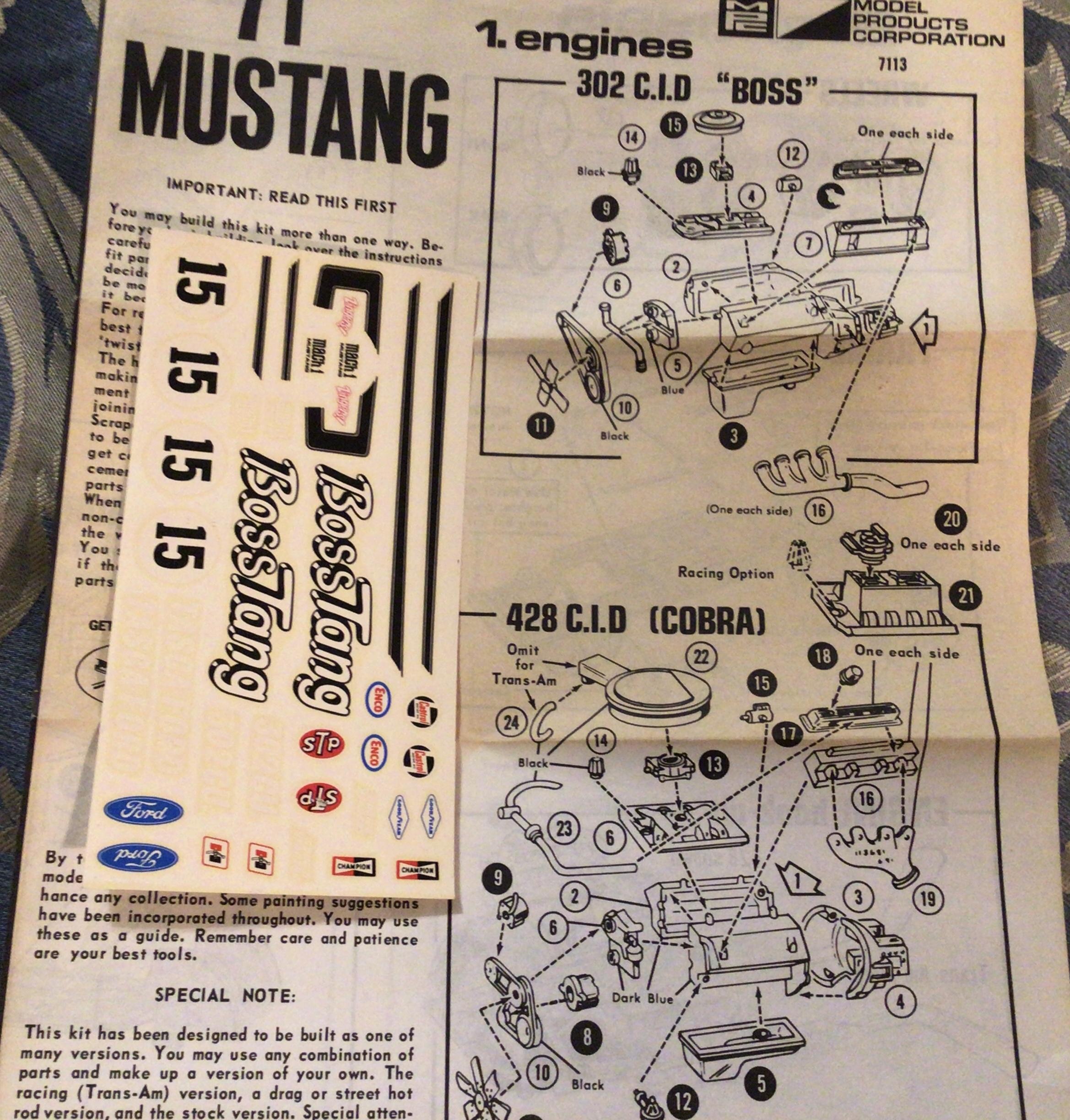

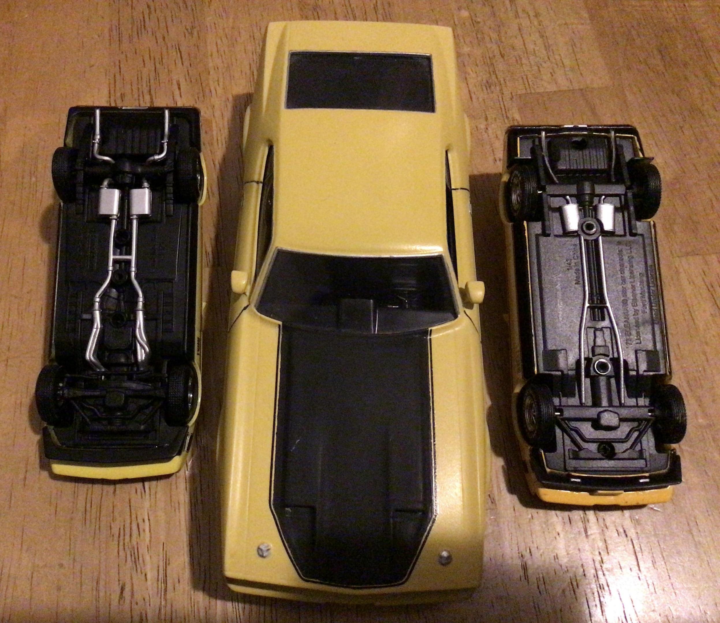

Well - decent if you do not mind it having either a 302 Windsor claiming to be a 1971 Boss 302 (of which Ford only made one prototype) which magically has become a 351 Cleveland in the 007 issue or a 428 FE engine (not available in 1971 or later) and an exhaust system without the oval mufflers , then yes it could be described as slightly better than the previous MPC (not AMT) kits this issue is based upon.  Even in the original MPC kit the sport stripes were incorrect (no surprise) but to this day I see them still replicated incorrectly.  All 71-72 Mach1’s had the lower side painted either black or silver (argent) whether they had the sport stripes or not and you will notice on the original MPC box art that is not the case so the decal goes further down onto the valance that it does on the real car.  This error is seen on the MPC “Boss 351” version also and even some of the aftermarket decal makers get it wrong too. The green Boss 351 (pictured in progress) has an aftermarket chrome front bumper is based upon an original AMT kit which is slightly better (less things to correct) but neither the AMT or MPC kits of any 71-73 Mustang ever had a correct engine and carb combo.  The small block resembles the workhorse 302 engine that from FORD would have come with single exhaust - the 4bbl 302 engine was not even available but customers could get the 351C with either a 2bbl with single exhaust or pay extra for a 4bbl with dual exhaust and probably a competition suspension (staggered rear shocks).  I guess all I can say is do not spend $100 for an original AMT or MPC kit as there are so few parts that are different to justify the price of an older kit.  I am not a fan of the 007 version being molded in red due to the difficulty in filling in the vents that were wrong from the very first issue in August 1970 (per the date on the back of the decal sheet).  Please note of many of my builds of these accuracy challenged 71-73 Mustang kits I swap parts from other kits and use aftermarket resin parts and decals so the finished model may look much better than what you see in the box. Happy modeling.

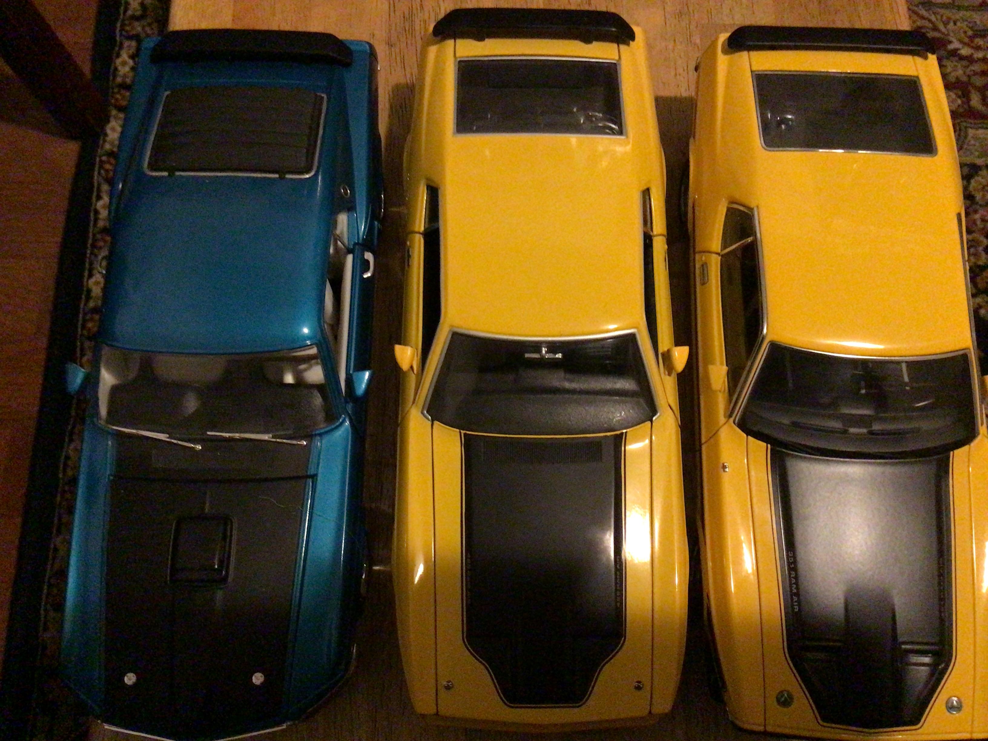

26 minutes ago, Rob Hall said:
There are none on the 1:1.  (cowl vents toward the back of the hood).
You are correct sir.  I’m guessing the the model mold makers assumed that there would be “vents” like on the 65-70 Mustangs so either they got a bad drawing of a pre-production Mach1 from somewhere or they flipped a coin and got it wrong.  If they would have thought for a minute the vents were never in the hood of a Mustang but were in the cowl area between the hood and the windshield.  Since the “cowl” area is under the hood on the 71-73 Mustang someone just wasted time making the vents.  To make it worse, look at these 1/18 diecasts.  The blue green 69 Mach1 is correct showing what the vents looked like for 69-70 Mustangs.  One of the two yellow 1/18 1971’s has the vents and guess which one does - it’s made by Ertl which looks like they enlarged the MPC kit and incorrectly left in those vents in again ?  Autoart did not that mistake as I assume they looked at a real car and not a 50 year old plastic kit or the competitions diecasts.  Even the Japanese and Chinese that did a 1/28 kit and 1/43 diecasts could get the “no vents” right and the 1/43 ones have dual exhaust that is a lot closer to what it looks like on the real car (except for those wild headers) but I assume they were starting from scratch and perhaps did a little research or had some help.

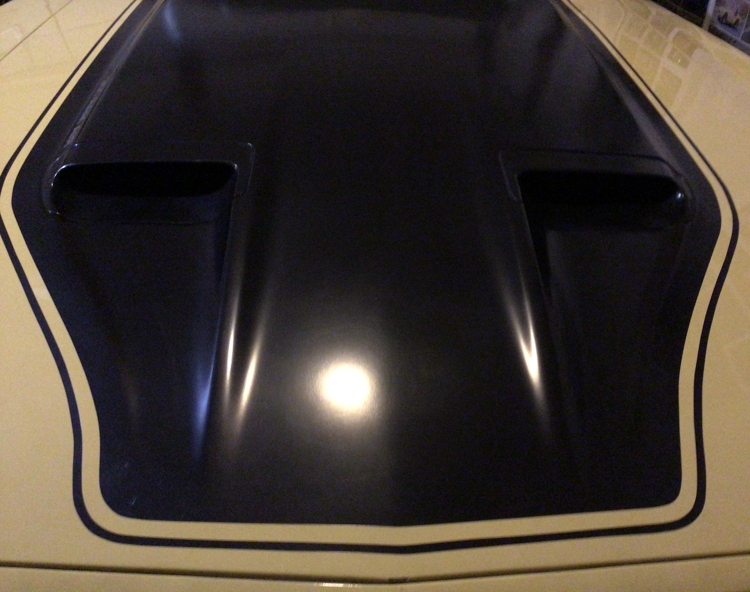

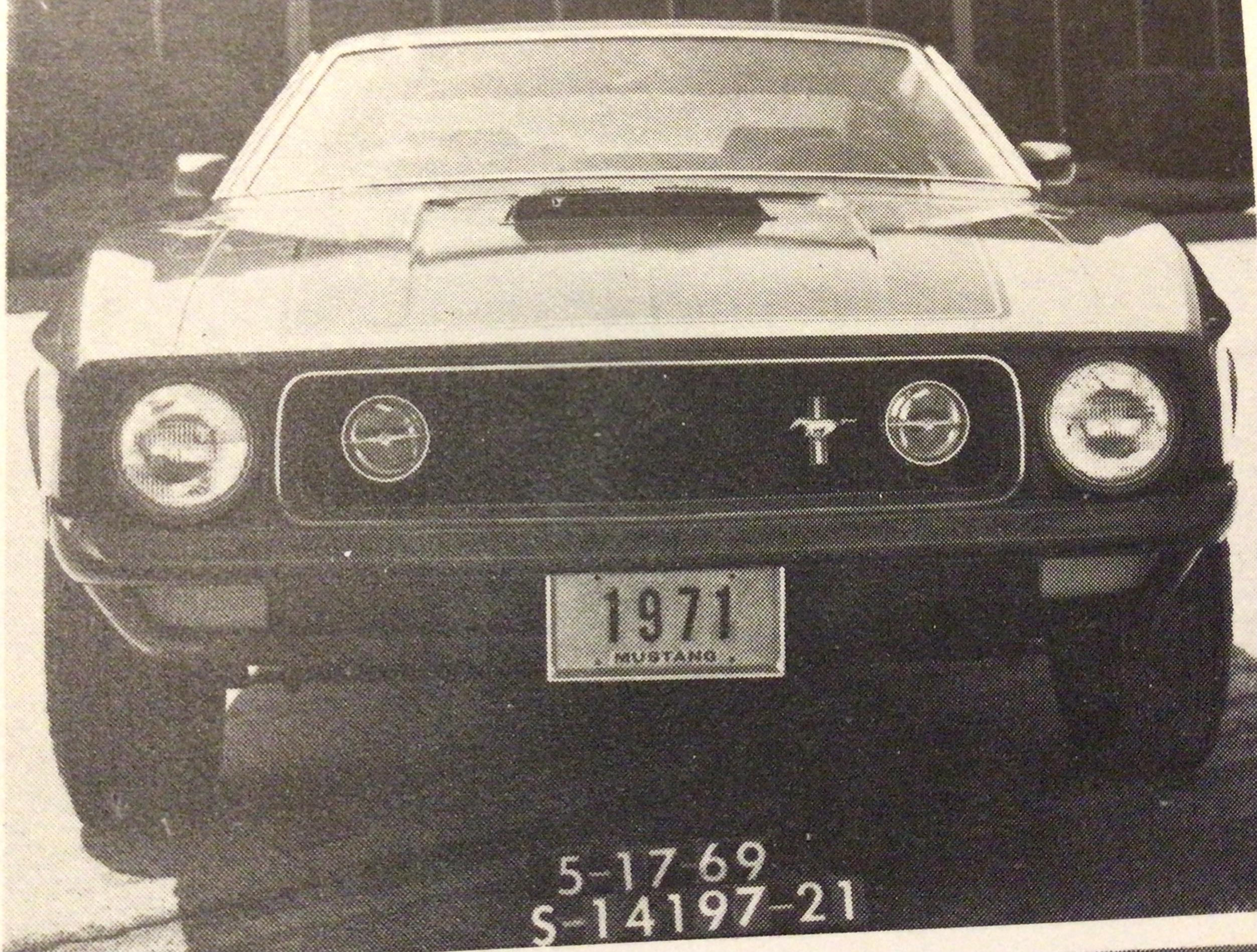

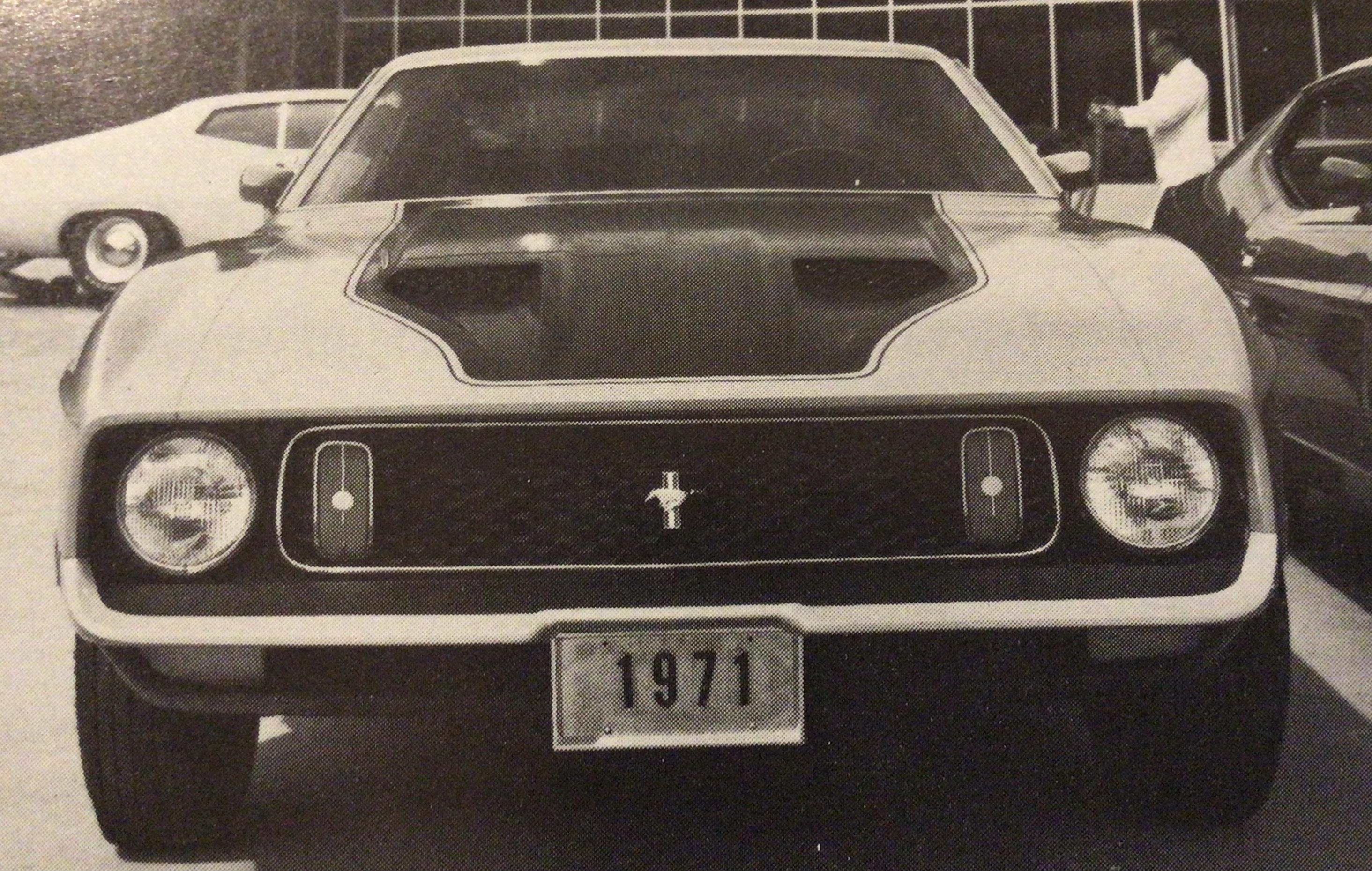

I’d rather not have to do both but such is the way it is after 50 years these things still bug us. ?
Here’s three versions I am glad did not make it to final production and the AMT and MPC hoods and my car (made Aug 1971) so it’s an early 1972.  Yes I would agree the MPC hood got the scoop area a little better than the AMT one.

What concerns me is that it's molded to the body.  It would have been better if it was separate IMHO.

Separate would have facilitated doing a subsequent '73 version, but not sure there would be much demand for that..

I would bet a fair amount the new molded-in-place grille also provides increased stiffness and better alignment/registration, too. Entirely possible there was some damage or wear in that area, too, so Round2 did what they felt was best.

It might be the pic angle, but the grill/header panel looks a little too sunken in compared to the real car.  However, I will have to see one built up for final judgement.  The separate clear headlights I do like though.  That's one thing about this kit l never liked, the slightly too small headlights.

I have seen the HPI guy review of this kit. It still shows the round glasspak mufflers from the 1966 MPC Mustang kit. The 1969 Cougar Eliminator has flat mufflers that are more correct.
Yes - we pretty much expected that all along.
