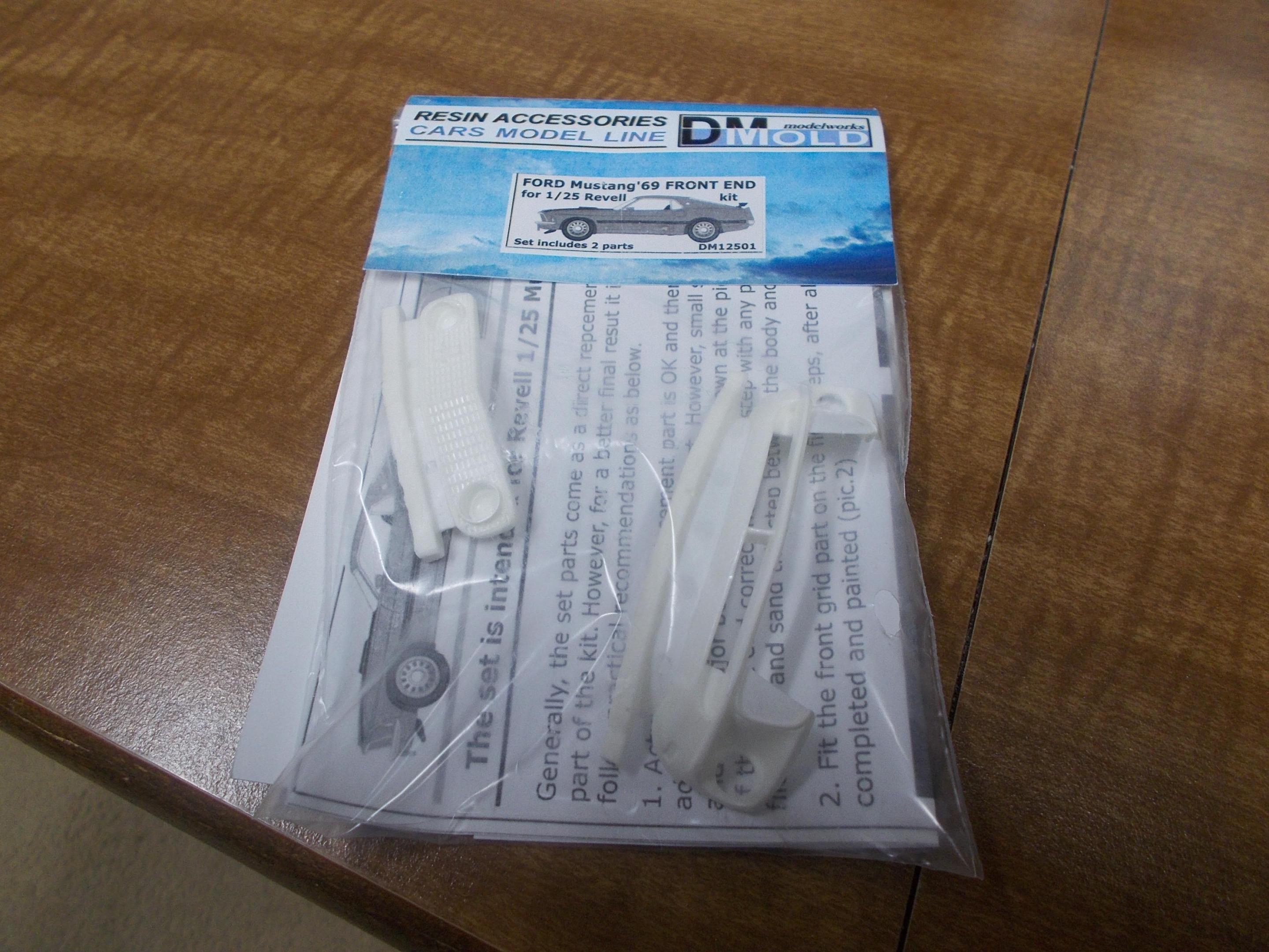

Sport Suburban Posted June 17, 2020 Posted June 17, 2020 You would need three pieces from the kit. The nose piece, grill and hood. The hood is longer and has no holes for the shaker. The DMold pieces actually fit the original hood and look real similar. I'm guilty of buying the parts but not rebuilding my 69 Mustang with it yet.
Curt Posted June 17, 2020 Posted June 17, 2020 The DMold is the Russian kit you mentioned. I'm guilty of not using it yet also.

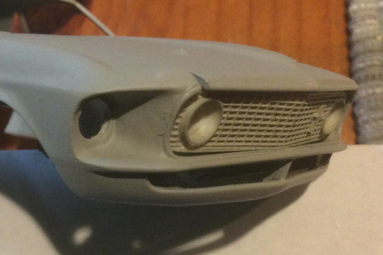

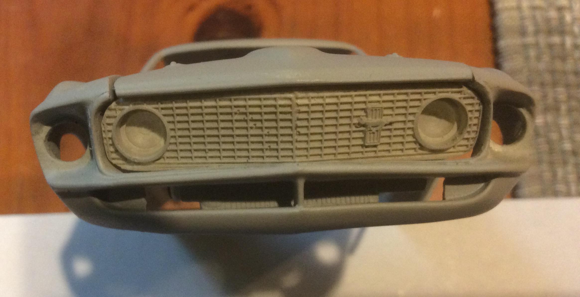

vamach1 Posted June 17, 2020 Posted June 17, 2020 (edited) Here is the DMold on the Revell Mach1 body that I was going to covert to a 69 Boss 302 and then we know what happened. At least I can get the correct engine now. Edited June 19, 2020 by vamach1
Dale Gribble Posted June 19, 2020 Posted June 19, 2020 Oof , that looks rough . Is the Revell kits shortcomings actually that bad ??

mk11 Posted July 13, 2020 Posted July 13, 2020 On 6/19/2020 at 11:09 AM, Dale Gribble said: Oof , that looks rough . Is the Revell kits shortcomings actually that bad ?? Worse...
Dale Gribble Posted July 13, 2020 Posted July 13, 2020 I guess I don’t see where that super rough casting makes it better . Looks like a mustang to me .
Justin Porter Posted July 14, 2020 Posted July 14, 2020 On 7/13/2020 at 9:10 AM, Dale Gribble said: I guess I don’t see where that super rough casting makes it better . Looks like a mustang to me . With the old version of the '69 Mustang, the problem is that the outer headlights are noticeably lower - I'd wager by a scale inch or so - than the inner grille mounted headlights, which on the actual car are in nearly a straight line across. The DMold resin set and the new '69 Boss 302 kit both correct this egregious error which had kept the 428 Cobra Jet kit out of circulation after being massacred in print.

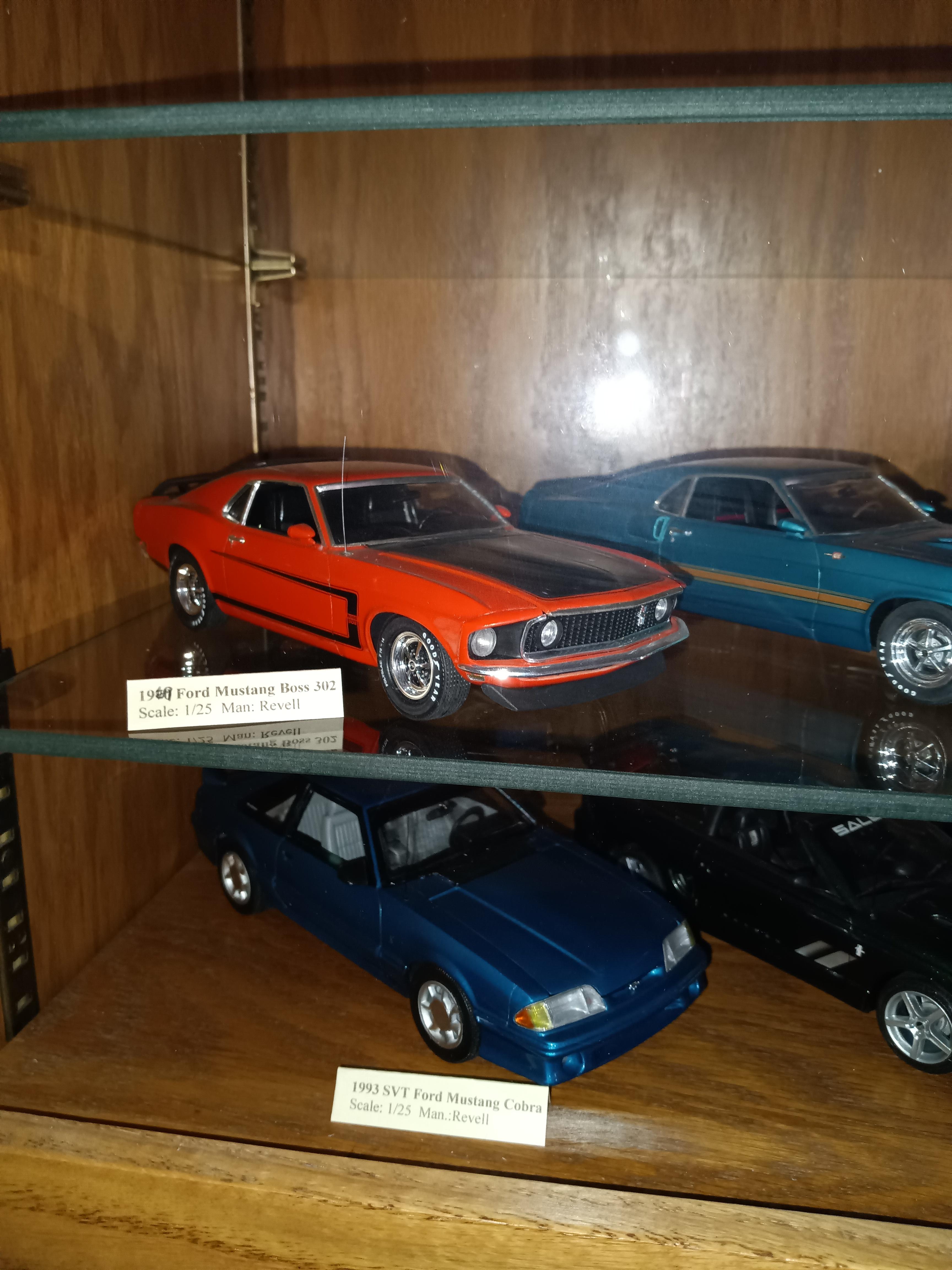

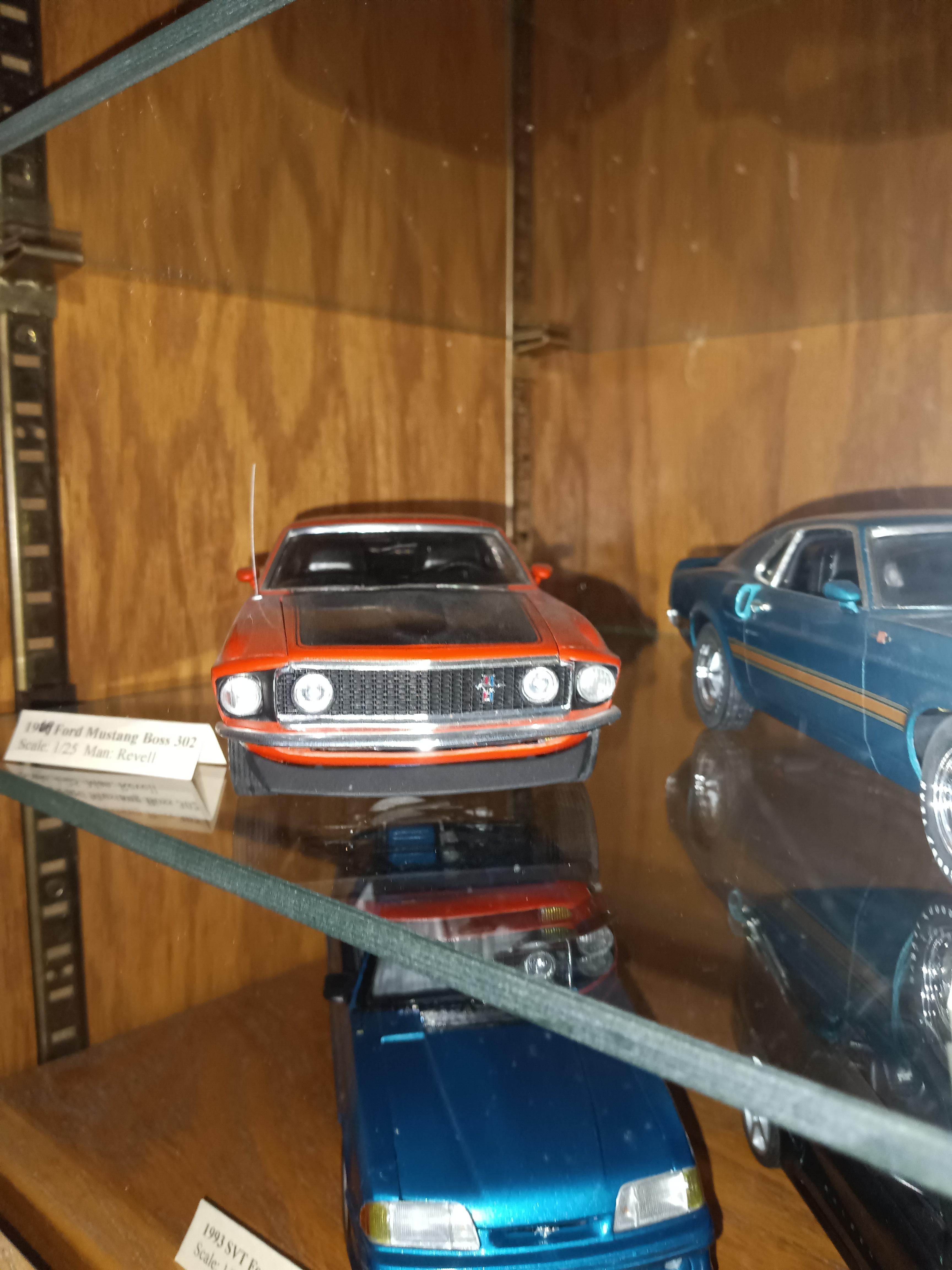

baycolony Posted March 21, 2022 Posted March 21, 2022 That picture from the box really doesn't do it justice. Here is a couple of pics of a Boss 302 I created from the Mach 1 kit long before the new release. The chrome bezels for the headlights weren't used and I just applied the lenses to the inside of the buckets after painting the edge chrome. It gives the impression that the buckets are deeper and much more appealing. 2
