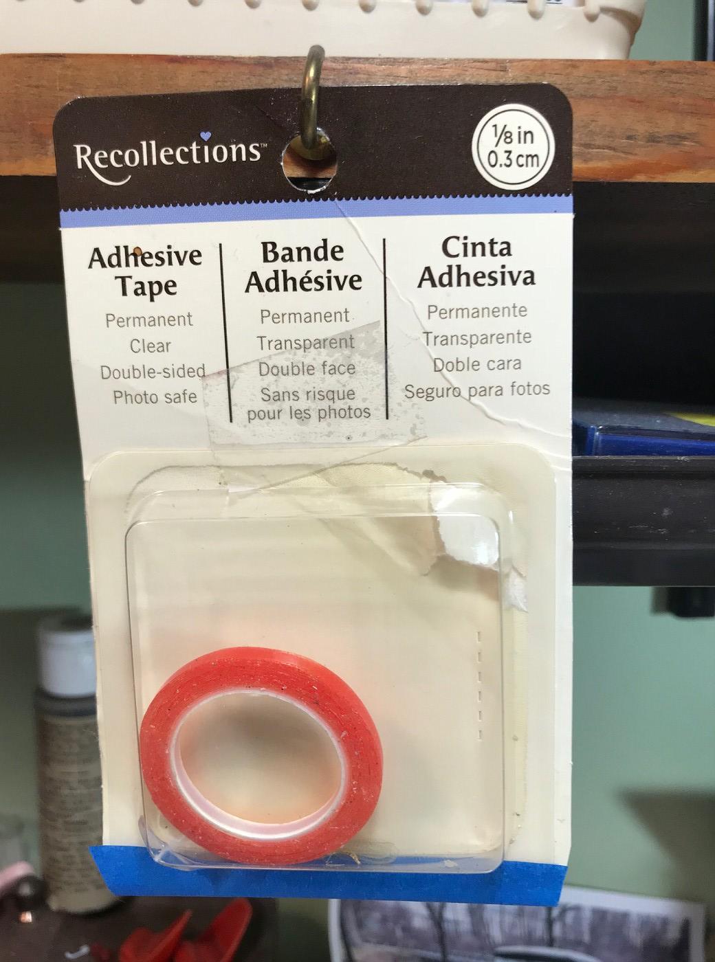

Tom Geiger Posted June 22, 2020 Posted June 22, 2020 when making my old glass, this tape helps a lot. It holds the glass on the curves
hedotwo Posted June 23, 2020 Author Posted June 23, 2020 13 hours ago, Tom Geiger said: when making my old glass, this tape helps a lot. It holds the glass on the curves Thanks Tom
