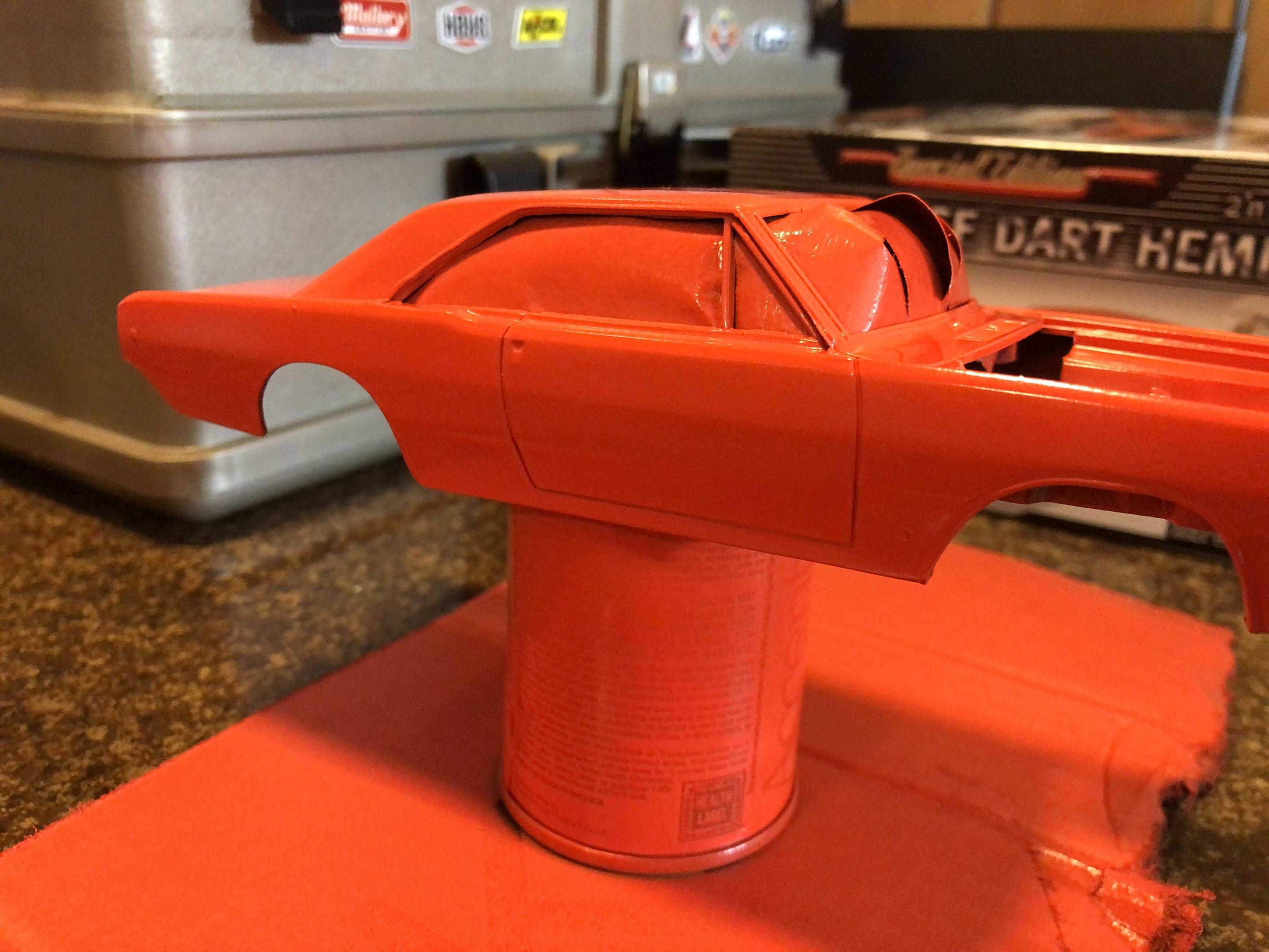

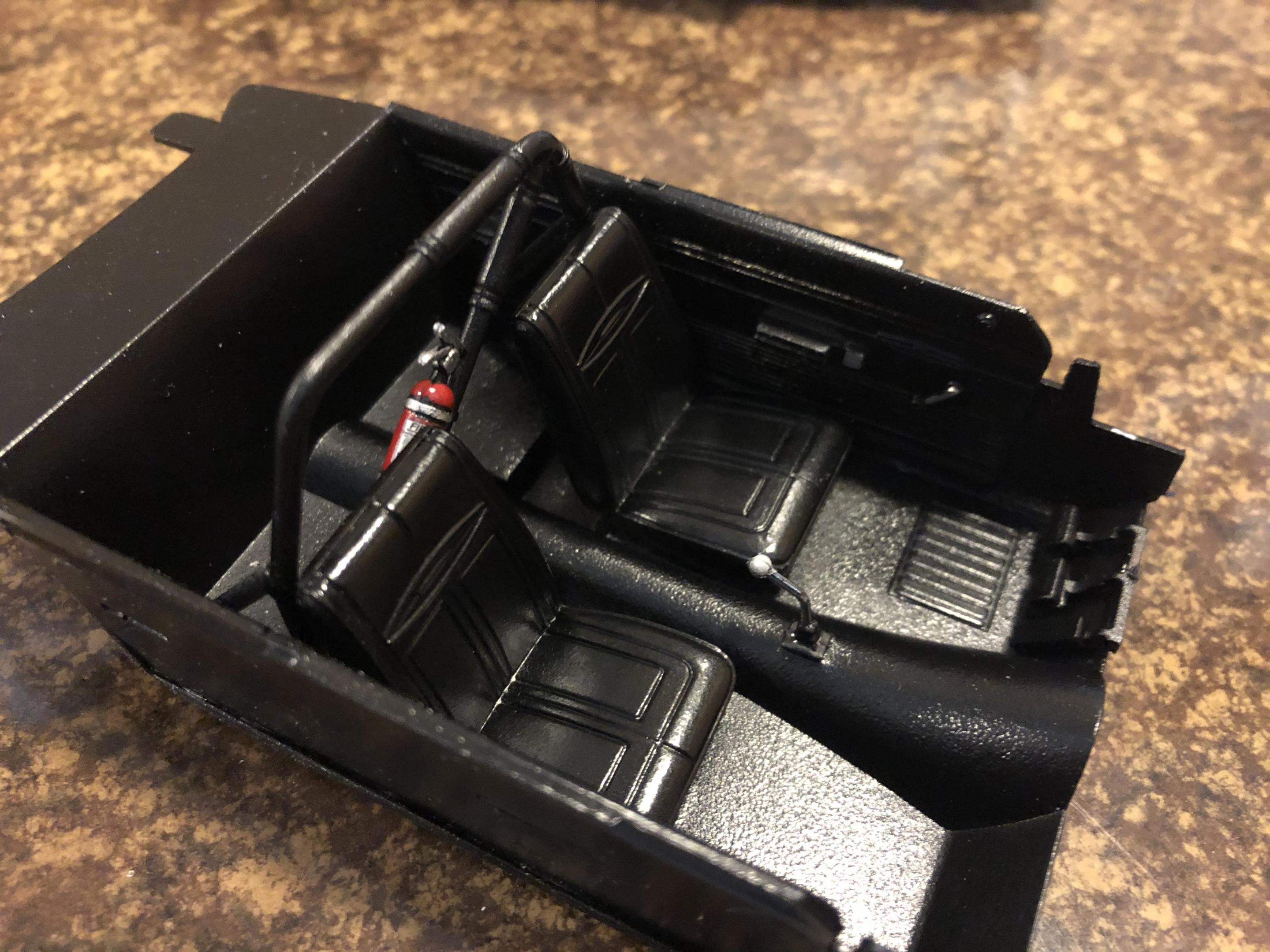

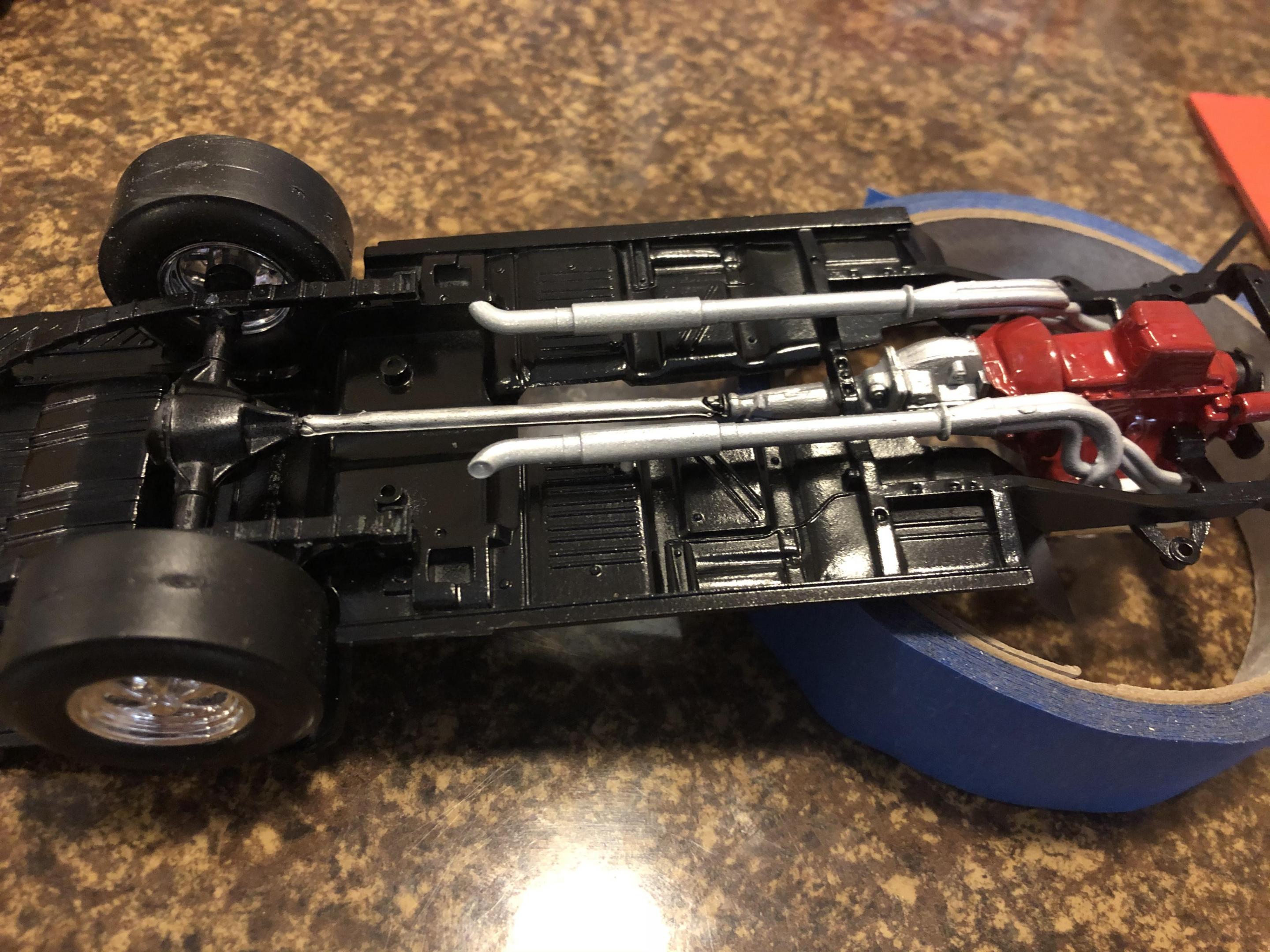

I just sprayed on some Testors Competition Orange. I’ve attached a few progress pictures showing the interior, underside of the chassis, updated spray job and the motor.

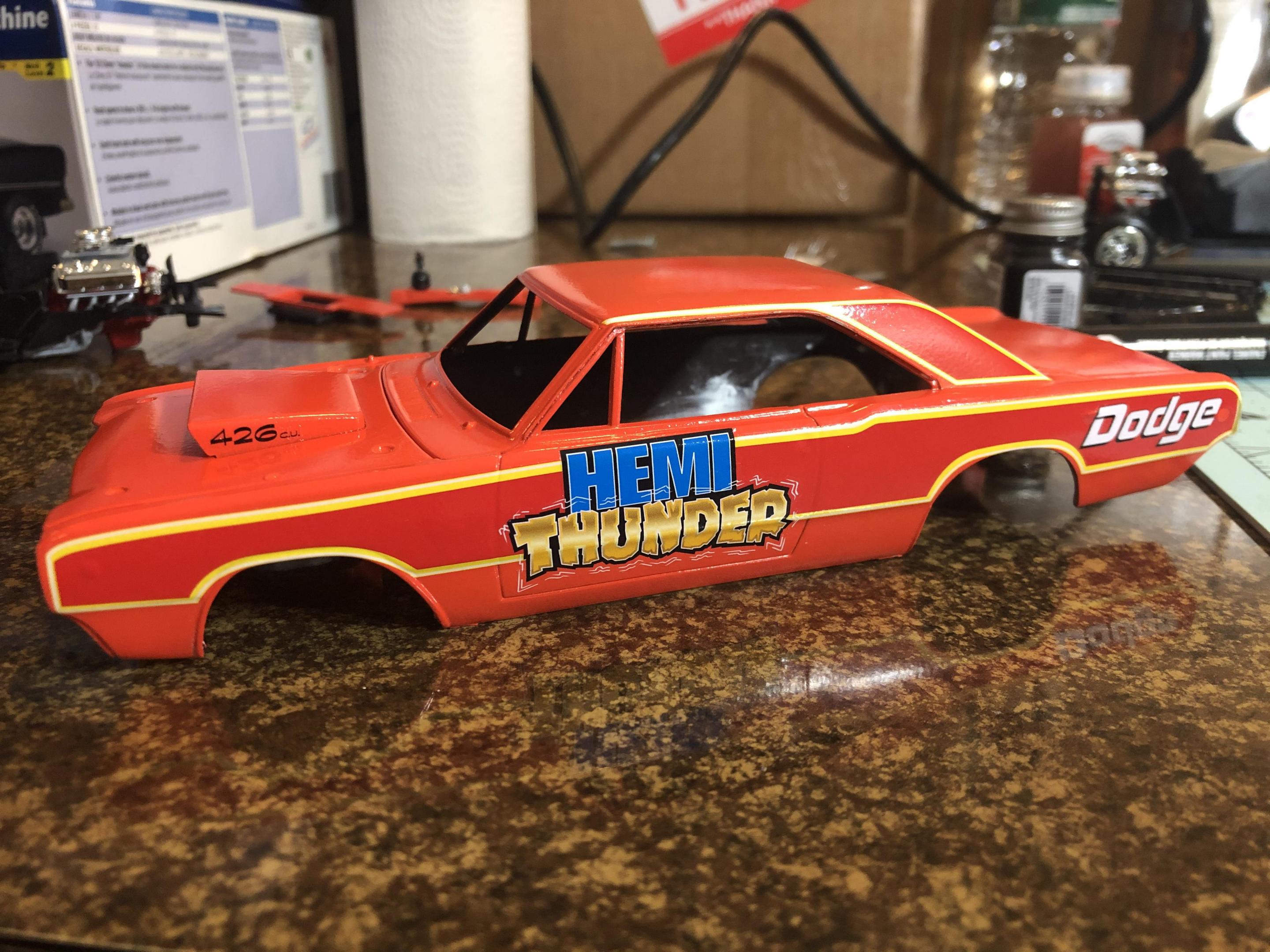

I’ve been waiting for the new paint to cure so I got started on some other projects but I circled back to this and started the decals. To the person who said they don’t line up with the wheel wells - you were very right!

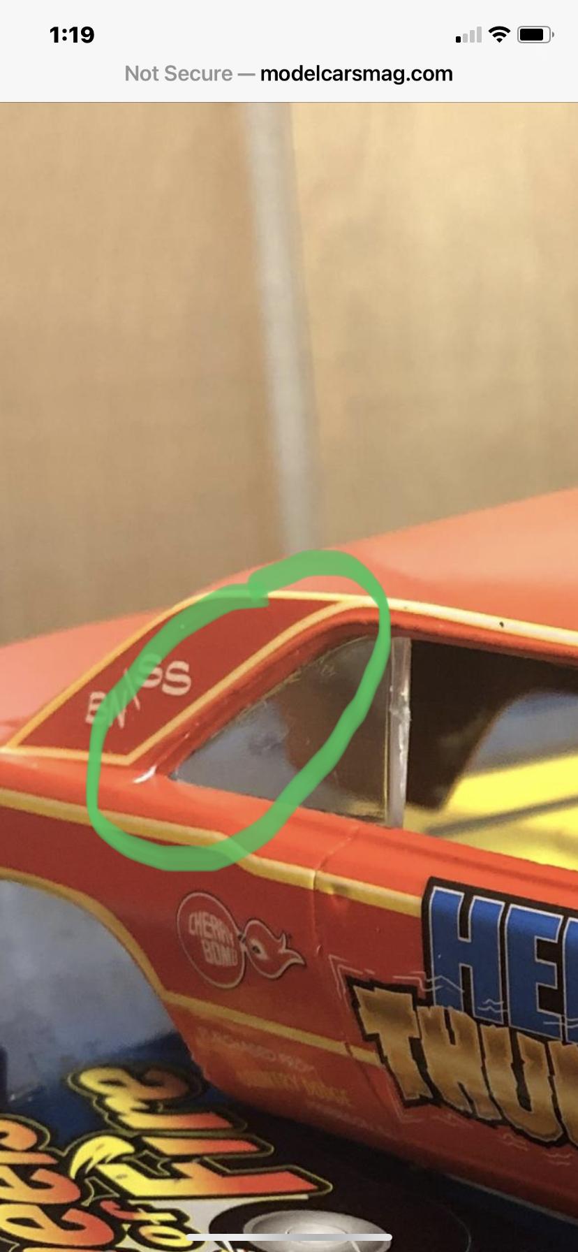

Any progress yet? The problem that I’ve encountered with mine was the rear passenger side window frame is not right. It’s way thicker than the drivers side. And after the glass is installed, the window sits too low, interfering with the interior door panel.  Since you have the body painted and all ready to go, sanding that piece of the window frame is not an option. I removed the rear window and trimmed the bottom of it so it doesn’t contact the door panel. Now the interior fits without being lopsided. I will correct this on my next 68 Dart build before paintwork.
This piece caused all the interior fit problems for me. And I modified my door panels, to fit with my tubbed chassis. It’s pretty thick compared to the drivers side.
