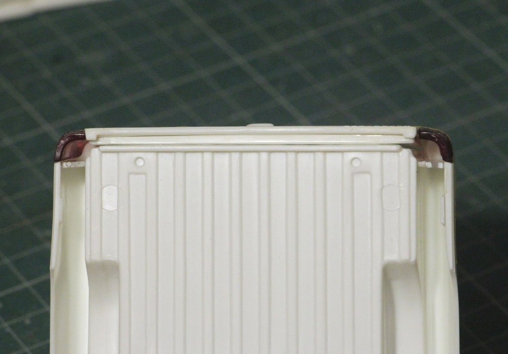

Sergey Posted July 8, 2020 Author Posted July 8, 2020 Hood hinges were extended to let a lid stand in opened position, when it need. I noticed plastic mud guard on a photo and tried to replicate it Tail lights needed reflectors Tail lights lenses were copied in clear resin in case I won't make with kit's one. Also I saw at the picture above, tiny shock absorber brackets. So Revell's horrible brackets were removed and replaced by a piece of PE fret. Feel the different. Also tried to make wheel arc overlays (correct me if It wrong term) 1
