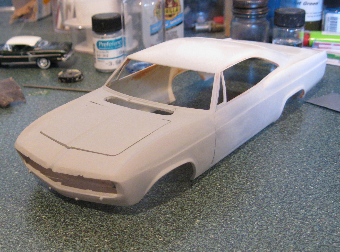

Can-Con Posted September 7, 2020 Author Posted September 7, 2020 Got the front end about where I can now start on other things like the back end and top chop. Not %100 yet but the body work that's left like final fitment of the hood will be done after the other big stuff is dome so I can do all the finesse work at once.

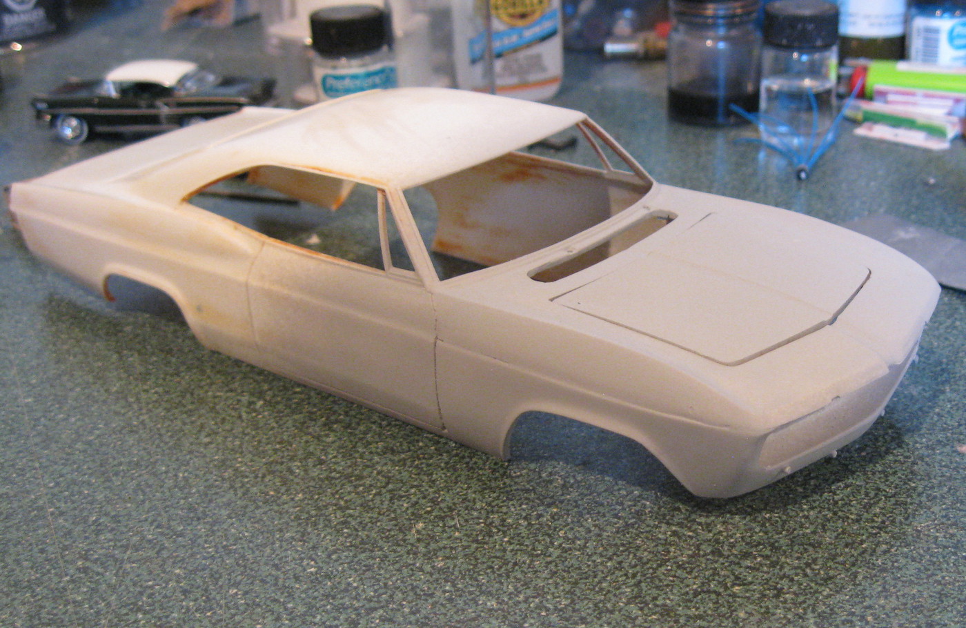

Can-Con Posted September 27, 2020 Author Posted September 27, 2020 got this far this afternoon. Cut the top off with an X-acto saw and added a small tab of sheet plastic to the underside of the back of the opening. I was originally going to cut the sail panels from the back of the roof also but as it turned out, I didn't have to. I just made a relief cut up each side so it would spread apart. I just sank the sail panels down at their forward ends and pulled the main part of the roof up. In the end I'll have about a 2 to 2 1/2 inch chop. When the sail panels are solid , I'll cut the base of the A-pillars and vent posts away, make notches where the cuts are. When I glue the top of the windshield frame back to the roof, the bottom of the pillars will slot into the notches.

Can-Con Posted October 3, 2020 Author Posted October 3, 2020 (edited) OK, I got the top roughed in I cut the windshield away from the body and cut some notches in the cowl and door tops for the pillars to notch into. The line at the front of the roof is how much I ground off it to get the slant I wanted on the windshield. glued some tabs to the top of the frame and front edge of the roof. Here's the results with the windshield glued down and the gaps in the sail panel filled with strips of plastic. It should take very little filler to finish it up for paint. I see I'll have to re-check the passenger side window opening. Looks higher at the front but I think it's just an illusion Edited October 3, 2020 by Can-Con

Can-Con Posted December 13, 2020 Author Posted December 13, 2020 Using the AMT '65 annual custom rear pan and tail light bezels. The bumper was dremmeled down from the kit part. I also started flaring the rear wheel openings to match the front custom parts.

Can-Con Posted December 28, 2020 Author Posted December 28, 2020 Kinda hard to tell in these pics but I also raised the height of the peaks on the rear 1/4s so they would be closer to the size of the peaks on the front fenders and redid the flares of the rear wheel openings to match the front..
