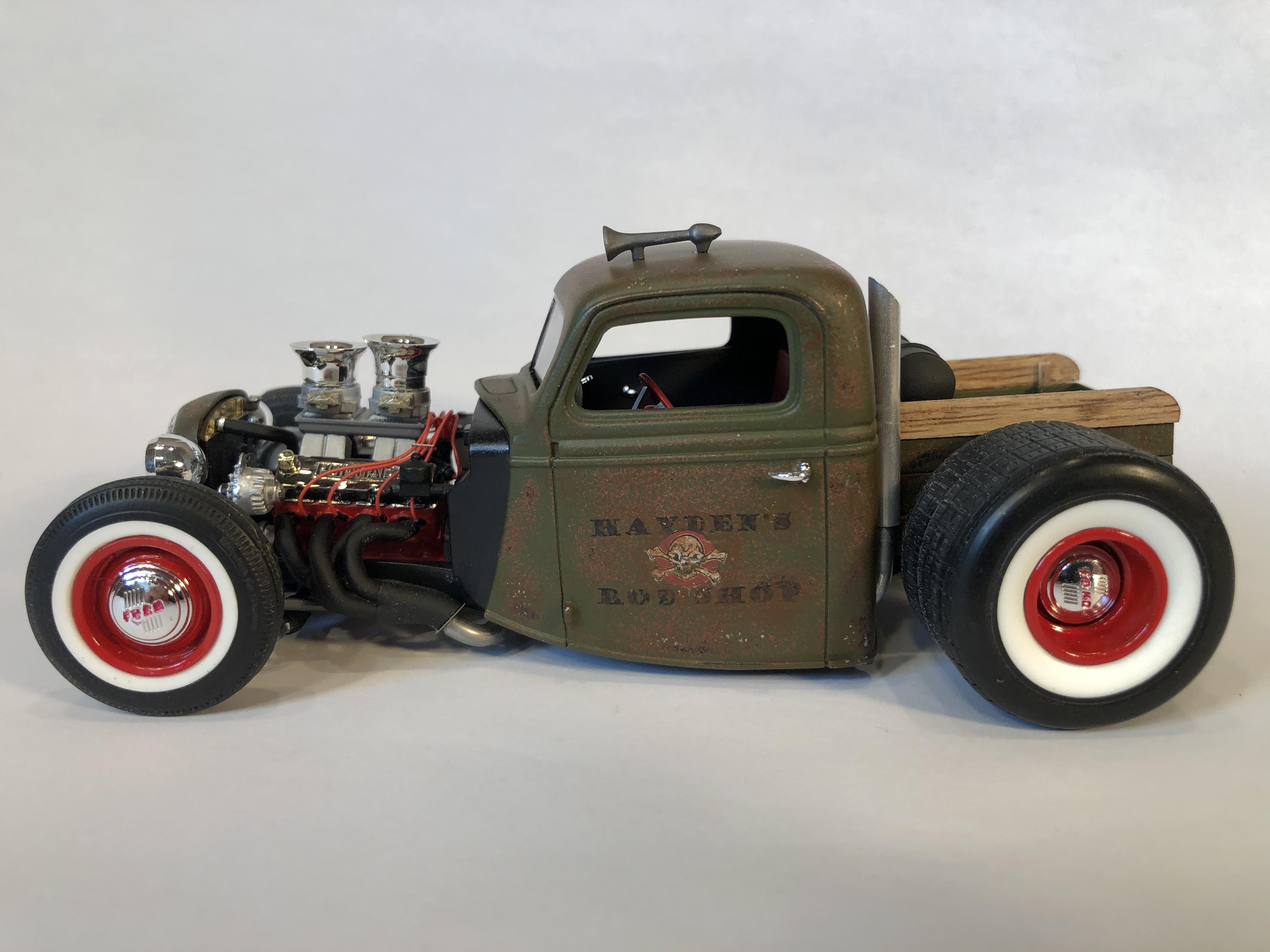

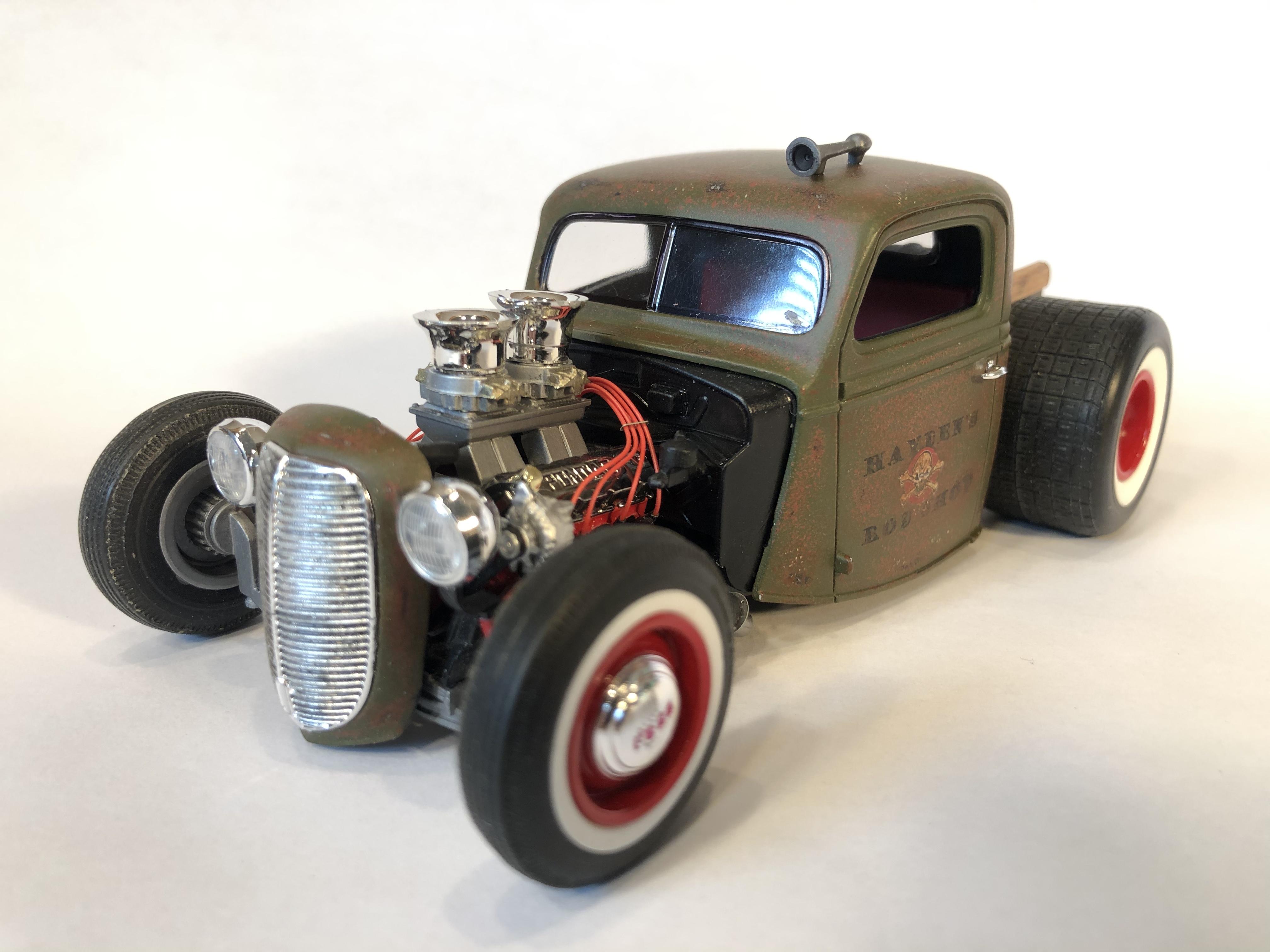

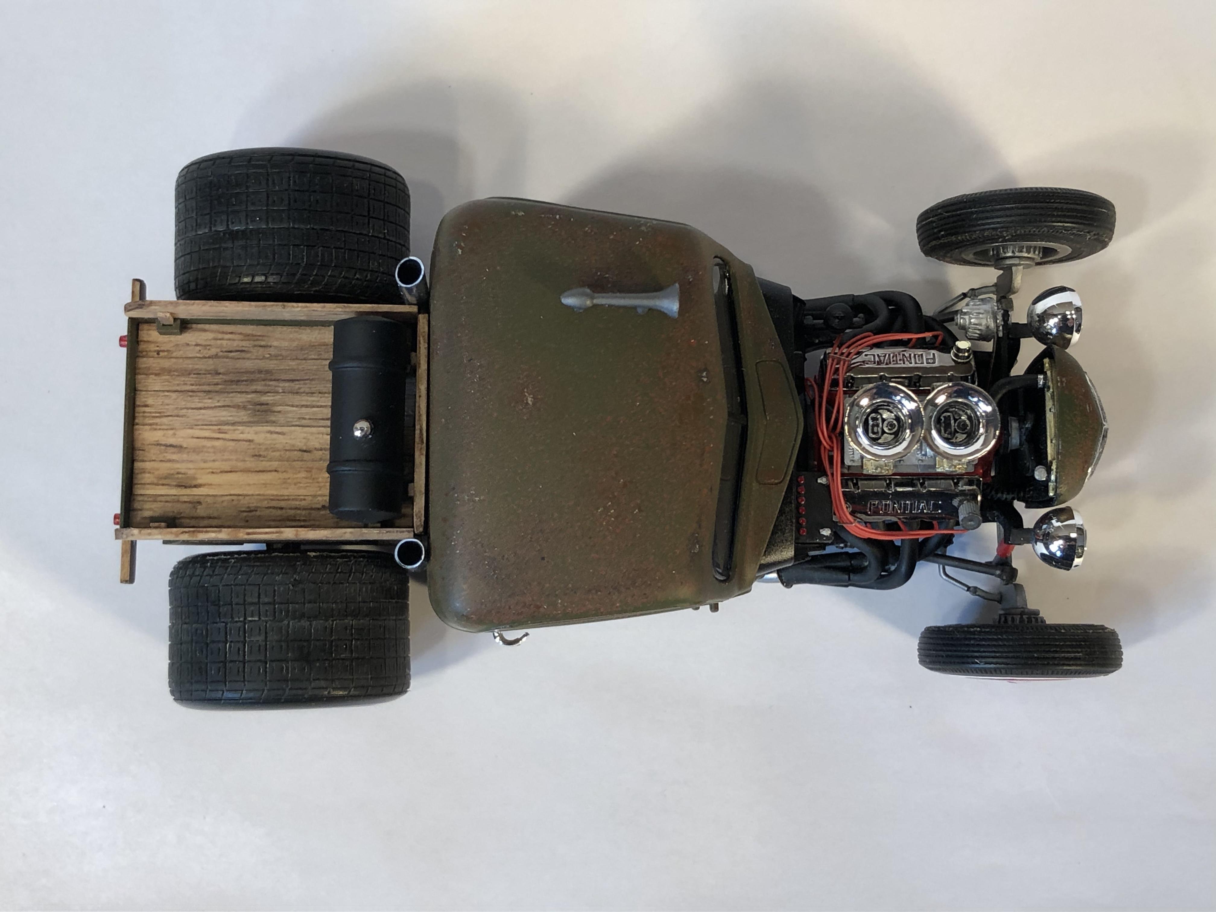

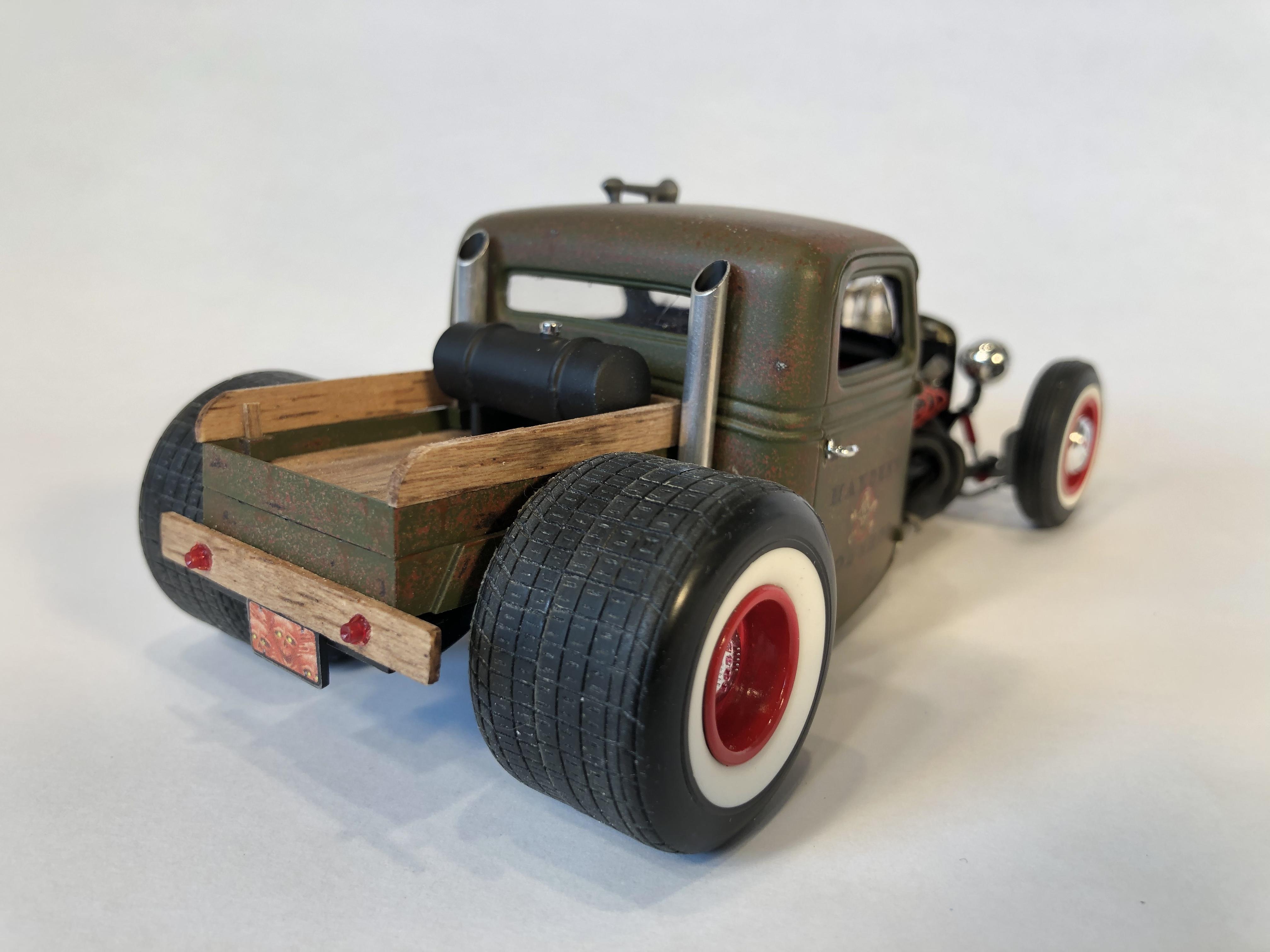

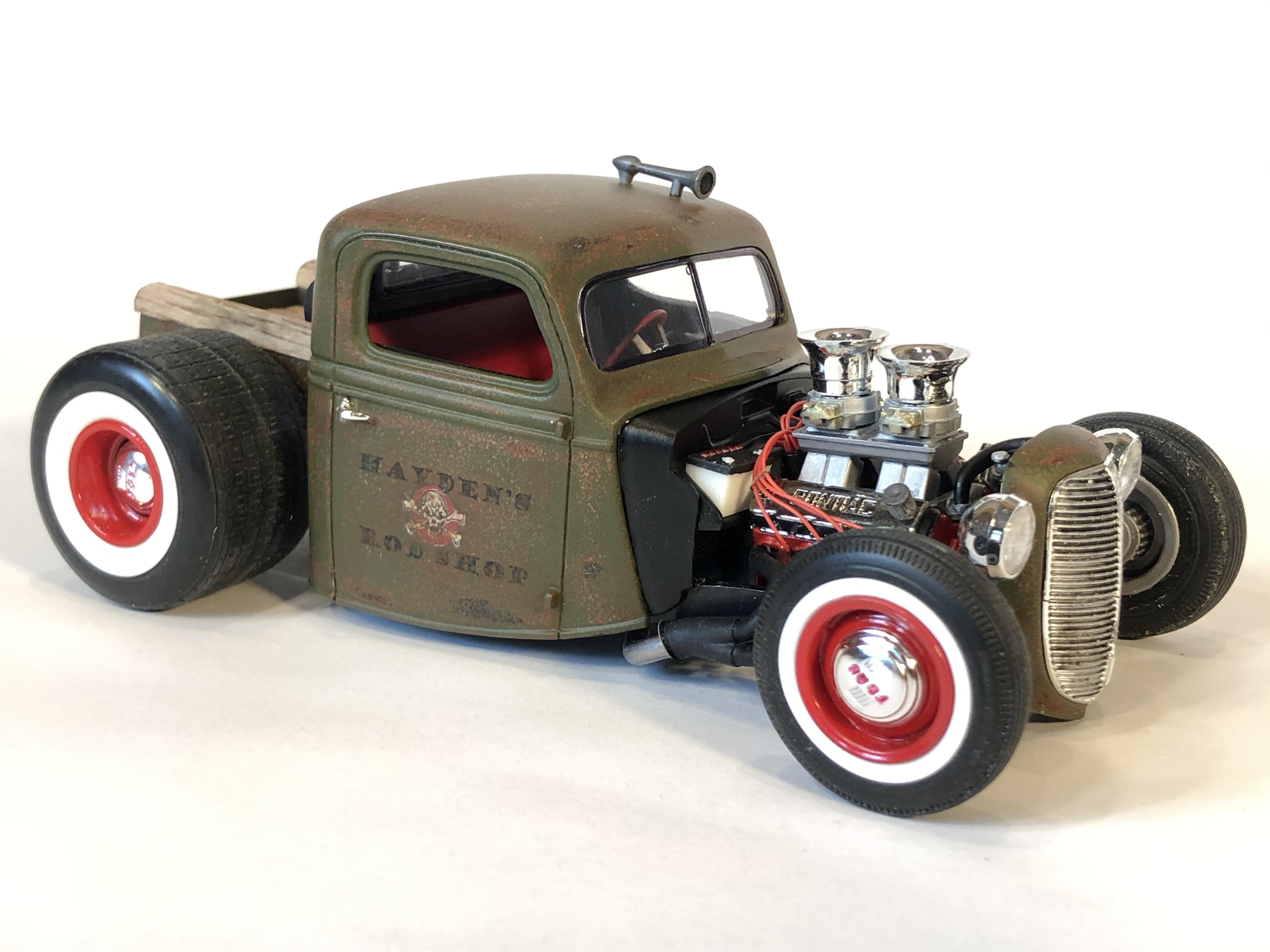

Steve H Posted August 14, 2020 Posted August 14, 2020 Hi all, This project was inspired by the awesome Modelhaus resin rear tires. I would describe it as a parts box raid, and a very fun build. Started with the “checkers” ‘37 Ford. Body channeled over frame, frame Z’d. Bass wood bed, rails and bumper. Exhaust is solder with aluminum tubing for stacks. Engine is from the pro street Firebird kit with various parts box stuff and ignition wires. Grille was shortened to align with the cowl, top chopped about 3 1/2 scale inches. Decals are home made. Paint is: red primer, rust, silver, flat black and tan, all topped with Tamiya olive drab. Careful sanding to create patina. Hope you like it, comments welcome. Cheers, Steve
