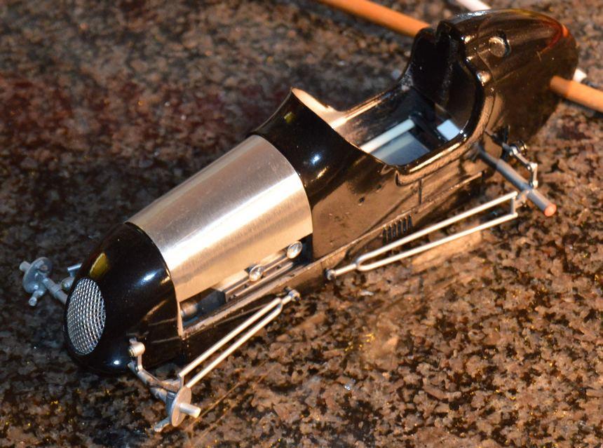

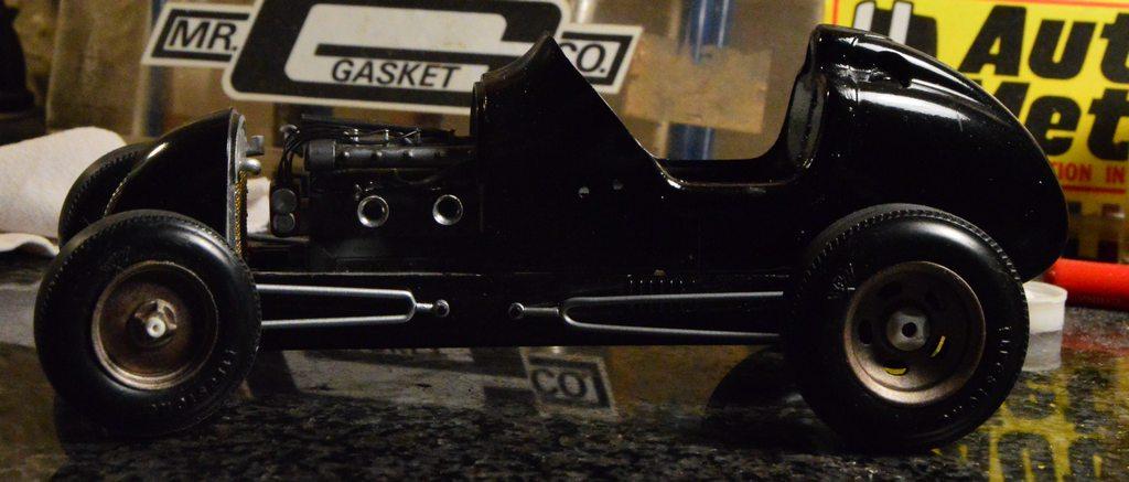

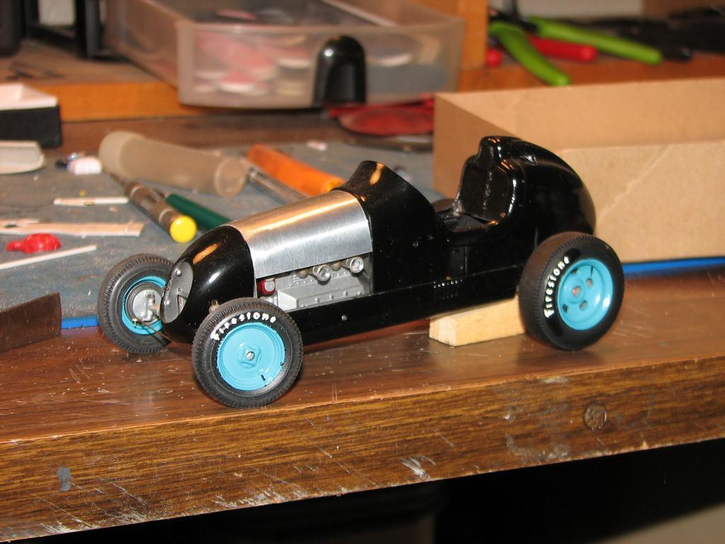

Straightliner59 Posted August 30, 2020 Author Posted August 30, 2020 (edited) The radius rods are mounted. I painted them with Testors' Stainless Steel Buffing Metalizer. Before I mounted the rear pair, I was looking at the tires, compared with the car. I'm sure it's been done, but lowering this thing could make for a mean looking little hot rod! Edited August 30, 2020 by Straightliner59

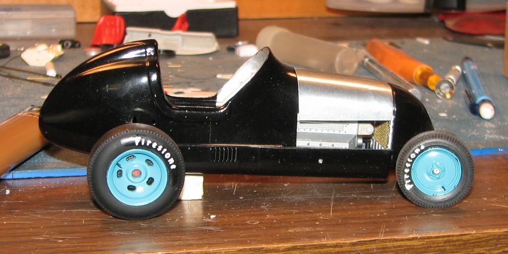

Straightliner59 Posted August 30, 2020 Author Posted August 30, 2020 (edited) 14 hours ago, Earl Marischal said: This is coming on nicely. steve It's coming together, relatively stress-free! Thanks, Steve. I got the wheels painted, and used them to support the car, to get a look at how it rides. I may try to tone the wheels down, a little. At any rate, they will get a wash, and probably a bit of Rub N Buff, as well as valve stems, front and rear. I don't seem to have a set of knock-offs, so, I may attempt to make a set, using the mill--I have already turned a length of aluminum rod to diameter and bored it. Trying, now, to decide how to go about milling and parting them off, given that I don't have a slitting saw, yet. Edited August 30, 2020 by Straightliner59

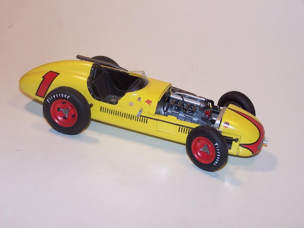

Straightliner59 Posted September 1, 2020 Author Posted September 1, 2020 10 hours ago, Ace-Garageguy said: Yeah baby...that's looking GOOD. Just an FYI...these things also ran 4-link front suspension WAY before it hit the street-rod scene. First photo reference I found dates back to '47 or '49. Thanks, Bill. I had forgotten that. I have an old HP Books publication titled "Indy Car" that covers the history, up to that point (probably mid-'80s) that covers most of the major technical and mechanical changes. That was my best reference when I built this Kurtis Kraft kit. It has a four-link. Like I said, I had forgotten that, specifically, but I remember being surprised, several times, at how early some stuff was incorporated/developed in Indy cars, that didn't really come around, commonly, until much later. I don't know what it is, with me, and these old Monogram kits. I just love 'em! 10 hours ago, Dave Van said: Great idea and work! Thanks, Dave! Thanks for commenting, gentlemen!

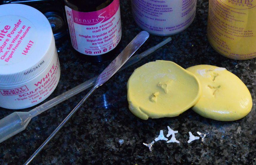

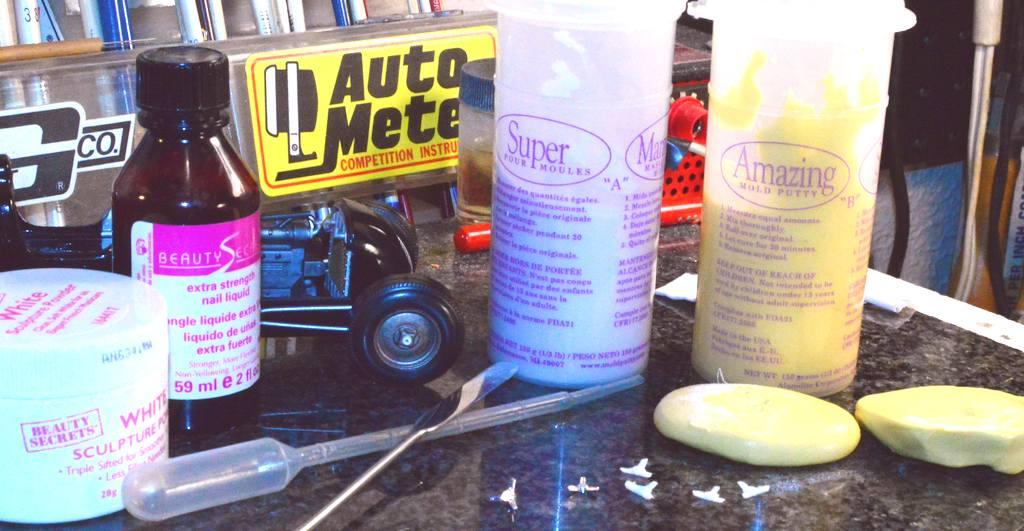

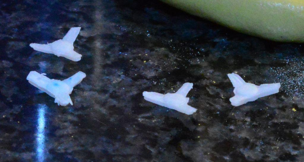

Straightliner59 Posted September 6, 2020 Author Posted September 6, 2020 (edited) Well, I had to take a little detour, of sorts. I couldn't/can't find the old Krazy Glue tube that has my knockoffs in it, and all I could find were two. I looked at kits I had, and came up empty. That left me with having to mold and cast one of those I had. I sanded the stalk from the back, and mixed up a ball of mold making putty. I placed the wad of putty on the piece of granite that I build flat stuff on, and pressed the prepped knockoff into it, so it was just flush with the surface. I let it cure then cut a hole in it, to help index the mold halves (I should have done that while it was soft, and cut two of them!). I then coated it with mold release. I mixed another ball of putty, and pressed it down onto the other half of the mold. Once that was cured, I washed the mold halves, and cast new spinners using acrylic nail compound. I got the stuff in the photos from Sally Beauty supply, but, I also found a small kit at the local Walmart. I've been using this acrylic as a casting medium since the middle '80s, when Don Fahrni acquired some from a dentist he knew. At that time, it was used to make bridges, thus was dyed pink. Its odor is distinctive, so, the first time I smelled the acrylic nail medium, I knew what it was, and knew I had a ready source for a casting material. One of the things I like about it, is that I can flow the liquid component into a mold, then add the powder before closing the mold. Mixing is not necessary, and the liquid tends to flow well, to the nooks and crannies. That said, had I begun this project when I could have worked straight through, I could have made a set of knockoffs, beginning only with the kit part, in about two to three hours. As you can see, they still need to be cleaned up. There's really no excuse, nowadays, not to at least cast some of your own parts, given the ready availability of the materials needed. The mold putty is available at Hobby Lobby. I use the same stuff when I make "pre-drilled" distributor/mag caps. Edited September 6, 2020 by Straightliner59
Straightliner59 Posted September 6, 2020 Author Posted September 6, 2020 (edited) With Testors' Stainless Steel metalizer, straight from the can... Edited September 6, 2020 by Straightliner59

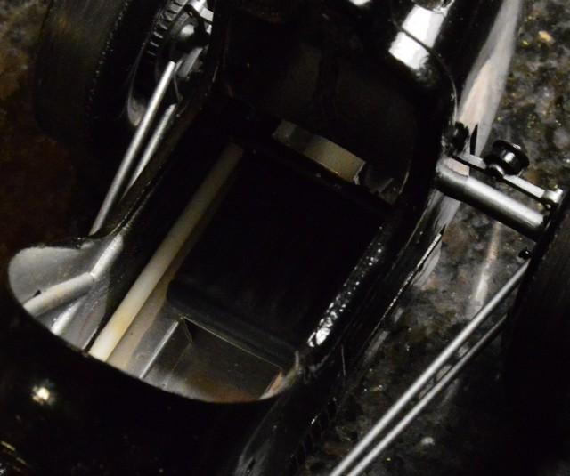

Straightliner59 Posted September 7, 2020 Author Posted September 7, 2020 I sanded the seams from the tires. I also cut down the centers of the rear wheels and added centers cut from castings of the front wheels, so they somewhat match. I had to do a little repair to the steering. I covered the seat bottom with tracing paper over a coat of tacky glue, and shot it with some Krylon chalky texture charcoal grey. I will use it to cover all the leather/naugahyde surfaces, and to make the cockpit coaming. Once the wheels and tires are finished and mounted, I will begin work on the cockpit details like the master cylinder, clutch, throttle, etc. As always, questions, critiques and comments are welcome! Thanks for looking!

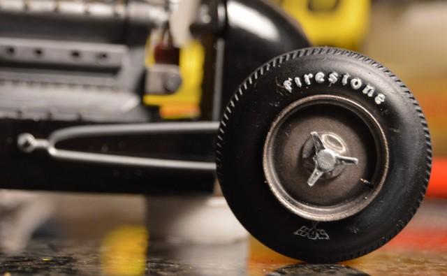

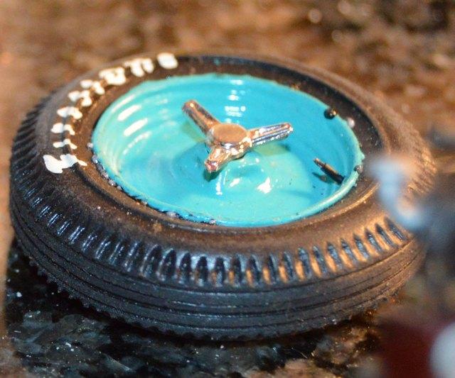

Straightliner59 Posted September 11, 2020 Author Posted September 11, 2020 I repainted the front wheels. They are painted with Modern Metals Metallic Taupe. I think it's still available at Michael's. There are several colors in that line that can be useful to modelers. I still need to install valve stems, and apply a wash, along with a little bit of Rub N Buff. I tried something a bit different with the tires. First, I shot them with Tamiya Tire Black. I then taped off the treads, and shot the sidewalls with Krylon Ultra Flat Black. I like the subtle difference in color, between the two surfaces. Next, I mixed some titanium white artist oils with a dab of Permasol black, and a tiny amount of yellow ochre, and applied it to the lettering with a small piece of rubber eraser. I have to be careful with it, for a couple of days, since the oils take some time to dry. I still need to add wheel inners, as well. As always, questions, comments and critiques are welcome! Thanks for looking!
Straightliner59 Posted September 11, 2020 Author Posted September 11, 2020 Now, with the aforementioned treatments applied to the wheels, and the knockoffs installed. At this point, the wheels are simply sitting in the tires, as it's a tight squeeze, and I want the oil paint to set up, before I attempt to insert them into the wheels...
Alan Barton Posted September 17, 2020 Posted September 17, 2020 Dan, I am really enjoying this because I too started one decades ago and never got to finish the bodywork. I especially like your representation of the tubular frame. - when I unearth mine I will be copying that trick for sure. You asked for critiques so I hope you will understand that my suggestion is meant in the right spirit. When I look at your last mockup photo, I am still seeing a midget, not a big car. Could I suggest that, if it doesn't involve wrecking your model, that you lower it a few mm? The thing is, proportionally, a big car hugs the ground closer than a midget and I think dropping it just a smidge would complete the illusion you are seeking. The mockup in your August 30 post was much closer to the mark, in my humble opinion. Either way, it is going end up a great looking racecar. Cheers Alan
Earl Marischal Posted September 17, 2020 Posted September 17, 2020 Daniel, Those wheels are looking good. Neat idea about the two shades of black on the tyres. steve
Straightliner59 Posted September 17, 2020 Author Posted September 17, 2020 14 hours ago, alan barton said: Dan, I am really enjoying this because I too started one decades ago and never got to finish the bodywork. I especially like your representation of the tubular frame. - when I unearth mine I will be copying that trick for sure. You asked for critiques so I hope you will understand that my suggestion is meant in the right spirit. When I look at your last mockup photo, I am still seeing a midget, not a big car. Could I suggest that, if it doesn't involve wrecking your model, that you lower it a few mm? The thing is, proportionally, a big car hugs the ground closer than a midget and I think dropping it just a smidge would complete the illusion you are seeking. The mockup in your August 30 post was much closer to the mark, in my humble opinion. Either way, it is going end up a great looking racecar. Cheers Alan Thank you for your comments, and your kind words, Alan! I appreciate them. Ah! Well, we're in luck, as the photos from August 30 were taken while it was actually sitting on the wheels. The latest was just a "perspective" shot, in which the wheels were just placed at the ends of the axles, while the car was sitting on the deck! ? However, it's not as long and lean, as it should be, and the cowl's too short, thus the "(Sort Of)", in the heading. There was a time I couldn't have imagined saying this, but, these old, classic Monogram kits provide me with a different perspective on my building. To me, they have a sense of "folk art" about them, and I have come to accept their shortcomings, dress 'em up a little bit with items of visual interest, and throw 'em out on the dance floor! I don't expect to build replicas from them, although, I think my Cook and Bedwell dragster (Slingshot) comes fairly close. Thanks for looking! 14 hours ago, Earl Marischal said: Daniel, Those wheels are looking good. Neat idea about the two shades of black on the tyres. steve Thank you, Steve. I used a paint I found at Michael's for the base color (it's called Modern Metals Metallic Taupe--I know you're in the UK, so I wouldn't have a clue as to a substitute!), then shot them with matte clear (Testors' Dullcote). I followed that with a wash of India ink and water, and, finally, gave them a very light "coat" of Rub N Buff silver. The effect on the tires is very subtle, but it does create a visual difference! Thanks for your comments!
Straightliner59 Posted September 18, 2020 Author Posted September 18, 2020 (edited) 22 hours ago, alan barton said: The mockup in your August 30 post was much closer to the mark, in my humble opinion. Alan, here it is, back on the wheels. I got them done, and wanted to see how they look. Better? ? Edited September 18, 2020 by Straightliner59
Alan Barton Posted September 18, 2020 Posted September 18, 2020 It's working for me Dan! Can't wait to see it with the painted hood on those knockout wheels - I reckon it will look nicely stretched out then. I agree about those folk art cars - my hot rod collection has quite a few, including the Old Monogram 32 Hiboy with the two piece body, the 32 Sport coupe and the dragster you mentioned. Still have to build my Long John dragster. Cheers Alan
