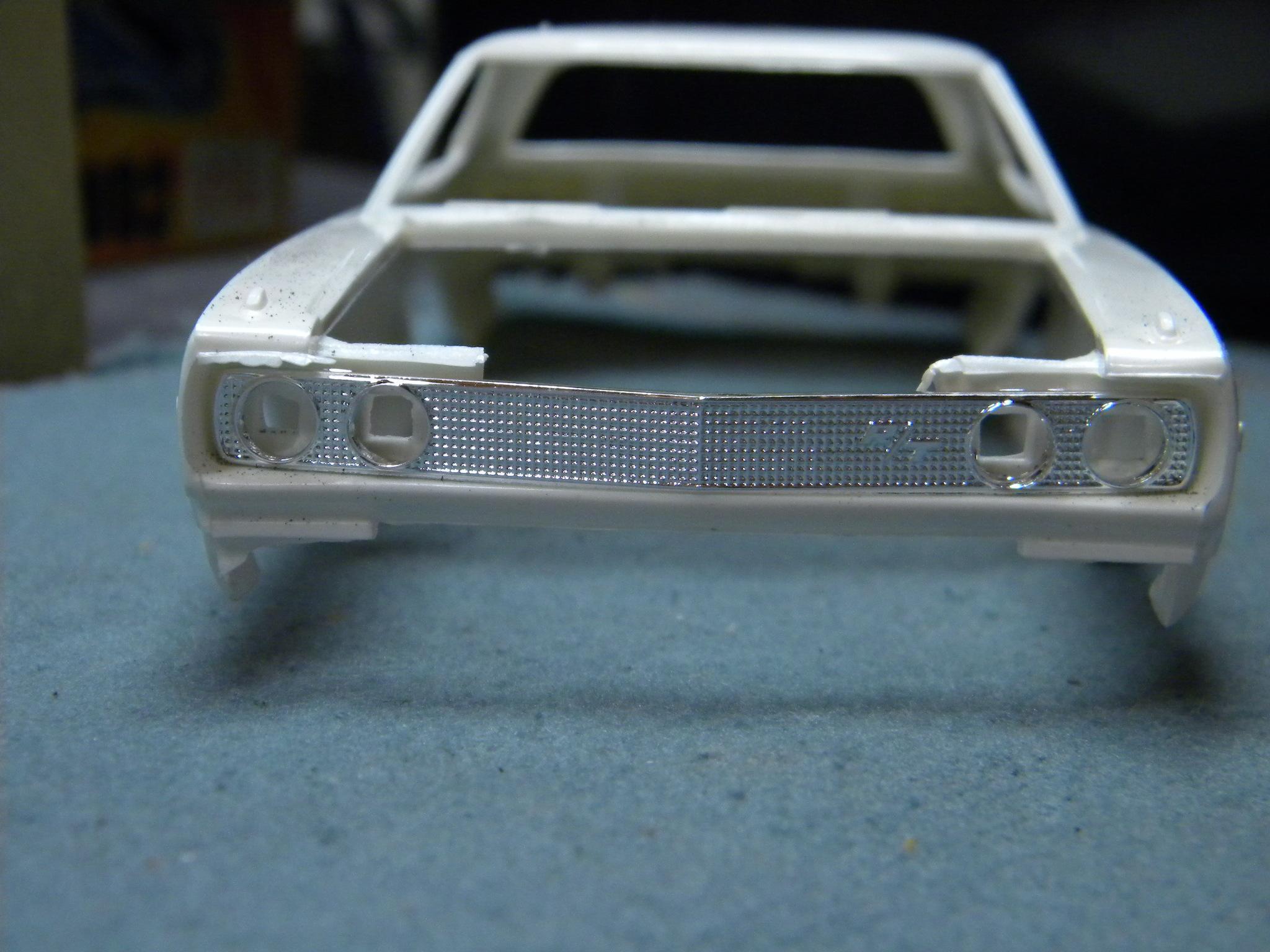

StevenGuthmiller Posted September 13, 2020 Author Posted September 13, 2020 On 9/11/2020 at 10:57 PM, Carmak said: Very interested in seeing the "Steven Guthmiller" treatment on a 68 Coronet R/T. I hope you start by tossing the kit's grille. Carmak I wasn't aware of any issue with the '68 Grille, Craig. I know the '69 was kind of a disaster, but as far as I can tell the '68 looks pretty good. I did drill out the head lights for replacing, but I thought the rest looked okay. Something I'm missing? Steve

Snake45 Posted September 13, 2020 Posted September 13, 2020 1 hour ago, StevenGuthmiller said: I wasn't aware of any issue with the '68 Grille, Craig. I know the '69 was kind of a disaster, but as far as I can tell the '68 looks pretty good. I did drill out the head lights for replacing, but I thought the rest looked okay. Something I'm missing? Steve Just looking at these pictures, I can see that the headlight pairs are too far apart on the model. The headlight rims are nearly touching on the real one. This might be troublesome to some; I think I'll just live with it.
krassandbernie Posted September 13, 2020 Posted September 13, 2020 12 minutes ago, Snake45 said: Just looking at these pictures, I can see that the headlight pairs are too far apart on the model. The headlight rims are nearly touching on the real one. This might be troublesome to some; I think I'll just live with it. The only way around it is to completely scratch build a new grille by cutting out everything but the outer 'frame', laying the appropriate shaped photo etch screen mesh in place with bracing on the backside, using headlight rings and buckets from another source, and then gluing the R/T emblem from the Revell '68 or '69 Charger (for example) onto the grille if you were sticking with building an R/T instead of a Super bee; which would require further scratch building on the taillight panel. The taillights are actually quite different between the R/T and Super bee in '68; yet look similar.
Snake45 Posted September 14, 2020 Posted September 14, 2020 It looks like the headlights on the MPC Charger 500 might be a little closer together than the Coronet grille's, but then again it says Charger on it.
StevenGuthmiller Posted September 14, 2020 Author Posted September 14, 2020 3 hours ago, Snake45 said: Just looking at these pictures, I can see that the headlight pairs are too far apart on the model. The headlight rims are nearly touching on the real one. This might be troublesome to some; I think I'll just live with it. Yeah, I noticed that, but that's really not worth freaking out over IMO. Way too minuscule of a detail to justify messing around with it. I'll be far too focused on removing the convertible "well" detail and replicating the rear door panel trim to mess with something that inconsequential. Steve
Carmak Posted September 14, 2020 Posted September 14, 2020 Steve, It is the headlight spacing and grille opening that bothers me. The 1:1 grille sides are angled in much more than on the kit My Photon SLA printer is scheduled to arrive within the next couple weeks and my first cad project is a new grille. If you would like any interior pictures or measurements my 68 Coronet 500 convertible is out in the shop. The AMT 69 GTX convertible panels are really close but there is something wonky about the boot opening. Carmak

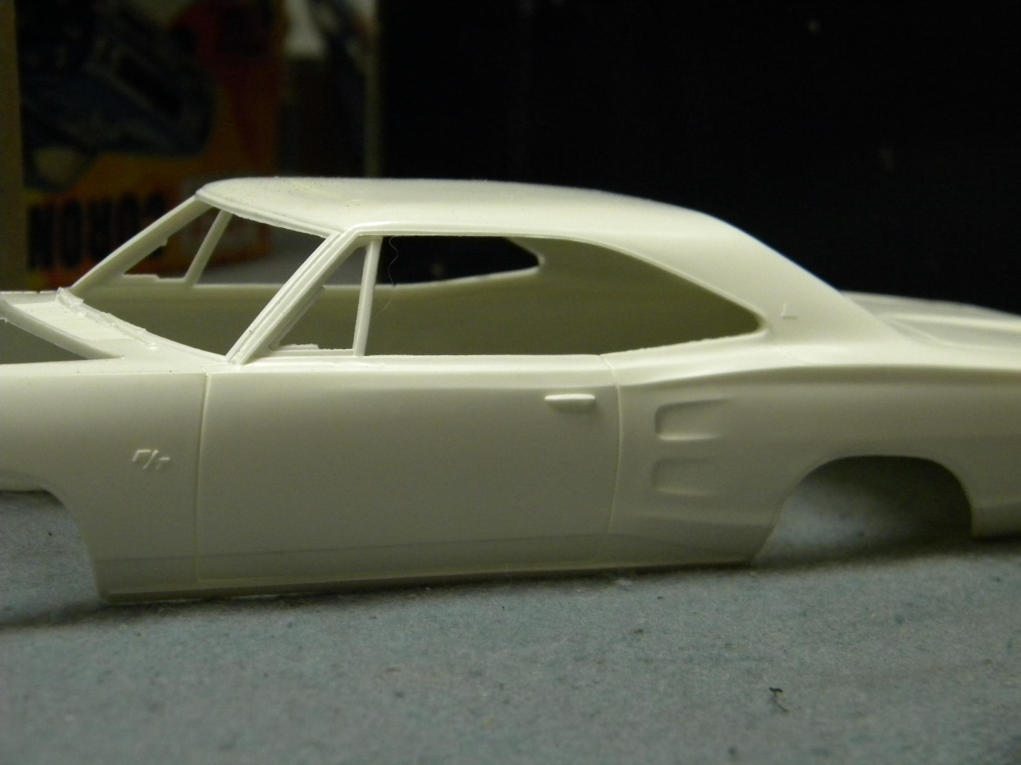

krassandbernie Posted September 14, 2020 Posted September 14, 2020 (edited) 12 hours ago, Carmak said: Steve, It is the headlight spacing and grille opening that bothers me. The 1:1 grille sides are angled in much more than on the kit My Photon SLA printer is scheduled to arrive within the next couple weeks and my first cad project is a new grille. If you would like any interior pictures or measurements my 68 Coronet 500 convertible is out in the shop. The AMT 69 GTX convertible panels are really close but there is something wonky about the boot opening. Carmak I agree with you here; having studied these cars for quite some time.......and the MPC kits. The early production '68 bodies have a more accurate shape to the bottom edge of the rear quarter windows; but it was altered to have that goofy sweeping upward curve by the time they came out with the "Feverbee" funnycar kit; and this change stayed put right on through the '69 and '70 bodies. I believe Steve corrected this to some degree on his '69 Coronet R/T build. One other area that is off on the MPC '68-'69 Coronet bodies is the two little indented 'coves' at the front of the quarter panel. They're too large......or long to be a bit more accurate. I plan on attempting to graft the 'coves' from a Monogram '69 Super bee into a junk '70 Super bee body first to see if I run into any issues with the contour of the surrounding 'sheet metal' before cutting on one of my '68 or '69 MPC bodies. Visually, the 'coves' look about the right size despite the Monogram body being 1/24th scale. Back to the '68 grille...........it is also not set into the opening deep enough compared to the 1:1. There's more 'material' on the inside of the fender/grille opening; where it looks more carved out at the deepest area on the sides on the MPC body instead of having a slight angle inward to meet the grille. Since there already appears to be a slight gap around the sides of the grille a little plastic sheet stock glued and reshaped might be all that is needed here to correct this proportional error. Edited September 14, 2020 by krassandbernie
oldscool Posted September 14, 2020 Posted September 14, 2020 After seeing the pic of the real deal, the headlights don't really look that much closer together.

CapSat 6 Posted September 14, 2020 Posted September 14, 2020 I'm really looking forward to seeing what you'll do with this, Steve! This kit has always looked fairly right to me, I never noticed the grille issue before. I actually have a 1:1 '68 Coronet grille stashed away in the basement. I got it at a swap meet back when they were inexpensive. Is there any way to scan a part (or in the case, 3 assemblies) and make 3D files out of them? I would like to do that in order to create a '69 Charger 500 grille in 1/16 scale, but we could also use a better grille in 1/25 while we are at it.
StevenGuthmiller Posted September 15, 2020 Author Posted September 15, 2020 I likely won't be making too many alterations to this body, except for possibly the most glaring inconsistency, which strangely enough, Ed neglected to mention. This would be the crease, or ridge evident on the door panels just above the door handles. This doesn't exist on the 1:1 and needs to be removed. Other than that, the rest is close enough for me. Steve
krassandbernie Posted September 15, 2020 Posted September 15, 2020 16 hours ago, StevenGuthmiller said: I likely won't be making too many alterations to this body, except for possibly the most glaring inconsistency, which strangely enough, Ed neglected to mention. This would be the crease, or ridge evident on the door panels just above the door handles. This doesn't exist on the 1:1 and needs to be removed. Other than that, the rest is close enough for me. Steve You are correct, I failed to mention it! LOL! Subconsciously I knew you already corrected this on your '69 Coronet R/T; so it would be a bit redundant to bring it up again! LOL!
