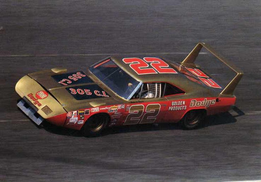

Just finished over the weekend. Took 215 hours to build including the decals which took 56 hours of that time. This is supposed to represent the last winged warrior that competed in Nascar. The 1971 Daytona 500 was the race. Mario Rossi prepared the car and this was the only race it ever appeared in.  Bill France changed the rules on these cars for 1971, saying that if you wanted to run one you had to run a 305 cubic inch engine with one 4 barrel carb. Rossi took him up on it and almost won the race. He used a Keith Black prepared 340 cuda engine that had been prepared for trans am racing. It was destroked to 305 cubic inches. This stock block engine ran at over 9000 r.p.m.'s all day long and survived. If Brooks had'nt got caught up in a wreck with Pete Hamilton, he could have possibly  won the race. They were fighting for the lead on laps 97 and 98 when they tangled. Brooks ended up seventh. If you want to see how it came together click on the link below.

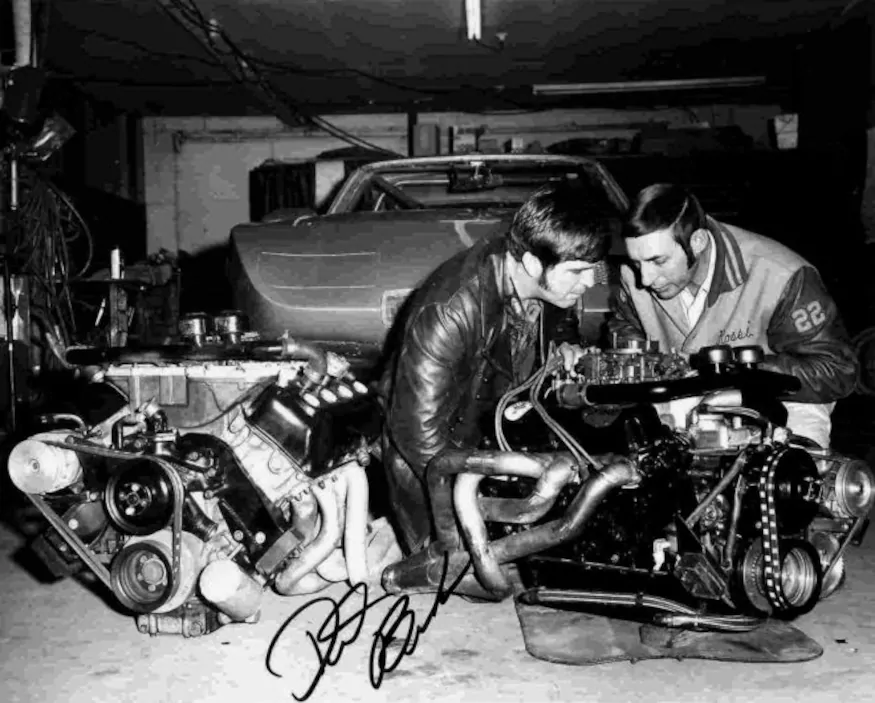

Francis, Yes that little black motor is a 340 destroked to a 305. Chrysler didn't make one back then. I don't think they ever did for that matter. Keith Black the drag racing motor builder built those 340's to be used in the trans am series in cudas and challengers. I made mine from a 440 taken from a 71 amt  charger kit. I shortened it moved the heads more upright to make it less wide and fixed the valve covers to look like 340 valve covers. Added an intake from my parts box that looks some what like the intake on the picture I found of the real motor from above. I was thinking it would be a bathtub manifold but it was not. Thanks for your interest in the build.

Chrysler built 288" and 296" Pro-Stock drag engines in the 1977-1979 time frame for drag racing. I did the dyno development on those engines at the Tech Center. Don Glidden ran a Pro-Stock Plymouth Arrow back then. Ran the engines to 10,400
rpm. Also, had the 327" Indy car engine in 1969. See picture.1331203722_PlymouthIndycarengine1969-5.JPG.593bbc304f45557cfde0a5e96298c455.JPG
Edited by Vietnam Vet67
addition of info.
