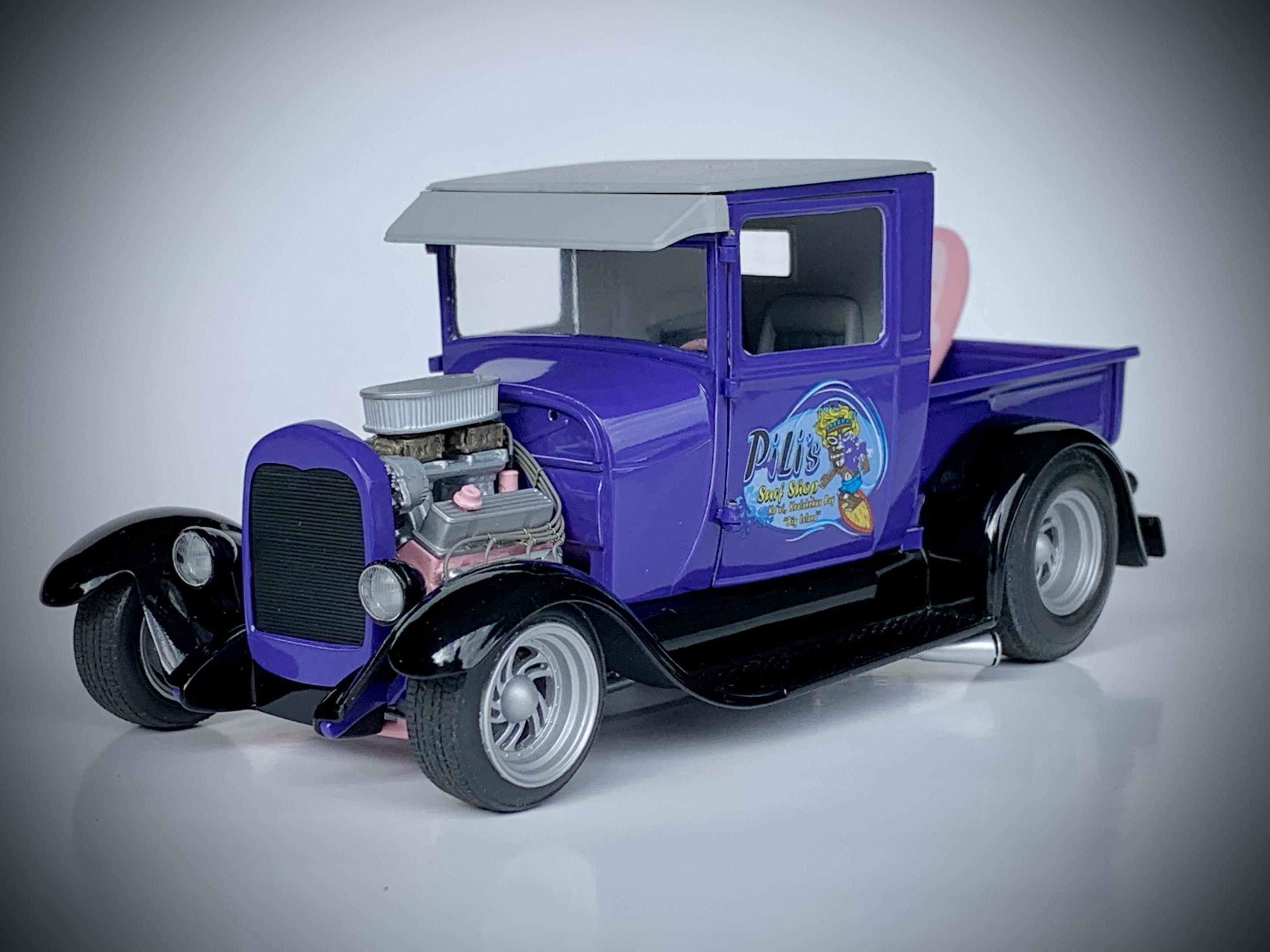

Dennis Lacy Posted September 15, 2022 Author Posted September 15, 2022 (edited) Our friend @Kit Karson has suggested that I create a group thread in the Under Glass for pickups where we can all share our finished Tim Boyd tribute trucks. Sounds like a good idea to me so look for that soon. I realized that the finished pictures I took of my truck weren’t the greatest so I figured out a good background and lighting so that I could shoot new and improved pics that show the finished quality of my truck much better. Edited September 15, 2022 by Dennis Lacy 3 1

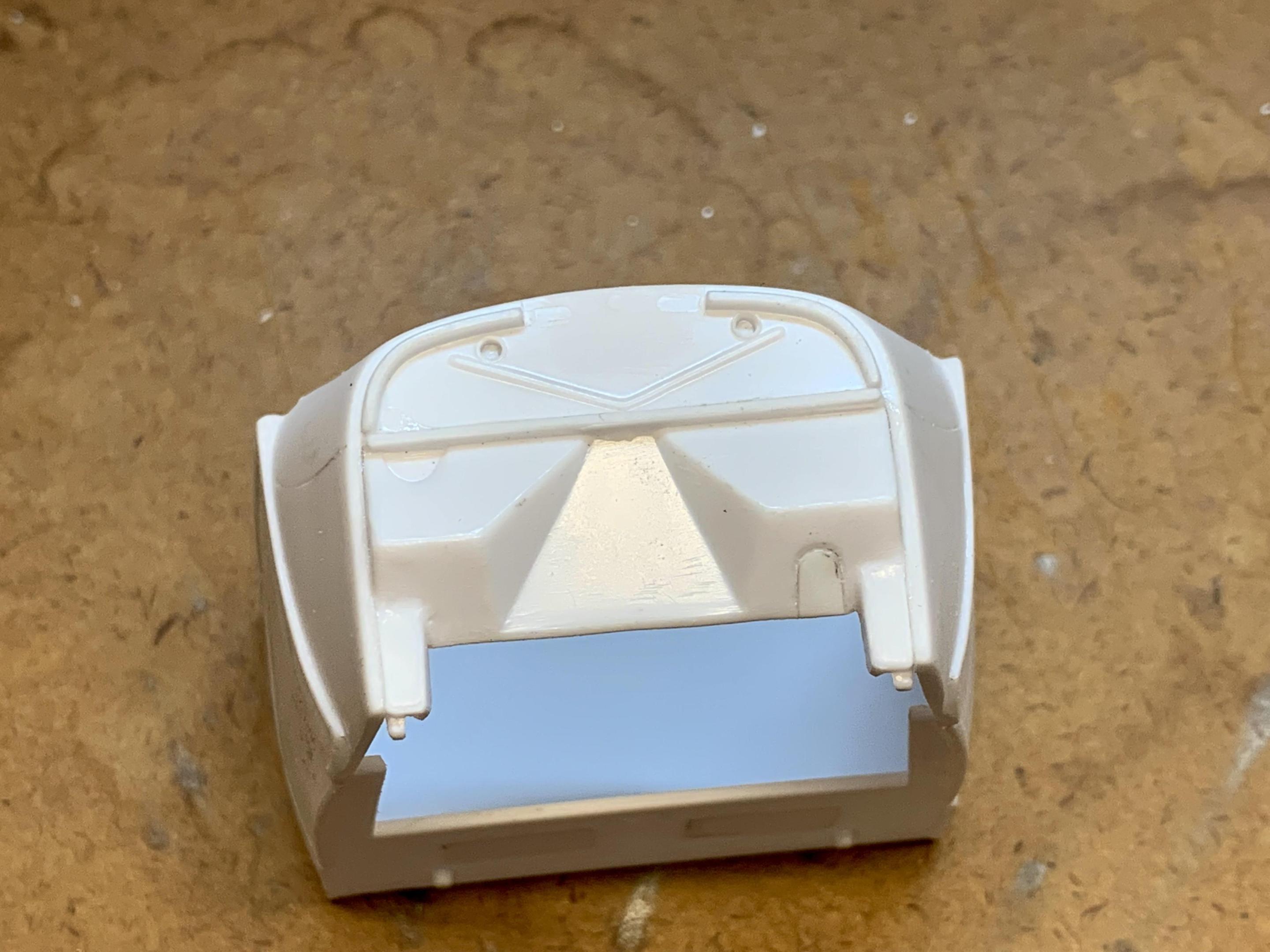

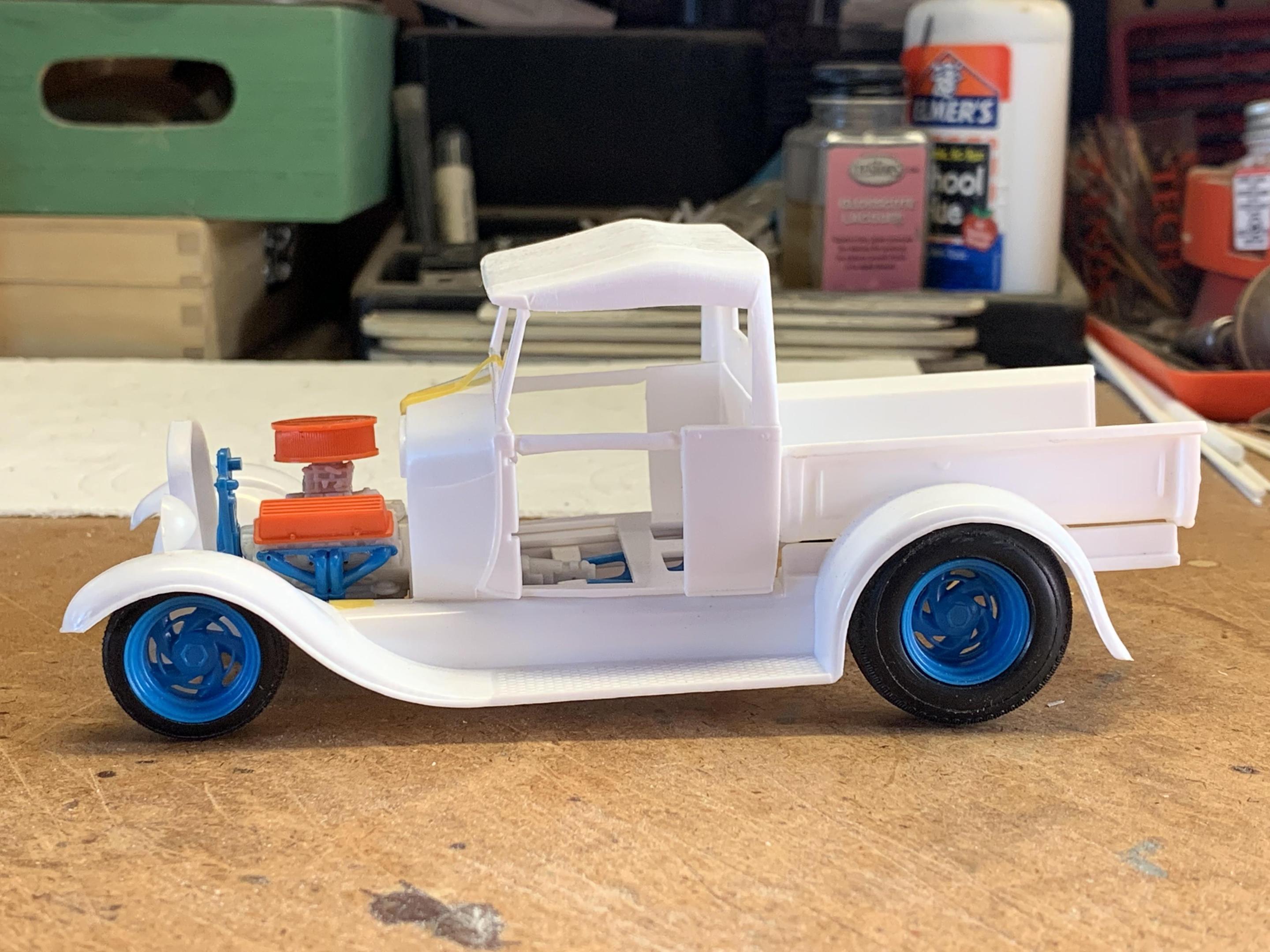

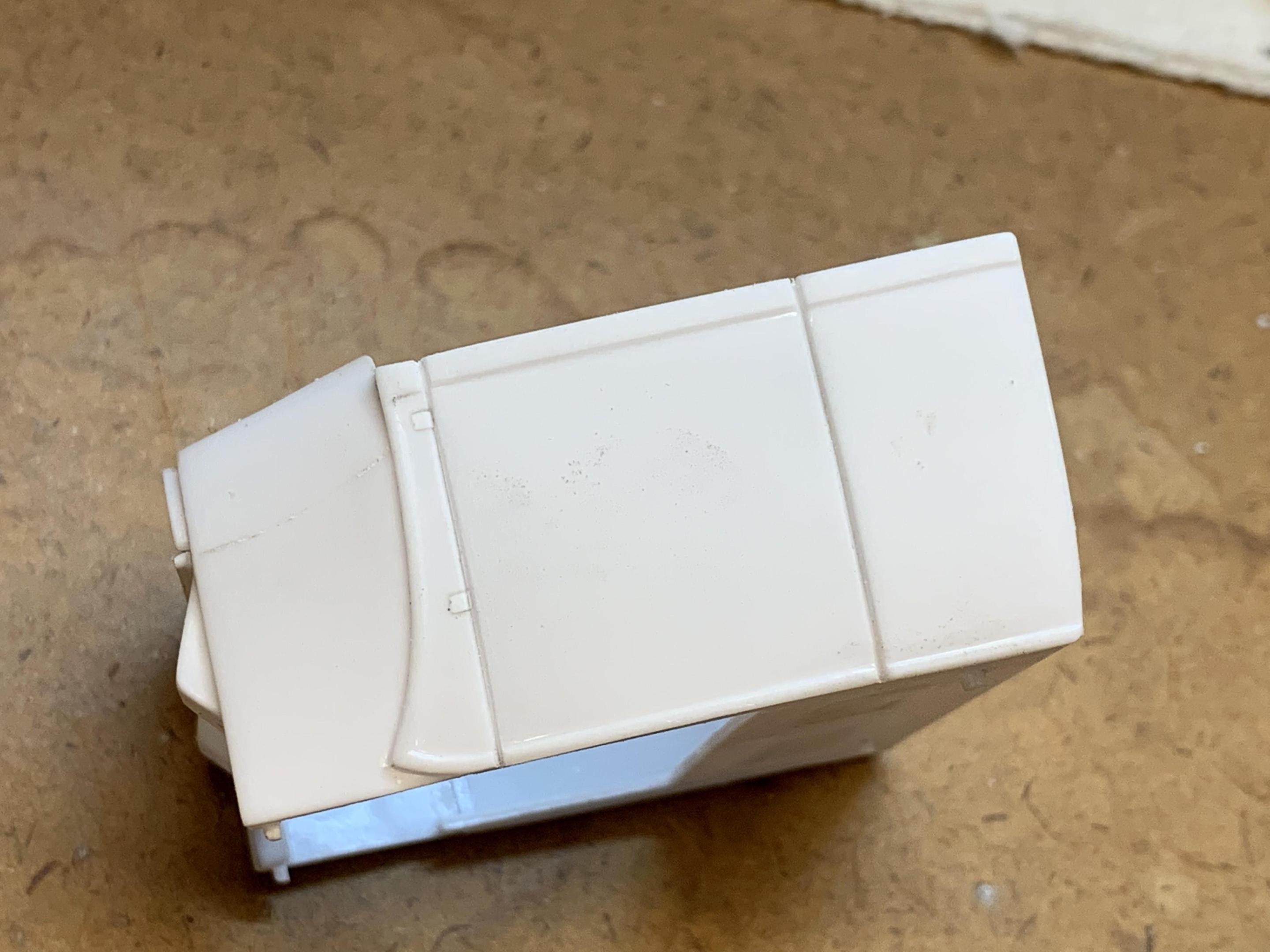

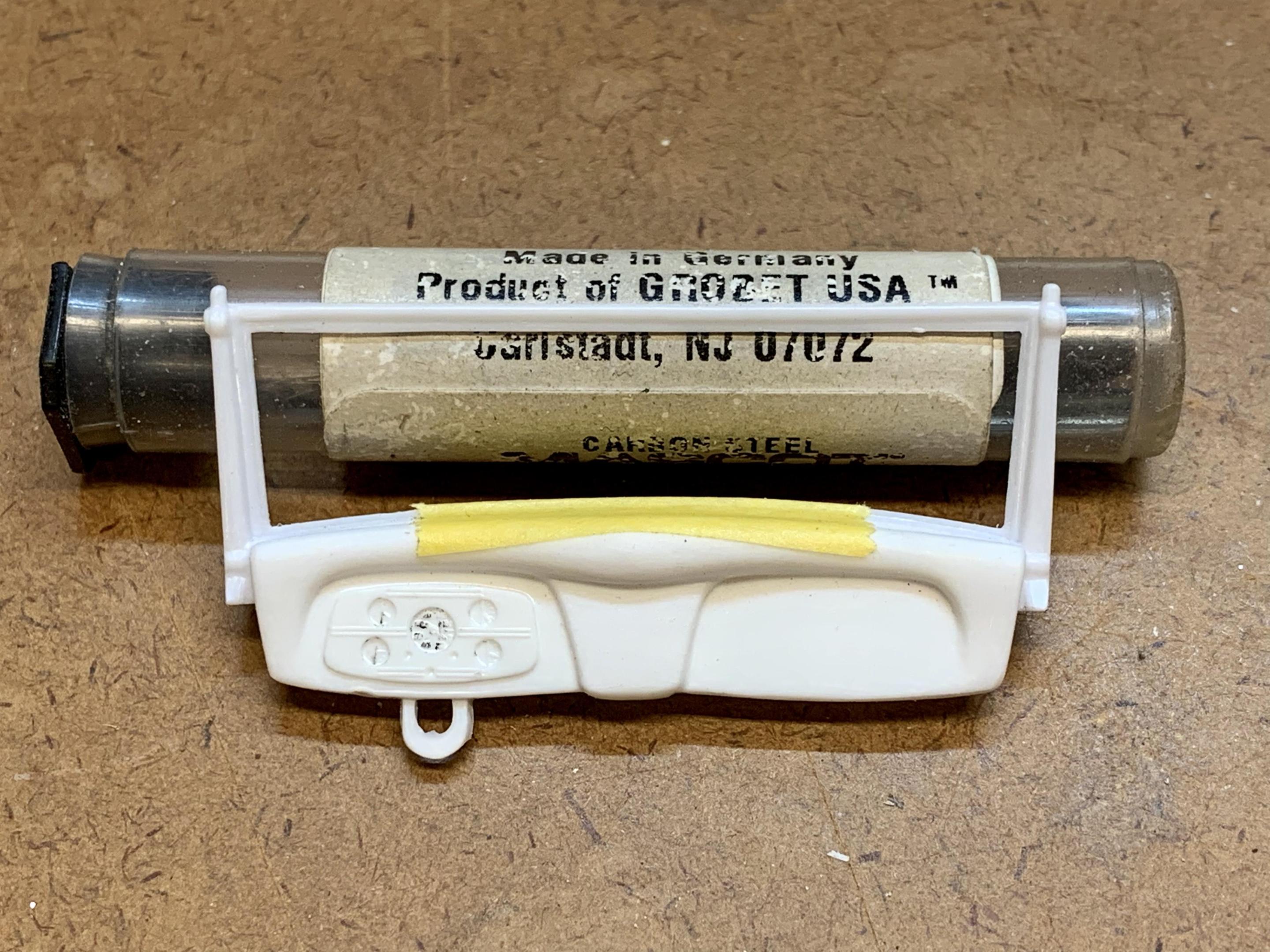

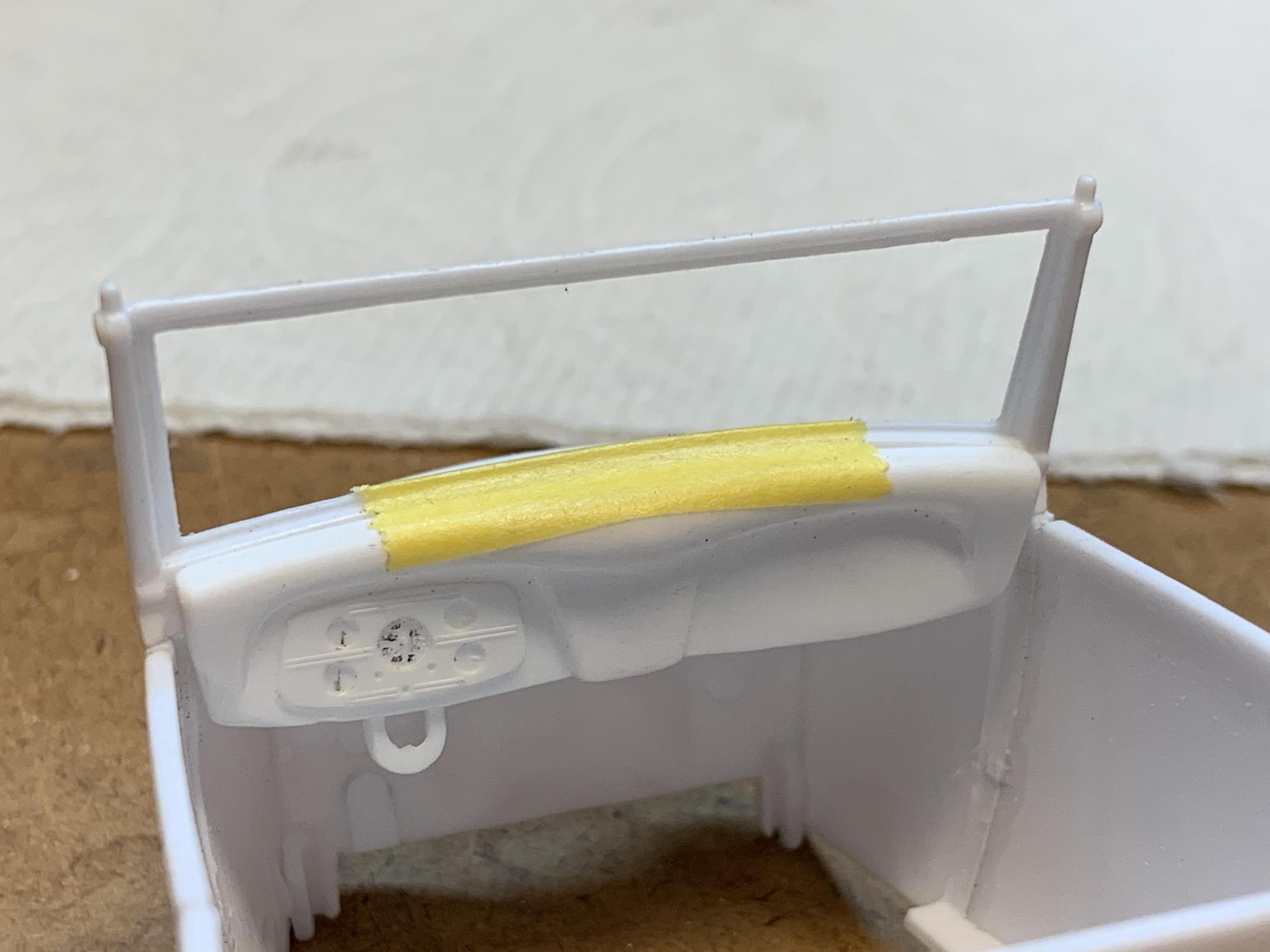

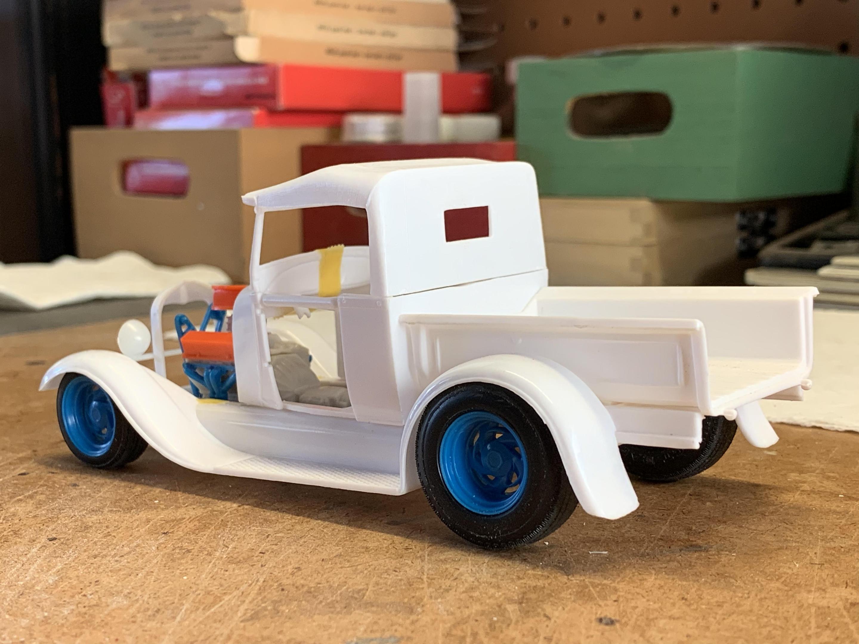

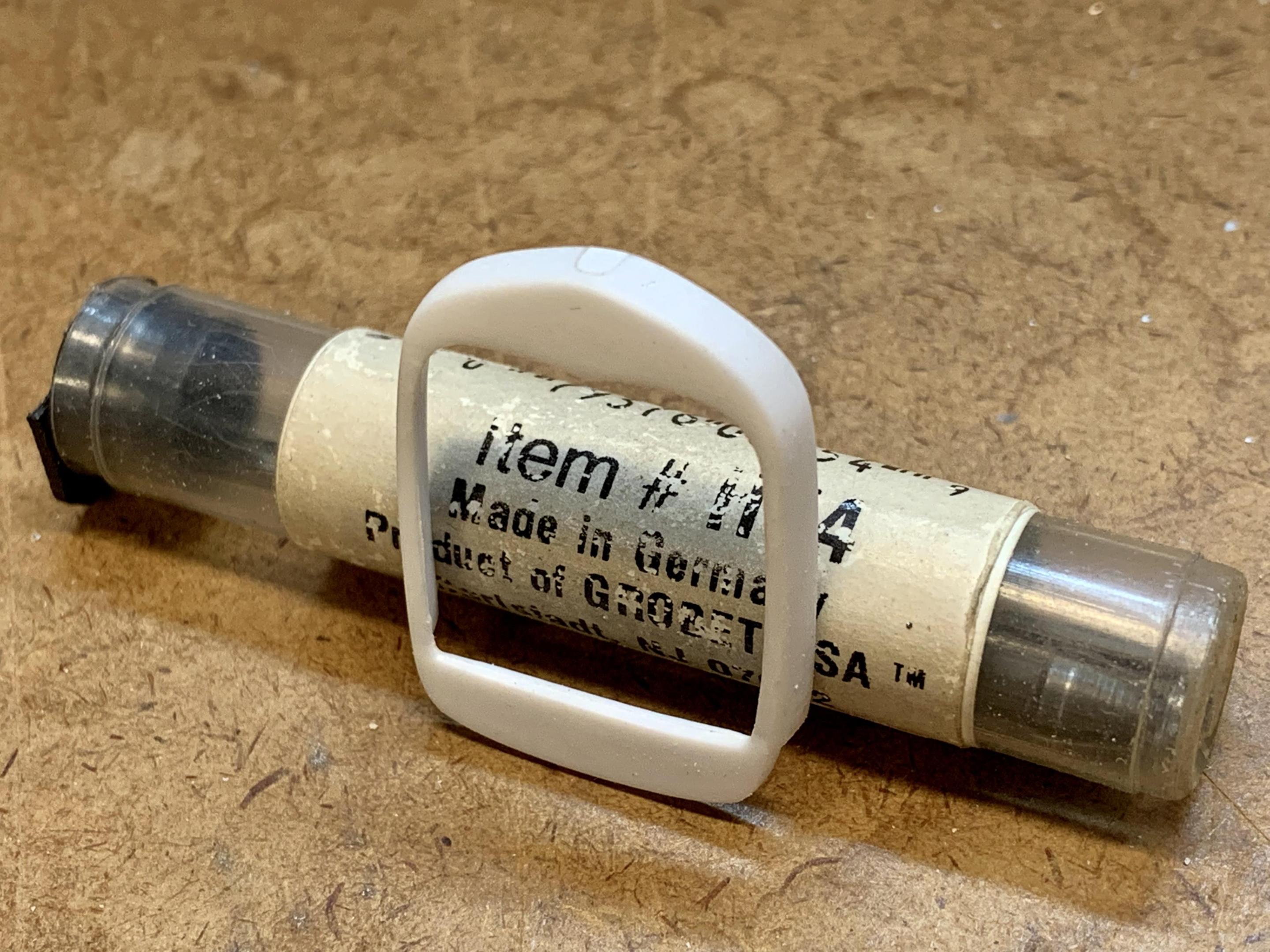

Dennis Lacy Posted September 19, 2022 Author Posted September 19, 2022 UPDATE! Did a little work on the sister Roadster Pickup yesterday. Started addressing getting the body properly smoothed out. I left the doors functional on my closed cab but since this is a roadster and the interior can be easily viewed I felt it unnecessary. The notches for the hinges got filled and the doors were glued in with liberal amounts of Zap A Gap. Once set I smoothed everything out and then scribed the door gap lines back in. I also permanently installed the lower half of the firewall and filled the slot where the original steering shaft passed through. On the bottom side those two rectangle holes were filled and the rear floor generally smoothed out. The radiator shell had its Ford emblem and lower crank access cover smoother and the radiator cap slot at the top filled and smoothed. Lastly I started working on fitting a dashboard. This one is from the Monogram ZZ Top coupe and features a period correct billet gauge panel. This could change but so far I think I like it. Thats all for now. It felt good to make some progress! 2

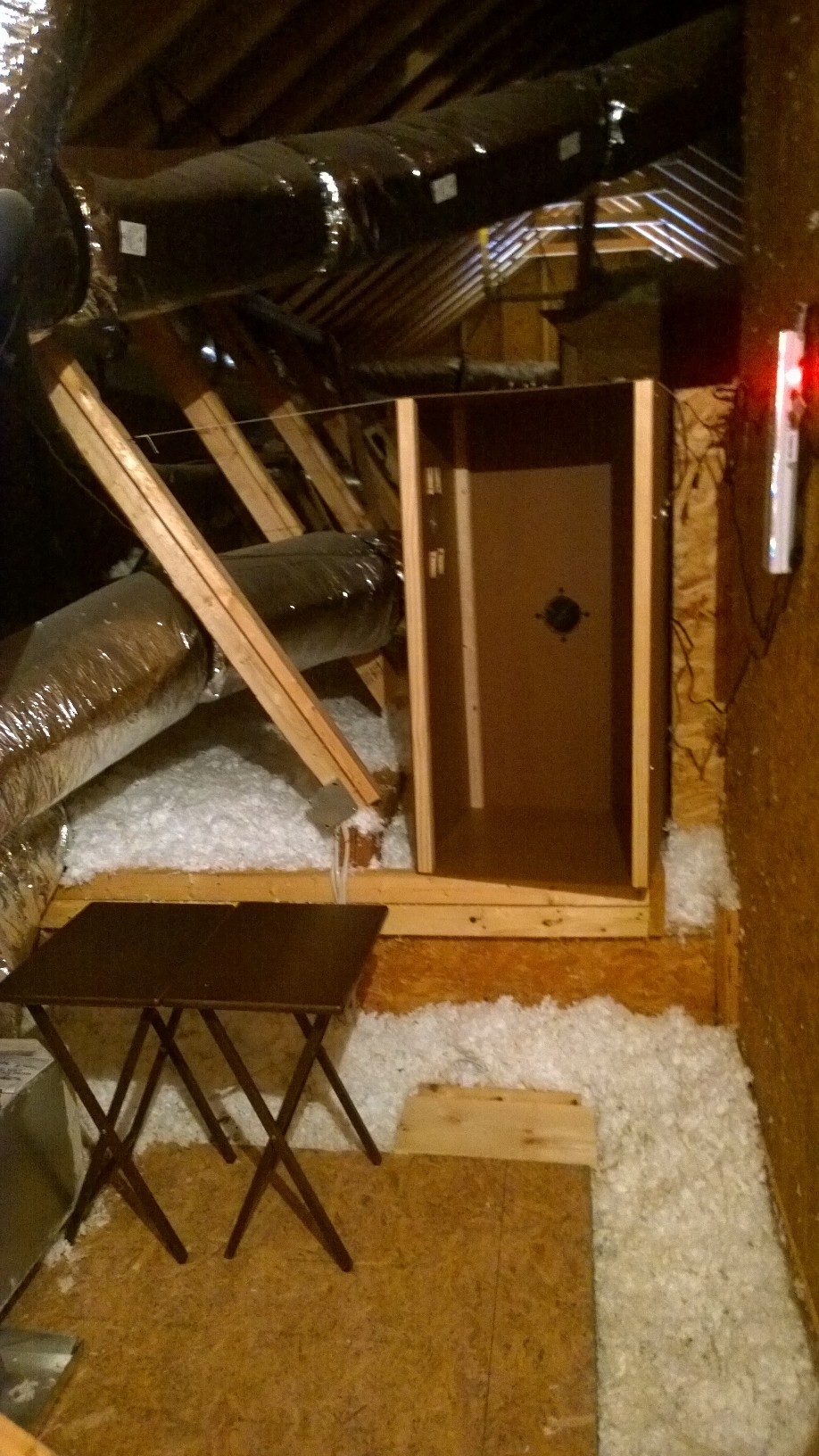

horsepower Posted October 31, 2022 Posted October 31, 2022 On 5/6/2021 at 9:54 AM, Kit Karson said: Ain't nobody but us palsticholics left on earth! I haven't given up on finishing my part of this thread! @Dennis Lacywe have over 15k views! As soon as I get back to my bench, I will finish my tribute '29A closed Cab PU! This is right where I left off... Spent a little time building a paint booth in the attic! And, I bought a new old PU! Be back at the bench in no time, Brothers! That looks like a fairly easy p'cup to get the right parts for, but getting a round tuition may be the bad part of the build. The Lindbergh/AMT '34 Ford truck for the cab, grille shell, and bed, the '32 five window coupe from Revell for the chassis running gear, (gotta stay Ford here, just a personal thing for us old timers) fenders (without a spare indention in one of them) hood and headlites, the Revell Dan Fink '32 for the door panels and using its rear seat for a bench in the truck cab, (if it doesn't look right I'll use the buckets) and an overhead console from any of the Revell '26 T kits, tires and wheels from the Revell '32 five window again. With all those parts and pieces (except for the overhead panel that will be built with some .010 sheet.plastic and one of the stereo faces from Detail Master and a few gauges that I think will look better up there than cluttering up a nice smooth dash) maybe I can get the ambition to start on it before the snow flies??. 1

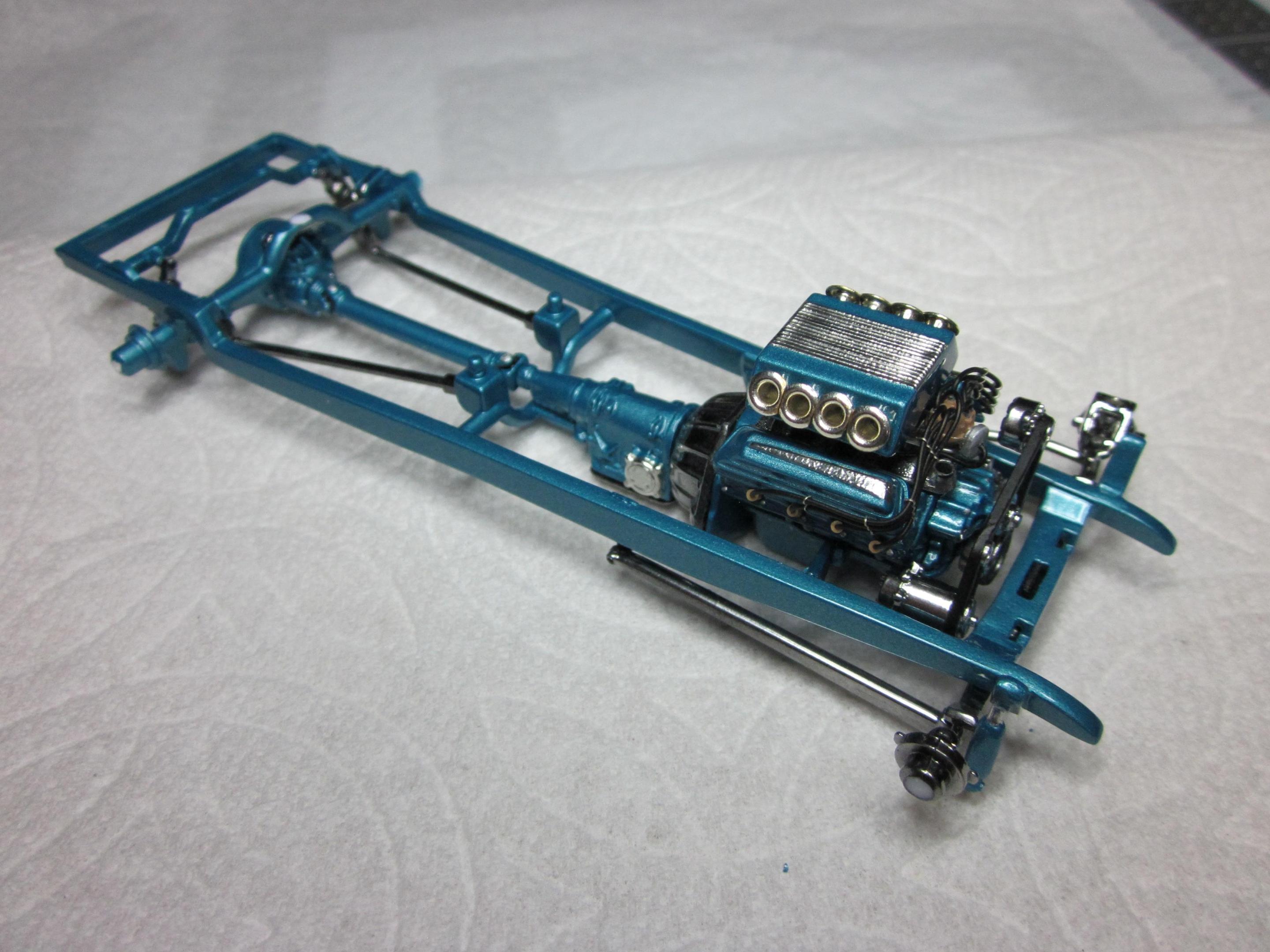

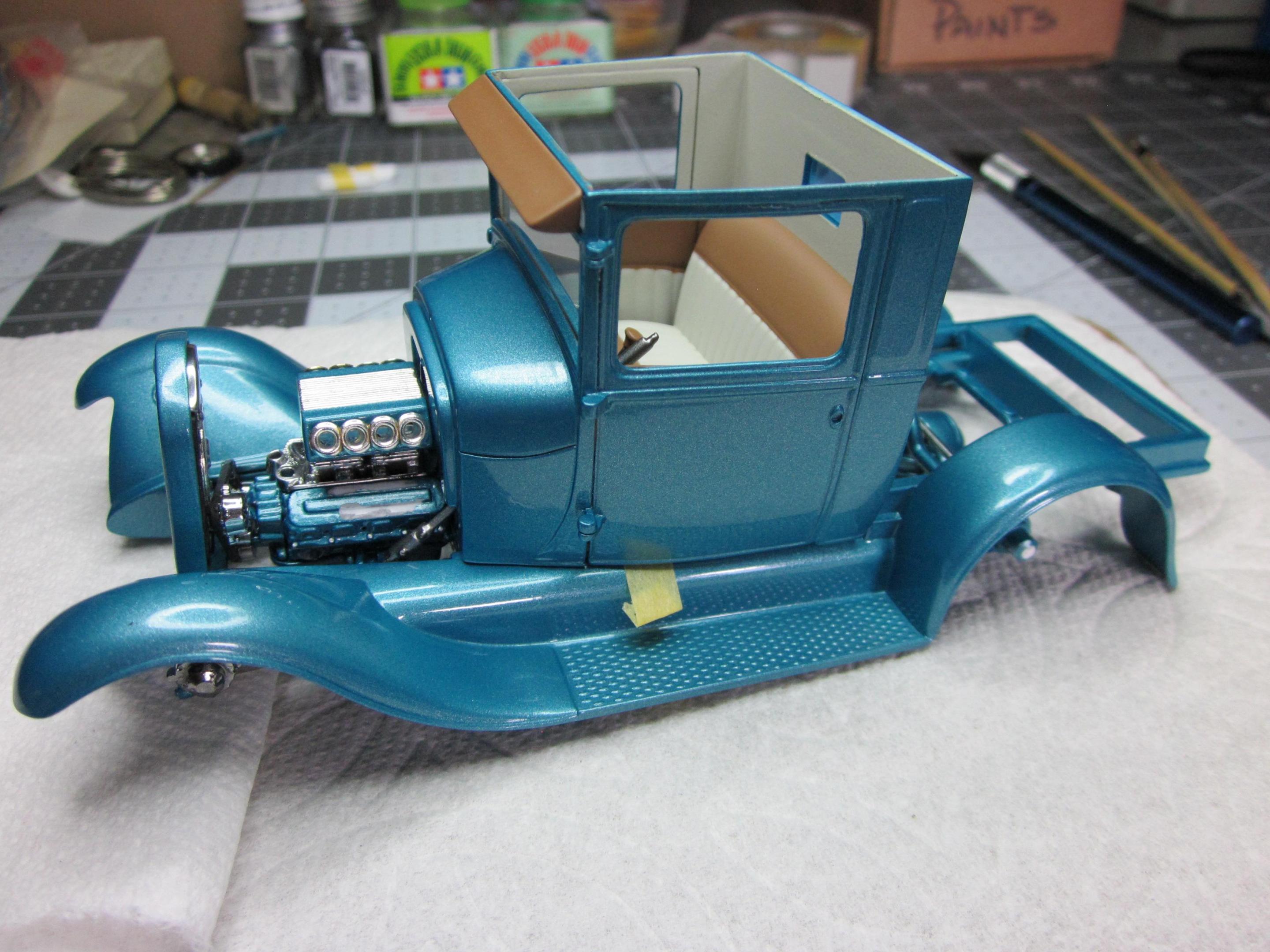

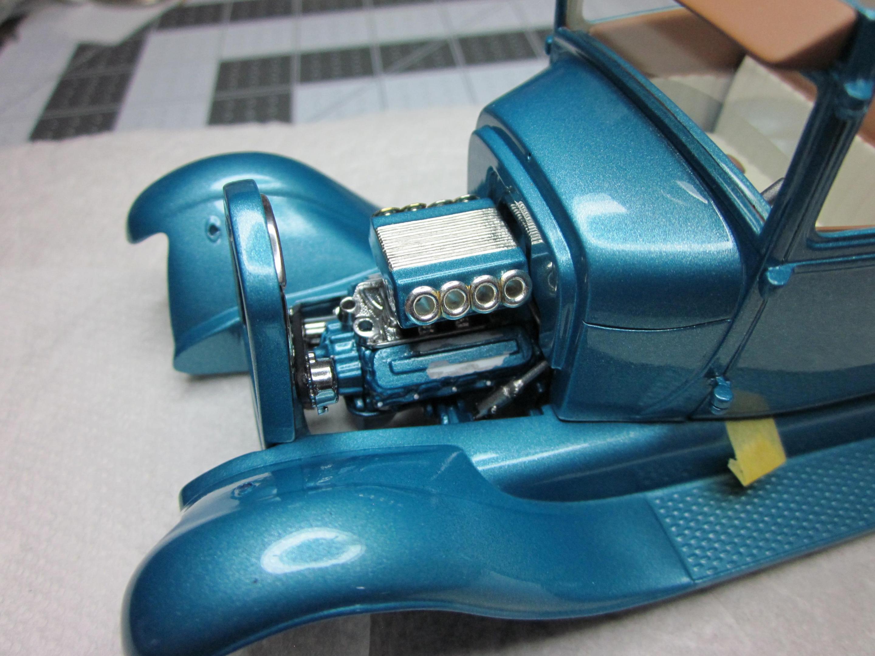

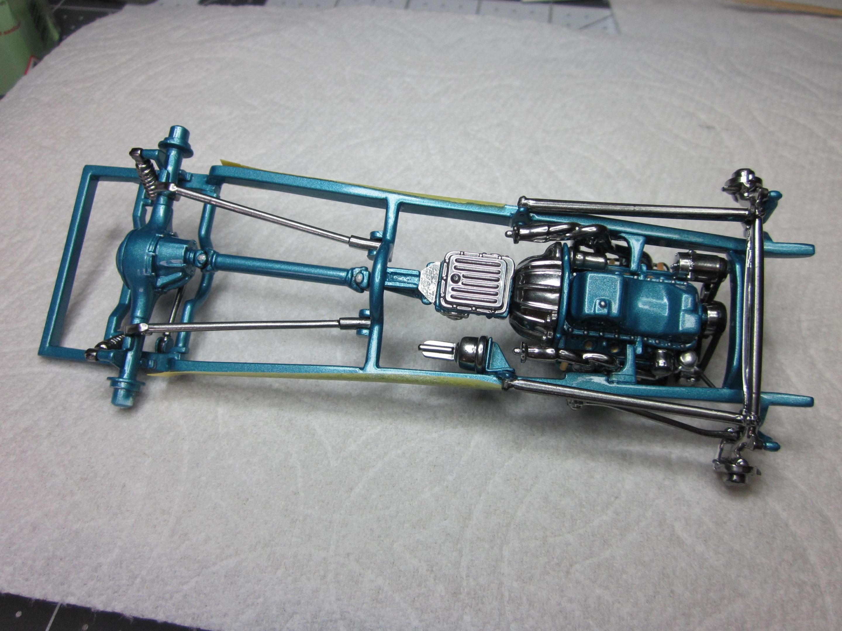

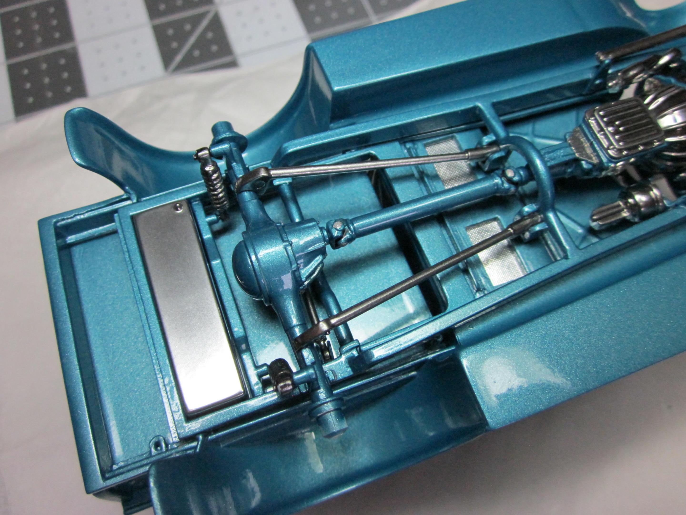

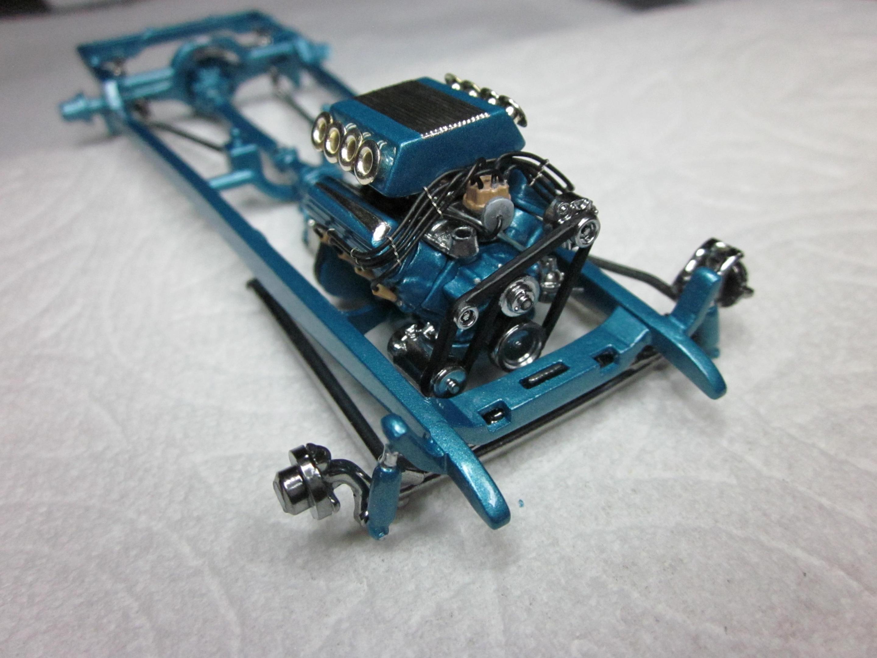

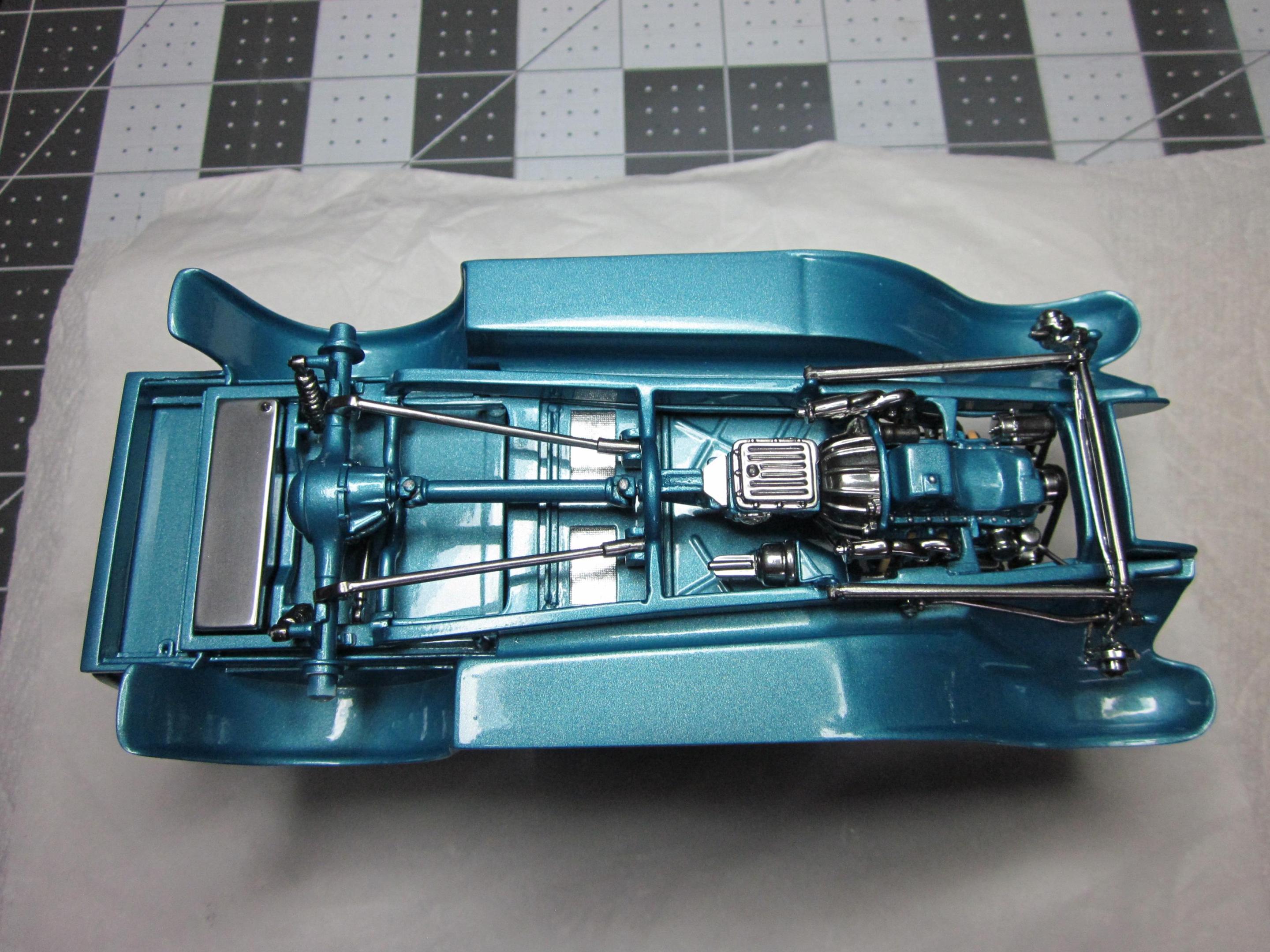

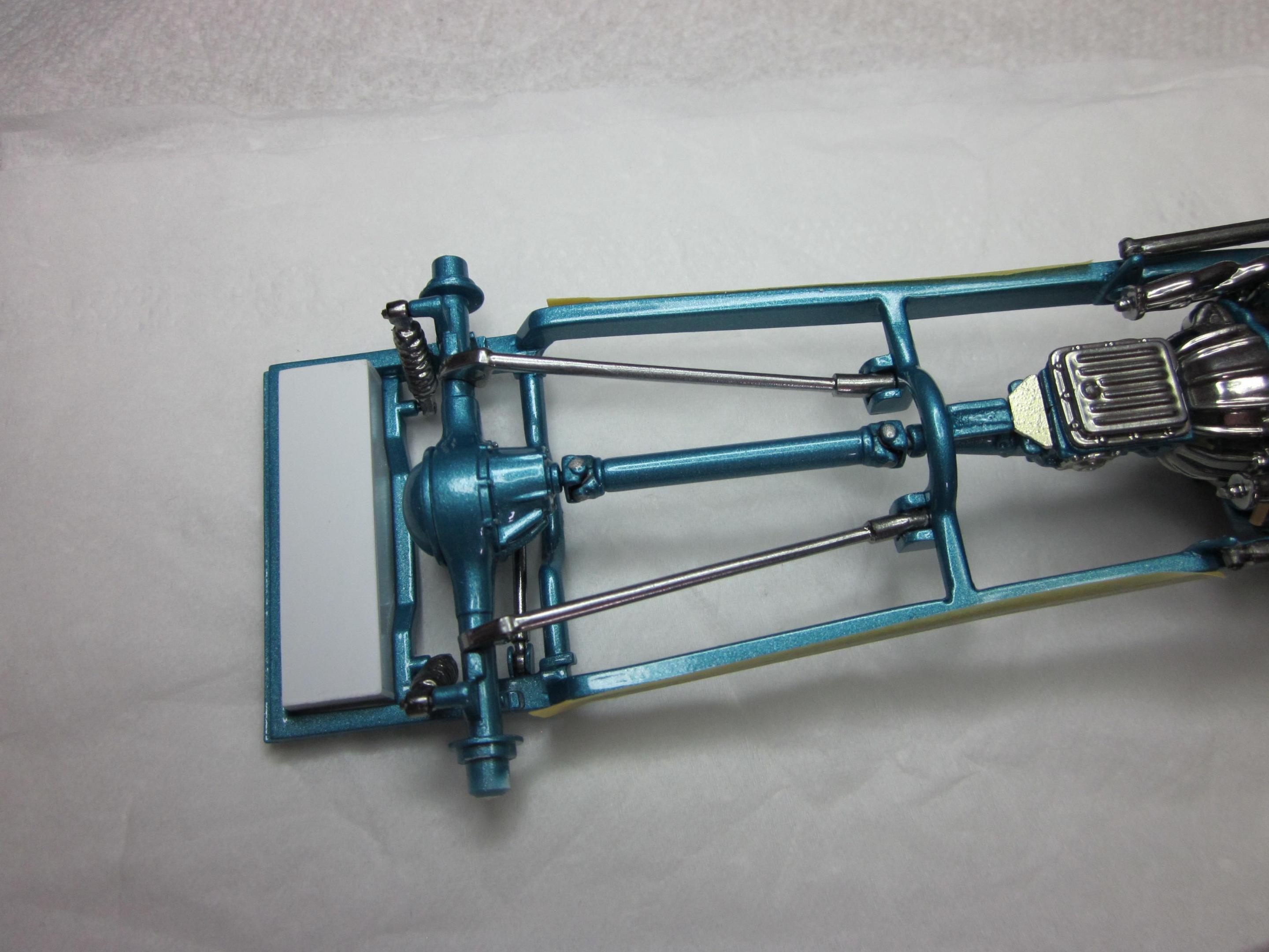

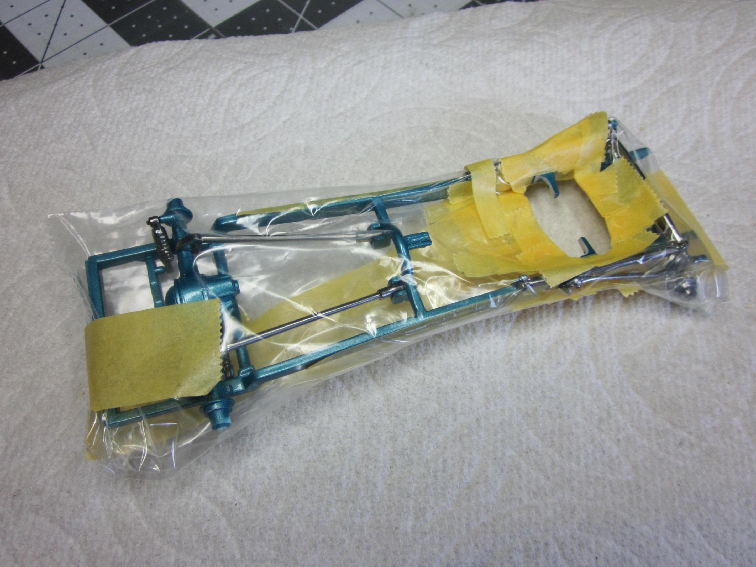

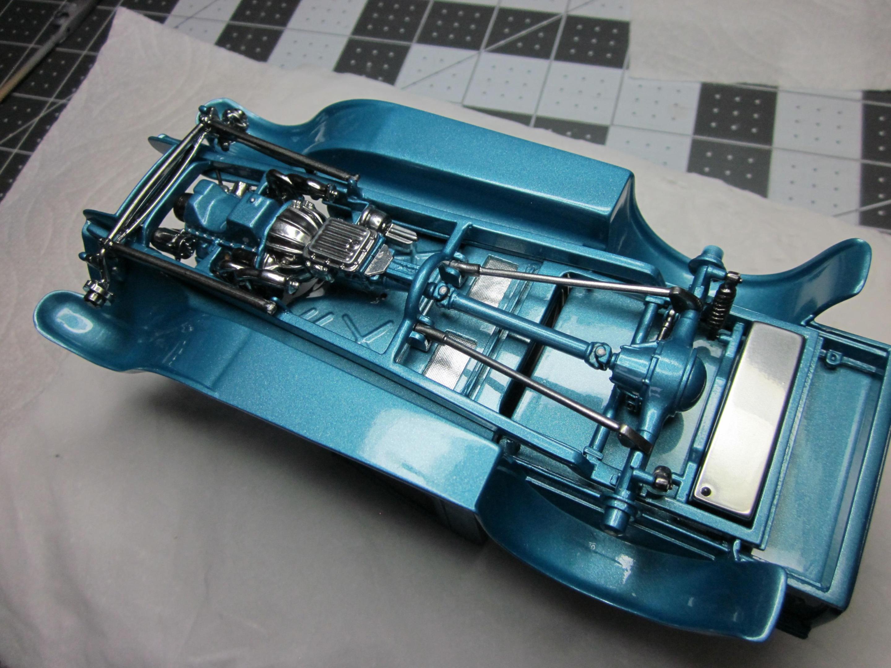

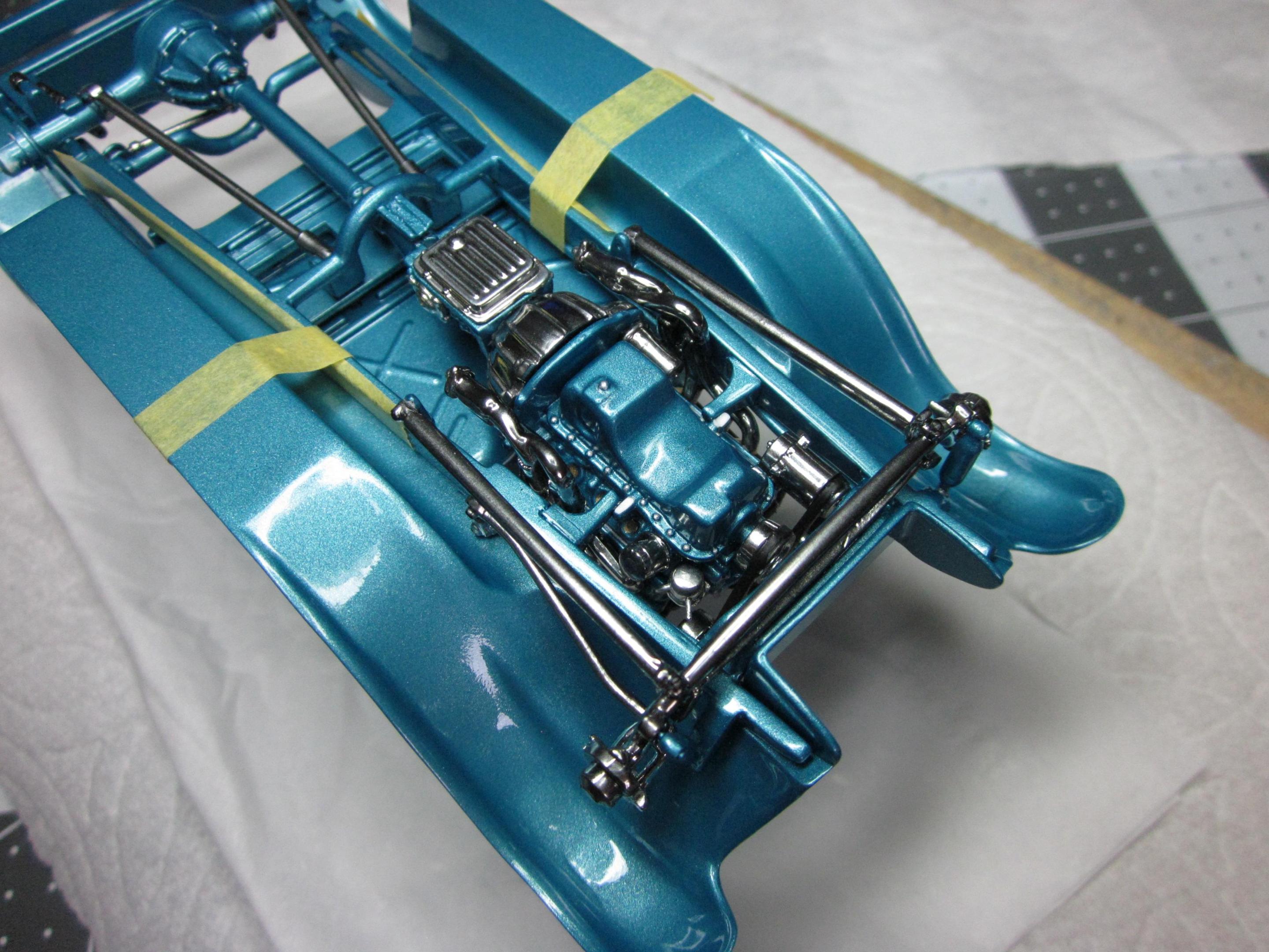

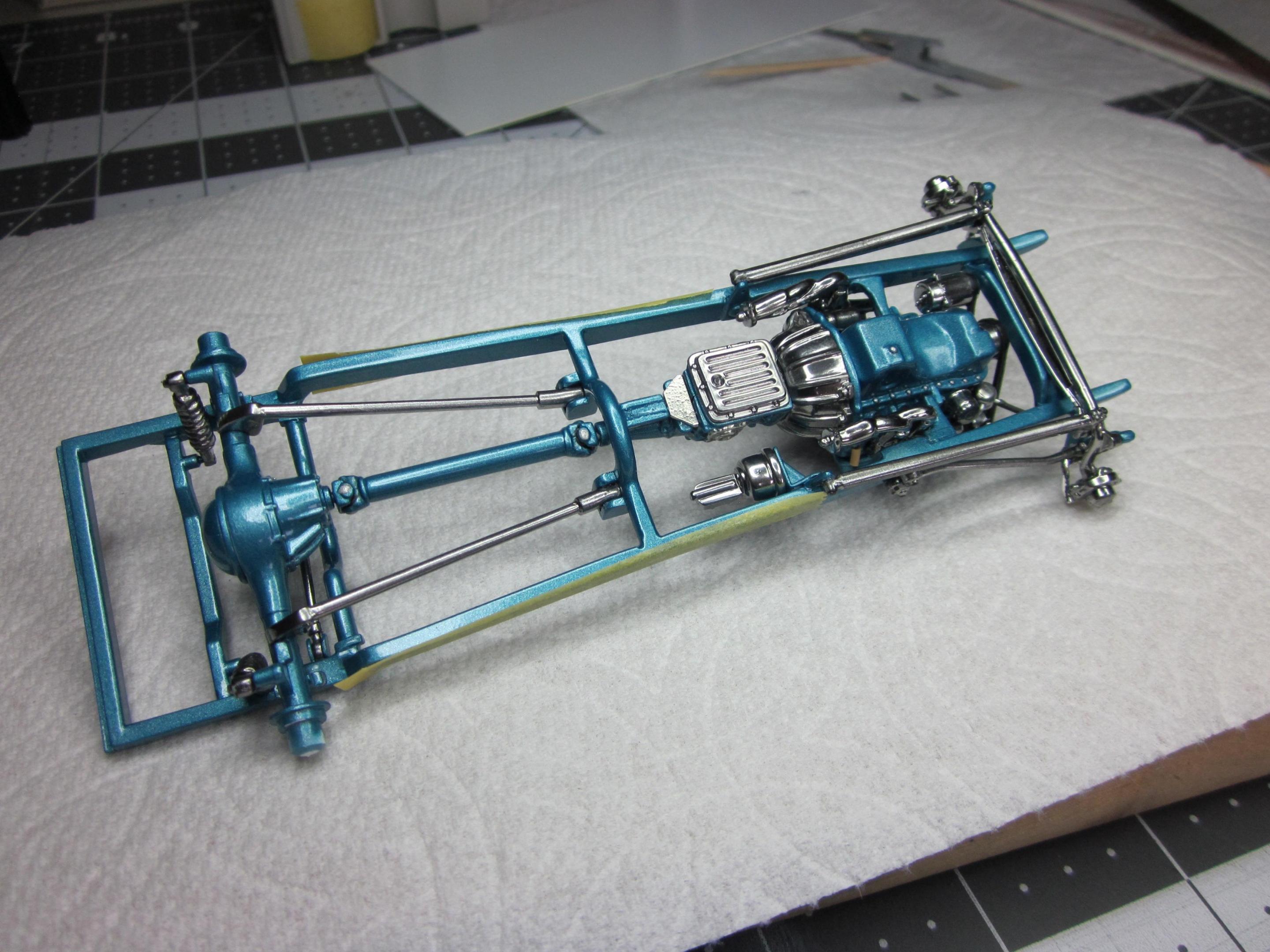

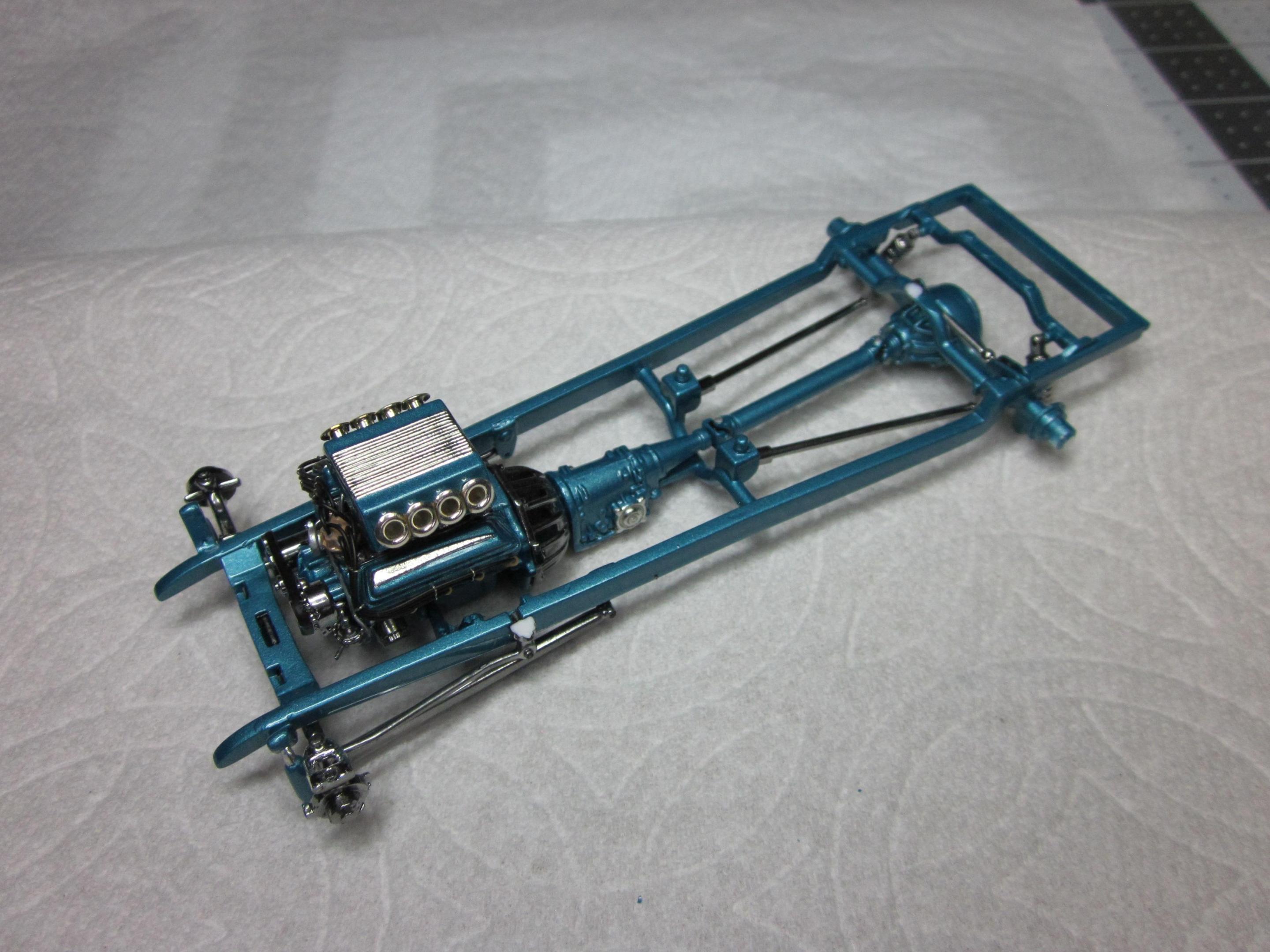

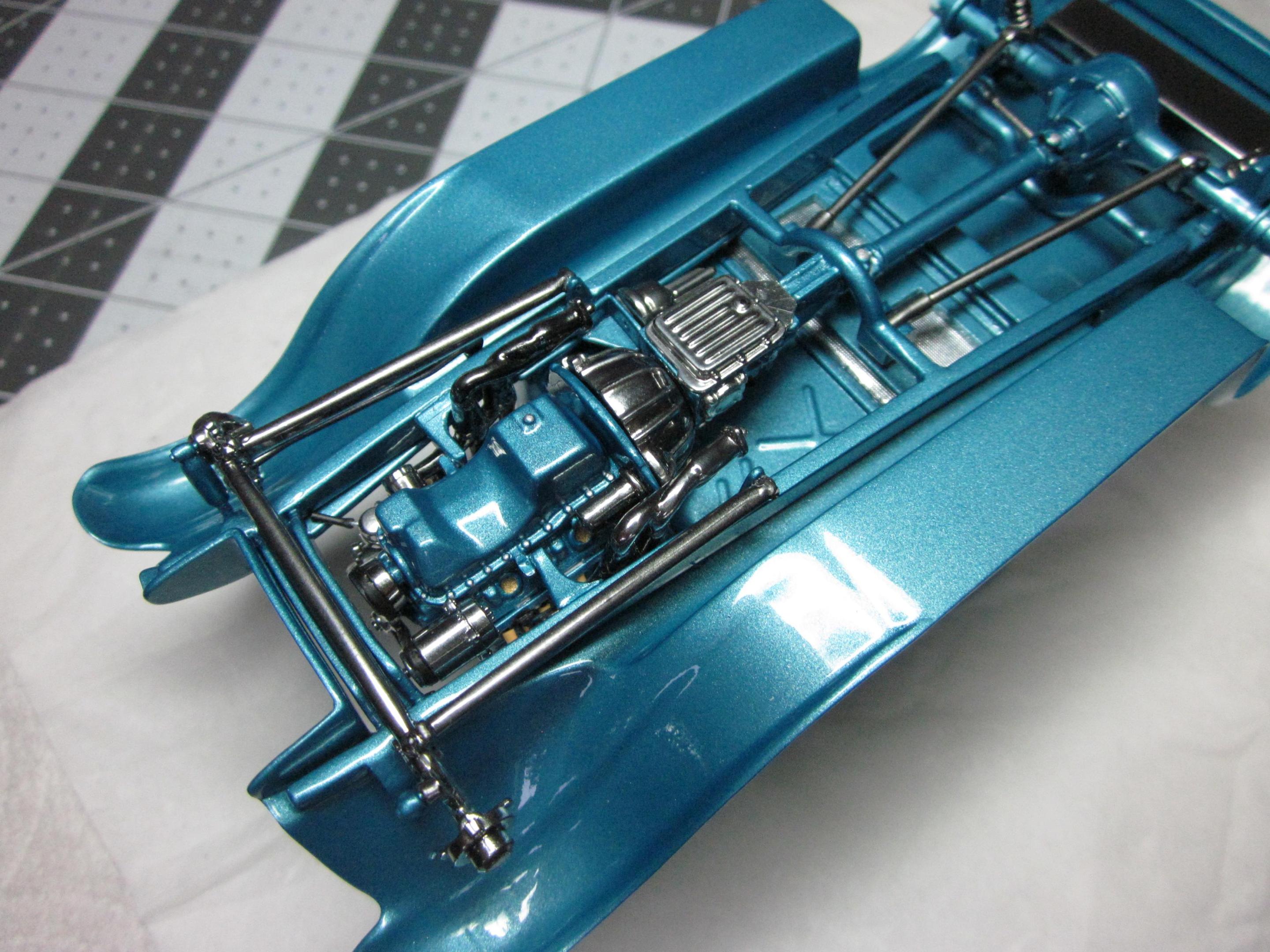

Speedpro Posted November 1, 2022 Posted November 1, 2022 (edited) Finally getting close on @Kit Karson's 29 truck that has been in the work's for almost a year now. When I left off, I had just finished correcting the engine placement in the frame so the engine would clear the firewall. But the frame needed some touchup paint done so it was masked off and I sprayed it. Also, After fiddling with some of the alcladed parts a little to much, they ended up having to be redone. Everything was mocked up to make sure things will now fit. This stuff never ends! The engine is pretty much completed. Did some plug wires and a fuel pump and line. Not much more. Put the engine in the frame. Now the exhaust can be done. Still have some touch up to do here and there. But it's coming along. Have yet to do a full mock up. Thats up to @Kit Karson. After all, It is his truck. I'm just making sure it will all go together for him. Speedpro Edited November 1, 2022 by Speedpro Remove picture 2 1

Kit Karson Posted November 1, 2022 Posted November 1, 2022 14 hours ago, Speedpro said: Finally getting close on @Kit Karson's 29 truck that has been in the work's for almost a year now. When I left off, I had just finished correcting the engine placement in the frame so the engine would clear the firewall. But the frame needed some touchup paint done so it was masked off and I sprayed it. Also, After fiddling with some of the alcladed parts a little to much, they ended up having to be redone. Everything was mocked up to make sure things will now fit. This stuff never ends! The engine is pretty much completed. Did some plug wires and a fuel pump and line. Not much more. Put the engine in the frame. Now the exhaust can be done. Still have some touch up to do here and there. But it's coming along. Have yet to do a full mock up. Thats up to @Kit Karson. After all, It is his truck. I'm just making sure it will all go together for him. Speedpro Thank you so much for every little detail that you covered making this beautiful work of art that you've collaborated on with me. I know and only a very few know that this is not our first joint venture! It was even mentioned to @tim boyd shortly after you took the truck back to the master's bench and paint shop. One-to-one builders have their vehicles painted by someone they totally trust. And, Brother you have done a masterful job on our Tribute PU! -KK
Dennis Lacy Posted November 13, 2022 Author Posted November 13, 2022 @Speedpro Wow, the engine and chassis look fantastic! I especially like the chrome scallop on the valve cover. That’s a nice touch. KK @Kit Karson should be plenty happy with what you’ve done. 1
tim boyd Posted November 14, 2022 Posted November 14, 2022 6 hours ago, Dennis Lacy said: @Speedpro Wow, the engine and chassis look fantastic! I especially like the chrome scallop on the valve cover. That’s a nice touch. KK @Kit Karson should be plenty happy with what you’ve done. Agree! TB 1 1
Kit Karson Posted November 14, 2022 Posted November 14, 2022 20 hours ago, Dennis Lacy said: @Speedpro Wow, the engine and chassis look fantastic! I especially like the chrome scallop on the valve cover. That’s a nice touch. KK @Kit Karson should be plenty happy with what you’ve done. 14 hours ago, tim boyd said: Agree! TB Actually, the chrome scallop on the valve cover is all @Speedpro! Did you know that Paul restored this several years ago:

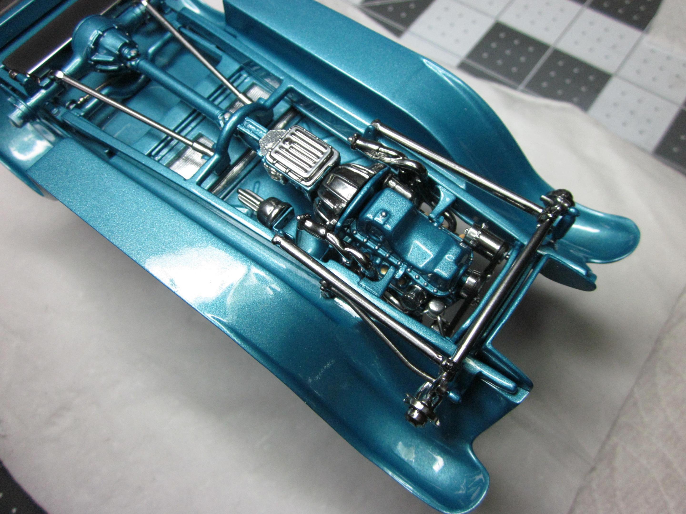

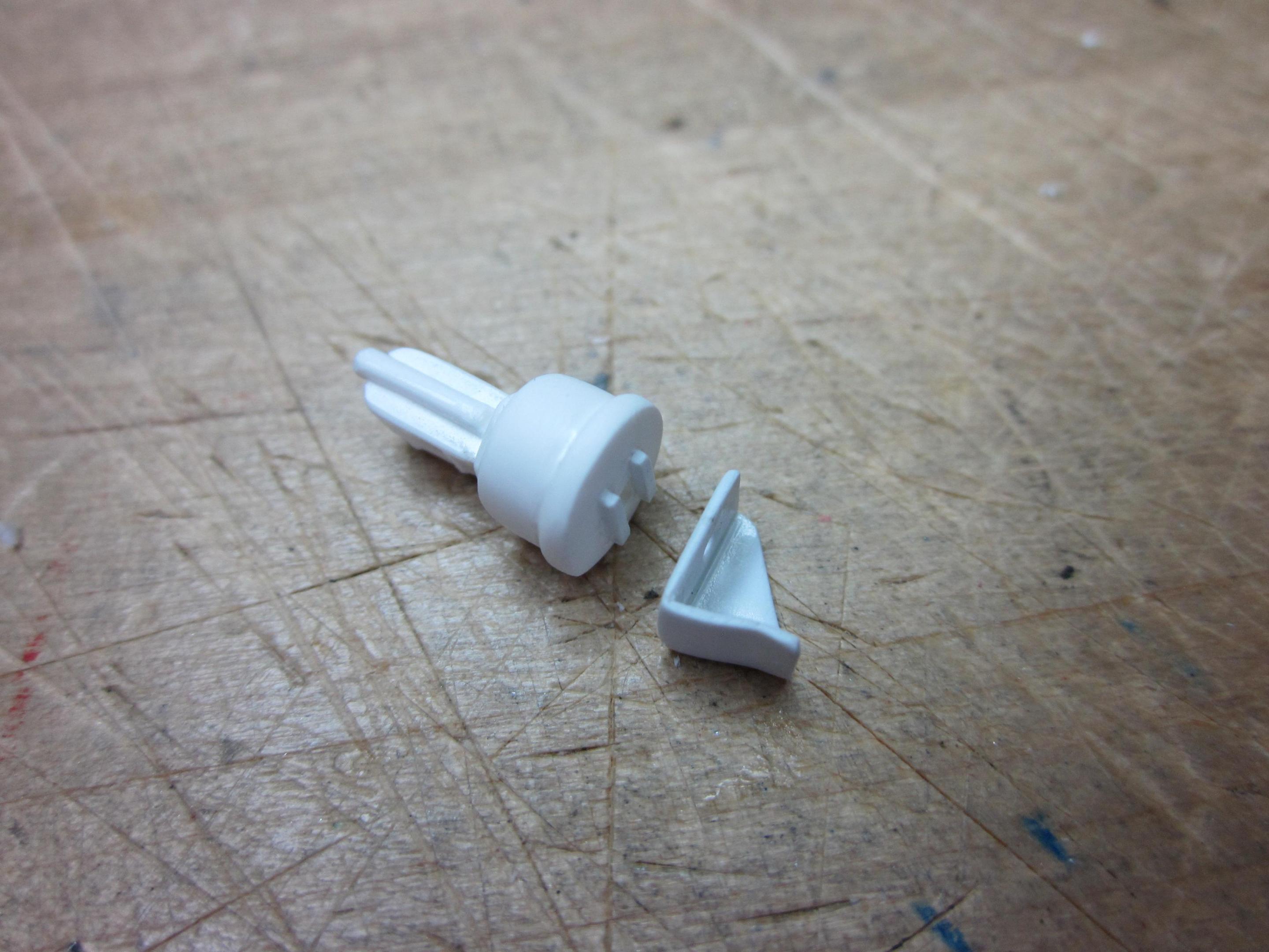

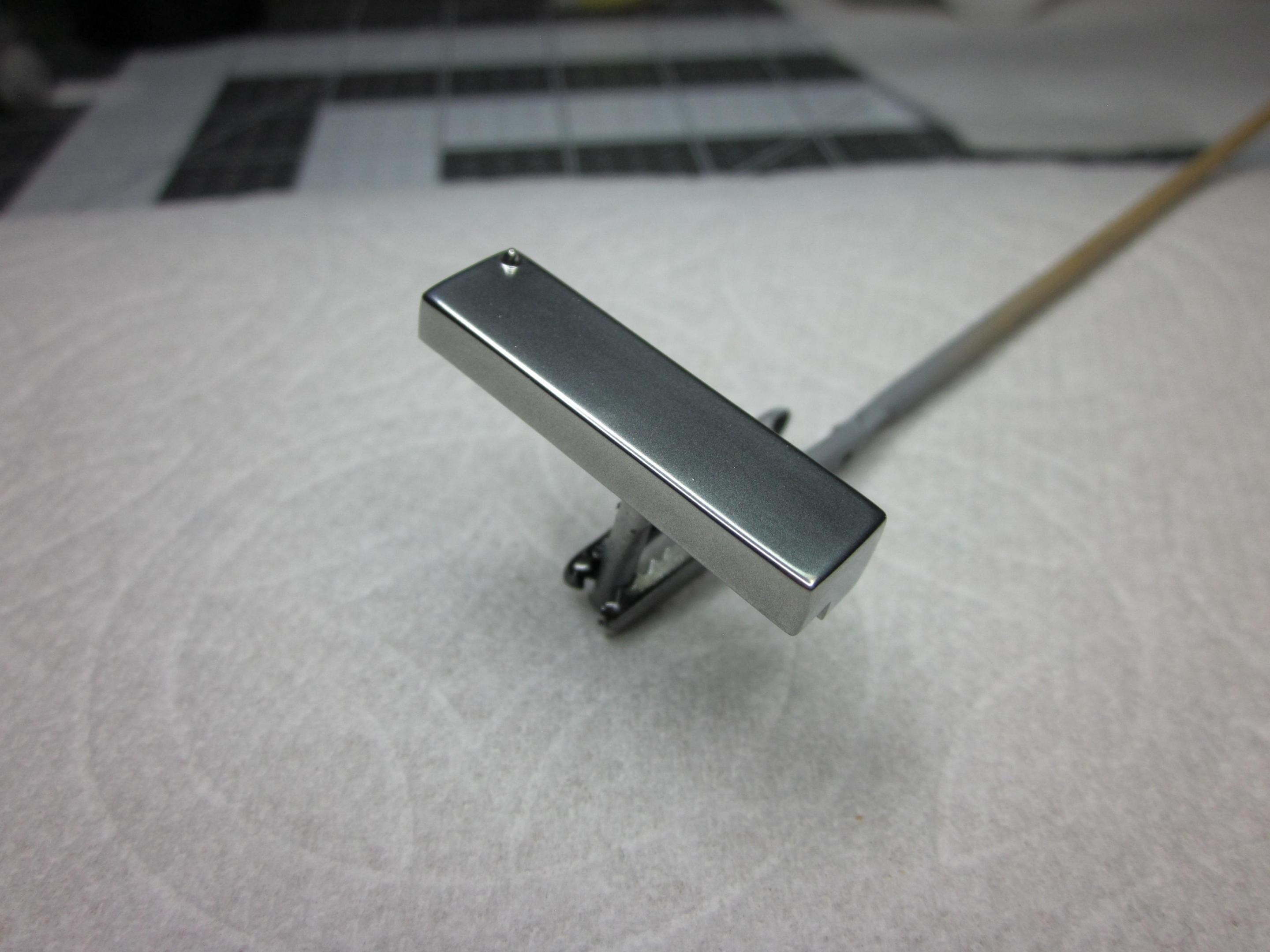

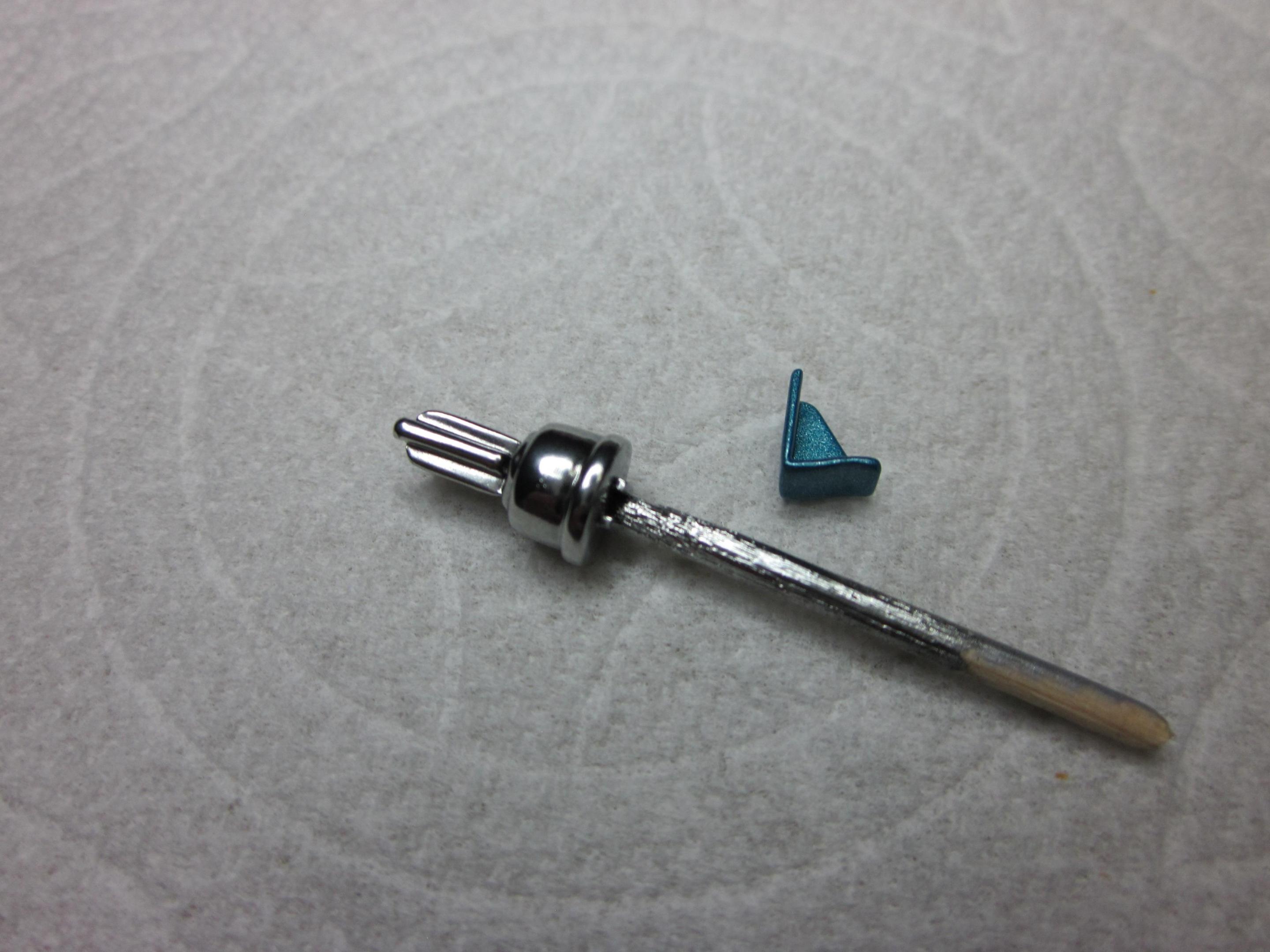

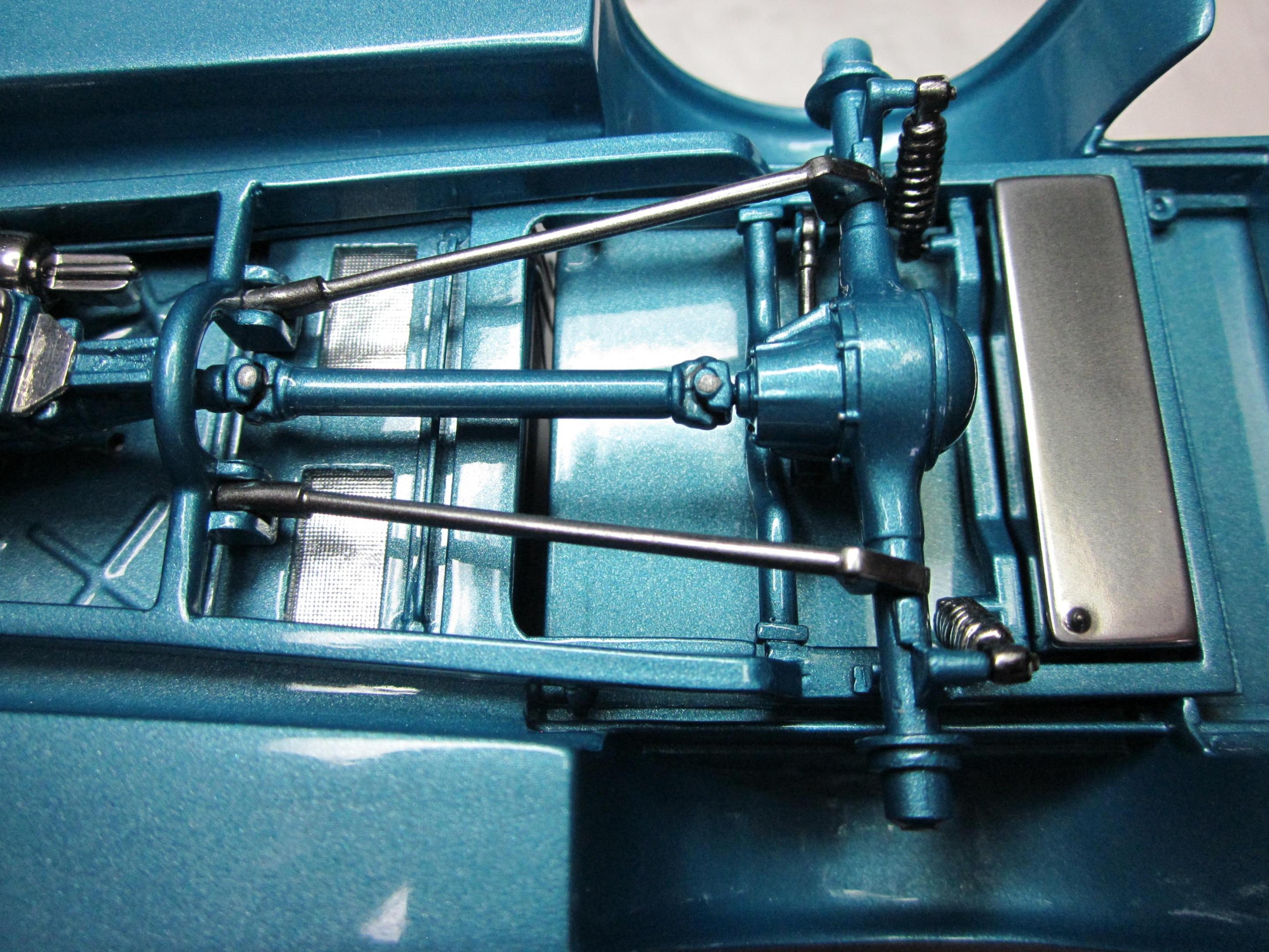

Speedpro Posted November 15, 2022 Posted November 15, 2022 Just a small update on @Kit Karson's truck. Got the headers in place. Was going to get after the exhaust but realized there was a couple things that needed to be done before that could be done. First it needed to have a brake booster and master cylinder. I'm going to use the booster that was sent with the truck. A mount was made to mount it to the frame. It was painted the same color as the frame and the booster was sprayed with alclad chrome. Next up was the fuel tank. After figuring out where it was to be going, One was built out of some sheet styrn and fit with a drain made out of a steering column shift handle. It was also sprayed with alclad. Another thing that needed to be done was the headlamps. Decided to paint them body color. The chrome was stripped and shot some paint on that part. After the tank and booster assembly are installed I can start on the exhaust. Thats it for now. Getting close but I'm sure that I'll find more. Speedpro 1
Modelbuilder Mark Posted November 16, 2022 Posted November 16, 2022 3 hours ago, Speedpro said: Just a small update on @Kit Karson's truck. Got the headers in place. Was going to get after the exhaust but realized there was a couple things that needed to be done before that could be done. First it needed to have a brake booster and master cylinder. I'm going to use the booster that was sent with the truck. A mount was made to mount it to the frame. It was painted the same color as the frame and the booster was sprayed with alclad chrome. Next up was the fuel tank. After figuring out where it was to be going, One was built out of some sheet styrn and fit with a drain made out of a steering column shift handle. It was also sprayed with alclad. Another thing that needed to be done was the headlamps. Decided to paint them body color. The chrome was stripped and shot some paint on that part. After the tank and booster assembly are installed I can start on the exhaust. Thats it for now. Getting close but I'm sure that I'll find more. Speedpro This project is gorgeous. 1 1
slusher Posted November 16, 2022 Posted November 16, 2022 Very impressive work on this build! Every thing looks so perfect! 1

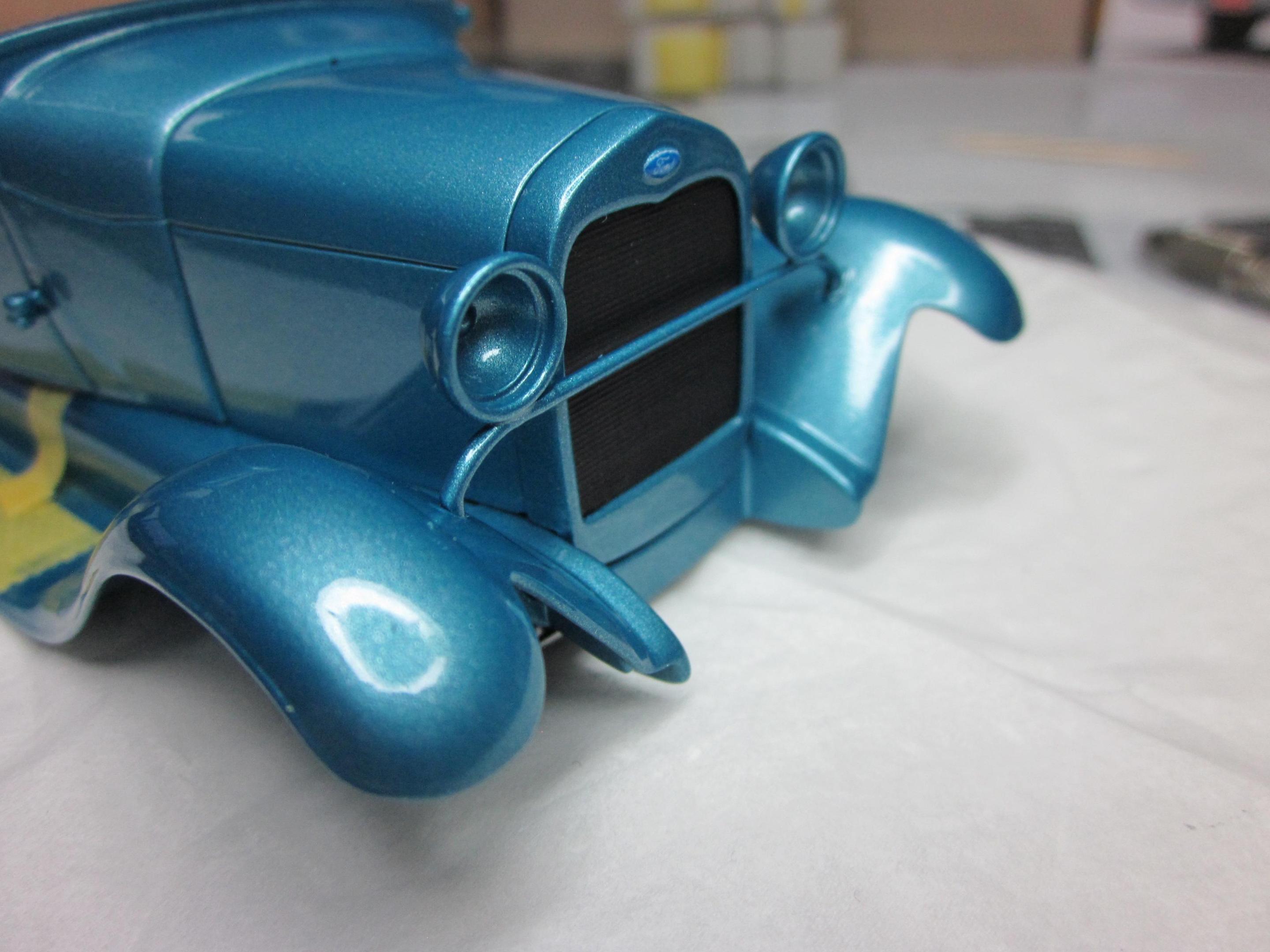

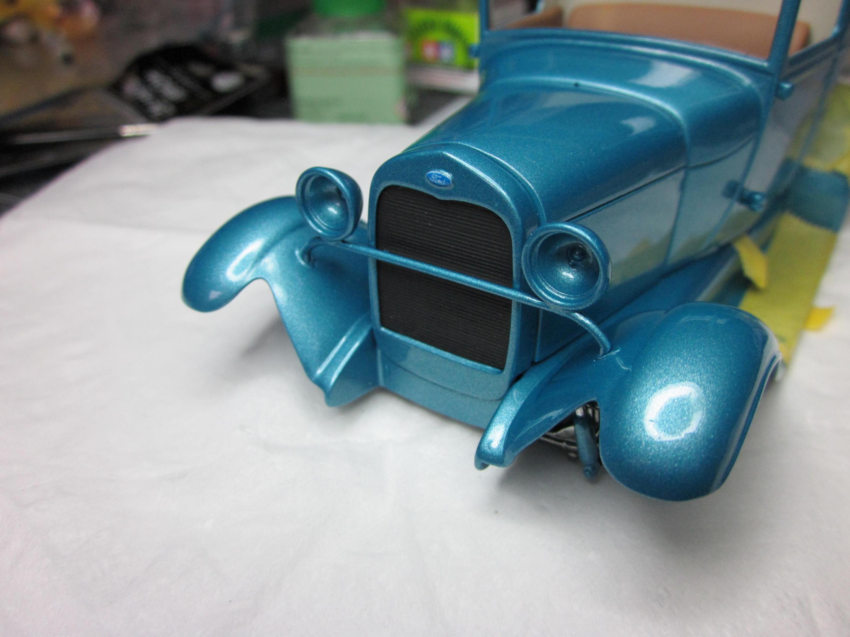

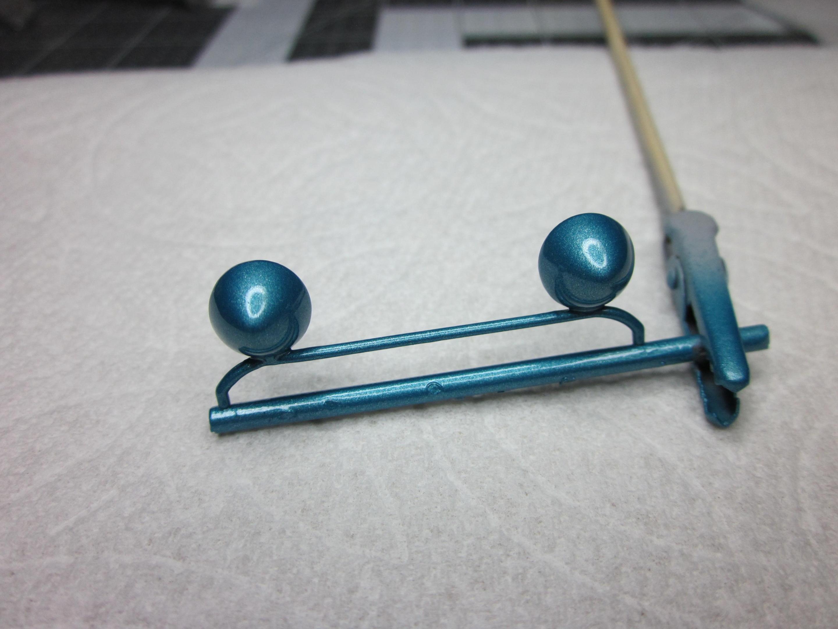

Speedpro Posted November 17, 2022 Posted November 17, 2022 Today was a good day. I was able to finish up a few things on the chassis and drive train on @Kit Karson's truck. Got the brake booster installed, Did some touchup painting(3 things), Test fit the painted headlamps and mocked it up with the gas tank. Another thing I worked on was the bottom side of the cab. I recently was looking at @Dennis Lacy's roadster pickup build and thought what a great idea he had filling in the two square holes on the bottom of the bucket. I was thinking to myself, I should have done that! But then it turned into "What can I do" to fix those two square holes in the bottom of the cab of this truck. So what I did was pretty simple. Using a piece of foil from a cigarette pack, I cut a piece to fit between the cab and the chassis. I brush on some clear tamiya paint to glue it down with. The foil has a perforation to it that resembles heat sheilding. Worked perfect. Thank you @Dennis Lacy for the inspiration to work on that area. Everything is done and it's ready to get the exhaust(which I have no idea what to do yet) going. Here is a few photo's.................. Speedpro 1
Dennis Lacy Posted November 17, 2022 Author Posted November 17, 2022 @speedpro For a lack of words I’ll just leave this emoji here. ?
foghorn62 Posted November 17, 2022 Posted November 17, 2022 A masterpiece developing! I just love the contrast between the body color parts and the metalized parts! Photographs well, and looks almost surrealistic. Very nice! TS
tim boyd Posted November 18, 2022 Posted November 18, 2022 So clean, so clever, so spectacular.....TB
