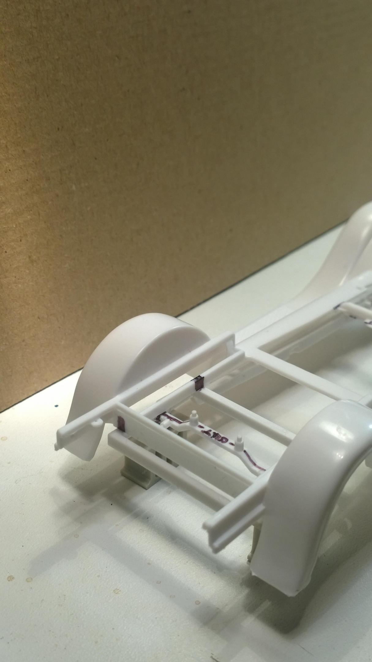

2107065211_A77Fame-ChassisMarkedforDe-Constructiong.jpg.f401d28f4115e32f6bbbc5d4dc544373.jpg
77 Fame-Chassis Marked for De-Construction
1428567730_B51FendersMarkedforDe-Constructiond.thumb.jpg.f739ca3ea2ba56b6416debf23428d865.jpg
77 Fame-Chassis Marked for De-Construction & 51 Fenders Marked for De-Construction
1683908900_B51FendersMarkedforDe-Constructionh.thumb.jpg.2a8849b0db919312c38db6a491db684a.jpg
849815570_B51FendersMarkedforDe-Constructionj.jpg.a34baed3f649133edd4a106454a01005.jpg
1212111595_B51FendersMarkedforDe-Constructionk.jpg.2c47e78578b4db43e94bf4f946fecd5c.jpg
Each BLACK mark and parts marked OUT & REMOVE are then scribed with the actual "cut line".  Cutting decisions are made on a "Leave" the line and "Take" the line basis.  Always taking into consideration the width of the knife/saw blade; the cut line may be be inside the cut line or outside of the cut line. Deciding to leave or take the line depends on how much material is to be removed or cut off.  @Rocking Rodney Rat will say, "I measured it once and cut it twice and it's still too short!"  Measure twice and cut once!  Cut long and file or sand to length has always worked in craftmanship and modeling. It's always easier to take a little more off that to have to add a little back on! (Or is it?) -KK

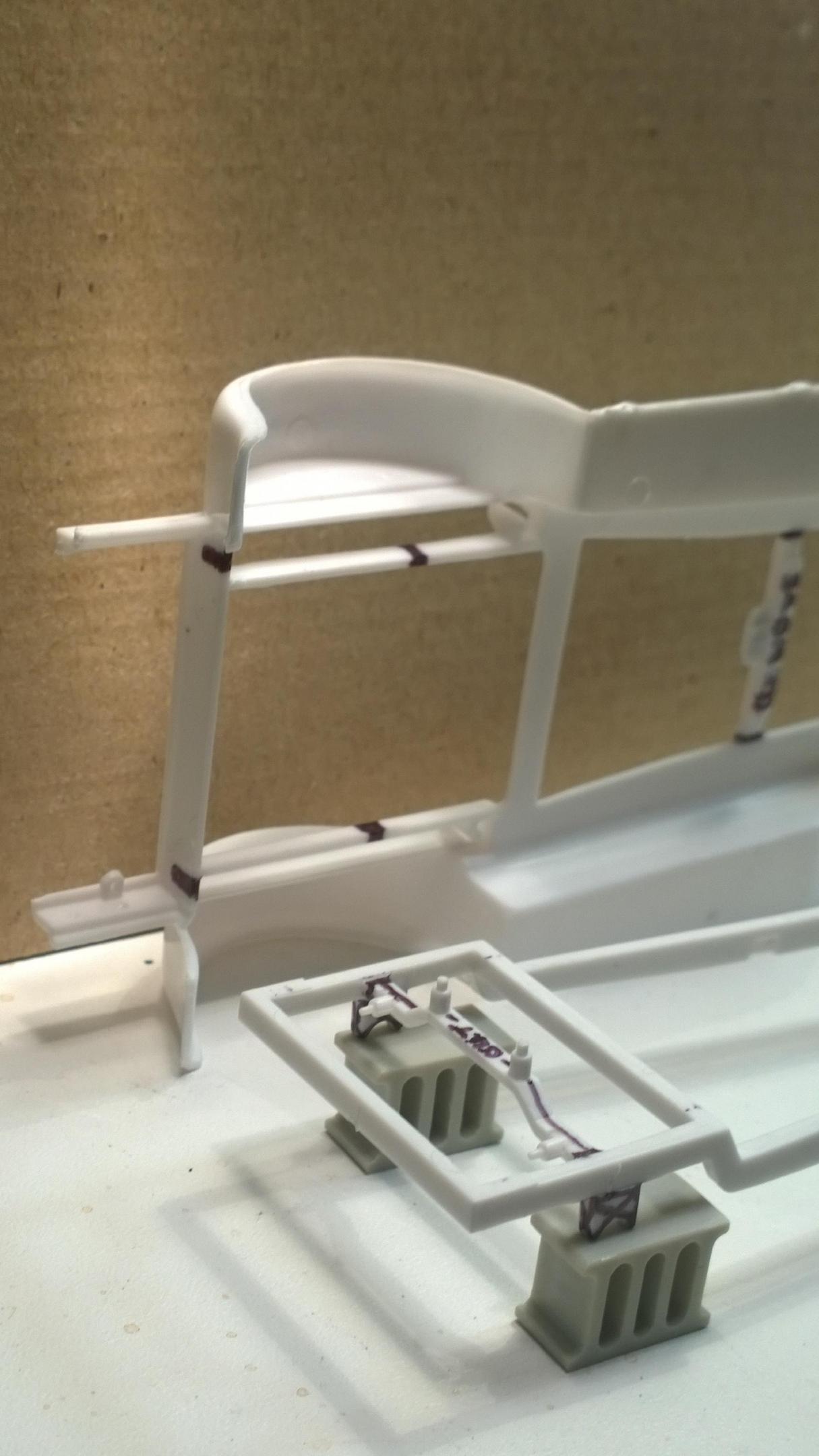

Time to start cutting!
Removed the coil-over spreader bar...
Cut off the solid axle mounts...
on both sides of the frame...
Trim with a #11 blade...
Easy enough!?.
Now to tie the frame and fenders together so as to secure them enough to scribe the cut-lines...
Used a strip of tape to hold the back together...
and the front end, too...
Note where the frame crosses over the blacked out marks...
Scribe in the blacked out areas where the cut-lines are going to show where material will be removed...
Cut away the blacked out area from the inner rail...
on both sides, not cutting all the way through with the saw...
Finish trimming with a #11 blade...
on both sides...1220445974_H51FentersCuttingg.jpg.caf9c19567d9f9c30d53ccdf9b107bd6.jpg
Here where the decision to "Leave" the line or "Take" the line... in this case removing everything between the scribed cut-lines, "Leave" the line!
Cutting out the relief in the back valance... again, "Leave" the line...
Cut up to the scribed line, but not passed it...
on both sides...
Use a #11 blade to slice between the cut-lines...
With a little cleaning; enough to knock the burrs off... the '29 Roadster Frame and the '29 Pickup Fenders will press/snap together!
77 Frame-Chassis & 51 Fenders fit together like they were made for each other!
Neat? Huh? You can imagine how excited I was when I first noticed the commonality between these two kit parts!! '29 Roadster (77) Frame-Chassis under the '29 Pickup (51) Fenders
Nice tight fit, because enough material was left in the cut-out areas... that with a little filing and sanding they come together as planned!
Notice how the '29 Roadster kit Z'd frame cleans up... where @Dennis Lacy and @Rocking Rodney Rat had to manufacture their Z'd frames, easier? Yup! -KK

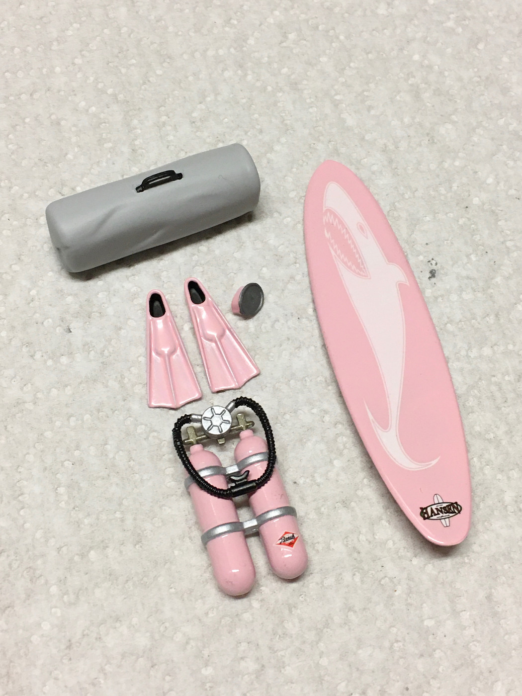

Here's all the surf junk for the bed detailed out. A bunch of tedious steps masking and painting the scuba tanks! RRR suggested off-site that I should add a strap to the goggle so I'm contemplating that. The board and shark decal are from Revell's 37/38 Ford Pickup while the rest is from Monogram's "Blue Bandito" '29 Roadster Pickup retro release.

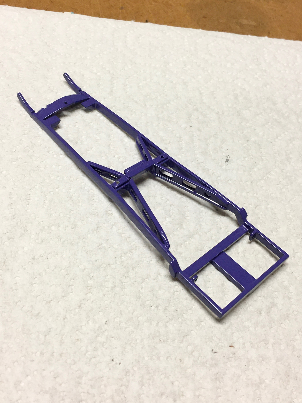

Frame is finished purple and clear coated.

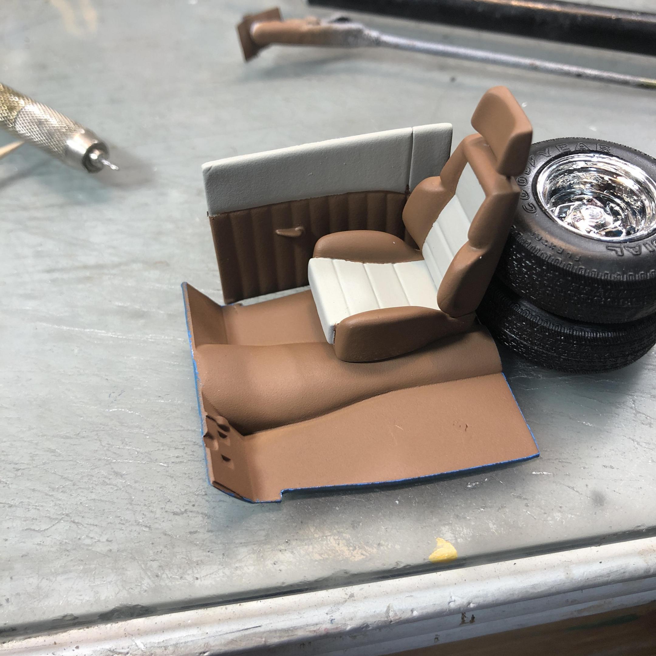

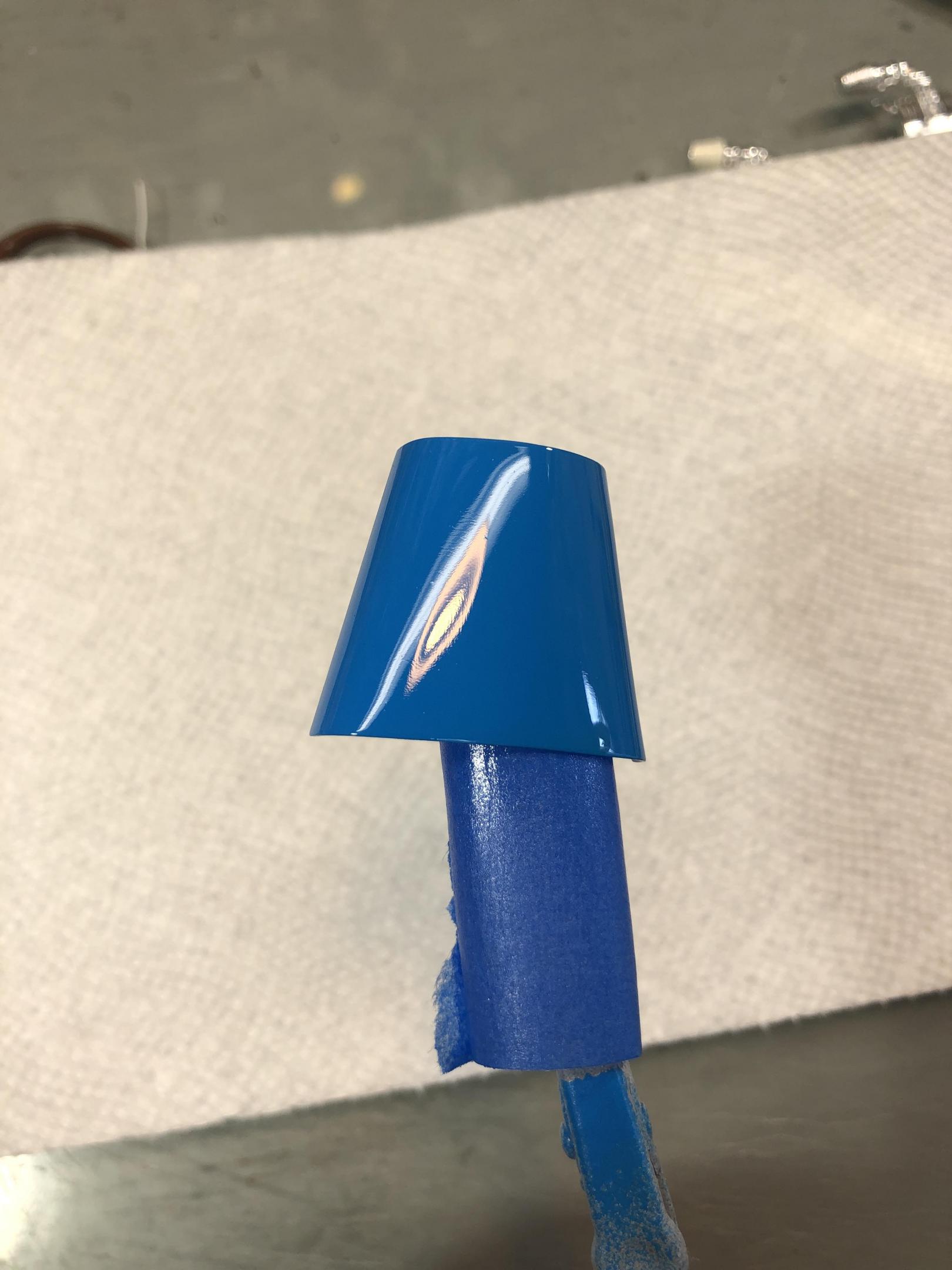

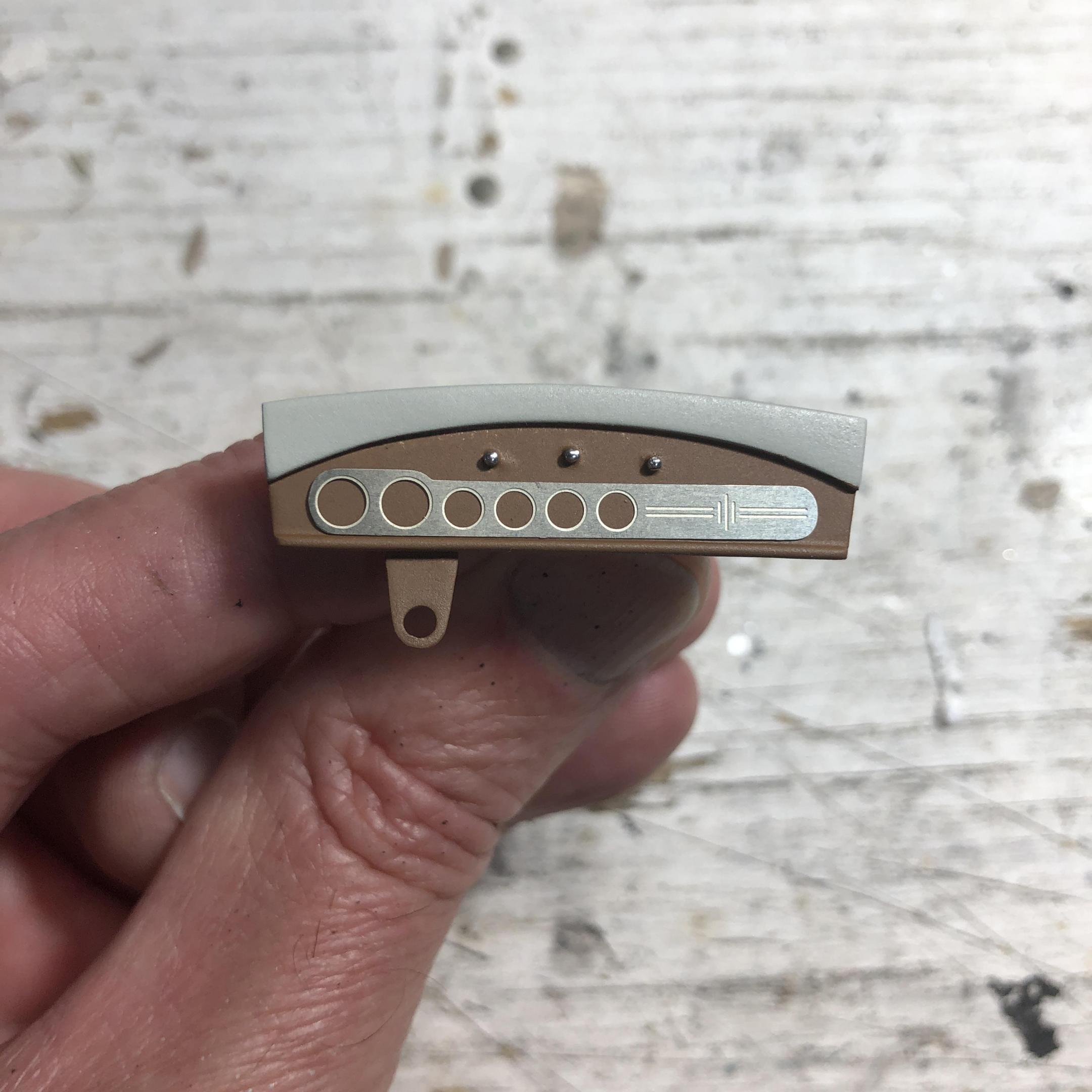

Lest anyone thinks I'm not hard at work on my version of the truck, I'm in paint mode. here's a few sneak peeks of what I've been up to....
I fabricated my own dash after I was considering the dash from the AMT '34 Ford. I decided to use some of the photo-etched parts I have that I hardly ever use. The gauge panel is from Model Car Garage, the gauge inset panel will be added soon.
Door panels are from the AMT Phantom Vickie [sic] with parts box seats.
Here's the hood, in Tamiya Light Blue. It's BRIGHT!! Just like they used to do.... -RRR

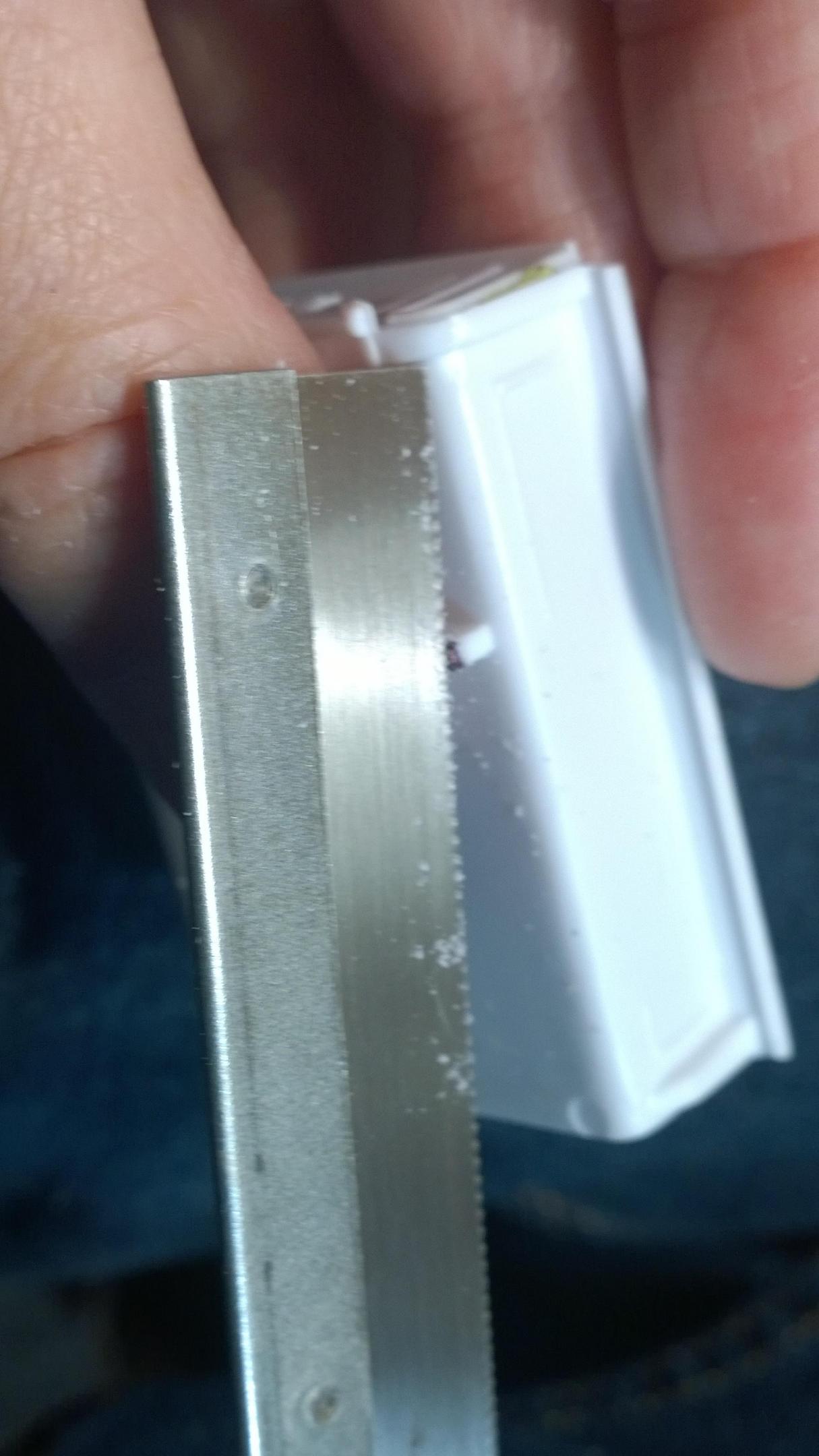

Dragging the #11 blade chisels a fine line removing material about as wide as a fine marker ink line.
