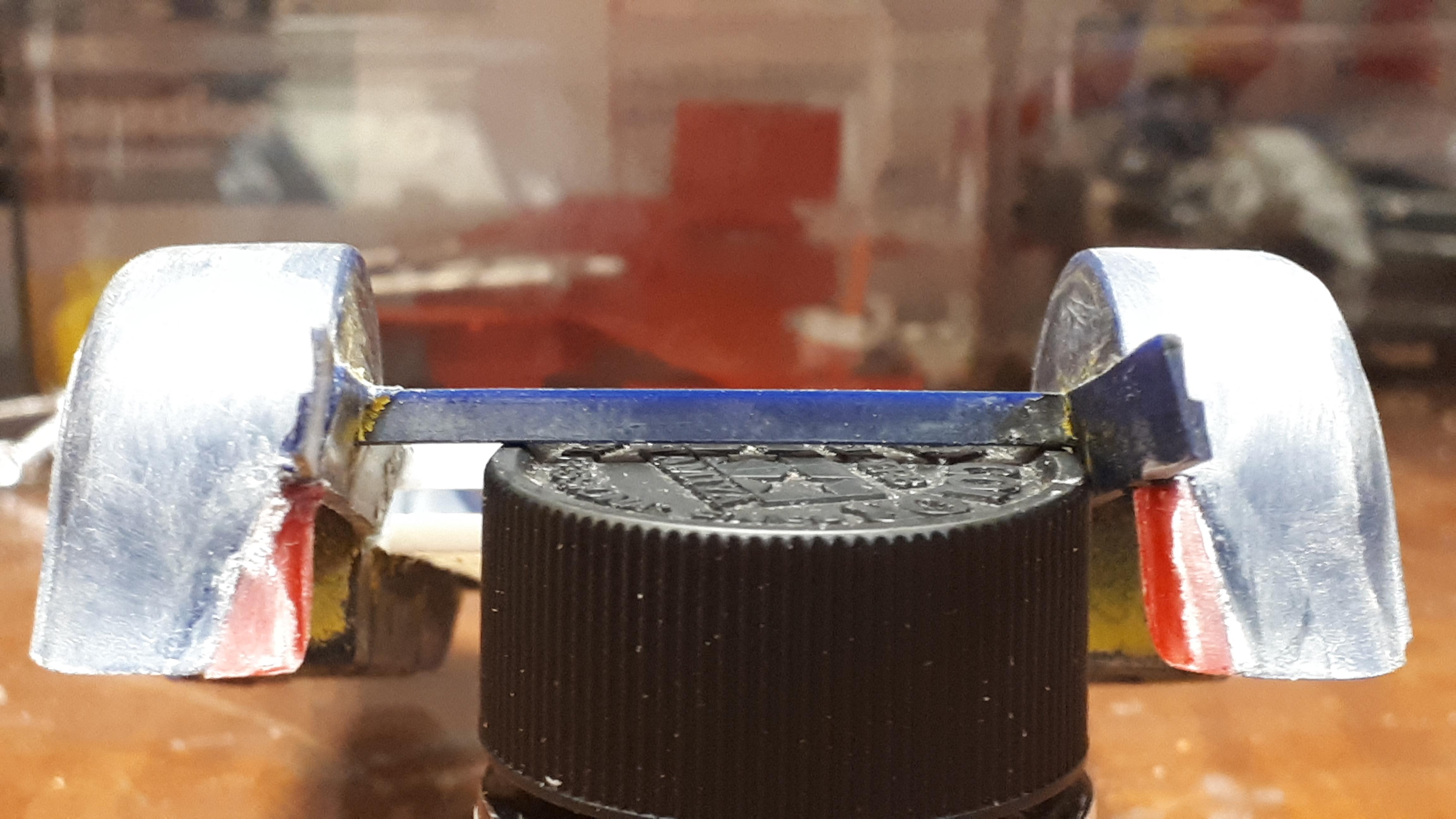

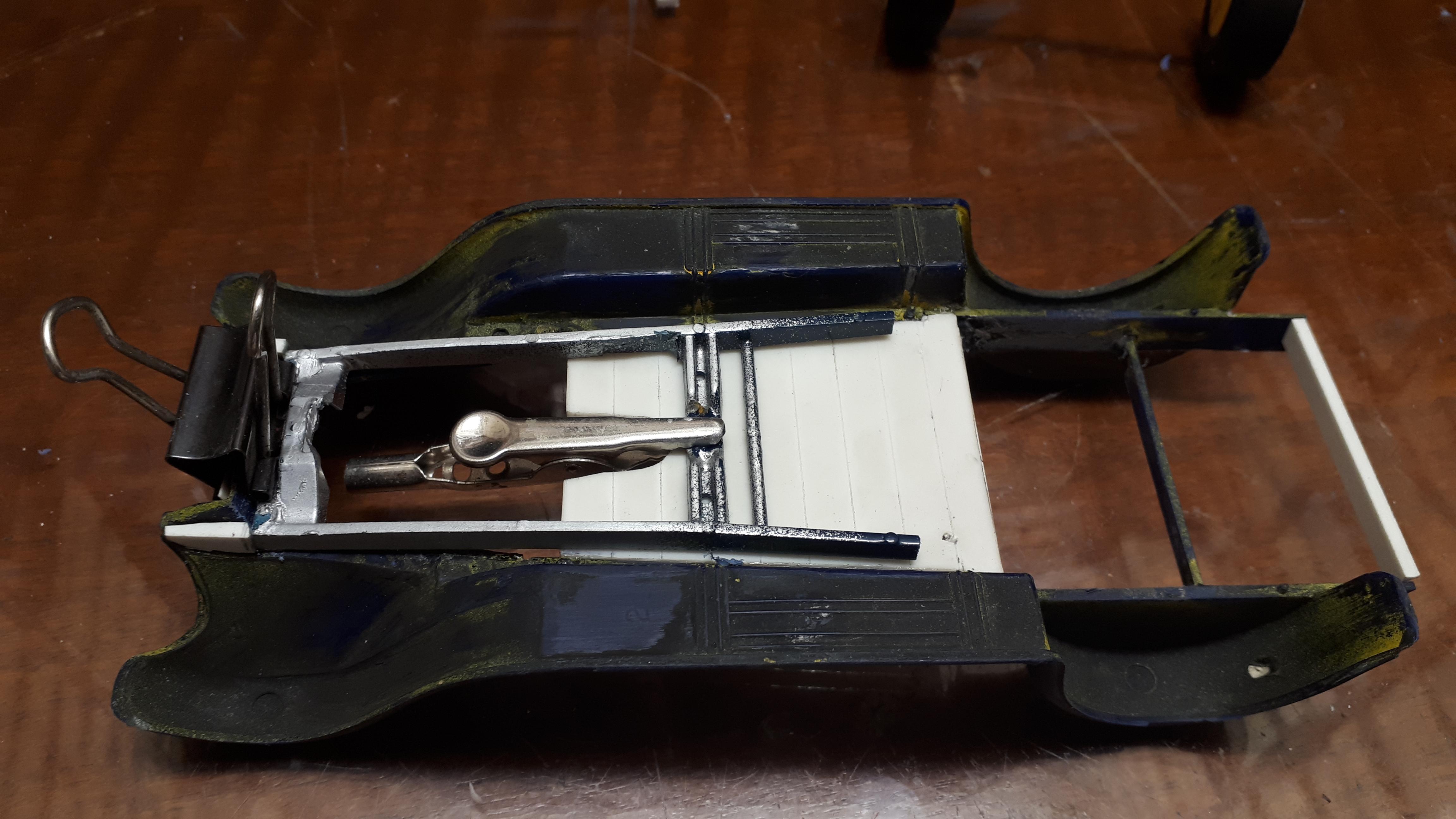

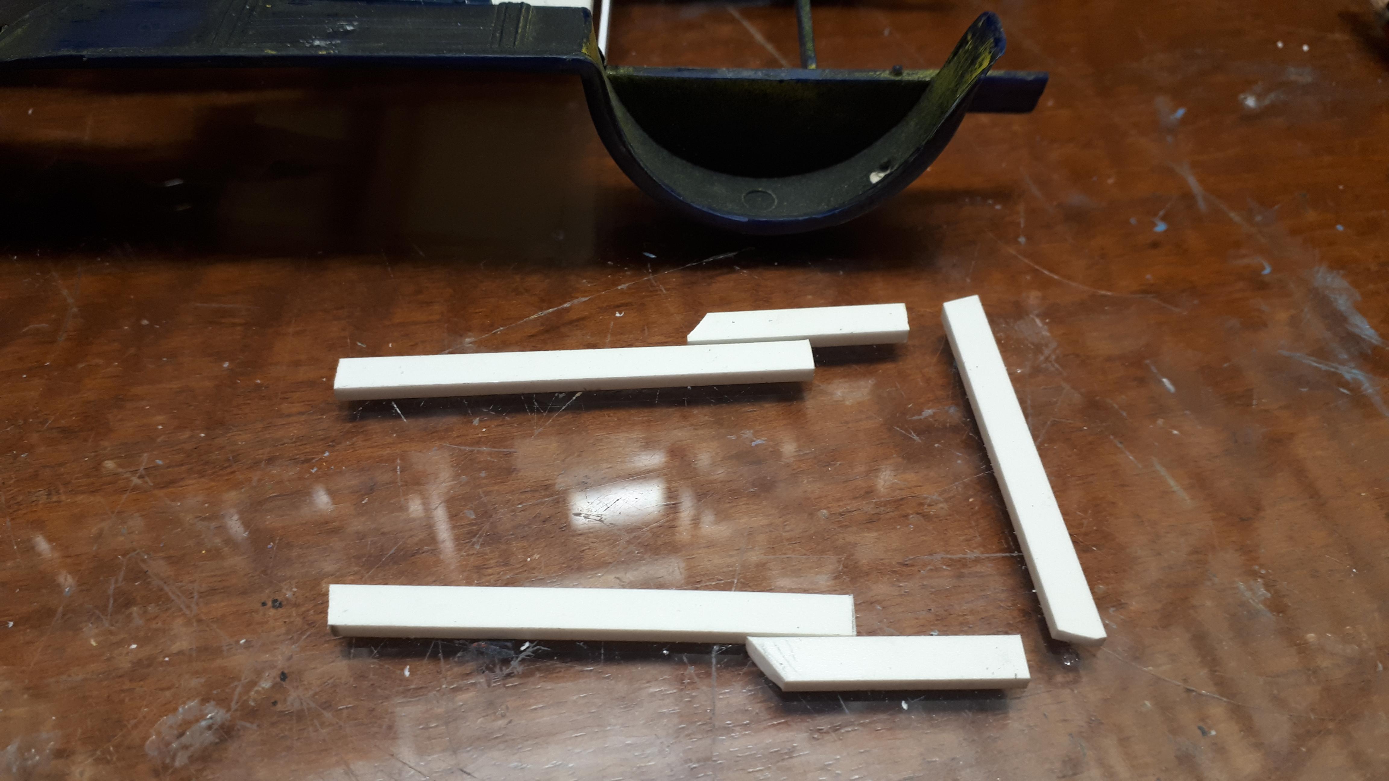

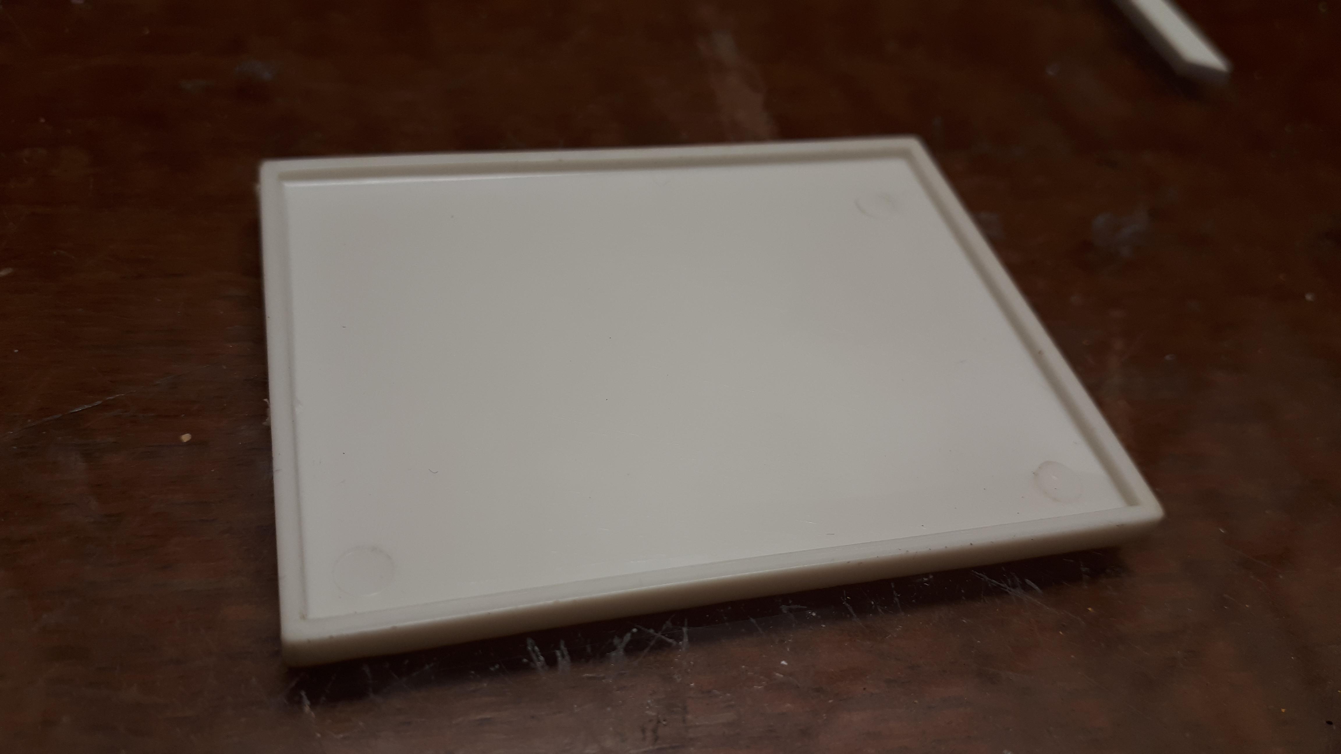

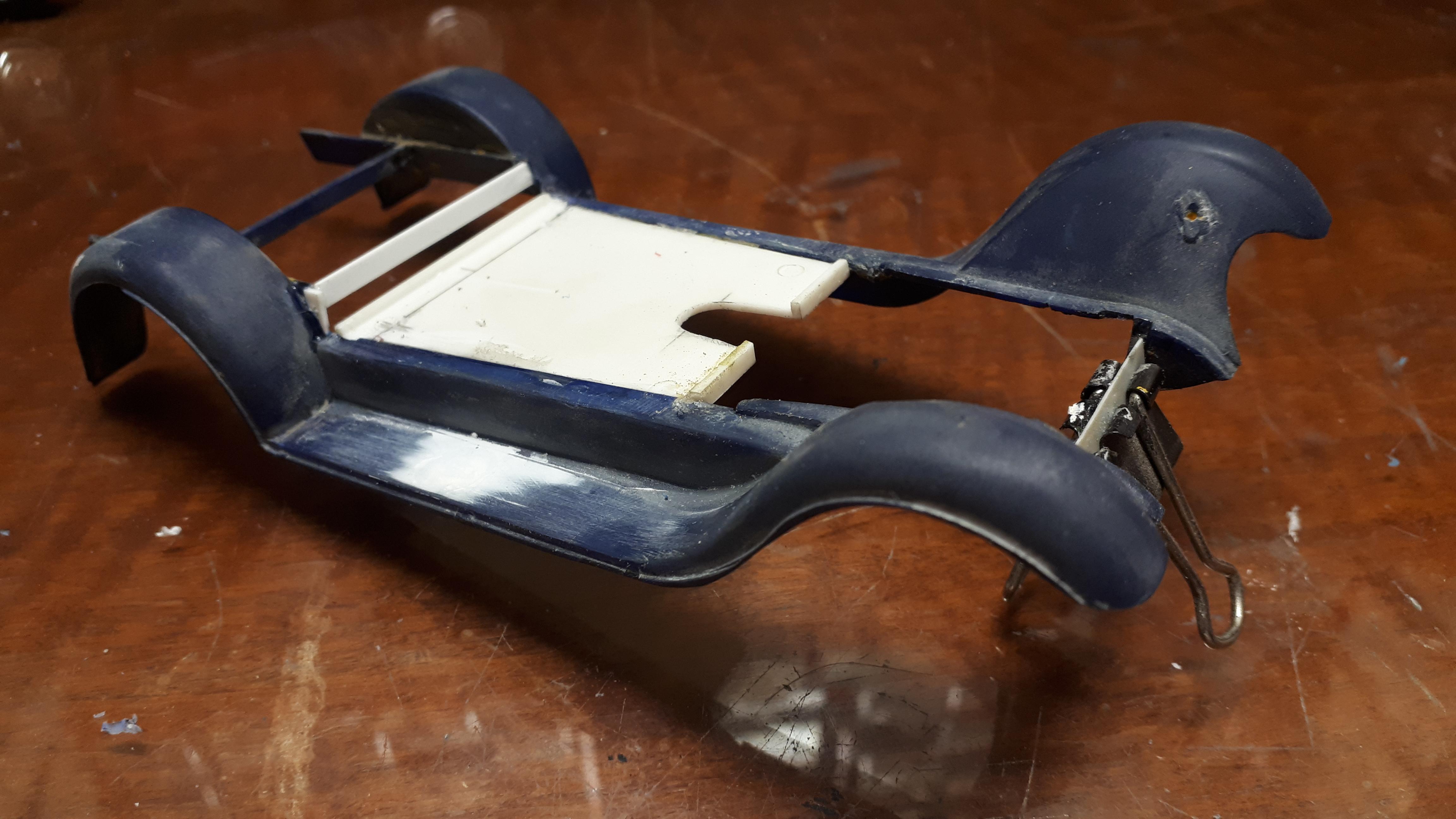

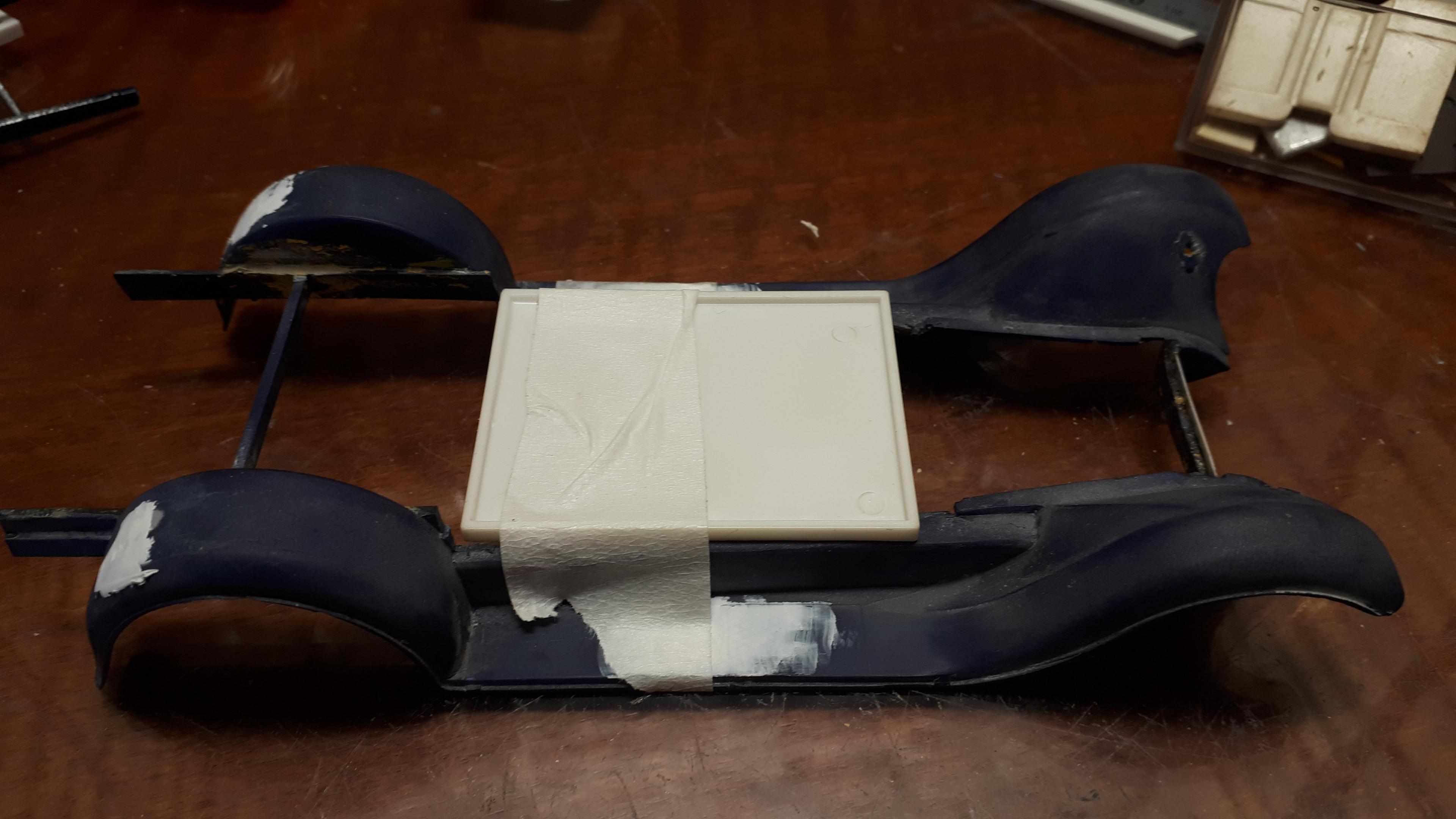

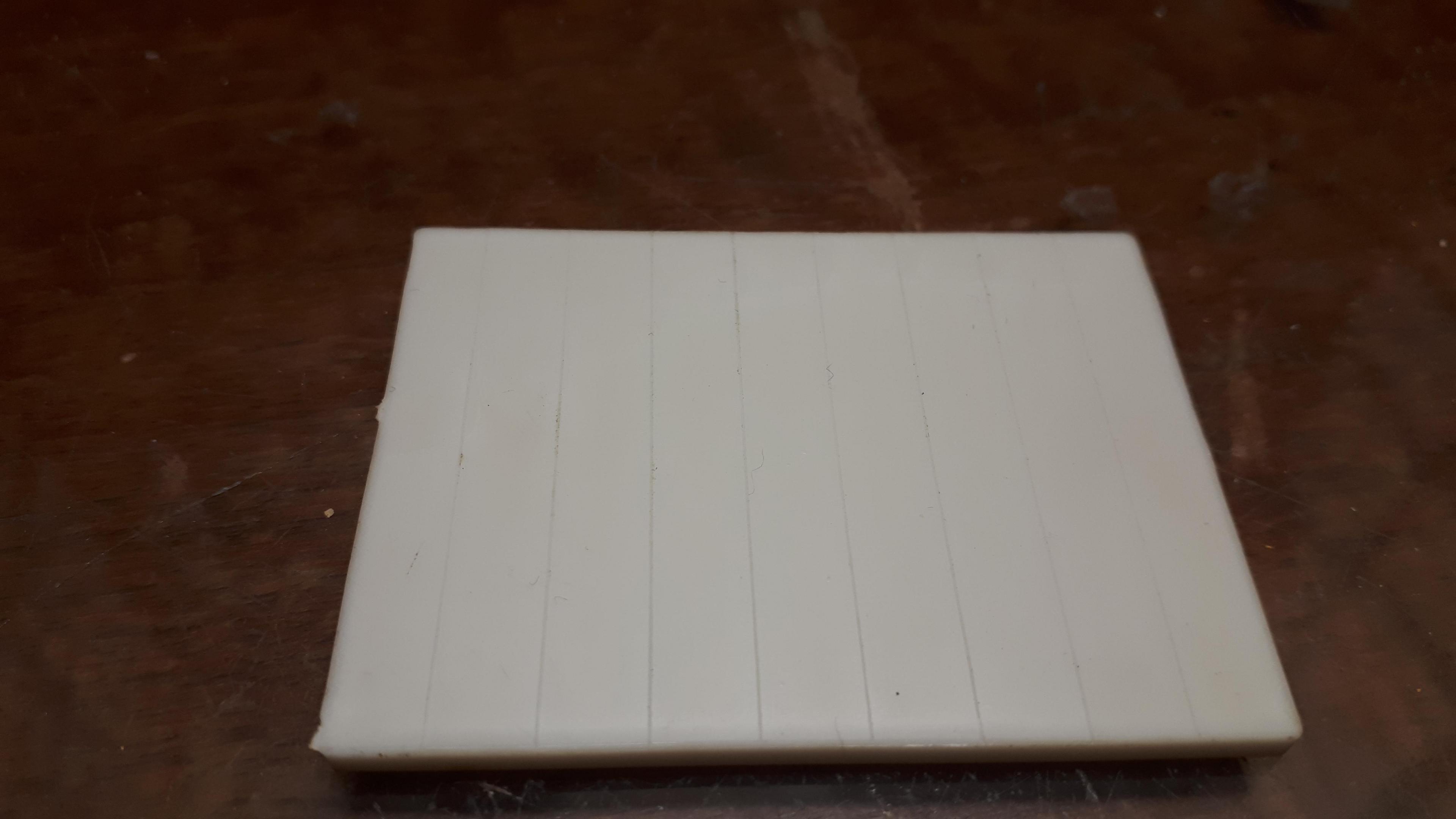

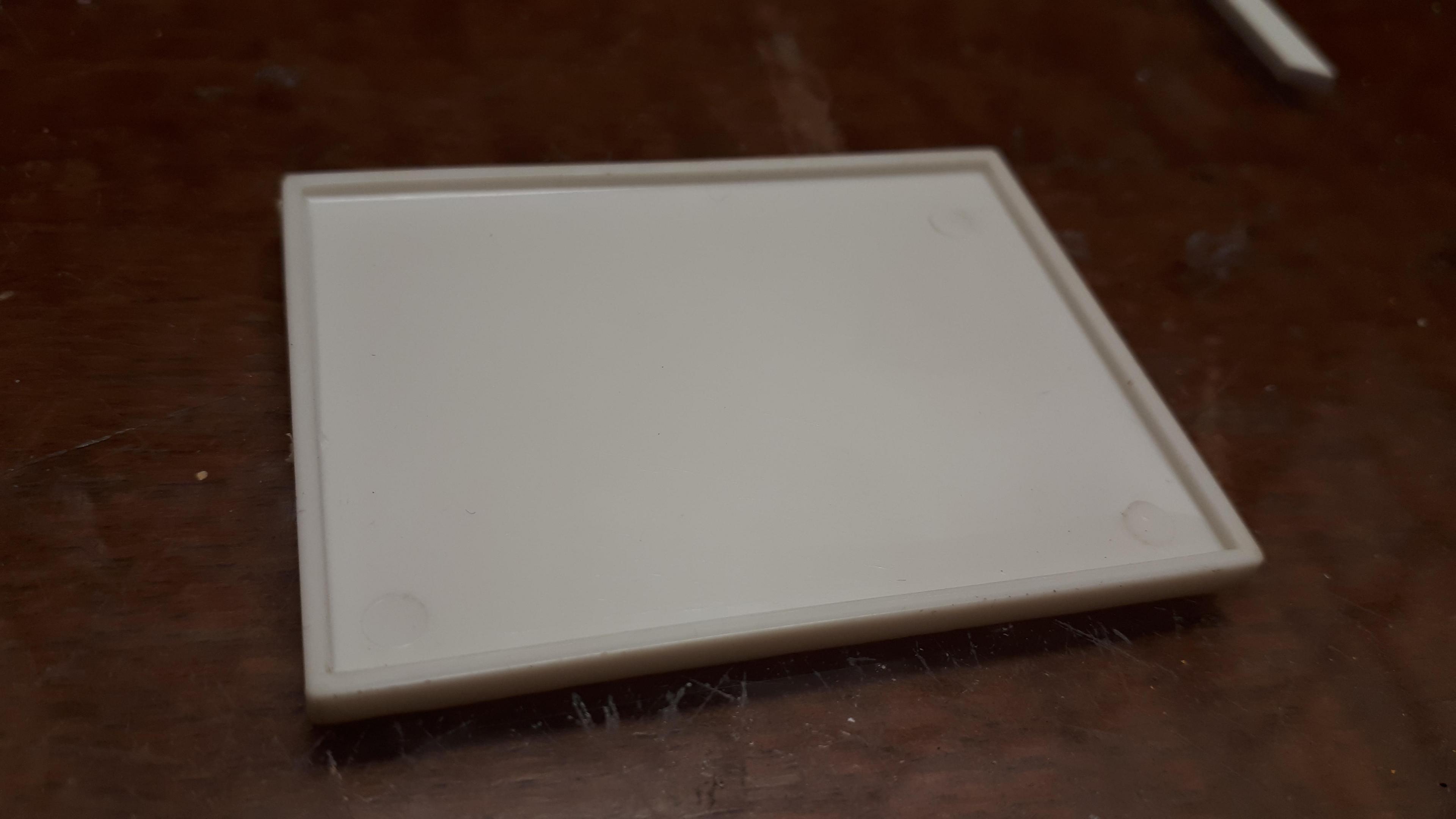

alan barton Posted March 3, 2021 Share Posted March 3, 2021 Looks like I'm making things happen! Lots of sawing, filing and sanding going on so I am doing other projects in between while various parts set up. After stripping the paint, I had to laminate a very thin piece of styrene across the front of the splash apron to repair an ancient break through the middle. I then wanted to get a solid floor in place because that ancient Bandai dark blue plastic was pretty floppy, yet brittle at the same time! I found this rectangular panel with raised lines across it. I consider myself fairly good at identifying oddball parts but I have no idea where this one came from. Was it a door, a floor panel, who knows? Anyhow, I taped it to the top surface of the splash aprons and then used a black fine marker to indicate the cut lines. used a razor saw to cut it and with a little bit of filing and sanding I had a fairly good fit. I also cut out the transmission clearance needed at the front - this may need extra trimming later on but we will see. I also put a thin strip of Evergreen across the front of the bed rails to give a definite rearward location for the cab. Now I must be a glutton for punishment but you can see here the very abbreviated remains of a Blue Beetle chassis from my childhood building years. For some strange reason, I seem to be short a few Monogram A bone chassis compared with the number of bodies I have. Can't think why that would be but as I always say, waste not want not! And anyway, the back of the chassis needed a Z and needed to be extended to tidy up the rear aspect so i would only have had to cut off the bit that is missing anyway! Not sure how the repair on the front frame horns is going to go, as it looks pretty sketchy at the moment. I cut six pieces of Evergreen rectangular section to extend the chassis. Two new rails to go under the bed, two "Z" sections to join up to the Blue Beetle parts, a rear crossmember to join up the existing bed rails and another piece on the flat, located on the axle centreline to provide a mounting crossmember for the Jag rear end. Time for bed now - we'll see what I've got in the morning! Cheers Alan 1 Quote Link to comment Share on other sites More sharing options...

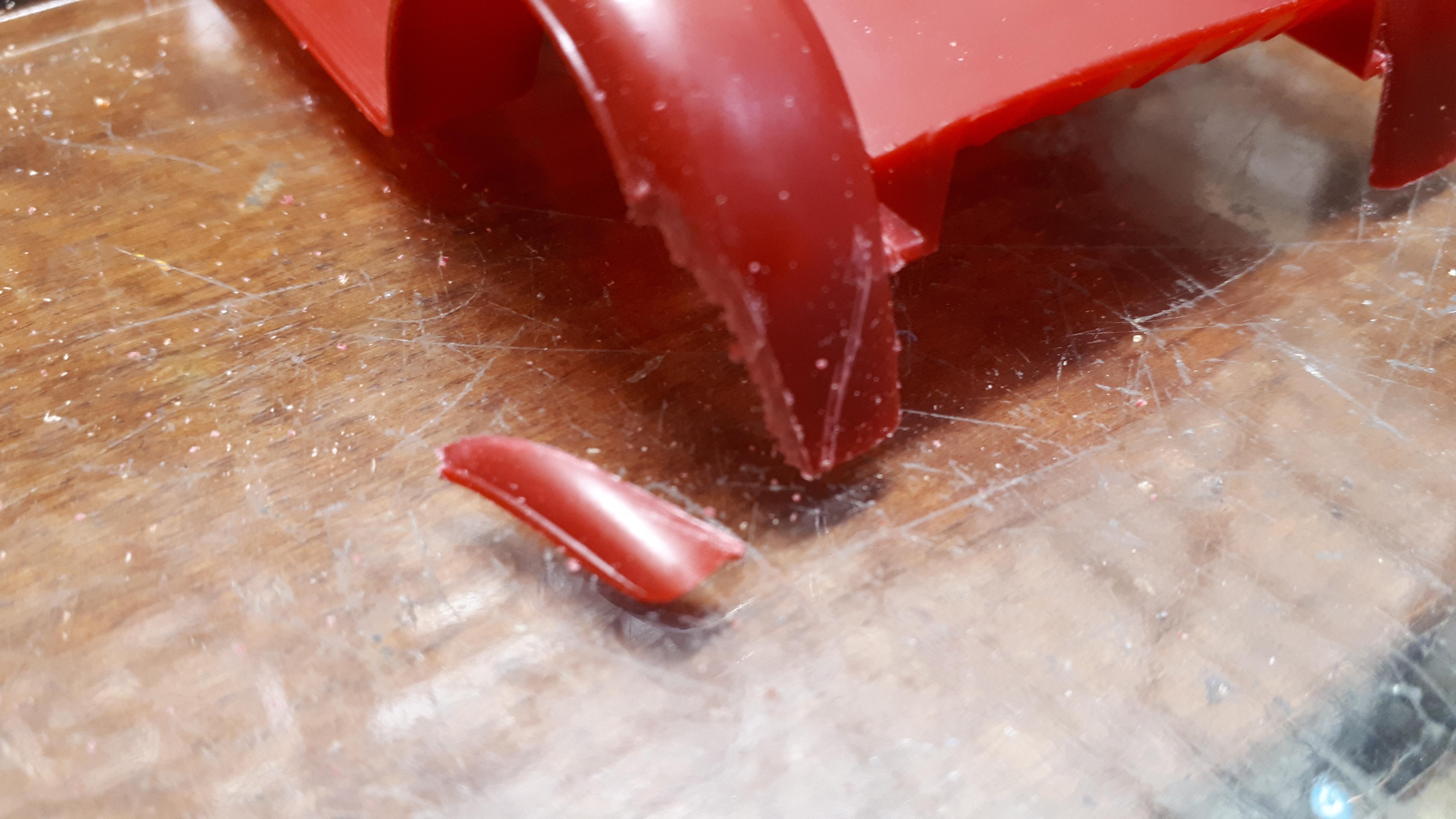

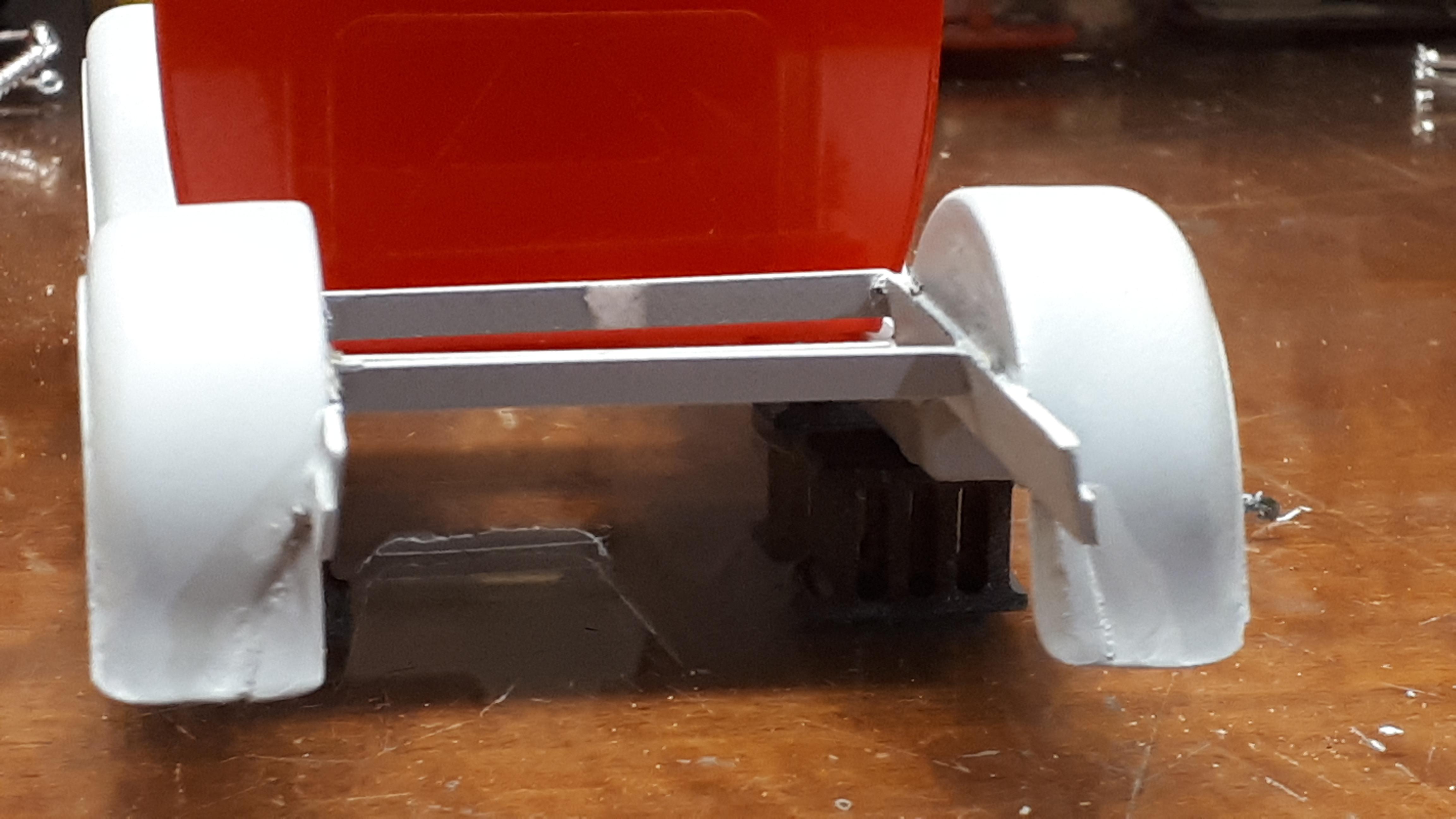

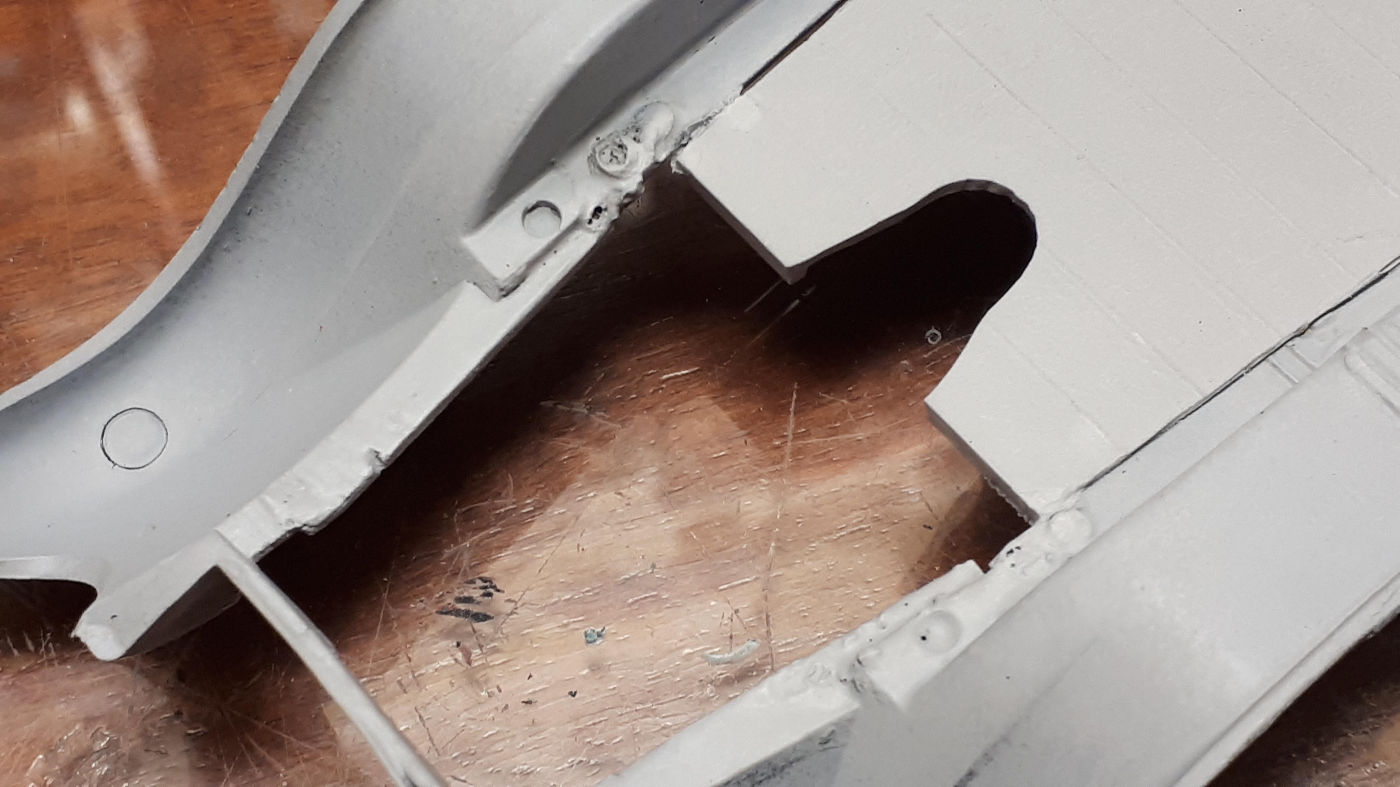

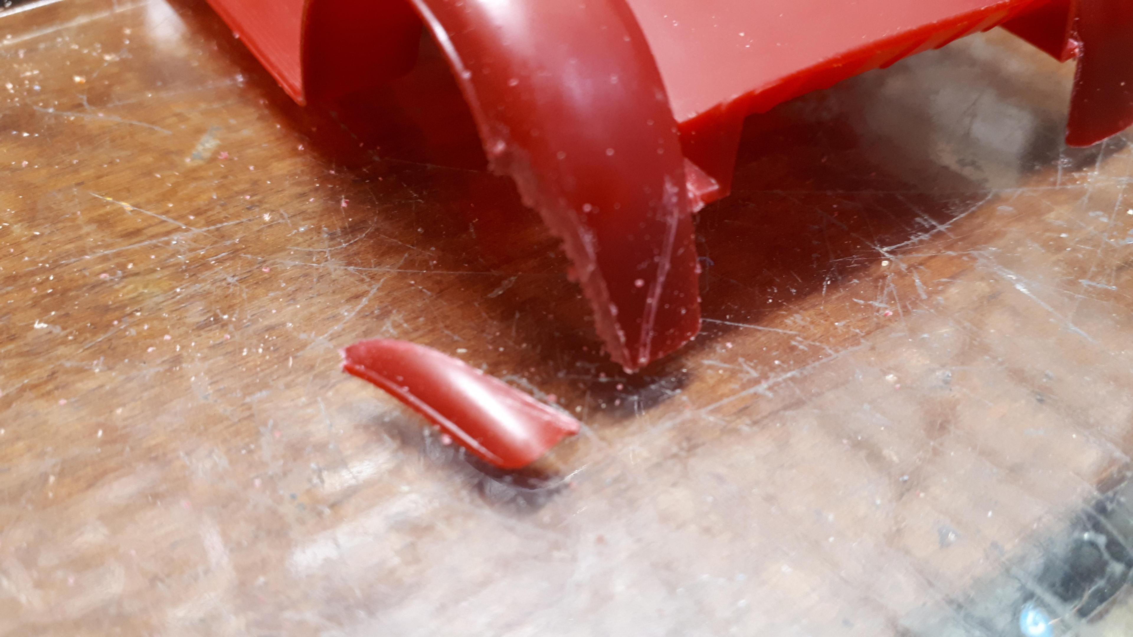

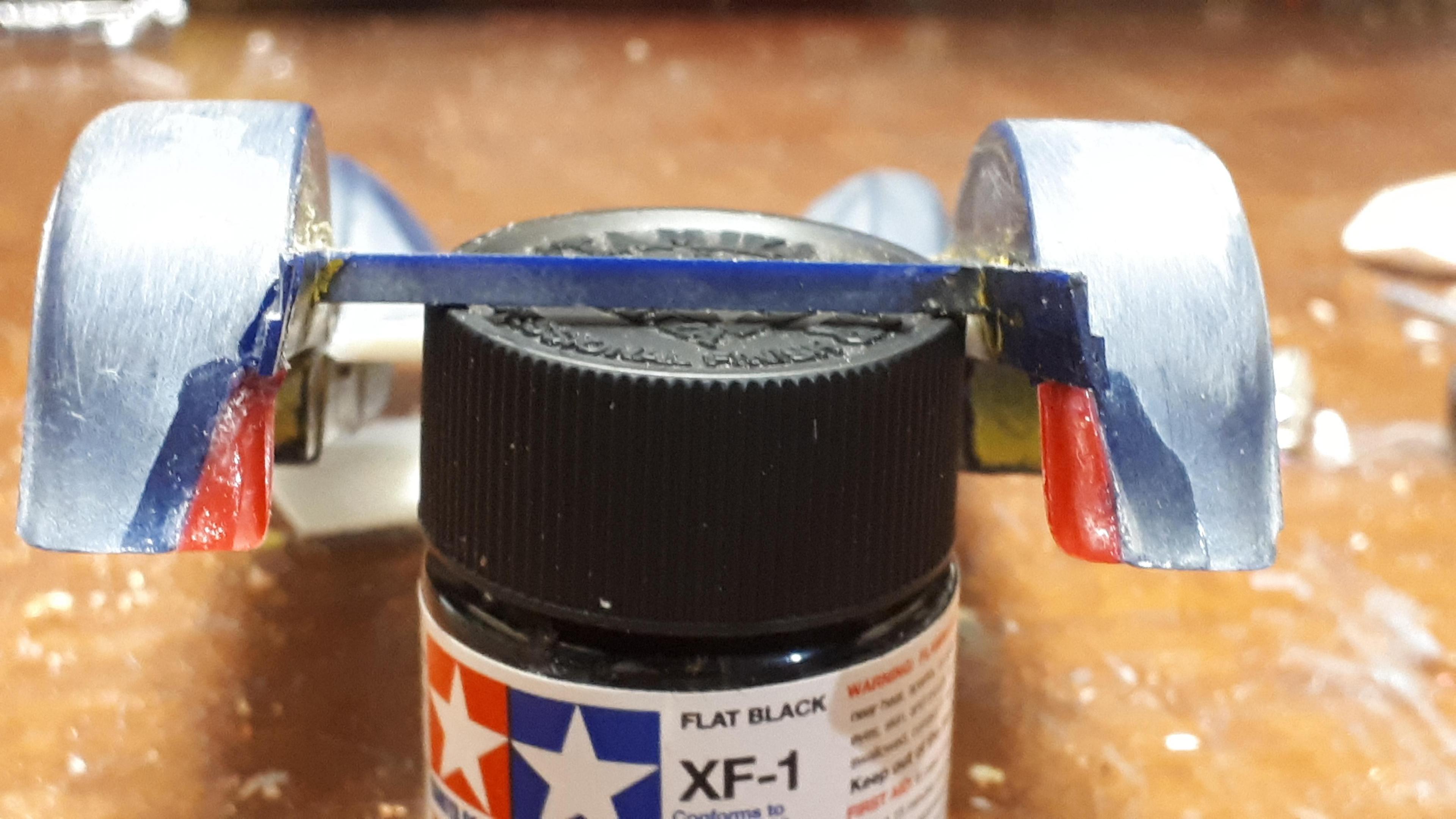

alan barton Posted March 6, 2021 Share Posted March 6, 2021 Before I went to throw an initial primer coat on, I realised that the rear fenders had tapered inside edges, perhaps to aid in ejection from the mould? Who knows, it did not have that nice fat, squared off look of a stock Model A so I needed to do something about it. I was going to just glue some bits of styrene scrap on to build up the edges but I have at least six spare AMT Model A fender units so I sacrificed one to cut the corners off to correct the Bandai fenders. Don't worry, I think what is left will make a nice set of bobbed fenders for an early sixties style hiboy in a fender law state. Note that I used the outside edge of a left fender to fix the inner edge of the right hand fender, and vice versa. IT gives a nicely finished edge that will only need a smear of putty to finish. The first primer coat revealed a few issues. There is a lot of glue damage around the lower surfaces of the front end of the side valance panels. The extra crossmember I added to support the front edge of the bed is on the wonk and there is a bit of the fender bead missing off the top edge of the right hand rear fender. On the other hand, my initial attempts to smooth off the inaccurate and damaged running board has come out great and will only need a little more effort to be ready for paint. Obviously some more puttying and sanding to go but, hey, that's hot rodding for you. Best of all, the extended cab now has somewhere nice to sit without actually having to lengthen i the fender unit. And that, my friends, is a good thing.. 1 Quote Link to comment Share on other sites More sharing options...

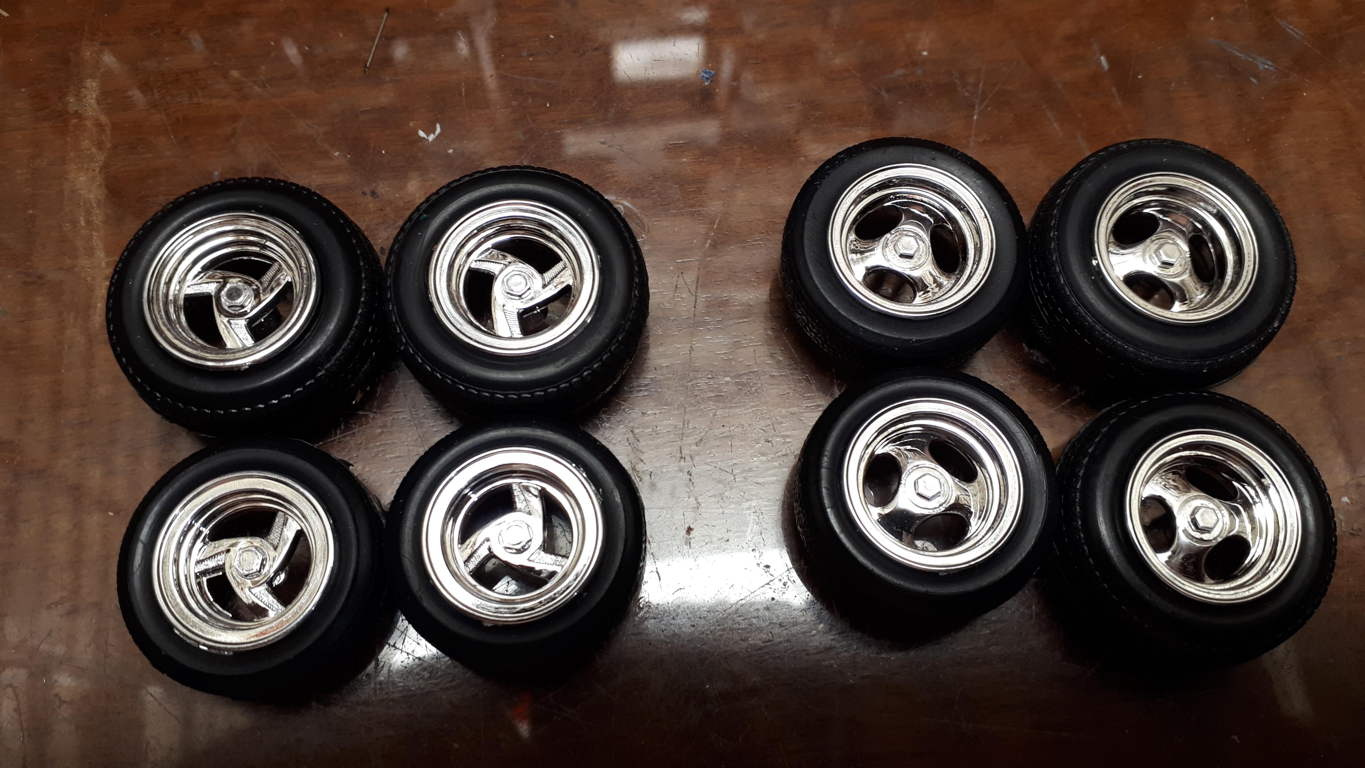

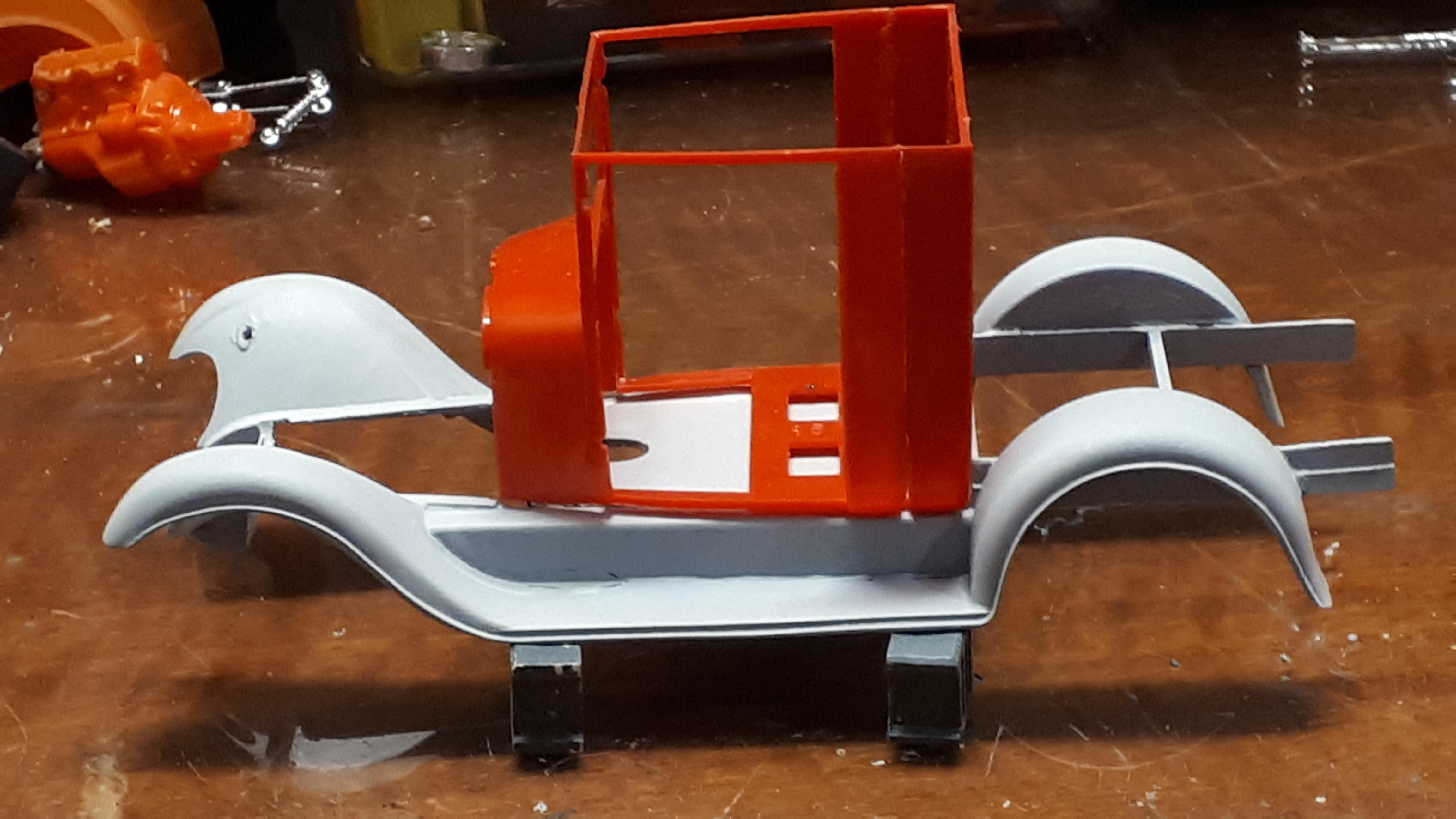

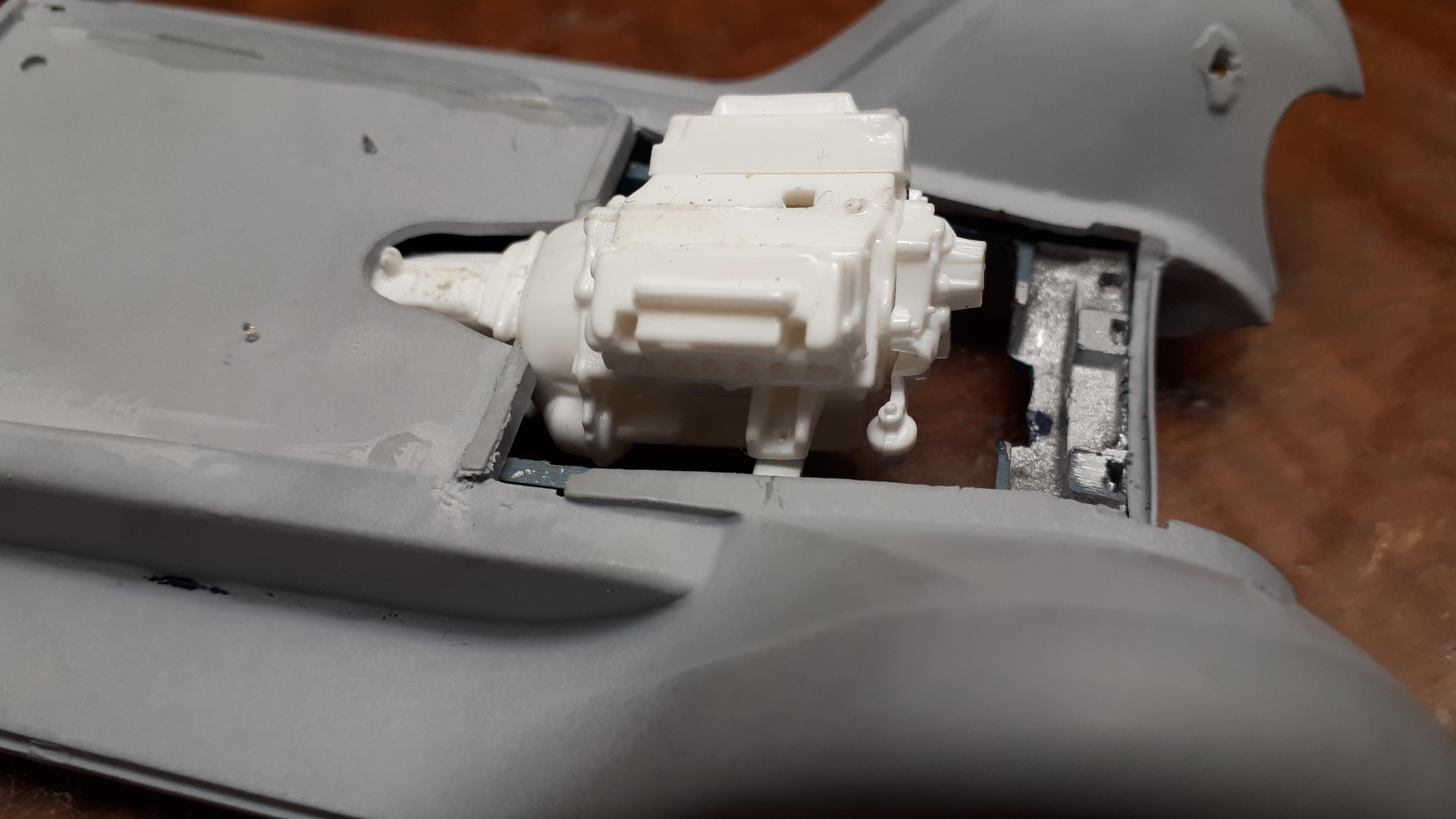

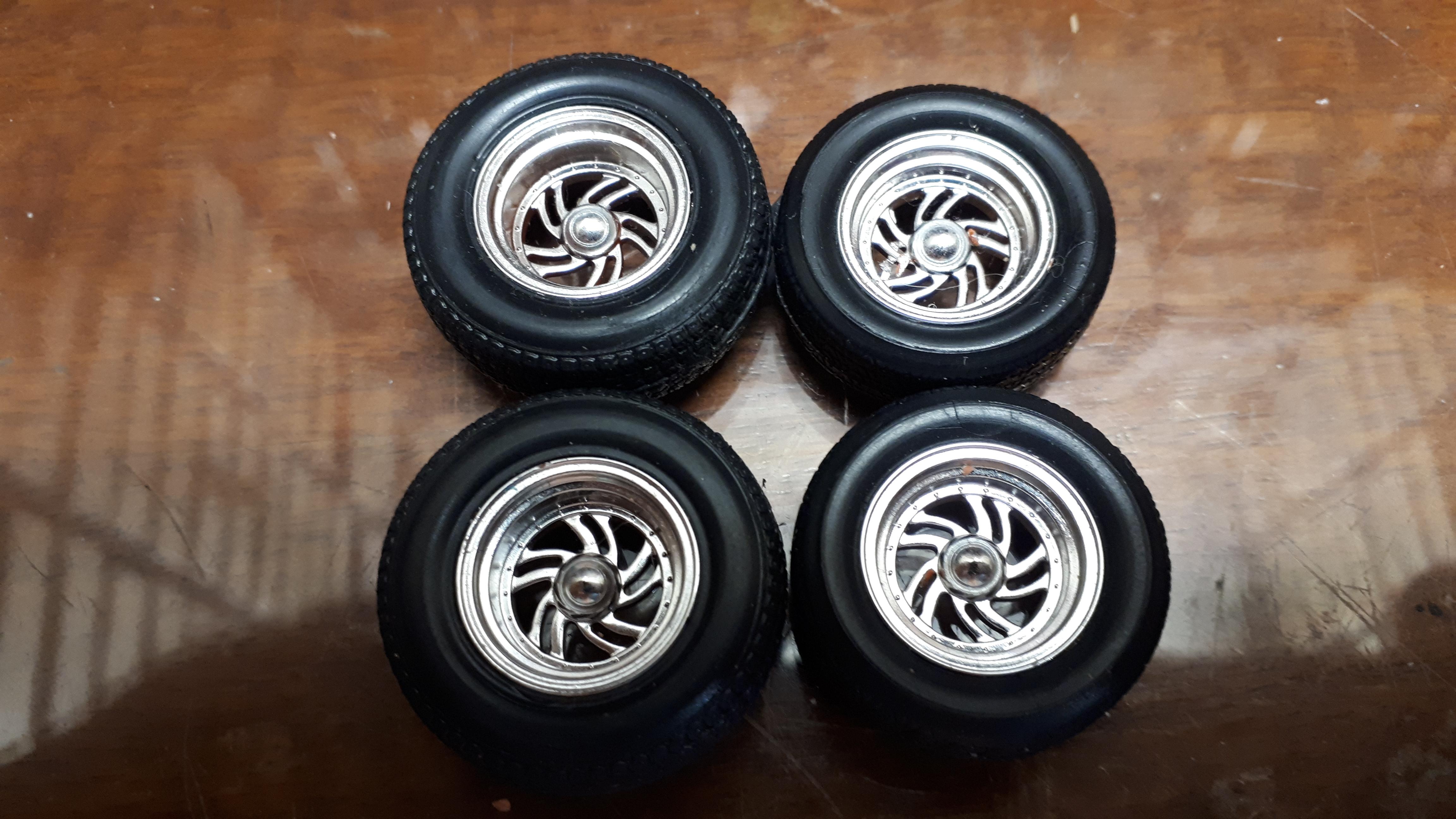

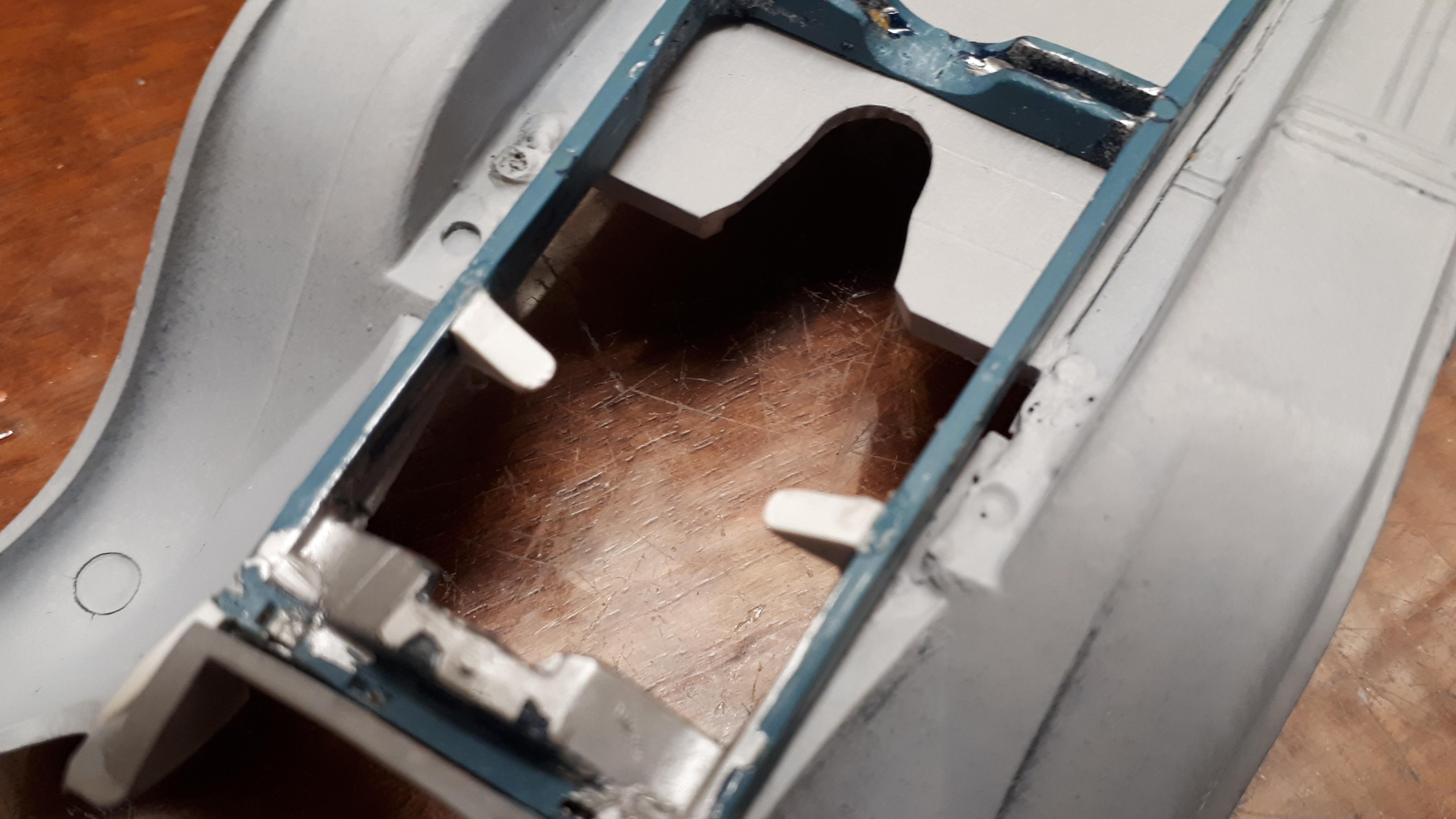

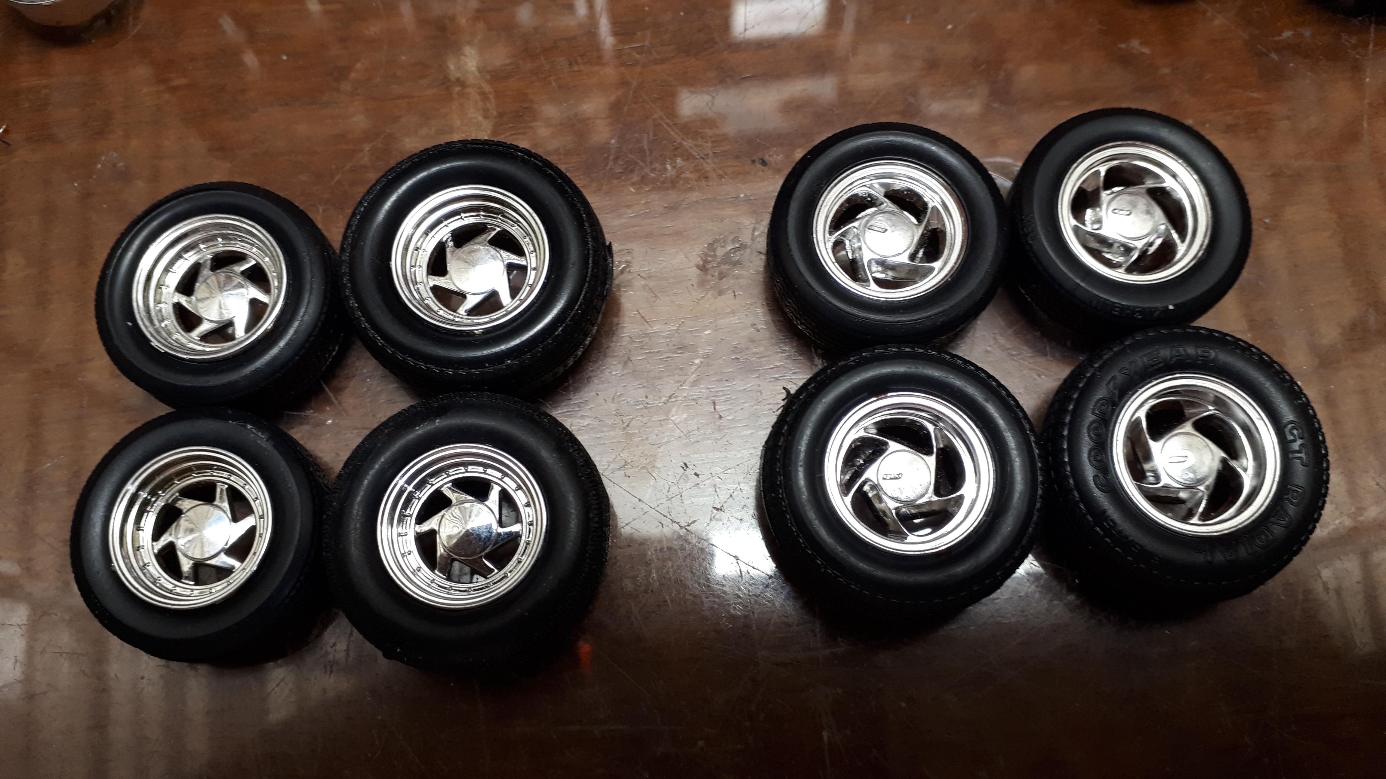

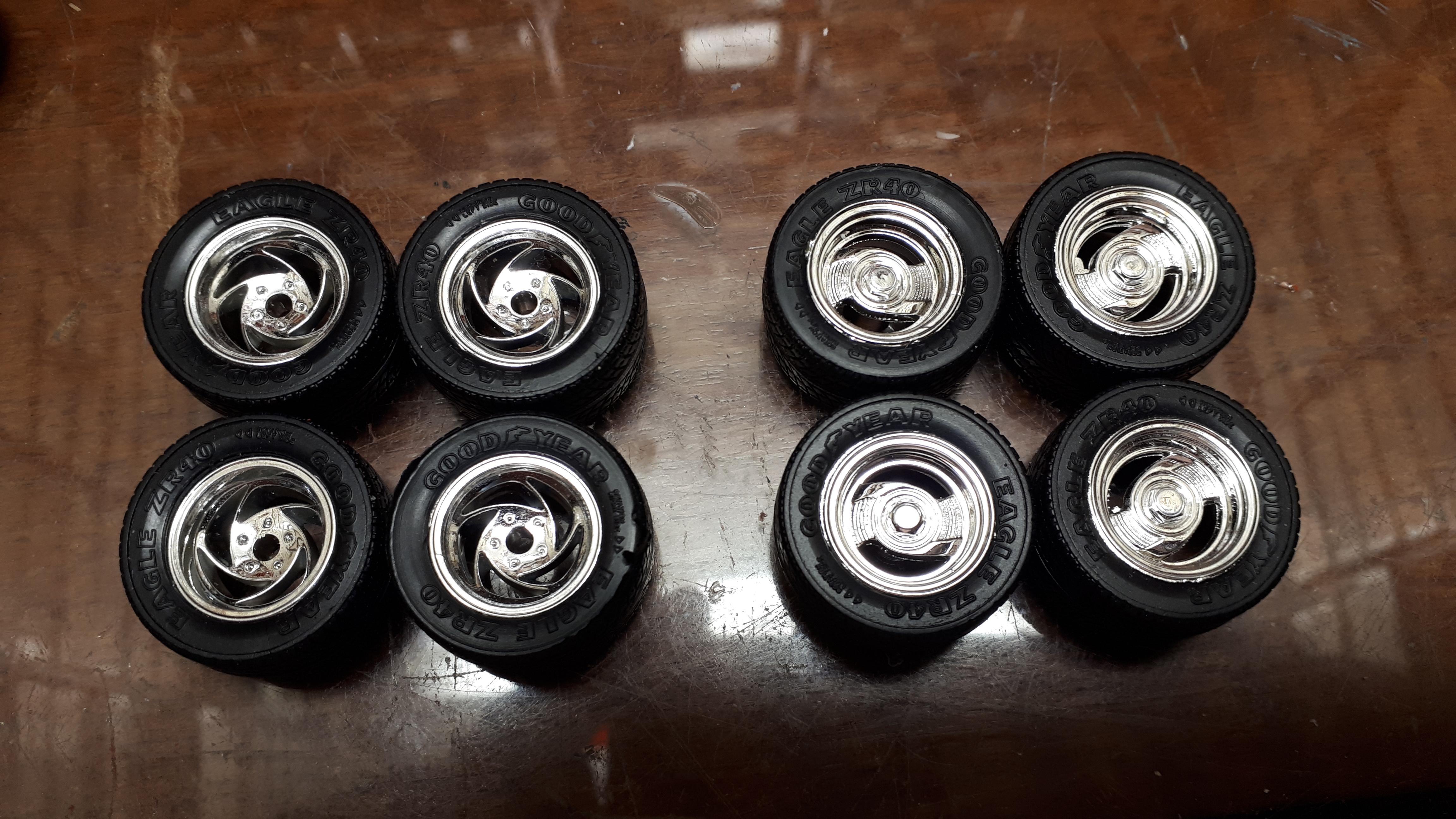

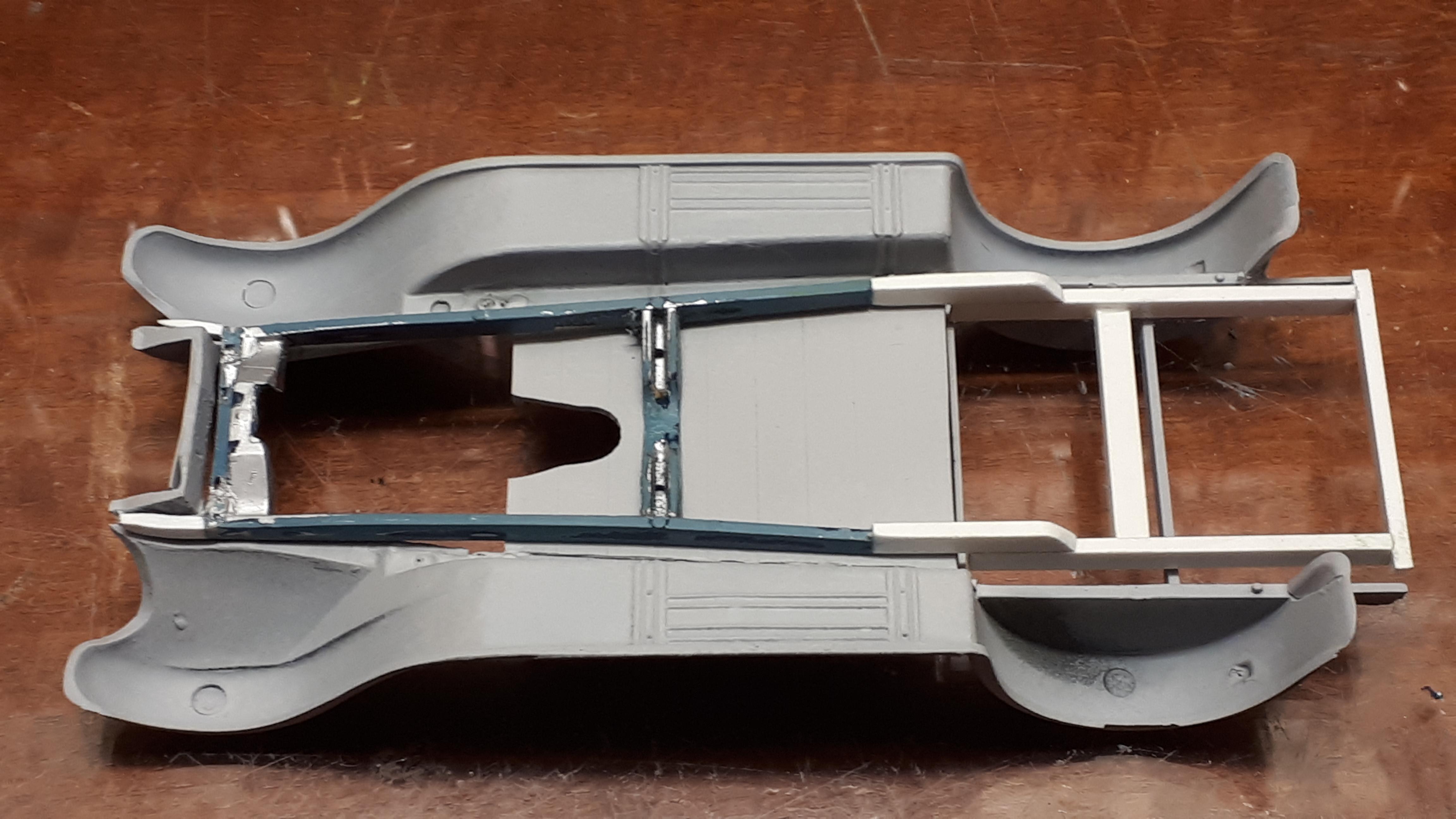

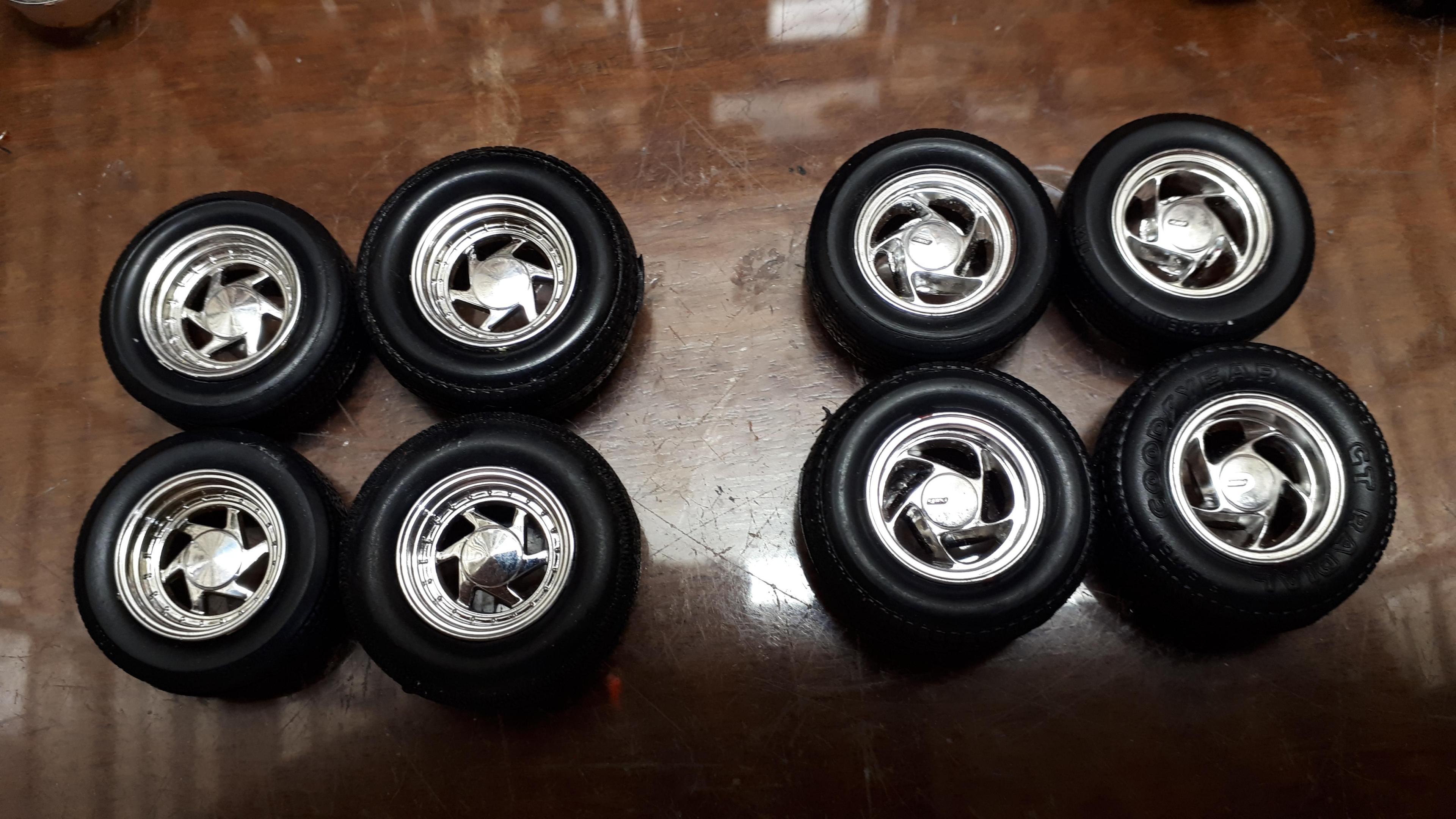

alan barton Posted March 7, 2021 Share Posted March 7, 2021 (edited) Not a lot of progress today but we do now have front engine mounts - simple triangles of styrene glued to the Model frame. I am going to set the V6 right back in the firewall to improve weight distribution. I also dug out my "Billet Wheels" box for about the first time in 25 years and started looking at wheel and tyre combinations. Some are absolutely perfect for the period but I'm sorry guys, I just can't do it! Two and three spoke - no thanks! I am old school enough to feel you need at least five spokes on a hot rod. (I did find some four spoke fans but they were too ugly to photograph!) I was surprised to see that three of the fan design wheels had the spokes correctly aligned in opposite directions. Tyres look like being Monogram Goodyear radials on the rear , the smaller diameter. It looks like I am all out of the larger diameter, my favourite rear tyre, but for the era I think the slightly smaller ones will do and they will contribute to a flatter rake. Fronts are Michelin TRX, a good choice for a skinny, short radial, again, correct for the era. I think I know which wheel I'm going to use but would be keen to hear your opinions. The last set have already been used by others in this thread but I thought I would chuck them in for comparison sake. Cheers Alan Edited March 7, 2021 by alan barton Quote Link to comment Share on other sites More sharing options...
Bullybeef Posted March 7, 2021 Share Posted March 7, 2021 @alan barton My vote would be for either of those 2 Quote Link to comment Share on other sites More sharing options...
Dennis Lacy Posted March 8, 2021 Author Share Posted March 8, 2021 Good progress @alan barton I had never given any thought to the inside edges of the rear Monogram fenders having that angle cut but it looks a lot better with them corrected. Neat approach to the floor, too! My wheel vote is Picture 4, the set on the LEFT. Quote Link to comment Share on other sites More sharing options...
alan barton Posted March 8, 2021 Share Posted March 8, 2021 Thanks Dennis, me either! It sure makes a difference and I will be looking out for it in future. Not sure why it took nearly fifty years for those fenders to catch my attention but I can't unsee it now.! Bullybeef came really close by picking the right wheels photo, you nailed it, that is the set I popped under the fenders just before I left for work! I have quite a few sets, not sure why, but only one set of really wide rears - there appears to be three different widths. On some of my spare narrow ones I am going to experiment with some of your techniques for satin finish. I'm really a shiny guy but this is the billet era after all - we will see! Next step will be to get some axles under this puppy! Cheers Alan Quote Link to comment Share on other sites More sharing options...

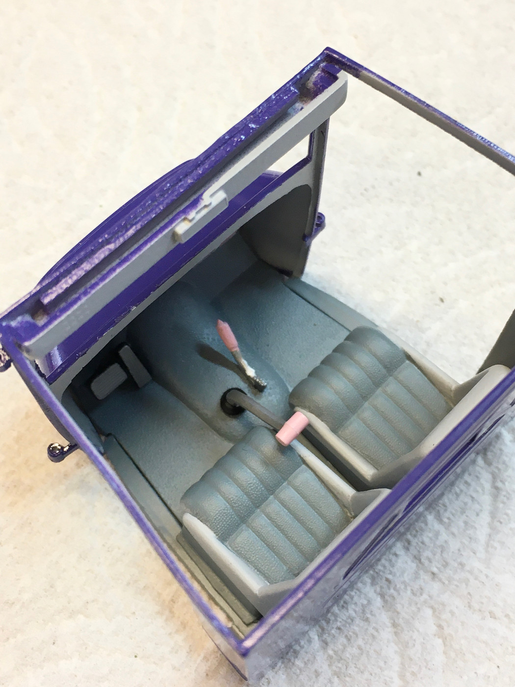

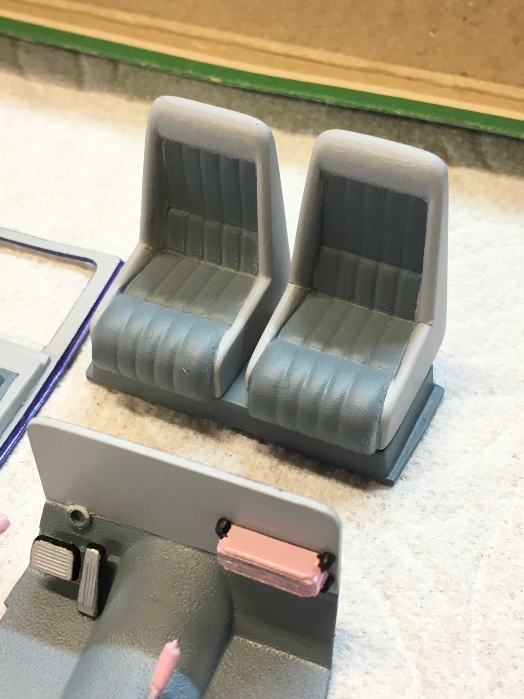

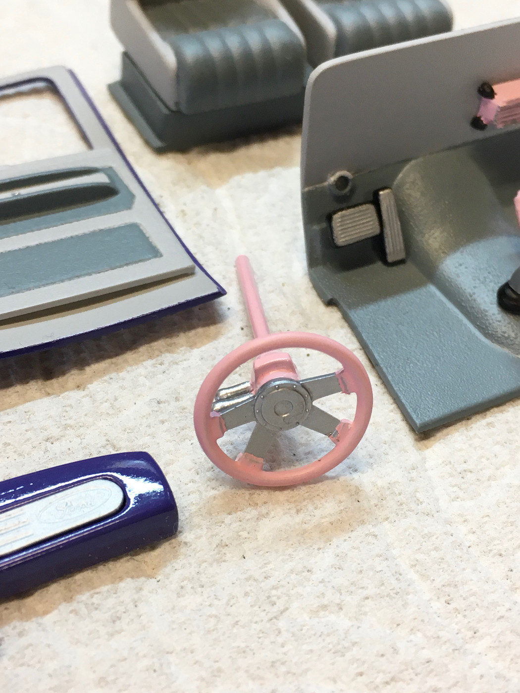

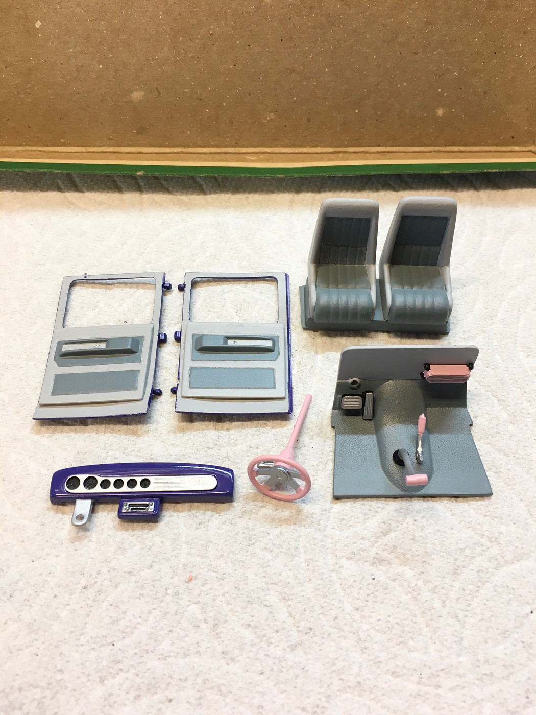

Dennis Lacy Posted March 8, 2021 Author Share Posted March 8, 2021 UPDATE! As of today I have all of the detail painting for the interior finished and even glued some sub-assemblies together. The lighter gray is simply Tamiya's fine gray primer while the darker is Tamiya's "Haze Gray". I wanted the steering wheel grip, hand brake lever handle and shift handle to look like pink leather so I sprayed them with the same Tamiya Pink followed with their flat clear. I mocked a few things together into the cab to get a look at how it will all come together. 1 Quote Link to comment Share on other sites More sharing options...
alan barton Posted March 8, 2021 Share Posted March 8, 2021 Like it a lot - spot on for the eighties! Wow, you got a neat colour break on those seats. I'm going to use them as well, at least at this stage, and with my extended cab I may not need to stand them up - we'll see. I will be using the T door panels as I have used them before and know they work well with Model As. Plus I have a fret of photo etch instrument panels and tail lights that I have never used until now. Cheers Alan Quote Link to comment Share on other sites More sharing options...
Dennis Lacy Posted March 8, 2021 Author Share Posted March 8, 2021 2 minutes ago, alan barton said: Like it a lot - spot on for the eighties! Wow, you got a neat colour break on those seats. I'm going to use them as well, at least at this stage, and with my extended cab I may not need to stand them up - we'll see. I will be using the T door panels as I have used them before and know they work well with Model As. Plus I have a fret of photo etch instrument panels and tail lights that I have never used until now. Cheers Alan Thanks! I am so sick of masking. I had to do it so many times to get all these color. Like the cab. Had to mask the WHOLE inside, spray the outside. Mask the WHOLE outside, spray the underside flat black. Mask everything but the inside floor, spray that the darker gray. I'm over it! LOL With your extended cab you should have plenty of room for the seats as they come. Reworking them was a bit of a pain in the rear. Quote Link to comment Share on other sites More sharing options...
