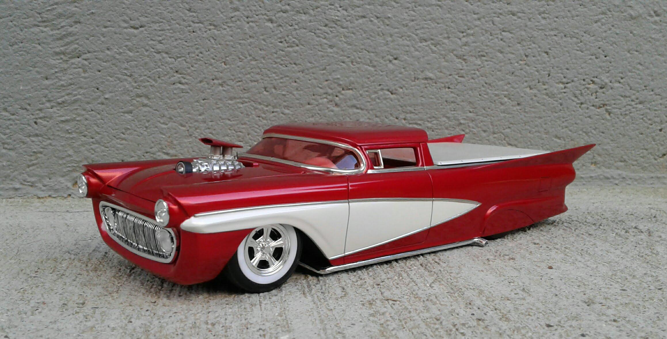

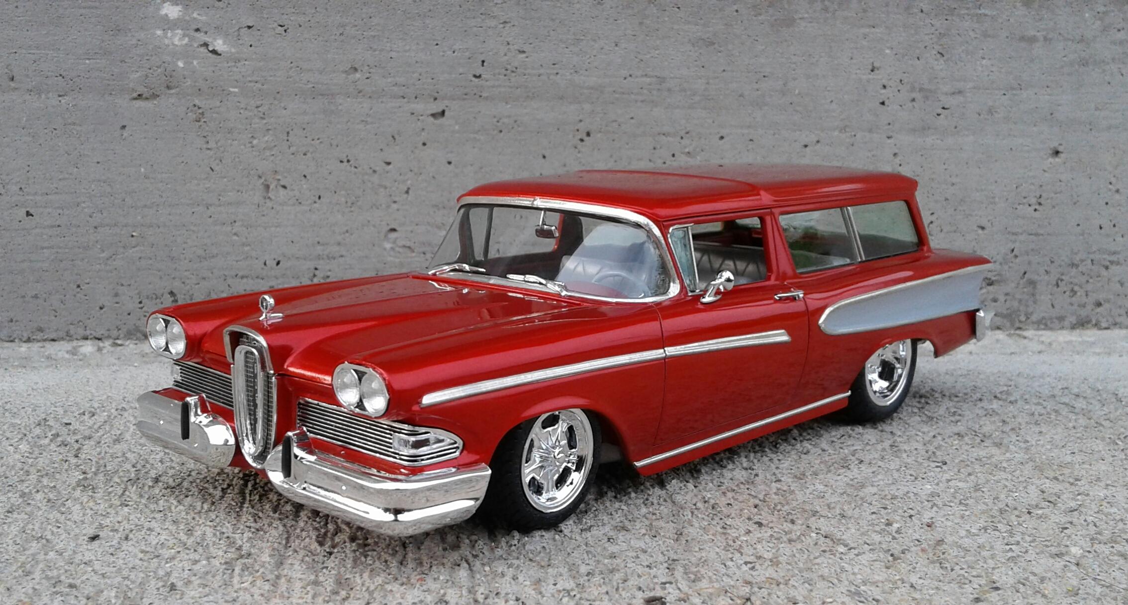

Plowboy Posted October 21, 2020 Posted October 21, 2020 (edited) On 10/21/2020 at 3:15 PM, TransAmMike said: Just wondering here. When rattle can spraying a pearl color, say a red in this case, does it really make a difference if the undercoat is a primer or say a gold metallic? Expand It does make a difference in my experience. I prefer to spray pearl or mica reds over a silver or gold base. Gold seems to give a little darker, richer color. These photos illustrate the difference between a silver and a gold base coat. The Edsel wagon is over Mica Silver. The Ranchero is over gold. Both are painted with Tamiya Mica Red. Edited October 21, 2020 by Plowboy

BlackSheep214 Posted October 23, 2020 Posted October 23, 2020 On 10/21/2020 at 3:27 PM, Plowboy said: It does make a difference in my experience. I prefer to spray pearl or mica reds over a silver or gold base. Gold seems to give a little darker, richer color. These photos illustrate the difference between a silver and a gold base coat. The Edsel wagon is over Mica Silver. The Ranchero is over gold. Both are painted with Tamiya Mica Red. Expand Those are fantastic! I definitely see the difference! I don't mean to stray away from the OP's original question but I do have one question. What would you suggest for a base coat for Candy Apple Red? I know there are a few candy colors out there - and red being the most common one. My thinking silver or gold base coat would work just as well?
Plowboy Posted October 23, 2020 Posted October 23, 2020 On 10/23/2020 at 12:05 AM, BlackSheep214 said: Those are fantastic! I definitely see the difference! I don't mean to stray away from the OP's original question but I do have one question. What would you suggest for a base coat for Candy Apple Red? I know there are a few candy colors out there - and red being the most common one. My thinking silver or gold base coat would work just as well? Expand Thanx! I would use gold under Candy Apple Red.
