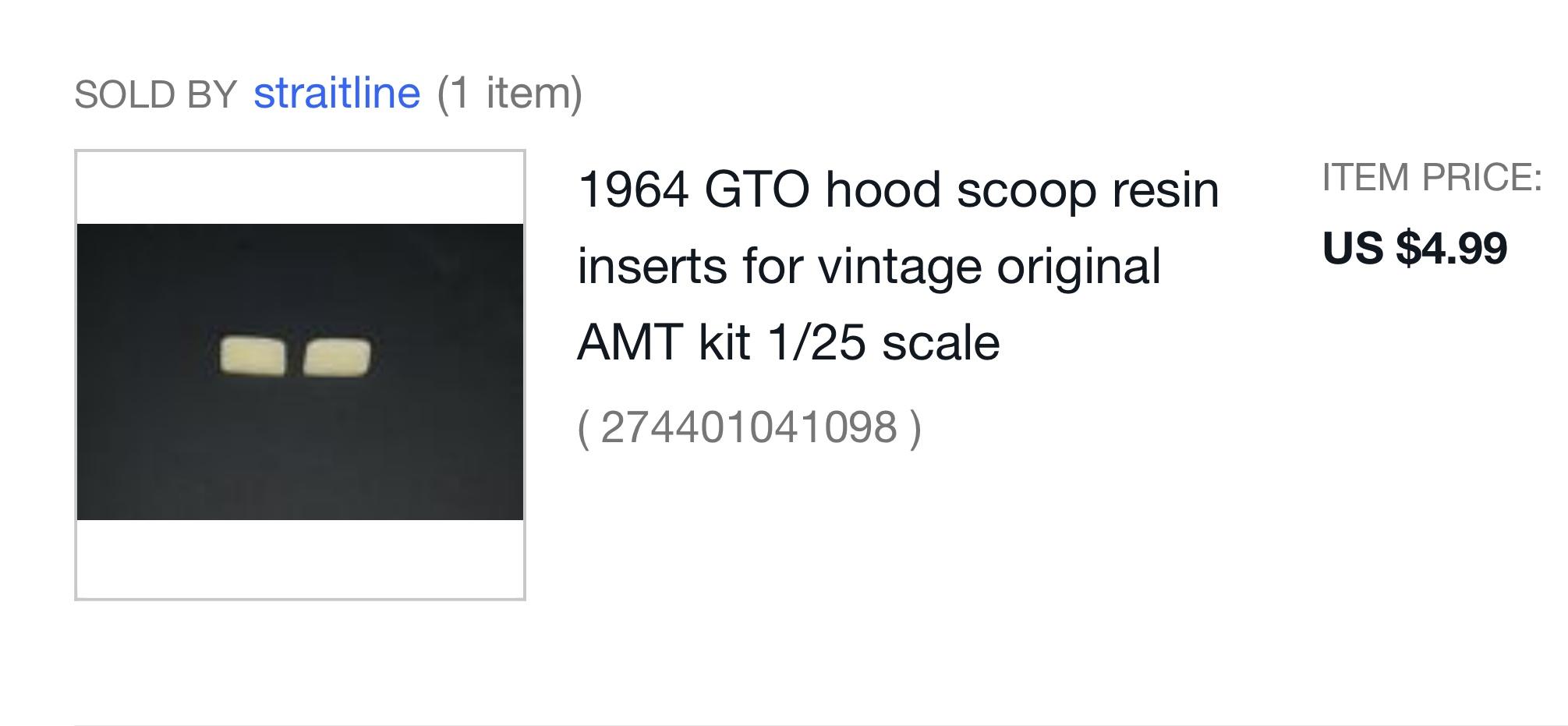

Basically box-stock.  I was missing the AMT hood inserts so I massaged a Monogram hood to fit.  The fit is a little wonky at the front corners, but I have the AMT hood painted to match just in case I ever find the inserts.  Paint is Tamiya TS-74 clear red over TS-38 gunmetal to simulate Marimba Red; not bang-on but I'm satisfied with the look.
The gto came out great. I bought an original issue gto as well that was previously built but was complete. I’ve since dismantled the model ,stripped the paint and had the bumpers rechromed. Anyway, I the process of dismantling it I had a hard time popping the hood vents out and destroyed one. I looked for quite a while for original replacements but struck out. I found a guy on eBay that was selling resin repops for the original annual kit which I purchased. They are very ice ,fit great and price was right ($4.99). I’ve included a screen shot of them and the sellers eBay name. Maybe contact him and he could help?
