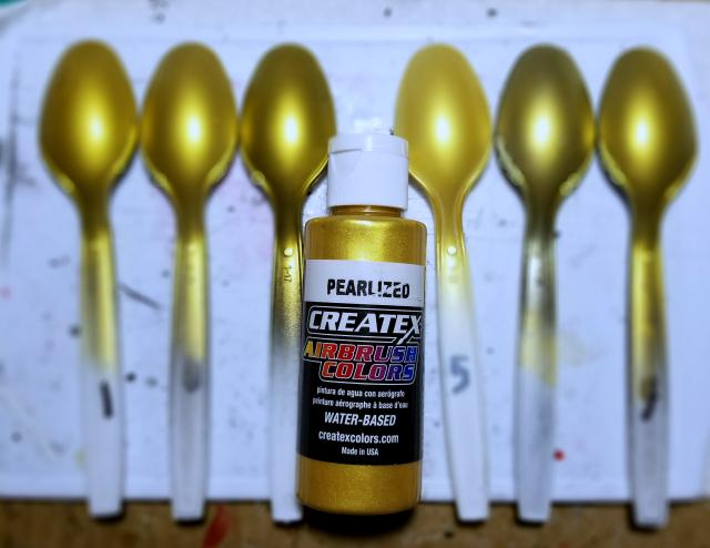

 Finally made my trip to Hobby Lobby and of course they didn't have the gold I wanted in the Wicked Color line so I just picked up the one in the picture.
With my limited air brush experience and other issues not withstanding, I was able to spray a number of spoons after spraying them with various rattle can primers.  The biggest difference is in the spoon just to the right of the paint bottle. It's clearly the lighest (it was sprayed over Krylon white primer).  The color definatetly varies by the shade of primer.  I sprayed one over gloss black(the 2d one from the right) and it is darker than the rest.
My conclusion??  Well, I'm still on the fence on what to do about the paint. I can't honestly say any one of the samples is the right color.
Also, Using my Paasche H airbrush wasn't a particularly good experience.  I had trouble getting any consistant flow, maybe (or probably) because the air pressure would pretty quickly bleed off from the 25 psi.  Gonna take me a long time to get this right. Oh, and as I'm sure you can tell, no clear on anof the spoons.
It does have a number 5 needle.  I'm assuming higher pressure with the thicker paint too.  The compressor I was using is a tankless one but as I said the pressure kept bleeding off quickly.
Try thinning the paint some more to where it will shoot at 20-22 psi. Your compressor might keep up there. Try it with plain water in the airbrush first if need be. If that doesn't work try a #3 tip with it's smaller air cap, it's really all you need for models anyway. You need to solve this problem because even if you go OEM mix for your paint job you need steady air flow. Usually with an H though one of the above will do it with a tankless comp. And do understand the problem is the compressor not the airbrush. It's just many airbrushes have restricted airflow to something on the order of 25psi, the H will flow 50 if you set it there and the comp can't keep up.
No comment on the paint, it's pretty though. Oh and you might as well go on to clear coating it, you need to experience that anyway. I do tests like this all the time lol !! Just so I know.
Edited by Dave G.
