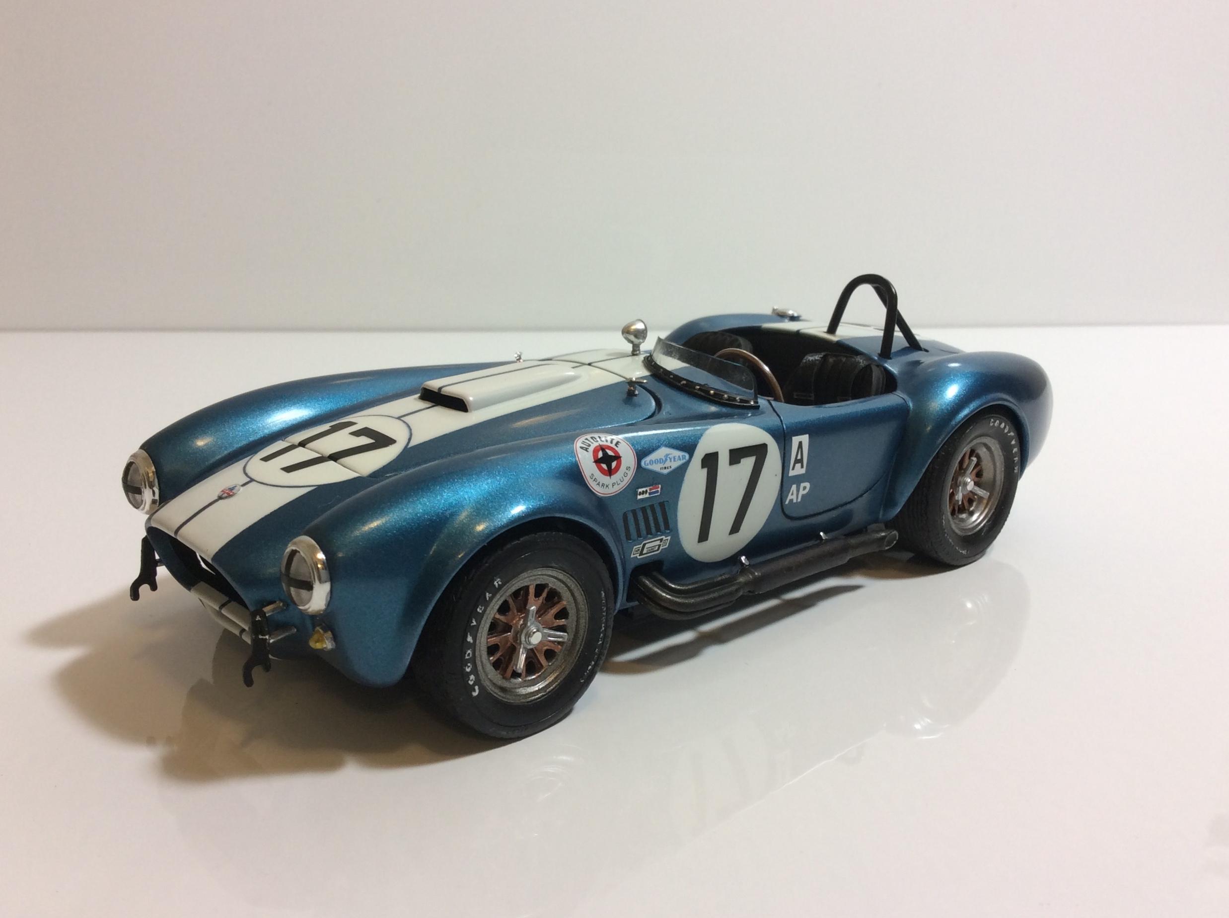

Venom Posted November 13, 2020 Posted November 13, 2020 I haven’t read every post on this thread, so forgive me if I reiterate something. I just wanted to mention that I just started using the Createx colors and clear over the summer. Some of what I used in mixing my colors was 7 year old Auto Air colors which I understand are the same company as Createx. As far as the Createx Wicked Colors line is concerned, I’m thinking it is simply their higher quality stuff based on the price jump from the regular Createx colors. The only color I had disappointment with so far has been the regular (not Wicked) Createx satin black. It took me a lot of very light coats before I coul get it opaque enough, and then when I was done and let it dry a couple days it would come off down to the bare plastic when handled with bare hands. The parts I was painting were undercarriage parts, so it wasn’t a huge issue as it would have been if I were painting the body...However I was able to solve the problem by spraying over the black with the 5620 clearcoat and 4012 reducer combined as it gave it a nice durable shell. One thing I want to stress is the learning curve. When I first started spraying this stuff I really panicked and struggled a lot, mostly with the clearcoat. I’m using the 5620 gloss clearcoat with the 4012 reducer. I kept expecting it to come out more glossy, but it would always dry to more of a satin finish. At first I hated it, but then after using some good patience with wet sanding and polishing I came to realize that it’s near impossible to screw it up in the end. The car I’m currently working on is a gold Ford GT40 and I was able to polish the clear out to a perfect high gloss. Albeit, some cars, especially vintage models look better with a less glossy sheen, so all in all I think the 5620 is awesome stuff if you have the patience for it. Getting the best mix of clear/paint plus reducer is going to come down to spray time and trial and error. I’ve been mixing my paints to be the same consistency as whole milk with great results. The clear I start out diluting with the 4012 just like the bottle says maybe only deviating by adding a few extra drops to the into airbrush. I have had some clogging where I had to break down the entire airbrush and clean with Windex, especially with the 5620 clear, even having to do a bit of scraping with a sewing needle, but I’ve accepted that this is just part of the deal and whenever I’m not going to be using the brush for a day after using the clear, I break it down and give it a thorough cleaning with the Windex. I’m using an Iwata Eclipse airbrush, and so far it cleans up well using this method. Below is a pic of the first model I painted entirely using Createx and Auto Air colors and clearcoat and then doing some polishing. After wet sanding I used Macguires Micro Scratch remover followed up with Turtle Wax Super Hard Shell. Then cleaned out all the wax from all the little crevasses with water and a tooth brush... Hope this helped at least a little.
Kit Basher Posted November 13, 2020 Posted November 13, 2020 On 11/13/2020 at 4:25 AM, Venom said: Expand That Cobra is gorgeous, Josh. What color did you use?

Venom Posted November 13, 2020 Posted November 13, 2020 On 11/13/2020 at 5:03 PM, TransAmMike said: And Josh, I forgot to tell you also, great looking Cobra. May I do need to try that clear too. Expand Thanks Mike... So I guess in short what I’m saying about the clear is that it is very workable and forgiving. So even if you don’t get the results you expected from simply spraying it, it is quite polishable.
Venom Posted November 13, 2020 Posted November 13, 2020 (edited) On 11/13/2020 at 12:52 PM, Kit Basher said: That Cobra is gorgeous, Josh. What color did you use? Expand Thank you Hugh. I used Auto Air Pearlized Metallic Blue and added Auto Air Aluminum Base and very small parts of Createx Black,(non metallic), and just kept doing remixes until it looked like what I perceived to be Guardsman Blue... The stripes are just pure white with a tiny bit of Lemon Yellow added. Edited November 13, 2020 by Venom
