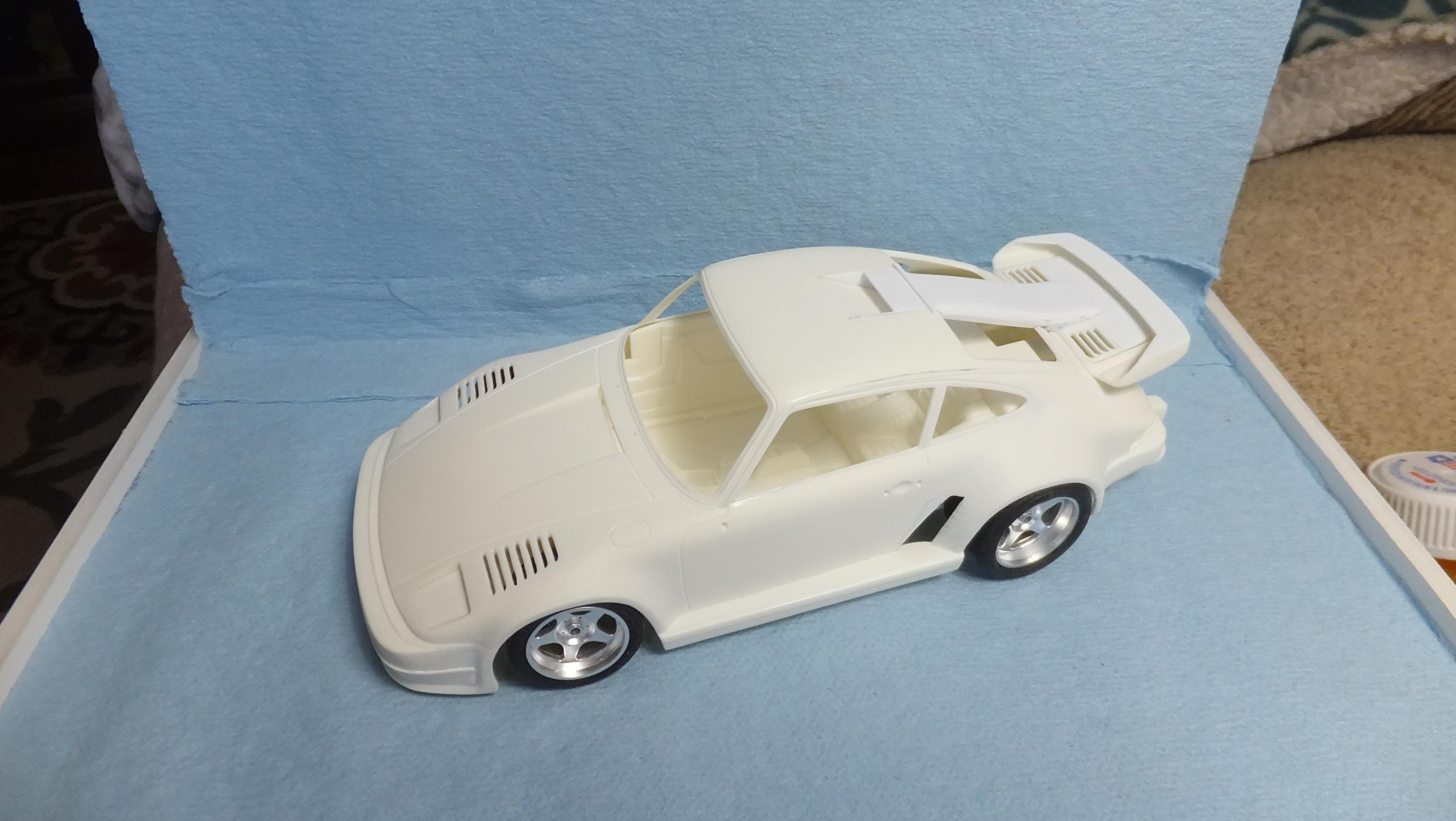

-Photo 1; Since its a curbside, if i cant see it when its on a table...i wont waste my time, money, or supplies on it, so i have this all together ready for paint -notice the upgraded exhaust tips.
-Photo 2; Fujimi must have reused a narrow-body chassis for this WIDE body car!...the wheels/tyres are waaay too far into the fenders, but no worries, i'll fix it with the fatter tyres!
-Photo 3; Since you can easily see through the hood vent, i needed to put something engine like in there, so i made a pedistal for a Tamiya 911GT2 intercooler to sit on.
-Photo 4; I attached another lift-block with a quick locater tab, and...
-Photo 5; ...it works great!
-Photo 6; An easy to take off body is one nice thing, but this is annoying! the contact is so weak, that you could say there is none -its as loose as throwing a hotdog down a hallway! Again, no worries...i added some styrene strip to the rear contact to make it stronger, and stop it where it needs to be.
-Photo 7; Here you can see the much improved contact.
-Photo 8; The intercooler fits the space perfectly, and adds some nice visual interest.

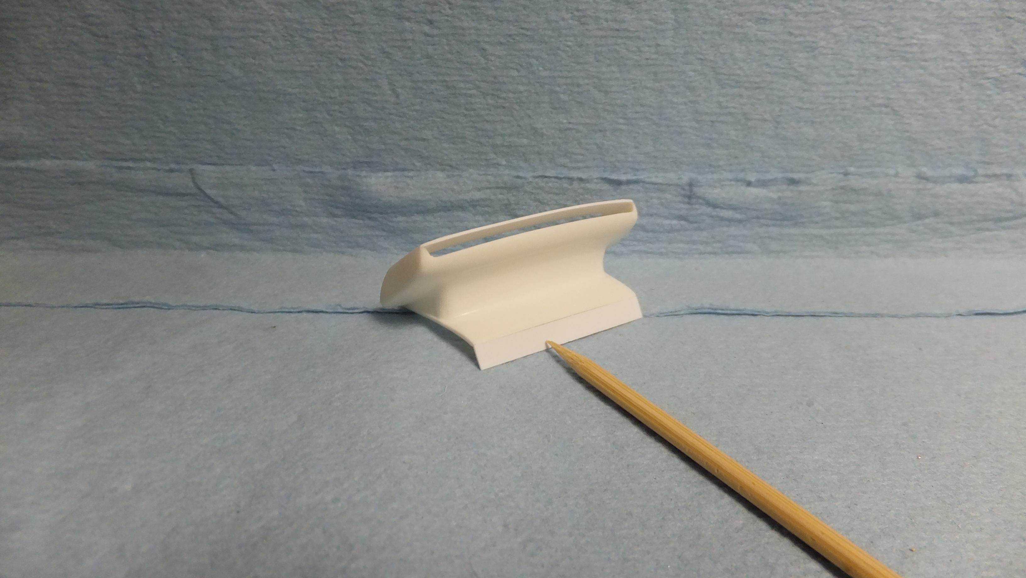

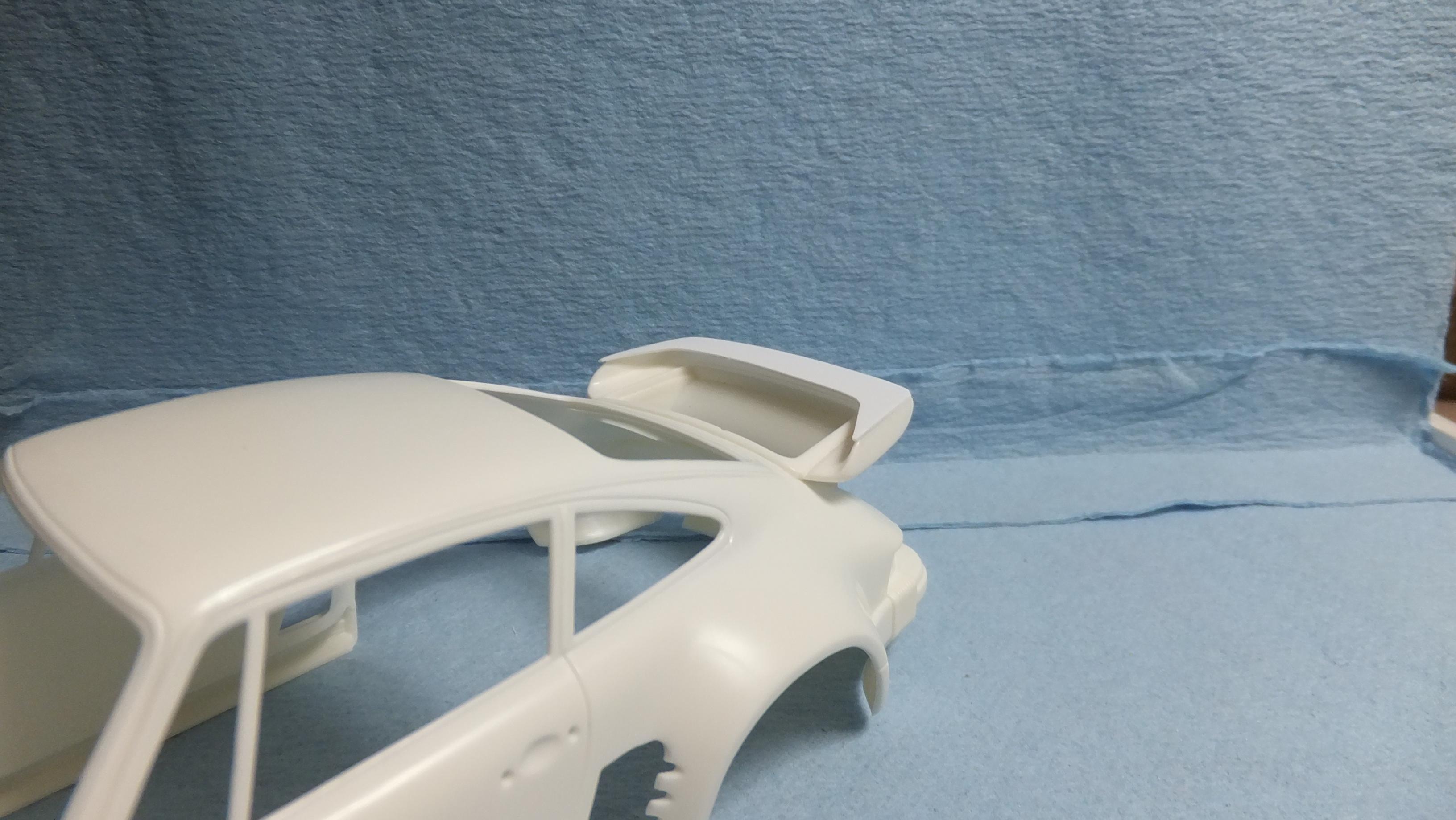

-Photo 6; Four things are displayed here...I started making a roof vent that will be very low profile. I ditched the stock hood vent, and started to make my own from styrene. To upgrade a bit more, i removed the side window vent pillars -mimicking the newer Porsches. The last thing i did here was to glue in filler styrene so that i can reshape the side vents later.
-Photo 7&8; Time to cut that roof for the cool air engine duct -idid this the same way i tackled the headlamps.
-Photo 9; This area needed to be notched out a bit.
-Photo 10; This is the start of the interior side of the vent.
-Photo 11&12; This is the body side of the vent. I added a thin strip of styrene to help keep the vent where it will be blended into the roof while i work on it. It will be sanded away later. As you can see, i blended in corner pieces of the stock vent, which balance out the front fender slots nicely.
-Photo 13; Forgot to show you that i had to cut out this area, and lower the crossmember for clearance.

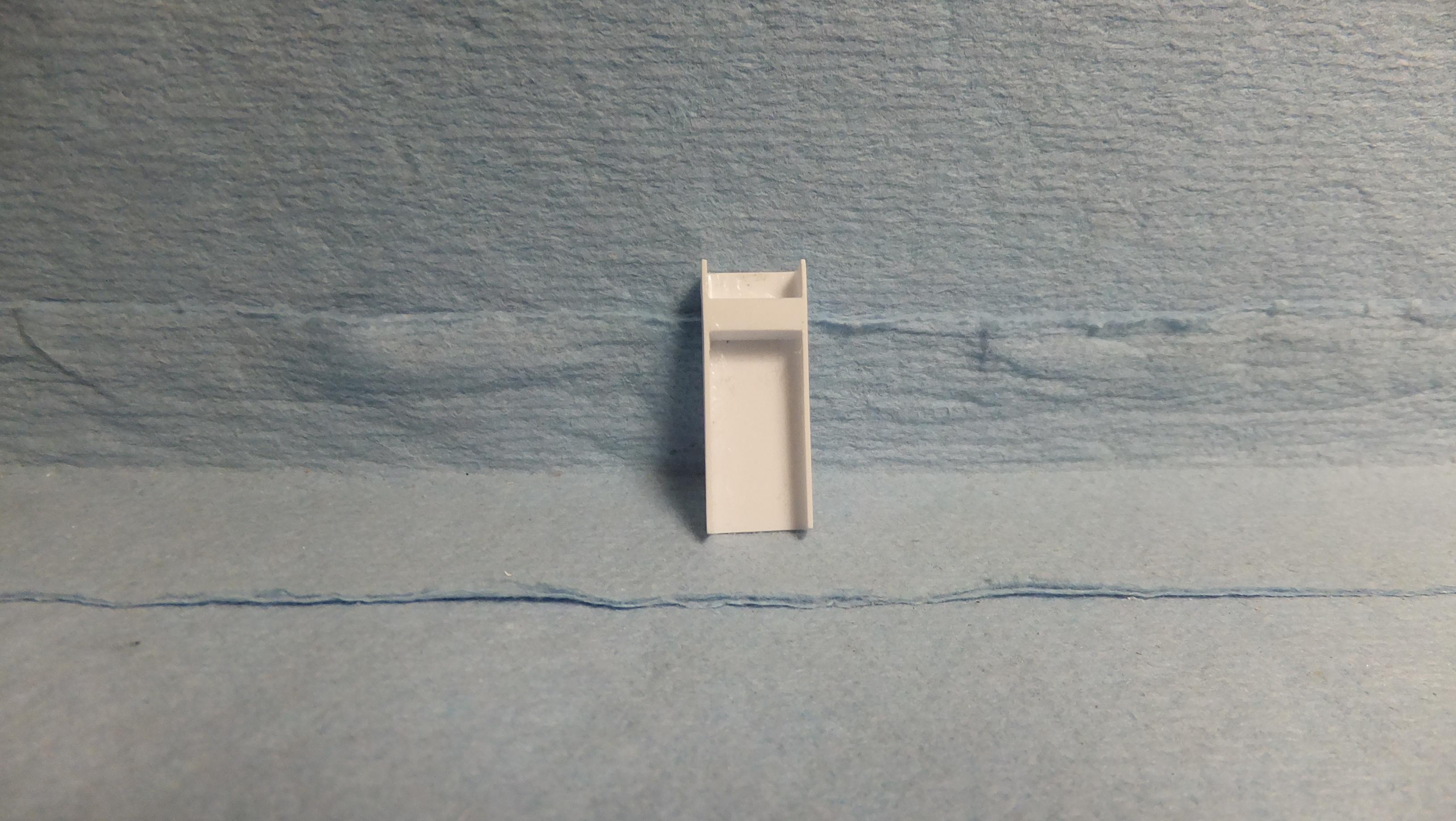

-Photo 14; It fits great, but now i need to add a funnel-neck to it in order to meet the roof cut out.
-Photo 15; Taping the interior vent to the body vent, helped me with where to notch out the parcel tray. I put the body over the chassis/interior tub, then traced around the vent. Always cut slightly inside your lines incase you have to tweak things a bit.

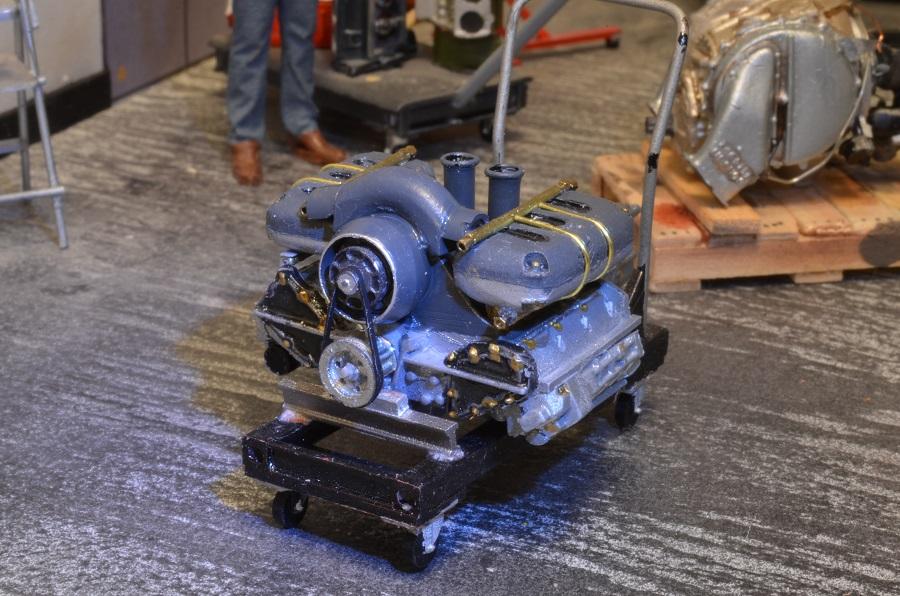

47 minutes ago, Dann Tier said:
Thats pretty cool!, where did you source it?
I scratched it based on a 911 Turbo using Signer's own photos.

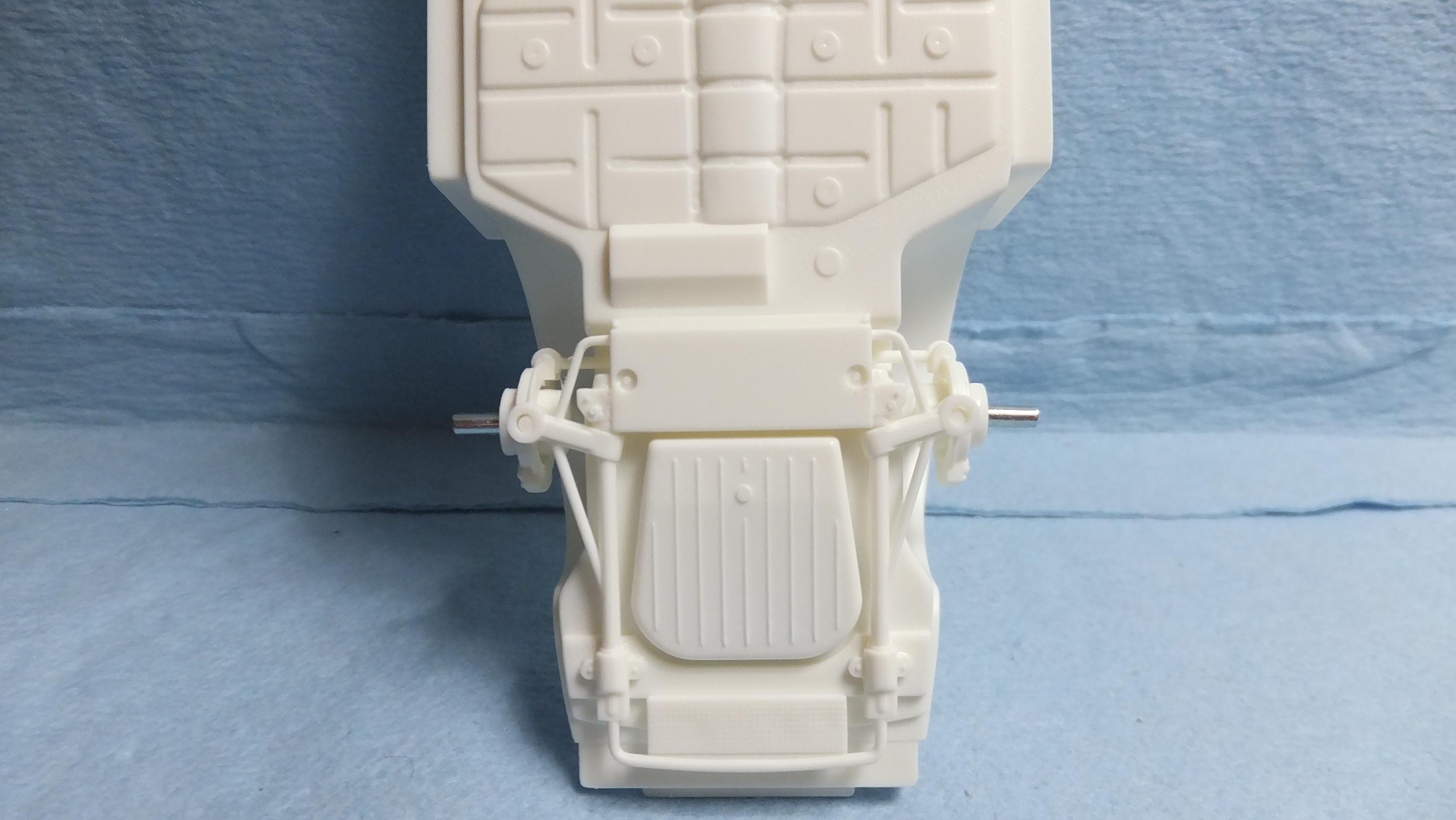

WOW!!....NICE job, Bud!!!.....can i copy you if i decide to put an engine in mine later?
Sure.

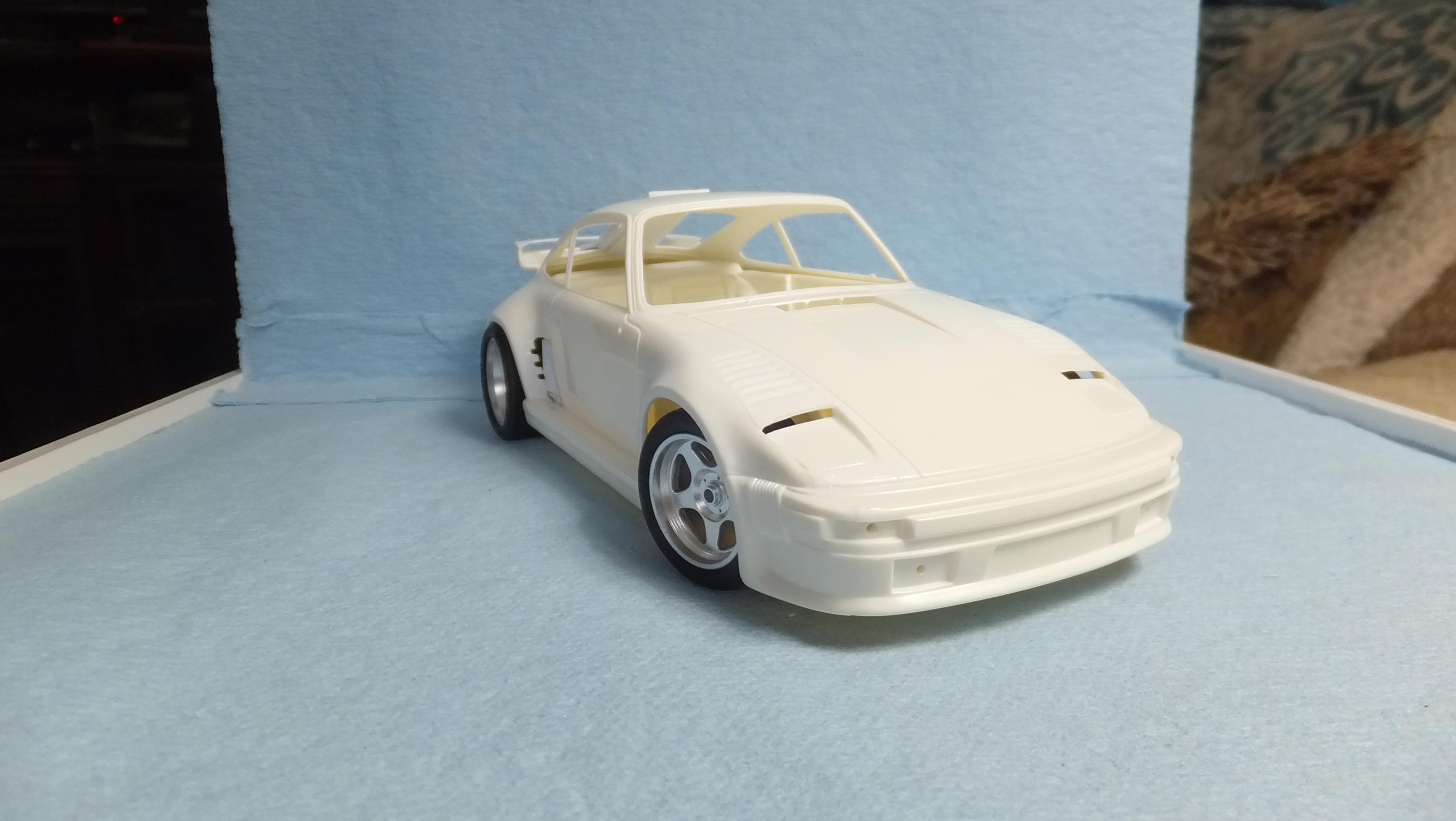

Update #2!
-Photo 1; I wanted a smoothed out front fascia, so i filled in the turnsignals, and mouth. I turned the fog lights into brake ducts.
-Photo 2; I opened the fender vents....gotta love PE saws!!
-Photo 3; I replaced the scalloped side vent with the "Shark Fin"...only mine is a functional vent -not a chip guard.
