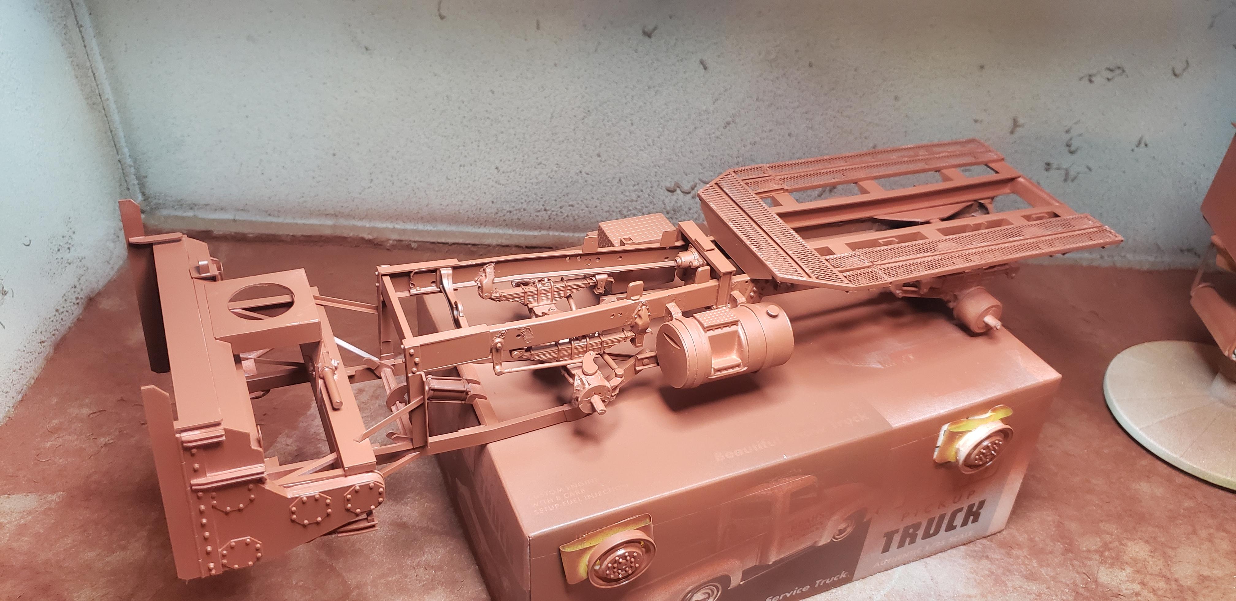

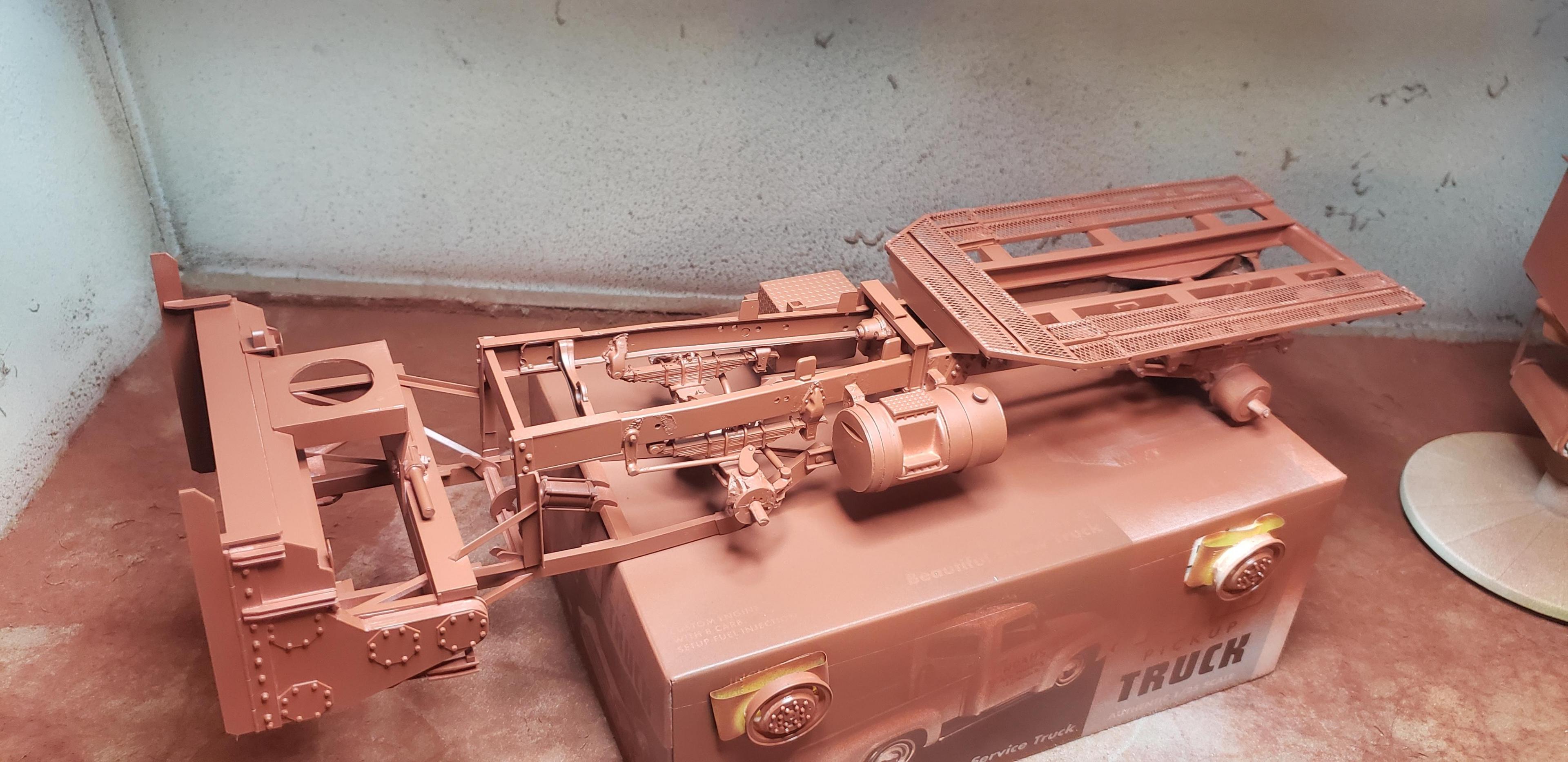

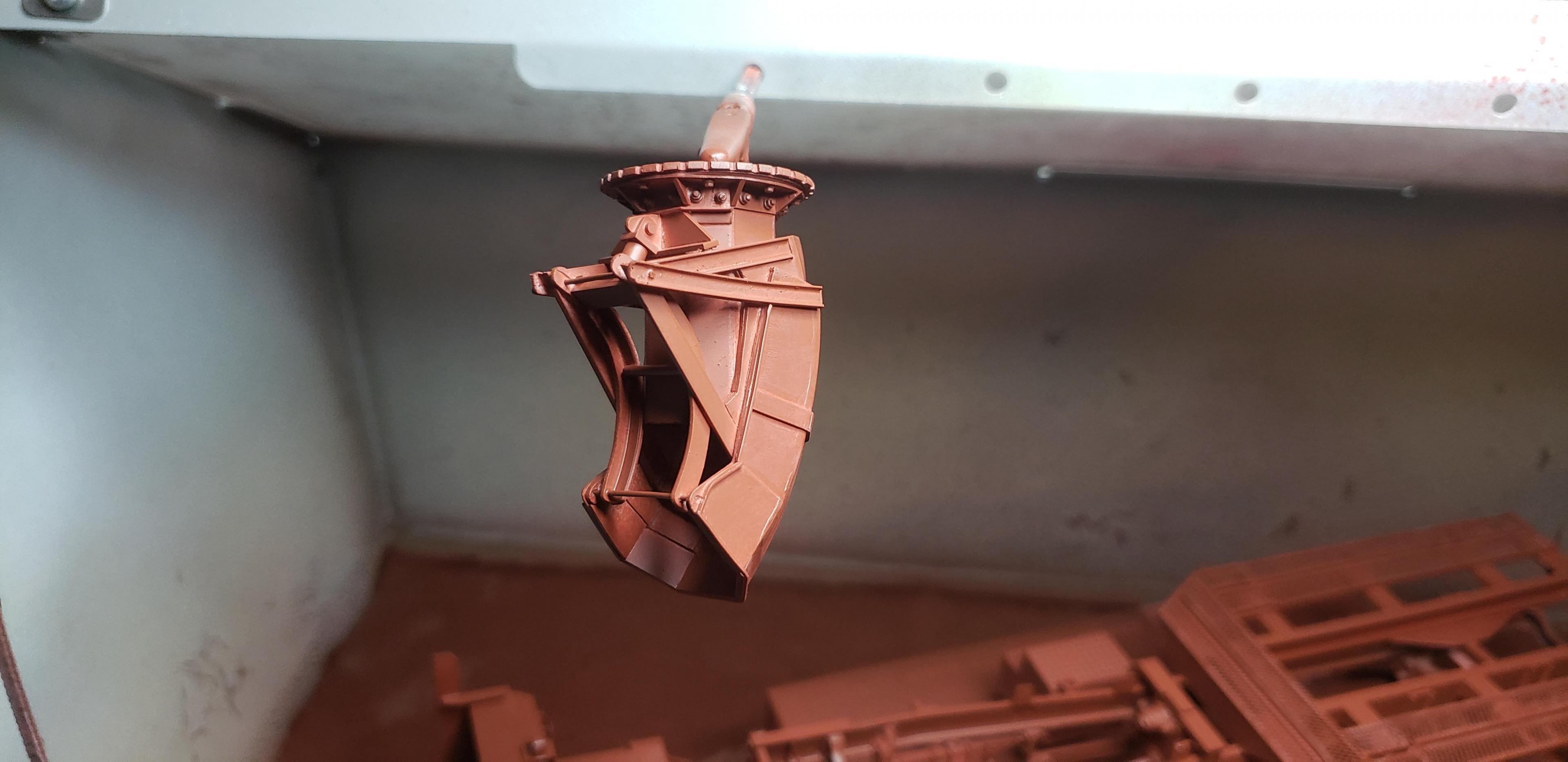

gotnitro? Posted January 17, 2021 Author Posted January 17, 2021 Update time and its a colorful one... The mesh arrived yesterday so I framed in the walkway w U strip and a popsicle width strips of screen. The radiator opening for the blower engine also received a patch of screen , ill frame it in w narrow 020 strip and meng bolts right before primer After the last mockup, the major parts were transferred to the paint side of the shop and received a light coat of tamiya red oxide fine primer . I chose this color to darken the final color into a goldenrod shade seen on the NYSDOT trucks . Jeff

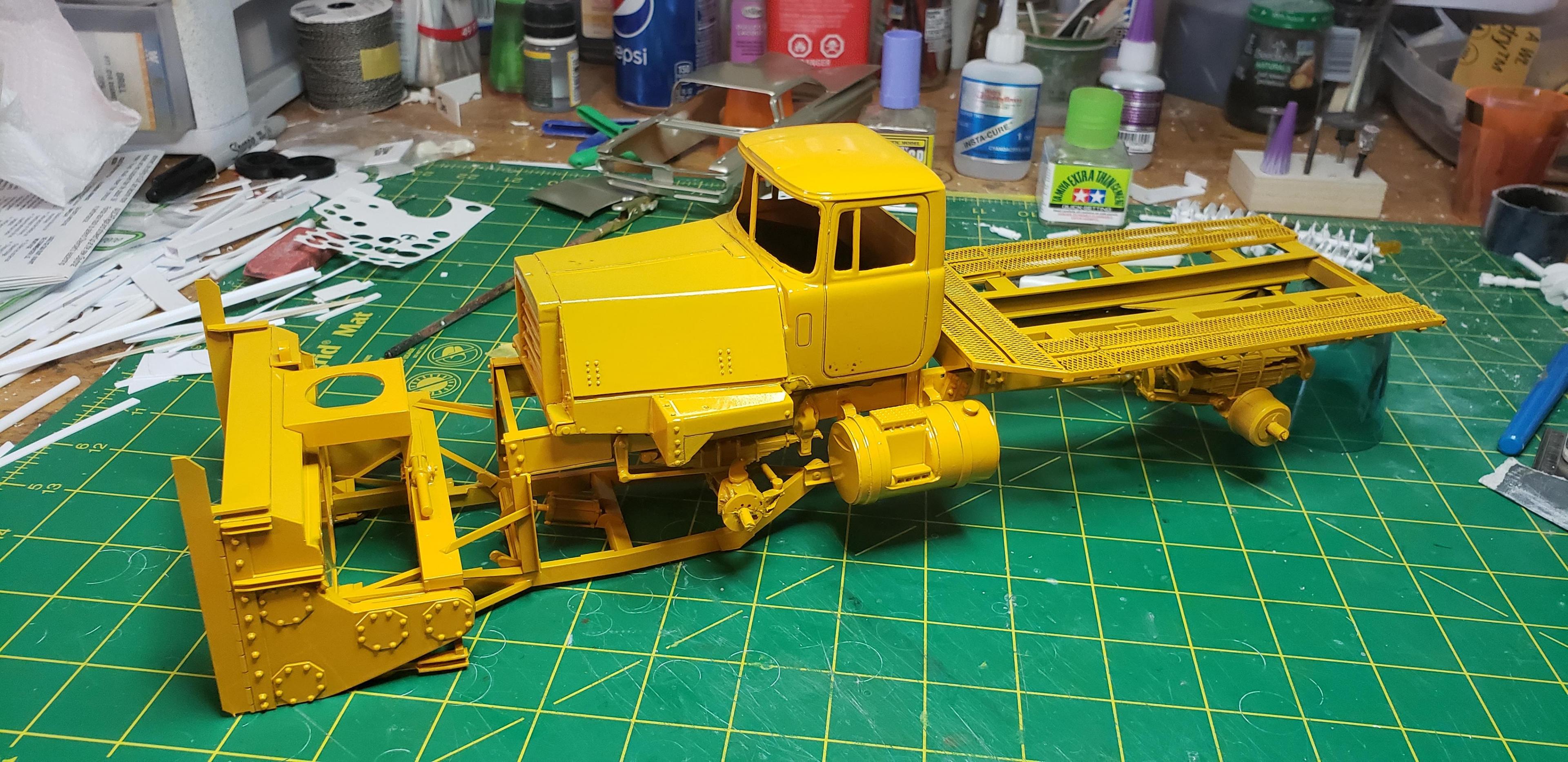

gotnitro? Posted January 18, 2021 Author Posted January 18, 2021 We have color !!!! Ended up using tamiya camel yellow after chrome yellow can was dud . As per norm w yellow coverage was poor and several coats were needed . This will be weathered so gloss wasnt a factor . Once the paint cures ill spray the black hood and blue warning stripes on back
Mopar - D Posted January 19, 2021 Posted January 19, 2021 Wow Jeff the yellow really brings out all your little details that is making this awesome!
gotnitro? Posted January 19, 2021 Author Posted January 19, 2021 3 hours ago, landman said: Absolutely fascinating!!! Thanks ! Really like how it turned out 28 minutes ago, Mopar - D said: Wow Jeff the yellow really brings out all your little details that is making this awesome! Glad it worked out that way too, seems some colors bury details . I'll take a few around truck once its cured more . I gotta break out the airbrush to add all the larger color sections , black stripes, hood and the bank cutters are red oxide ..whew a huge way to go

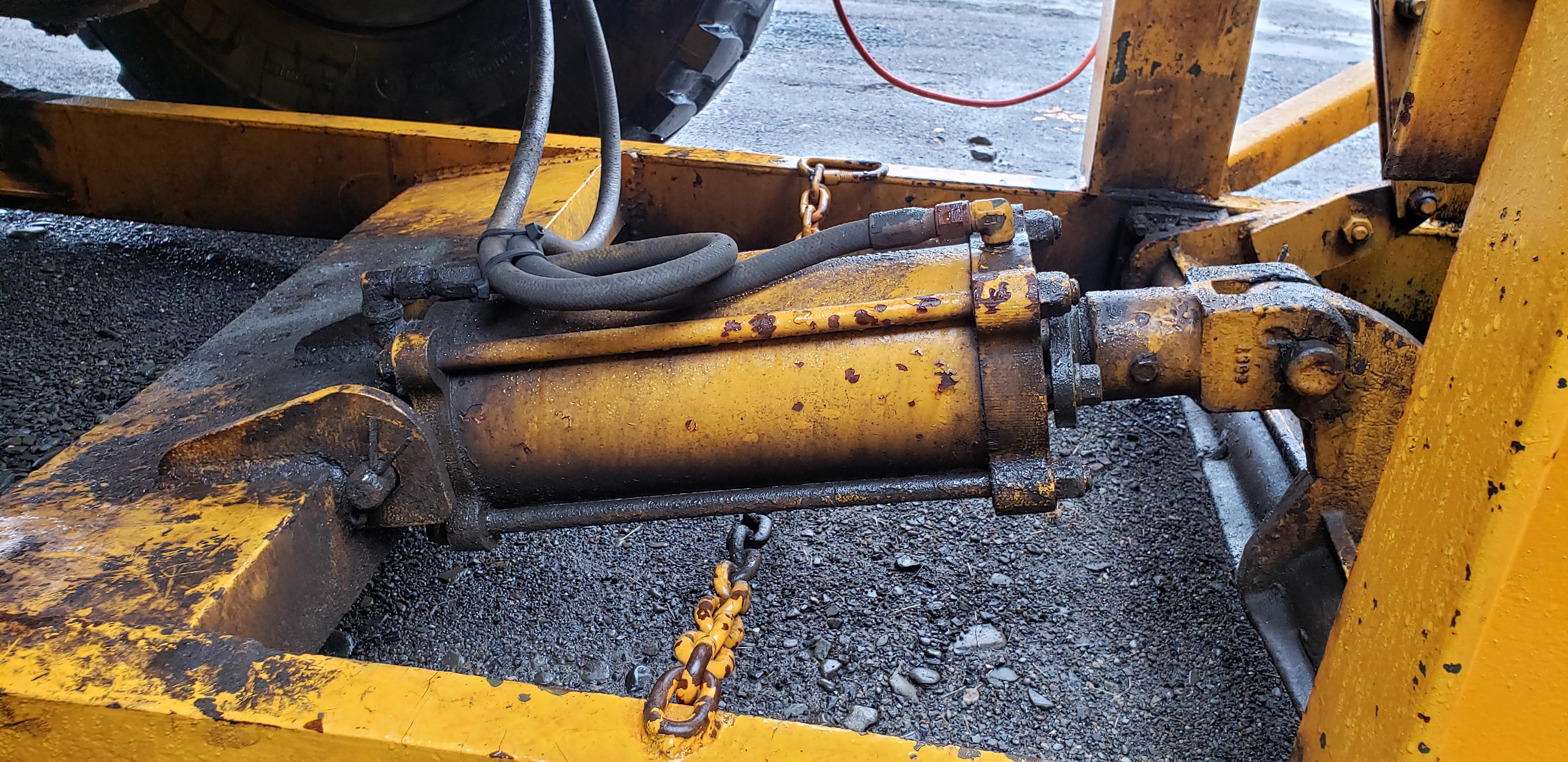

Chariots of Fire Posted January 20, 2021 Posted January 20, 2021 I'm liking it! The expanded metal screen really looks right. Just asking: How does that whole mechanism get raised up for travel? Hydraulic pistons up front of the grill?

Warren D Posted January 20, 2021 Posted January 20, 2021 1 hour ago, Chariots of Fire said: I'm liking it! The expanded metal screen really looks right. Just asking: How does that whole mechanism get raised up for travel? Hydraulic pistons up front of the grill? Not sure about this beast but I had to move one similar at NJDOT years ago, was a 1960's vintage International with the blower on the front and second engine on the flatbed. IIRC, it was air pressure that raised the blower assembly for travel as she had to build air pressure after I started her before I could lift the blower. The one I moved didn't need the aux engine running in order to lift the blower, ran off the main engine. The blower itself ran off of hydraulics, the hydro pump was on the aux engine.

gotnitro? Posted January 21, 2021 Author Posted January 21, 2021 (edited) Charles - there's a large hydraulic cylinder right below the grill that raises the blower kinda right behind front tires . 10 hours ago, Doug 1061 said: Very nice. You're a much faster builder than I am. I don't think I could do that in a whole year. Thanks its surprisingly going together quickly Edited January 21, 2021 by gotnitro? Added photo

Chariots of Fire Posted January 21, 2021 Posted January 21, 2021 I thought I saw the cylinder on the model but was not sure. Now I know! Thanks.

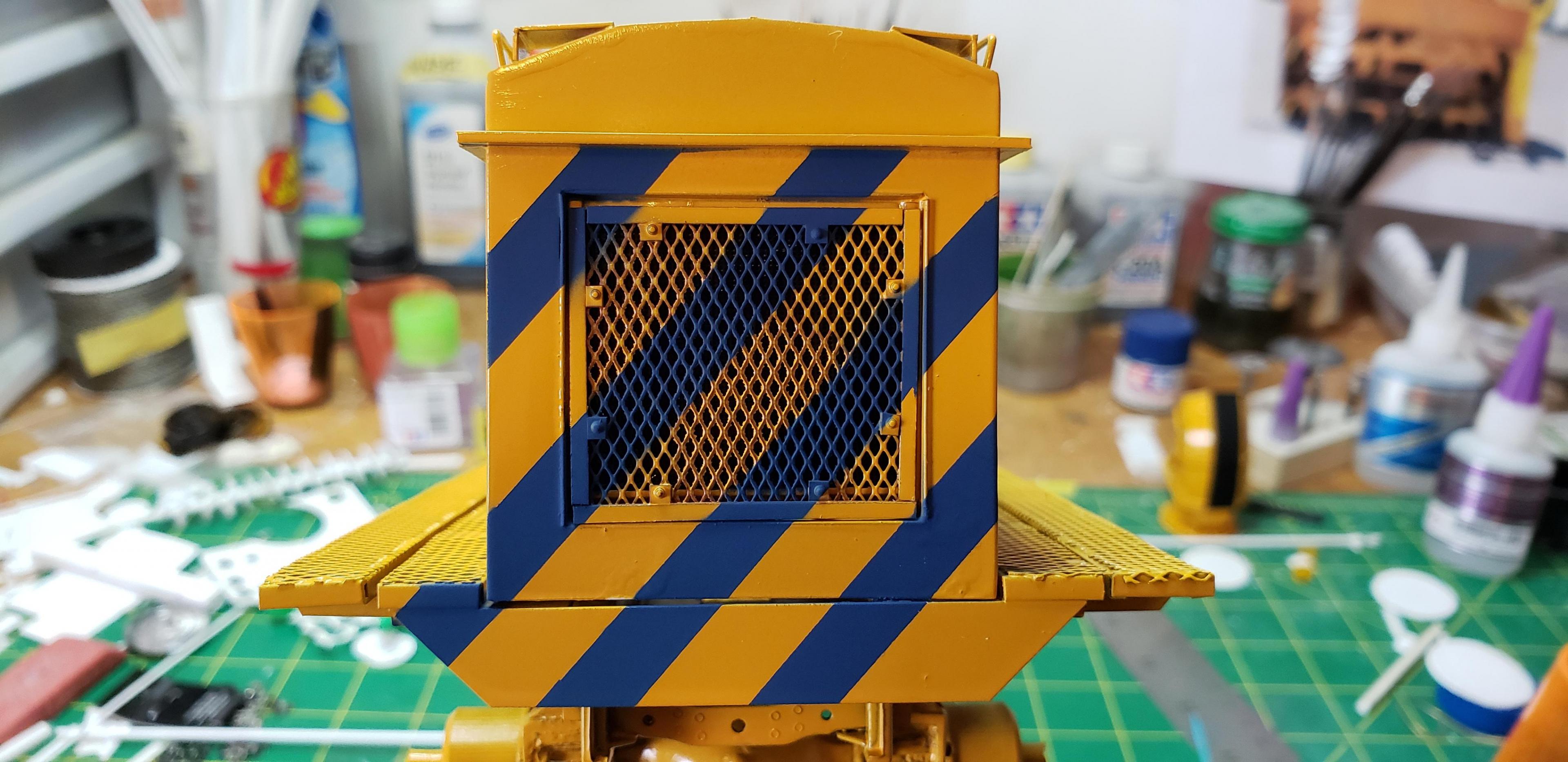

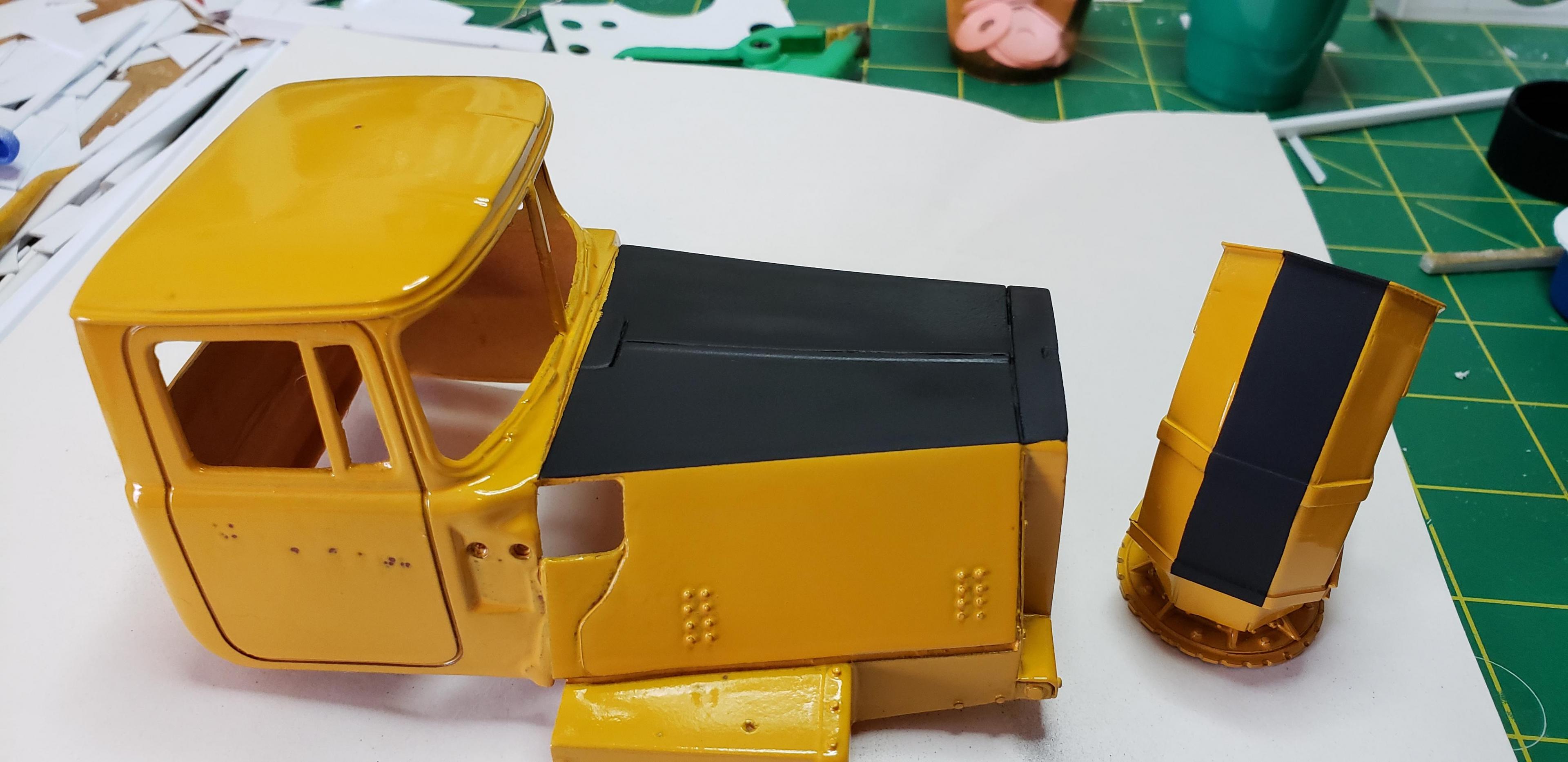

gotnitro? Posted January 29, 2021 Author Posted January 29, 2021 Update time !!! Sprayed a few detail colors on the truck once paint has plenty of drying time . The anti glare hood , and chute was airbrushed w flat black, then the blue DOT stripes sprayed across the blower engine compartment. The bank cutters also got a squirt of red primer. Looking at the chute photos I gotta add more black along the sides.. Enjoy!
Mopar - D Posted January 29, 2021 Posted January 29, 2021 Looking good Jeff. What’s that on the passenger door?
