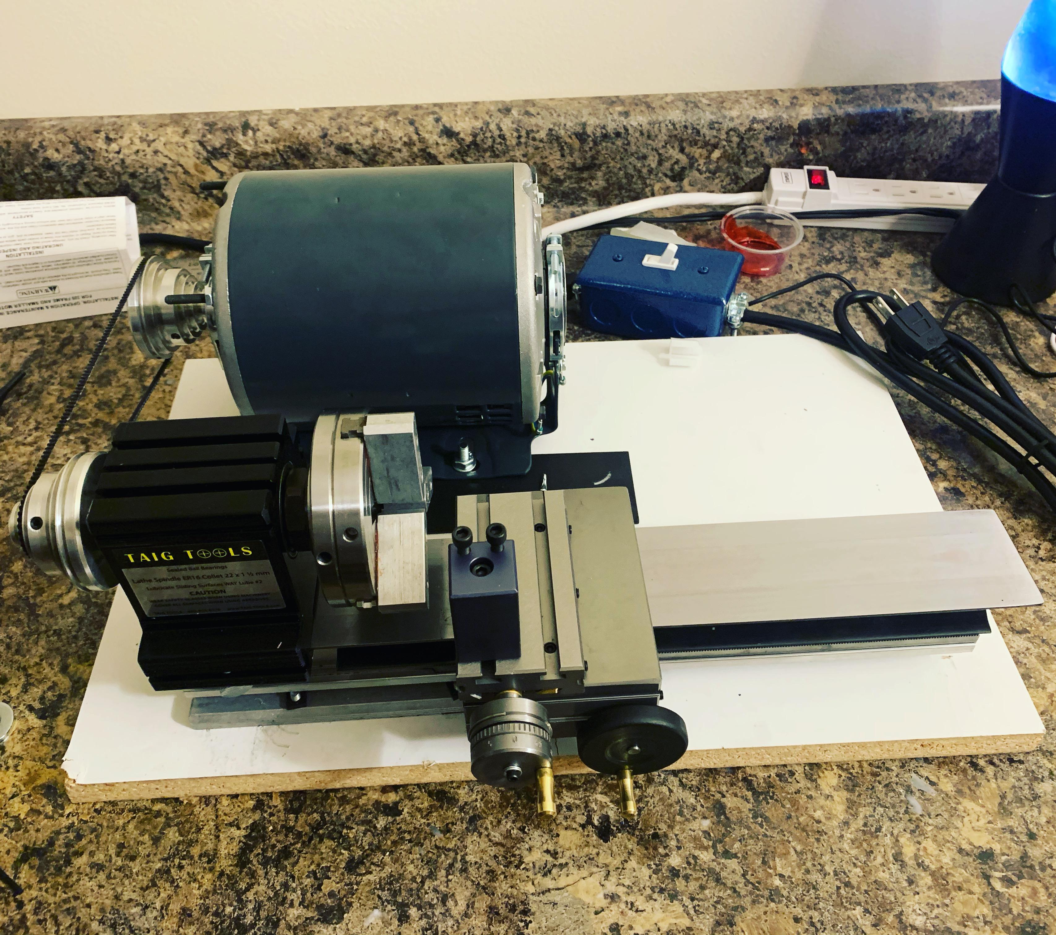

OldNYJim Posted January 25, 2021 Author Posted January 25, 2021 Thanks for the continued comments guys - appreciate you taking the time! I just recently bit the bullet on the Taig Micro - I’ve only been messing with it for a couple of weeks but I’m really enjoying it so far. Too soon for me to properly review it, but it seems well made and is doing what I hoped it would!
Aaronw Posted January 26, 2021 Posted January 26, 2021 Good I hope you enjoy it. Just having a decent lathe to play with will teach you so much.
