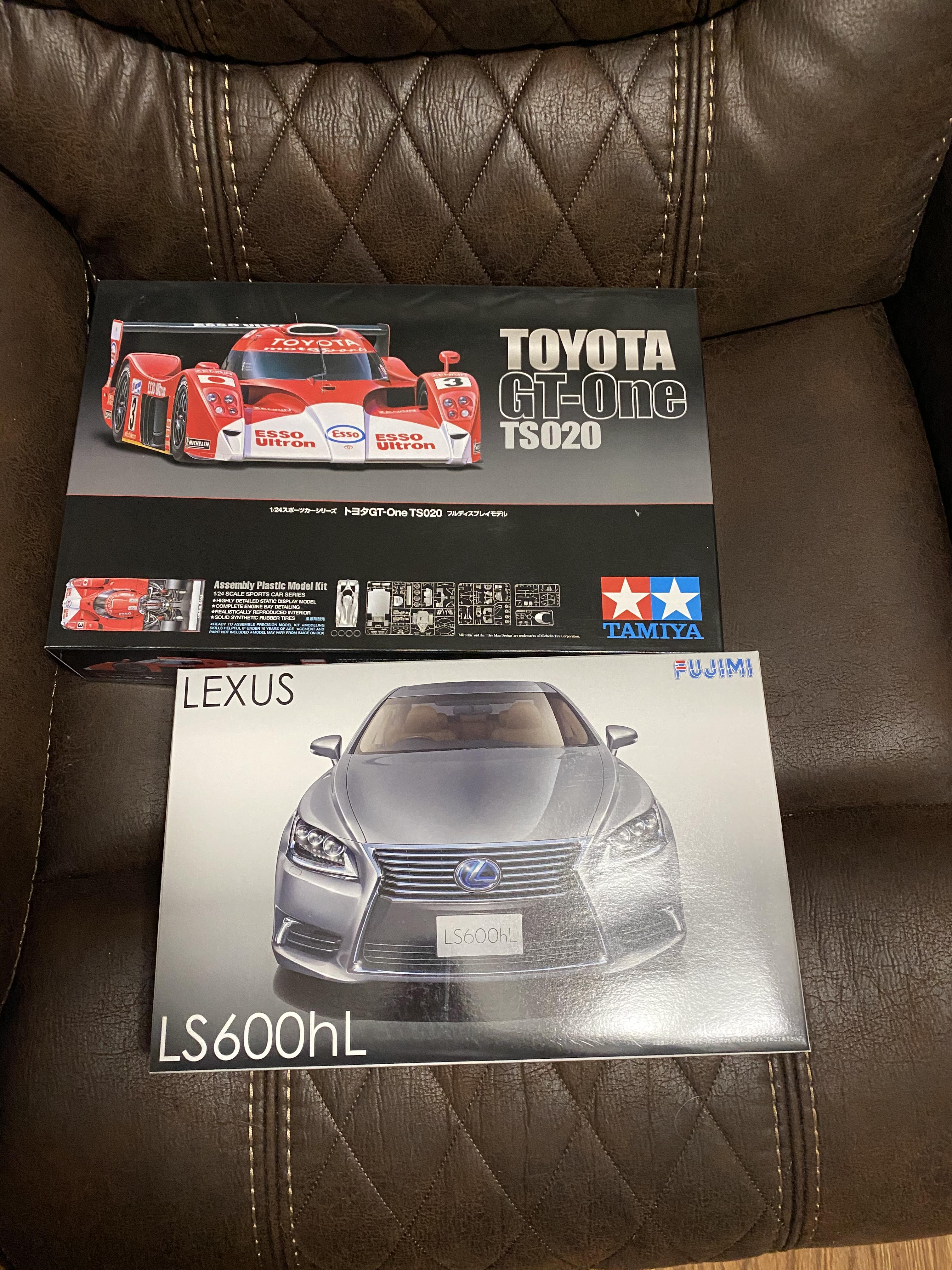

  On 1/14/2021 at 5:08 AM, Northwindcustoms said:
I hope I am doing this in the right place I would like to join this build with the merge of a gt1 endurance car and a Lexus I plan to keep it in the spirit of the current era of cannonball era with a twist . I will keep it updated as I build If all goes to plan will be mid engined with a stock outer appearance will most likely have a bunch of 3D parts required and it goes on . Sorry for the long post it’s been 10 years since I have been on a forum . I look forward to seeing all the great builds on this theme .mike
Expand
You are in the right place Mike, welcome to the forums. Guys, Mike is a member of my local face-to-face model club and an excellent builder. He provided the 3D printed, twin turbo SBC for my build.

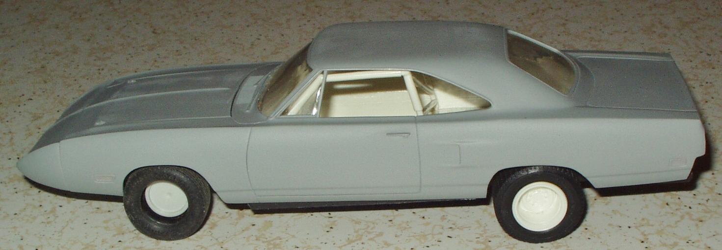

Stupidbird in its second coat of primer, now sitting on its own chassis (not the borrowed one) with the tires I'm planning on using.
Cazart! The chassis wheelbase is too long! :angry: I noticed when I was setting it up that the underside details were a little different from those on the borrowed stocker chassis but didn't think too much about it, just assumed one was an original issue and one a later reissue, or something. Now I guess it's from some other JoHan Mopar. What, I wonder--the '68 Fury police car? At any rate, looks like I'll have to shorten it by a couple scale inches to look/fit right. :unsure:
Nothing is easy in this hobby, is it? :angry:

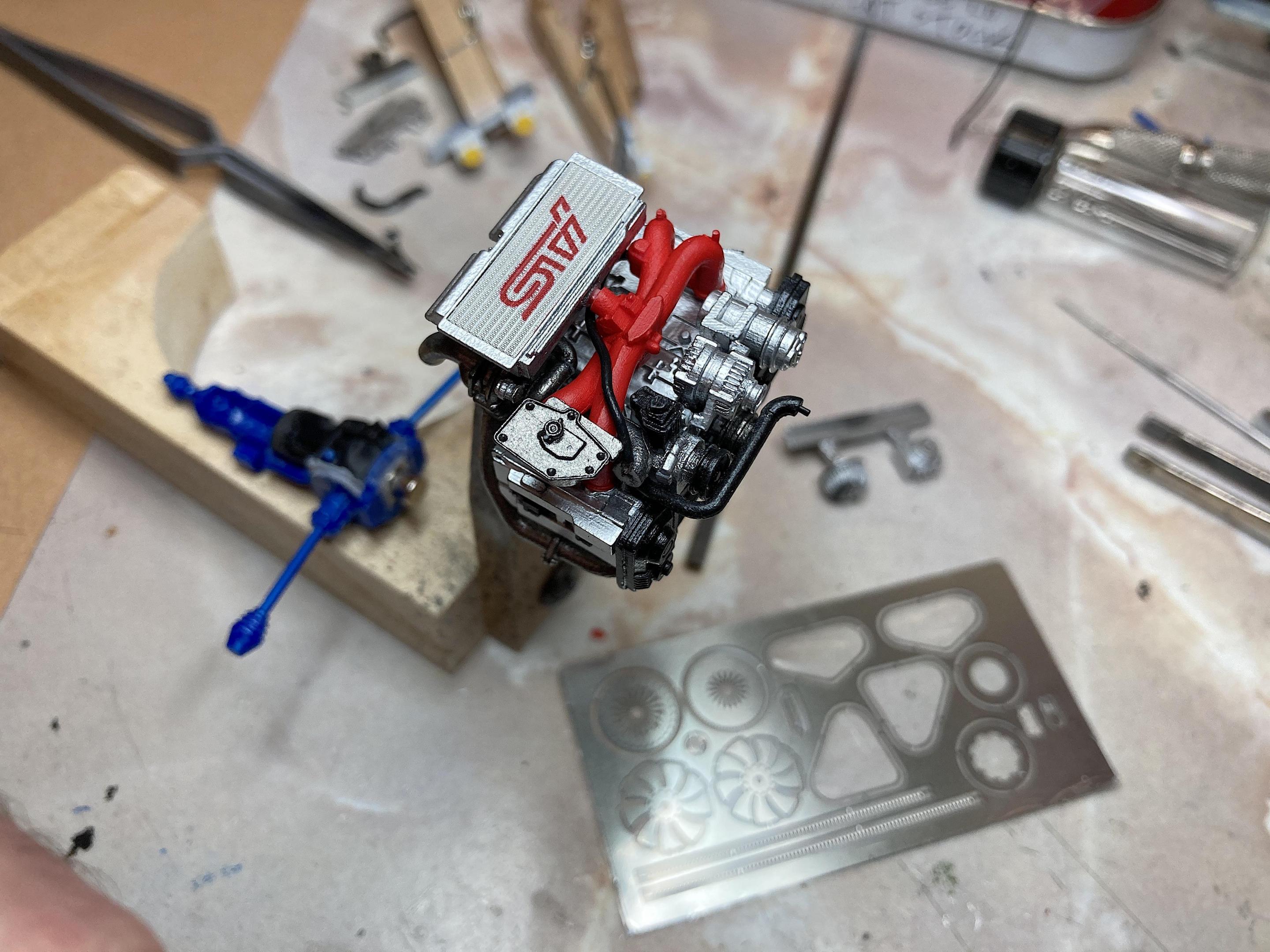

Using a trick that Mark D. Jones does, magnets for sub assemblies, for the engine to transaxle.  The Hobby Design engine is very detailed, but it's a bit rough because of early 3D printing resolution.  It came with a photo-etch clutch assembly which I'm not using on this project, might have a diorama that could work.  Seeing what others are going to race with, I'm hoping the weather will really suck.  ?

That engine looks great.

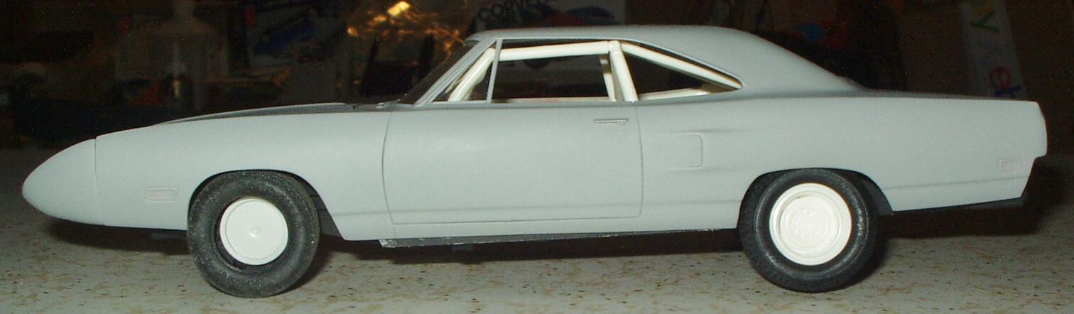

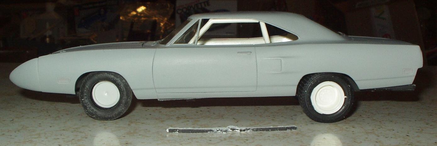

I chopped .090" (about 2.5 scale inches) out of the chassis and glued it back together. That looks better! The removed slice is also shown.

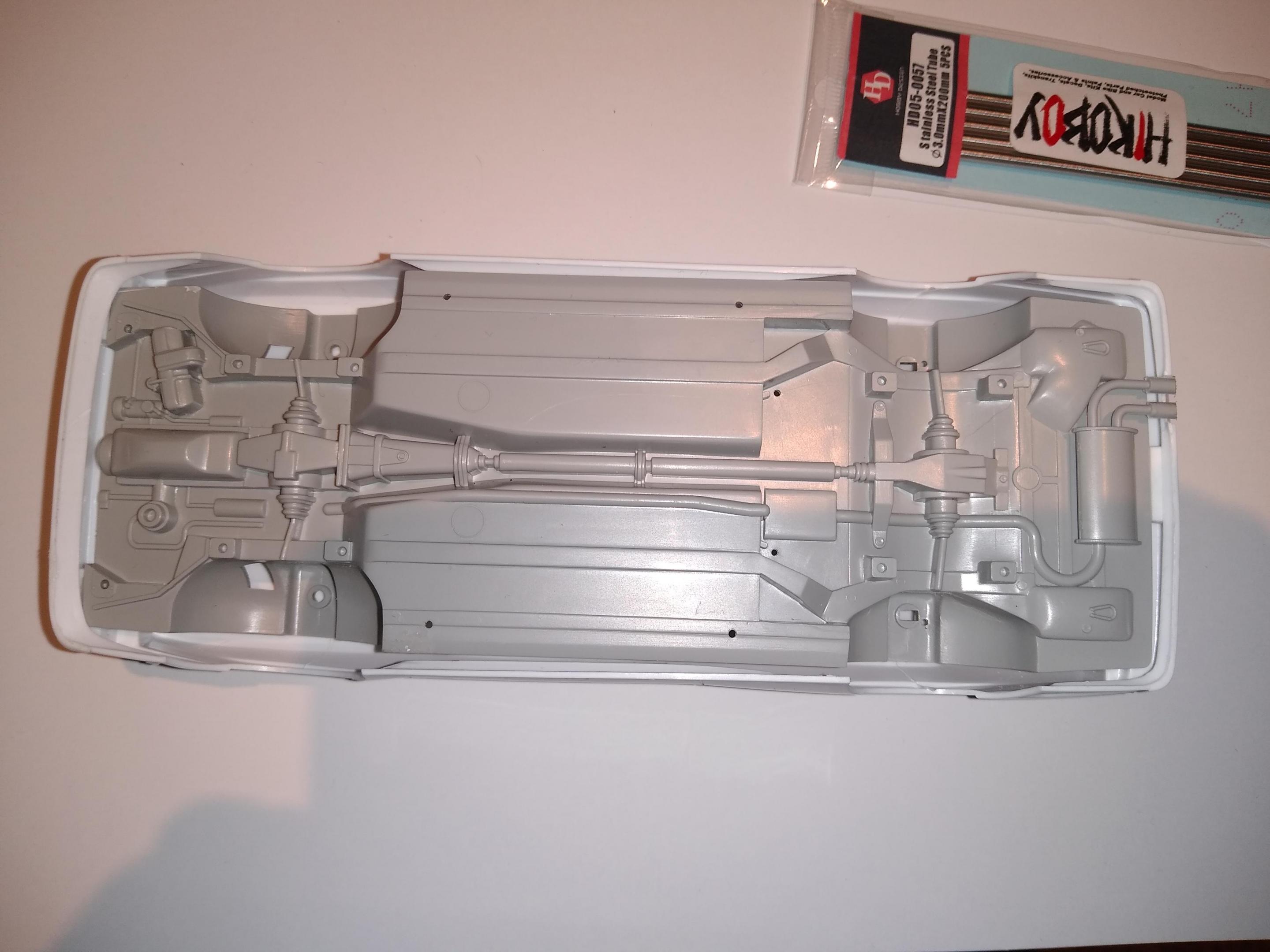

#5 Audi Quattro

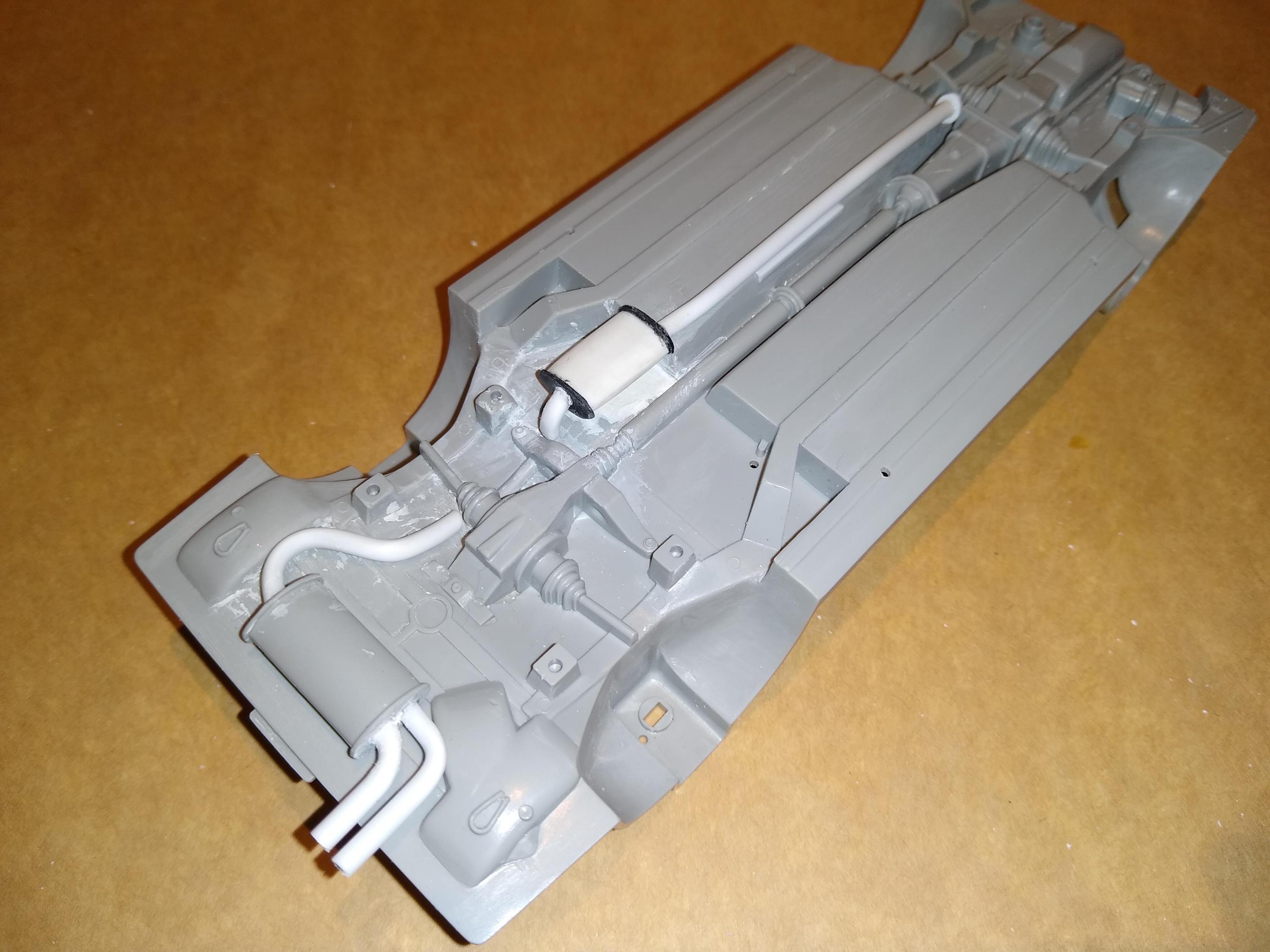

Got some 3mm steel tube to replace the puny exhaust tips, but the rest of the (largely moulded) system was equally unimpressive and needed to go:
Removed the moulding with a chisel blade & tidied up with putty. The replacement pipe is 2.4mm tube with a wire insert. Made the centre muffler from layered/shaped plasticard:

Way cool! You are shaming me into doing some kind of upgrade to the molded-in exhaust on Stupidbird (darn you!)! B)

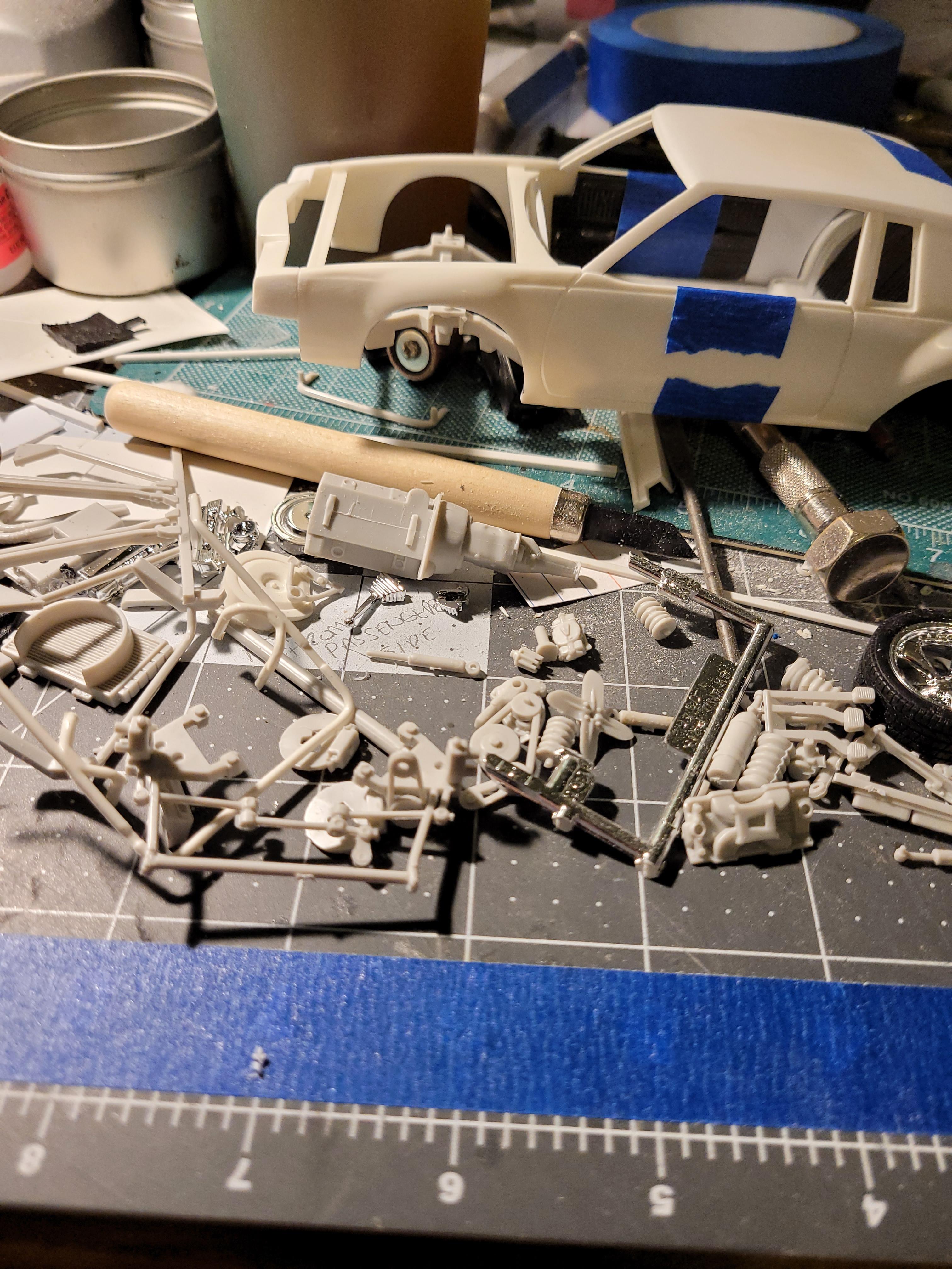

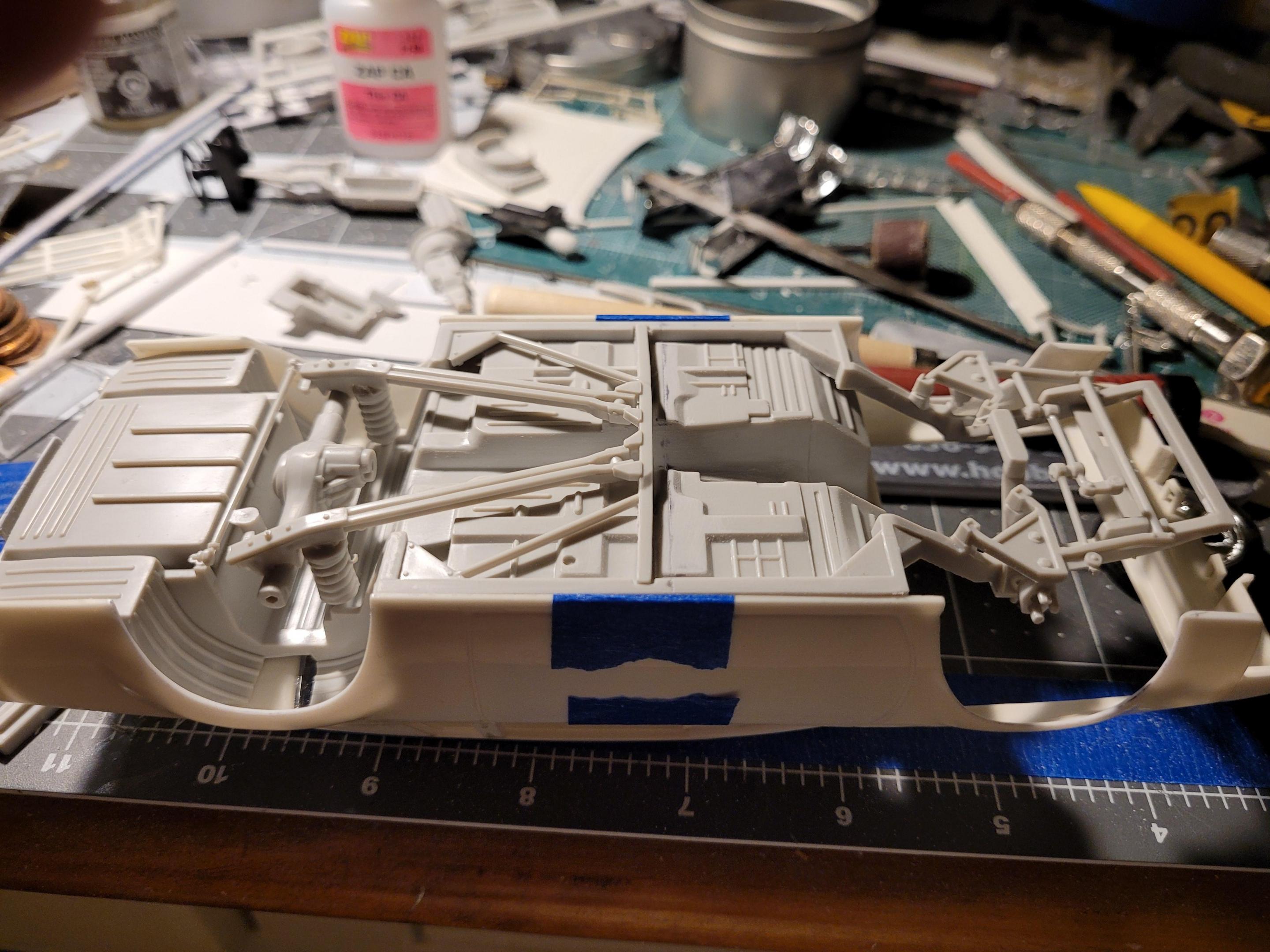

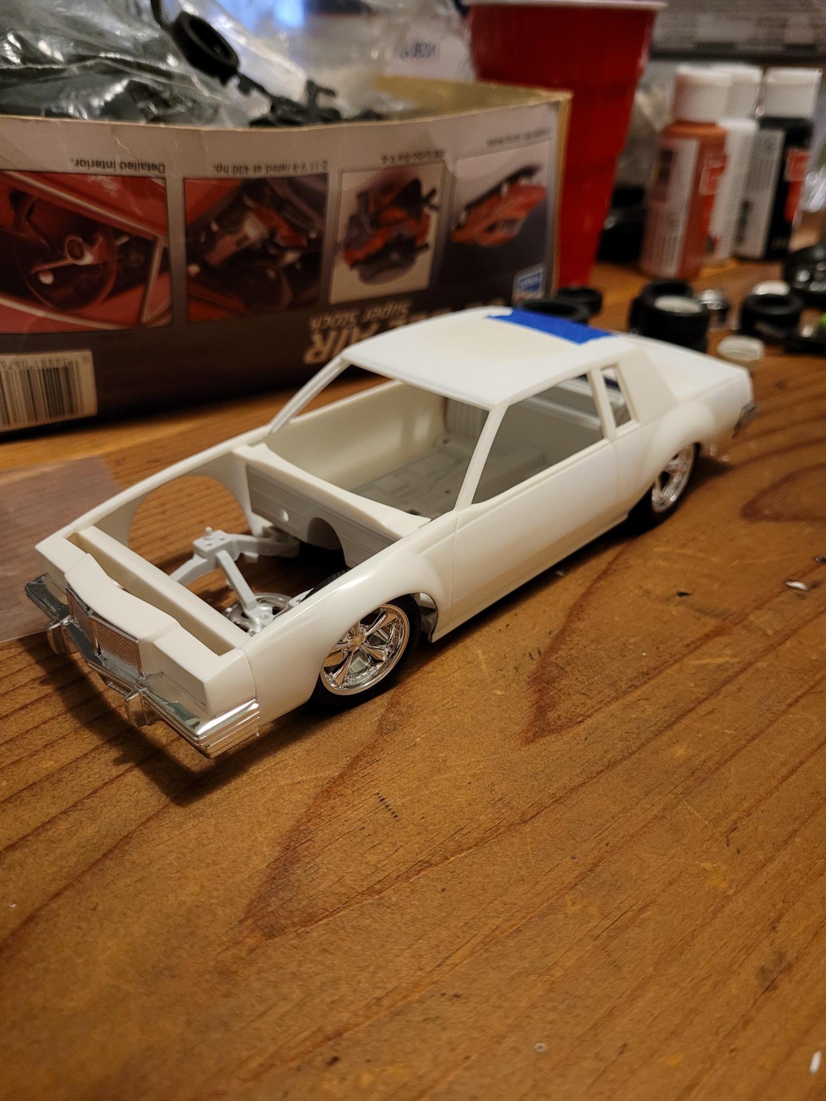

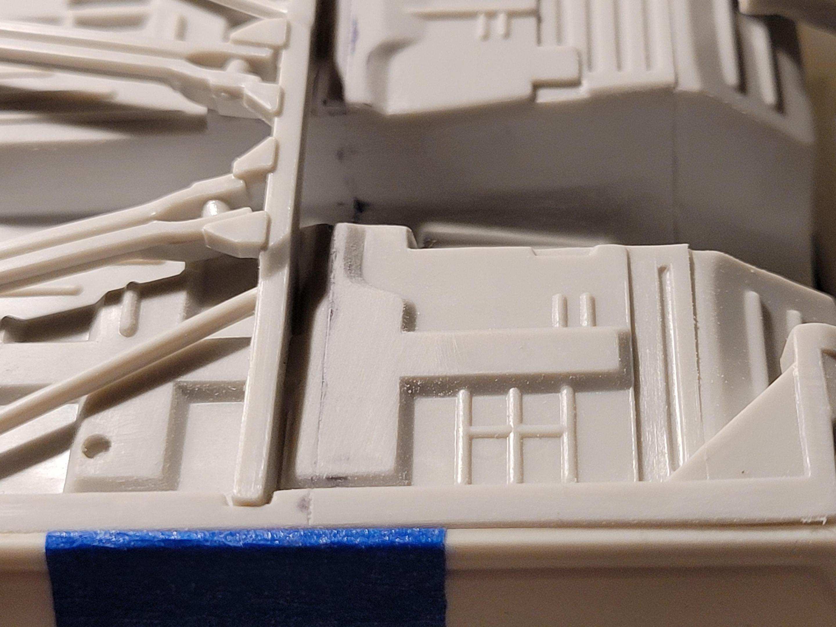

Well I got the chassis shortened about an eight inch to fix the wheelbase.
20210115_204915.thumb.jpg.08983066a8e3e8e281c36326b6a2a5f9.jpg20210115_204905.thumb.jpg.9cf571cf7c49c8dab2eb9c3ae5e151a7.jpg

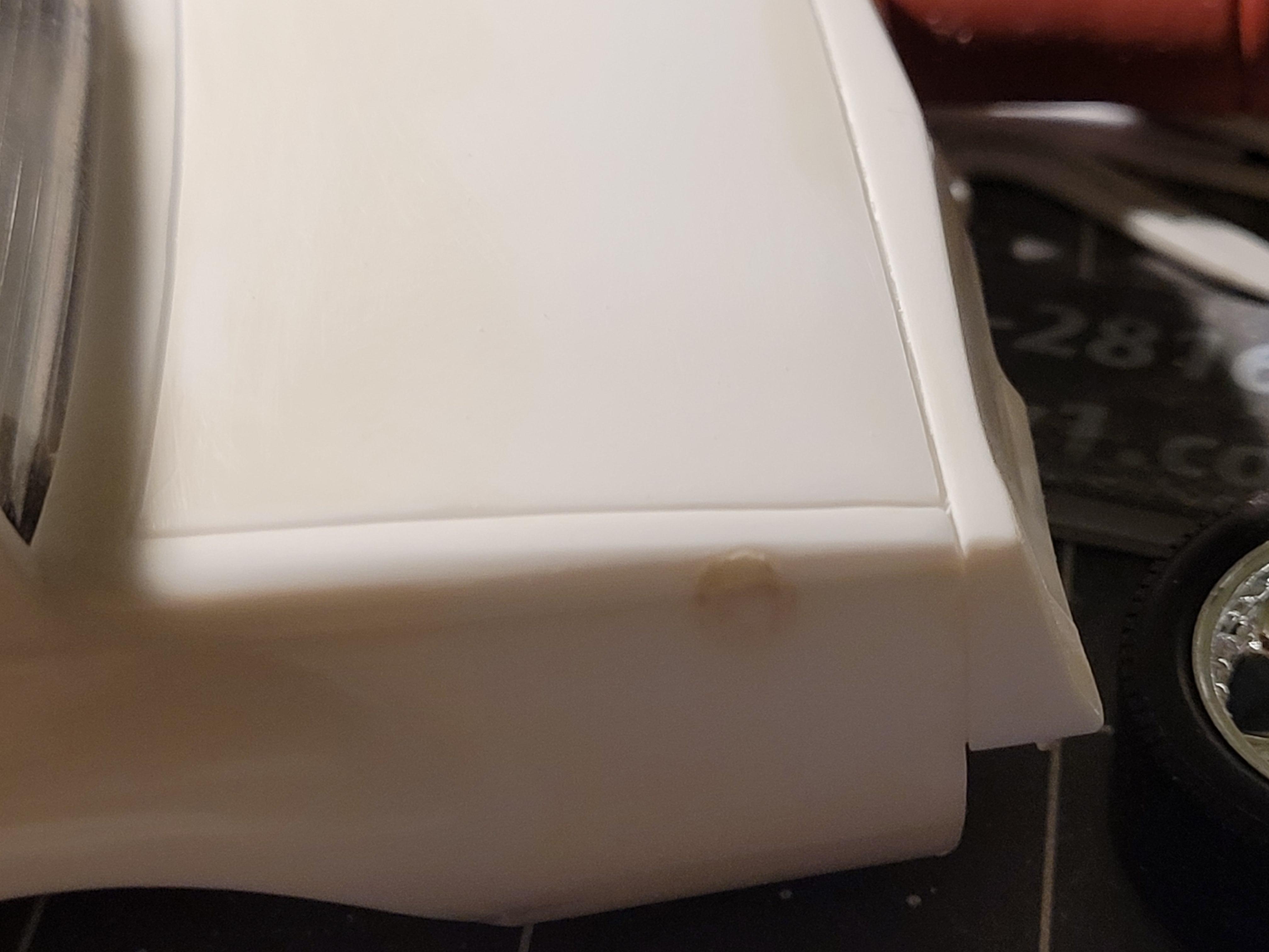

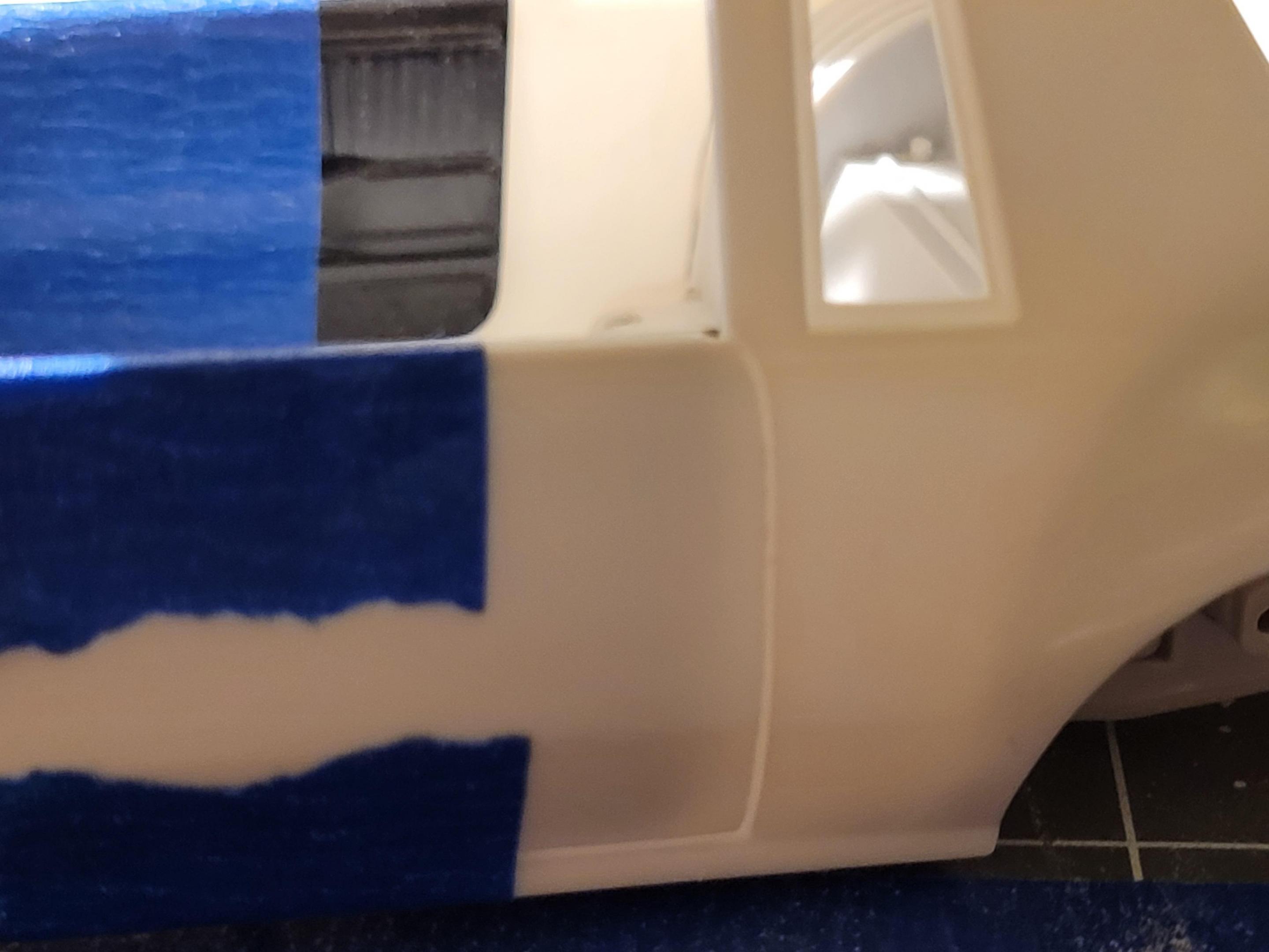

Removed the door handle patches , hood and trunk pins, and the fuel filler.20210115_204952.thumb.jpg.74e9ace39c3cd256f3fbc96893c582c5.jpg20210115_204941.thumb.jpg.72306dcdb3bfea442d2767fc68fd3ac8.jpg

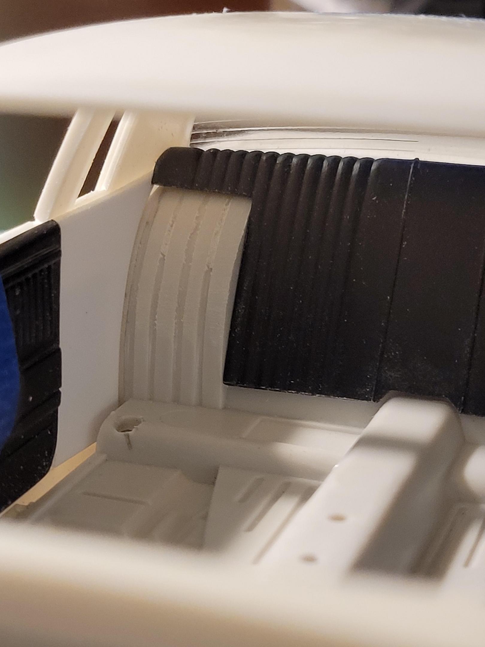

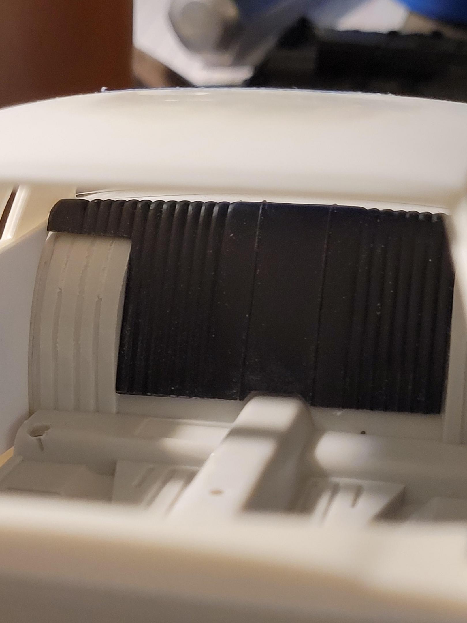

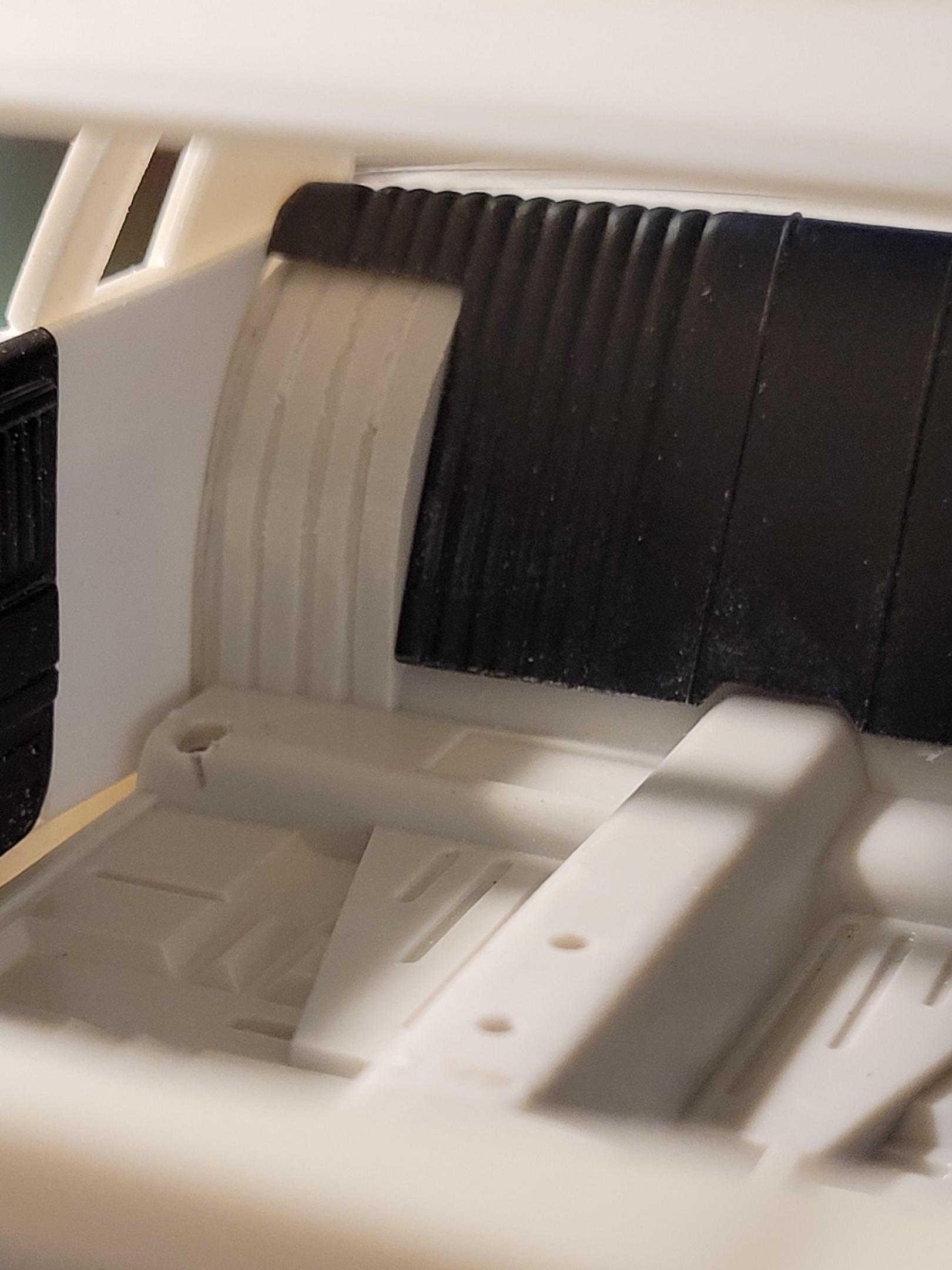

And also made rear interior quarter panels. Also cut the rear seat to at least look like it's there.
20210116_034057.thumb.jpg.1f1b1f45ba3052c9a6884de18ea48e23.jpg20210116_033940.thumb.jpg.70270deecb12048fa95ad0774e2250f5.jpg

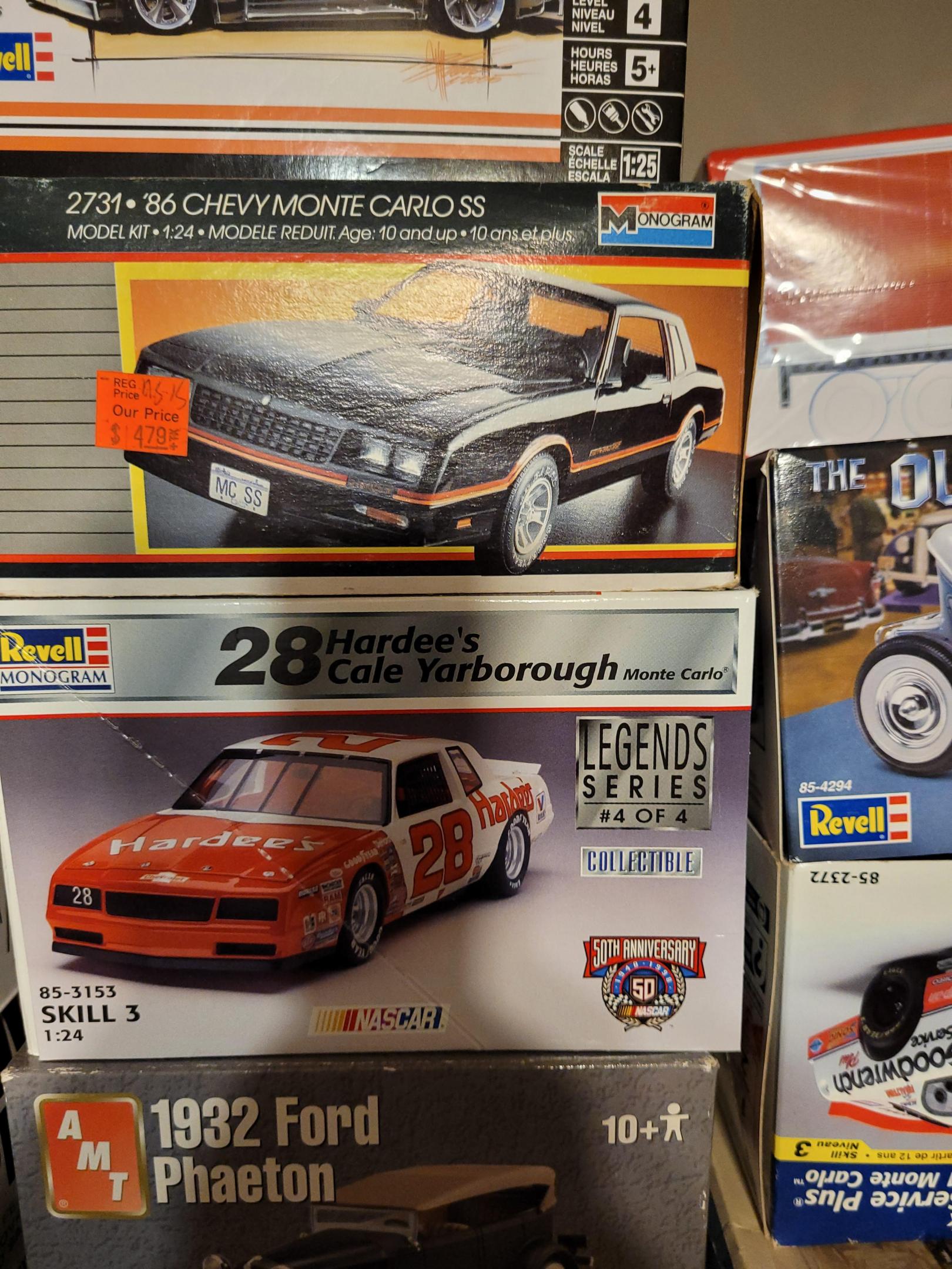

I've been looking for a kit that trips my trigger, ever since the idea for this one was announced. But nothing has really done it for me. I love the concept, but nothing grabs me.
But... I have an idea... and I think I'm going to jump in with this.
I realized earlier today, I have this and several Monogram Nascars as well... I'm going to rob parts that I need from any of those and some factory monte's also. And I have a few 3d and resin options to pick through engine wise.

The nose,  hood, and rear bumper are pretty much interchangeable. The deck lid and taillights look like they would work too.
Expand
That's what I was hoping. I was planning on using the lights and mirrors and little things things here and there.

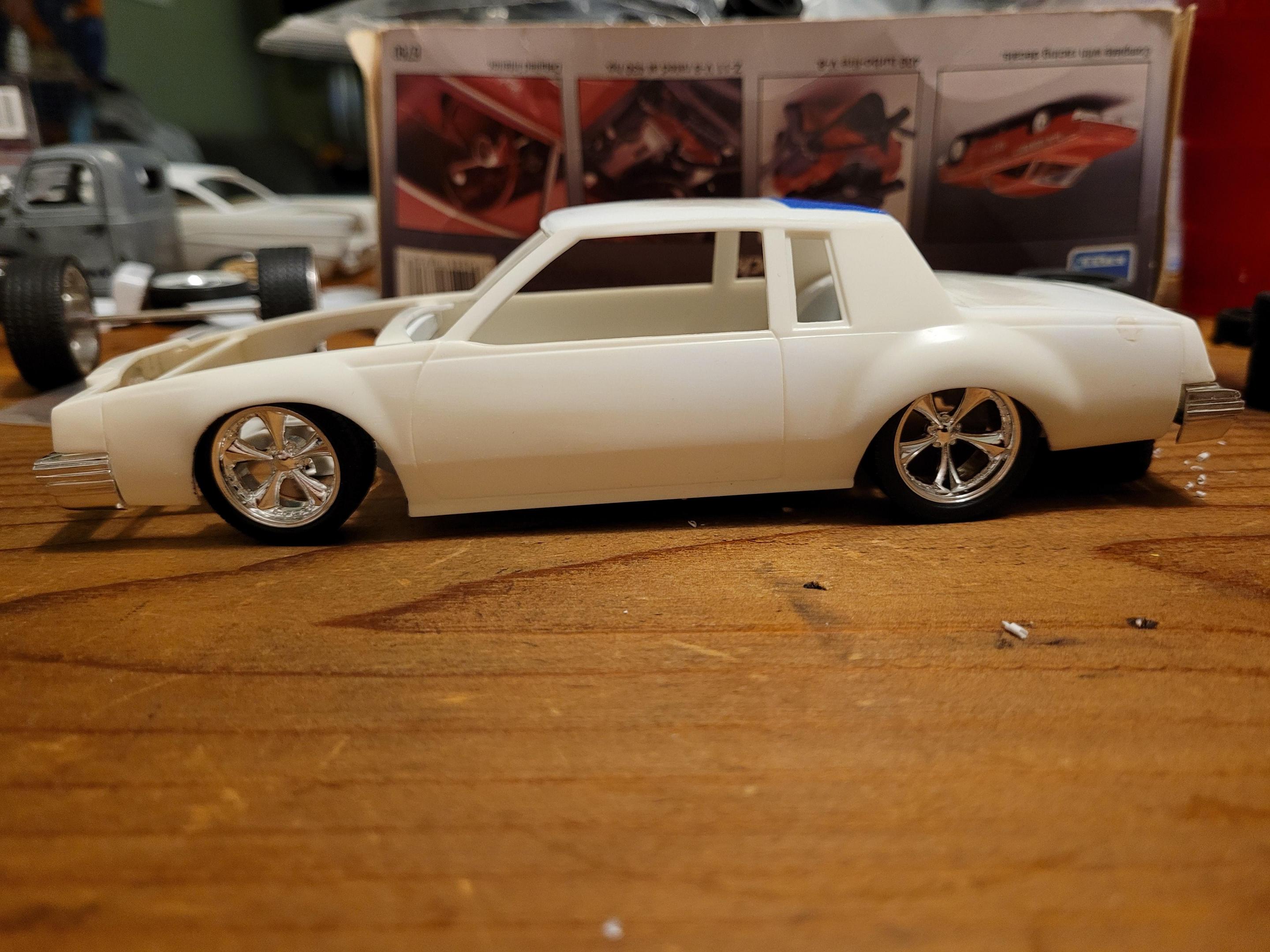

Going for a more raceworthy rendition of the olds I did a couple years back... Maybe. Still have to decide on color(s)
