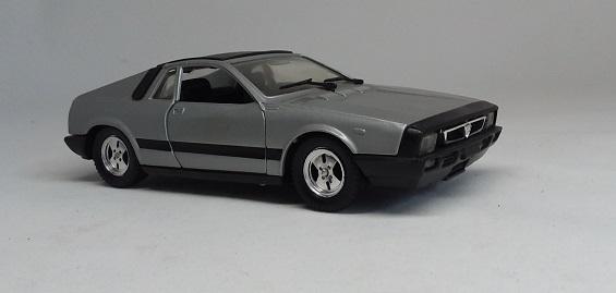

afx Posted January 12, 2021 Posted January 12, 2021 (edited) Esci issued the kit in short-tail and long-tail forms. Short Tail: Long-tail Doing a build of the short-tail. For the few that might be interested you can follow along here: https://race-car-models.proboards.com/thread/2408/lancia-beta-montecarlo-short-tail?page=1&scrollTo=23079 Edited January 12, 2021 by afx
