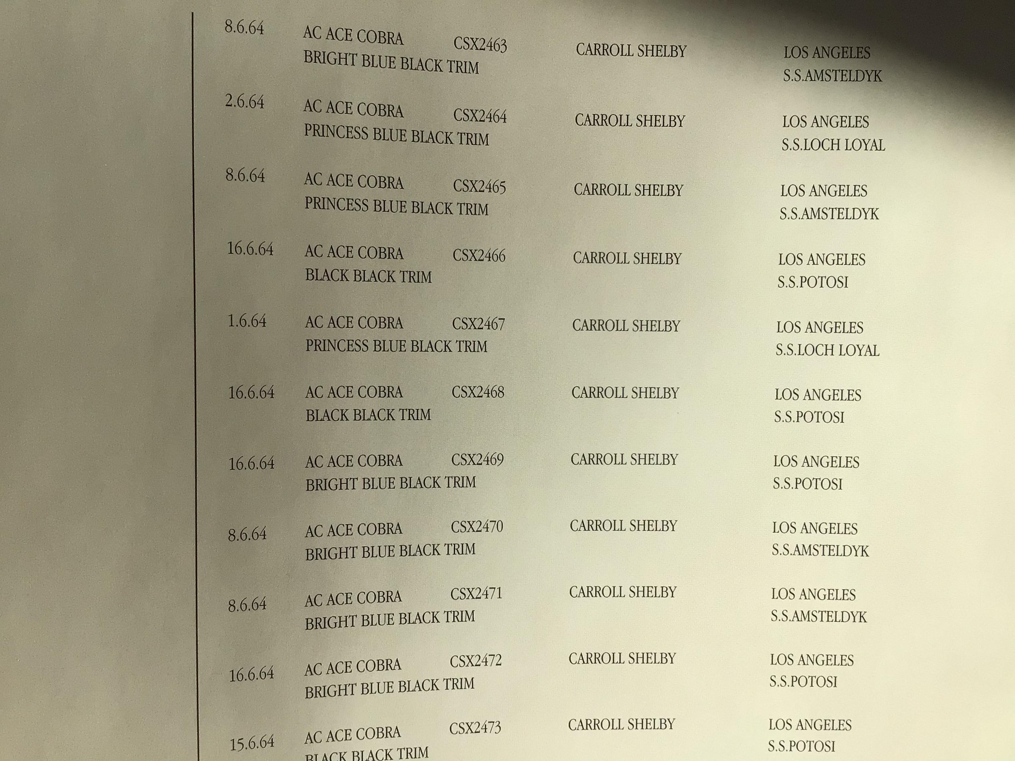

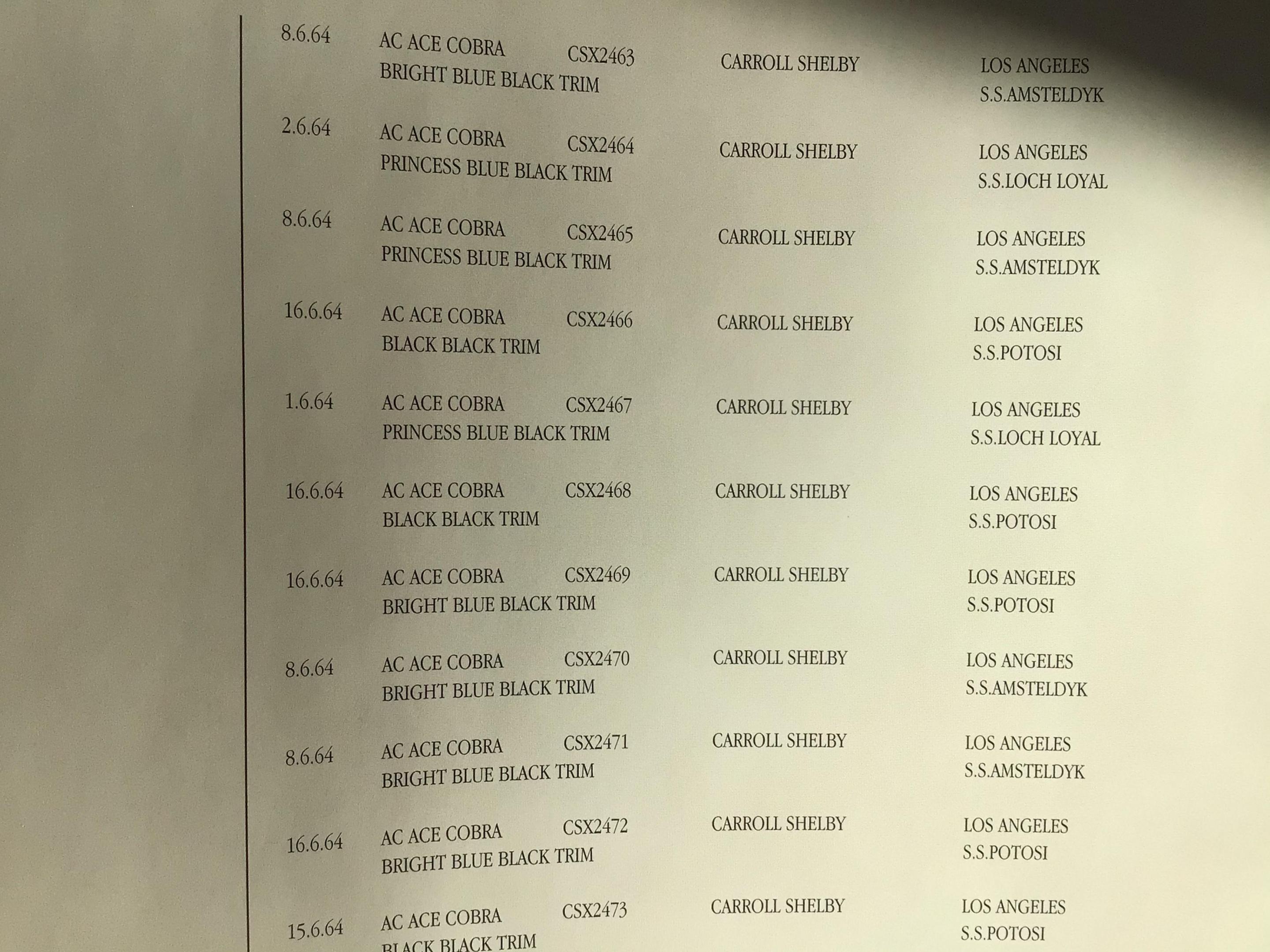

vamach1 Posted March 3, 2021 Posted March 3, 2021 2 hours ago, absmiami said: https://worldwideauctioneers.com/listings/private-treaty/1965-shelby-cobra-daytona-coupe-csx-2469/ for sale; Shelby's Daytona without a racing history - it appears to be "show-room new" which is almost weird - but its a Daytona ... walk-a-round might help with some last minute details enjoy It’s not one fo the original six and it’s not one of the twenty that McClusky built from “new” chassis. It appears to have been born a 289 roadster and converted to a Daytona Coupe. The Original six are CSX 2286, 2287, 2299, 2300, 2601 and 2602 per Pete Brock’s book from 1995. I believe the McClusky chassis are 2603-2623 but I am not sure. Many would say those are not real Daytona Coupes even though they are almost duplicates in every sense. I’ve attached the page from the book COBRA The first 40 years that shows CSX2469 which from the description should like Shelby wanted to have a Daytona Coupe since they original six race cars were used up and Ford was pushing the GT40 program so they sold them off for hardly anything. I suppose that one is where McClusky got the idea to build one more for Shelby after restoring some of the original ones over the years. My neighbor has the one featured in R&T magazine in 2015. I got to ride in it on the pace lap for a race. ? Back to the HRM model - I spoke to Brad (Harold Bradford) today and he got just gotten out of the hospital after a few weeks and he sounded okay but pray for his recovery or send him well wishes. He left a message that he was sorry the resin kit he made for was taking so long. There are not many people left around with his dedication to the hobby and his customers and Maryland Automotive Modelers Association members. He enjoyed the pictures I printed and mailed him last month that I took at the Boulder CO Shelby Collection in early January. I will send him pictures of Josh’s build when it’s done. I need to get my butt in gear and start on mine.
