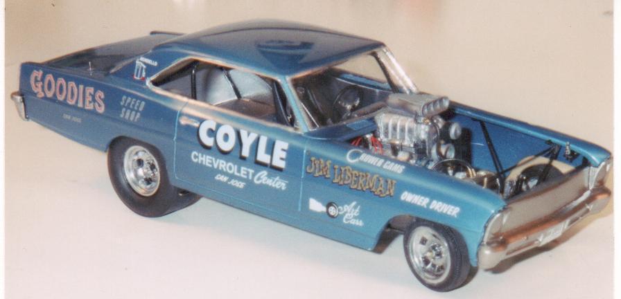

nitro norman Posted March 1, 2021 Posted March 1, 2021 I just ran across this pick on facebook. Maybe it will help with your build. 1

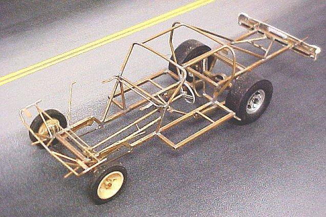

nitro norman Posted March 1, 2021 Posted March 1, 2021 On 2/17/2021 at 6:49 PM, Snake45 said: The '66 car was completely different, with long nose and altered rear wheel openings. No idea what kind of chassis was under that one. These are some pics of Roger Lee's chassis for the longnose Nova ( '66 ) He was kind enough to share them with me for reference for my styrene version. I have read that J Jim built the real chassis himself on his garage floor. 1
magicmustang Posted March 1, 2021 Posted March 1, 2021 9 minutes ago, nitro norman said: These are some pics of Roger Lee's chassis for the longnose Nova ( '66 ) He was kind enough to share them with me for reference for my styrene version. I have read that J Jim built the real chassis himself on his garage floor. Now that is good information. Never seen those before.
