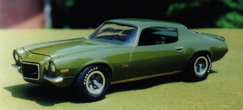

Snake45 Posted March 27, 2021 Posted March 27, 2021 Yes, just clearcoat it. The Model Master lacquer system was based on flat basecoats with clear glosses. About 30 years ago I painted this Camaro with Model Master military Flat Interior Green 34151 and clearcoated it with Model Master Clear Top Coat enamel. Came out fine.

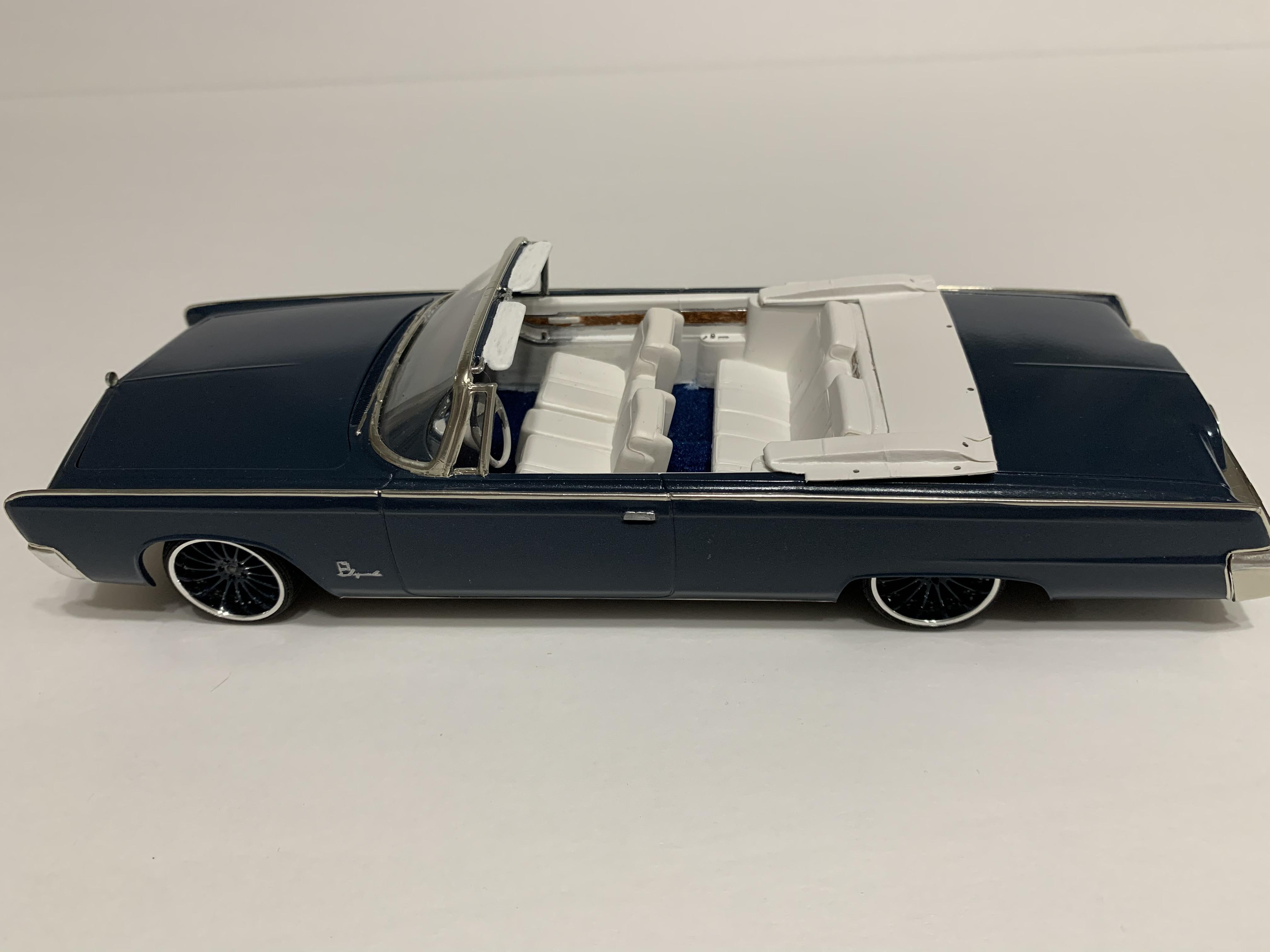

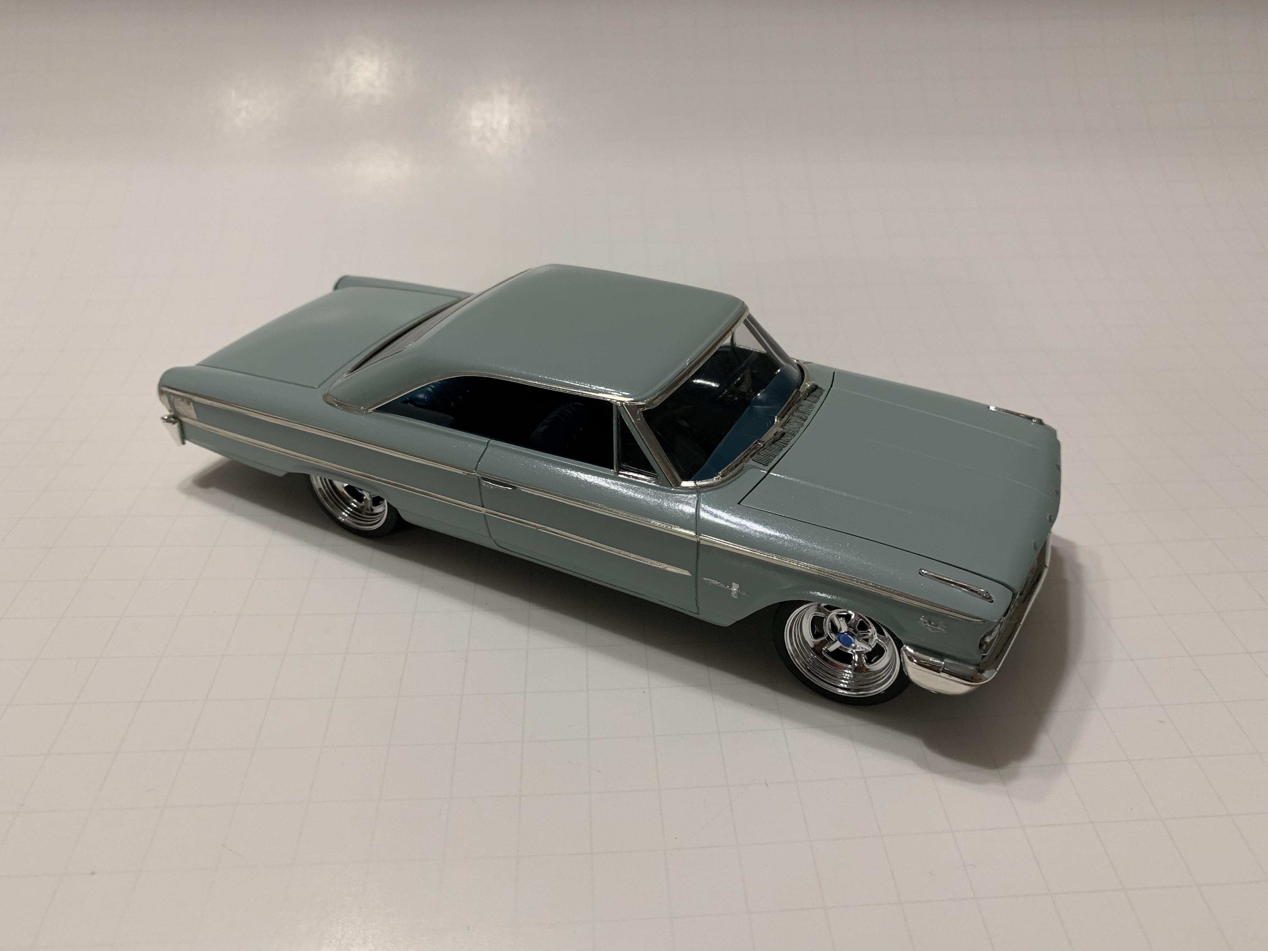

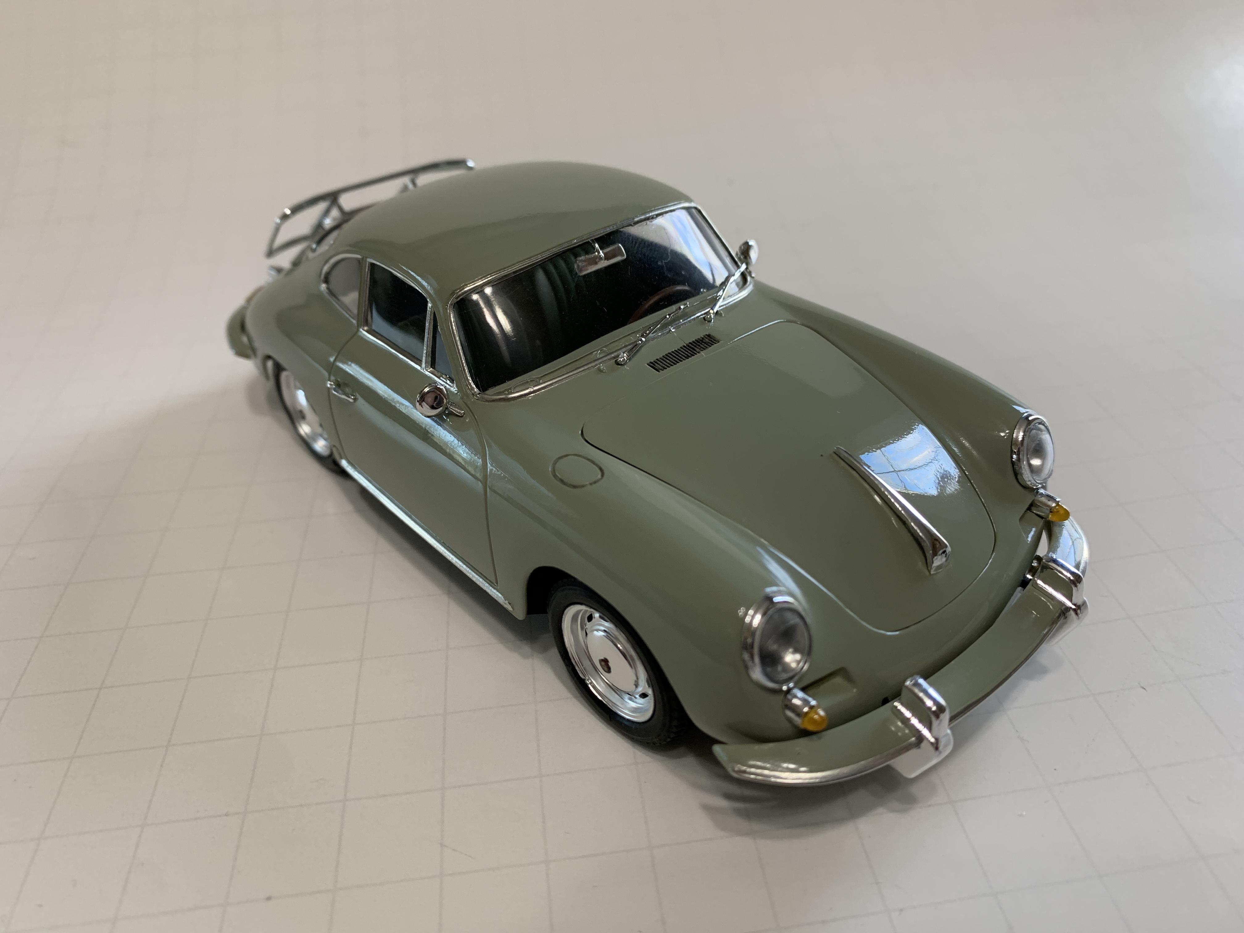

BeakDoc Posted March 27, 2021 Posted March 27, 2021 (edited) To expand on what Snake said; gloss clear, wet sand and polish will make her shine. Testors Wet Look clear and Model Master work great over Tamiya paints. A word of caution, though, I’ve never had any success spraying Tamiya products over Model Master products. The following builds were all Tamiya AS (dull) lacquers with Testors Wet Look clear. The Galaxie and Imperial got a coat of Tamiya Pearl Clear between the paint and gloss clear. edit: the Porsche is the AS-29 Gray Green you mentioned in your original post. Edited March 27, 2021 by BeakDoc

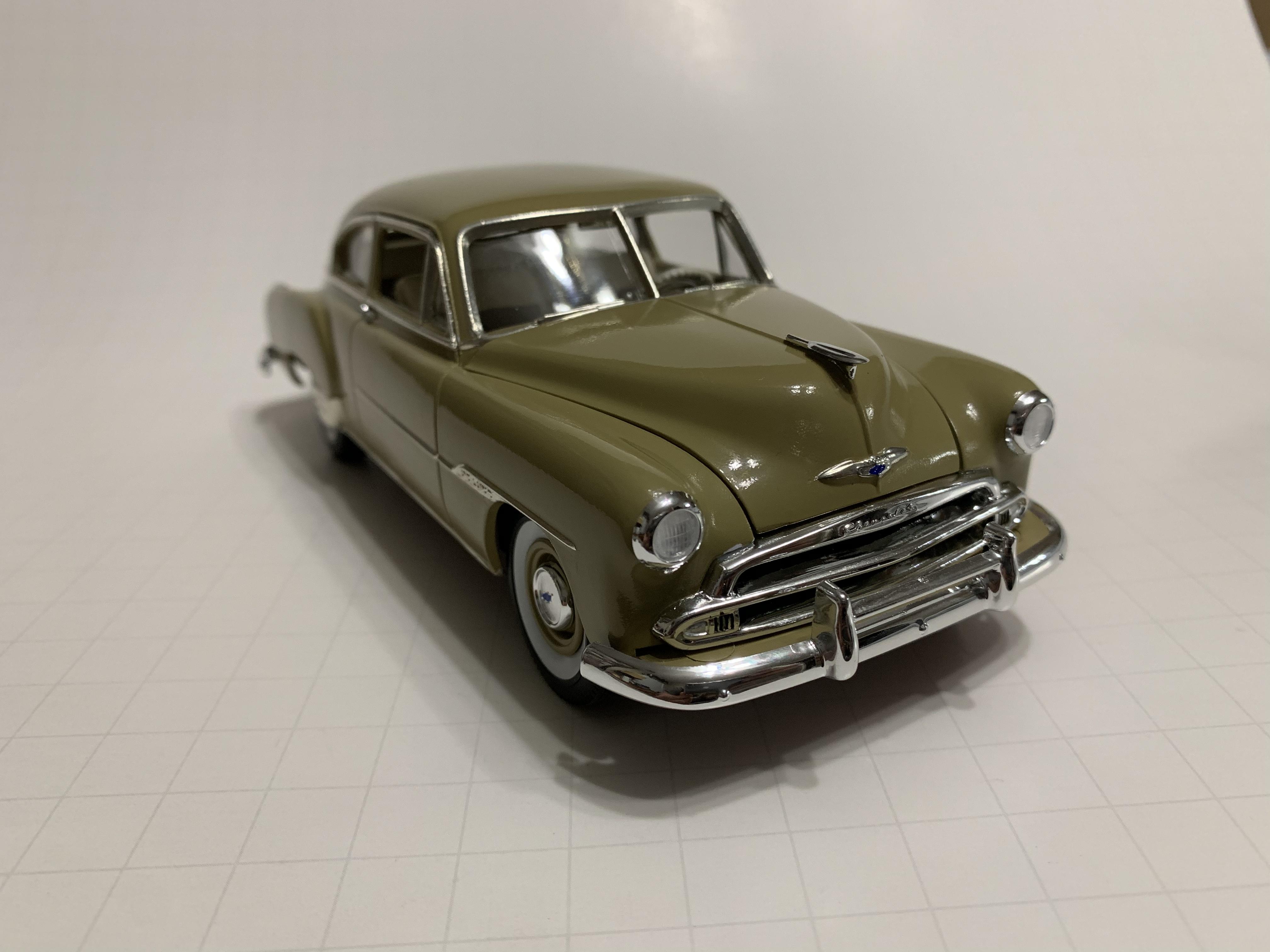

Plowboy Posted March 27, 2021 Posted March 27, 2021 I would recommend using TS-13 over the AS-29. I've also sprayed a coat of TS-65 clear pearl over AS-29 and followed with TS-13. It's hard to capture the effect in photos. But, it looks really nice in person. Same color. No pearl.

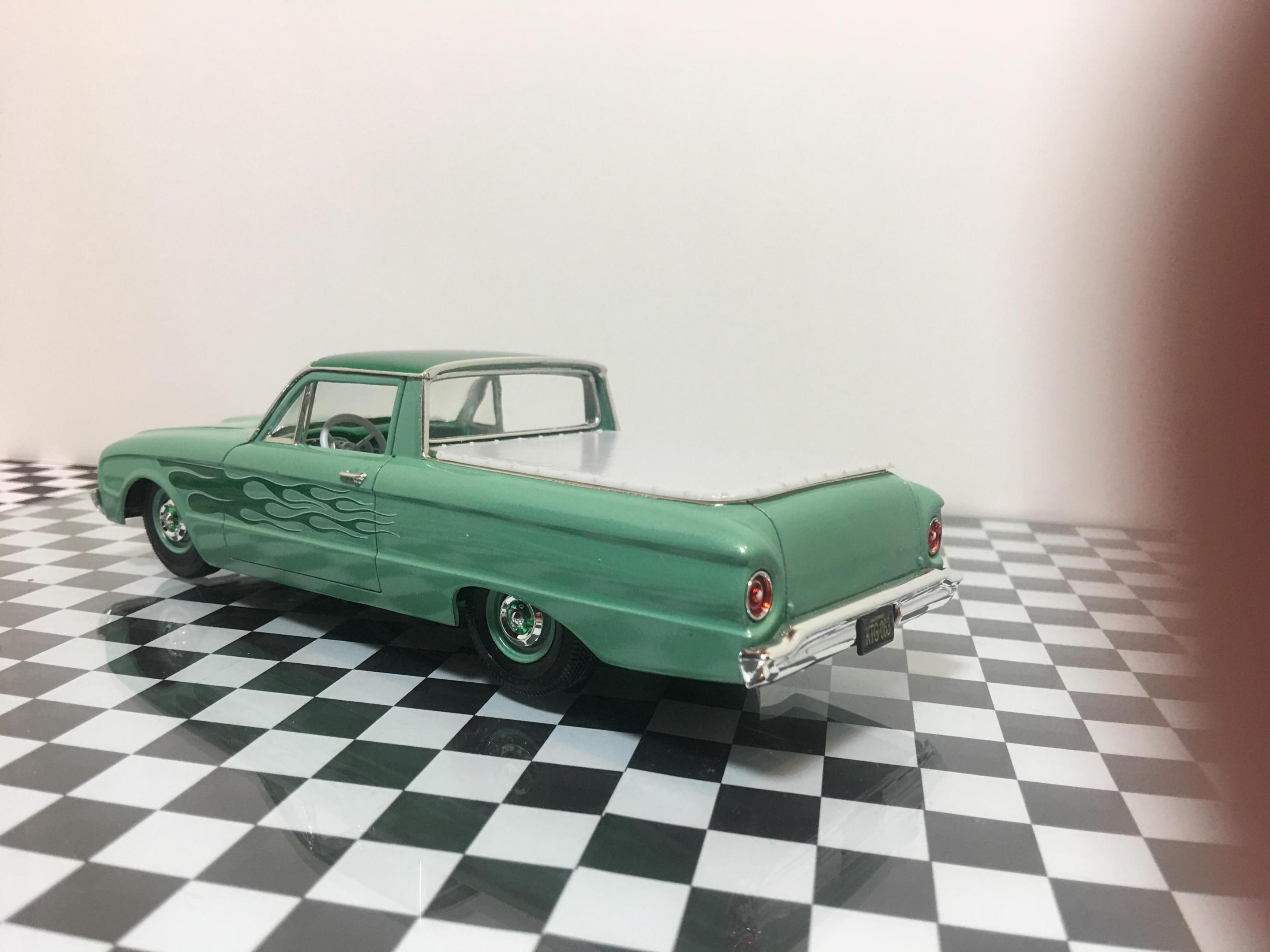

espo Posted March 27, 2021 Posted March 27, 2021 To expand on Snakes suggestion of using TS-60 Pearl Green this is a Ranchero that I used that color on. Hope this gives you an idea of what it may look like.
