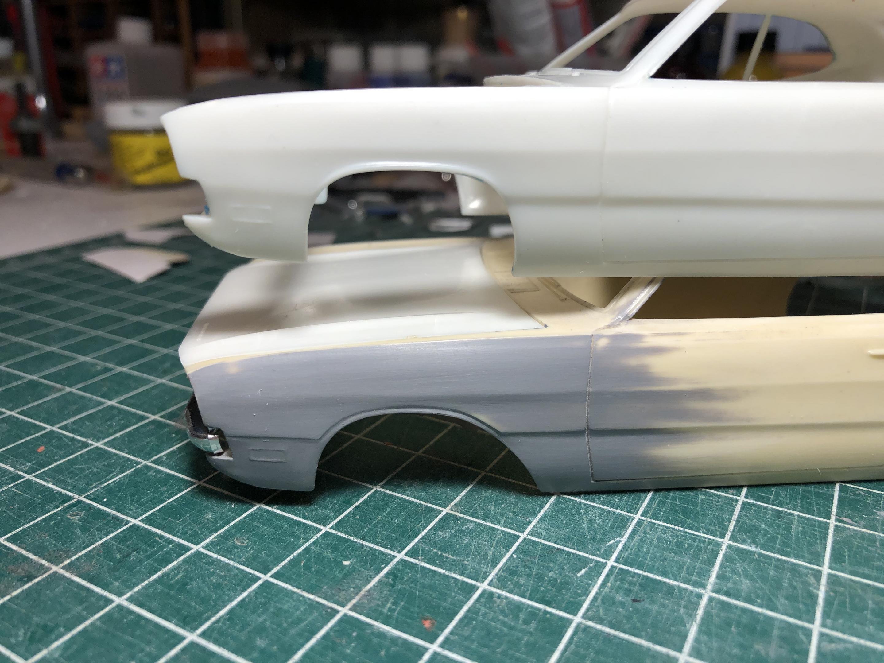

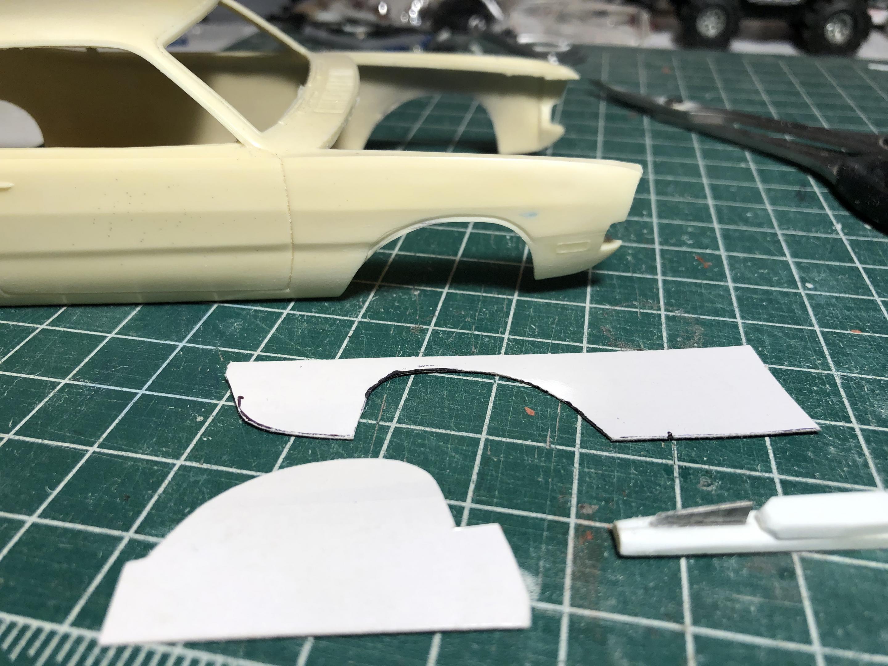

Maindrian Pace Posted June 3, 2021 Share Posted June 3, 2021 A friend in the model club bought this minty and rare MPC '71 Demon, knowing the major problem that this kit has - the front wheel openings are Duster/Valiant, not the completely different Demon/Dart that they should be. I had no idea - but once you see it, it's an obvious mistake. So he asked me if I could correct them to the proper shape, and blend the engine compartment from the current tool Duster 340 kit so this can be cast as a transkit to be used with that Duster kit. "Oh, and could you please not use the mint $300 Demon kit as a base for this?" No problem, I guess. So he cast the Demon body and gave me a resin copy to hack away on. Working with resin masters can be tricky, but what isn't. I printed a photo of a Demon left side and sketched in the new opening. Had to add some resin in the upper rear corners to allow for the new shape. I then made patterns to trace the left side onto the right side so both were identical. I made a scribing tool to make the curved depression above the wheel wells - a detail lacking in previous efforts to correct this body. After fitting the kit hood and grille, the final step was to relocate the right fender Pentastar more rearward, done by foil casting a new emblem and putting it in the right place. Top - original Demon body. 1 Quote Link to comment Share on other sites More sharing options...

Bainford Posted June 4, 2021 Share Posted June 4, 2021 Nice work. Huge improvement. Quote Link to comment Share on other sites More sharing options...
Maindrian Pace Posted June 4, 2021 Author Share Posted June 4, 2021 6 hours ago, espo said: You mentioned making a transkit, is this something that you may offer in the future ? Not me, but another member here. I'm sure he'll make it know when they will be available. 4 hours ago, afx said: Another shot of the fender/door/cowl seam. Thanks, looks like a simple mod. 1 hour ago, Bainford said: Nice work. Huge improvement. Thank you. Quote Link to comment Share on other sites More sharing options...

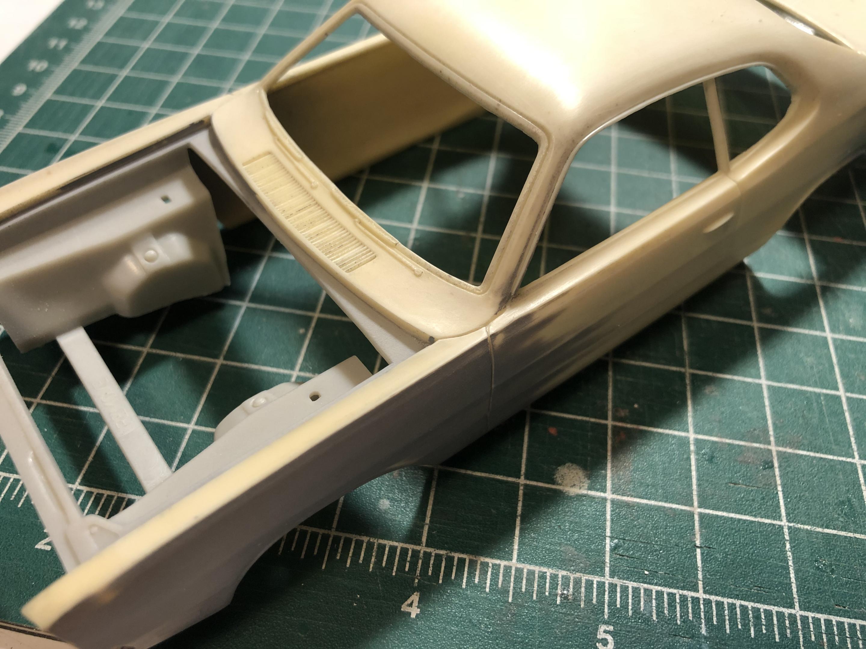

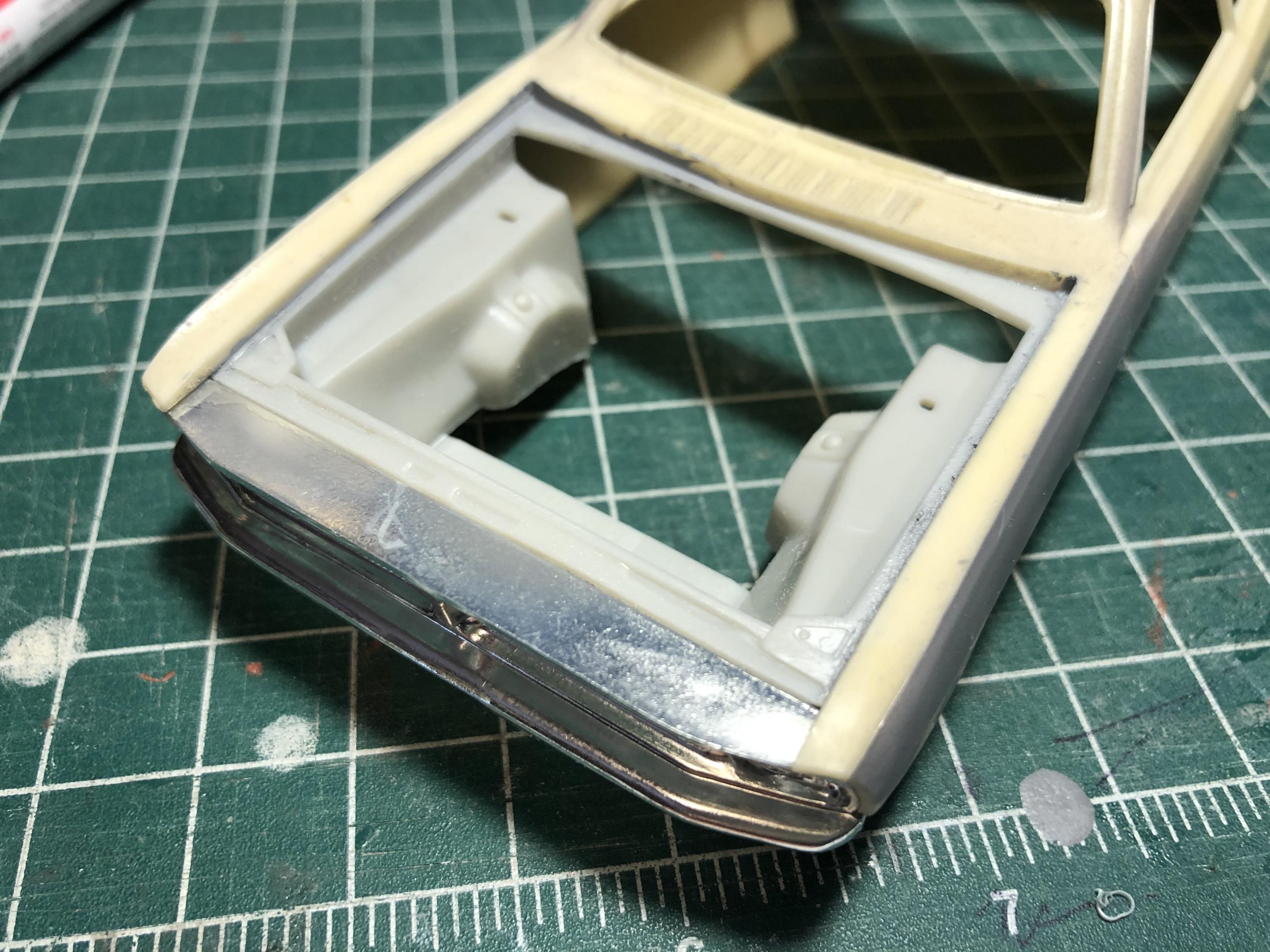

djflyer Posted June 4, 2021 Share Posted June 4, 2021 Definitely interested to see where this goes as I have an original MPC body I bought when I was a kid and am trying to do the same adaptation to the Duster chassis. Have you tried mounting the chassis plate yet? I found even before re-working the front wheel openings that some mods will be needed to the inner fender piece and tail end of the chassis plate. Quote Link to comment Share on other sites More sharing options...
Maindrian Pace Posted June 4, 2021 Author Share Posted June 4, 2021 The fit is OK, some trimming might be necessary in the back as you said, but a lot better than many trans kits and their recommended donor kits. Quote Link to comment Share on other sites More sharing options...

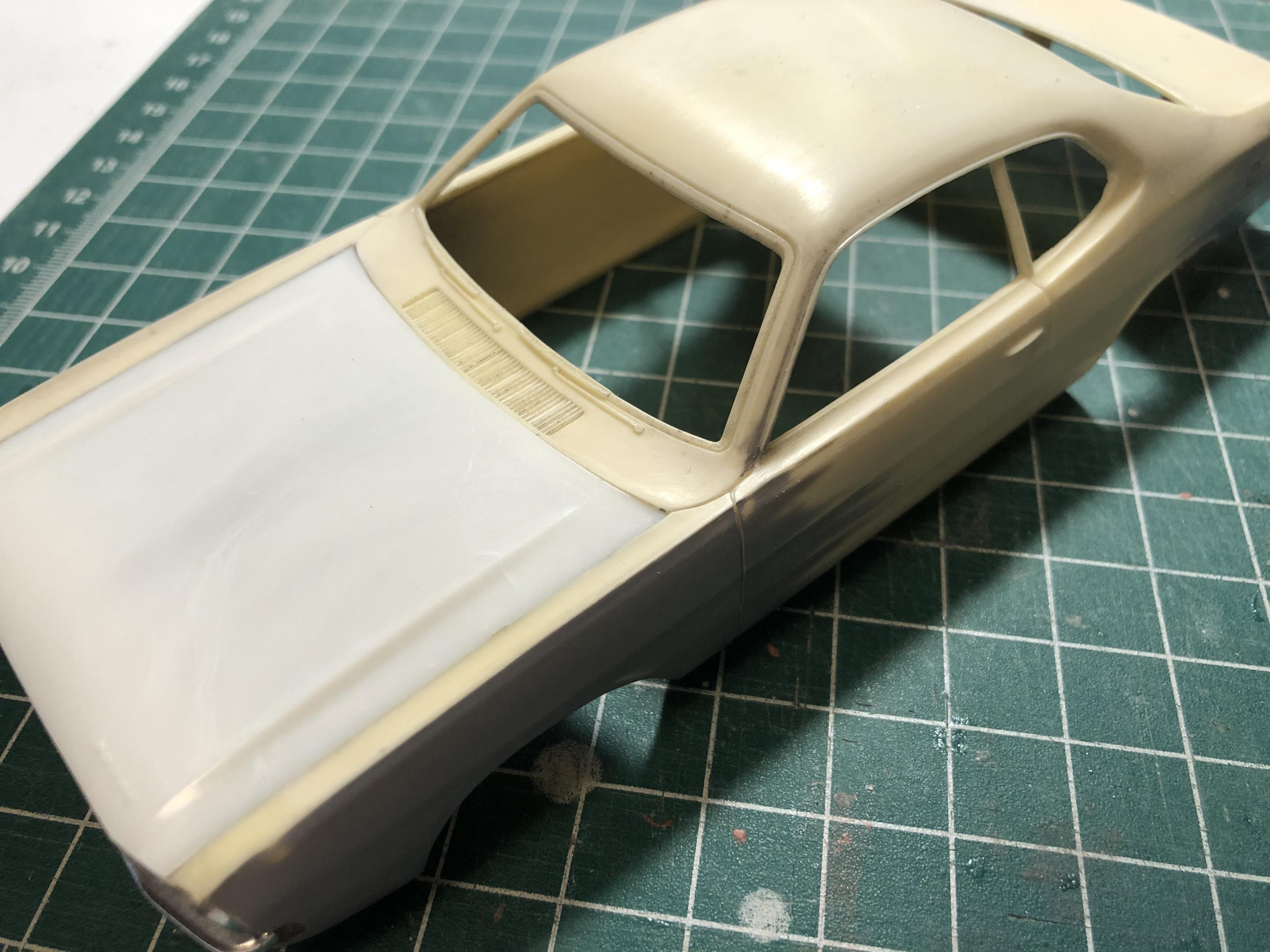

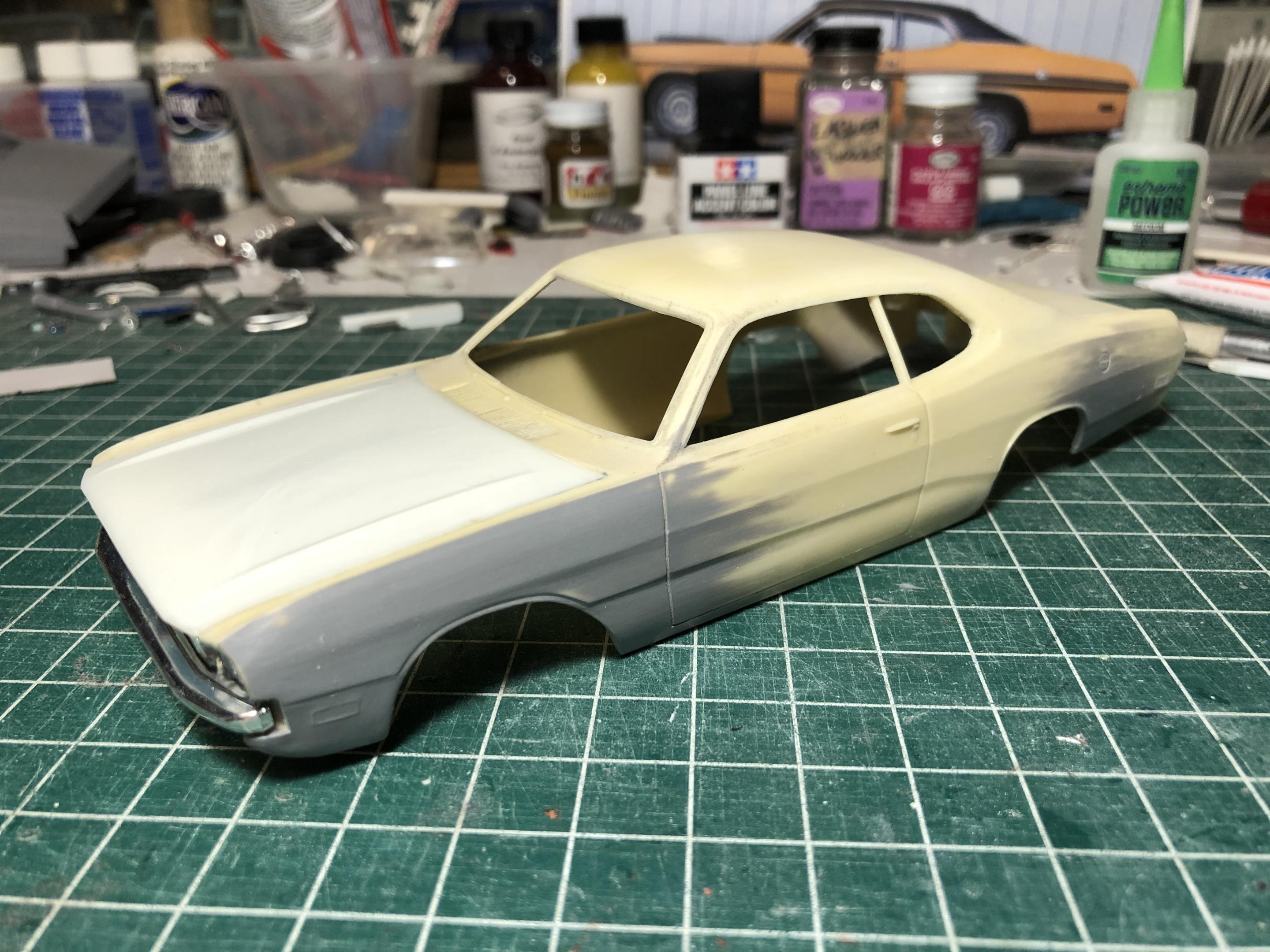

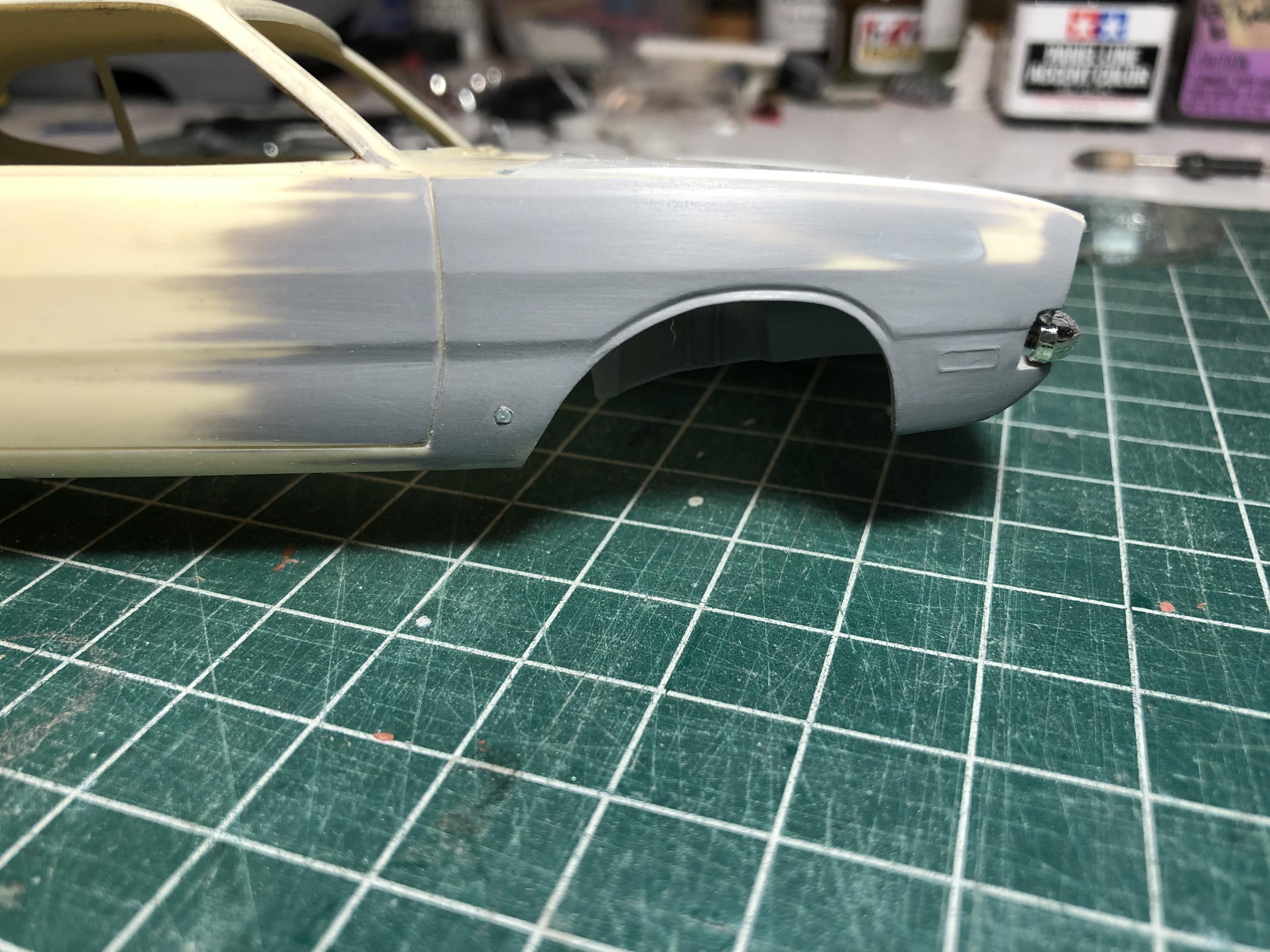

Maindrian Pace Posted June 5, 2021 Author Share Posted June 5, 2021 Latest revision: 2 Quote Link to comment Share on other sites More sharing options...
1972coronet Posted June 5, 2021 Share Posted June 5, 2021 15 hours ago, Maindrian Pace said: Latest revision: Magnifique ! Makes a big difference . Quote Link to comment Share on other sites More sharing options...

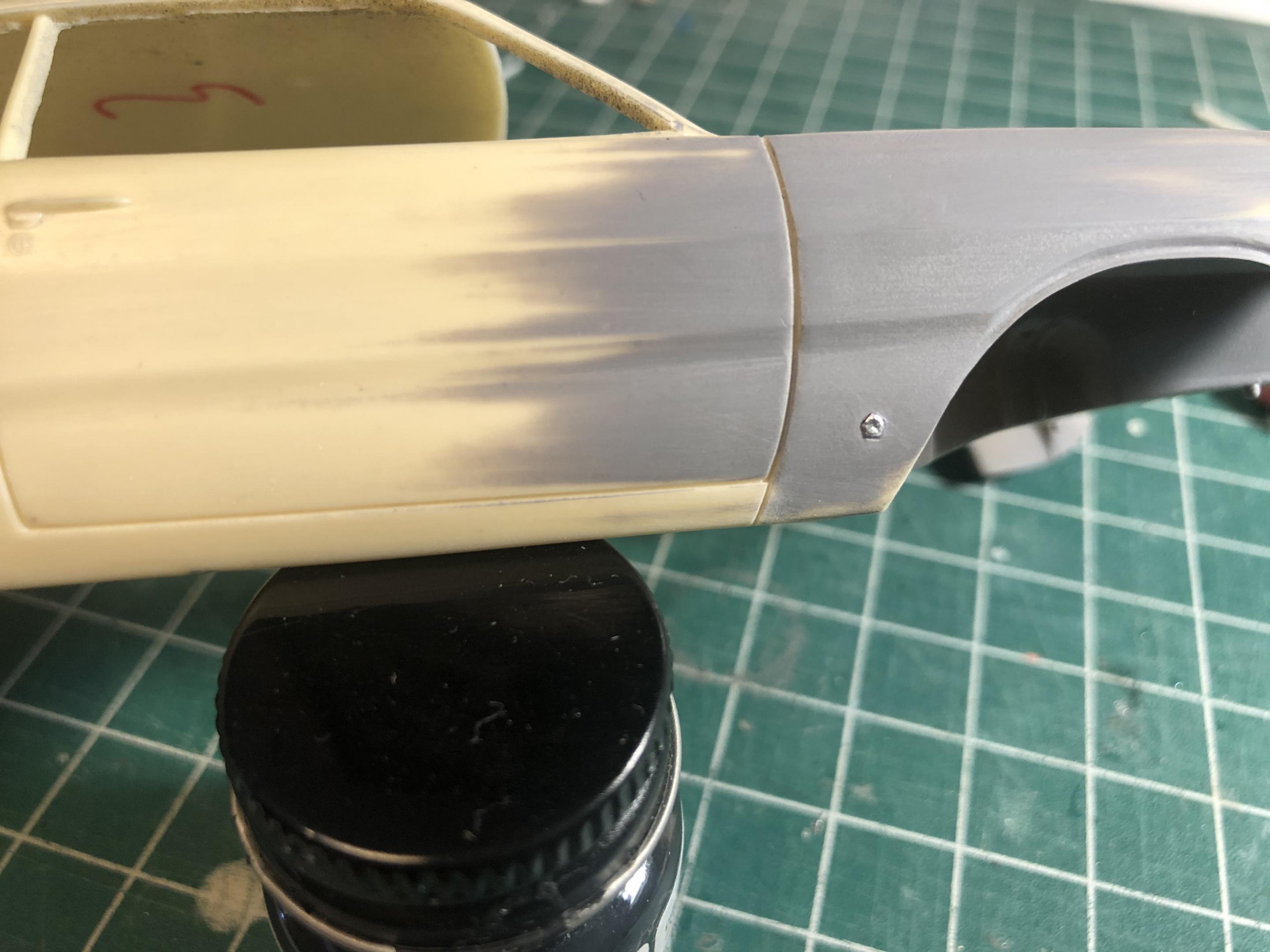

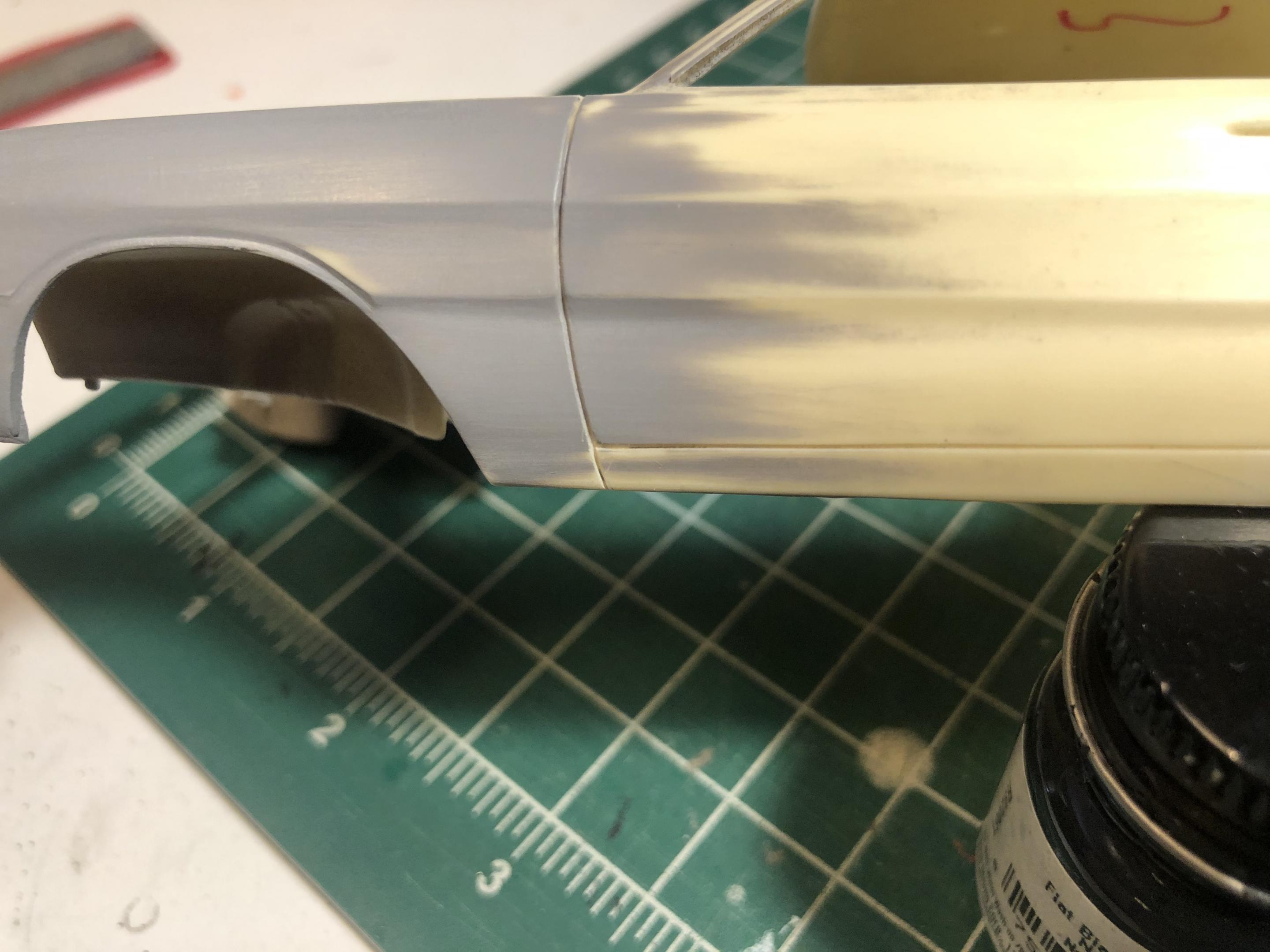

Maindrian Pace Posted June 17, 2021 Author Share Posted June 17, 2021 A Mopar guy on another forum pointed out to Greg that there should be a fender separation line at the rocker. We both agreed. so here is the final detail. Greg should be claying up the master as we speak. 1 Quote Link to comment Share on other sites More sharing options...
