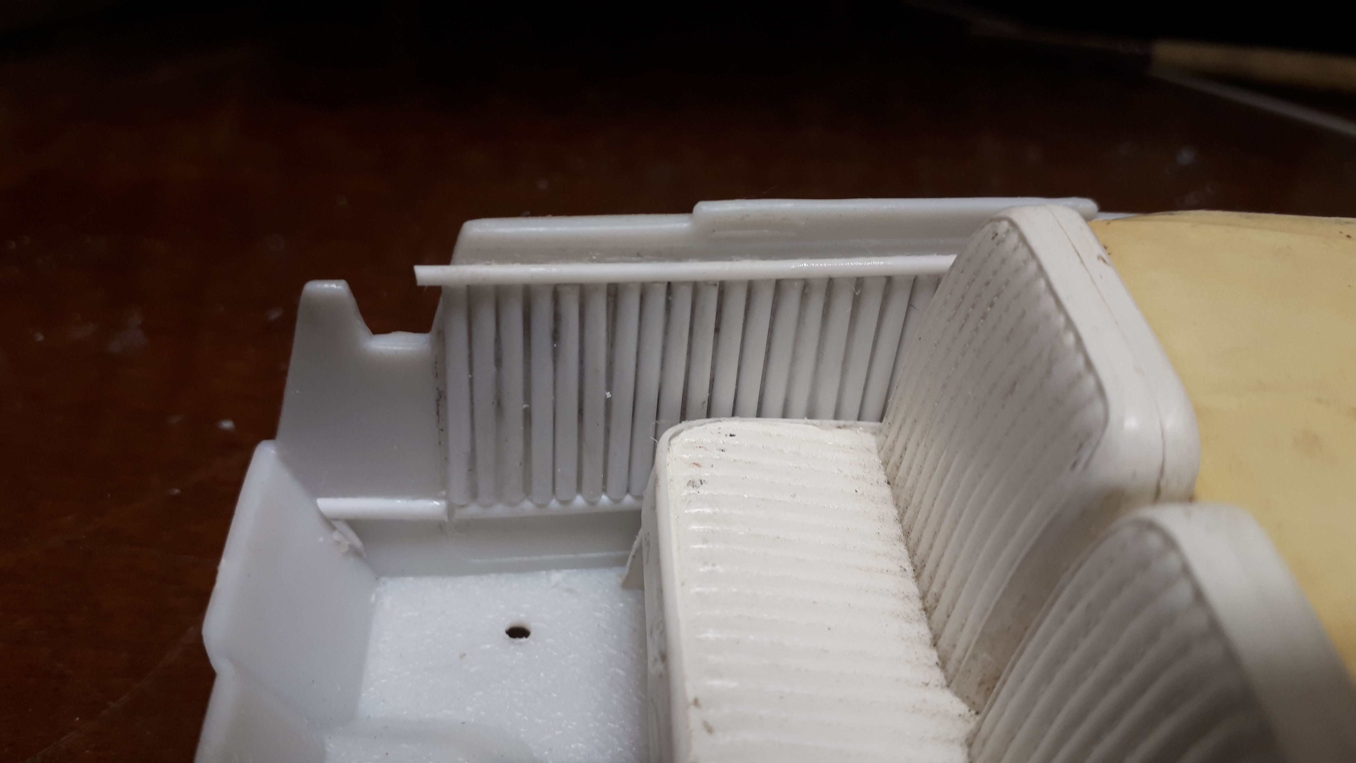

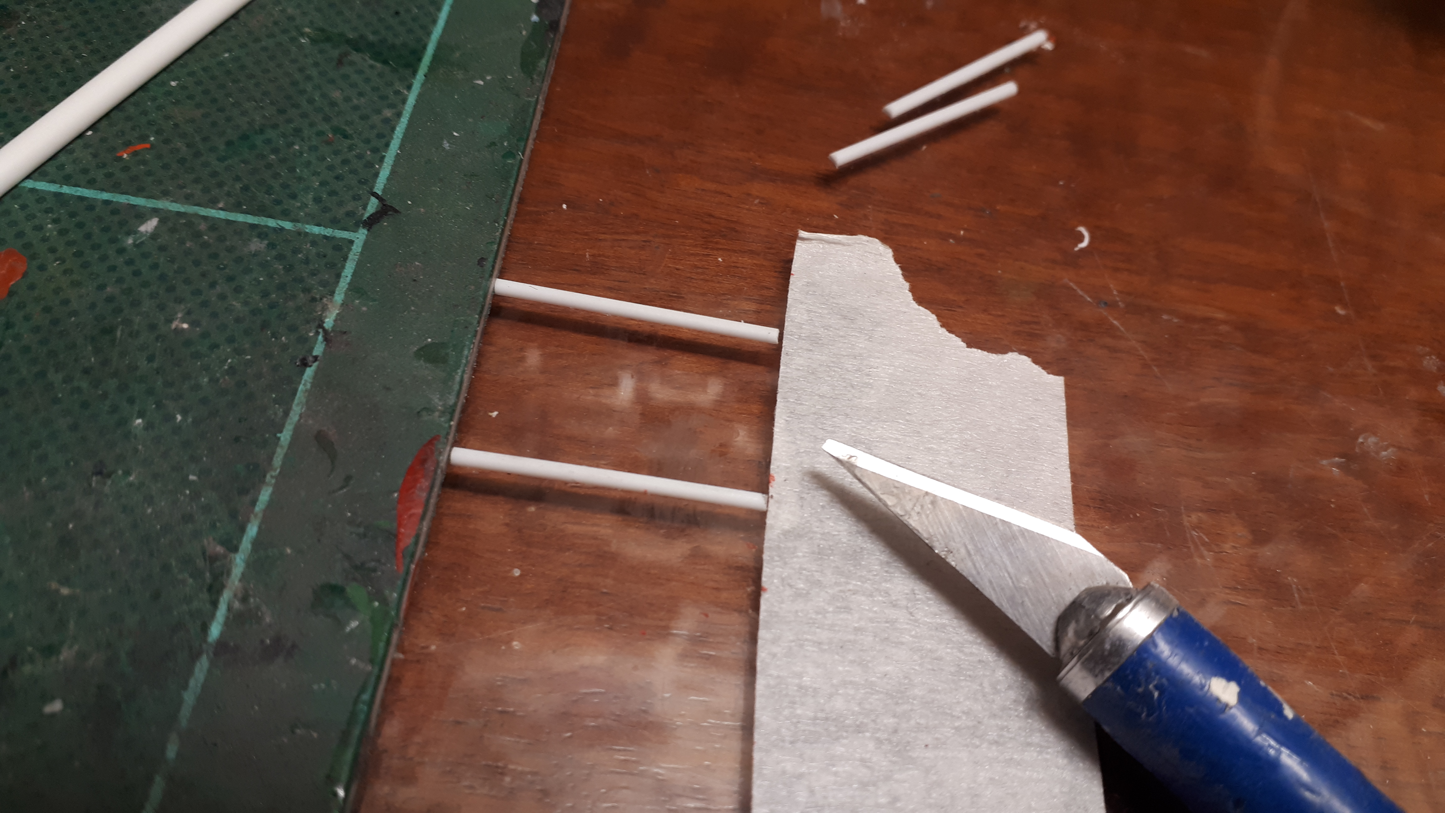

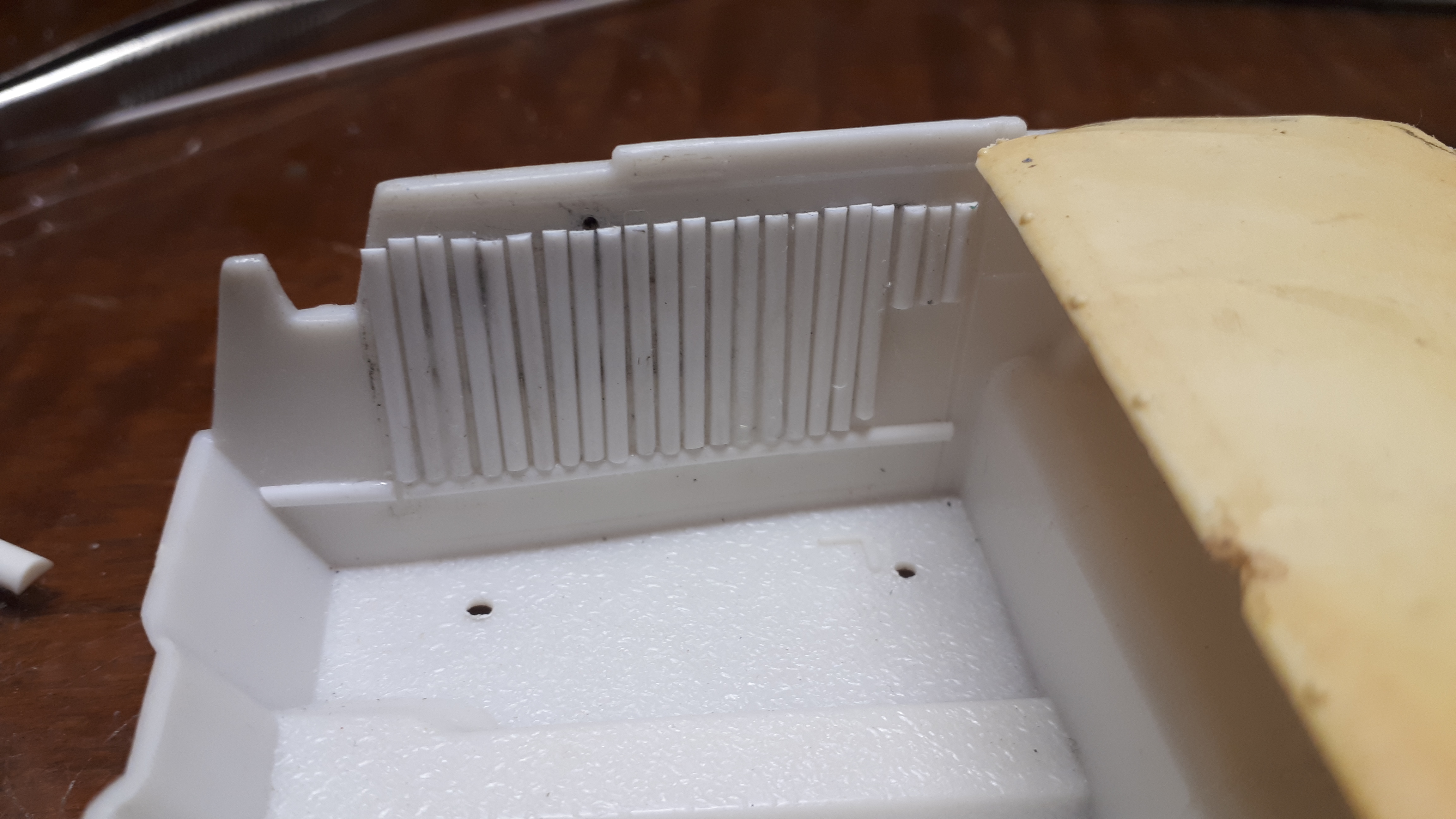

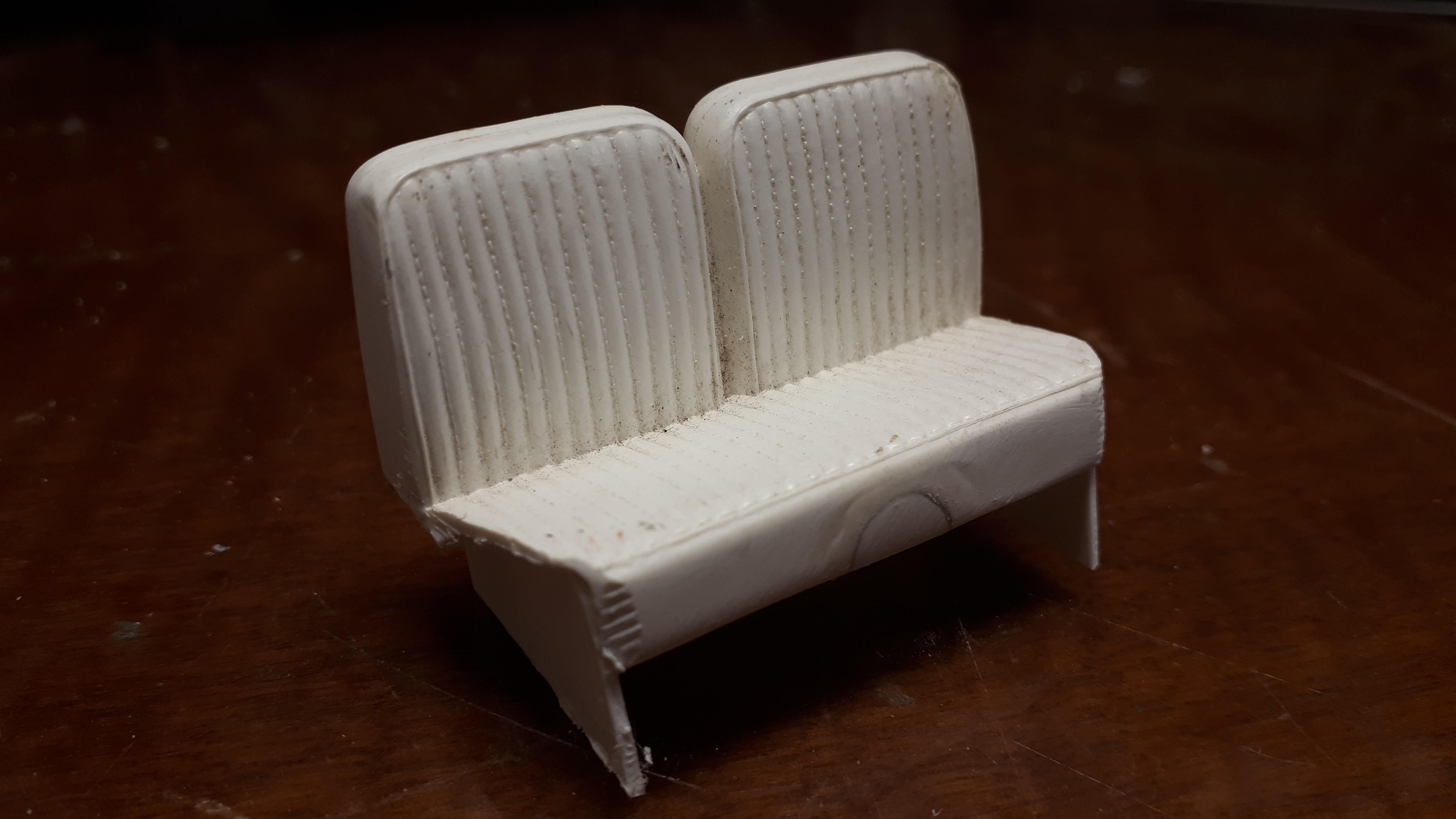

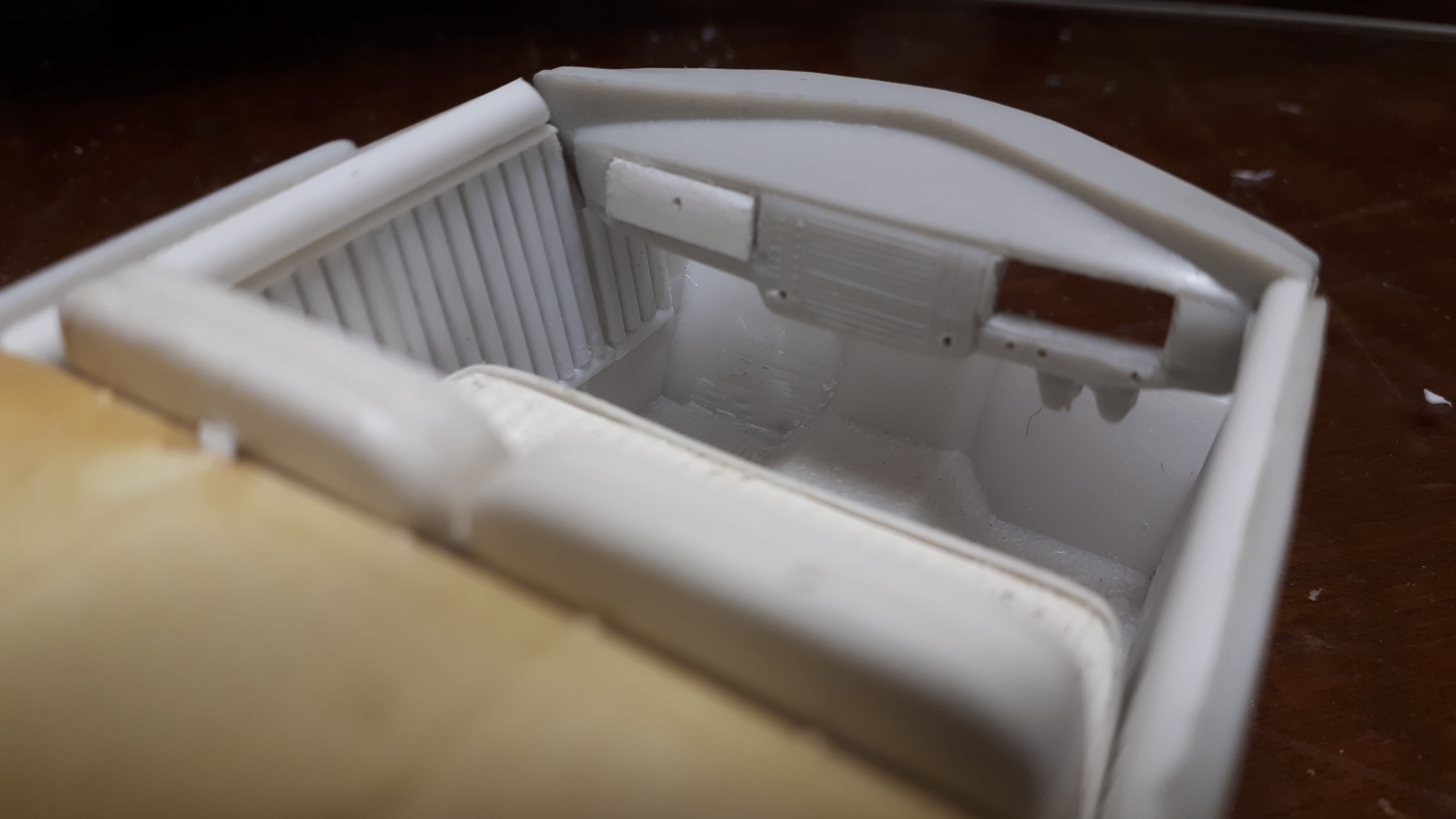

Meanwhile I have got most of the fab finished for the interior.  To start with, I put a piece of tape on my desk to mark the length of the Evergreen half round I wanted to use for tuck and roll. Even for a small interior like this is takes a lot of strips!  I then glued them to the tub with Revell Professional liquid cement.  I left a gap between each strip to allow the white paint to flow into the gap and give the impression of a deep tuck - next time I might close the gaps up a bit.
When that was dry I used a steel rule and a sharp knife to trim the top surface straight and then glued another strip of half round along the top and bottom of the pleats.

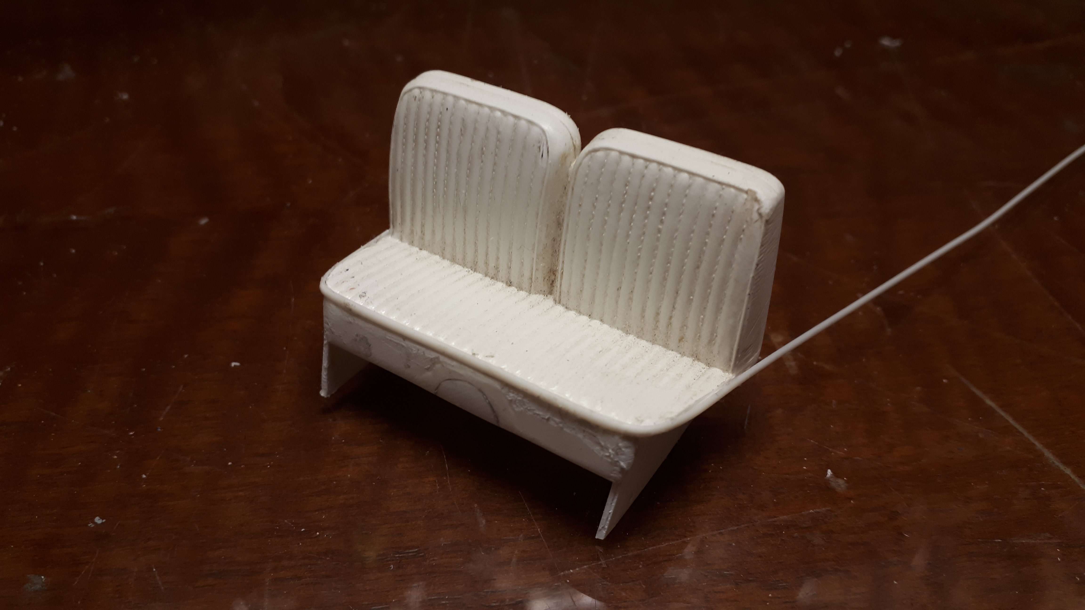

I think the seat is from an AMT 53  Studebaker.  I had to file the front corners back to fit in the tight confines of the interior tub and then replace the original piping with thin Evergreen half round.  I made some very simple seat supports from flat styrene to lift the seat to a believable height - these supports are invisible on the finished interior.

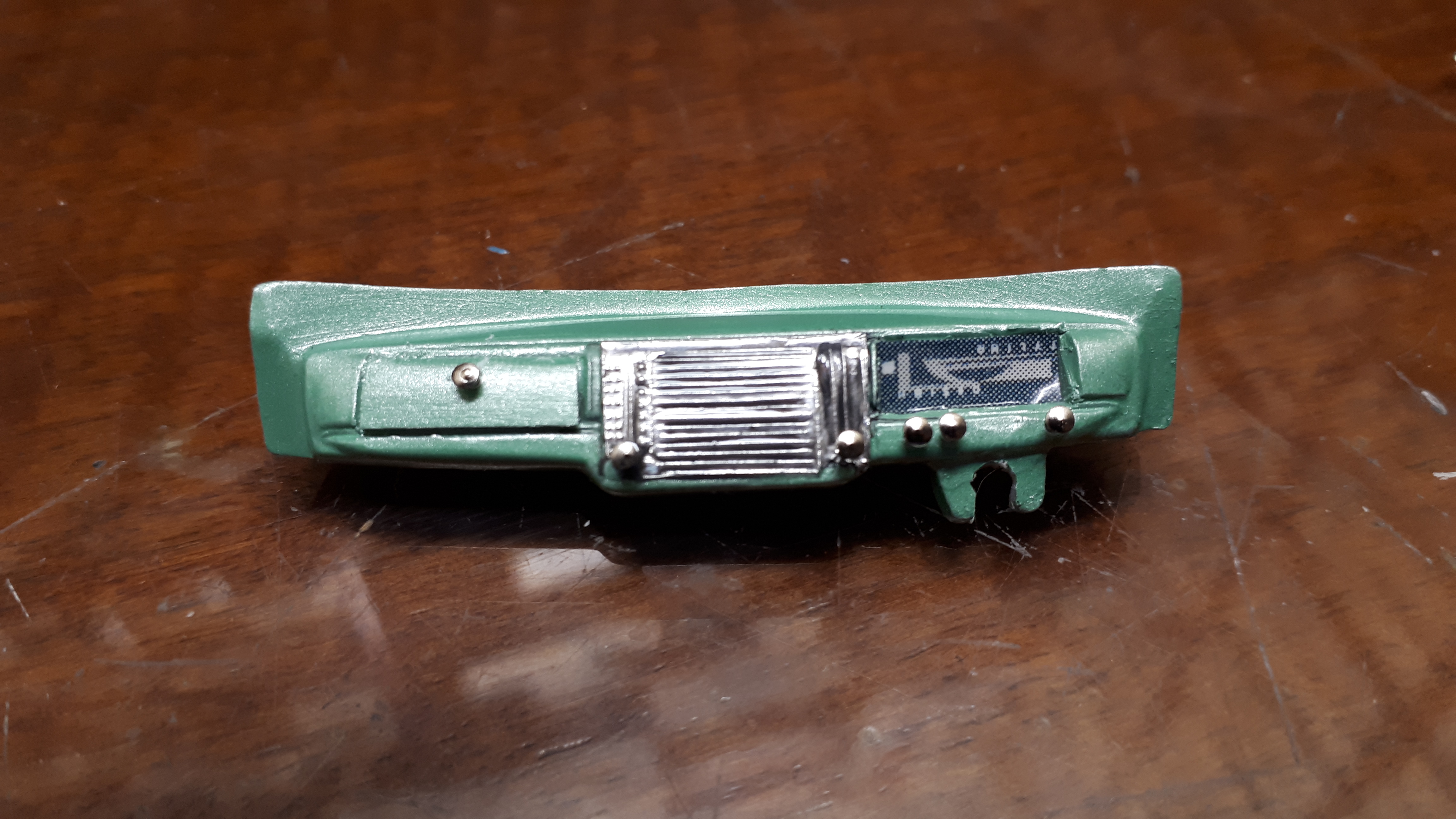

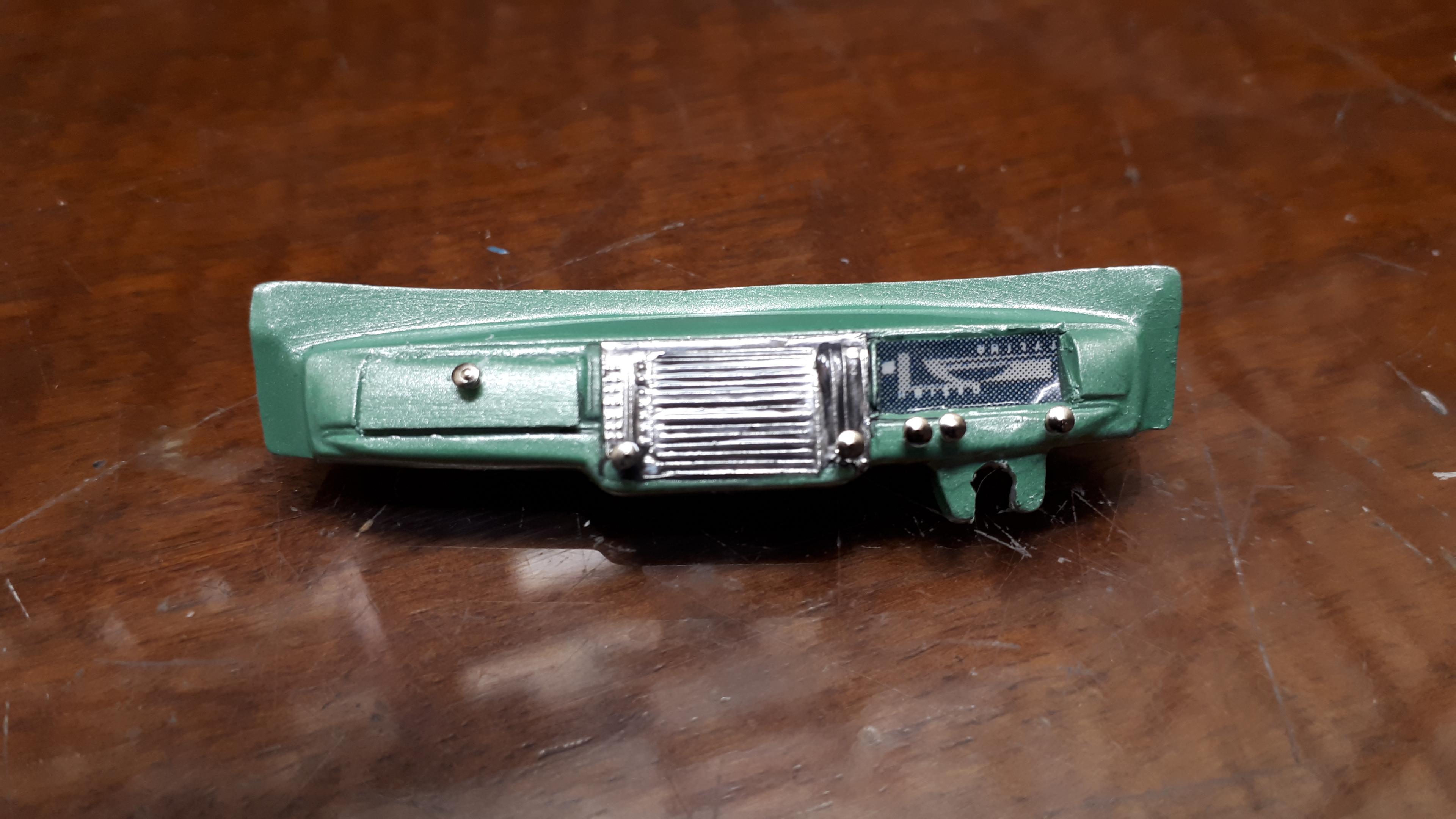

The dash needed to be converted to right hand drive so I cut out the glovebox door and the instrument panel.  I then cut a piece of styrene and sanded it to form the replacement door on the left hand side.  The instrument cluster was not particularly well engraved so I fabricated a small rectangular housing on the right hand side and used a decal instead.  It is not the greatest gauge cluster ever but when you peak inside the window it looks fine.

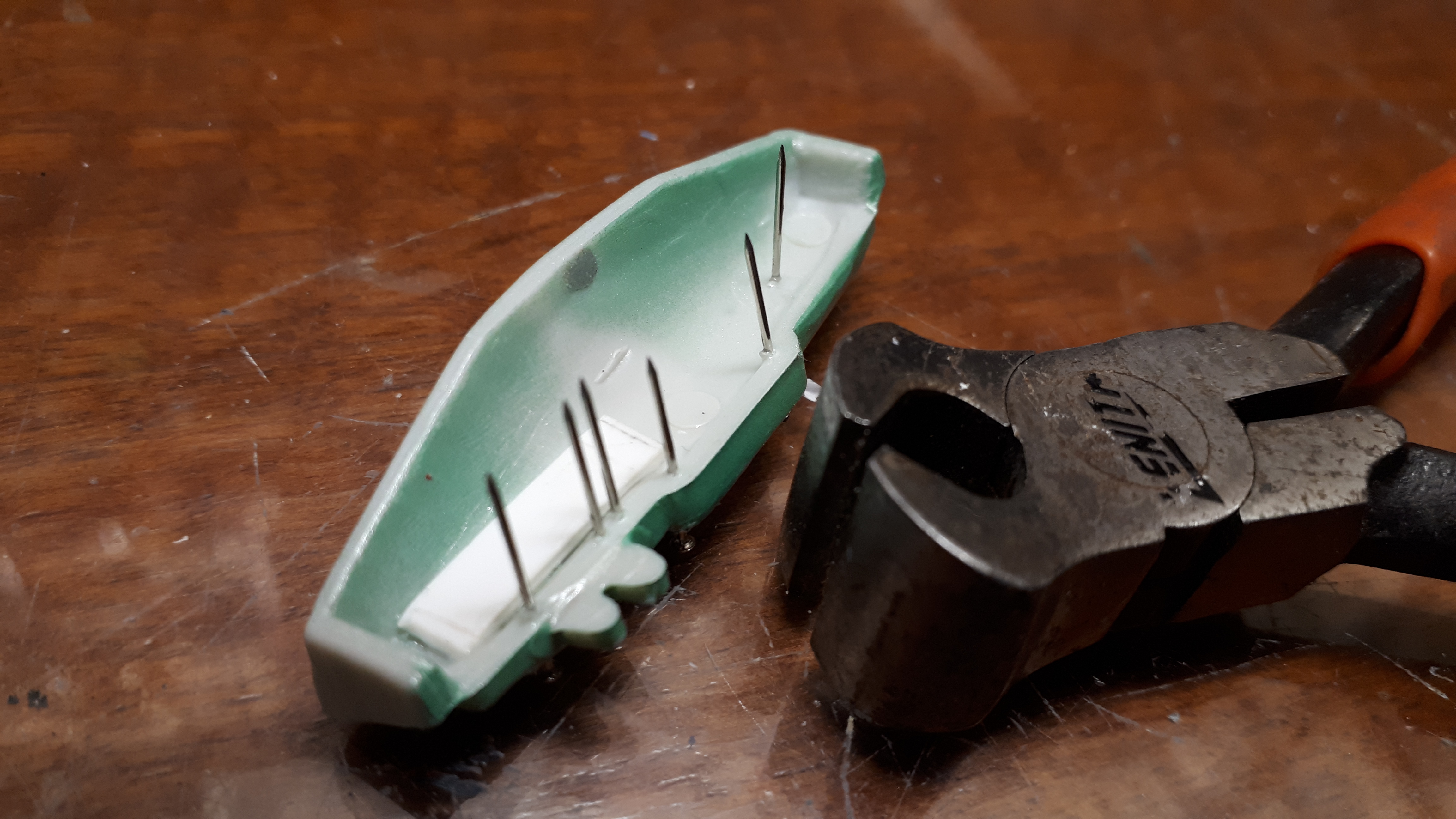

Finally I drilled a bunch of small holes and fitted them with tiny dressmaking pins to replace the dash switch knobs.

nice work on the dash, well done....

I love the work on the dashboard!  Especially the pins.
Excellent work all around. It looks much sleeker than original. Those pins for dash knobs is a terrific idea…consider it stolen!?
