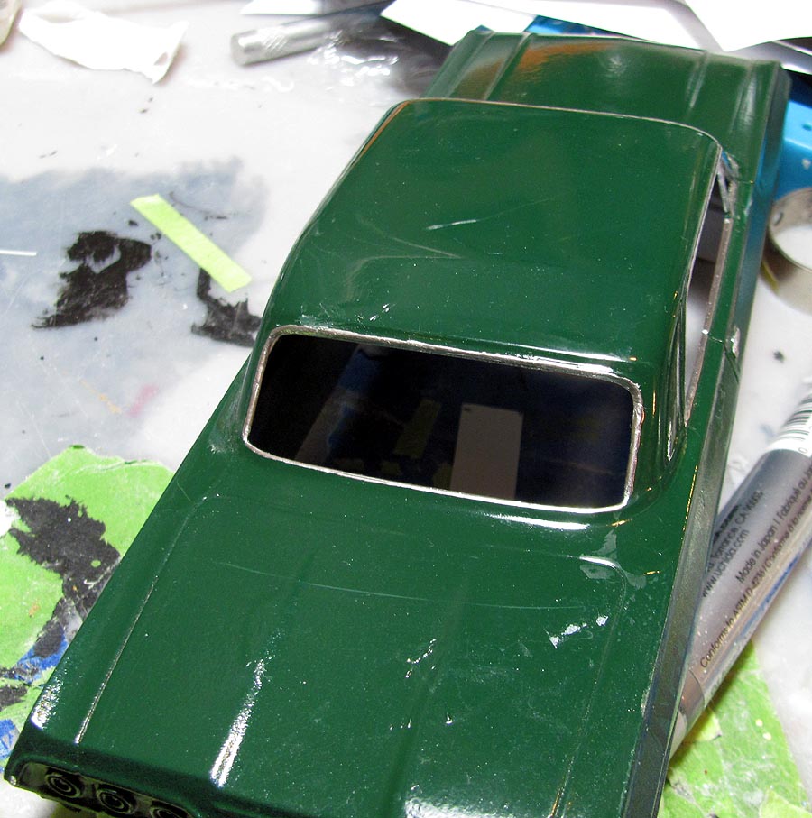

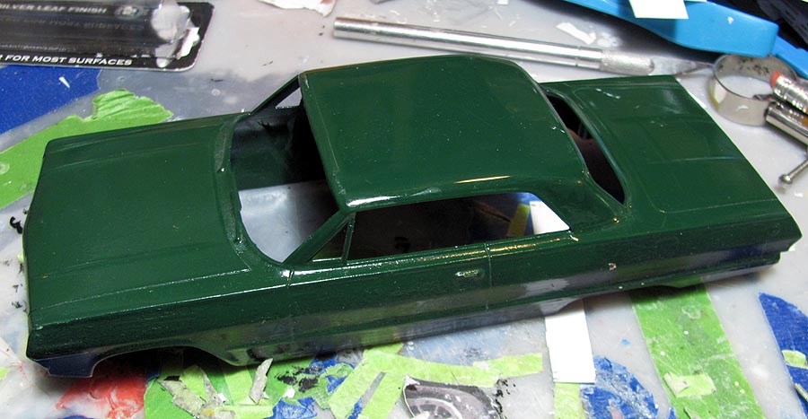

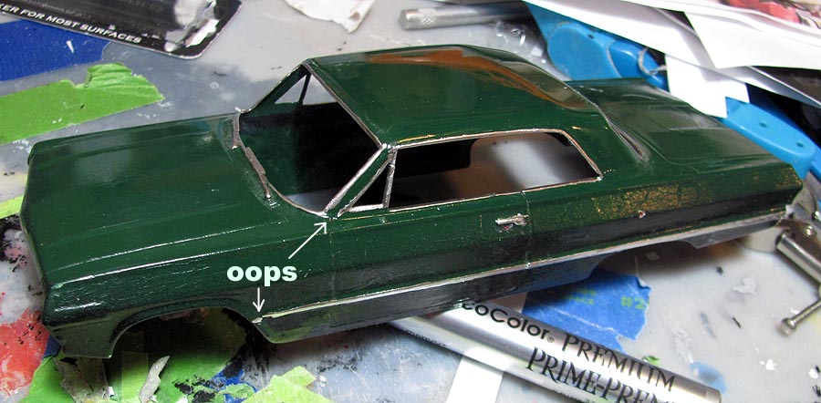

MarkJ Posted August 17, 2021 Author Posted August 17, 2021 4 hours ago, Pierre Rivard said: Mark, thank you for doing this research. I definitely will try this when I start building again next winter. I was looking for an alternative to brush painting trim with my hands being less stable as time passes... I look forward to future progress on this fascinating build of your's. Pierre, I have a spare body that I do experimenting on . Its an old 63 Chevy body with probably 6 different coats of paint on it. it wasn't a kit but a promo pre-built model, kind of the precursor to the die casts we have today, except they were plastic. . I thought I would use the pen I chose, on it, to see how the trim turns out. That chisel tip flows the paint nicely, so I'm hoping for some good results. Thanks for the kind comments on the build. I hope it's worthy of them, when it's finished.
MarkJ Posted August 17, 2021 Author Posted August 17, 2021 Tried out the pen and was pretty happy with it. If I had sanded the mouldings first, I would have gotten better results, but I didn't want to go to that much trouble. . Some parts of the mouldings were smooth, so that's what I focused in on. I also started on the rear bumper. Still have to add the bottom part of it and the rubber pad. Which wont actually be rubber. Remember this green body is just a test body. It will never be a model.

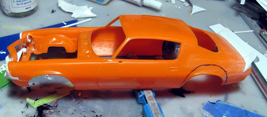

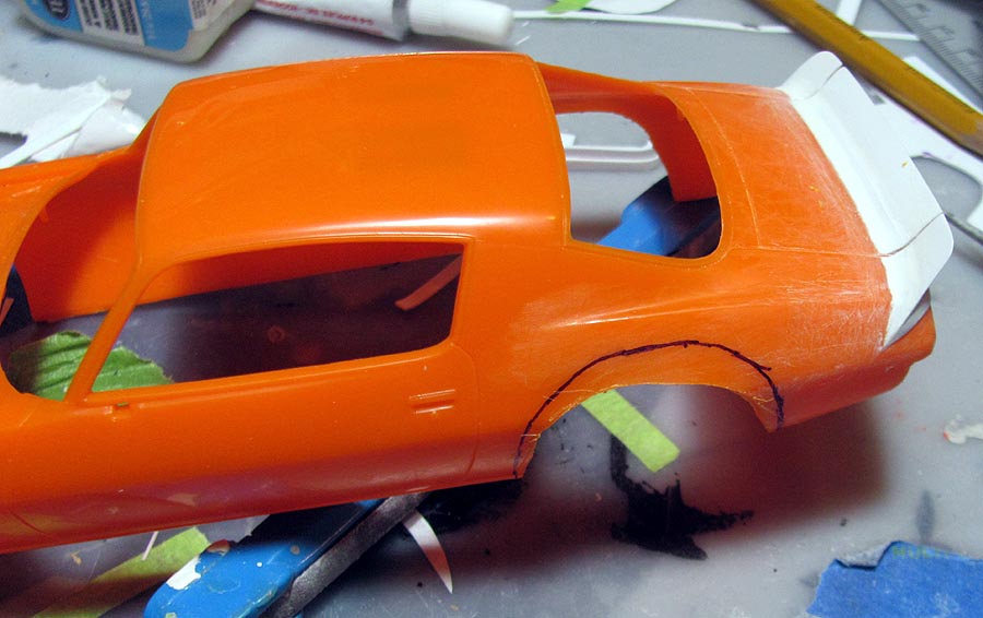

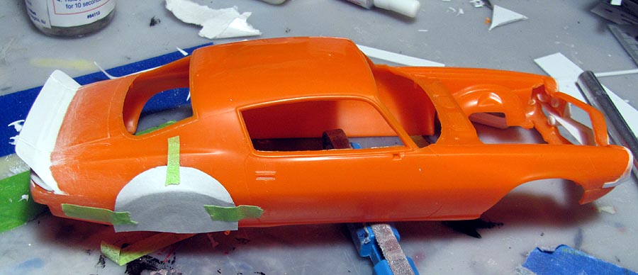

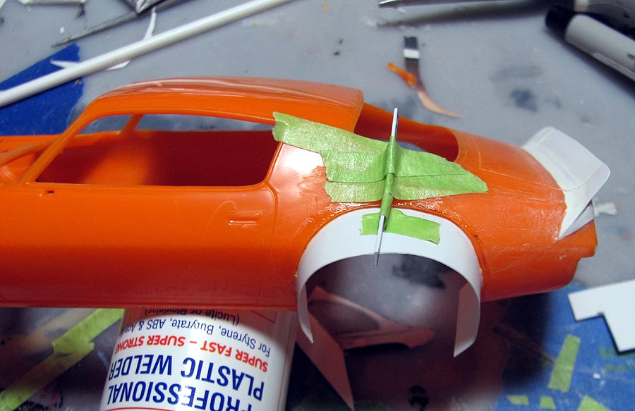

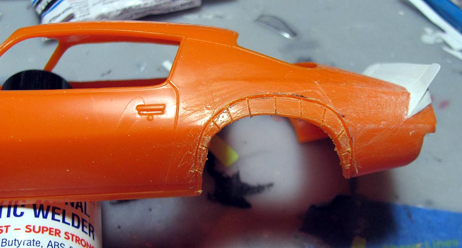

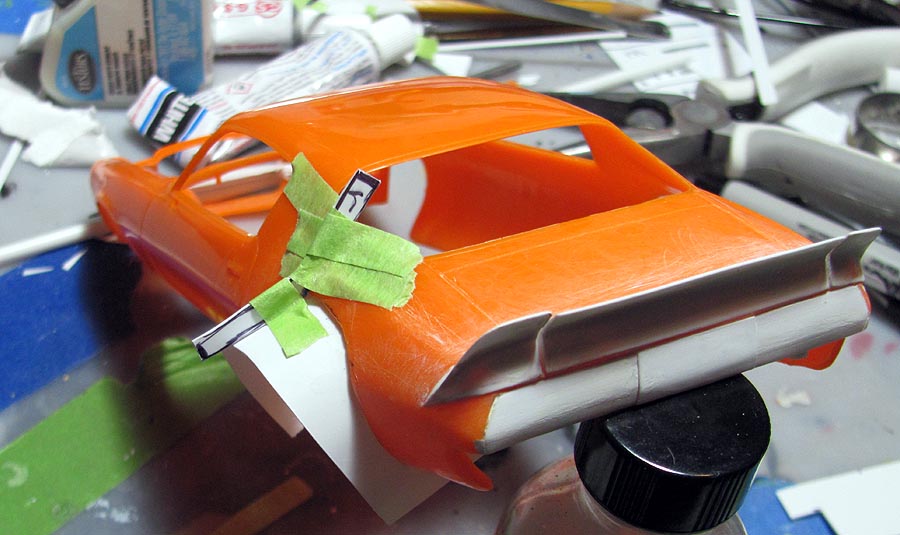

MarkJ Posted August 22, 2021 Author Posted August 22, 2021 (edited) I had to make a jig to get the angle right for the rear quarter fender flare coming out of the body, I made a 1/25 scale picture of the real car from directly behind to get the angle and also how far it sticks out of the body. I haven't done that dimension yet because I wanted to finish the rear bumper. The bumper is made to remove so these are just mock up pictures. I will do the same process for the front fender flares. The rear spoiler is very bendable but I will get it lined back up before I paint it. It gets moved around a lot when I'm handling the body to do the mods on it. Edited August 22, 2021 by MarkJ

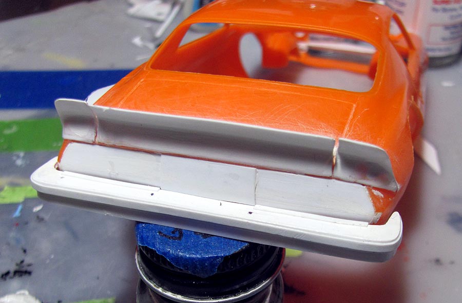

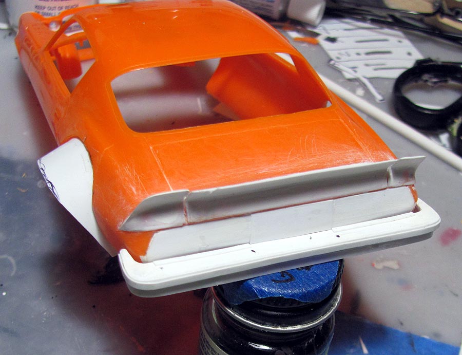

MarkJ Posted August 24, 2021 Author Posted August 24, 2021 11 hours ago, slusher said: Nice bumber Mark, been watching your scratch building and progress friend". Thanks, Carl. I appreciate your interest in the build. I think I might finally have the bumper where I can install it in the correct position.
MarkJ Posted August 24, 2021 Author Posted August 24, 2021 The bumper is installed using the rod in tube method I used on the front bumper. Its a loose fit, so when its finally installed for good, it wont be touching the body like you see it is now. I think I'm pretty much through with the bumper except for some detail sanding, Now on to the fender flares and completion of the body, so I can move on to the interior.
