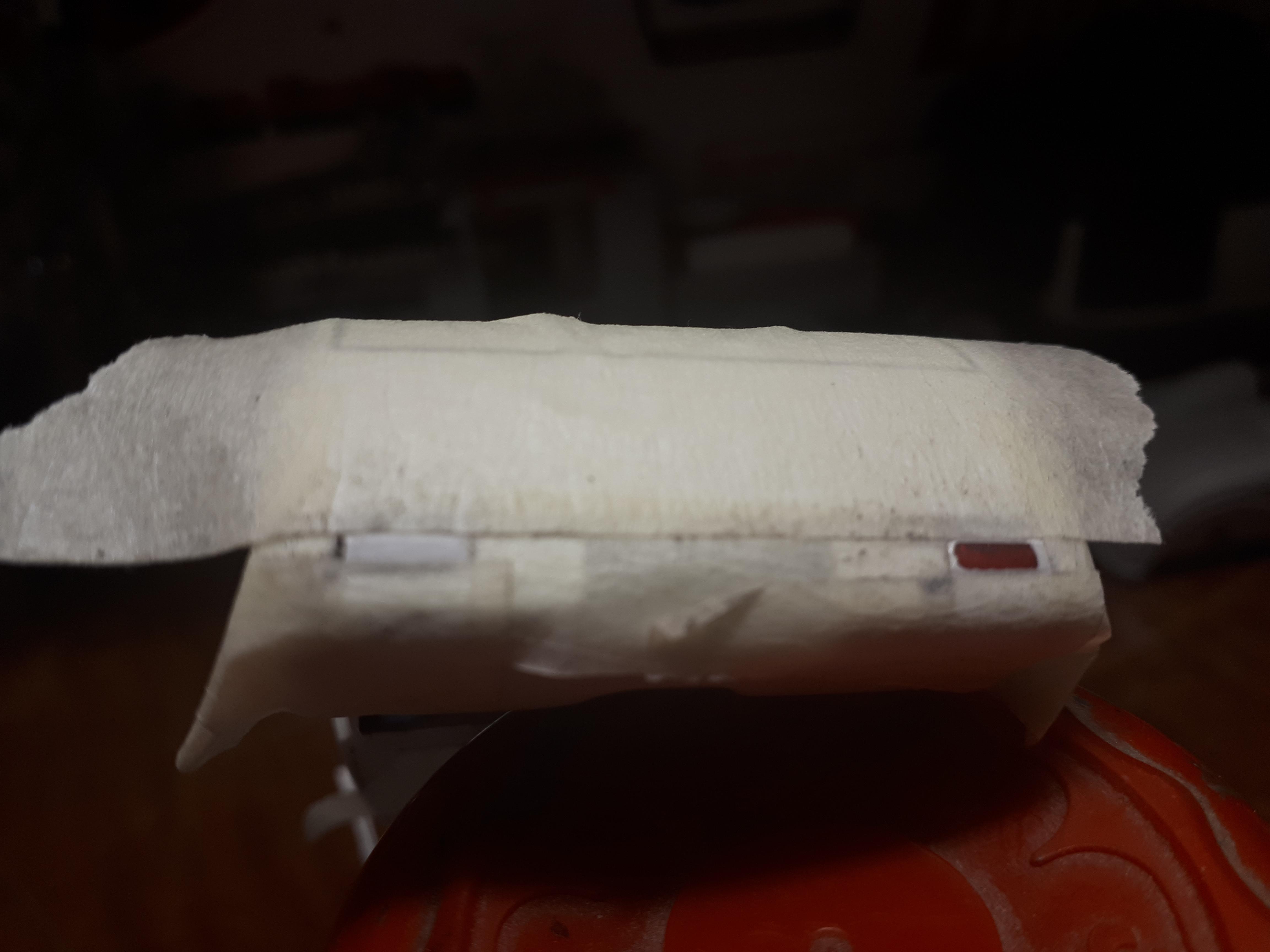

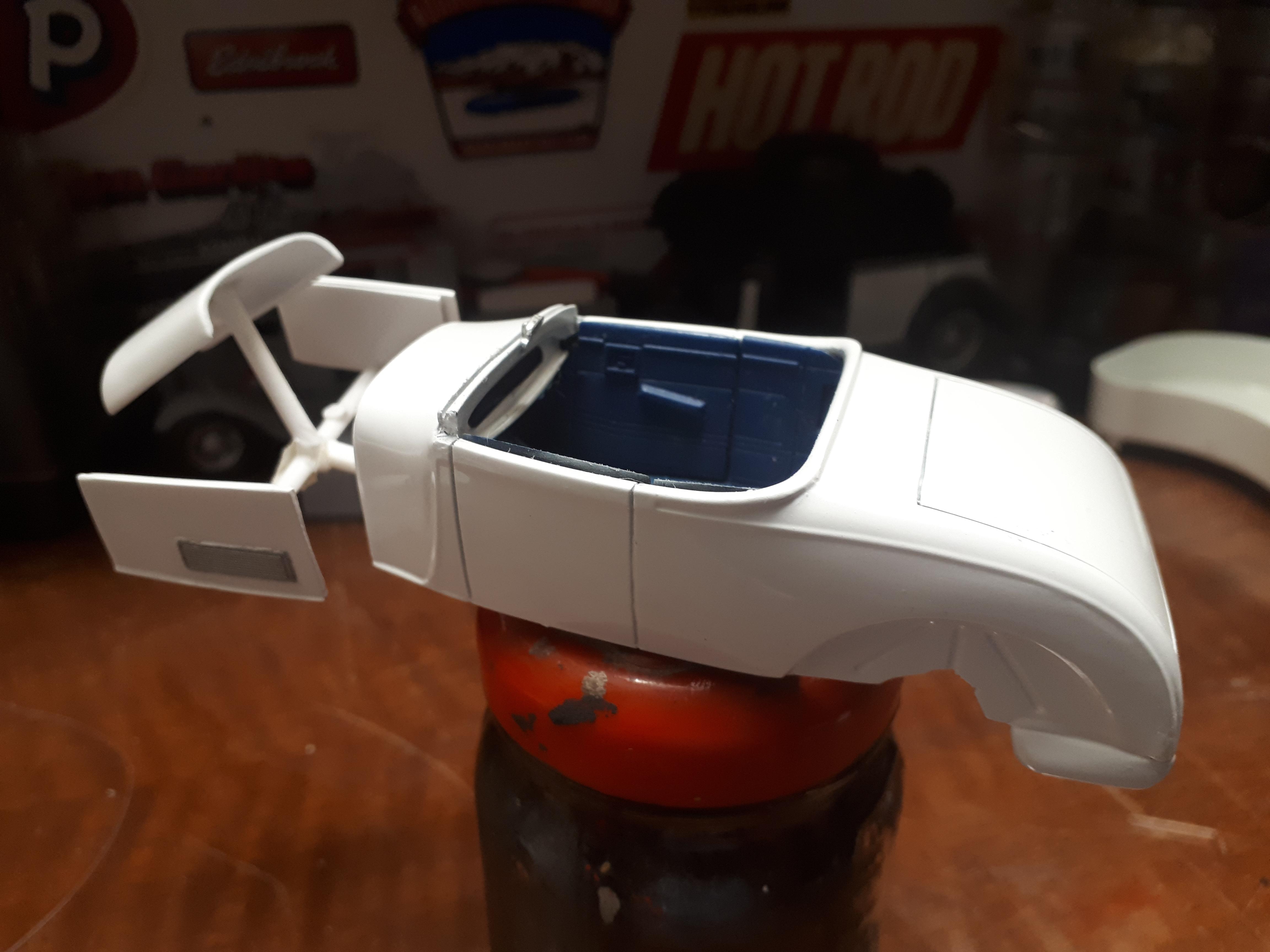

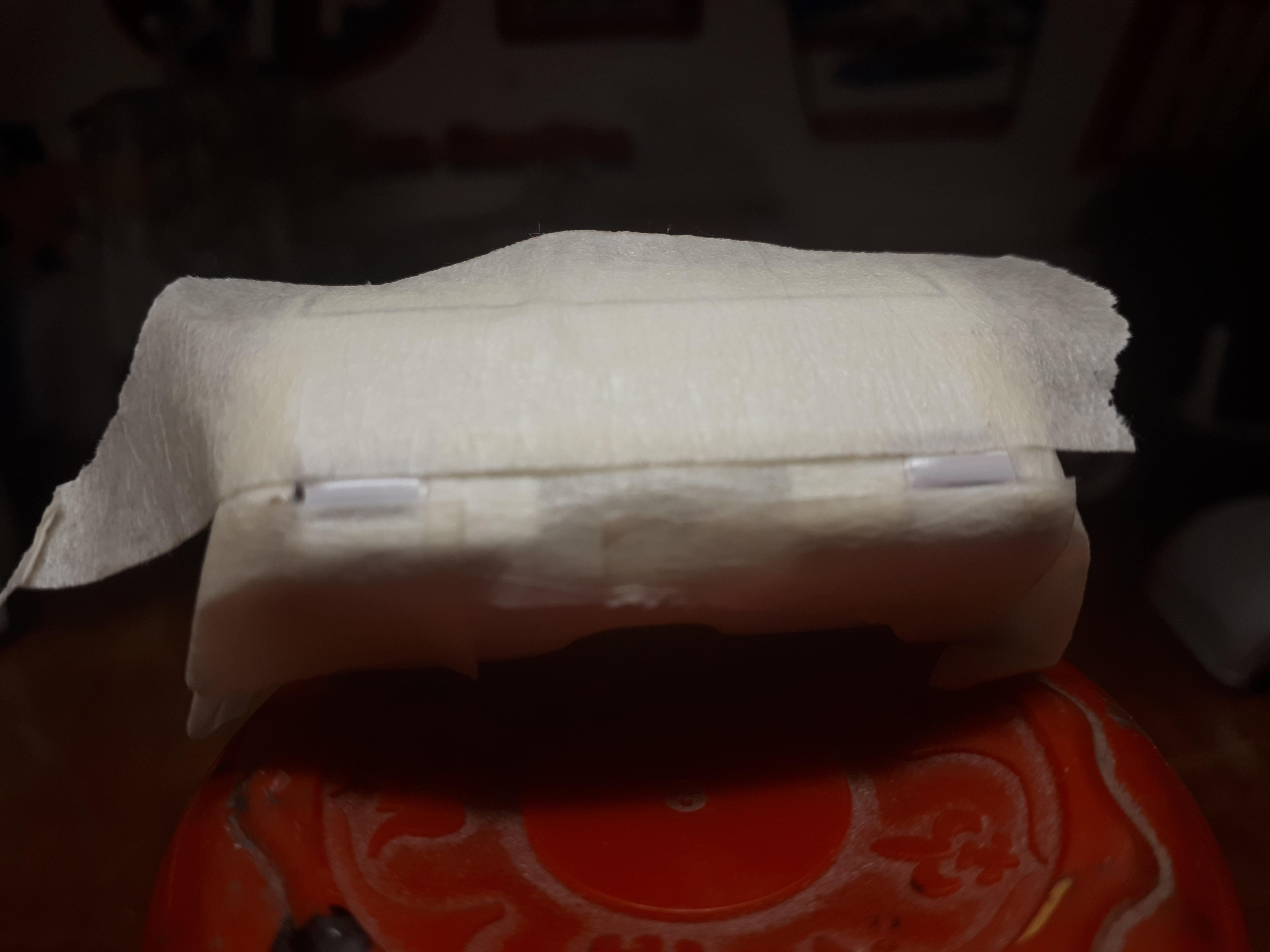

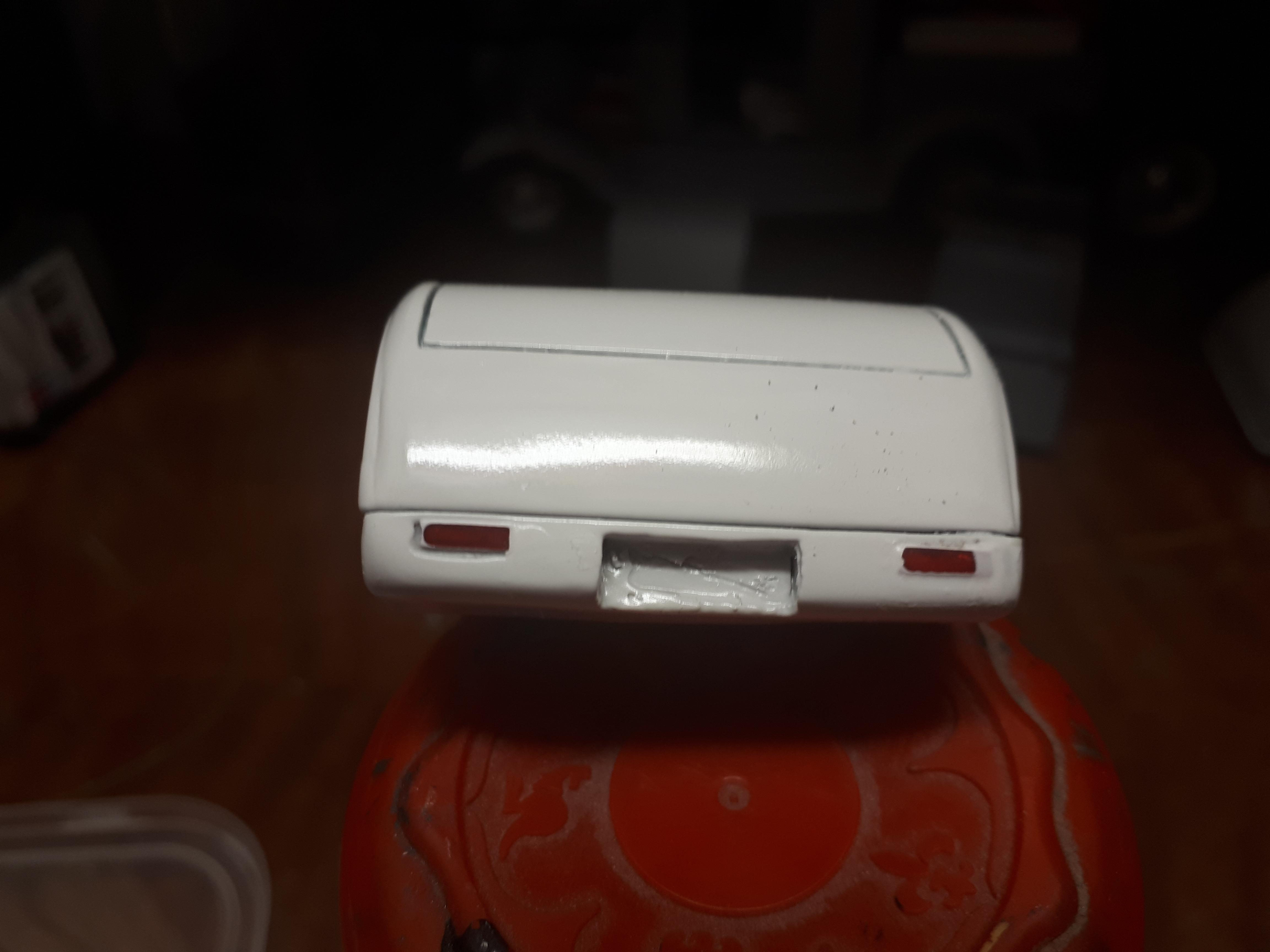

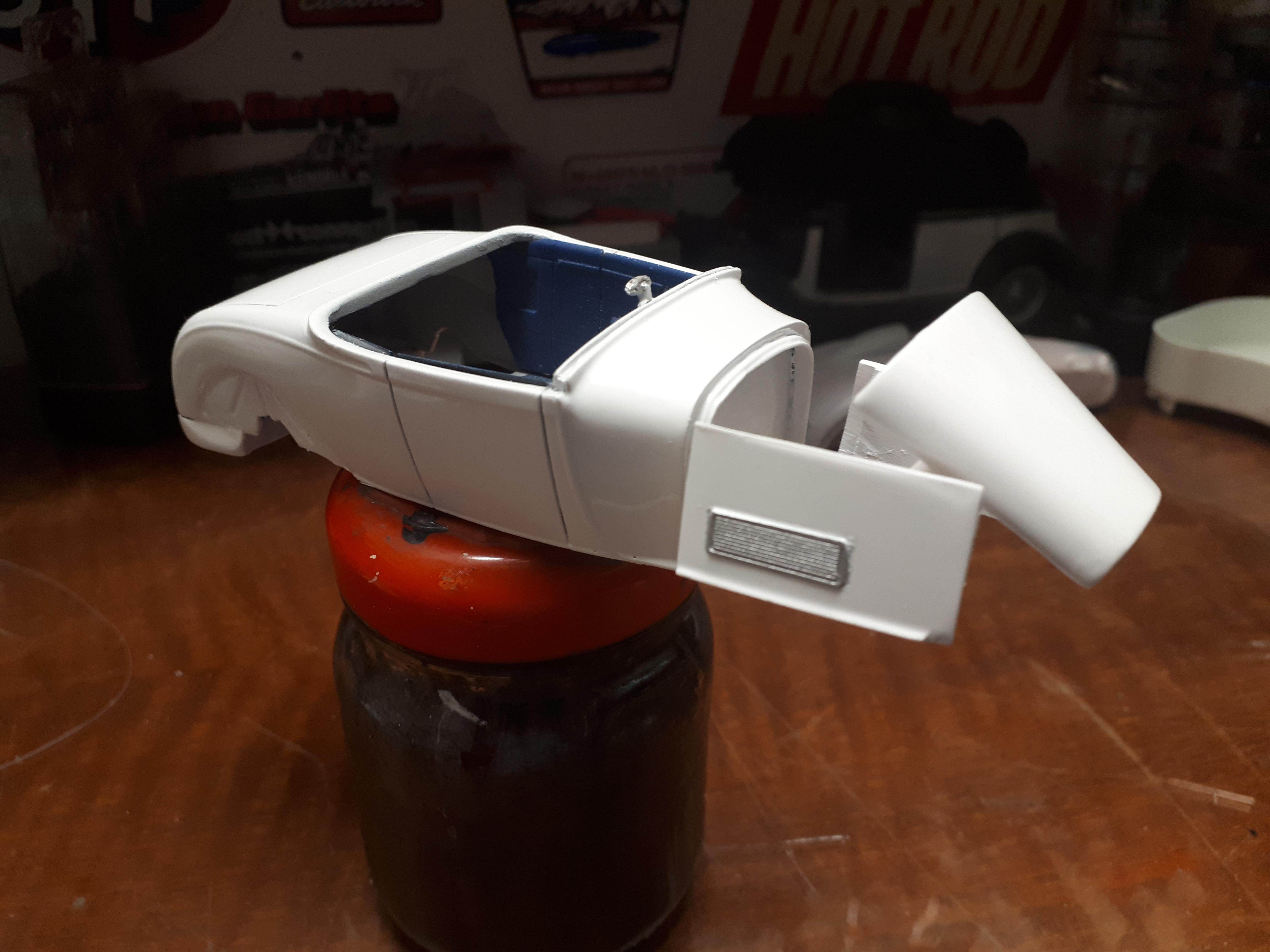

Alan Barton Posted December 10, 2021 Author Posted December 10, 2021 (edited) Well, the update was a long time coming but I just couldn't abide the multiple shades of white that I ended up with. However, we had one of our longest, coldest and wettest winter in years so I really couldn't get excited about painting! Sometimes, though, the planets line up to make things happen! First, as a result of my job I had to pass through Adelaide Airport a few weeks ago which, at the time, was classed as a COVID hotspot and as a result I was forced into 14 days of self isolation quarantine. At the end of the first week, we got our first taste of hot weather, say around 100 degrees in the old money. I gently removed the seat, the steering wheel and column and the windshield and posts. I then masked up the rest of the interior. I sanded the whole body and panels down with 800 wet and dry and then glued them together with some old sprue and superglue. This had to work as I really couldn't afford to get much more paint on that body - the AMT bodylines were starting to disappear on me! I put about three more coats of Tamiya white primer over everything, followed later in the day by three coats of Tamiya gloss clear. I left it a few days to gas out and then today I polished it with Tamiya fine polishing compound. And at last, I am happy! While I was doing all this, I noticed that the taillights weren't the tight fit I would have liked so I swiped a bit of Tamiya putty around the edges and sanded the result smooth before paint. I painted the body, taillights and all, and then used a sanding stick to cut through the paint back to the red taillight inserts. It's not quite flawless but I am very happy with the results. They are as close to a flush taillight as I could get without risking cutting through the paint! Tonight I have the body glued and clamped to the frame and then there are just a handful of pieces to glue on before I send it Under Glass. Hopefully this weekend so stay tuned Cheers Alan! Edited December 10, 2021 by alan barton

Alan Barton Posted December 11, 2021 Author Posted December 11, 2021 Thanks Bob, thanks Dan, thanks Greg. My wife just googled Zinser and we can get it here in Australia at Bunnings ( like your Home Depot, just with less range and higher prices!) She had used Zinser brush on paint years ago in our bathrooms but we weren't aware of the spray cans so will be getting some today! Cheers Alan
