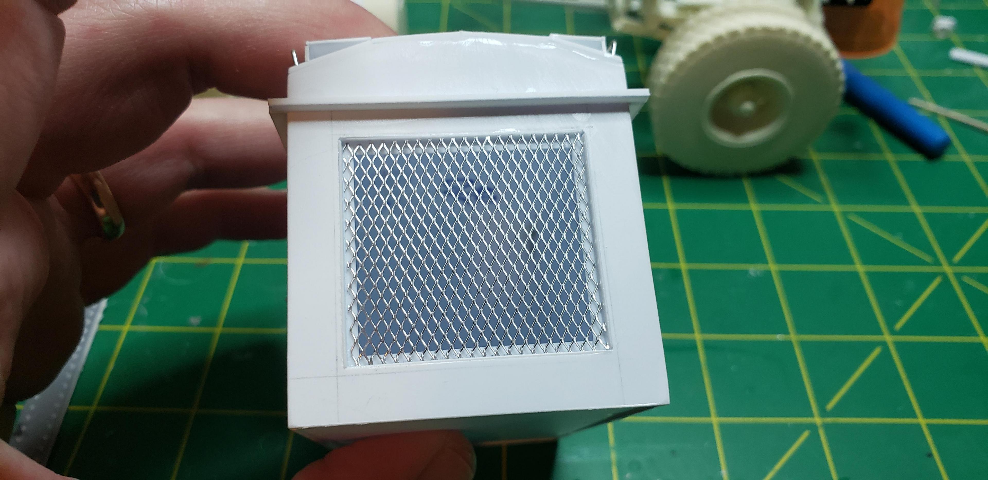

gotnitro? Posted September 9, 2021 Posted September 9, 2021 Looking forward to another fantastic build from your bench ! Enjoy these vintage truck builds that you build . That expanded metal screen looks similar to the type available in wire form screen from craft stores . Dave Natale suggested it for my catwalk on the snowblower, same that comes with his cabs
Chariots of Fire Posted September 9, 2021 Author Posted September 9, 2021 The wire screen is from KS Special Shapes. I've had it a while and I'm not sure if it is still available. Jeff: The screen I used is not woven. It is flat like punched screening would be. Is that what you used on the snowblower?
gotnitro? Posted September 10, 2021 Posted September 10, 2021 4 hours ago, Chariots of Fire said: The wire screen is from KS Special Shapes. I've had it a while and I'm not sure if it is still available. Jeff: The screen I used is not woven. It is flat like punched screening would be. Is that what you used on the snowblower? Its a flat sheet , looks kinda similar to the grill . Heres a pic from the blower just for reference to the pattern Wish the other materials were still available, these are the details that really make a build stand out. !
Chariots of Fire Posted September 10, 2021 Author Posted September 10, 2021 (edited) I'm with ya on that. Good looking screen. Mine is brass but looks quite similar. I like using odd stuff and I'm always on the lookout for items that can be used to benefit scratch building. Craft shops and even sewing and fabric shops are great places to get materials. Have you seen the new package of tiny brass tubing by Trumpeter? Next time I'm at the LHS I'm picking some up. Four different sizes with pieces about 6" long and they telescope. Edited September 10, 2021 by Chariots of Fire
Aaronw Posted September 10, 2021 Posted September 10, 2021 Another source of expanded metal is frying pan spatter screens. Many just use fine woven screens like the screen on a window or screen door, but some use really fine expanded metal. Can't go wrong with any relative of a Dodge Power Wagon. I'm sure this is going to be another great project. The trailer pump is great too.
gotnitro? Posted September 10, 2021 Posted September 10, 2021 Charles- no I haven't seen the new tubing yet ! I actually should pop into the lfs for a few supplies , weather sounds decent for a ride this wknd to take the Mach 1 out Aaron- the splatter screens are a good place to score screens too!
