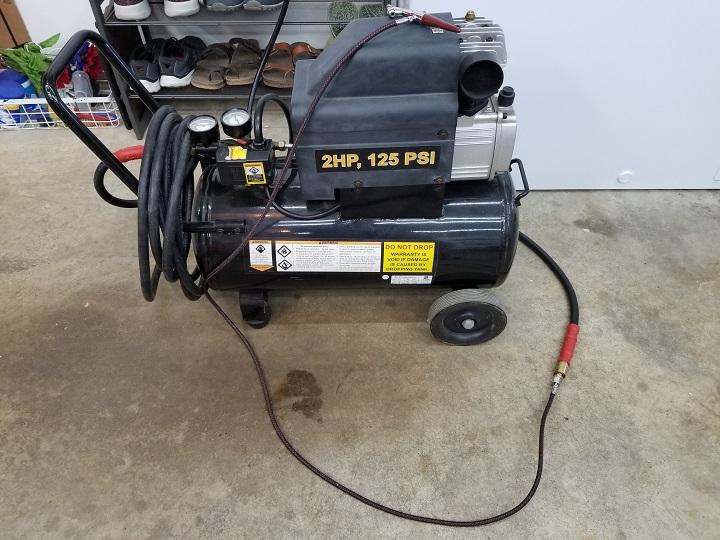

Zippi Posted September 12, 2021 Posted September 12, 2021 (edited) I bought my Paasche H about 6 months ago online somewhere just don't remember where. I think they were running a special and I got it for $59 and FREE shipping. It came with two plastic bottles and they are ok. I'd rather have glass. The air compressor I've had for some time. For acrylics I normally set it at 22 psi and the working pressure is about 18 psi. I was going to buy a moisture filter but never got around to it. Haven't had any issues but I still need to get one. Edited September 12, 2021 by Zippi
