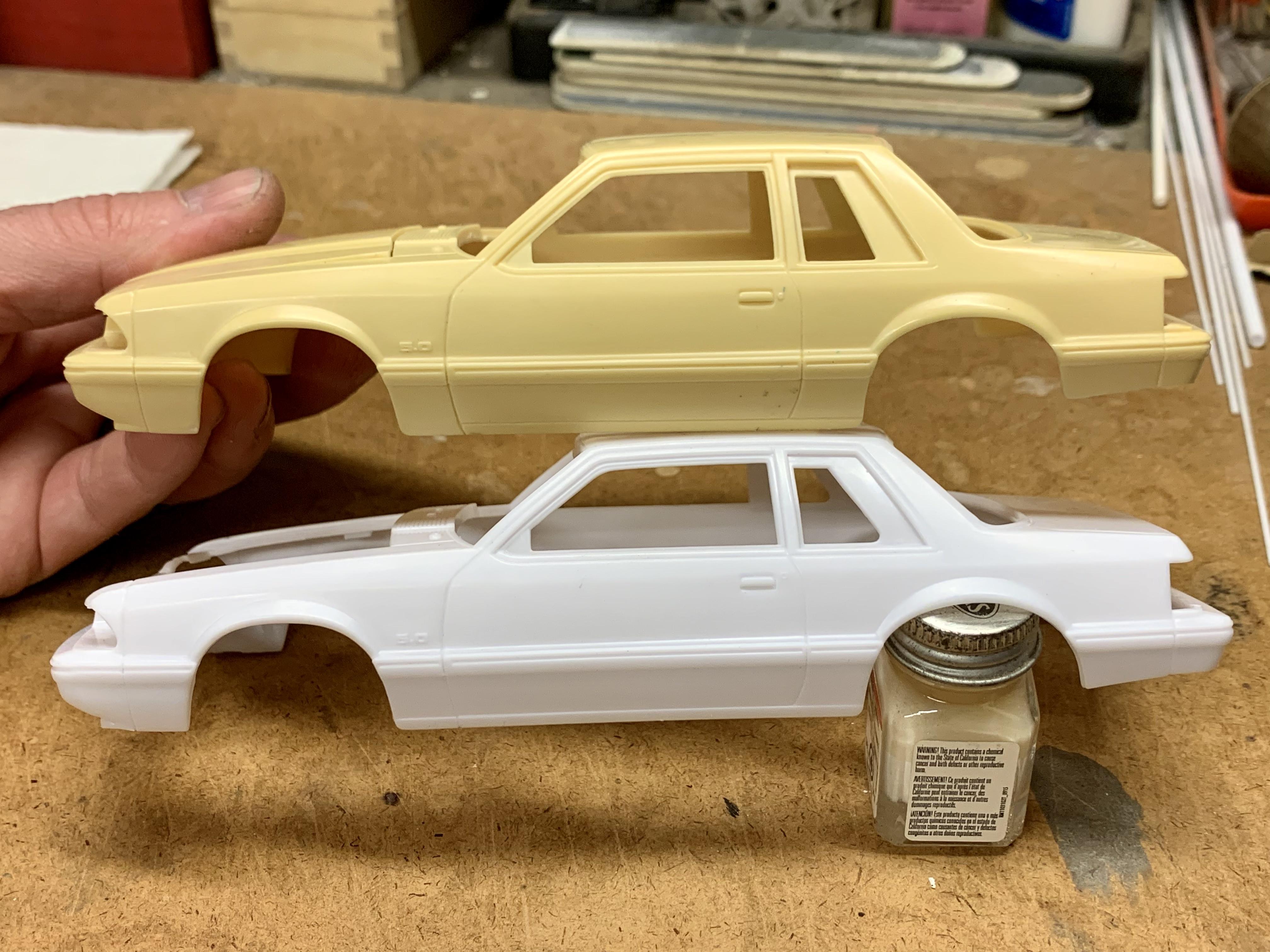

@tim boyd
You get a pass because your notchback experience was much longer ago than mine. But, yes, when comparing the kit and corrected bodies it’s undeniably obvious. And not just with the height of the roof but also the wheel openings, trunk lid edge and rear bumper width as my pictures show. I tried to convince myself it would be okay but in the end I just couldn’t.

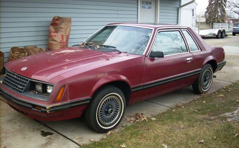

On 3/29/2022 at 9:09 AM, tim boyd said:
And I should have known better as I too owned a real one....in this case, a 1979 Ghia notchback 5.0L 4 speed manual overdrive.
What color was yours  Mr Boyd? I too had a 1979 Ghia Notchback with a 5.0 and automatic transmission. It was my 2nd car I’ve ever owned. I traded my first car(1974 Mustang II) and $150 for it and drove it for 3 years. Sold it to my local Mustang guru and it has sat in the exact same spot for the past 32 years. I went by one day and asked if he’d sell it back to me and it could be mine again for $400, I’m seriously tempted lol
  • Like 1
Keith....mine was Medium Red Glow metallic with a black vinyl roof and the medium red velour...what was yours?   TB
  • Like 1
Mine was just like this one with these wheels and interior
  • Like 1

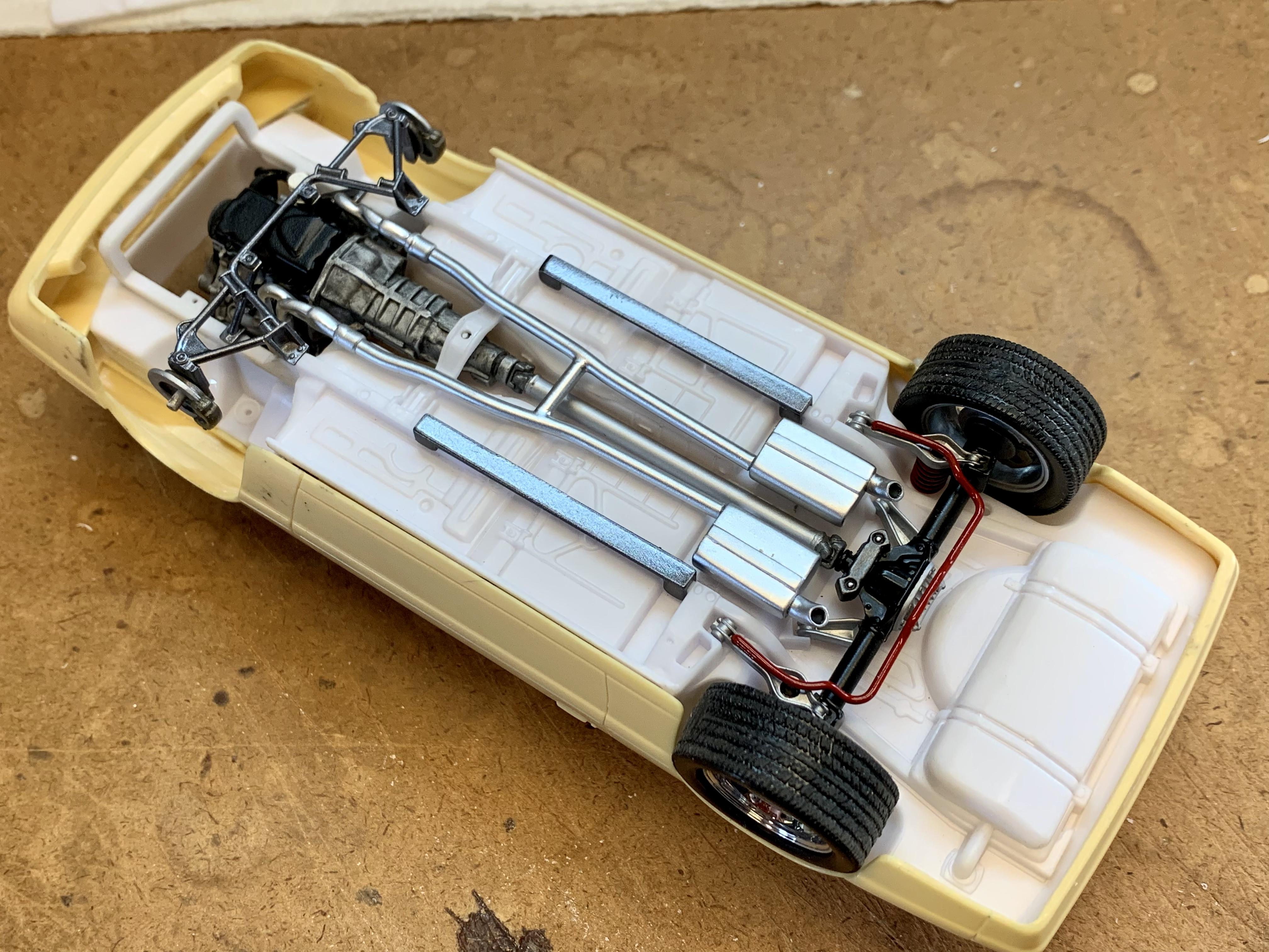

UPDATE!
Sadly, it looks like it’s been since March of last year since I’ve updated this project. I was on a good roll with it but it’s one of several that had to be put on the back burners when MCM asked me to contribute a model for issue 216. Then, as it often happens when I have a long hiatus from a project, I started second guessing the direction getting in my head that it wasn’t going well. ?

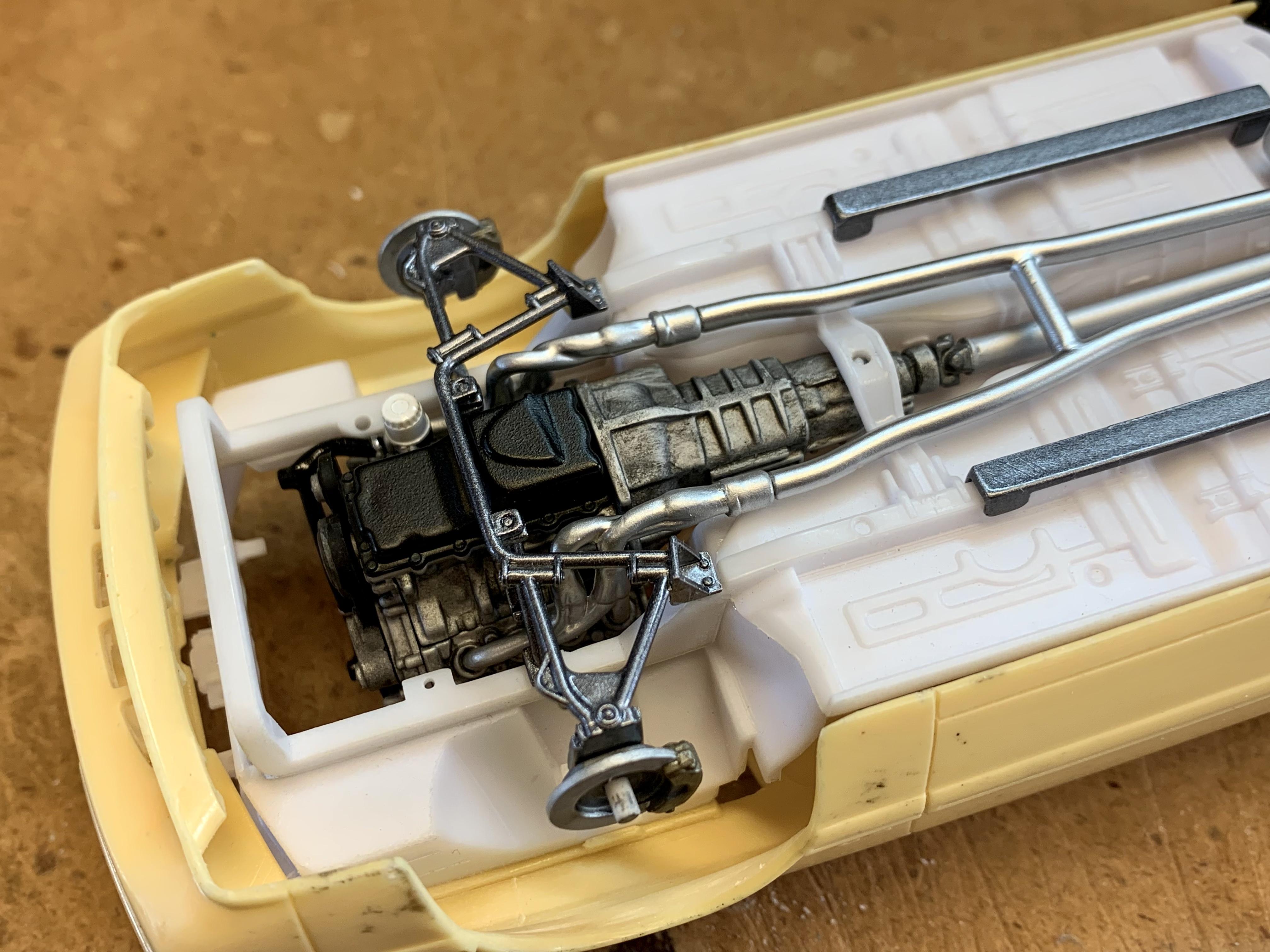

One issue I discovered last Spring that got me frustrated was that the engine sat too high not allowing the hood to close. After all of the mock ups I had done somehow this got by so I started going down the path of changing the engine to the 5.0 / T5 from the kit with modifications. I’d gone so far as to pull all of those parts and put them in the box a few months back.
Fast forward today and I decided to open the box and take another look at the engine height problem. This time I was able to visualize a (pretty) simple solution to the problem and make the DOHC SVT Cobra engine fit properly. It’s funny how time away can bring fresh perspective. So, I’m happy to say the the project can move forward without two steps back!

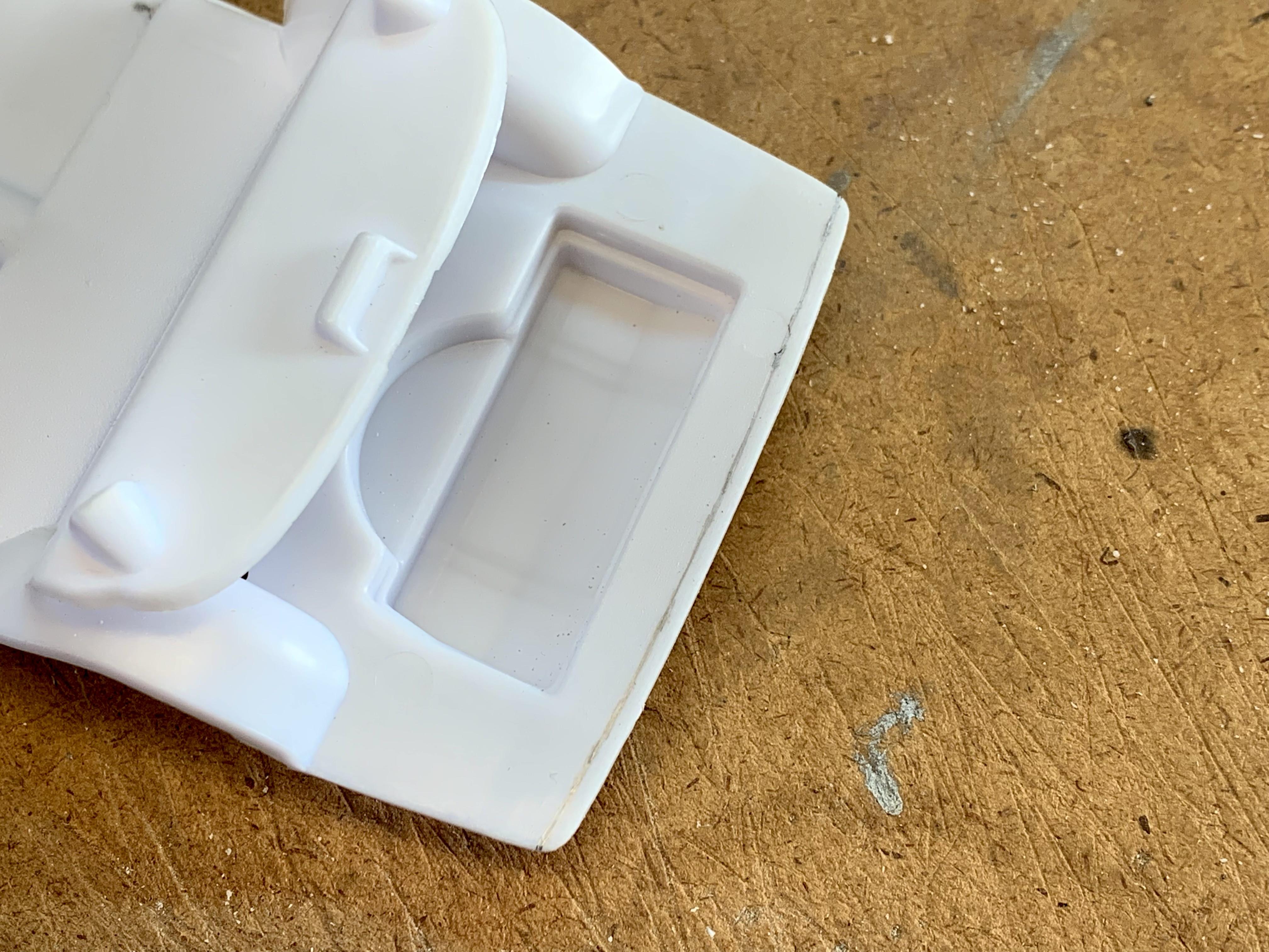

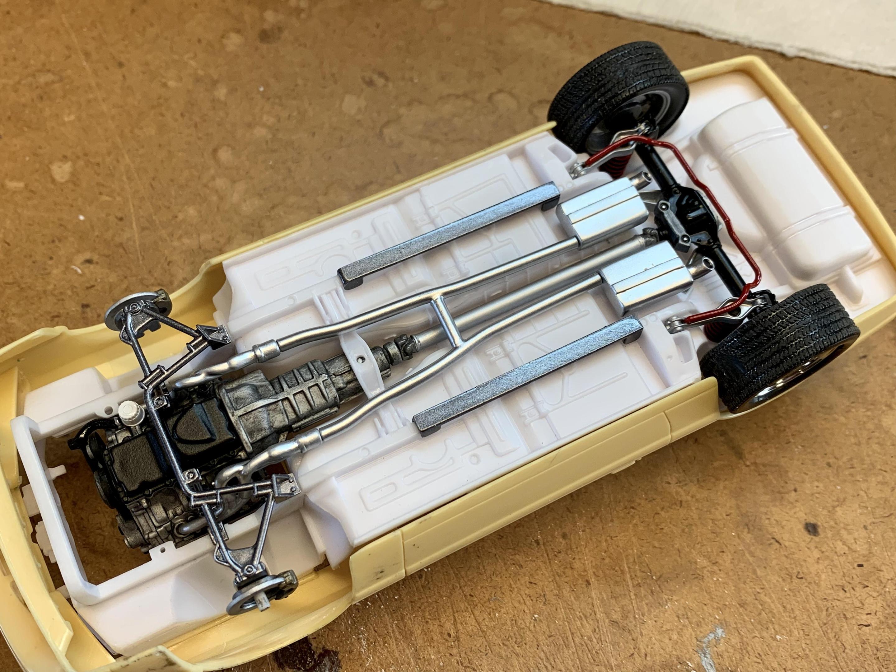

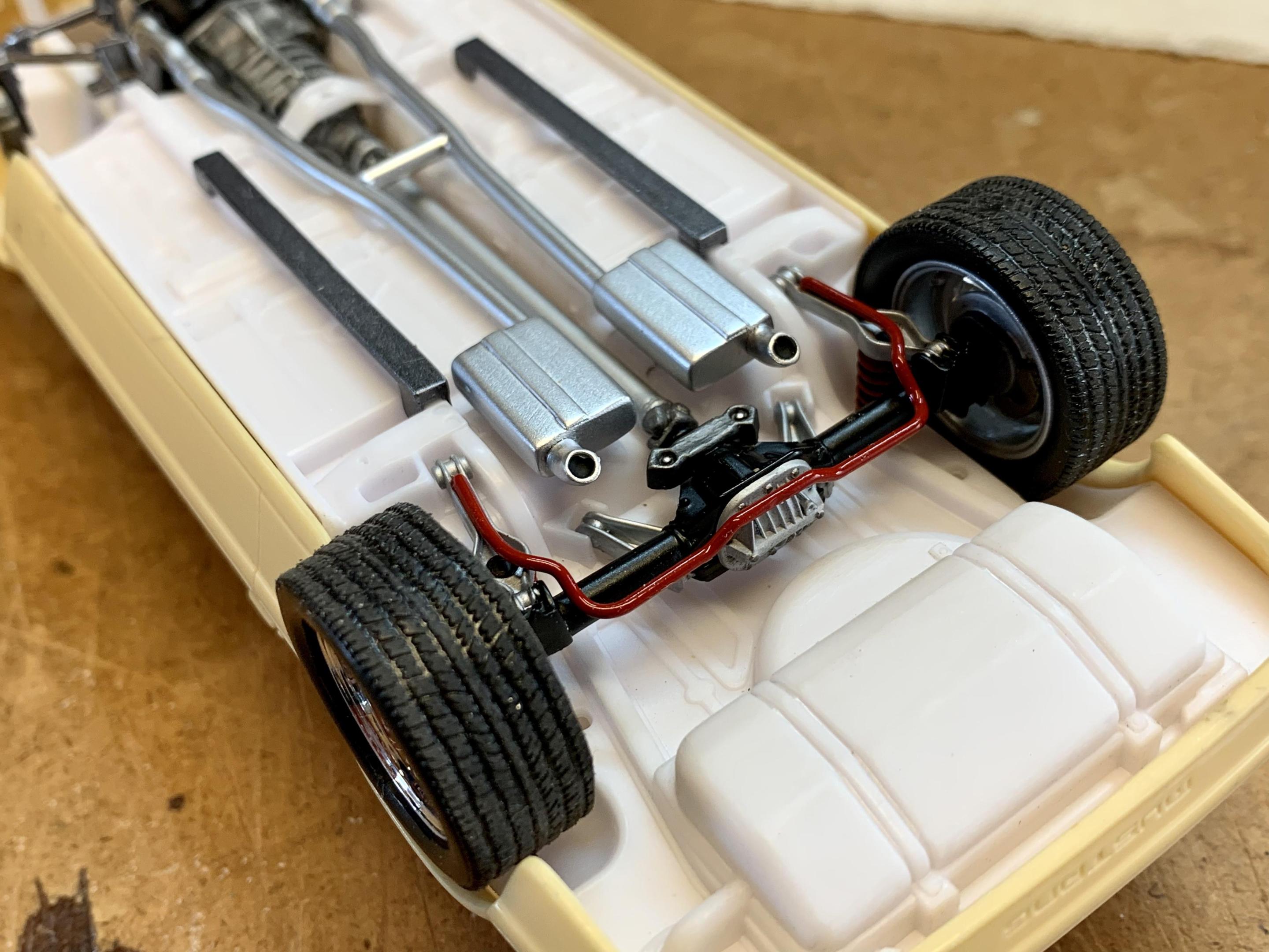

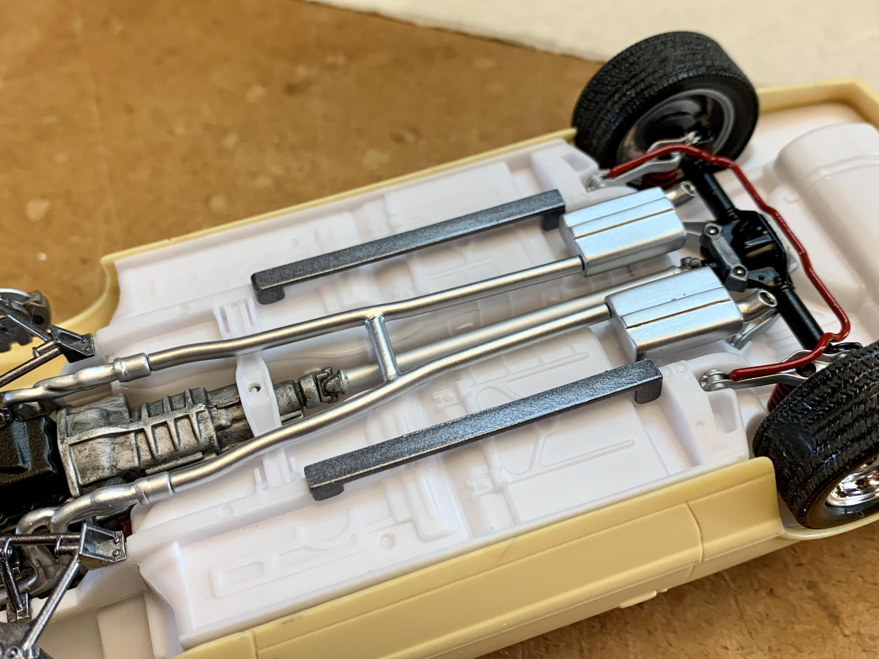

I was given a heads up when I bought the body that the back end of the floor pan would need to be trimmed because the rear bumper cover was tightened up by 1/16” on the master body to make the width of the ledge more accurate.
With that I figured I’d start with trimming 1/16” as I could always do more. As it turns out, that was the perfect amount.

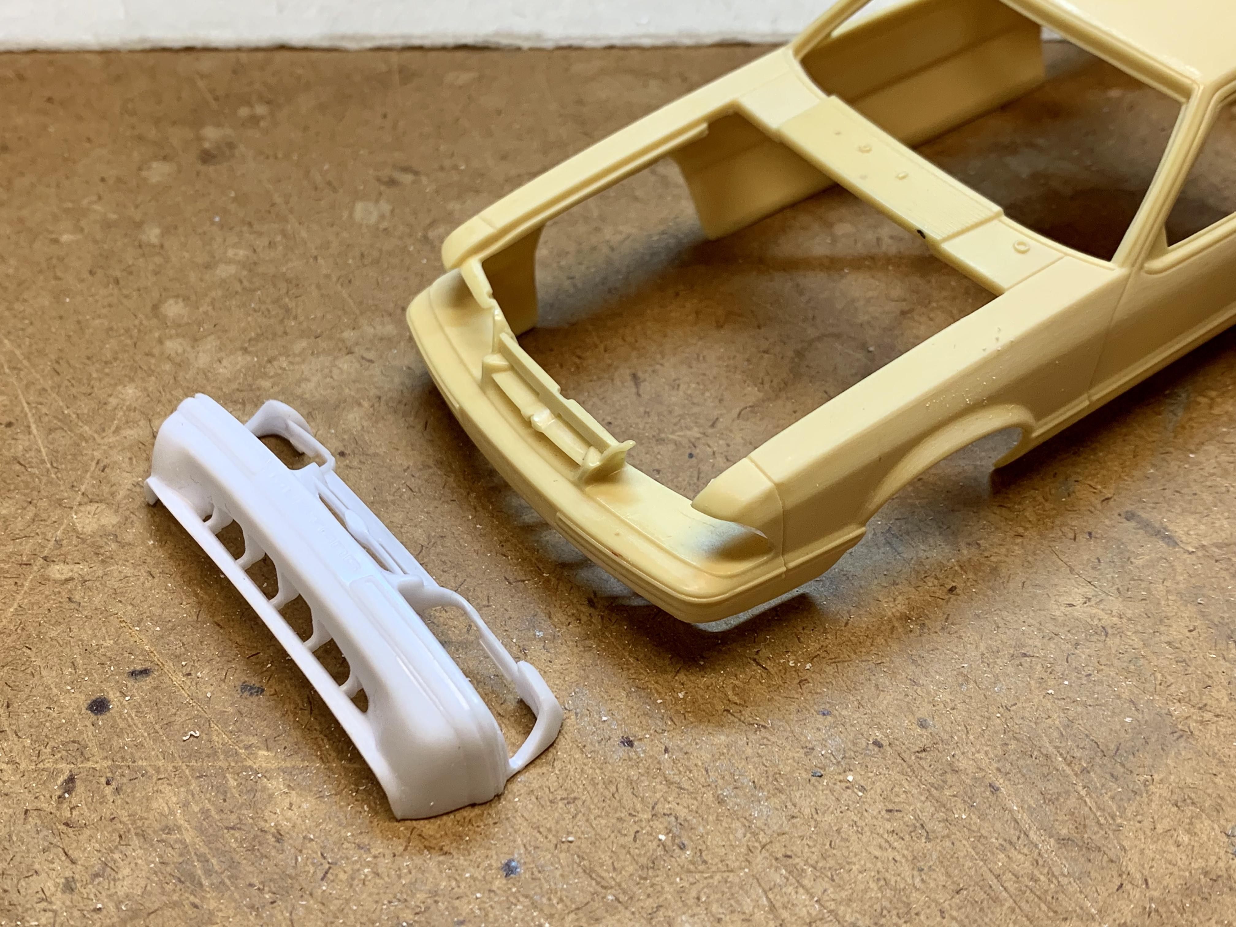

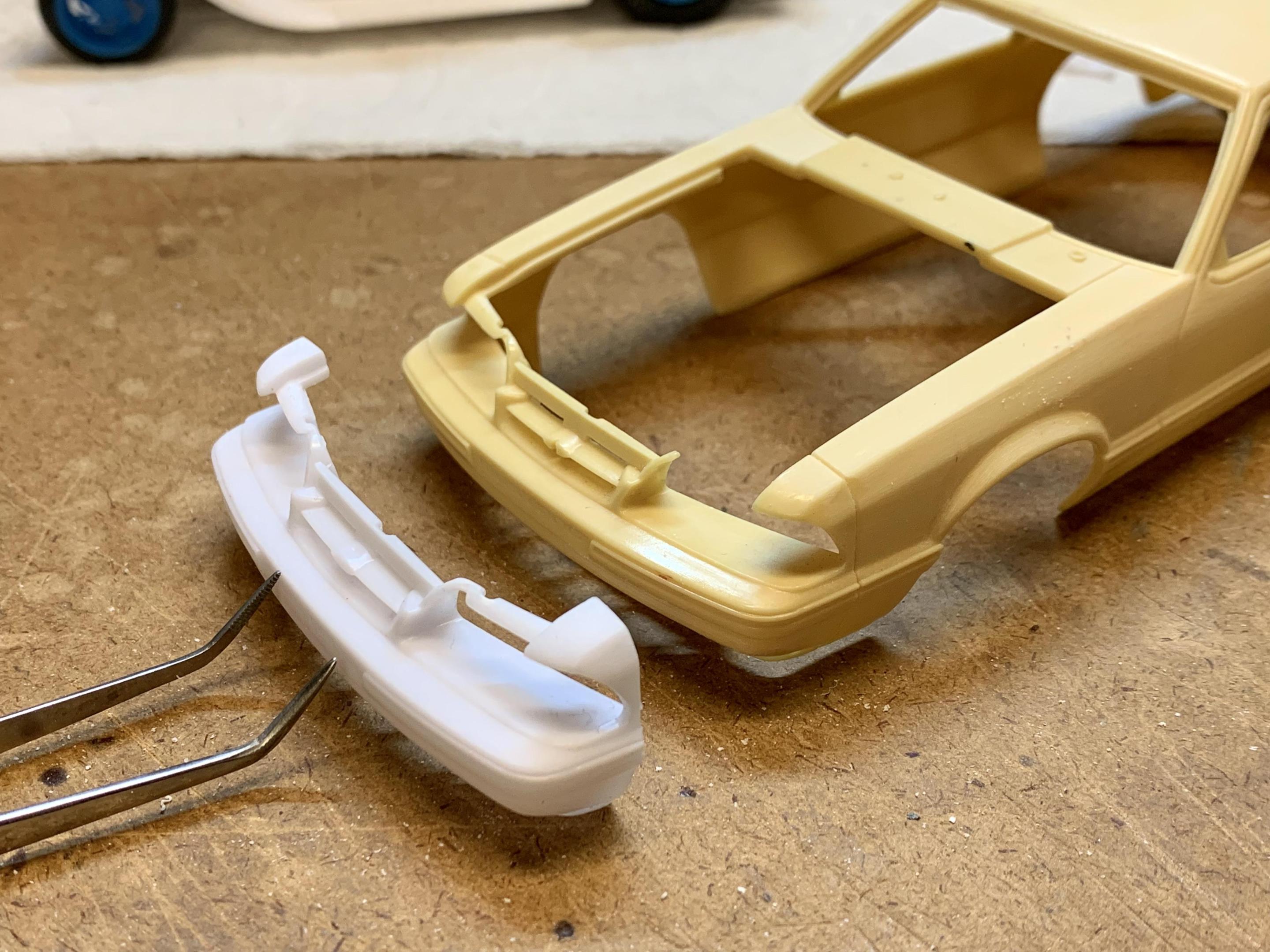

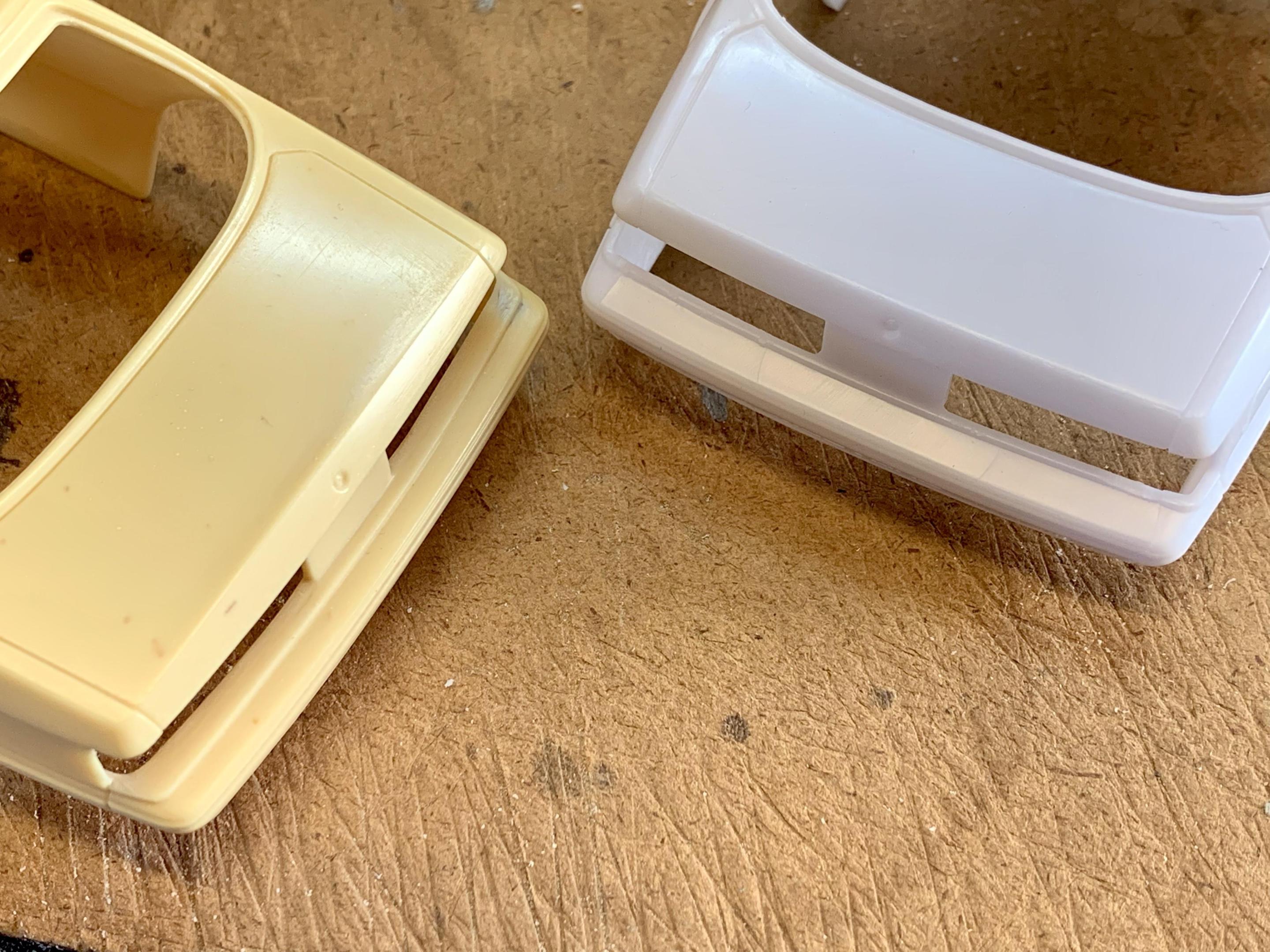

After trimming the floor pan assembly is a perfect fit in the body but I found it much more difficult to get it manipulated into place and I think that is largely because the  rear wheel openings on the resin body are smaller (corrected) which makes it hard to get the wheel wells past them. It’s also an extremely tight fit getting the front end up behind the bumper and into place as there’s details on the core support that protrude. It’s one thing to force things into place in bare plastic and resin but I don’t want a fight on my hands in the future during final assembly so my solution is that I’m going to cut the front bumper cover off the body so it can be installed separately after. It’s my understanding that the latest versions of this body are made with it separate.

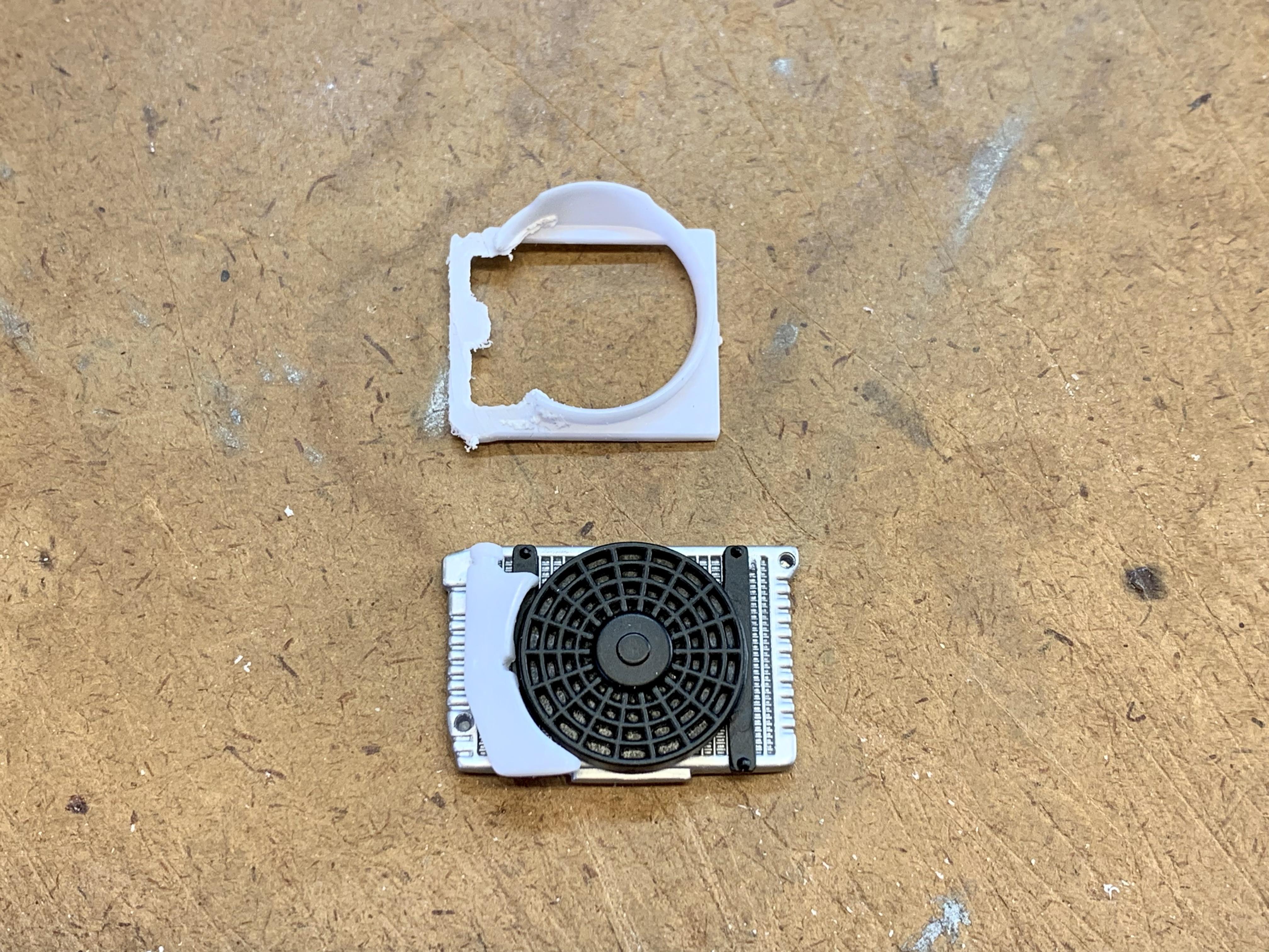

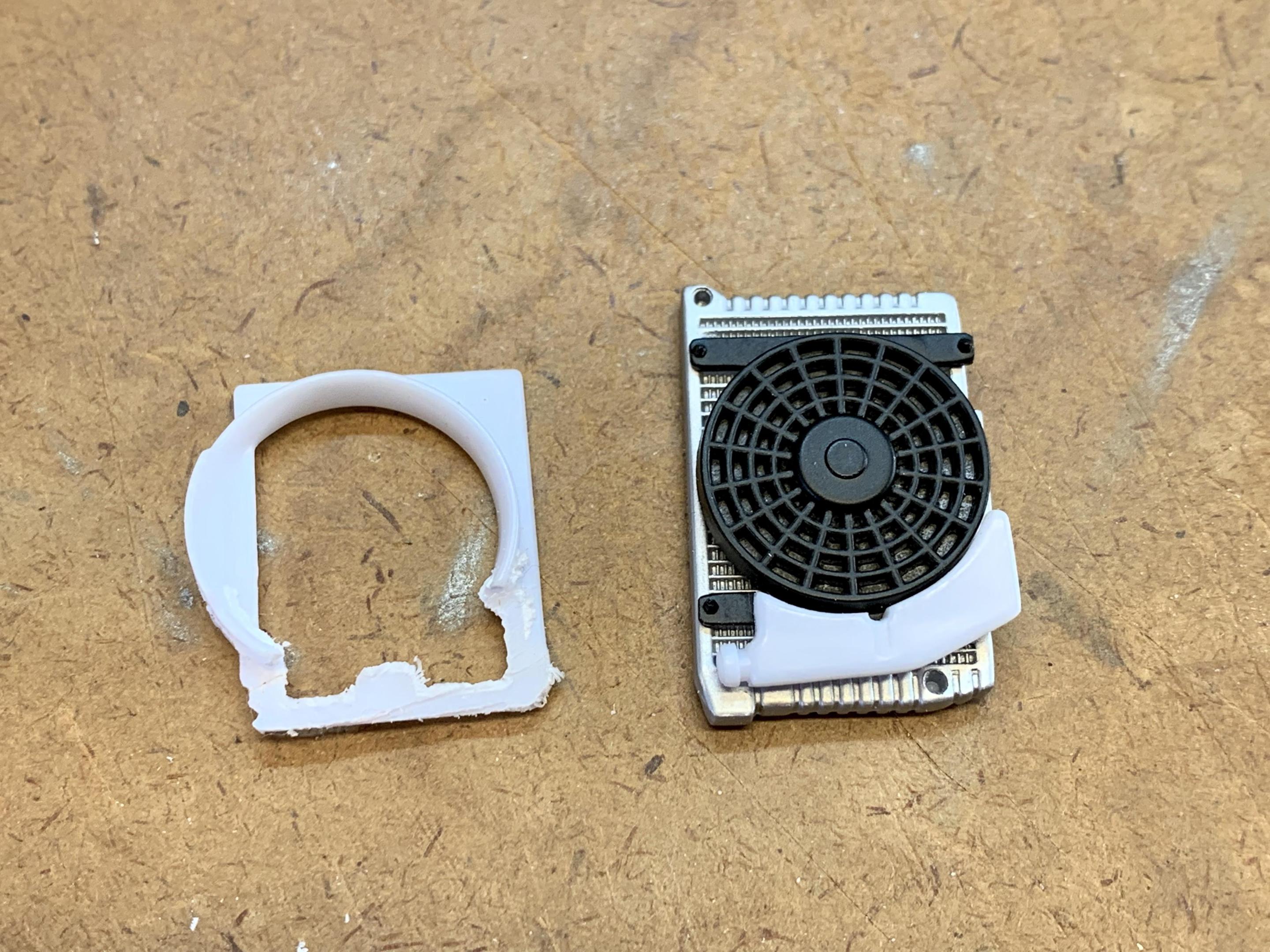

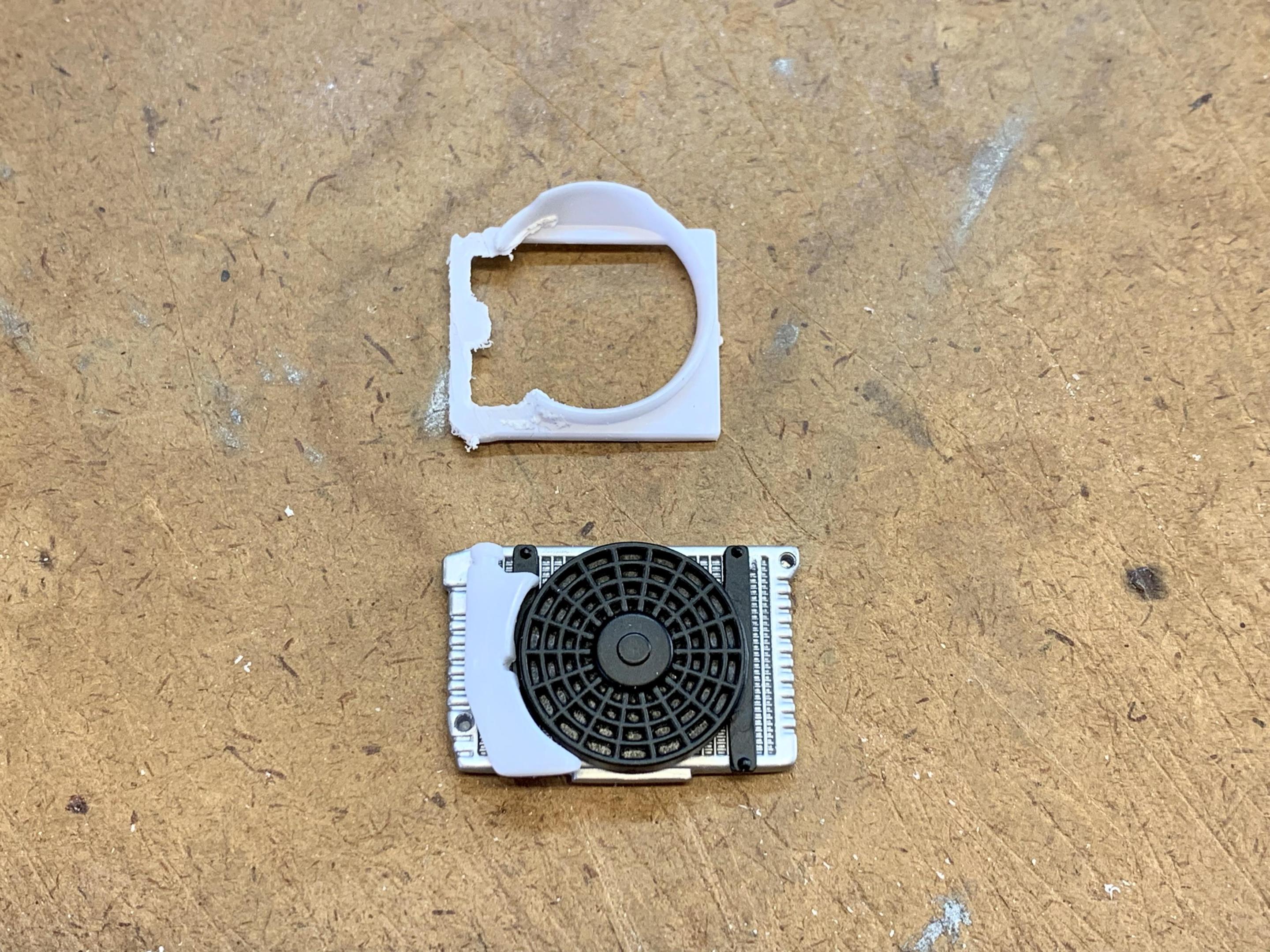

One of the details still needing to be figured out is a coolant overflow tank. I’m using the kit radiator with the electric frame from Revell’s 1948 Ford convertible. After some thought I realized I could carefully cut the factory tank away from the fan shroud and it’s a perfect fit up against the fan.
That’s pretty much it for today. I did take the opportunity while the floor pan was fit into the body to mock up the engine, exhaust, front k-member, rear axle assembly and subframe connectors to make sure everything is still fitting correctly. Thankfully I didn’t find any issues.
