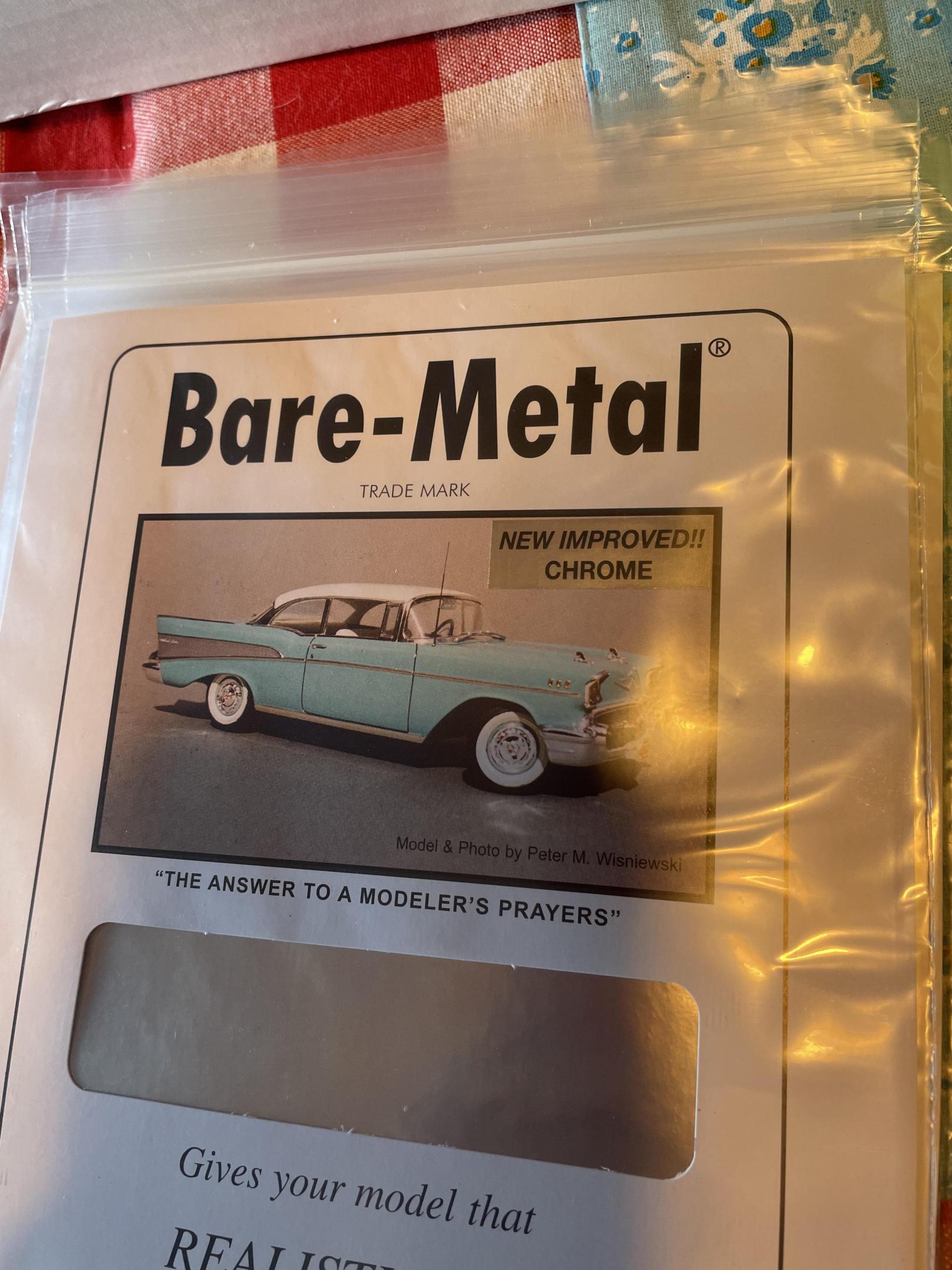

tbill Posted October 5, 2022 Posted October 5, 2022 I ordered 5 sheets from BMF Saturday, got it today ( Wednesday). It is packaged differently, each sheet in an individual zip lock bag, and what looks like the envelope is a fold open card with the foil sheet inside. I did a quick test piece, seems to be back to what we are all used to. I’m pleased that I can foil with confidence again after dealing with the sub par sheets I have purchased in the last year or so.
1972coronet Posted October 6, 2022 Posted October 6, 2022 2 hours ago, tbill said: I ordered 5 sheets from BMF Saturday, got it today ( Wednesday). It is packaged differently, each sheet in an individual zip lock bag, and what looks like the envelope is a fold open card with the foil sheet inside. I did a quick test piece, seems to be back to what we are all used to. I’m pleased that I can foil with confidence again after dealing with the sub par sheets I have purchased in the last year or so. Potentially silly enquiry here: Is the part number updated or changed? Any indication -- bar code, SKU -- that it is indeed the improved item (other than the "NEW IMPROVED CHROME!!" decal)?
