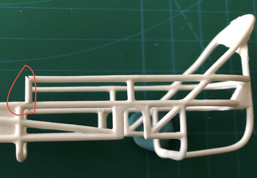

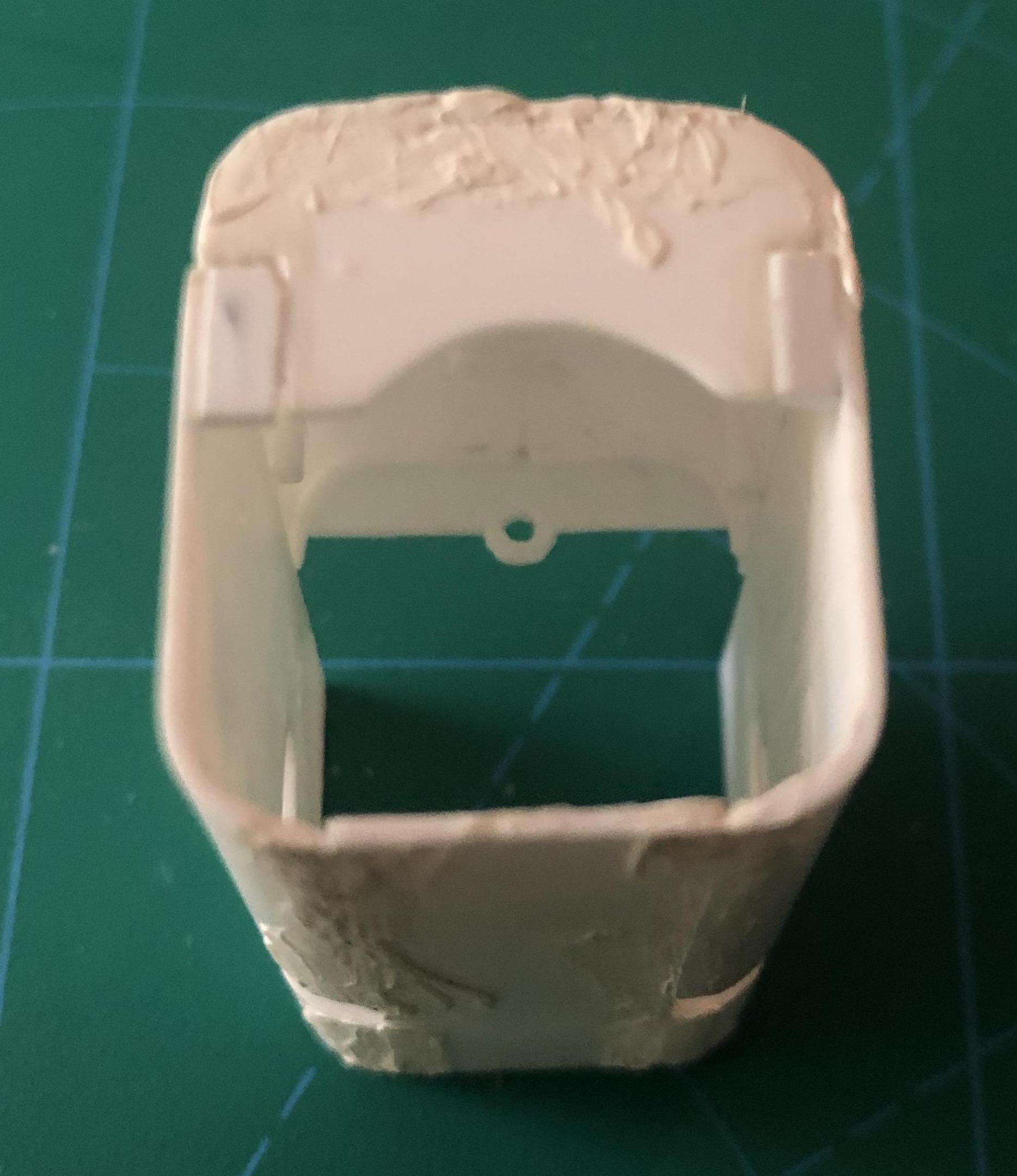

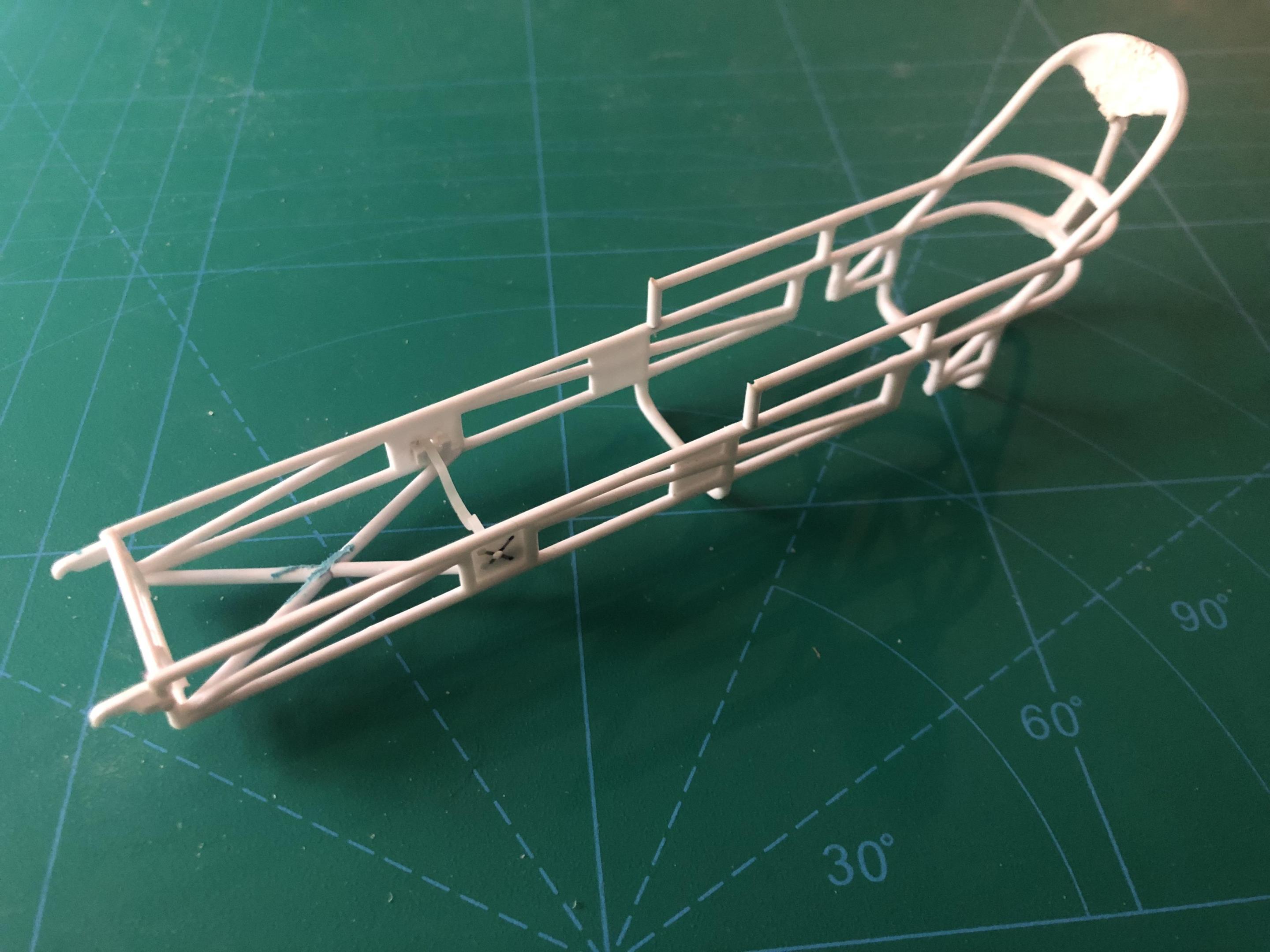

Bill Eh? Posted December 6, 2021 Posted December 6, 2021 I purchased this kit a couple of weeks ago. I have been in a non-building slump for too long. This is the kit that got me building again. Work started with assembling the frame. I glued the attachment points, moving from rearmost to the front. All in all, the frame members lined up well on the two halves. Please excuse the putty, which is yet to be sanded. After watching HPI Guy's build up on YouTube, I really wanted to do something about the seams/gaps between the panel components. So, I decided to assemble all of the pieces and putty the seems. Again, this needs sanding. There are two slots on either side of the firewall where vertical portions of the frame show through. Again, this did not appeal to me so I tried filling these slots in with strip styrene, to get a solid firewall appearance. Looking at it now, I will more than likely remove this piece and create a solid new piece from sheet styrene.

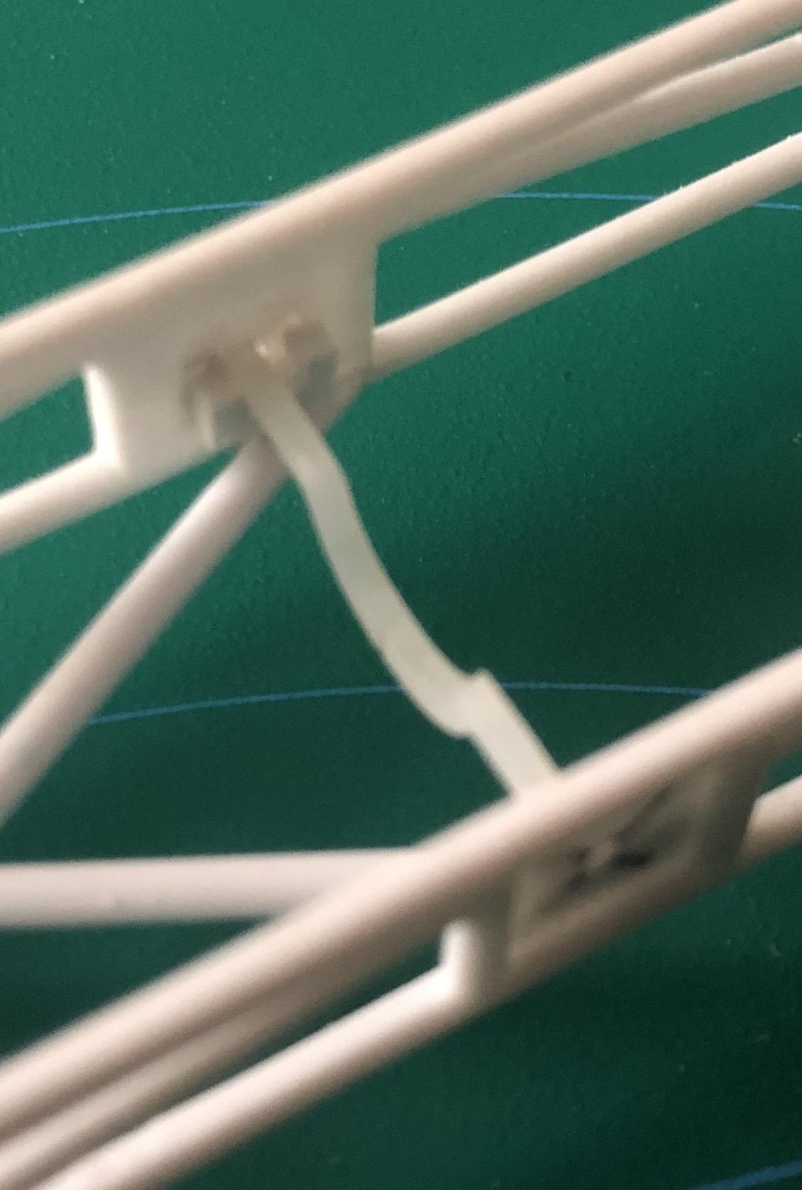

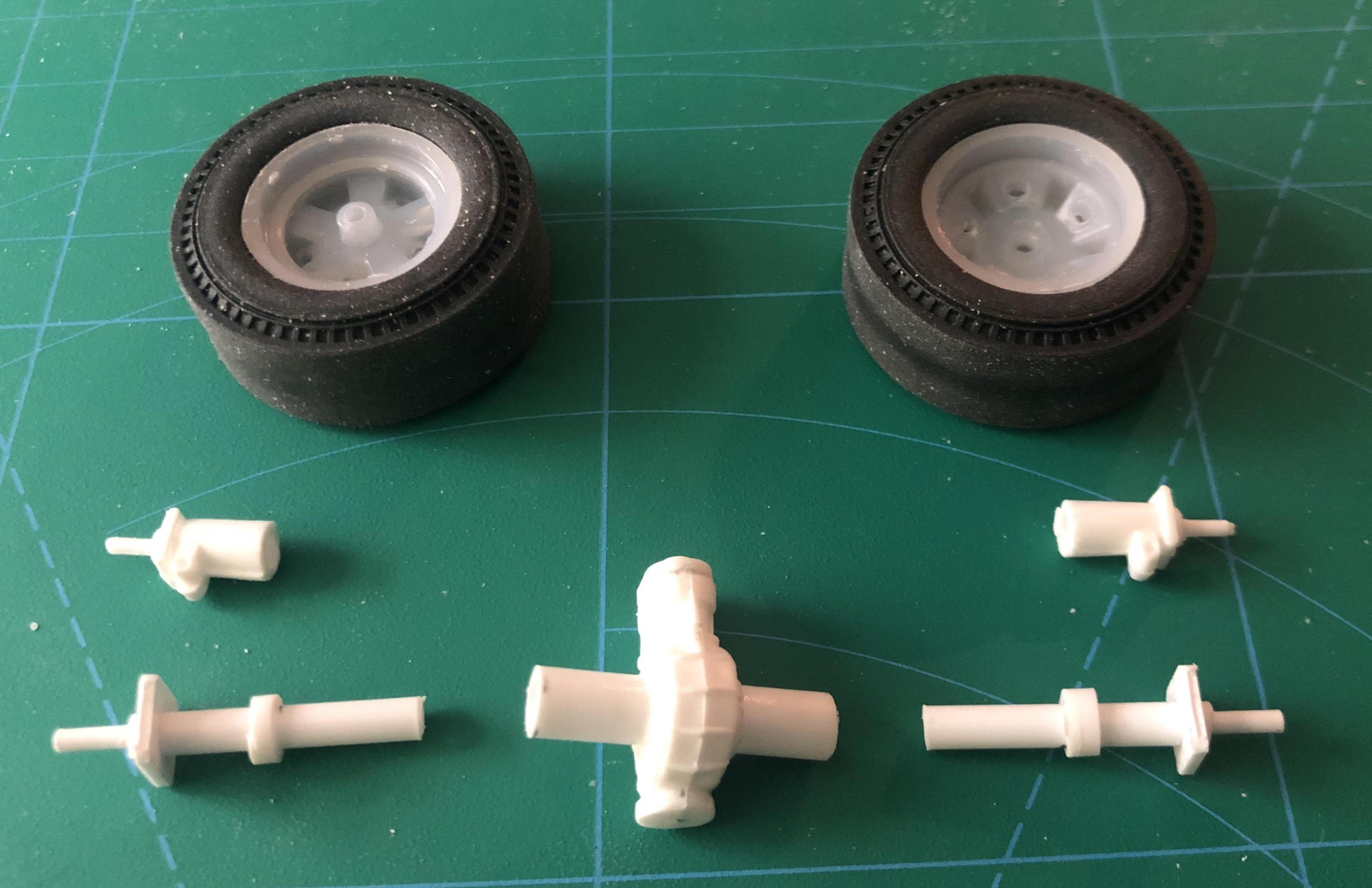

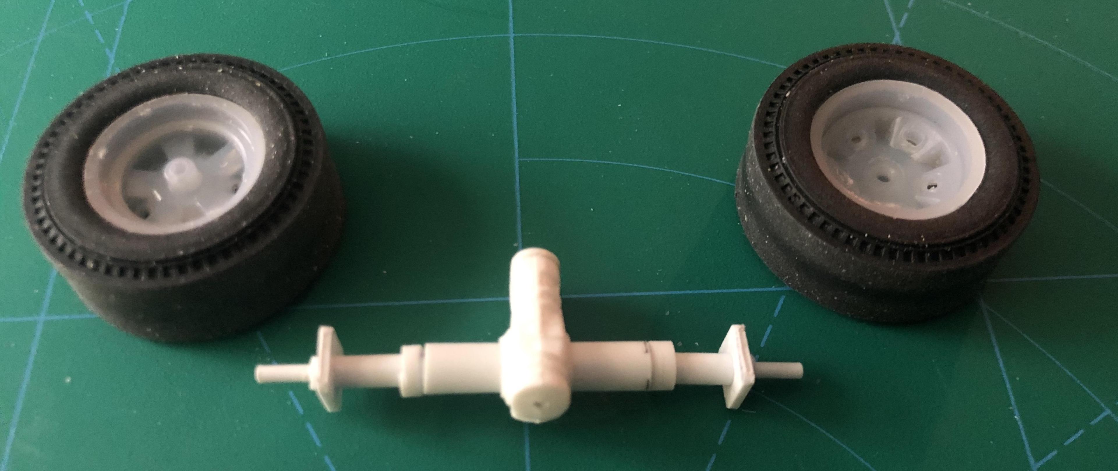

Bill Eh? Posted December 6, 2021 Author Posted December 6, 2021 By building up all the body panels, I had to think of a work around to installing the rear axle. My solution was to refabricate the rear axle into a component assembly. I started by installing a new styrene tube through the quick change differential. The width of this tube was cut to match the exact width of the frame when installed. This way, the one piece body can slide onto the frame from the front. The outer portions of the original axle were cut off, and refabricated with various sizes of Evergreen tube, rod, and strip. These new axle end, with wheels attached, will just slide into the axle/quick change already mounted in the body.

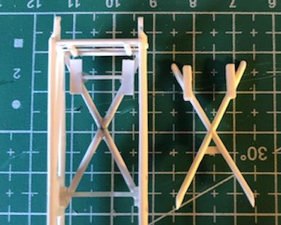

Bill Eh? Posted December 6, 2021 Author Posted December 6, 2021 The engine mount, as indicated in the instructions, is far too wide for the frame. To make it fit required cutting off the "triangular" portions on both sides of the engine mount. This meant that the gluing surface on the engine mount was next to nothing. I made c-hannel style mounts, and glued them facing up on both sides of the inside of the frame. With the firewall glued in place, there was interference with a vertical portion of the frame. To eliminate this, I moved the vertical portion of the frame, slightly rearward on both sides. This solved the interference issue. The joints need some work. LOL

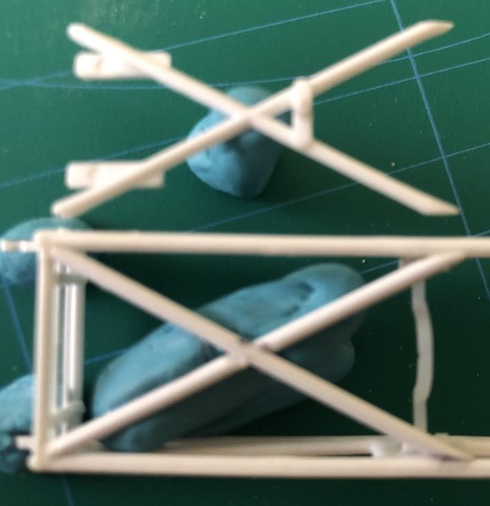

Bill Eh? Posted December 6, 2021 Author Posted December 6, 2021 I was not happy with the fit of the cross member, which glues in at the front of the frame. I made a new one. It still requires the rectangular pieces to be placed on the top for holding the moon tank, as well as the downward facing pin to attach the back of the wishbone. I learned that it takes a great deal of patience to fish-mouth 1/16" rod. The picture shows the new cross member glued in place, with the kit part right beside it. Please excuse the blue tac. More to come.... 2

Bill Eh? Posted December 13, 2021 Author Posted December 13, 2021 15 minutes ago, peter31a said: Looking mighty fine so far, Bill. Jumping back into building by doing this much scratchbuilding is truly inspirational. Thanks Peter. After sanding down all of the body seams, I was disappointed with the results of the Vallejo putty. I redid all of them with Tamiya putty along with the moon tank. Both halves of the moon tank slightly taper from the outer portion to the centre where they join. This gives a valley-like appearance around the centre of the tank. LOL
