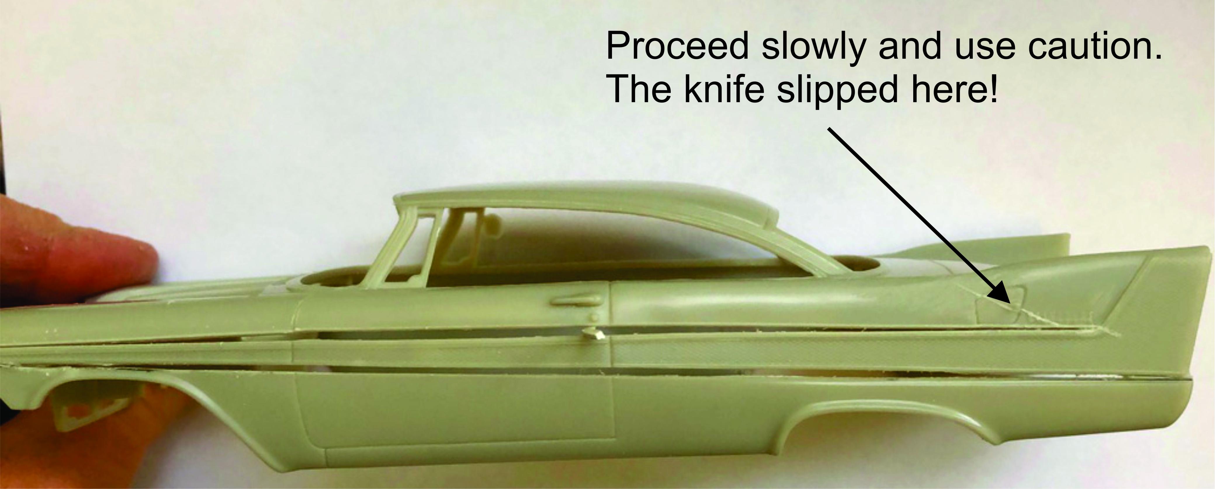

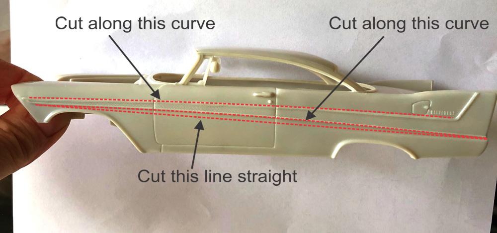

Smitty Posted December 13, 2021 Posted December 13, 2021 Much has been written about the infamous AMT '58 Plymouth and it's incorrectly curved side trim. Some modelers have pointed out other problems with the body in this kit, but I decided that the side trim was the one thing I could not live with. The most obvious solution would be to remove the crooked trim and recreate it. I didn't have the confidence in my skills to pull that off and achieve satisfactory results, so I thought I'd see if it was possible to use the trim that was already there - but straighten it. I made a series of cuts with the back of a #11 xacto blade through the sides of the body and pulled the trim down into a straight line and glued it there. Then I filled the gap above the trim with slivers of styrene and CA. There's lots of putty and sanding to come, but I believe I'll be happy with it when it's done. The body issues aside, this is a nicely detailed kit in my opinion. I'll post more pictures when it's finished. 1
moparfarmer Posted December 13, 2021 Posted December 13, 2021 16 minutes ago, Smitty said: Much has been written about the infamous AMT '58 Plymouth and it's incorrectly curved side trim. Some modelers have pointed out other problems with the body in this kit, but I decided that the side trim was the one thing I could not live with. The most obvious solution would be to remove the crooked trim and recreate it. I didn't have the confidence in my skills to pull that off and achieve satisfactory results, so I thought I'd see if it was possible to use the trim that was already there - but straighten it. I made a series of cuts with the back of a #11 xacto blade through the sides of the body and pulled the trim down into a straight line and glued it there. Then I filled the gap above the trim with slivers of styrene and CA. There's lots of putty and sanding to come, but I believe I'll be happy with it when it's done. The body issues aside, this is a nicely detailed kit in my opinion. I'll post more pictures when it's finished. You've done some pretty extensive work on that side trim..Looks much better..
