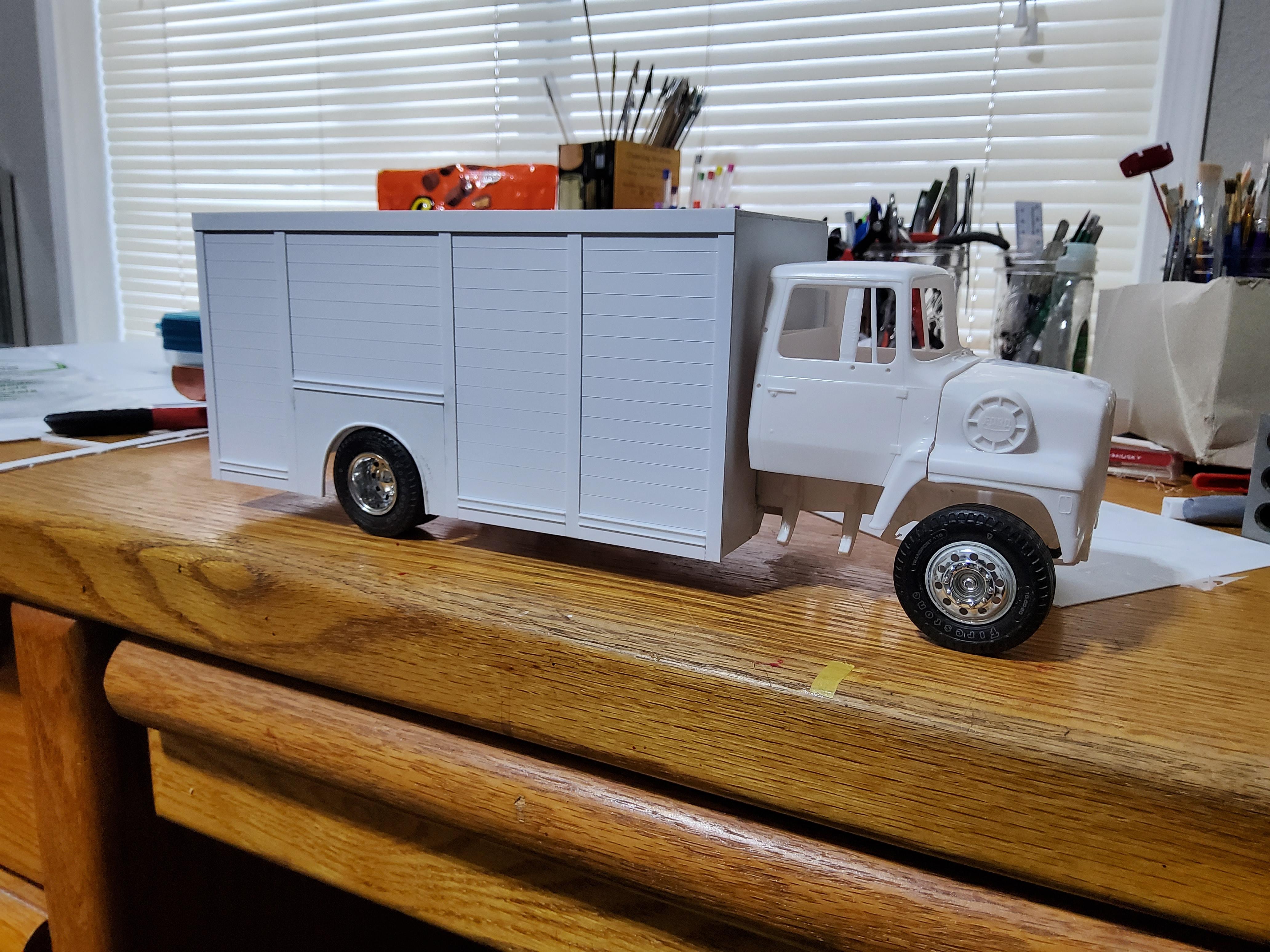

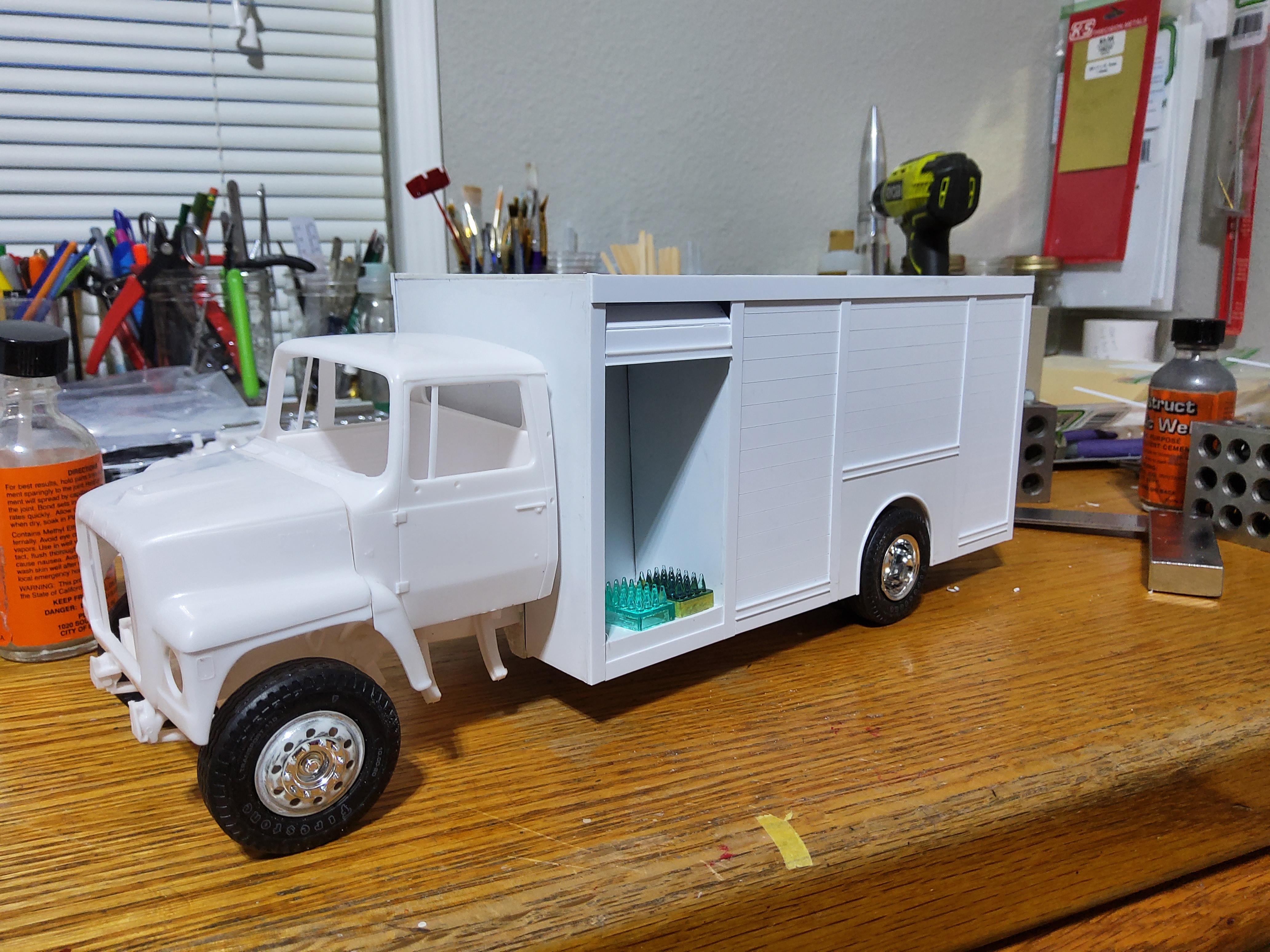

Oldmopars Posted January 24, 2022 Author Posted January 24, 2022 (edited) The Coketruck is moving forward. I have half of the beverage box finish. I did the right side first because it will not open. I have planned all along to have 1 of the side doors open to see inside and see the stack of coke bottles. This is going to be more work, so I did the easy side first. Right now I think the box sits a bit too low, I an going to raise it up at least an 1/8 inch. The box needs to be low, it is a city truck and the low box makes it easy to load and unload. But I think it is just a little bit too low. This will be an easy fix as the box slots over the frame. I will just add spacers till it looks right. Now for the hardside. Edited January 24, 2022 by Oldmopars

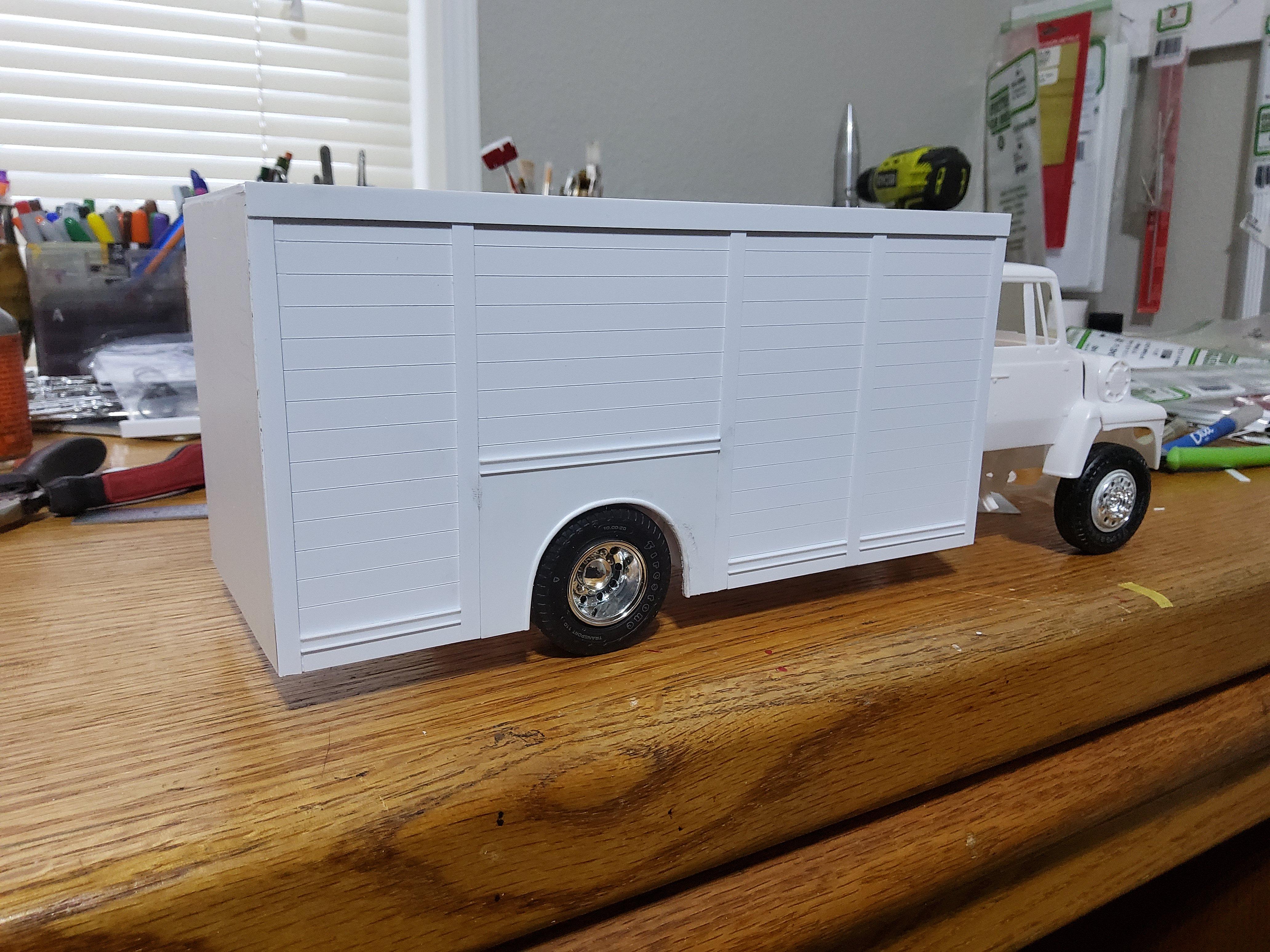

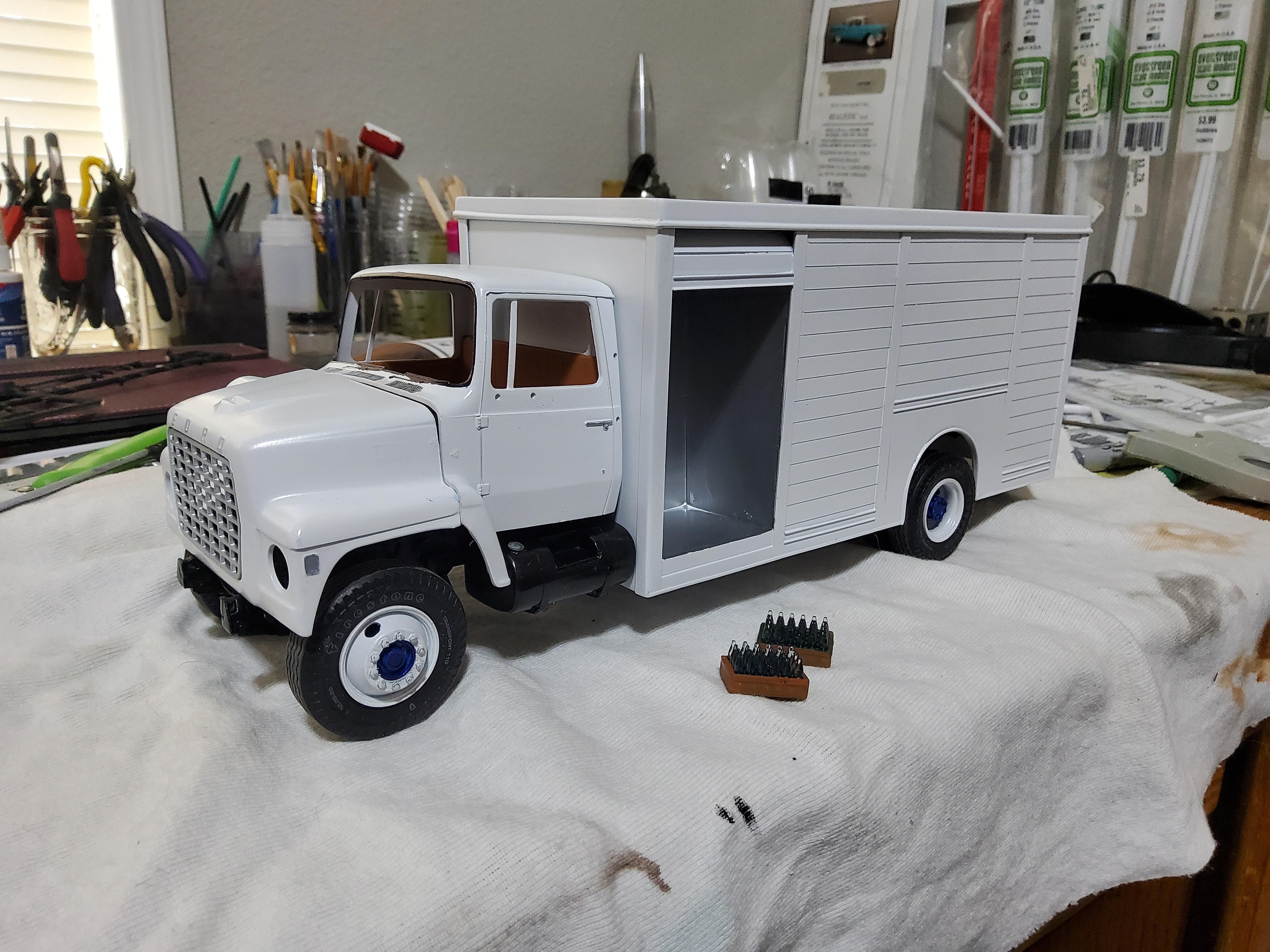

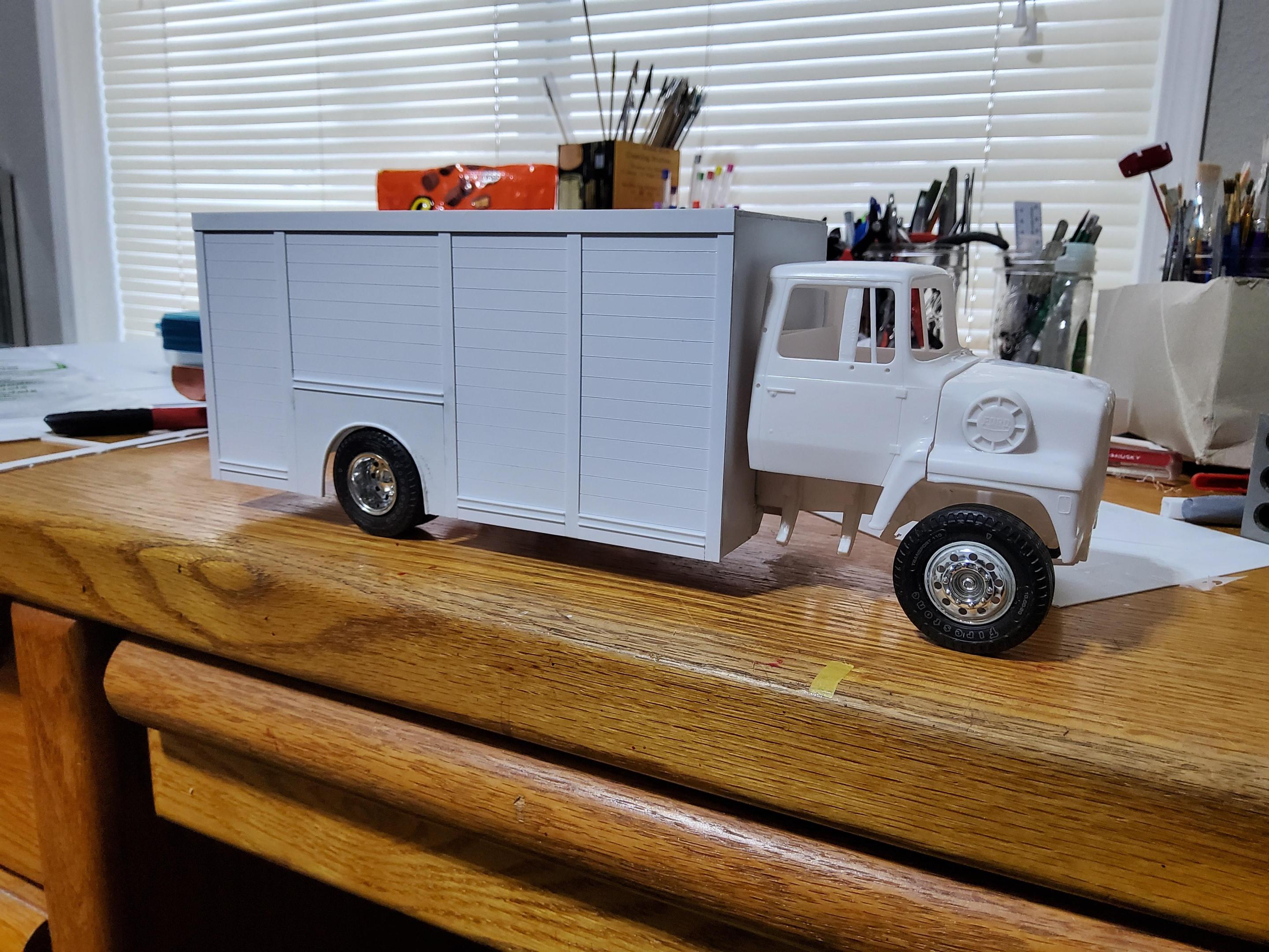

Oldmopars Posted January 24, 2022 Author Posted January 24, 2022 Well, some time later. I now have the left side done. There is still much to do, lots of seams to fill, lights to add. I may add some more details and moldings, etc. But the basic box is there. 1
mgreco53 Posted January 24, 2022 Posted January 24, 2022 Looking good, the pictures of the real truck look like the bottom of the edge is even with the rear hub.
DRIPTROIT 71 Posted January 24, 2022 Posted January 24, 2022 That looks awesome! Very nice looking drink bed! Excellent scratch building!
Mopar - D Posted January 24, 2022 Posted January 24, 2022 Excellent scratch building Scott your nailing this one!
doorsovdoon Posted January 24, 2022 Posted January 24, 2022 Looking good. That box is very well done, nice work.

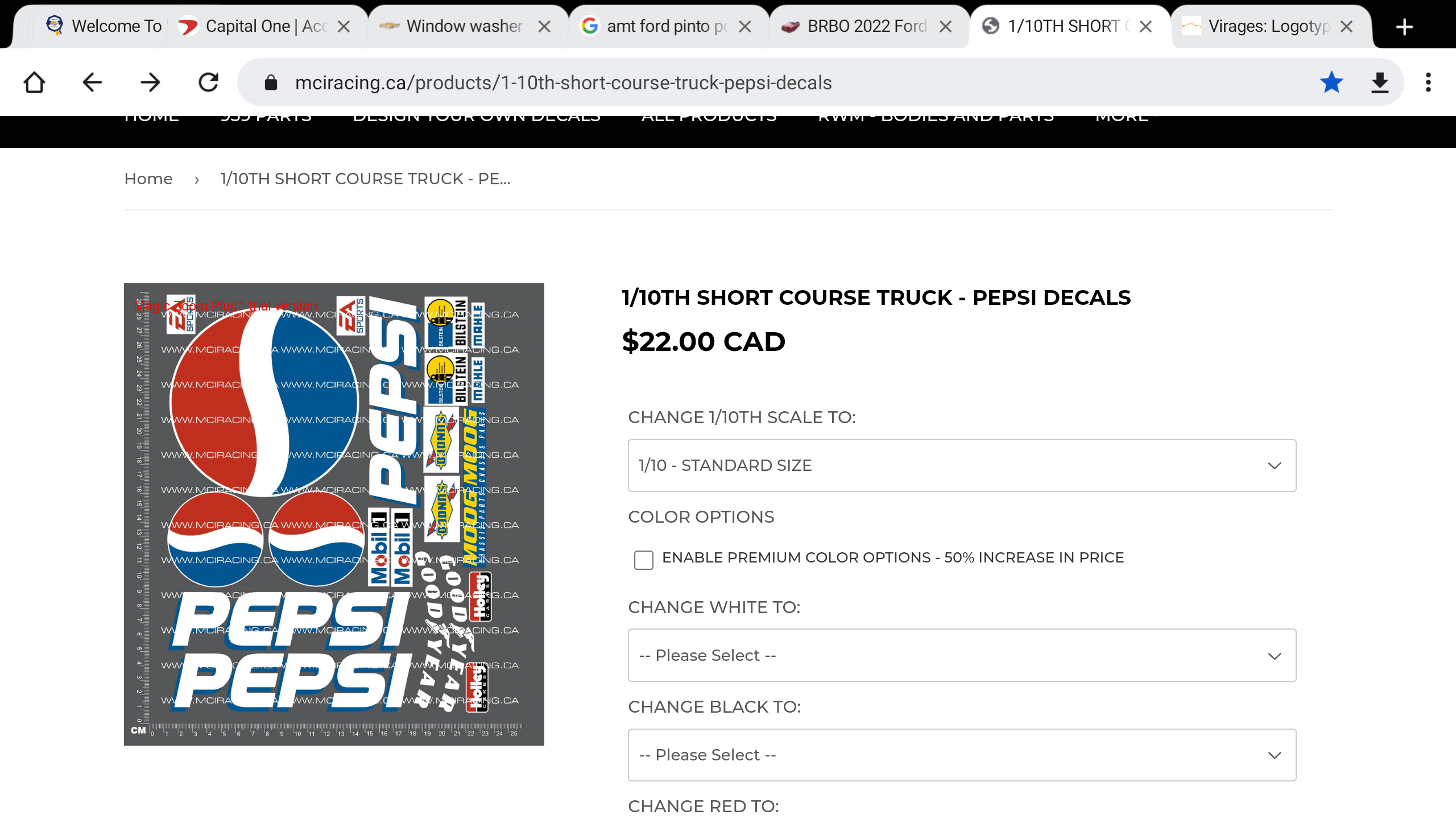

Oldmopars Posted February 10, 2022 Author Posted February 10, 2022 On 2/7/2022 at 7:27 PM, vincen47 said: Keep it up, great work. I like the round wheel opening. I’d say it looks a little more vintage that way, but I’m sure they’re examples of modern units that have a round opening too, and visa versa. Understandable using the Coca Cola decals, not like there’s a shortage of those. I’d love to see Pepsi, or a lesser-known brand like Sundrop, Sunkist, or Faygo, but gotta go with what’s available. Heck, even RC Cola. Maybe there’s the block “Coke” rather than script “Coca-Cola” decals to be a little different? I will look and see what I can find. I would like to go with Pepsi, there are just no easy to get decals. I will check Ebay.
Oldmopars Posted February 10, 2022 Author Posted February 10, 2022 I may have found an option. You can sellect the decals in different scales. I will just need to do some measuring and see what scale I need to order it in.
tbill Posted February 10, 2022 Posted February 10, 2022 3 hours ago, Oldmopars said: I may have found an option. You can sellect the decals in different scales. I will just need to do some measuring and see what scale I need to order it in. I think I have a sheet of the Pepsi decals from the AMT box truck, yours if you want them ( and if I can find them, lol)
Oldmopars Posted February 10, 2022 Author Posted February 10, 2022 29 minutes ago, tbill said: I think I have a sheet of the Pepsi decals from the AMT box truck, yours if you want them ( and if I can find them, lol) That would be awesome, I will pm you my address.

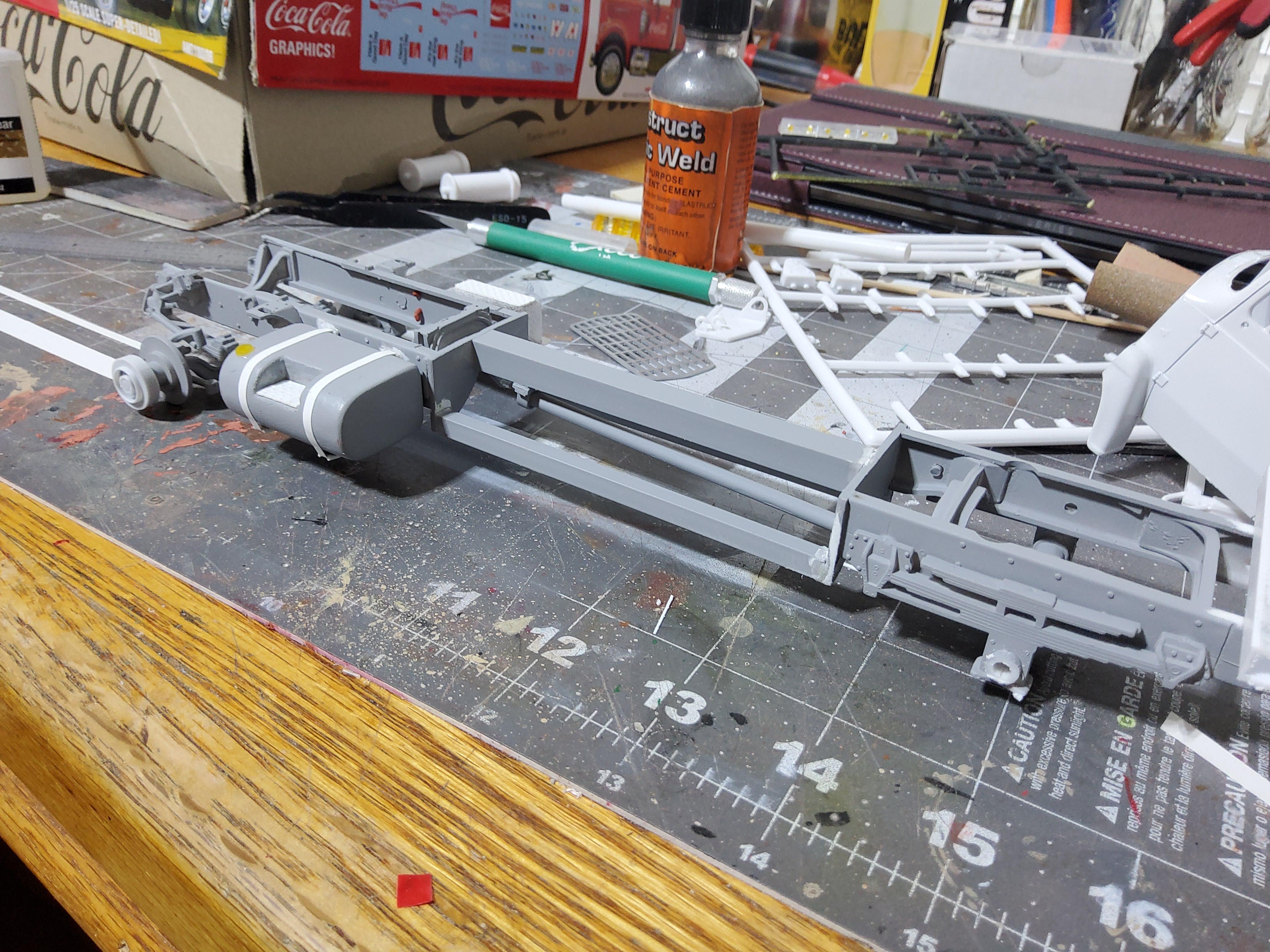

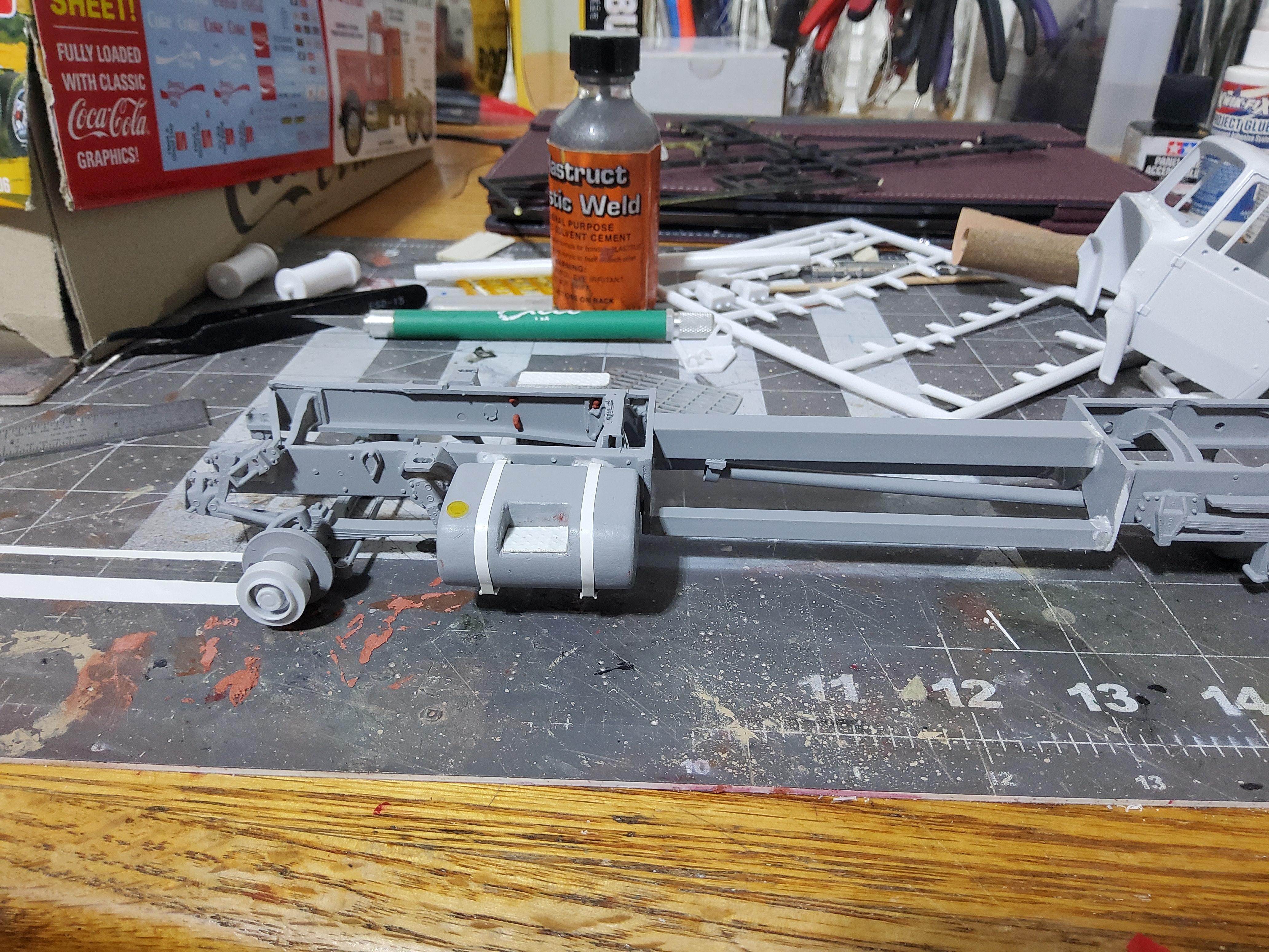

Oldmopars Posted February 20, 2022 Author Posted February 20, 2022 I really wanted to have a D shaped tank, but I just didn't want to buy one. Too much time to gett it and too many vendors are out of stock. So, I made one out of sign foam, its a lot like Renshape. I had to coat t with some putty and primer to fill the texture. The straps are electrical tape. I got some paint on the frame and the body. I wanted to add a little color, but every truck I can find pictures of are all black. So, I painted the hubs to just add a little pop of color. 2
gotnitro? Posted February 20, 2022 Posted February 20, 2022 Outstanding work Really like the open door you added, adds another dimension to the build
Mopar - D Posted February 20, 2022 Posted February 20, 2022 Coming along nicely Scott looking forward to seeing your next update.
