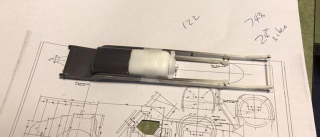

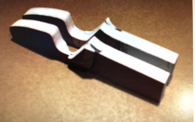

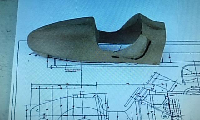

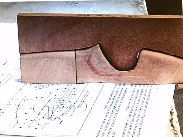

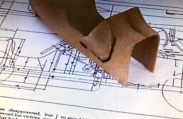

Starting with the Drawings from the Miller Dynasty book and a block of Renshape - this was the start of the project - photos not so good - these were taken pre I phone …
  • Like 1

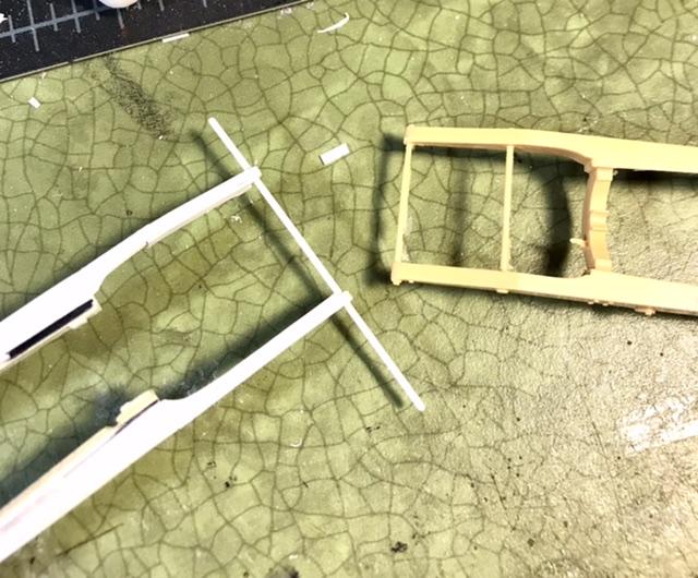

So the first thing you’re wondering is the difference between a 25th scale Indy car and a 24th sc Indy car.  The answer in this photo - the cream colored casting is the Miller 91 chassis casting in 25th sc by Etzel …. The longer chassis  next to it is my 24th sc Miller 122 chassis - this is the master part with engine castings ….  To be explained shortly ..
Did I mention that this has been a "long term" project ??

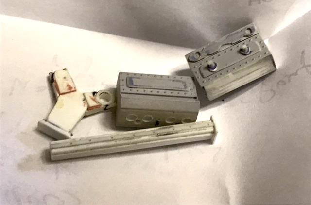

of some of the master parts with tabs added for casting - this is where Harold Bradford enters the story …

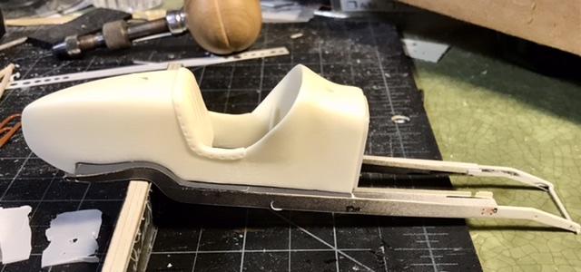

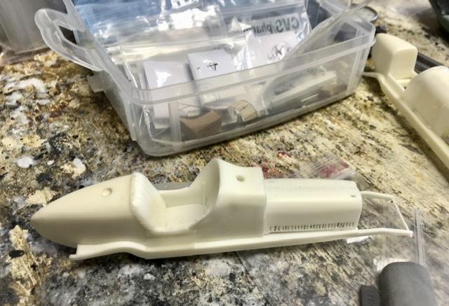

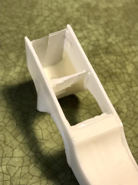

So the parts were finished some years ago - and then given to Harold Bradford - “Brad” - to cast - when I learned that The Revs Museum had a “sister” 122 - the 1924 “Boyle Special” - well of course I couldn’t make just one ….  Brad immediately set about casting the parts - just kidding- he actually stays pretty busy filling orders for stuff he has sold for years - so the parts sort of languished in his basement until I showed up  again and convinced him to let me cast the body - the pix aren’t so good but the casting turned out well - and Brad agreed to dive in and cast the rest …
Gracias

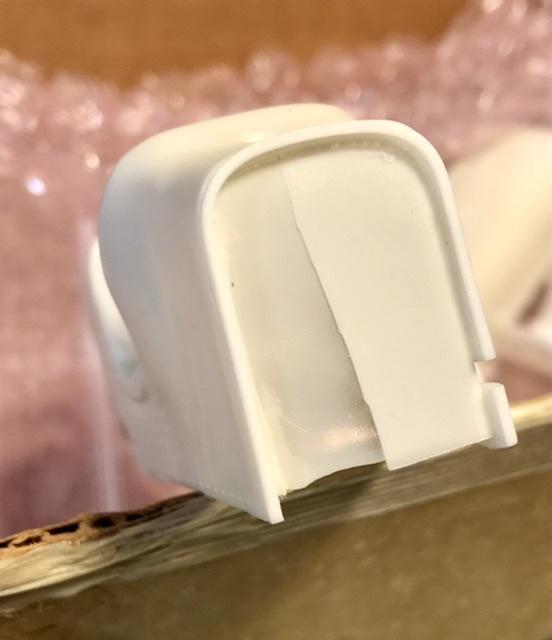

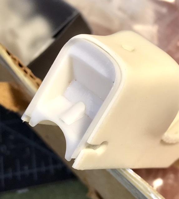

the body casting has some thin film to remove in some openings  -  the film is from thin plastic  -  this helps the caster get a clean casting and allows the mold to be opened without tearing the rubber…

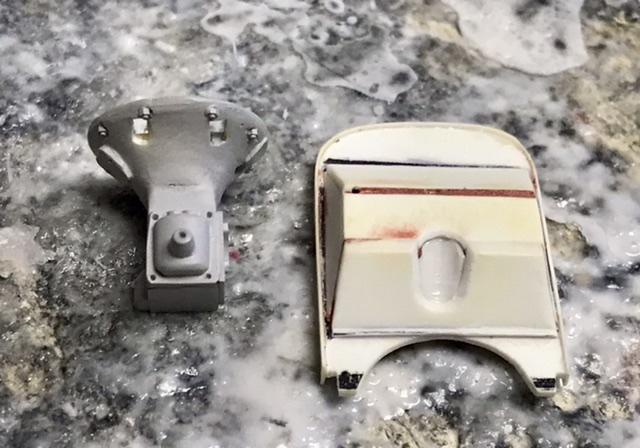

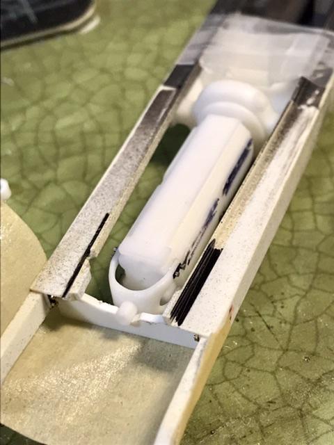

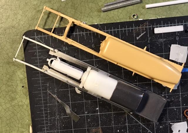

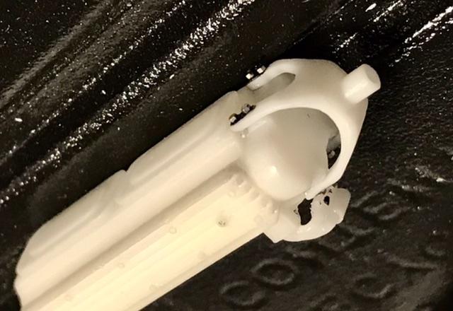

The engine bulkhead was a complex part to make.  The shape is dictated by the shape of the supercharger, which was attached to the back of the cylinder head …

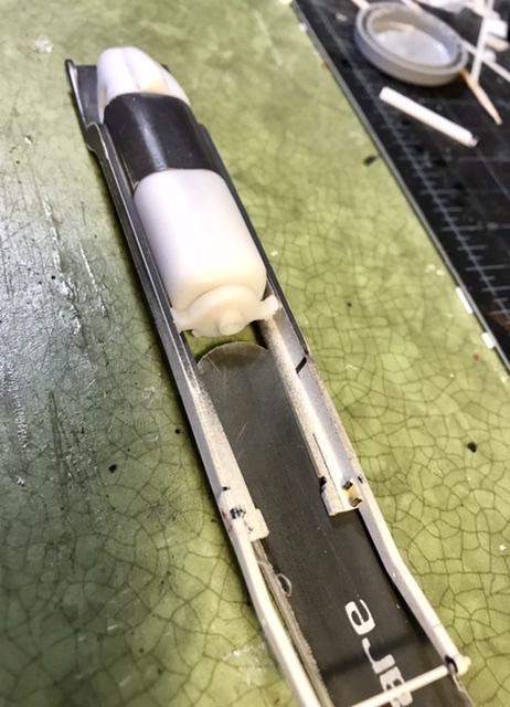

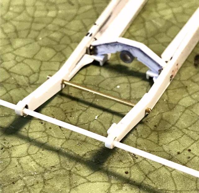

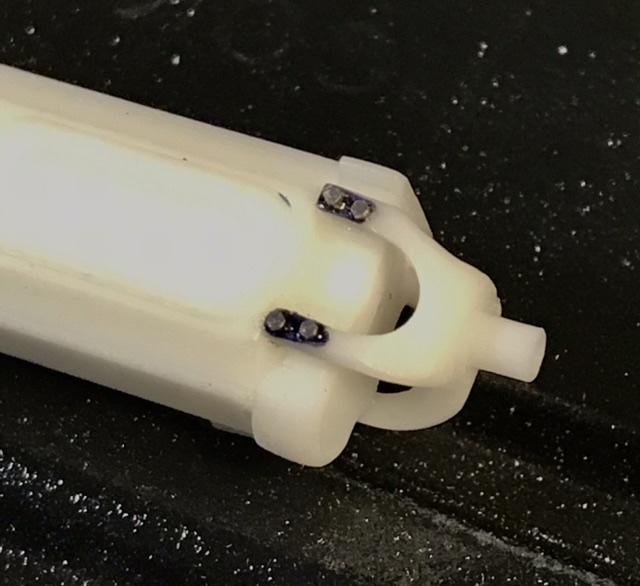

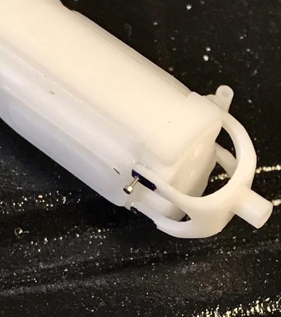

The front engine mount is a cradle that was used for the next 40 years by Miller and then by Fred Offenhauser  -  I’m attaching it with some bolts  which is spec - and will be secure … the Miller race cars site has a wealth of photos  - found one of the crank case cover - showing the fins and bolt pattern …

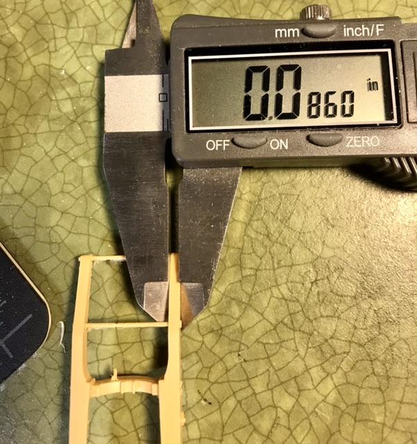

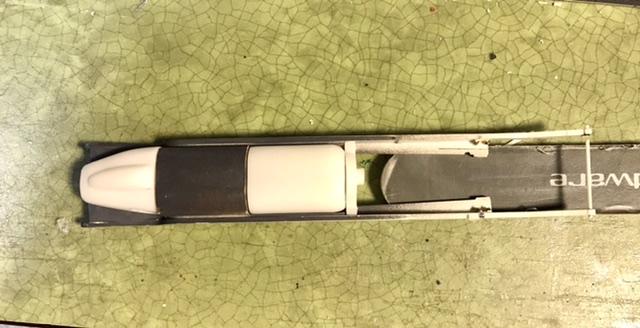

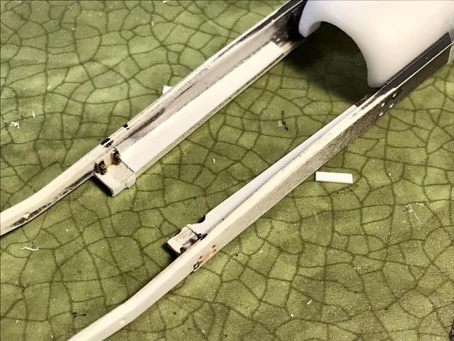

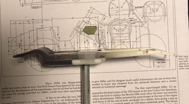

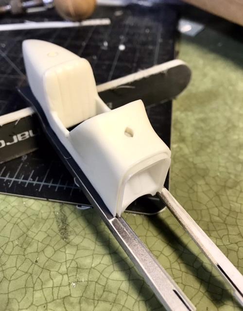

compares the Etzel 25th scale Miller 91 chassis casting to my 24th 122 chassis master  -  the main difference is the chassis length - the difference in width is minimal …

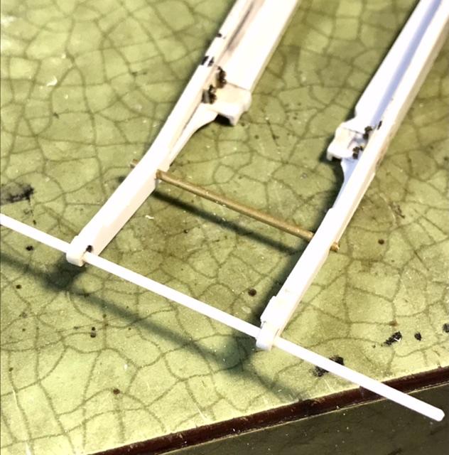

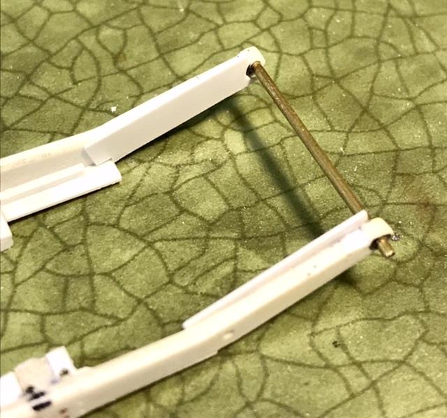

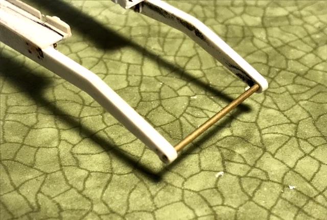

The forward section of the chassis is exposed and I’ve got to add some parts to correct scale width and for strength - I think the chassis longerons (think that’s they’re called) are a bit too wide on the Etzel chassis - but mine are too narrow …

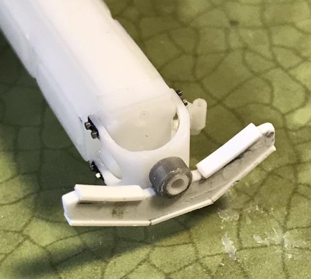

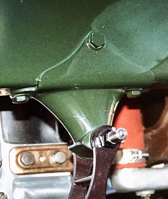

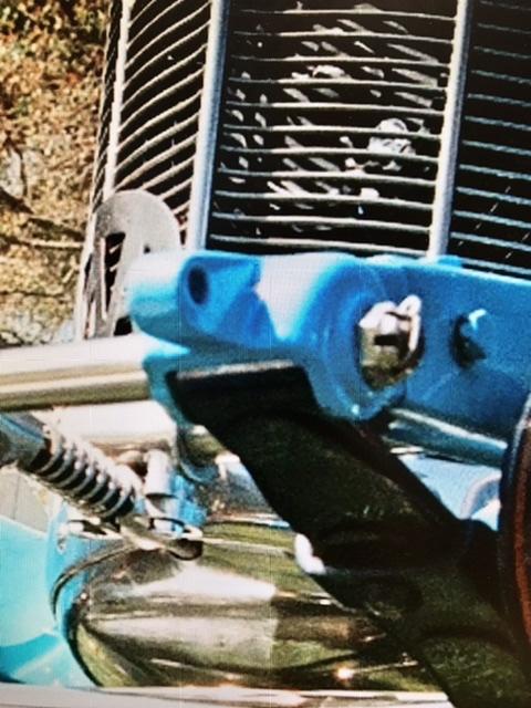

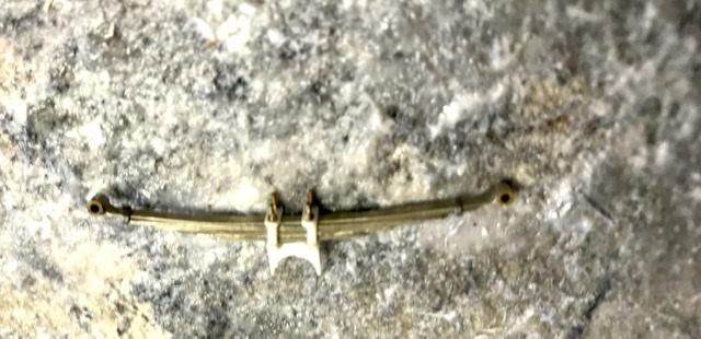

Over the years I’ve photographed a number of 91s and 122s. The first shot shows how the front of the shock attaches to the frame - the second photo shows the shock mount that holds the trailing end of the front leaf spring …. Going here next
