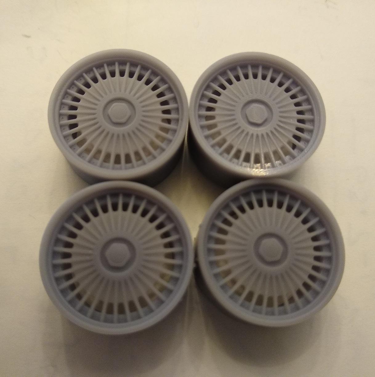

MeatMan Posted February 20, 2024 Posted February 20, 2024 For those of you printing wheels; How do you print them, flat or tilted vertical? I print mine tilted vertical and they tend not to be round and I need to print a set. Thanks.
stitchdup Posted February 20, 2024 Posted February 20, 2024 9 minutes ago, MeatMan said: Les Les, do you slice your files directly to the usb, or do you save them on your computer and then copy them? I usually save mine to the computer and then copy them in case the usb fails but also I notice it takes a lot less activity on the usb to copy than to slice it to the usb. Maybe nothing, but also may be worth trying if you're not. I've been slicing them straight from lychee to the stick. I'll try it your way and see if the sticks last any longer 1
stitchdup Posted February 20, 2024 Posted February 20, 2024 8 minutes ago, MeatMan said: For those of you printing wheels; How do you print them, flat or tilted vertical? I print mine tilted vertical and they tend not to be round and I need to print a set. Thanks. I find it depends on the wheels. for wire wheels and bbs style rims i find they print better flat and theres way less chance of the spokes breaking when you remove them. when wheels with spokes are at any angle the supports tend to be on the spokes but when they are flat it seems to ignnore them. Most other styles i have upright but angled back between 30 and 45 degrees. if the wheels are fairly thick walled they go nearer 30 but the thinner the wall the more angle i put on them but never over 45. Having said that i printed out a few of the slowlysmodels bomb wheel sets which are thick walled but i printed them flat and everyone of them turned out great. blackbox wheels i print at 45 every time with decent success. 1
MeatMan Posted February 20, 2024 Posted February 20, 2024 38 minutes ago, stitchdup said: I find it depends on the wheels. for wire wheels and bbs style rims i find they print better flat and theres way less chance of the spokes breaking when you remove them. when wheels with spokes are at any angle the supports tend to be on the spokes but when they are flat it seems to ignnore them. Most other styles i have upright but angled back between 30 and 45 degrees. if the wheels are fairly thick walled they go nearer 30 but the thinner the wall the more angle i put on them but never over 45. Having said that i printed out a few of the slowlysmodels bomb wheel sets which are thick walled but i printed them flat and everyone of them turned out great. blackbox wheels i print at 45 every time with decent success. Thanks Les.
Mattilacken Posted February 20, 2024 Posted February 20, 2024 4 hours ago, MeatMan said: For those of you printing wheels; How do you print them, flat or tilted vertical? I print mine tilted vertical and they tend not to be round and I need to print a set. Thanks. I say as Les, but most i have printed have been working great with around 30-40 deg. I tend to have no issues as long as the bottom edge is propper supported and if the spokes are thin i only support them close to the center. as well as the pin is supported, so far all but the first sets have been almost perfect. An other question, large flat parts, how do you support them so they dont warp?
Michael jones Posted February 21, 2024 Posted February 21, 2024 14 hours ago, MeatMan said: For those of you printing wheels; How do you print them, flat or tilted vertical? I print mine tilted vertical and they tend not to be round and I need to print a set. Thanks. I print "regular" spoked wheels flat to the build plate on supports. That has worked great so far. I'm sure they can be printed at any angle with the correct amount of supports regardless but would take longer. For wire wheels like the Maserati birdcage wire wheels, I printed them vertical, 90 degrees to the build plate on supports. This is to stop the "wires" buckling during the print which did happen when I tried to print them flat. I learned from some other peoples experience on facebook. I'm still new to the 3d printing game, but these ways have worked well for me. Mike 1

iamsuperdan Posted February 22, 2024 Author Posted February 22, 2024 On 2/20/2024 at 9:37 AM, MeatMan said: For those of you printing wheels; How do you print them, flat or tilted vertical? I print mine tilted vertical and they tend not to be round and I need to print a set. Thanks. Personally, I tilt the wheels at 22 degrees. I just find it works great, with practically no layer lines. Flat or 45 degrees, I get visibly layer lines. For tires, I just print them flat, and have never seen any issues. 1

MeatMan Posted February 24, 2024 Posted February 24, 2024 On 2/20/2024 at 12:00 PM, stitchdup said: I find it depends on the wheels. for wire wheels and bbs style rims i find they print better flat and theres way less chance of the spokes breaking when you remove them. when wheels with spokes are at any angle the supports tend to be on the spokes but when they are flat it seems to ignnore them. Most other styles i have upright but angled back between 30 and 45 degrees. if the wheels are fairly thick walled they go nearer 30 but the thinner the wall the more angle i put on them but never over 45. Having said that i printed out a few of the slowlysmodels bomb wheel sets which are thick walled but i printed them flat and everyone of them turned out great. blackbox wheels i print at 45 every time with decent success. On 2/20/2024 at 4:24 PM, Mattilacken said: I say as Les, but most i have printed have been working great with around 30-40 deg. I tend to have no issues as long as the bottom edge is propper supported and if the spokes are thin i only support them close to the center. as well as the pin is supported, so far all but the first sets have been almost perfect. An other question, large flat parts, how do you support them so they dont warp? On 2/21/2024 at 2:17 AM, Michael jones said: I print "regular" spoked wheels flat to the build plate on supports. That has worked great so far. I'm sure they can be printed at any angle with the correct amount of supports regardless but would take longer. For wire wheels like the Maserati birdcage wire wheels, I printed them vertical, 90 degrees to the build plate on supports. This is to stop the "wires" buckling during the print which did happen when I tried to print them flat. I learned from some other peoples experience on facebook. I'm still new to the 3d printing game, but these ways have worked well for me. Mike On 2/22/2024 at 10:16 AM, iamsuperdan said: Personally, I tilt the wheels at 22 degrees. I just find it works great, with practically no layer lines. Flat or 45 degrees, I get visibly layer lines. For tires, I just print them flat, and have never seen any issues. Thanks for the input guys. I decided to print a set in both tilted 30 degrees, and flat. I spent a bit more time on the supports on the tilted version and they came out almost perfectly round. The flat ones came out good as well as I made sure the supports avoided the spokes. If you'll note on the pic, the top set was printed flat and you can clearly see the layer lines in the light reflected off the one on the right. I looked closely at the tilted ones and there were now visible layer lines, at least visible with these old eyes and zoom phone camera. Now I can get back to mocking up my Fairlane for the Cannonball Run! 2

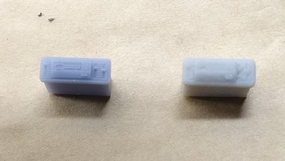

MeatMan Posted February 24, 2024 Posted February 24, 2024 (edited) So I upgraded to a new printer, as my old Anycubic Photon Zero was not getting it done. I bought the Elegoo Mars 9K, and I'm quite impressed with the results. It took a while to get it dialed in, and I had to switch resins but the results are worth it. Its called an entry level printer but I feel its entry "priced" but not beginner friendly because it doesn't print straight out of the box like my Zero did. In the pics below, the lighter color prints are with my Photon using Anycubic model gray resin. The darker prints are the Mars prints using Elegoo standard gray V2 resin. The lines are crisper, and the finish is much smoother. This will mean less sanding, and loss of further detail. I recommend it to anyone looking for a printer with a smaller print area, which is great for me since I don't do bodies, and most chassis come in sections. The last two pics show a bed I designed for my 53 F100 with wider fenders and its about the max you can get on the bed, though you can go taller, as I printed this with the tail up. Edited February 24, 2024 by MeatMan 9K instead of 12K printer 3

Mattilacken Posted February 26, 2024 Posted February 26, 2024 On 2/24/2024 at 4:57 PM, MeatMan said: Nice to see your new printer working good! The right one look over exposed to me. you could try do reduce the light on time and use the same resin as you have in the new one and your result with the old one will probobly improve.

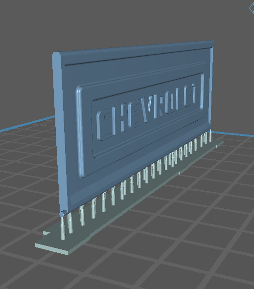

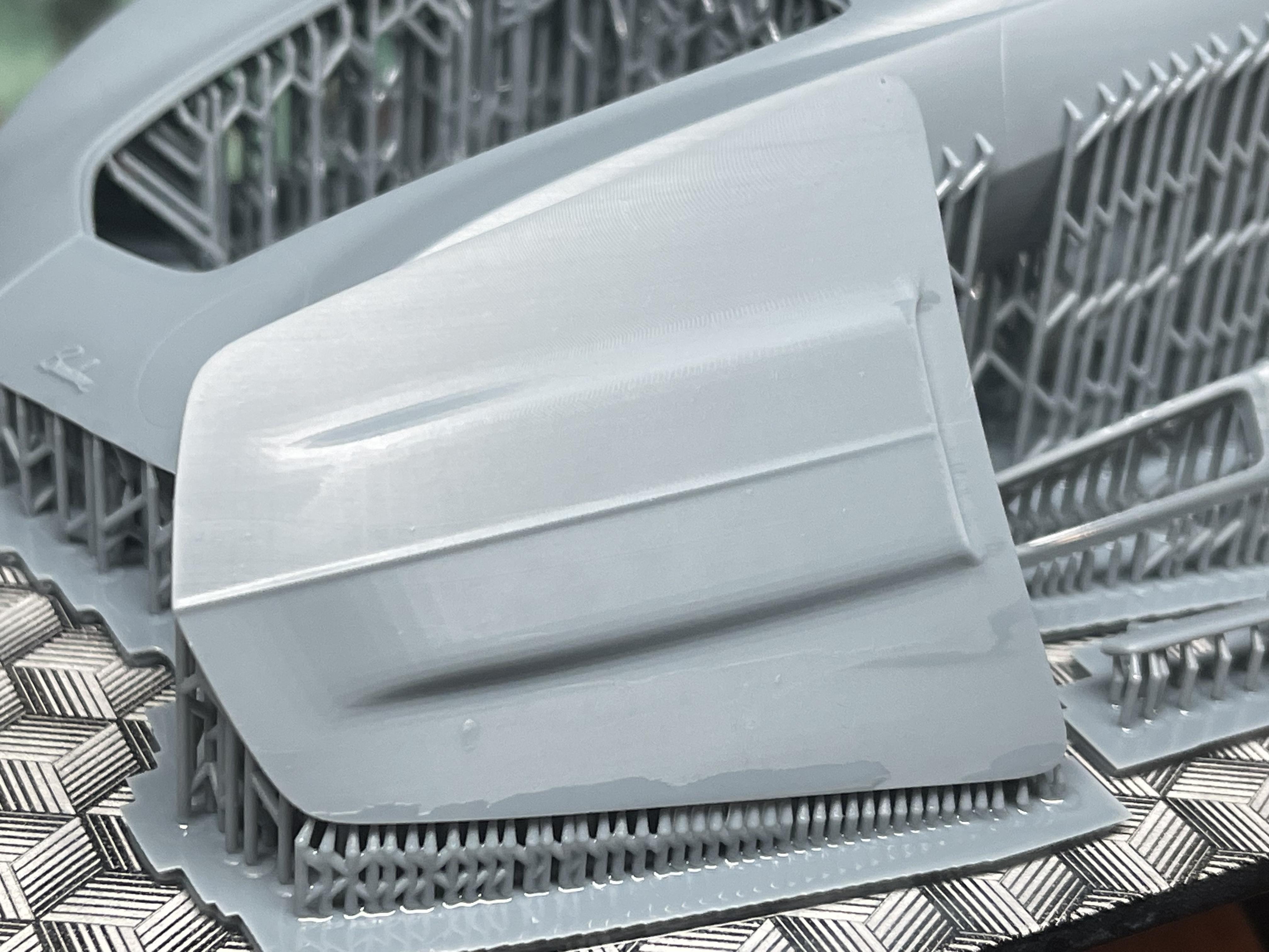

Mattilacken Posted February 26, 2024 Posted February 26, 2024 An other question, large flat parts like a panel or hood, how do you support them so they dont warp when beeing cured?
stitchdup Posted February 26, 2024 Posted February 26, 2024 2 hours ago, Mattilacken said: An other question, large flat parts like a panel or hood, how do you support them so they dont warp when beeing cured? i have them tilted back on th rear edge of the hood. I also add a couple milimetres to the back edge so if the edge doesn't turn out right i can file it back to where it need to be. I also leave it on the supports until after curing but i do this with most large thin items. a panel i would have supported upright. I tend to do my supports so they dont land on areas with trim or detail and with the front facing of the print items mostly clear of supports
Mattilacken Posted February 26, 2024 Posted February 26, 2024 3 hours ago, stitchdup said: i have them tilted back on th rear edge of the hood. I also add a couple milimetres to the back edge so if the edge doesn't turn out right i can file it back to where it need to be. I also leave it on the supports until after curing but i do this with most large thin items. a panel i would have supported upright. I tend to do my supports so they dont land on areas with trim or detail and with the front facing of the print items mostly clear of supports Okay I tried this but it got a bit bent middle came in to the upper supports. Is this what you would do?:
MeatMan Posted February 26, 2024 Posted February 26, 2024 9 hours ago, Mattilacken said: An other question, large flat parts like a panel or hood, how do you support them so they dont warp when beeing cured? Good question! I can't recall any success with large unattached panels like that.
stitchdup Posted February 26, 2024 Posted February 26, 2024 5 hours ago, Mattilacken said: Okay I tried this but it got a bit bent middle came in to the upper supports. Is this what you would do?: i use a lot more supports than that. usually light or medium supports with it layed back more. the back surface i would have at least 4 rows of support and posssibly more. imagine its a piece of that paper with squares on it. i would have it at 7 or 8 mm and everywhere a line crosses would be a support
