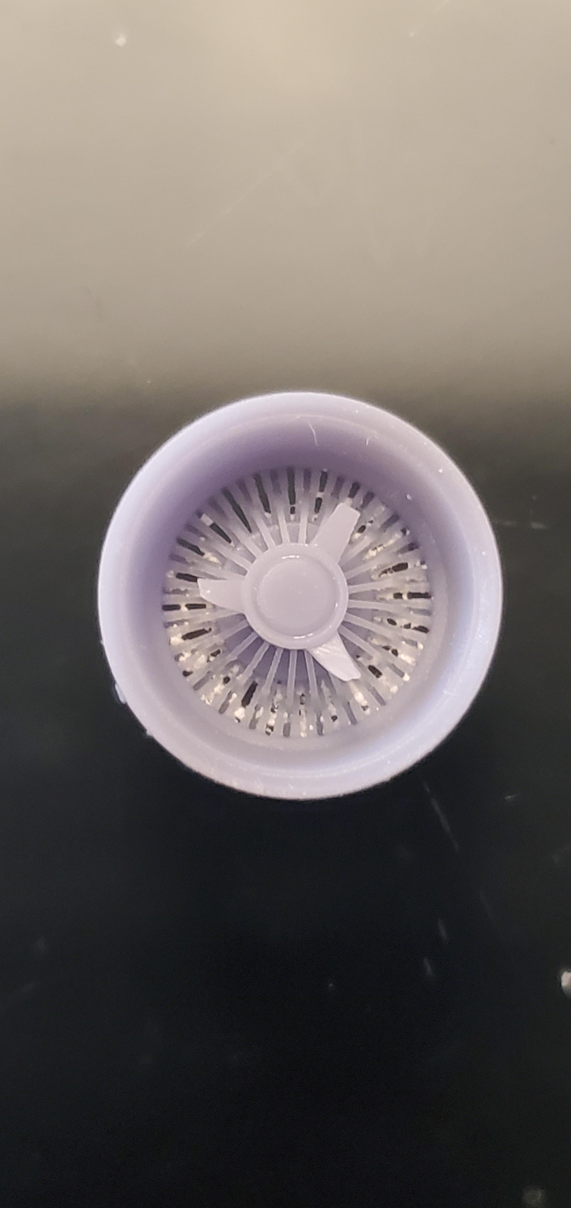

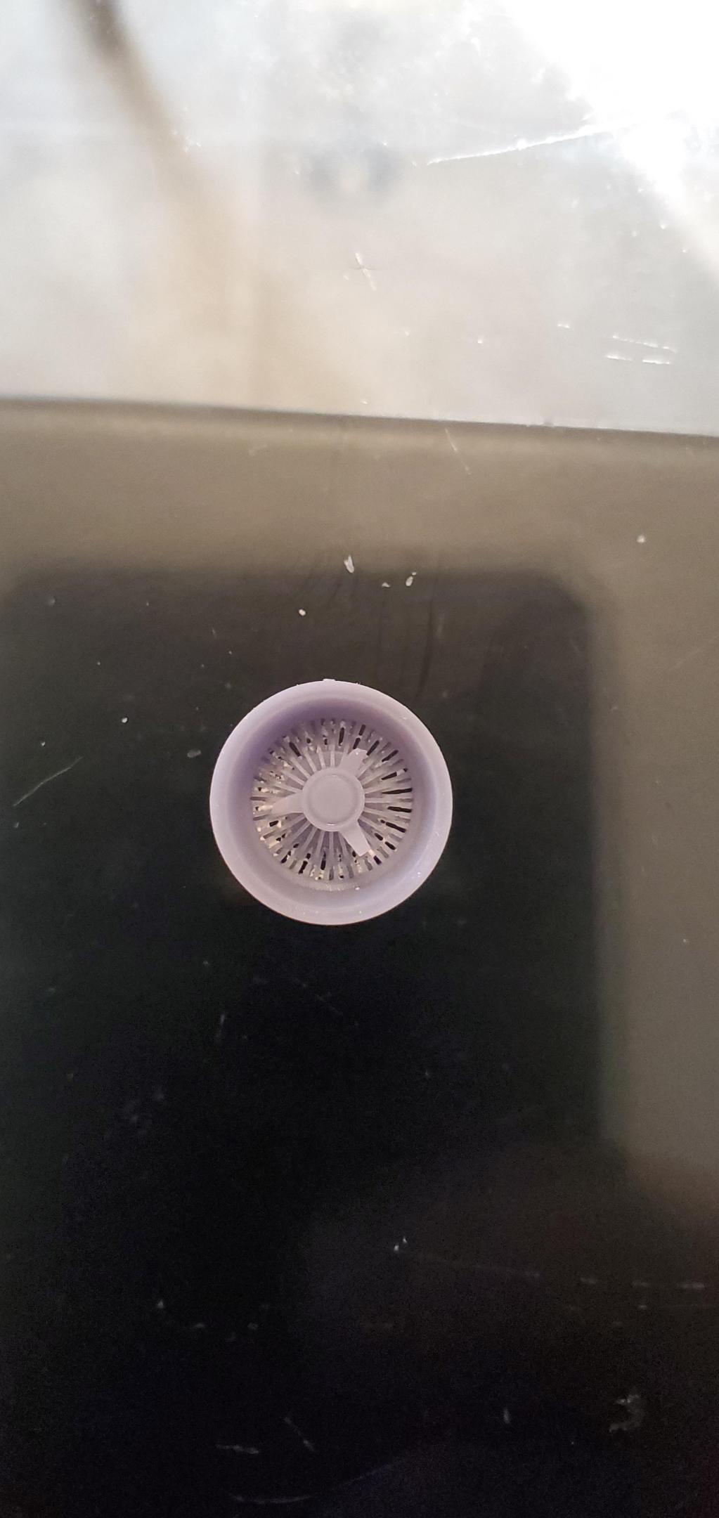

  On 9/17/2022 at 1:27 PM, Timonator said:
What can I  try to clean these up a bit ?
Expand

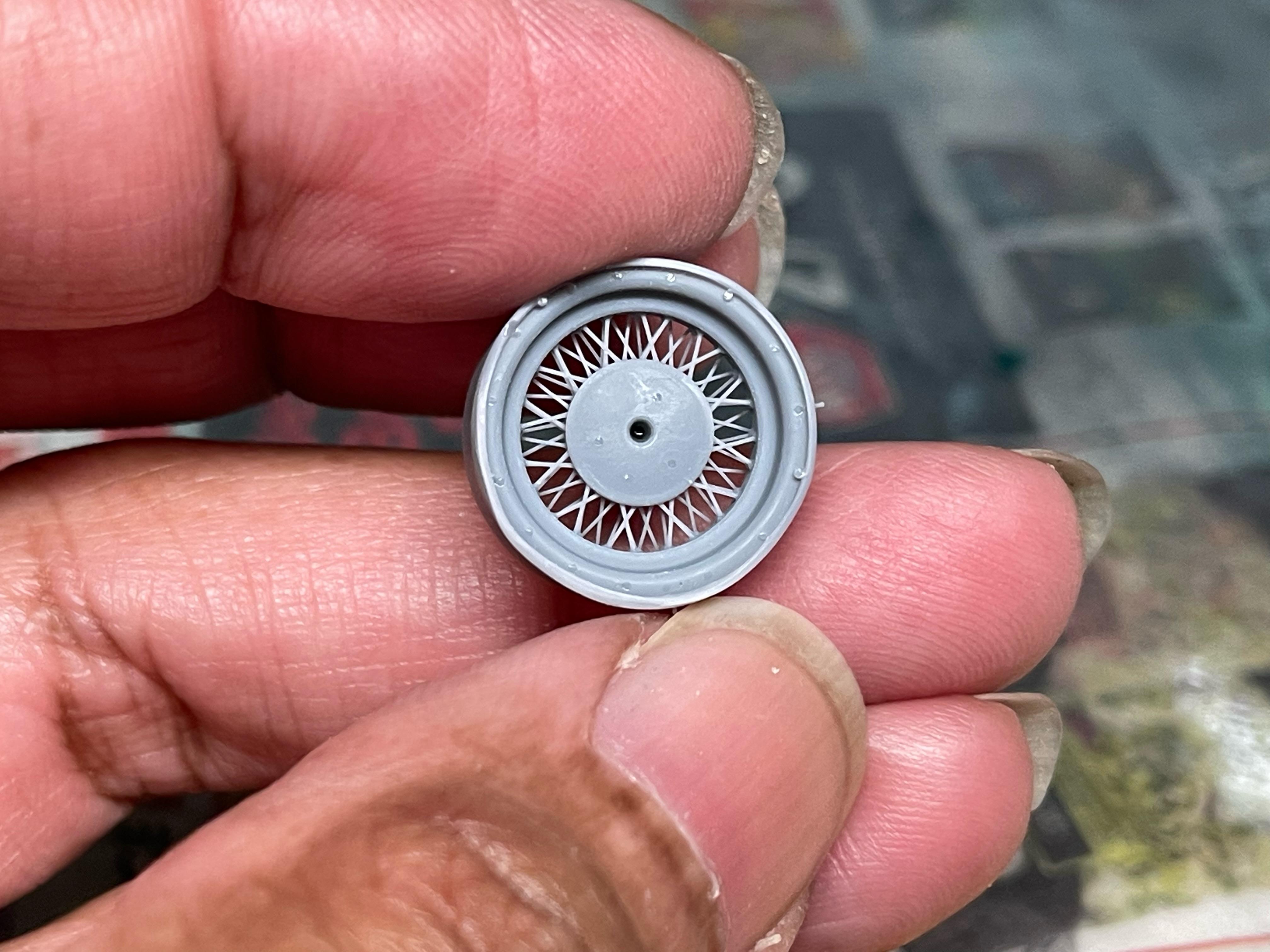

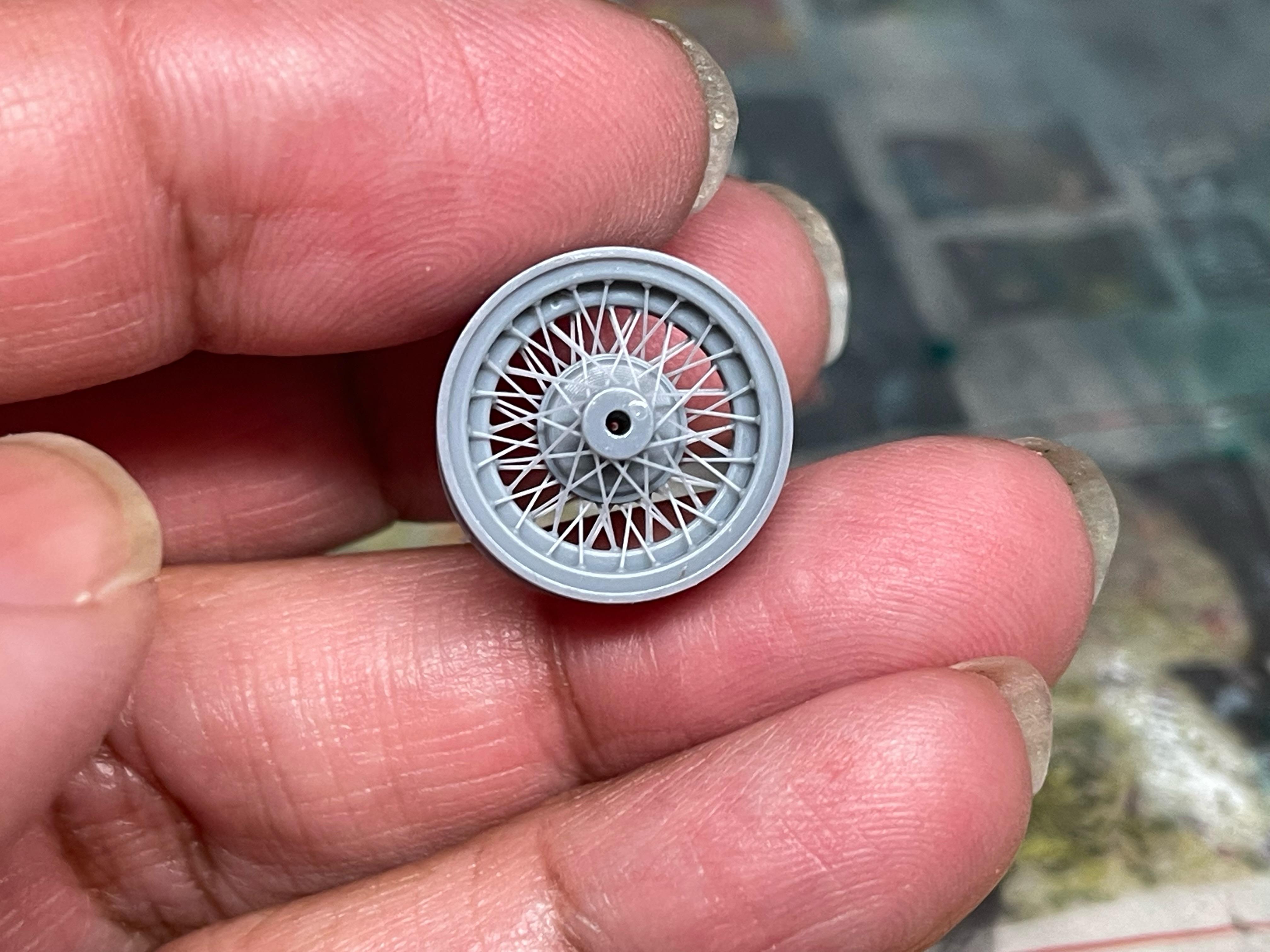

YIKES! Did you buy those or did they cure that way?? I just printed up these wheels recently and I had nothing like that occur. Those look like Shapeways wheels..........I'd try soaking them in 91% IPA to see if that helps.
image1.thumb.jpeg.b3742f606b7fc01e4661064a4c0f292e.jpegimage0.thumb.jpeg.5f915a7d4e826b8a4c77bce317027b6c.jpeg
