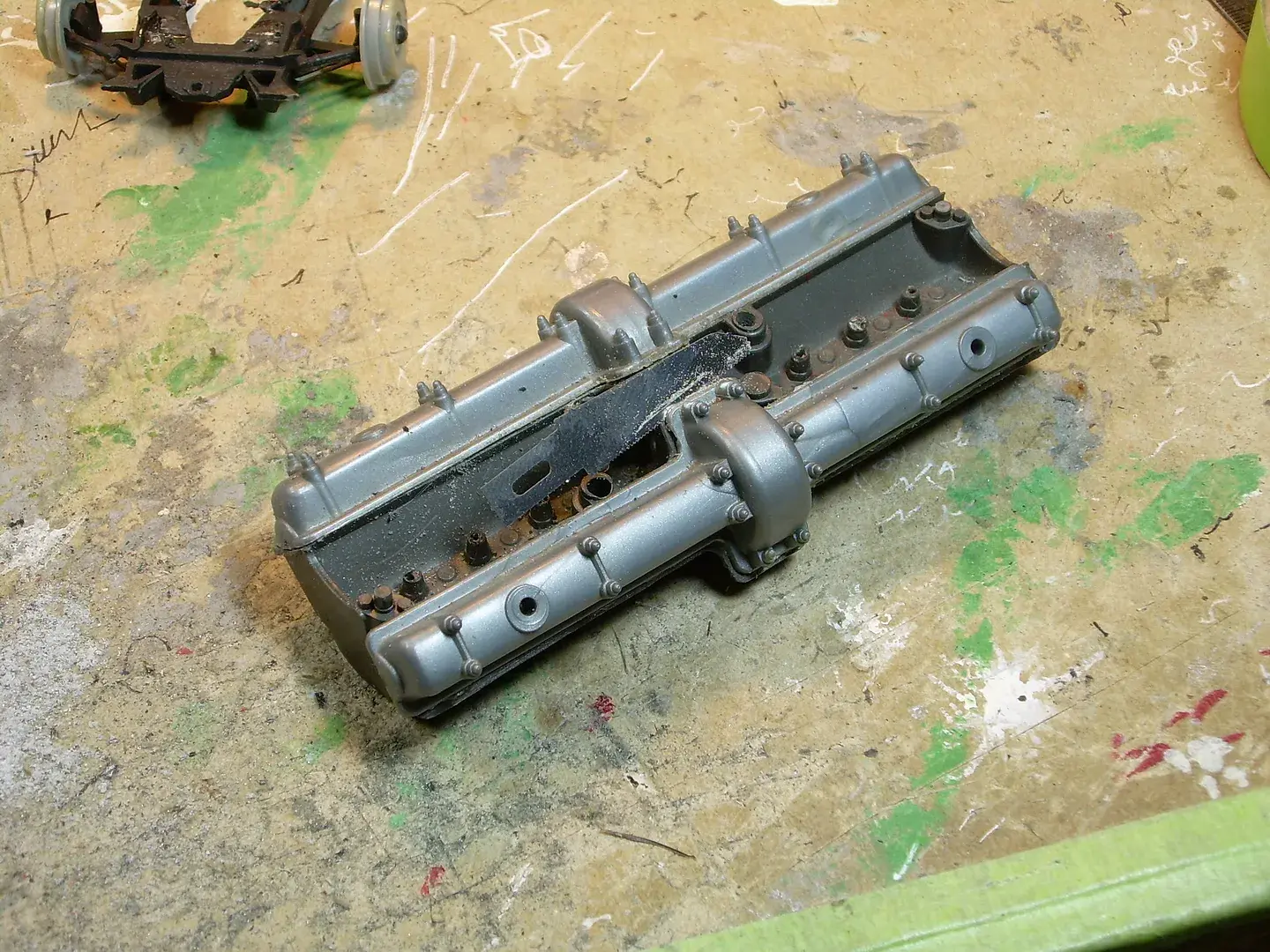

Photo below illustrates using an X-Acto chisel tip blade as a wedge to gently force a seam to split.

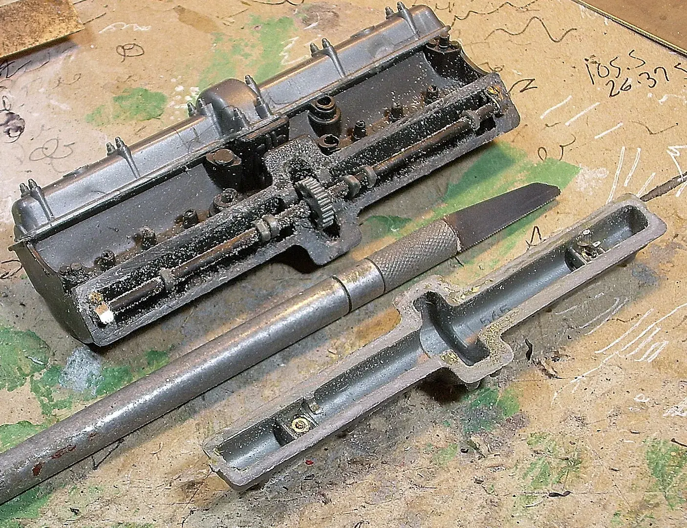

Next photos illustrate a photoetched saw blade used to separate a heavily glooed seam.

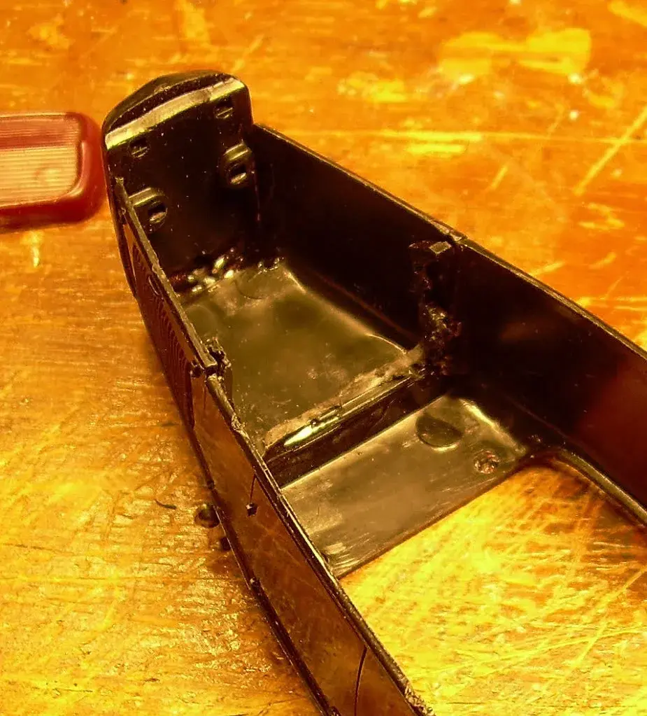

Last shots show a Dremel being used to grind out heavy gloo between two parts.
DSCN0970.JPG.5fb743b895f6d8342c75e6ce9139809f.JPGxt photos illustrate a photoetched saw blade used to separate a heavily glooed seam.
DSCN0255_zpszj08pmsl.webp.cdd92765f4a90c6e24896909a85c537c.webpDSCN0814_zpsxmrndpi1.webp.56306f3289a77780a5496de89fefe93b.webp
DSCN1100.webp.1a04beec3fd5c54774fc8e9321406a37.webpDSCN1102.webp.216d3b960827425ae081223248714571.webp

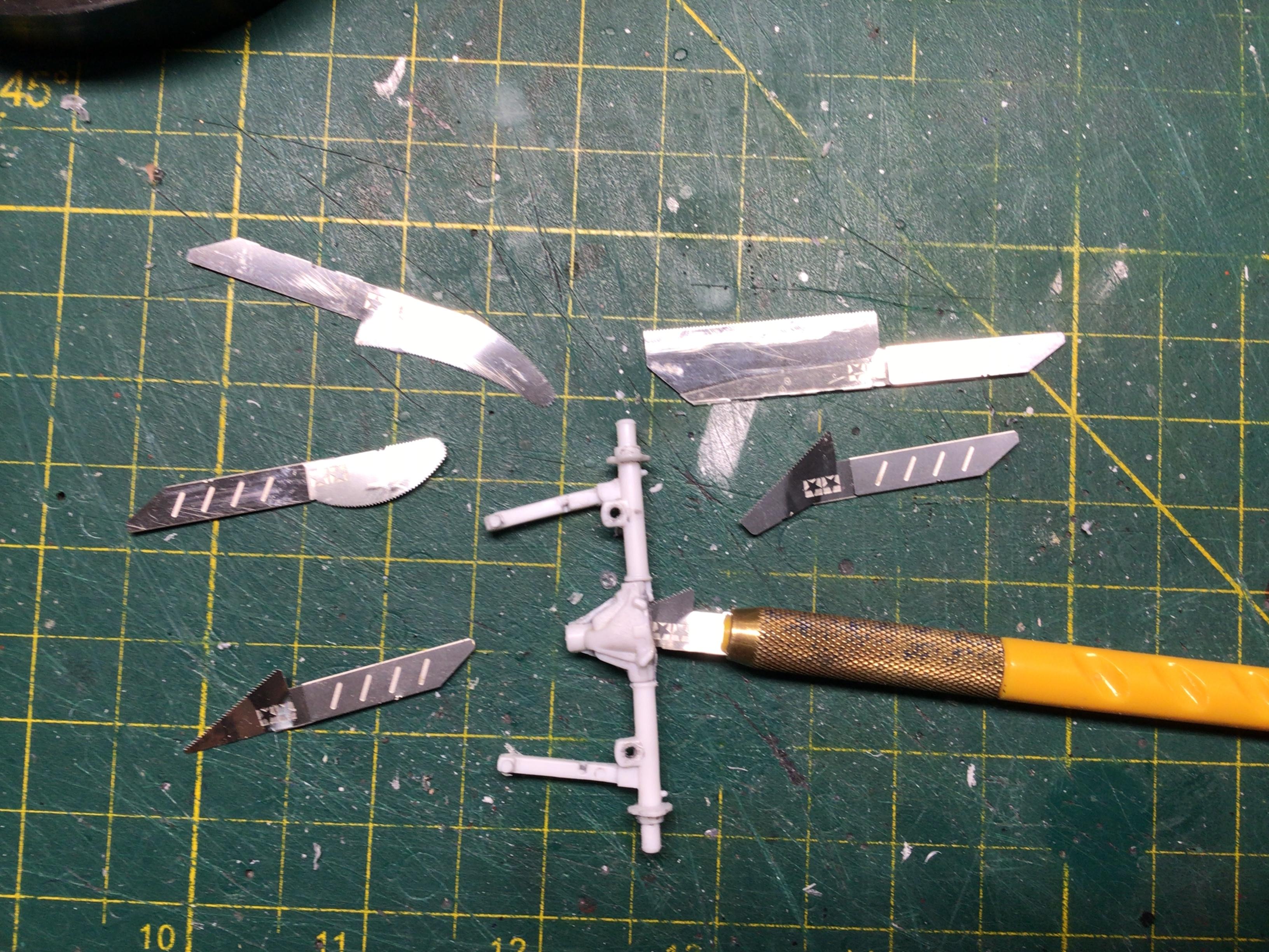

Photo etch saws are great tools. They can get into places that other saws can’t. And they can make an extremely thin cut so there is no substantial material loss. This diff was glued together crooked and would not be pried apart without breaking.
