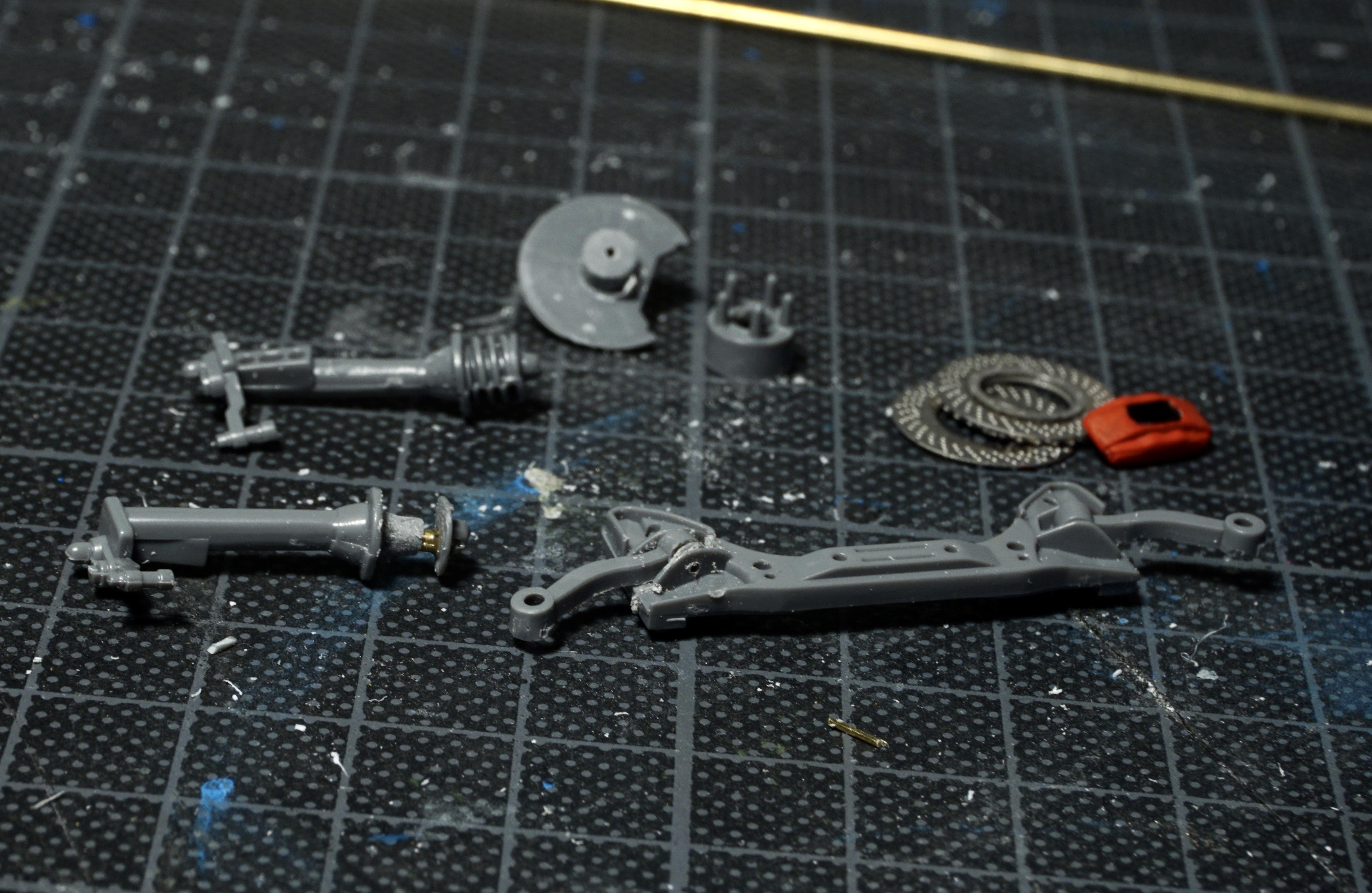

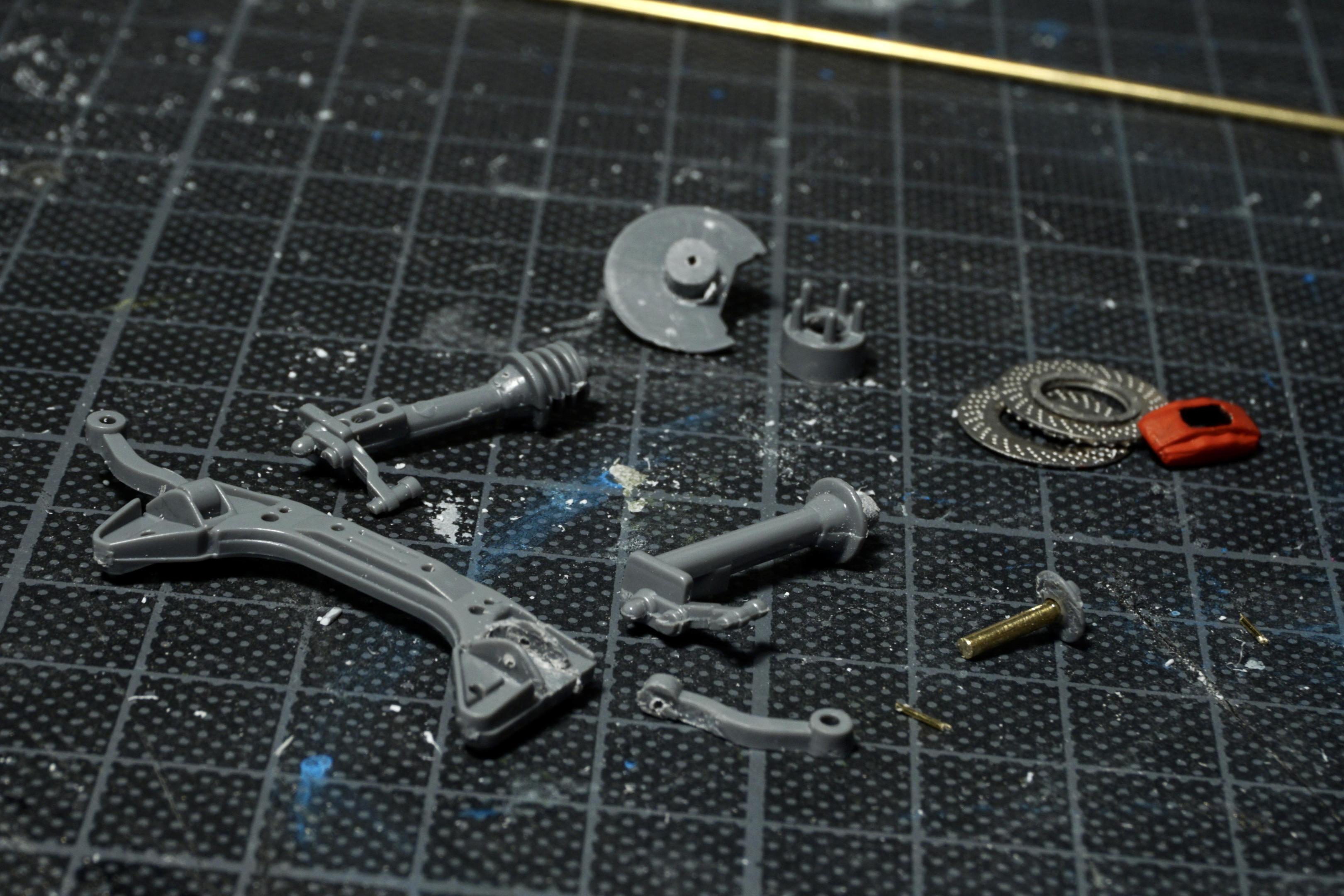

Ops I did it again.. maid it harder for my self.. the wheel and disc setup will be so nice. So I would like to be able to “lift” it in one corner to remove the wheel and display the disc and hub and such. So I exploded one side..
Very nice work so far. I love the sleeved wheels. I like the idea of displaying with one wheel off There’s  so much lovely detail in that suspension.
I have a few of these 6-Series Fujimi kits waiting to be built, plus one on the shelf that I built as a kid. I’ve got to say, Fujimi made an AMAZING kit here.
looking forward to seeing more progress on this one.

Thanks allot! Yea there for sure is! While I was driving to my cabin the other day I also thought about making the rear suspension functional so when at display one wheel will be extended in back.. also thinking about making wheel nuts out of bras.. feels like it’s snowballing right now!
I will keep an eye out for your future build!
On 4/14/2022 at 7:24 AM, Reuhkapelti2 said:
Oh man, you Anton surely don't cross the fence where it sits the lowest. The suspension in this kit really is great and it deserves to be seen.
haha! I could not agree more! So let’s make it a step better and display it!

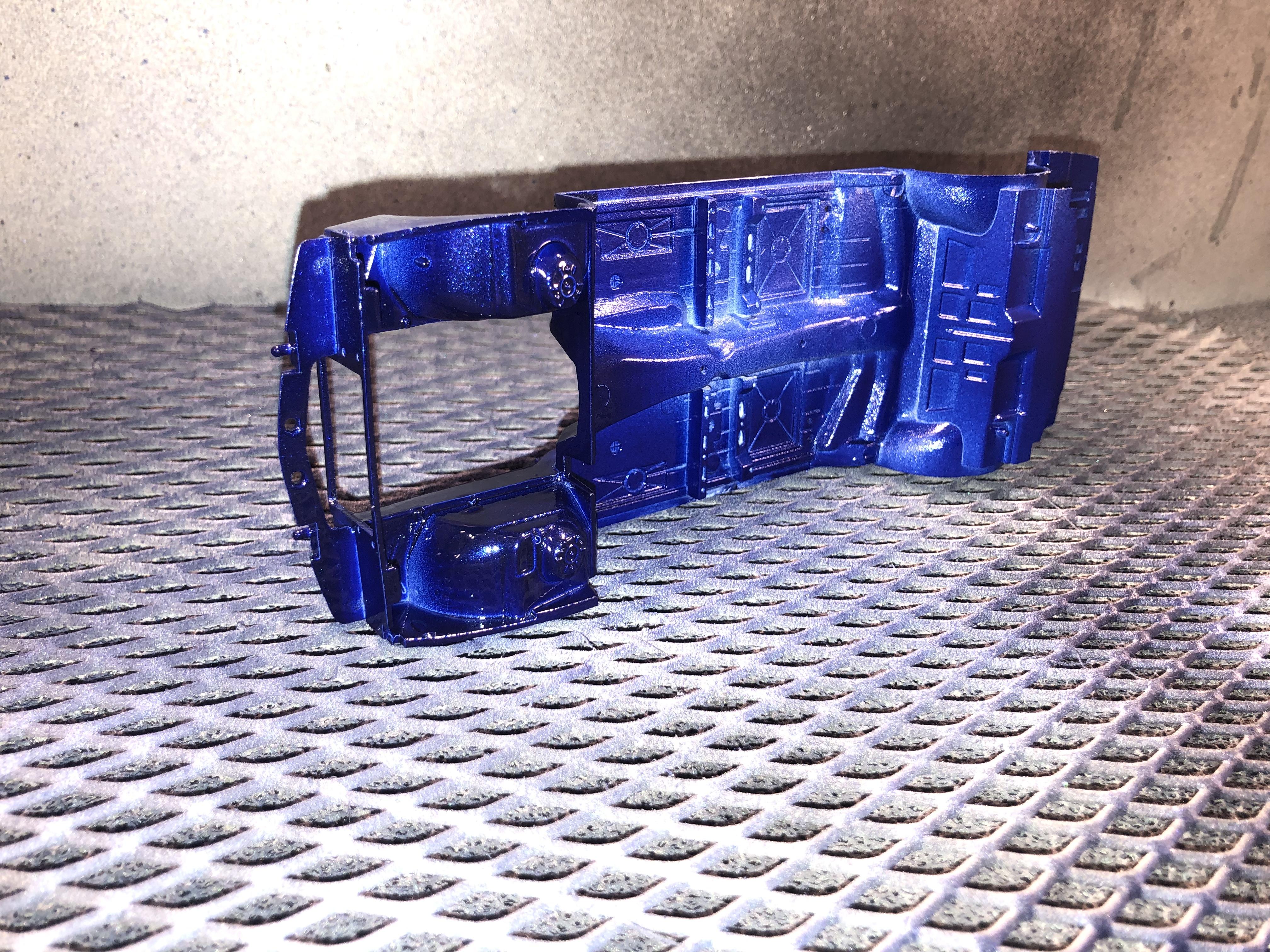

That's a really nice blue, Anton!
Are the braces on the floor separate pieces? That's crazy! I can't wait to get mine started..........
Thanks! Yes they are! As well as the firewall to the trunk! ?

thanks! The hade part is to get a good spring rate so it will compress easily but be just enough to push it outward when decompressed! I have made so it should be fully compressed when the car is on wheels. Thanks I will keep at it!

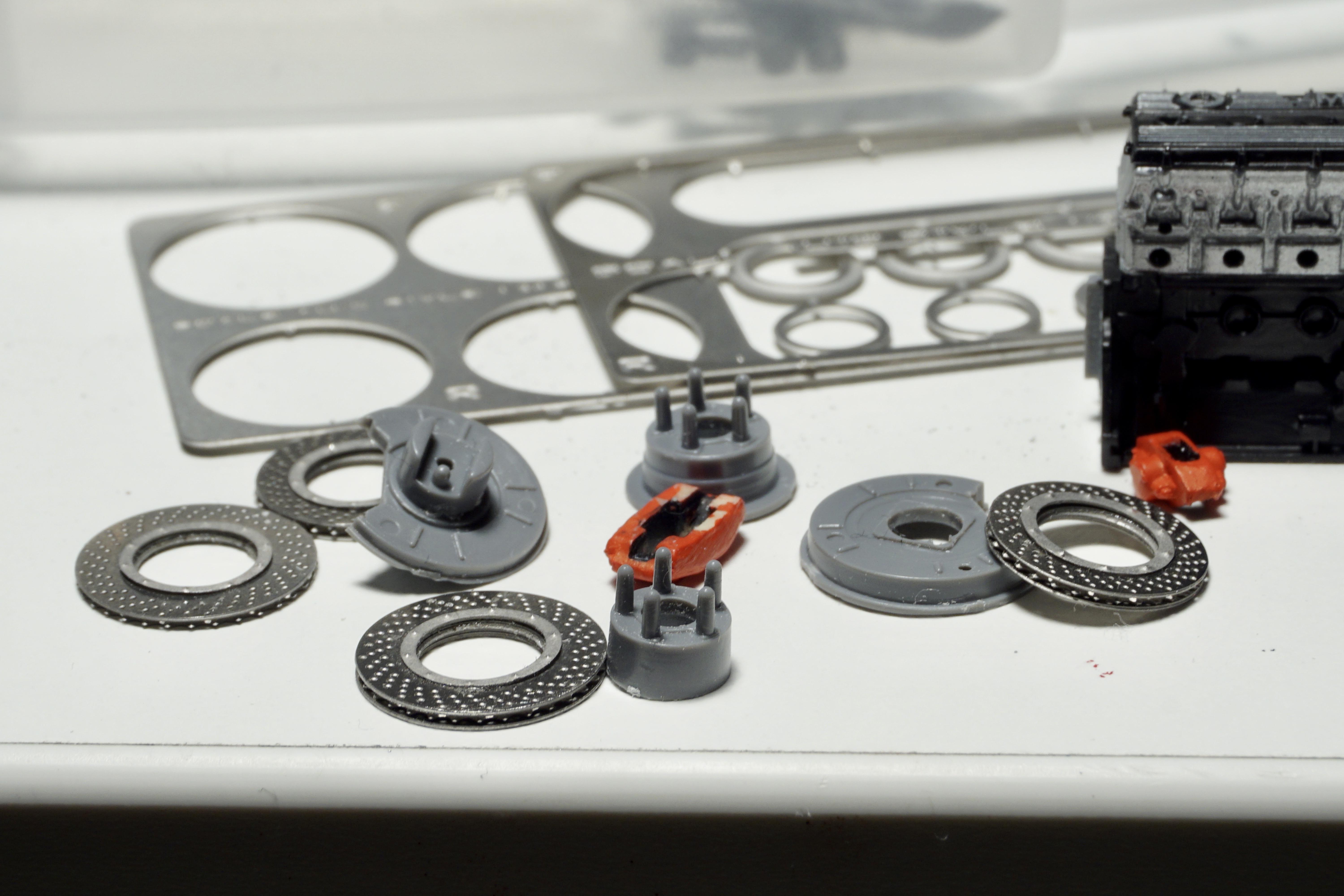

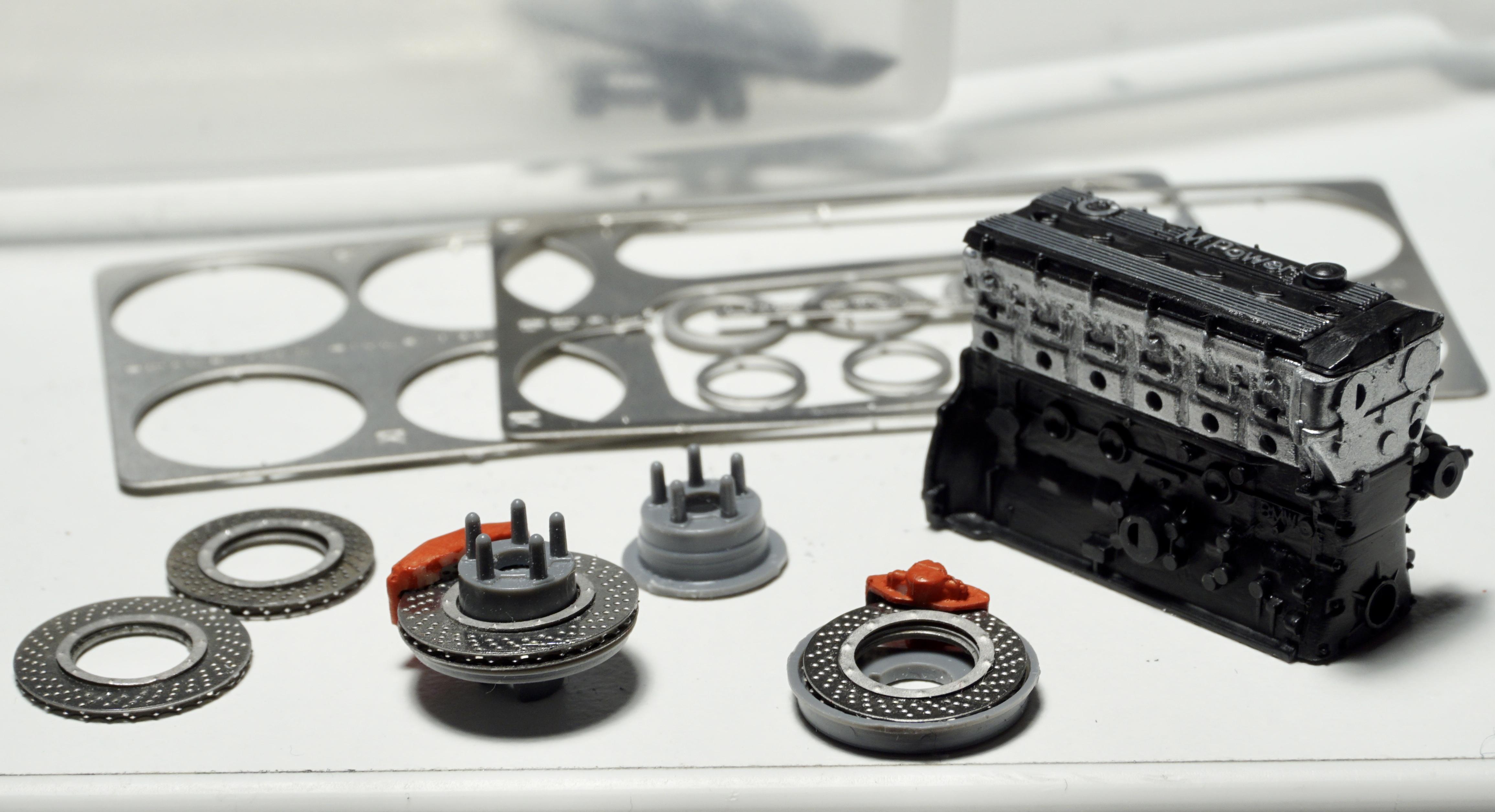

Micro steps, I have glued the Scale Auto Style 1/24 PE brake discs that I have had in my stash since 2006. They must have been made for this kit both the front and rear discs are perfect in size to this kit, except for the inner diameter on the rear hub so they will need to be turned a millimeter.
I Also tried to get the text to look good on the valve cover, but I do not have BMF so I tried Molotov and then paint over it and use AB thinner to remove the black again.

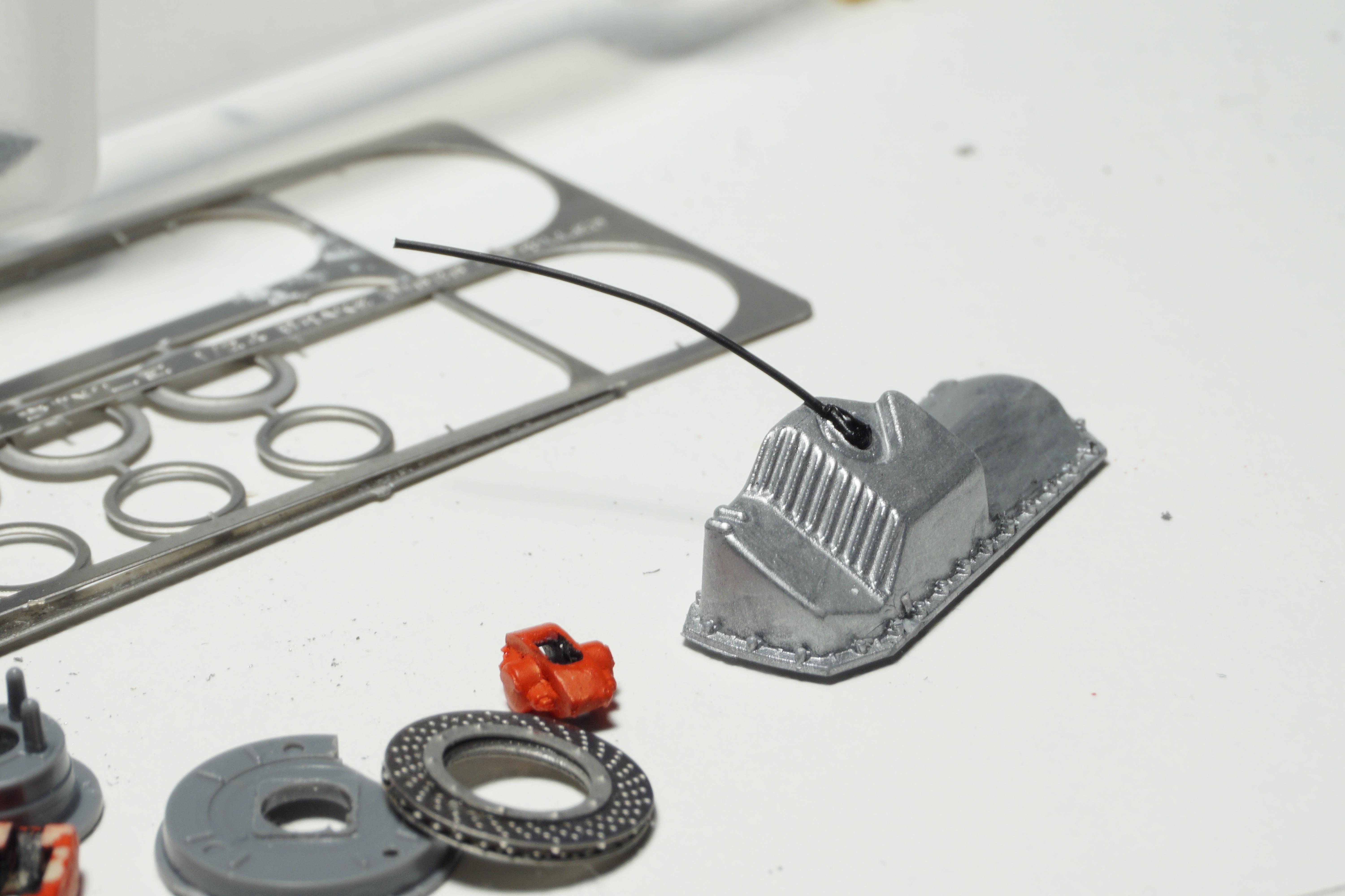

I could not resist to put a cable to the oil sensor.

Nice work on those valve covers. Please can you tell me what type of black paint you used to paint over the Molotov? When wiping it away, did it dull the chrome at all?
