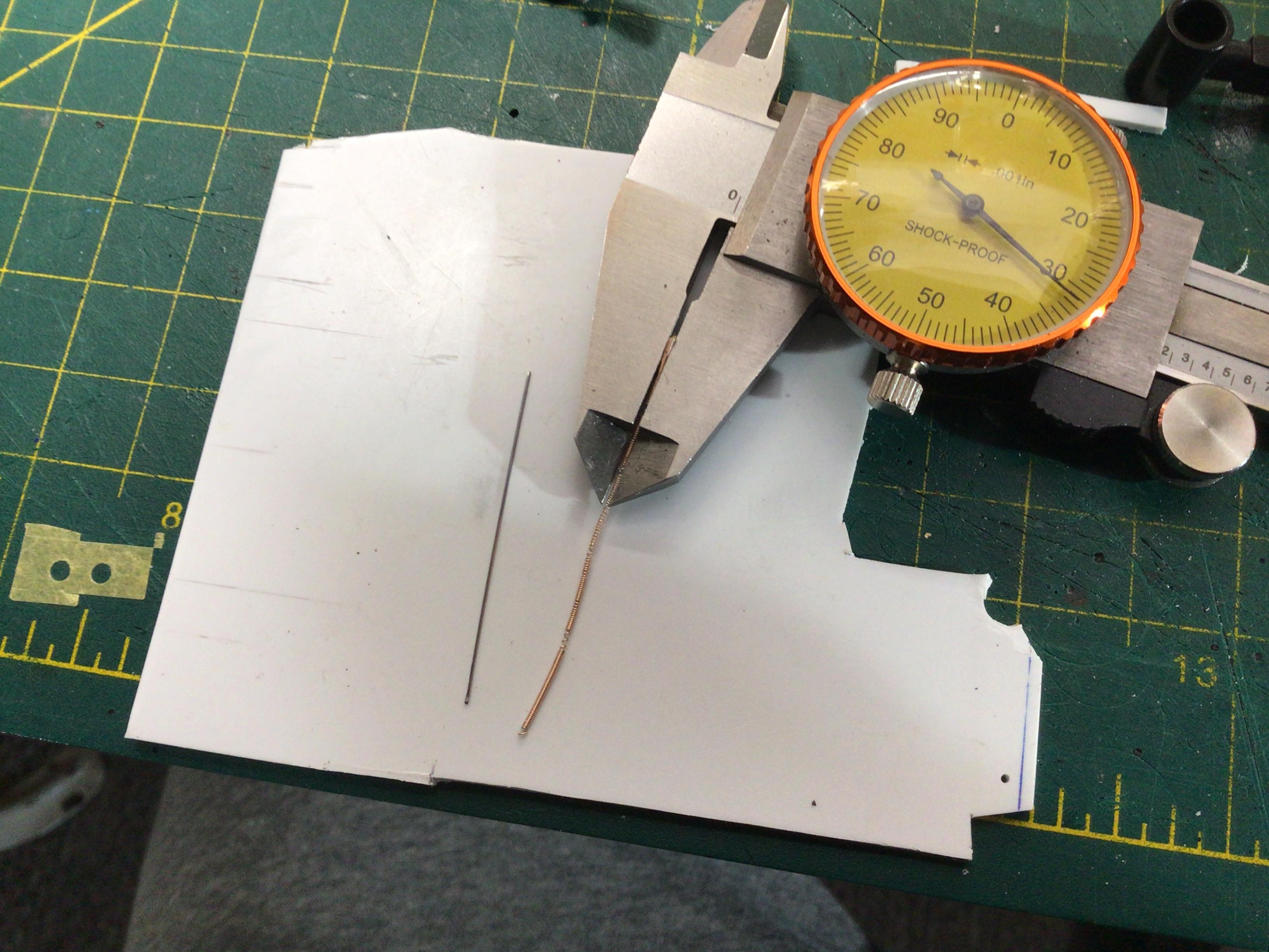

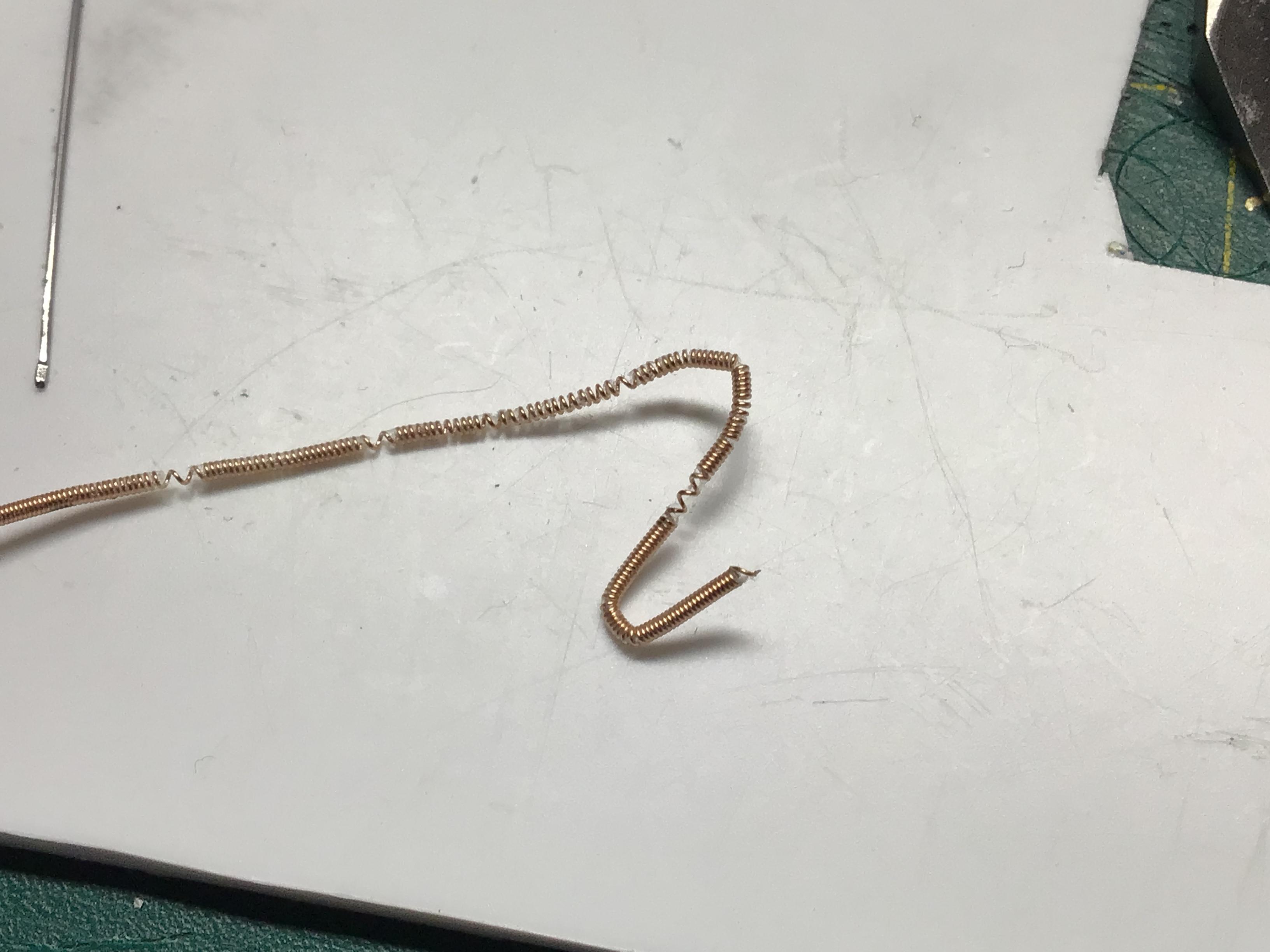

NOBLNG Posted March 24, 2022 Posted March 24, 2022 On 3/24/2022 at 4:53 AM, Bainford said: Would a wound guitar string work? Paint it black. It would have to be bent to the shape you want, wouldn’t be flexible. Expand On 3/24/2022 at 7:33 AM, peteski said: If you could remove the center core wire then it would be much more flexible. Not sure if that is possible though. Expand It is possible. It doesn’t come off easily, and it tends to kink rather than form a nice radius bend. It seems to have some sort of glue or plastic binder, so I dipped it in lacquer thinner before stripping it.
