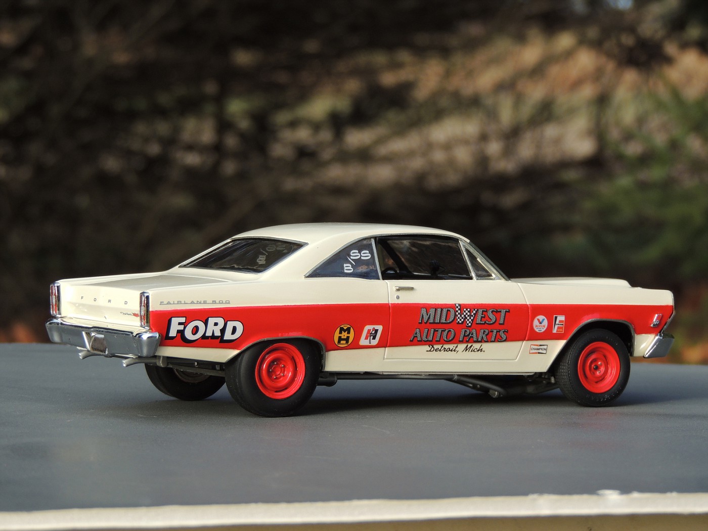

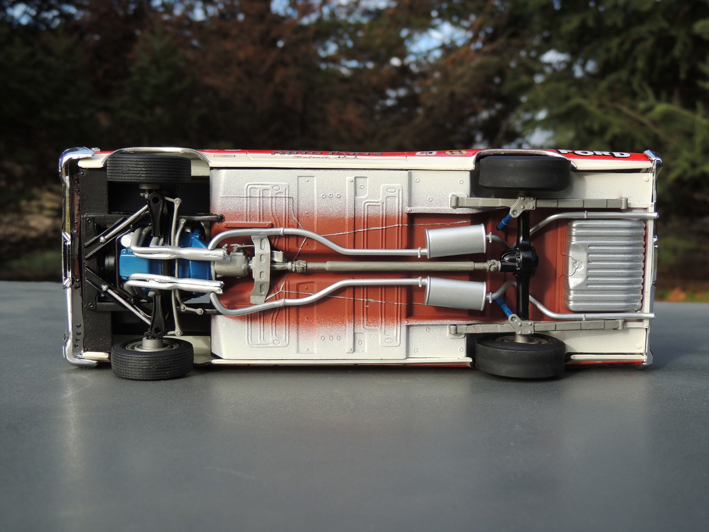

bogger44 Posted March 29, 2022 Posted March 29, 2022 22 hours ago, deuces wild said: Wish the kit would have included a set of headers, slicks and traction bars... No biggie.. I'm sure I have those in my parts stash. Except for the headers.. 8 hours ago, Plowboy said: The headers from the '64 T-Bolt should be almost a drop in. 5 hours ago, 1972coronet said: Both are FE engines, no? I've never had me hands on the Revell Thunderbolt; I have seen the contents of the AMT GT/GT-A. A number of years ago I built a Super Stock out of mine and used the Thunderbolt headers. It was an extremely tight fit. I got them to fit fairly decent but it wasn't easy, and took a lot of trimming & filing of them and the front frame rails (best I can remember). I do believe I had to file down some of the tubes to clear the shock towers (maybe the towers a bit too?). They ended up hanging down petty low as well. I'm pretty sure one could get them to fit better than what I did here. On another note, I had to slide the front spindles a bit forward to get the tires lined up in the wheel wells. A couple reference pics. Yes, this was built before knowing the exhaust didn't have to be hooked up to the headers per S/S rules LOL. 4 1
Plowboy Posted March 29, 2022 Posted March 29, 2022 That's a cool build and some good info Tony! I wonder if swapping the frame clip from the T-Bolt would make installing the headers easier? I made a set of headers from copper wire for one several years ago.

deuces wild Posted March 29, 2022 Posted March 29, 2022 5 hours ago, bogger44 said: A number of years ago I built a Super Stock out of mine and used the Thunderbolt headers. It was an extremely tight fit. I got them to fit fairly decent but it wasn't easy, and took a lot of trimming & filing of them and the front frame rails (best I can remember). I do believe I had to file down some of the tubes to clear the shock towers (maybe the towers a bit too?). They ended up hanging down petty low as well. I'm pretty sure one could get them to fit better than what I did here. On another note, I had to slide the front spindles a bit forward to get the tires lined up in the wheel wells. A couple reference pics. Yes, this was built before knowing the exhaust didn't have to be hooked up to the headers per S/S rules LOL. Thanks Tony for the pictures... Yes I do have a couple of the Revell T'bolt kits....??

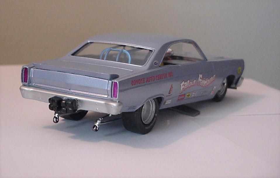

R.J Posted March 31, 2022 Posted March 31, 2022 I went way out of the box with the last Fairlane 427 issue. 5
stavanzer Posted March 31, 2022 Posted March 31, 2022 Sure is a terrific build, R.J. I like the Old NASCAR Racers. 1
