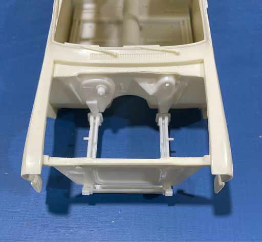

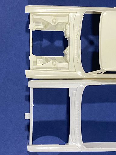

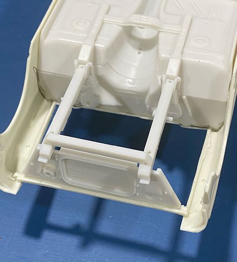

I did a side by side comparison of the two engine compartments and determined they were close enough that this should work without even putting a caliper on them. As I would find out, my assessment was right on the money, almost as if Moebius engineered their kit to mesh together with the AMT kit (I know they didn't, but it's fun to pretend, right?) I think overall the Moebius compartment may be 1 scale inch longer than the AMT as later you will see the moebius firewall ends up slightly farther back than where the AMT one was molded in, but the difference is hardly noticeable unless pointed out. You can see in this picture where I highlighted the upper edge of the compartment sheetmetal so i knew to remove everything on the underside up to that point.

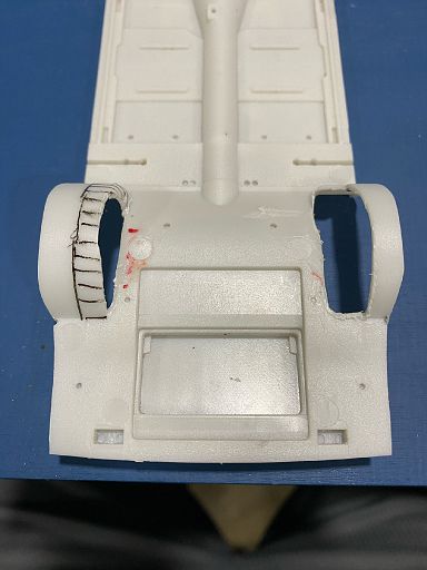

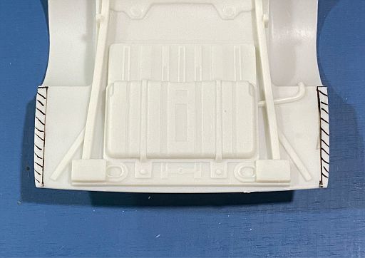

I set about with removing all the compartment stuff with my Dremel cut off wheel, sanding drum and then my razor saw and sanding sticks. Before I could test the fit I had to slightly narrow the rear area of the floor pan to fit into the wagon body. I cut out the areas highlighted in black with a straight cut where it transitions to the fender well and then finessed the area with a sanding stick to tightly fit the wagon body. Eventually the rear of this area will need to be extended a bit. I also assume the gas tank configuration is incorrect for a wagon, but haven't researched that yet, or even decided if I will tackle that feature at all.

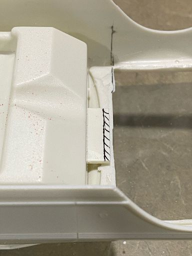

Now to begin the fitment of the interior. You need to shorten this tab on the front of the AMT bucket about 2mm. Don't go too far because you want that tab to hold the tub at the correct height in relation to the body.

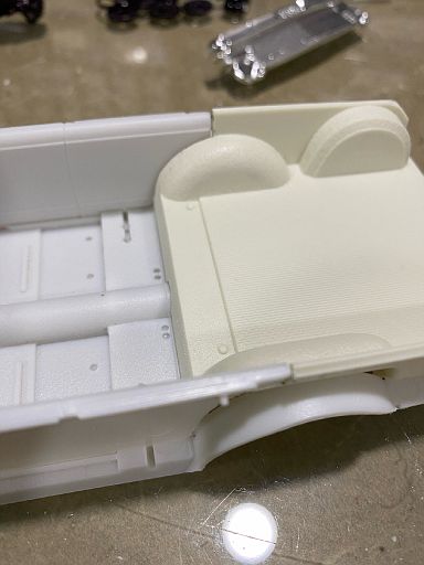

I cut the AMT cargo area away directly in front of the fenderwells and preserved the downward sloping sheetmetal to meet the Moebius floor. After removing the locating tab on the Moebius side panel where it meets the fenderwell I then used the panels as a pattern to show where I needed to cut away the side of the AMT bucket. Fortunately this is exactly where the inner door panel line on the four door wagon would be, so a gap here is prototypical to 1:1. Remove the shaded area and do some finesse sanding to get a good fit. Then repeat the process for the drivers side.
1648554438762

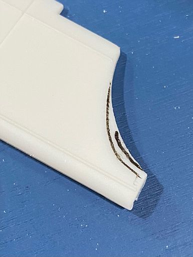

You will also need to remove this small sliver of plastic from the AMT bucket to allow the Moebius panel to fit properly and still allow everything to fit inside the body. It is the width of the vertical plastic that used to occupy this space.

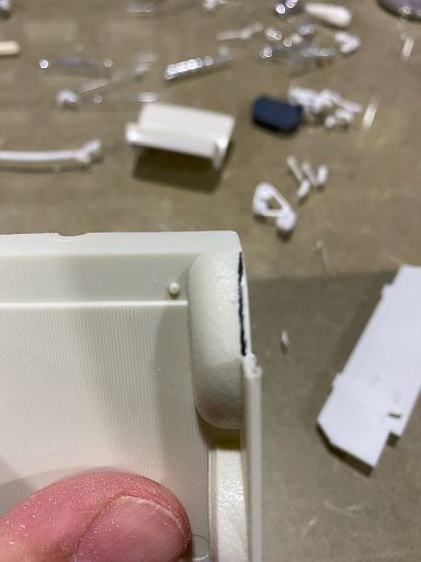

The drivers side rear fender well is a slightly more rectangular shape at its leading edge than the passenger side, so it requires a little more material be removed from the Moebius side to fit. Use the AMT fenderwell as your template, and remove material slowly.
1648554483678
Now you can see where all your hard work is getting you. You will need to slightly enlarge the arch where the cargo area fits over the driveshaft tunnel. Now everything is ready to test fit in the body.
1648554490781

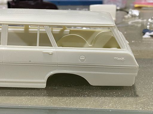

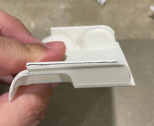

After you fit the interior into the body you will probably note that the cargo area now sits a little high compared to the window opening. There is a molded in parting line on the upper surface that serves as a great reference point for the removal of material. Run a fine line marker or pencil down that line and then gently sand the top surface until that line disappears. Now everything should line up.

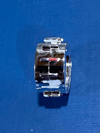

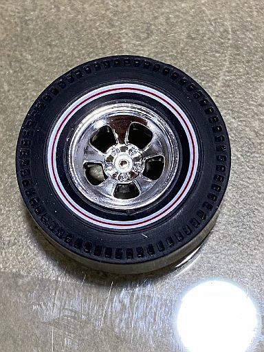

Decided to sort out the wheel and tire selection first. I really like the wheels in the Moebius kit, but something about the slicks leaves me cold. I don't think there's anything "wrong" with them, I just don't care for them. So, I set about to modify the kit rear wheels to fit a pair of the AMT Parts Pack slicks. Since I like the front tires from the kit this is a perfect opportunity to use up one of the cool red and white striped slick sets (really wish Round 2 would see fit to give us some matching red and white fronts, but oh well)
Moebius wheels feature ribs around the outside of their wheels, which must be removed to be used with just about any other manufacturers tires. However I decided not to completely remove all the ribs. The AMT slicks have a groove in the middle of the tire, so I decided to see if could still use the ribs to my advantage. I completely removed about 1/2 the ribs, and the other half I trimmed away the outer half (highlighted here in red). This allowed the wheel to fir very securely in the AMT tire.
1649674013517
No other mods were necessary, so here's the complete assembly

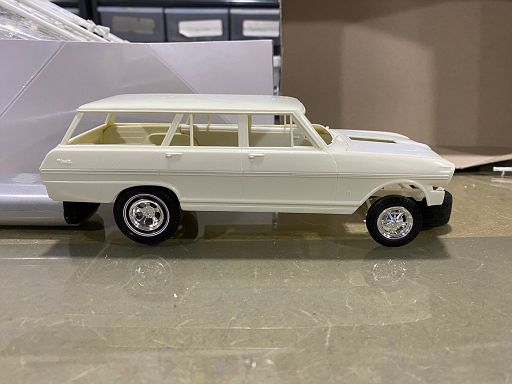

Now it's time for a proper mock up.
1649674031648
Note to others building the Moebius gasser kit, the instructions don't say which set of holes to drill our for the rear springs. Well, it's the outer set of holes. Don't ask me how I know. Now, where's my filler, lol
