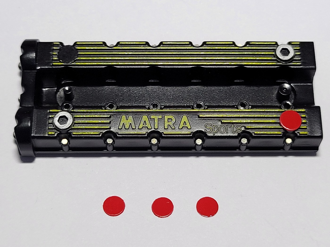

Here is a picture of an engine in a museum, (I believe).  Not an action shot but the details are the same.  I wanted to add the red circles and the white bits where the spark plug wires go in.  The white bits may actually be the spark plugs.  I honestly don't know.
P1020006 Fotor

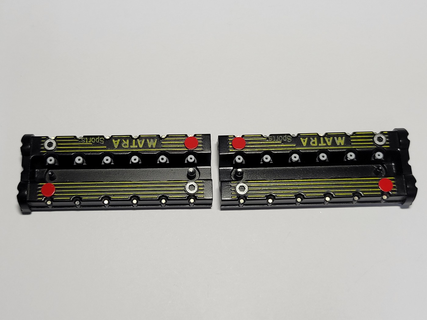

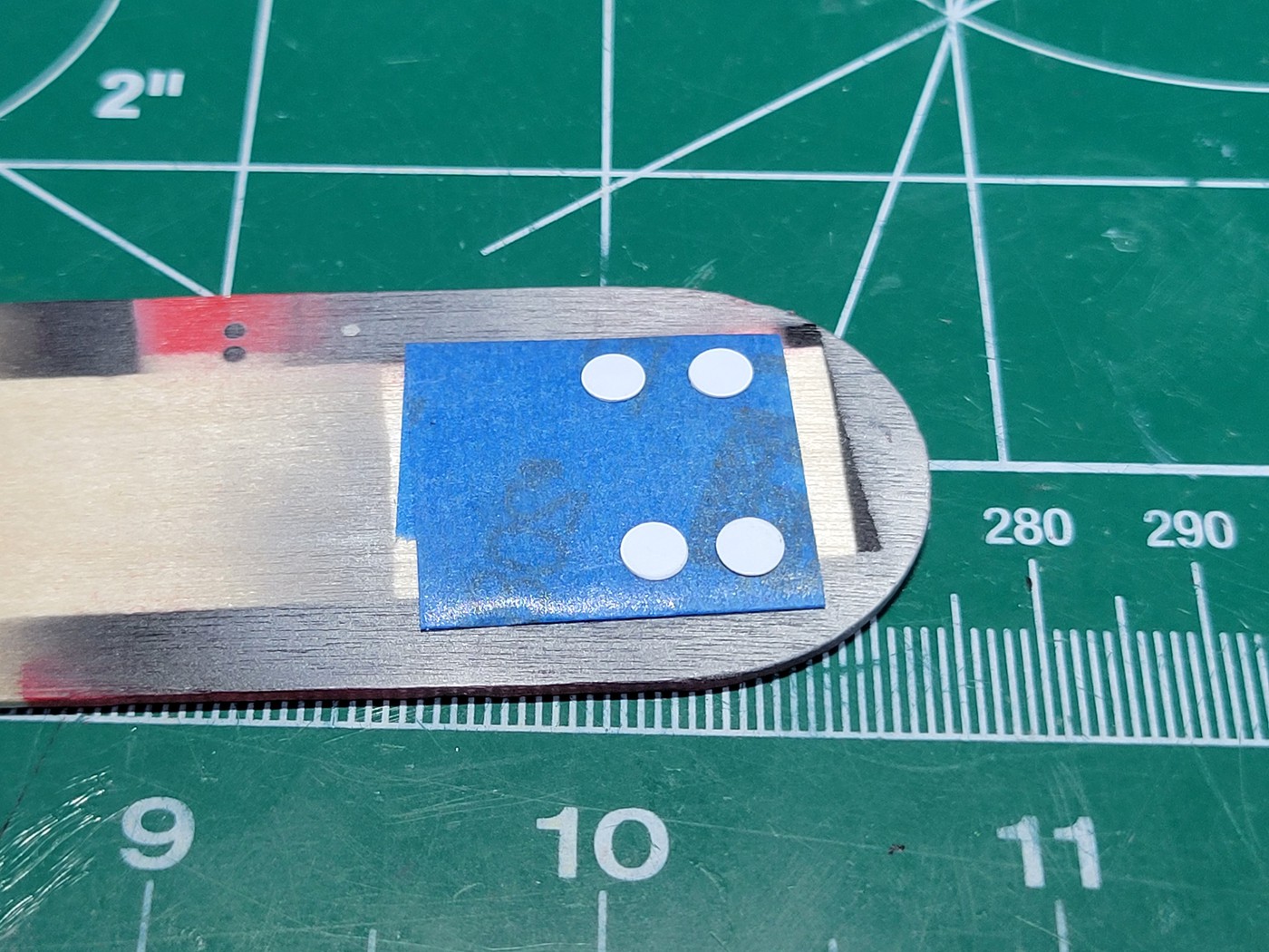

There was no way that I could neatly paint the 4 red discs on the cam cover.  I punched out 4 discs from sheet styrene and painted them red.  I did hand paint the silver parts.
20220626 155718
20220626 195343

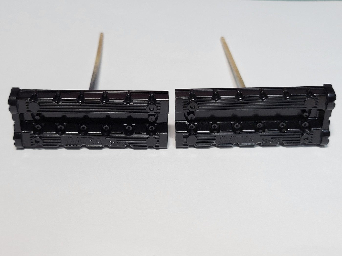

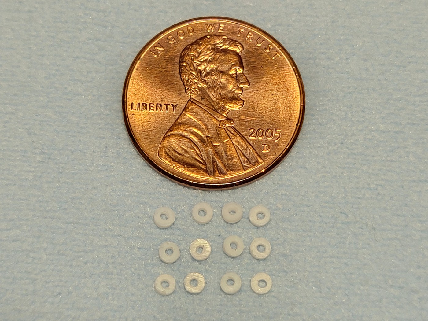

Next I sliced 2mm solid rod into .44mm pieces.  I hand drilled out the centers.  This is where the ignition wires will pass through.
20220626 212434
Those pieces were glued to the cam covers.  Here is the final product.  I may add a fitting to each cam cover once I figure out some of the plumbing that I would like to add.
20220626 214748
20220626 214841

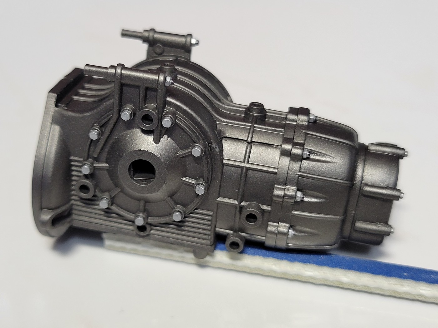

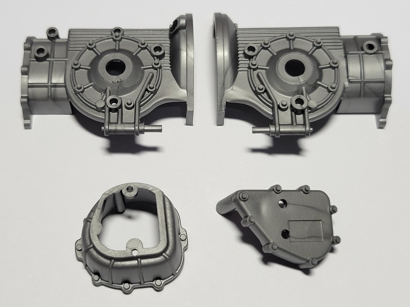

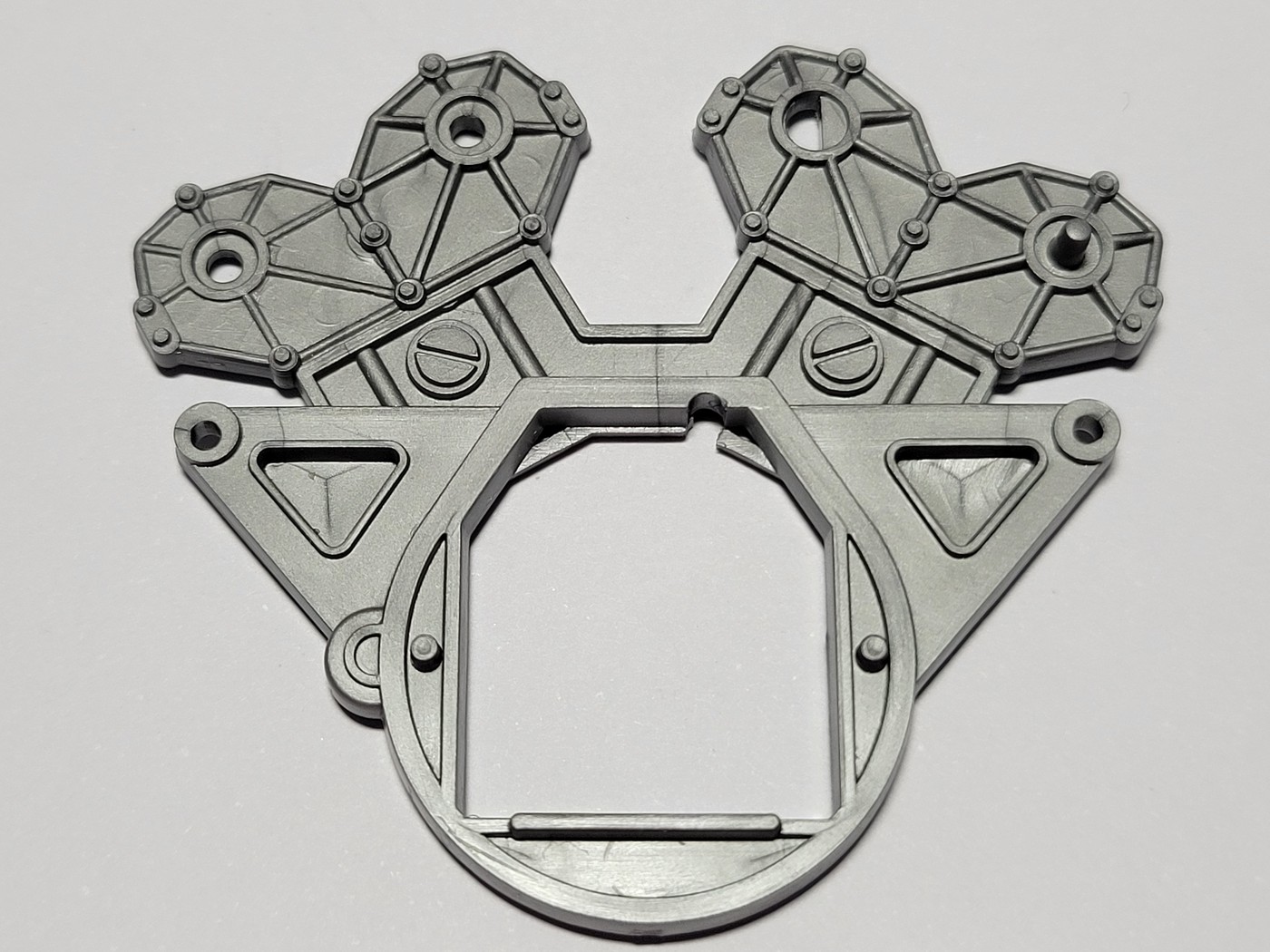

I'm still able to jump around and work on various sub-assemblies at this point in time.  This update is on the transaxle and the rear engine cover.  As I have said in previous posts, and will probably say in future posts, this is a late '60s tooling and a little disappointing in some areas.  Note on the 3rd picture how the bump outs where the bolt would go do not line up.  Also note the molded in bolt head detail is more of a round shape rather than a hex shape.  I decided to replace the bolt heads with aftermarket ones.  For the transaxle that required 36 individual bolt heads of various sizes.  For the rear engine cover there were 22 individual bolt heads.  Each one of the 58 bolt heads were taken off with a 1mm wide chisel, sanded smooth when needed and replaced by separately painted Meng ones.

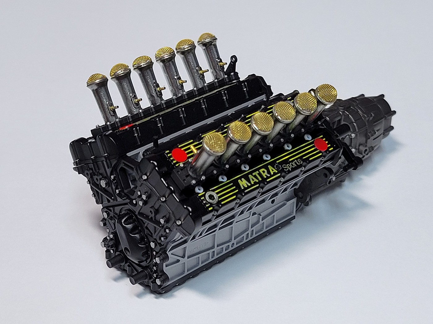

A bit of a milestone for me.  She is beginning to look like a proper drivetrain!  It was a bit nerve-racking to install 12 air funnels and get them lined up in all axes, (yes, axes is the correct plural of axis ?).  I have already began adding the ignition wiring but will save that for another update.  I did minimal detailing of the front of the engine.  It sits pretty tight against the driver's compartment bulkhead and will not be visible.
Let me know what you think and thanks for looking!

Love the screens on the air funnels. Did they come in the kit? That looks like a 1:1 engine I'm looking at.
Thanks, Mark!  I made the screens and did a lot of modifications to the funnels.  There are some good photos and descriptions towards the end of page 1 and the beginning of page 2.  The screens aren’t perfect but I think they do add a little something to the engine.  I left them brass for the simple reason that I like them like that more than silver.
