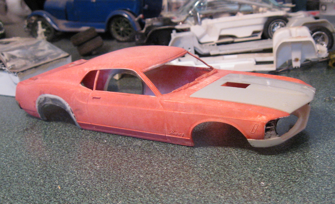

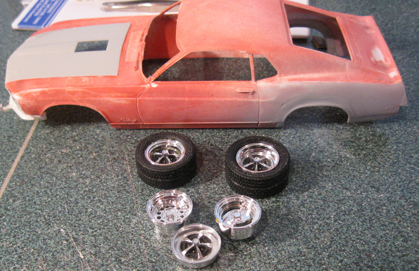

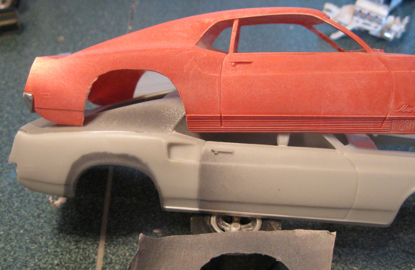

Got this in a trade a couple months ago in a trade with another member here [Thanks again Mike] Not exactly pristine but for me, the rareity of the kit warrants the work I'll be putting into it.

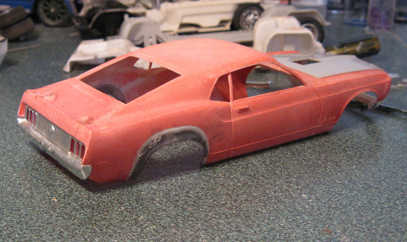

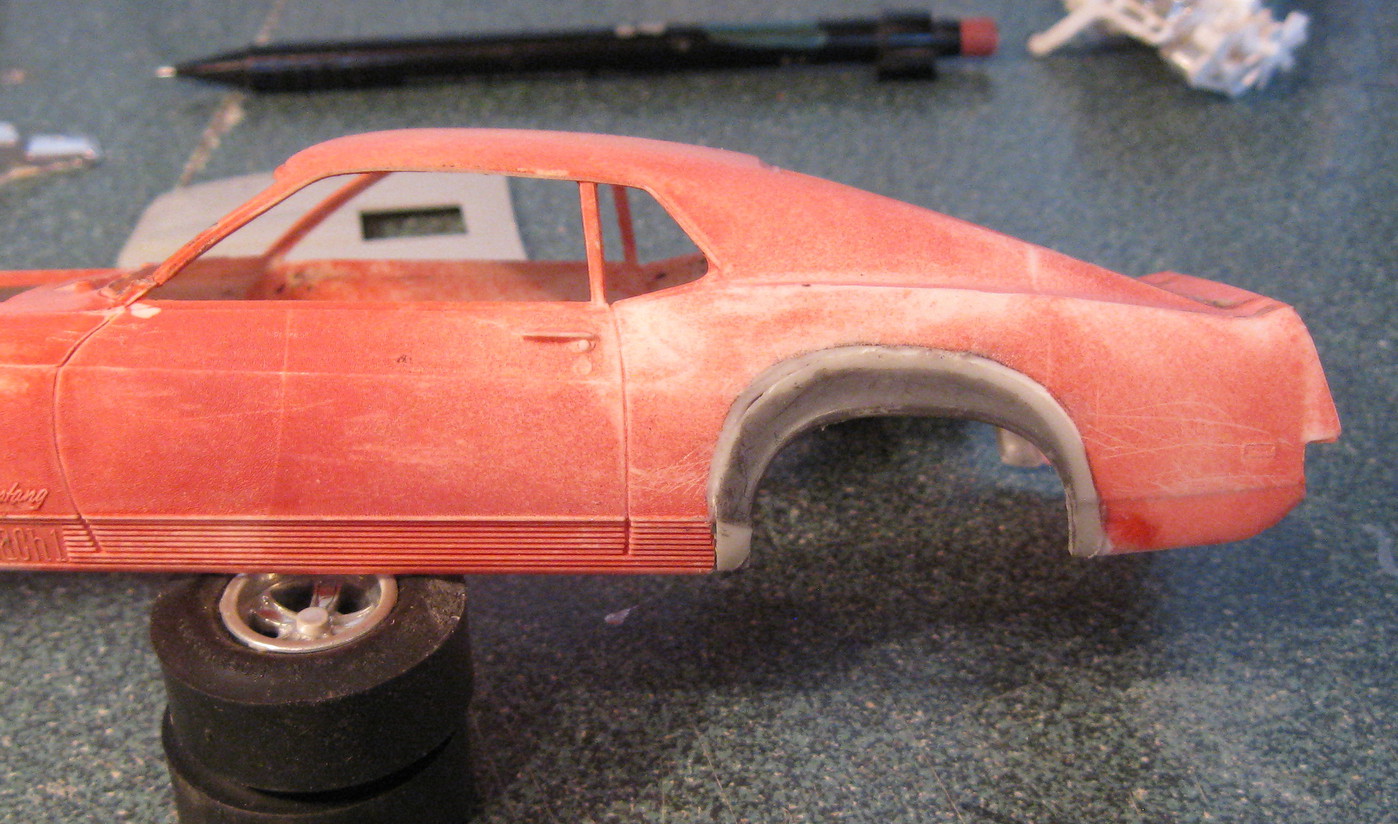

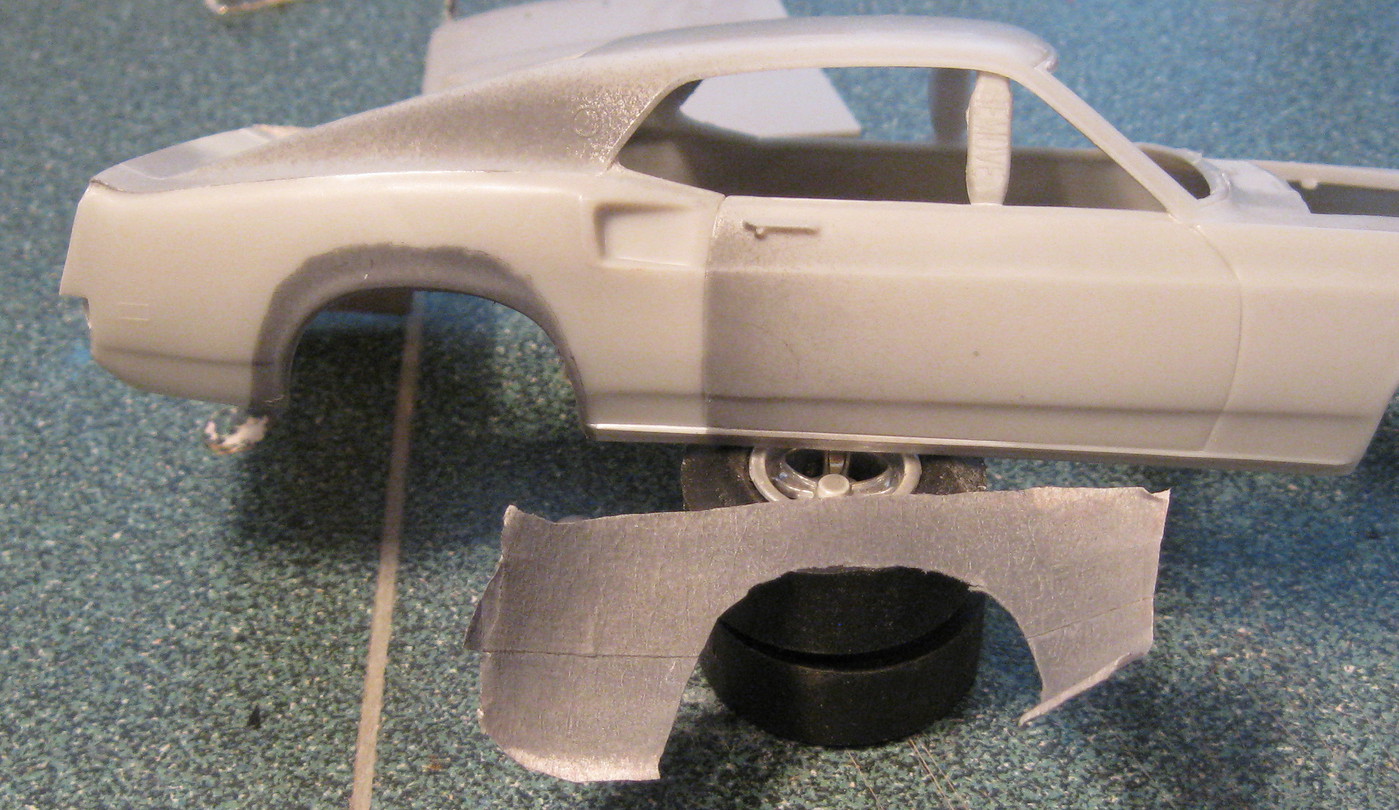

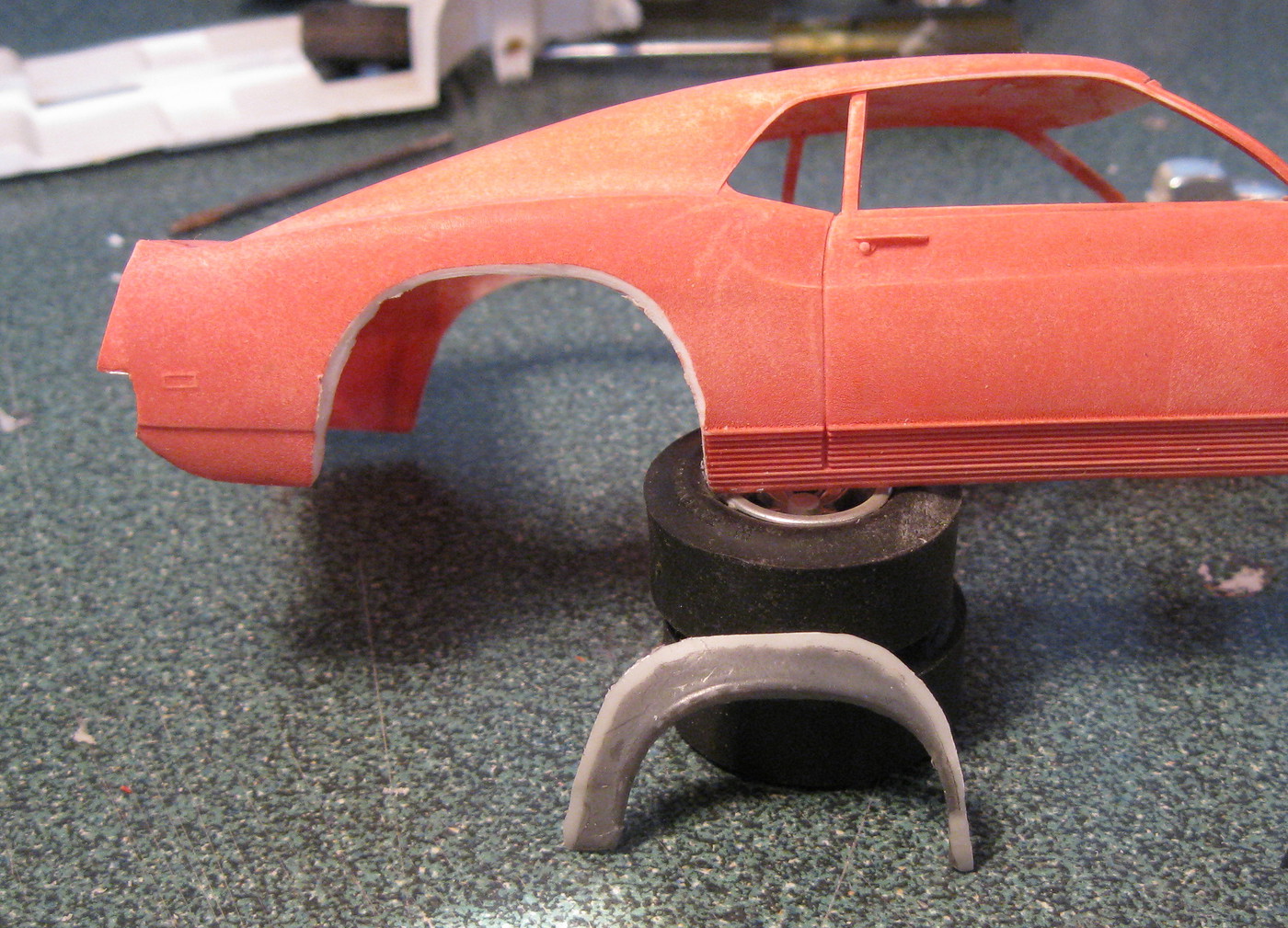

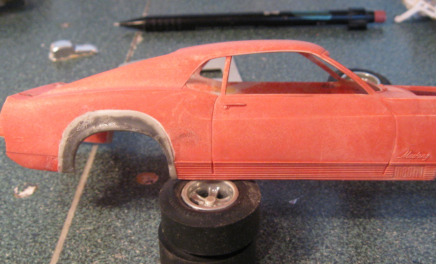

The rear wheel openings were gouged out, quite crudely at that. So I cut some repair panels from an MPC '69.
I beveled the edges of the patch and the cut opening to increase the glueing surface and make a stronger joint.

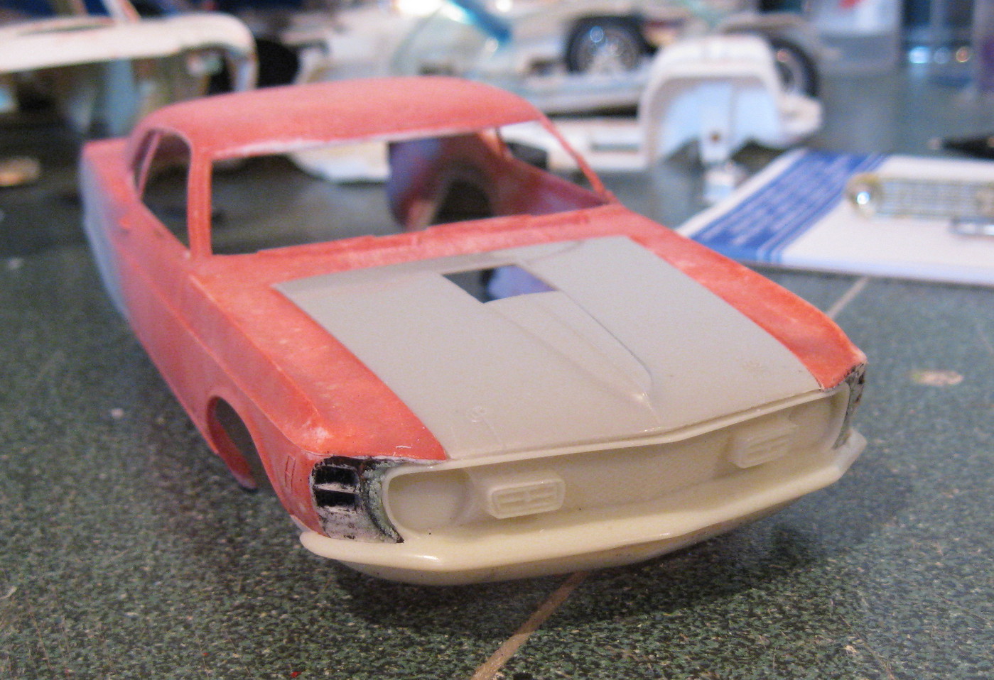

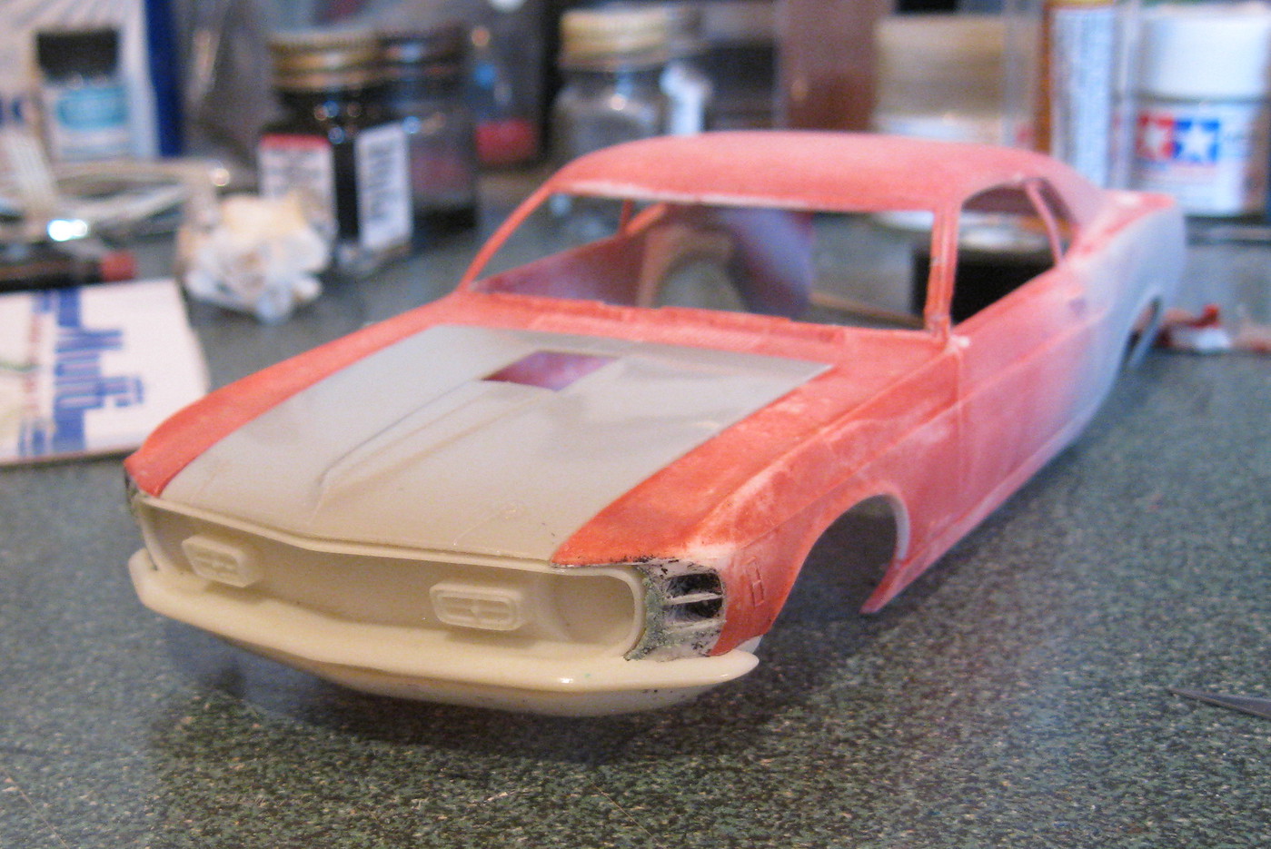

, , , and here it is with the repairs in place, the front pan cut from the chassis and glued in place to stiffen the body and the MPC hood sitting in the opening. The MPC '69 hood is almost a perfect fit on the AMT '70 body. I just need to sand the sides a hair for paint buildup. Right now it's a very snug fit.

Thanks Craig.
The original annual AMT '69 Camaros had them too.
I think this pair will eventually find their way to the back axle of a '40 Willys.
  • Like 1
With all that trim, please tell me this one is going to be a stock Mach1!
It'd be a shame to grind off all that beautiful engraving.

This body line looks odd, or is it just the angle of the pic? See blue arrow.
Perhaps remnants of where the mold was modified to fill in the fake scoops on the 69 body.

I wouldn't do that to you Patrick. ?
It's going to be close to stock. Just mag wheels of some sort and probably a bit of hop-up parts on the engine. Grabber blue paint.
It would kinda defeat the purpose of hunting down one of these unicorns to customize it. That could just as easily be done with a common as dirt '69.

It's there. It won't be for long though. I think it was remnants of a design choice Ford changed their mind on between the time the plans were sent to AMT and the body cut and the time the actual car was released. used to happen all the time with promos.

Thanks, now I can breathe. This Mach1 in Grabber blue will be an excellent choice!

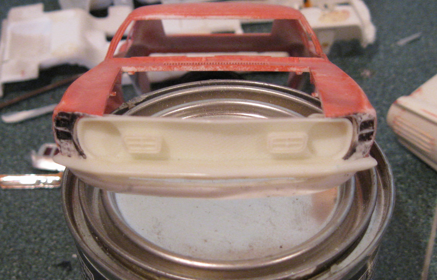

 I now have a front grille. It looks like the grille opening on this body was widened slightly for some reason and I'll fix that. I did fill the gaps but it doesn't look right. The slots on the sides of the grille are too narrow. I'll have to redo the repair work and make them wider before it goes any farther.
I may cut the bumper free and use the MPC bumper as I only had to do a bit of sanding to the inside of the ends for it to fit like it was made for this AMT kit.
I have the wheel and tires picked out. Going with some AMT Gatorbacks with 55s for the front and 40s for the rear. The wheels are modified Magnum 500s form a Monogram Superbird kit with the rims swapped from the wheels shown.

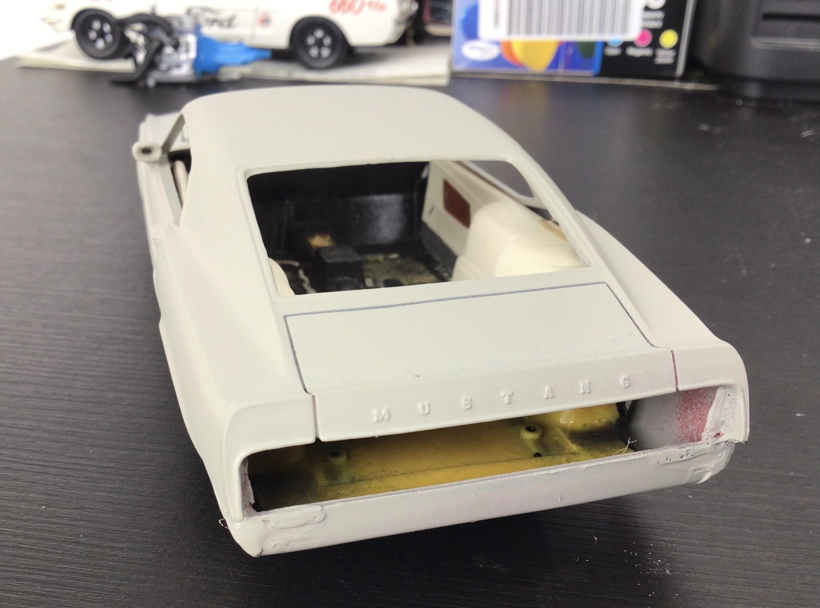

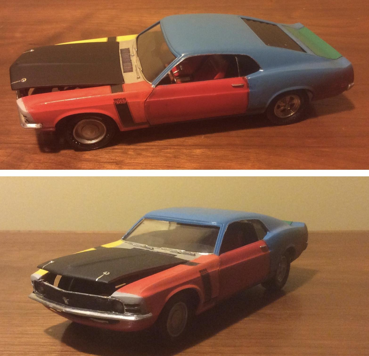

Here’s another 70 glue bomb special.  It’s not a Mach1 so I think it’s an MPC Boss 302.I hope to find the rest of the parts that were with it.  I may have swapped hoods with another kit as this one looks more like an AMT one.  I guess the good news is I can use most of the parts from the more common 69 MPC fastback.
Edited by vamach1
MPC kit
  • Like 1
I'd definitely say that's an MPC Rex. Nice one.  Most of the '69 parts should fit right on there, including the bumpers. The hard parts are the front grille and rear tail light panel.
I suspect it's short like the current '69s are but if you get ambitious you could lengthen it with pieces sliced from the doors and roof of the '69 donor's body.
Edited by Can-Con
