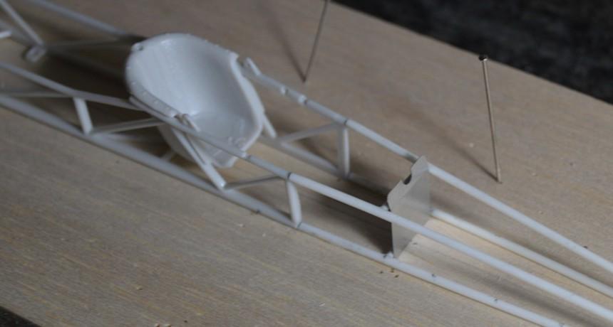

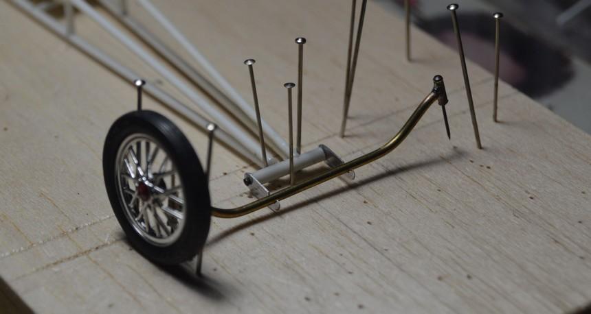

Straightliner59 Posted May 6, 2022 Author Posted May 6, 2022 14 hours ago, AmericanMuscleFan said: Great start and cool project Daniel! You did a great job on the slicks, I did the same kind of treatment for the same tires on one of my old builds and the visual effect is much more realistic, the finish looks much more like real tires. Another good subject where your skills will be highlighted, I'll be back to see your progress my friend! Ah! Glad to see you, my friend! The sidewalls on these old MPC slicks are thinner than I expected. I rubbed right through one of them. Fortunately, I have a ton of them! I've bent the "rain gutter". It needs to be cut to shape, and fine-tuned. I also made a pair of torsion arms, and bent and soldered a front axle. I'll make some tabs to solder to the axle, then drill them and the torsion arms, so that they can be "bolted" together. As always, questions, critiques and comments are welcome. Thanks for looking! 1

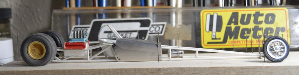

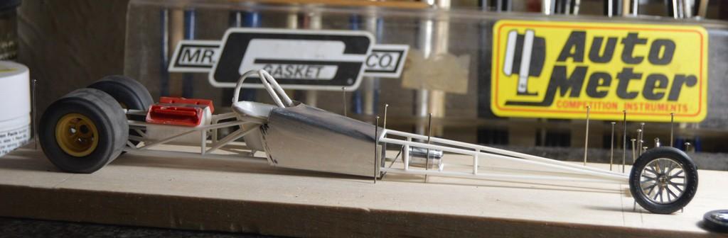

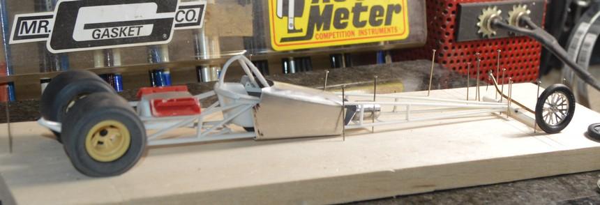

Straightliner59 Posted May 8, 2022 Author Posted May 8, 2022 I've gotten the body farther along. I also turned a Moon 2 gallon dragster tank (8.5" diameter by 15" long). I had to use a file on one end, because the tank, once parted free, was too short for my radius tool to reach the second end. I think it will be okay. I got the rain gutter shaped, and made a cowl. The cowl will have more work performed, to make a greater flare, around the opening. Next, I'll see about getting it on the wheels. I need to build and cast a pair of breathers, and two different sets of valve covers, and "Donovan-ize" a set of 392 heads, and mold and cast those, as well. Anyway...questions, comments and critiques are always welcomed. Thanks for looking! 1

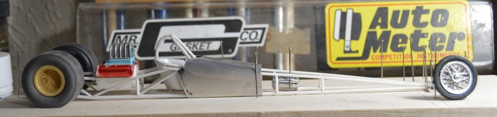

Straightliner59 Posted May 8, 2022 Author Posted May 8, 2022 Ride height determined. Looking good, there! 1
